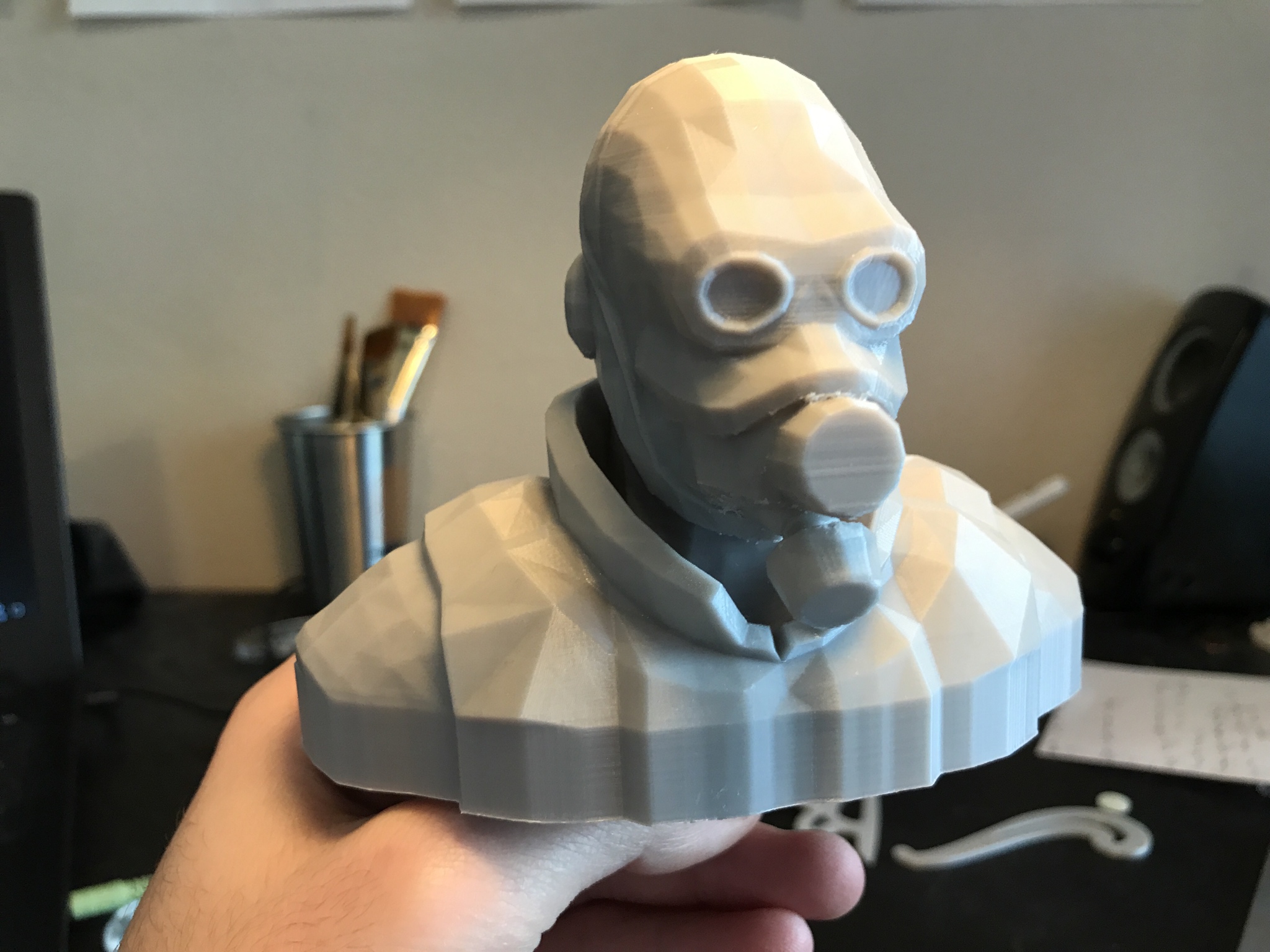

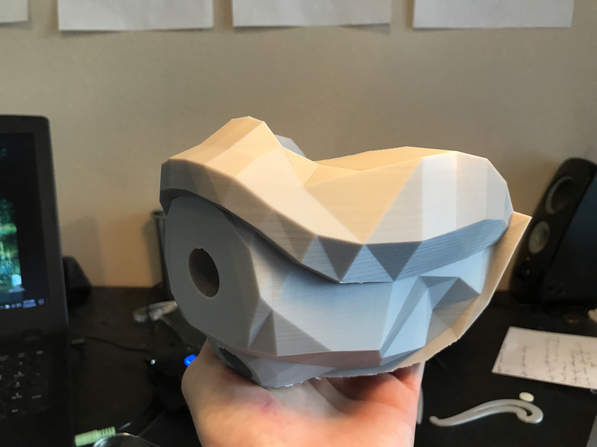

Because my goal was absolute accuracy, I needed to make the helmet as close to scale as possible. I took the high res model by mb214 and decided to print it. I figured the whole helmet would be too large for my Ender 3, so I cut it in half.
Hmm, not great. I printed a bust to see the whole thing.
Yikes, that is not great. Too low poly, I needed to smooth this model.

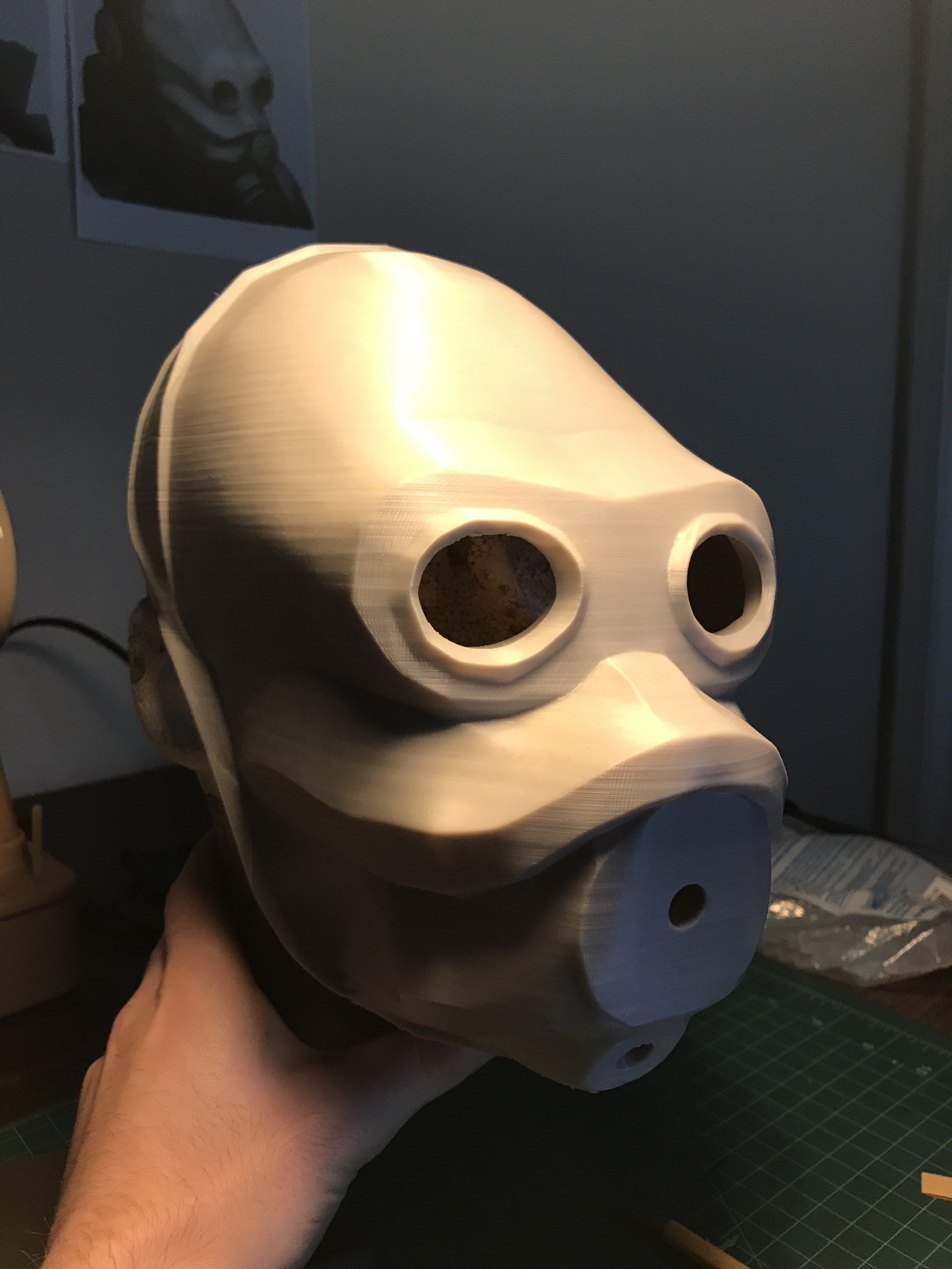

The only software I know how to use is Sketchup, so I was basically impotent in this matter. I tried the 3D builder that's built into Windows nowadays to see if I could smooth in there, but no luck. So, I paid a Venezuelan girl on Fiverr $17 to do it. It turned out great.
I will likely print another one in the future when I learn how, but I wanted something quick. This will serve my needs as a prototype. Also, I printed it too narrow to wear. I hope to convert it into a vacuum forming buck.

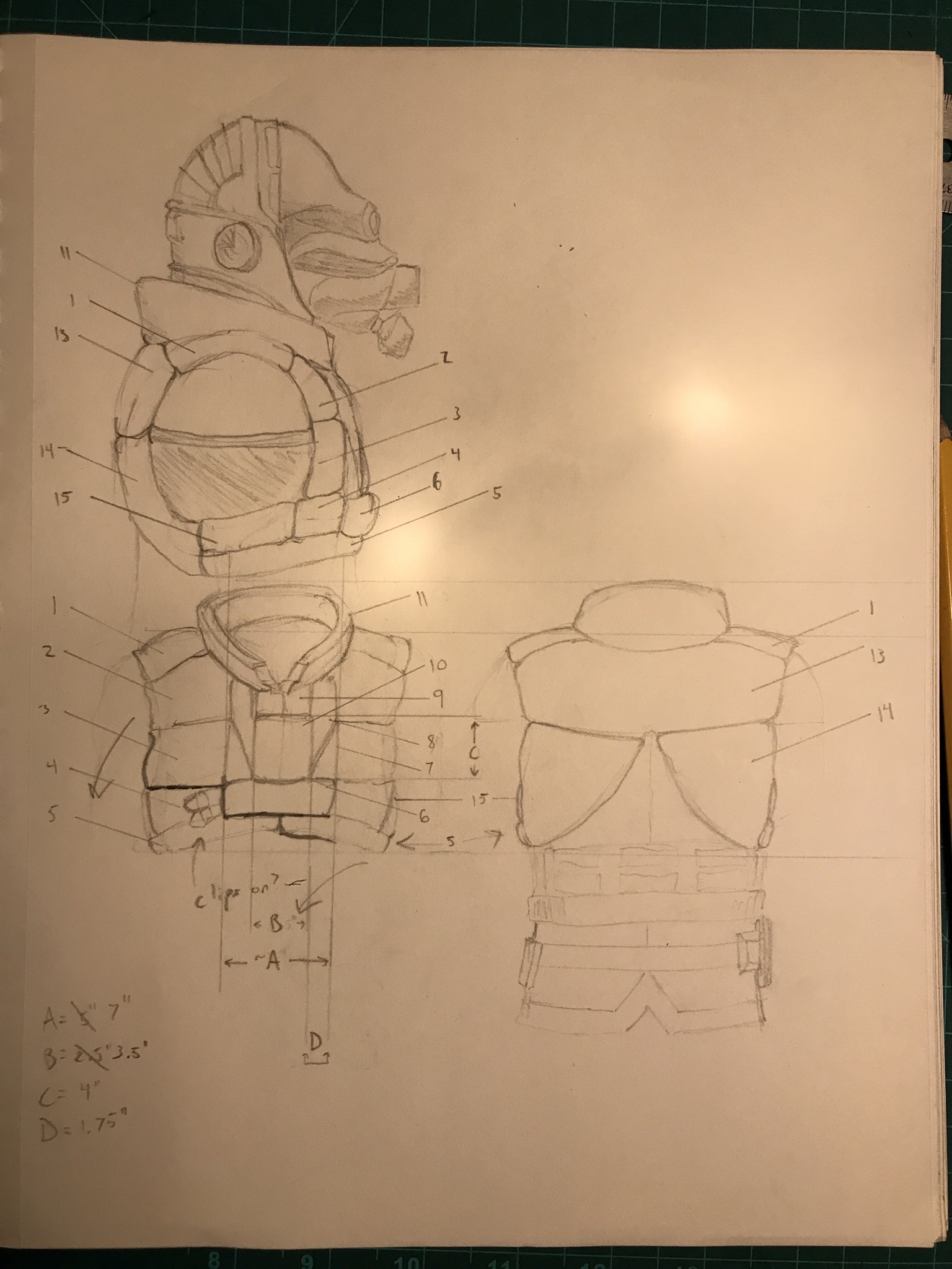

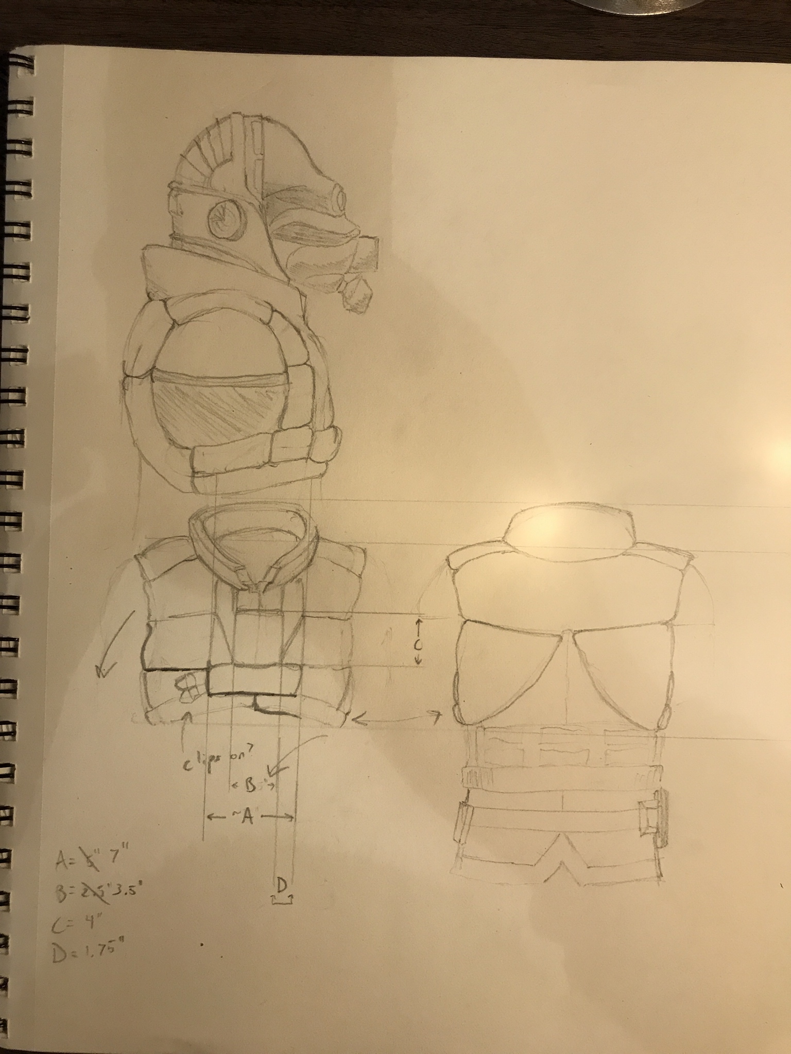

The first thing I did was a sketch of the vest, as seen above. This helped me think about the construction of it even deeper than I had been visualizing. I wanted to mimic the appearance of the game, I did not have to adhere to the in-game construction. I had been thinking for a while that building each block of the vest out of foam, then joining them together would be superior to just sewing over batting. The vest looks more like armor than it does a pillow.

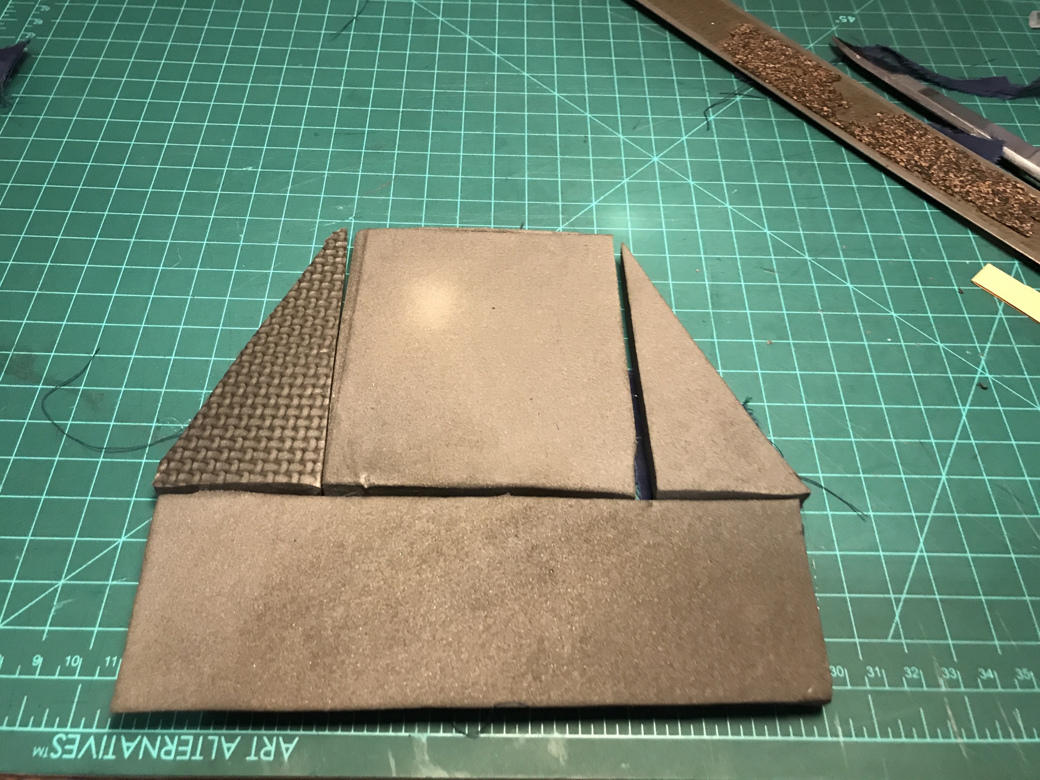

I got to experimenting.
I started with the center.
I used short pieces of cloth to join the cores in the back.
Then a quick mockup.
Hmm, no. That won't do. Too flat and weird.

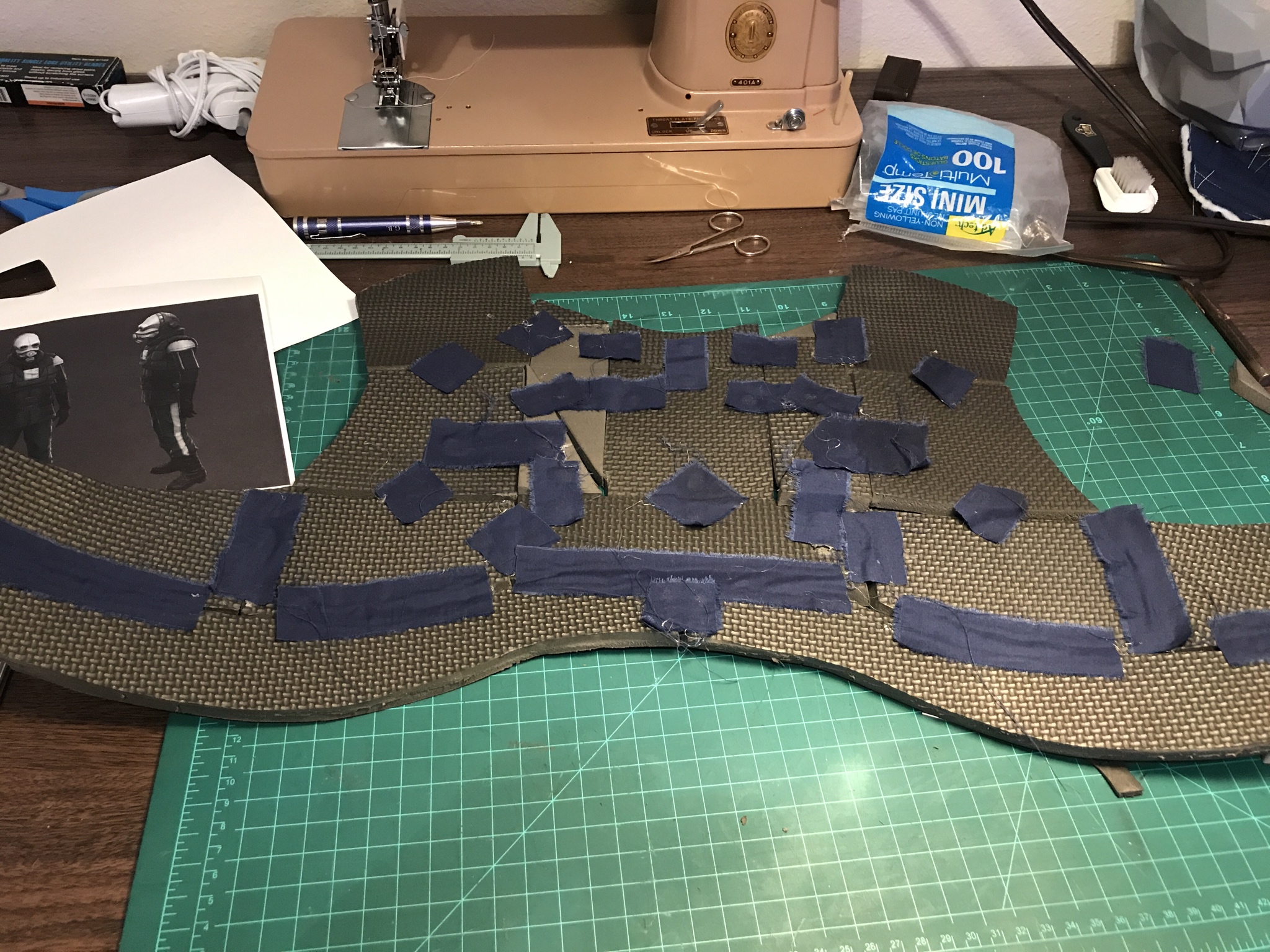

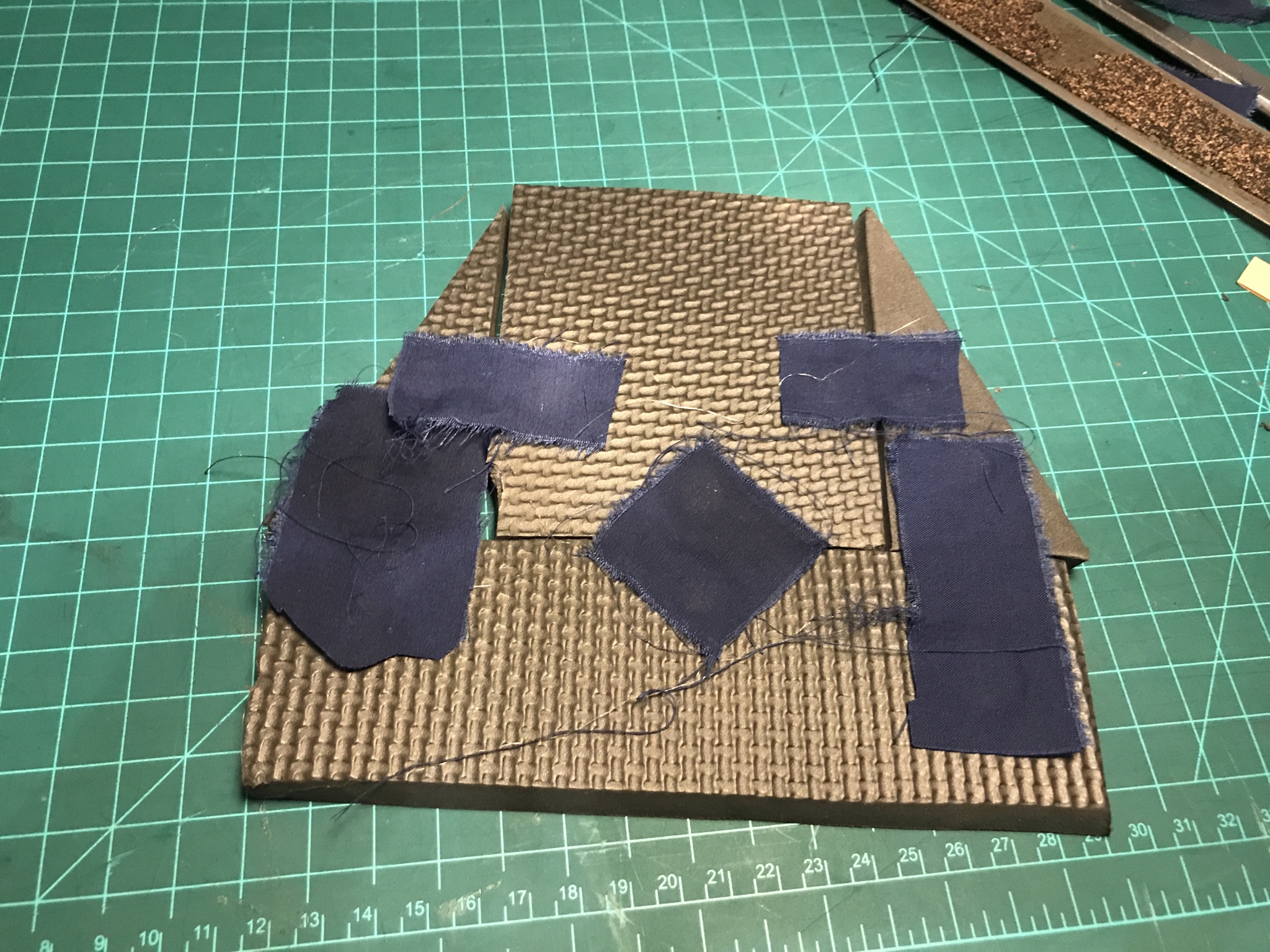

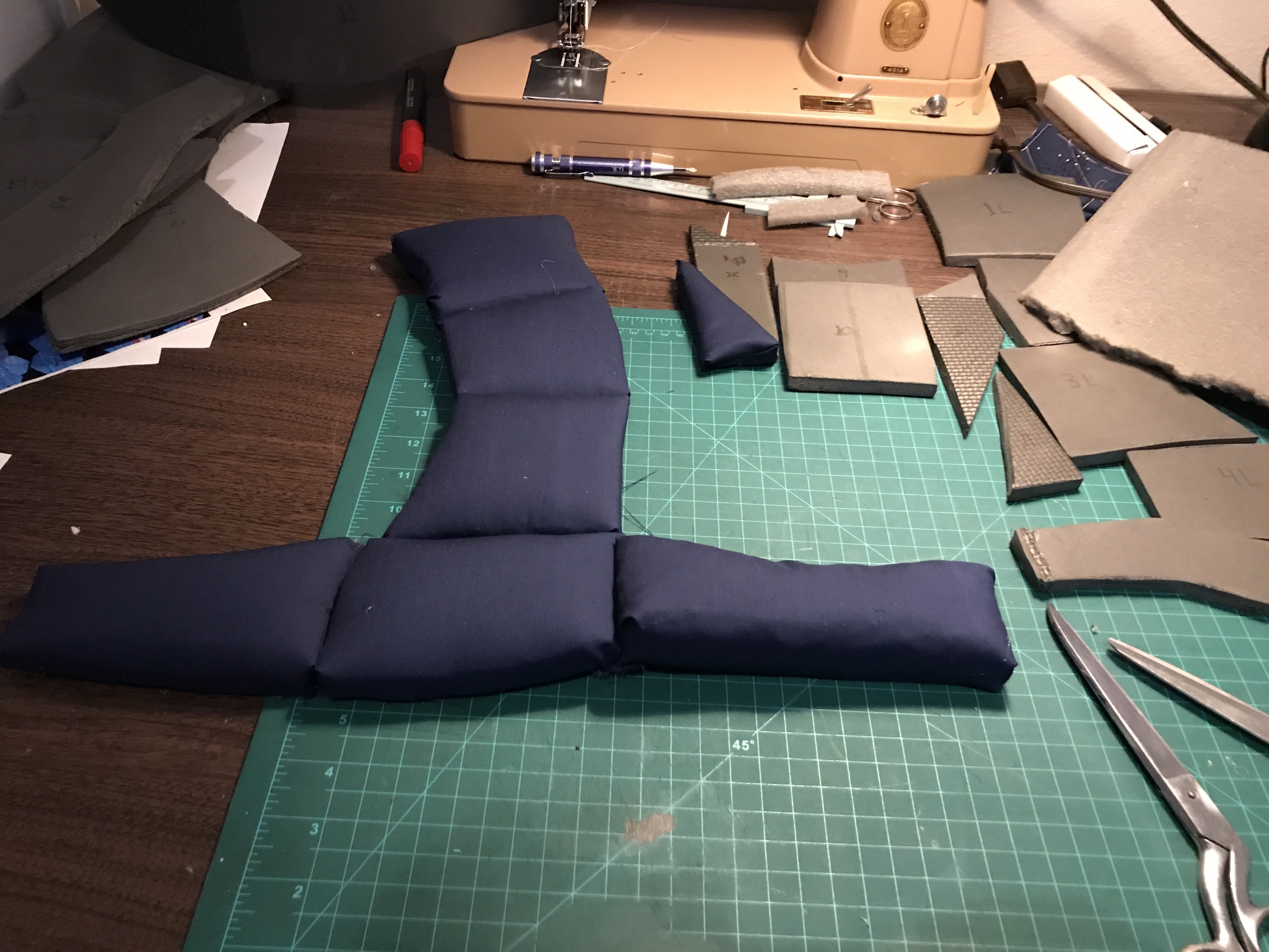

I forgot about the cloth for a bit and just focused on completing the foam pieces of the vest. I'd worry about the wrap later. It is upside down because I am a scumbag.
Then I glued a strip of cloth between each seam on these.
Shaping up!
There are a lot of pieces!
More to come!

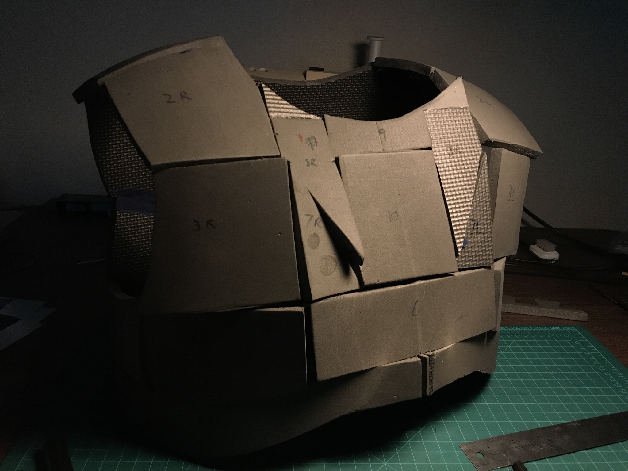

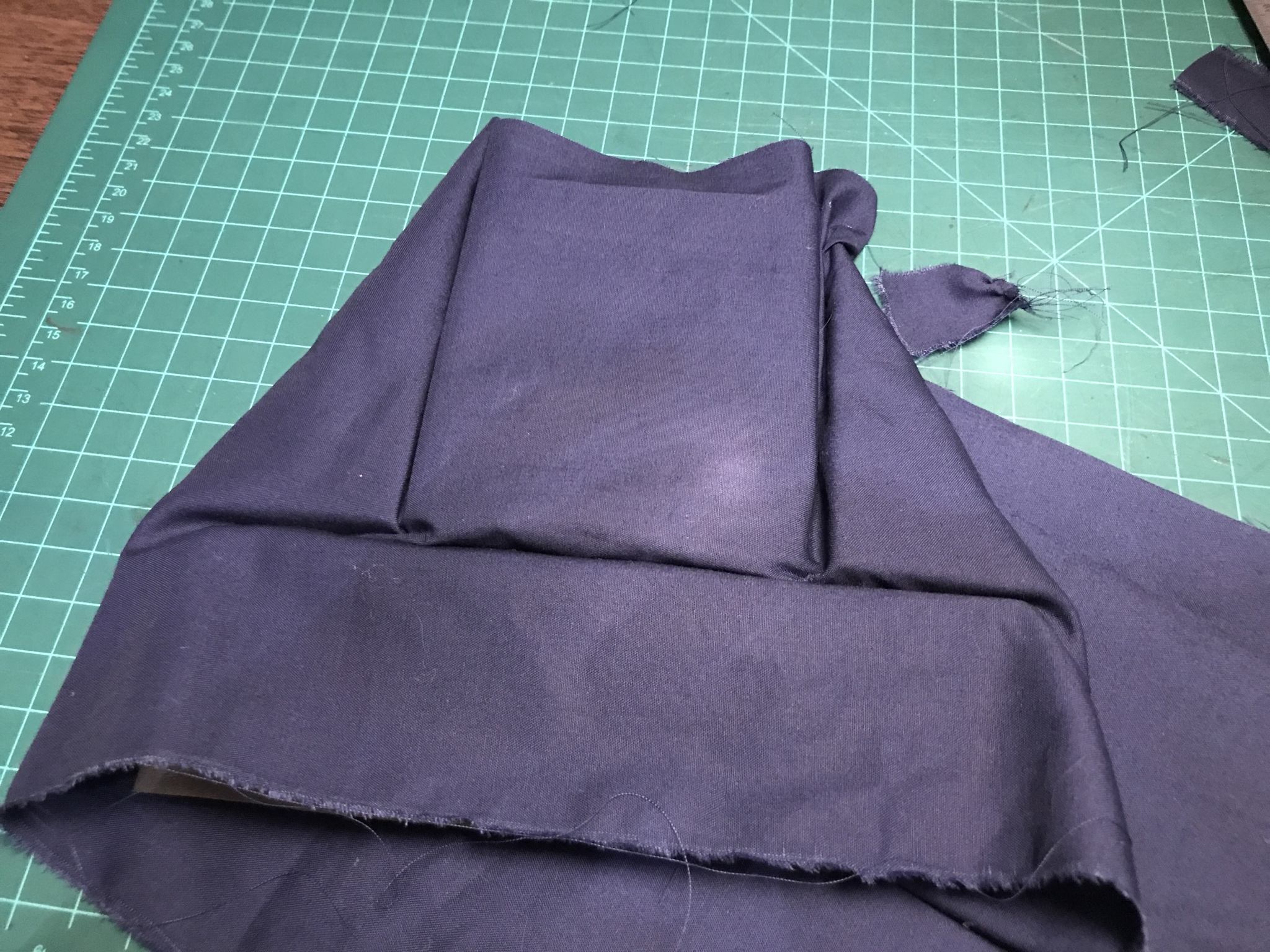

I kept building and ended up with this.
I was liking how it was shaping up. I ended up eyeballing the collar. It's not quite there, in the model it flares out quite a bit while mine is straight.
Quick test fit. I am digging this.

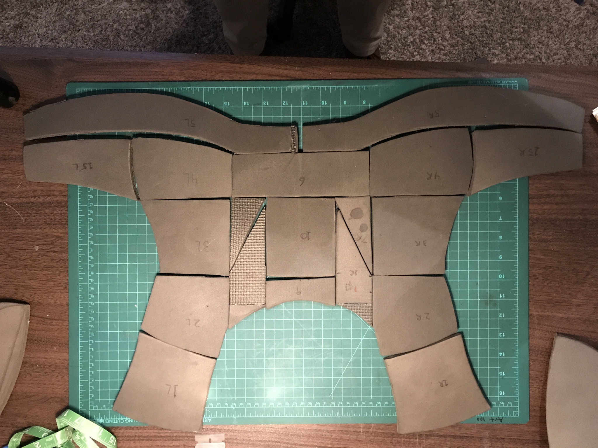

Then, I tore it all apart and took a picture of each piece on the mat so I could digitize them as templates. I'll upload the finished templates when I'm done digitizing them. Or, I can upload the raw images if someone asks for them.

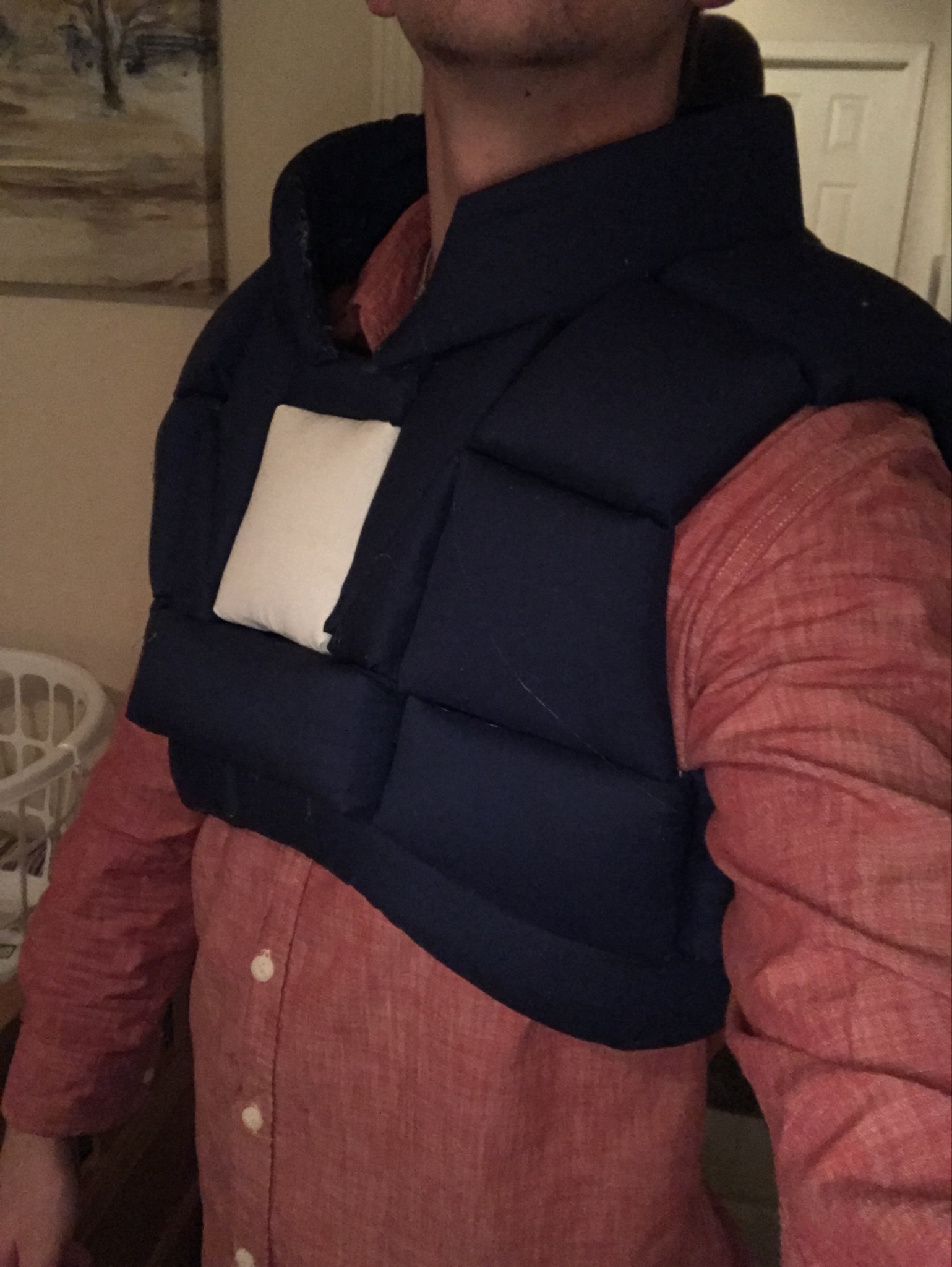

The collar was tricky, but it turned out alright.
And it fits perfectly. That was a bit lucky, since I completely forgot to measure against myself. I only scaled it by eye to the model image. I compared the front chest box width to the helmet width. Since I had the helmet, I could do the same.
