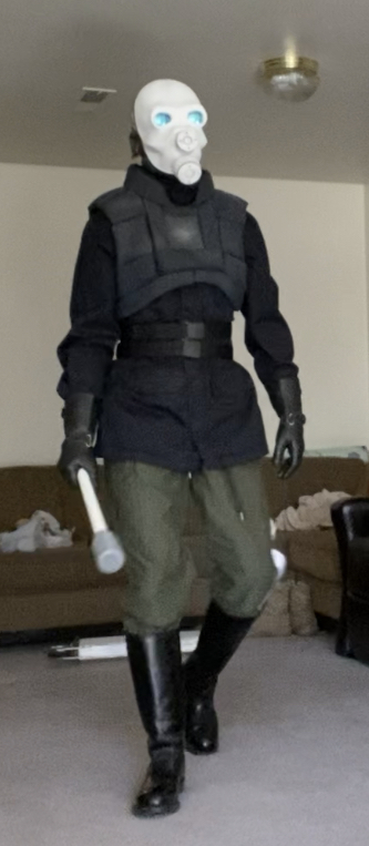

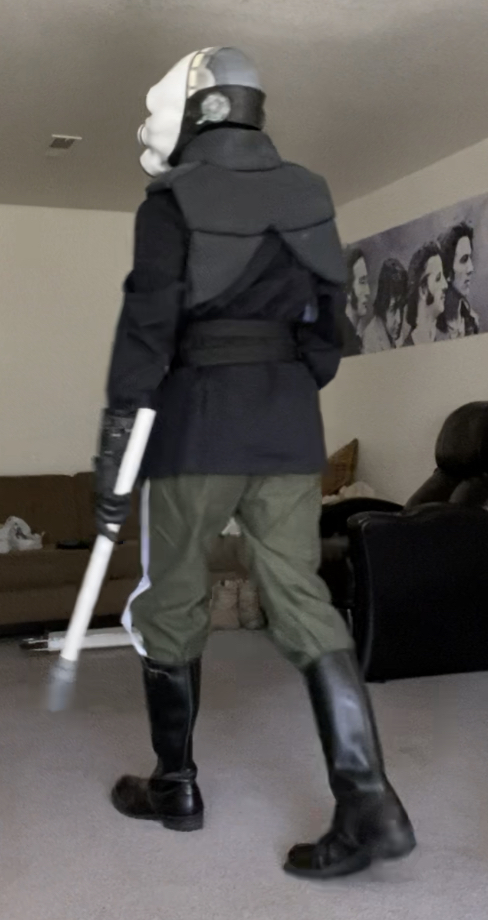

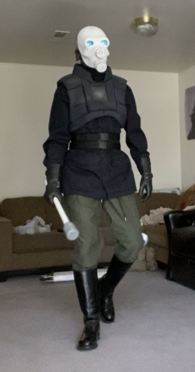

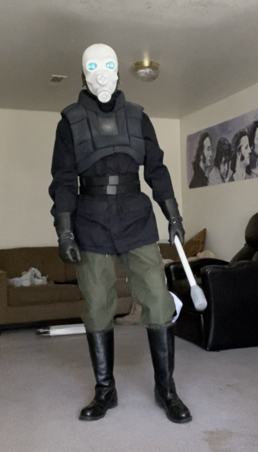

Little test fit to see where we are. Digging it.
BOO
Comments, questions, critiques?
Looks absolutely fabulous! Only thing of note that stuck out to me was the bottom of the vest, is it just me or does the arch look a little high?
As a person who owns an actual flak vest, it would seem a bit impractical to mold it perfectly to the shape of the ribcage, when the stuff below it needs equal protection too. Maybe that's just me nitpicking too much though, and I fully understand the modifications we need to make for comfort. (seems like it would be hell to bend over in eva foam while trying not to damage it) Aside from that, this is one heck of a cosplay! Definitely gonna be watching this with interest.
I am not familiar with the character outside of this thread but I love the process and the outcome so far. Particularly on the vest construction and methods presented . I love it. It is looking great and props for persevering and getting it this close to completion!
Oop, you’re totally right! I have a bad habit of forgetting to refer to my reference
I’ll see what I can do about correcting this. Right now, the front and back of the vest aren’t actually attached, which is why you might have noticed me keeping my upper arm pretty close in. This might have the effect of bulging out the front, making the center seem even higher.
As for practicality… the metrocop really is a rather impractical design, especially compared to the soldiers. But, like you said— that’s costumes!
That's what led me to compulsively checking my measurements quite literally every 10 seconds, try to find a balance between now and me lol.
The Metrocop really isn't that impractical if you compare it to most modern police/soldiers, a protective mask/respirator, a bulletproof/flak vest over most vital organs, an undercoat which could be stab proof looking at it, multiple utility belts for tools or weapons, etc. Sure it may not be the most comfortable or flexible thing ever, but it serves its one purpose; protecting the wearer from harm.
Anyways, restraining my militaria collecting side for a moment, looking at the way you've constructed the vest it shouldn't be hard to remove just the tiles in question, retrace and reupholster them. You've got a very good costume ahead of you!

Any thoughts on the blue lenses? I’m thinking about switching to standard silver mirror, maybe even just black. The blue is pretty stark, I suppose a final decision can be made when it’s all done. The lenses are only hot glued, anyway.
It looks like they’re silver in HL2 and black in HLA

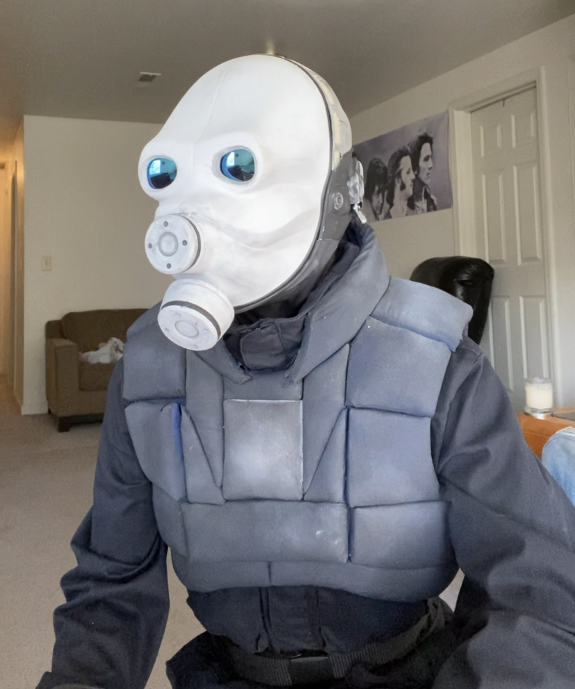

Your Civil Protection officer is the best ive seen! Im most impressed with the vest, I think you nailed the technique. Is there a way you could give some more insight on how you mocked up the template of the vest? And think the foam vest will be more efficient than me having to work with sewing, I do not like sewing
Bowye appreciate your kind words, still a WIP!
I do agree about the efficiency, worked out the whole vest in a day or two.
As for working out the templates, sketching the vest from different angles helped to really lock in a mental model. Used the center square as a reference point, then just sorta eyeballed it from there. It got away from me a bit, as pointed out by another user, but it’s good enough for me.
But, for the most part, it was just cutting out the foam, gluing the backs together with strips of cloth, then trying it on. If it didn’t fit, I trimmed. If it did, move on to heat gun and forming.
When that turned out well, I disassembled and glued batting to the front of the foam and wrapped in cloth, then glued the backs together again.
Hope this helps

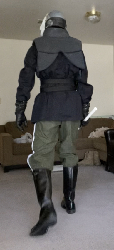

Small progress update, as I’m working on this again. A quick test fit of what has been complete so far.

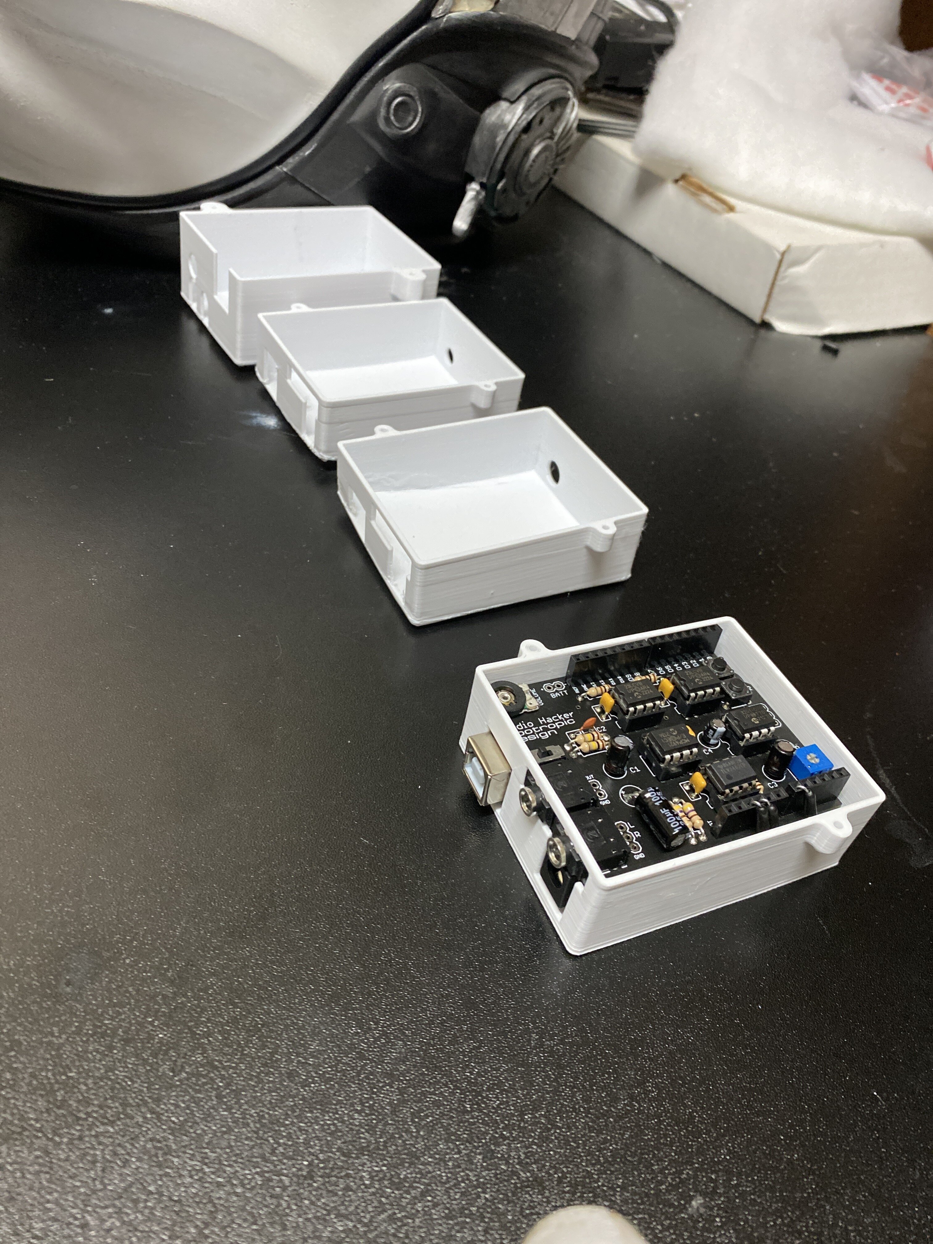

Also worked up a voice mod using an Arduino and a shield made by Nootropics Designs, AudioHacker. Neat, first Arduino project. Made an enclosure too, first time using Fusion 360.
Didn’t wear pants and boots for this one.
It’s coming along, thanks for looking.

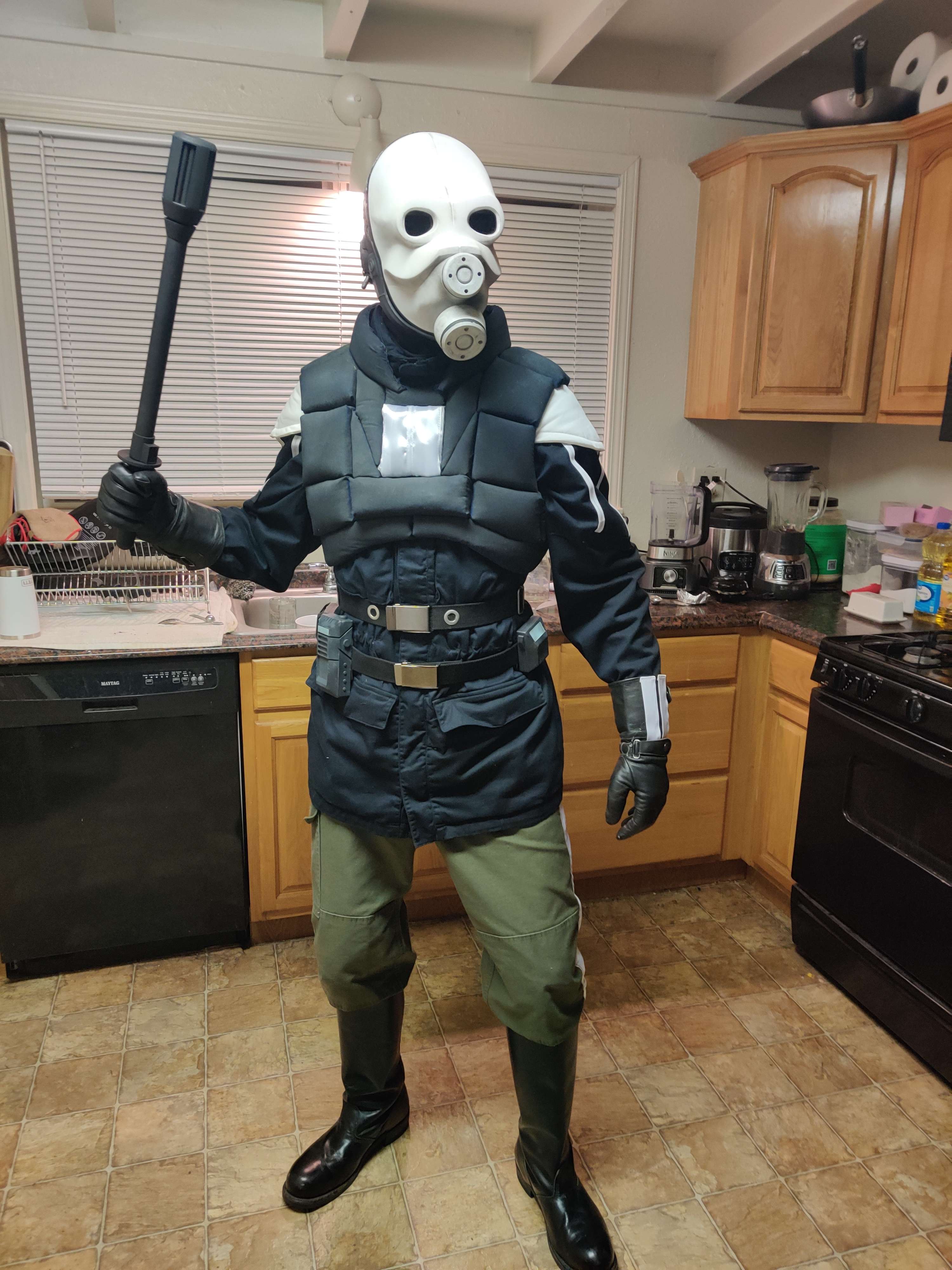

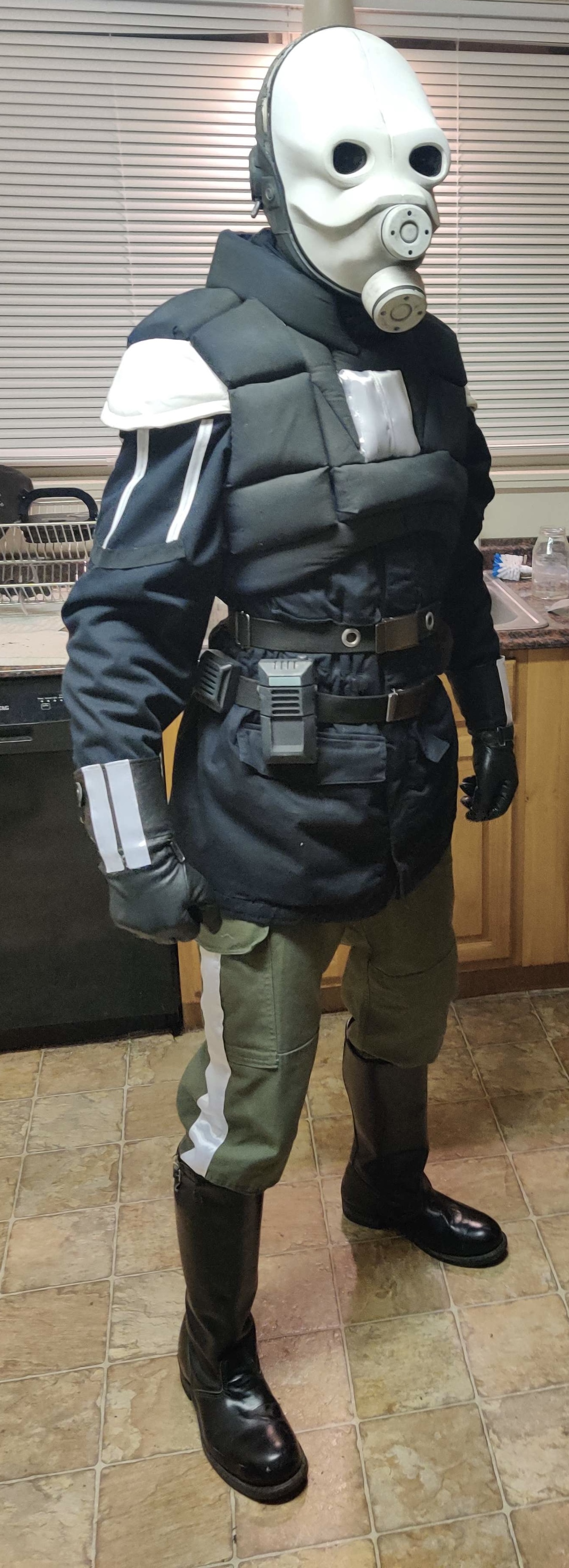

Almost there. A few tweaks, some soft weathering, and electronics. Very pleased so far.
Can’t forget a classic
Visibility is nil and I used hot glue waaayyy too much in an effort to fast track this build, but there was some real sewing.
Some.
More soon, thanks for looking.
