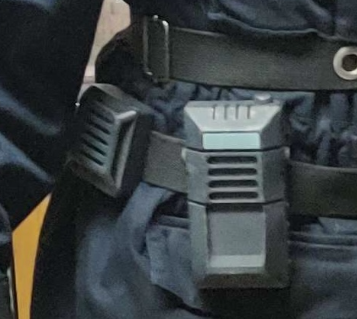

Hey really cool build I was thinking of making my own outfit using your templates. I was just curious what you did for the belt accessories?
I modeled them myself in Blender. I'll see if I can find the files and toss them up on Thingiverse or something. They were a couple computers ago, so I'll do my best.
