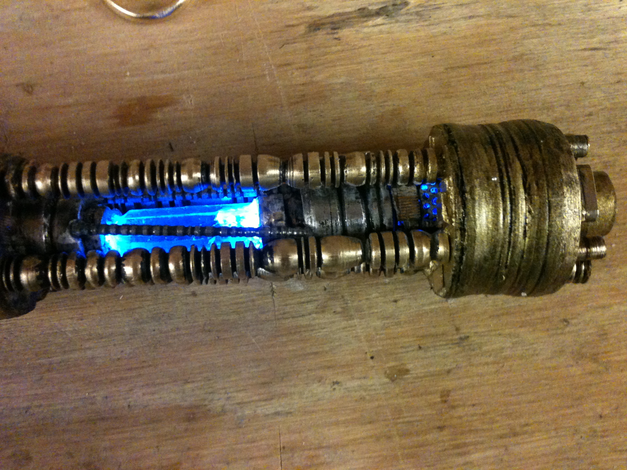

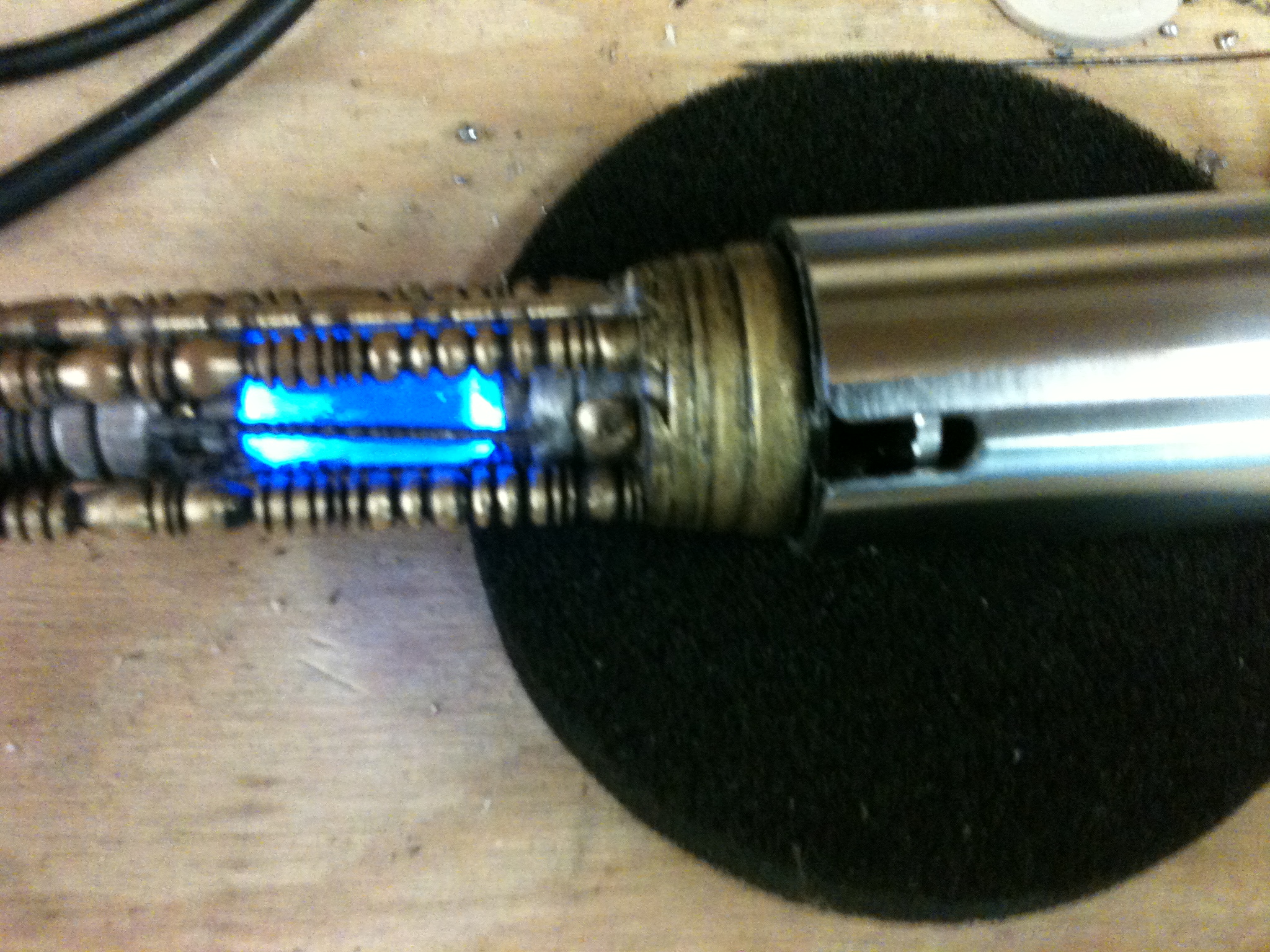

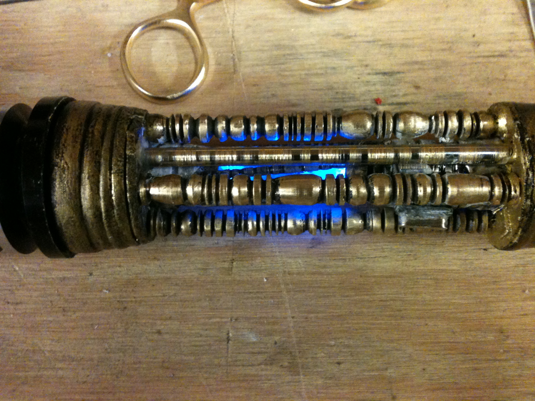

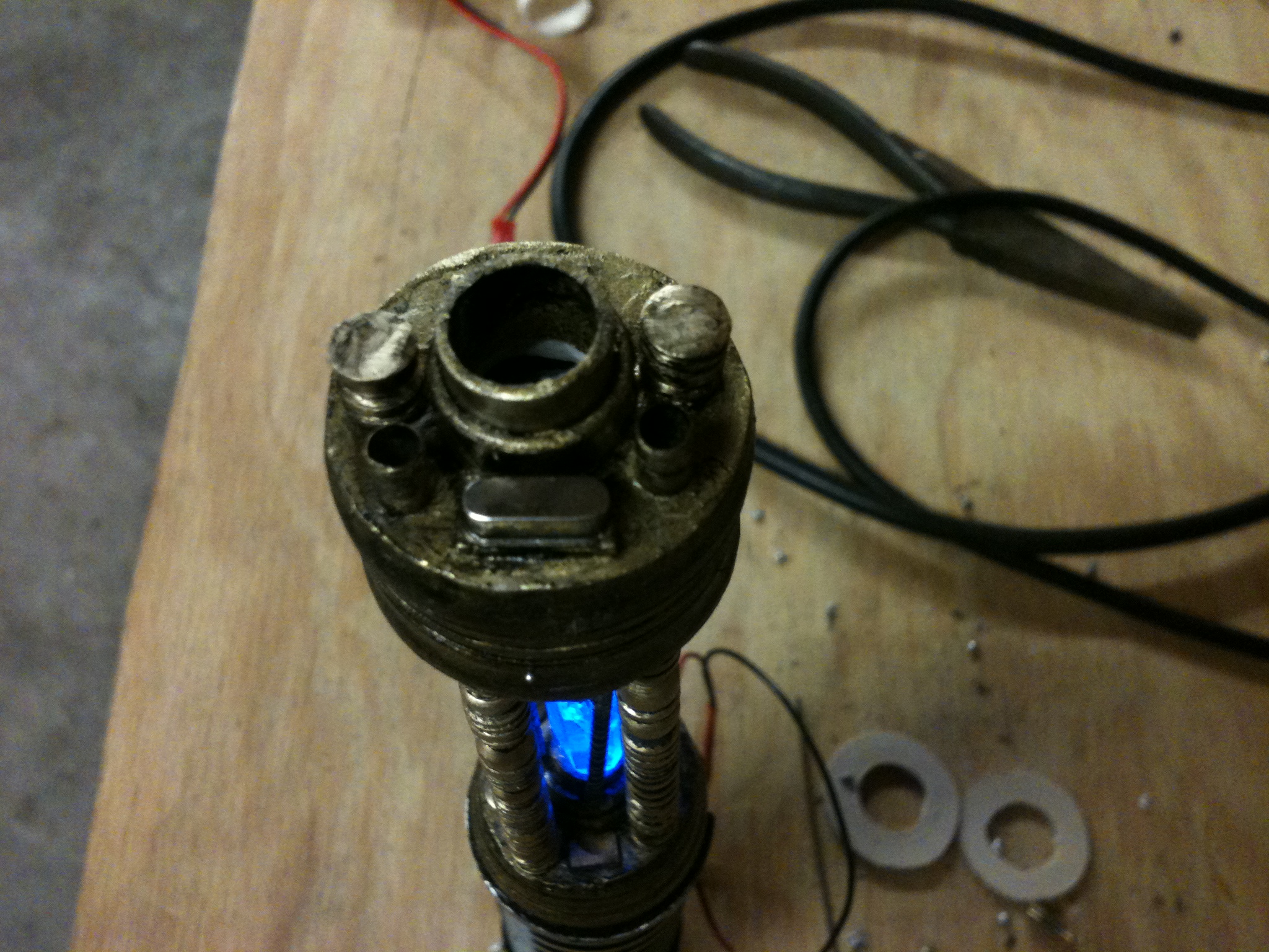

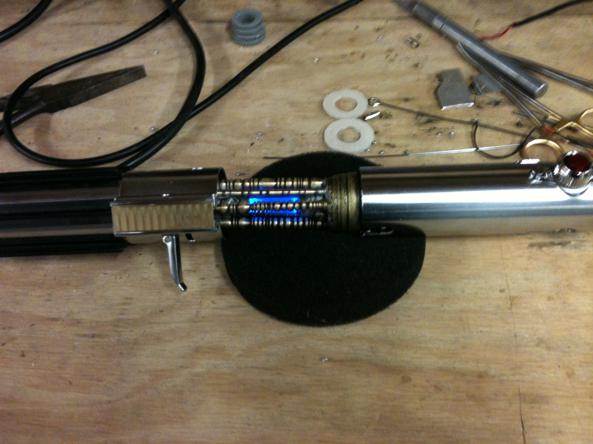

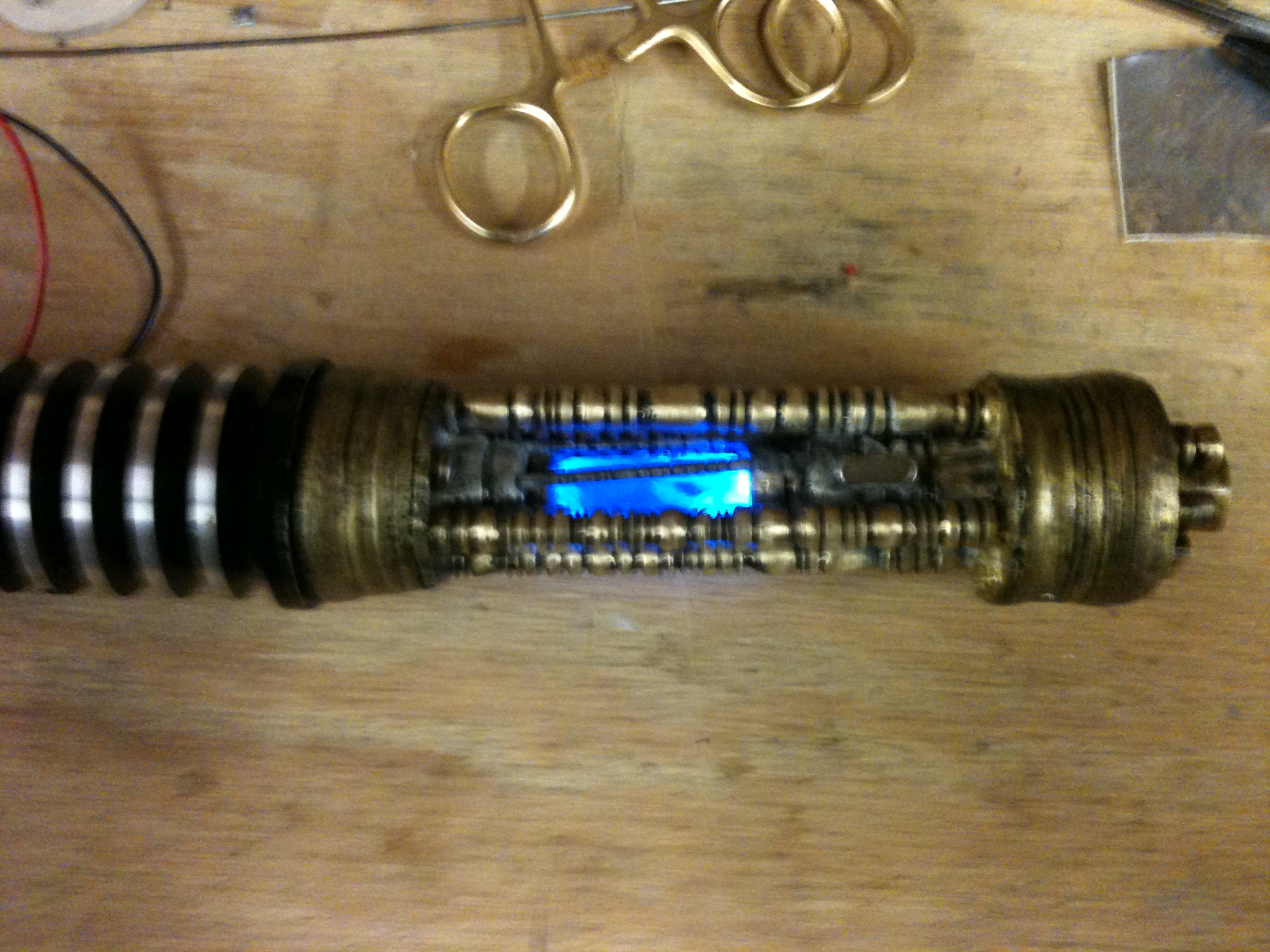

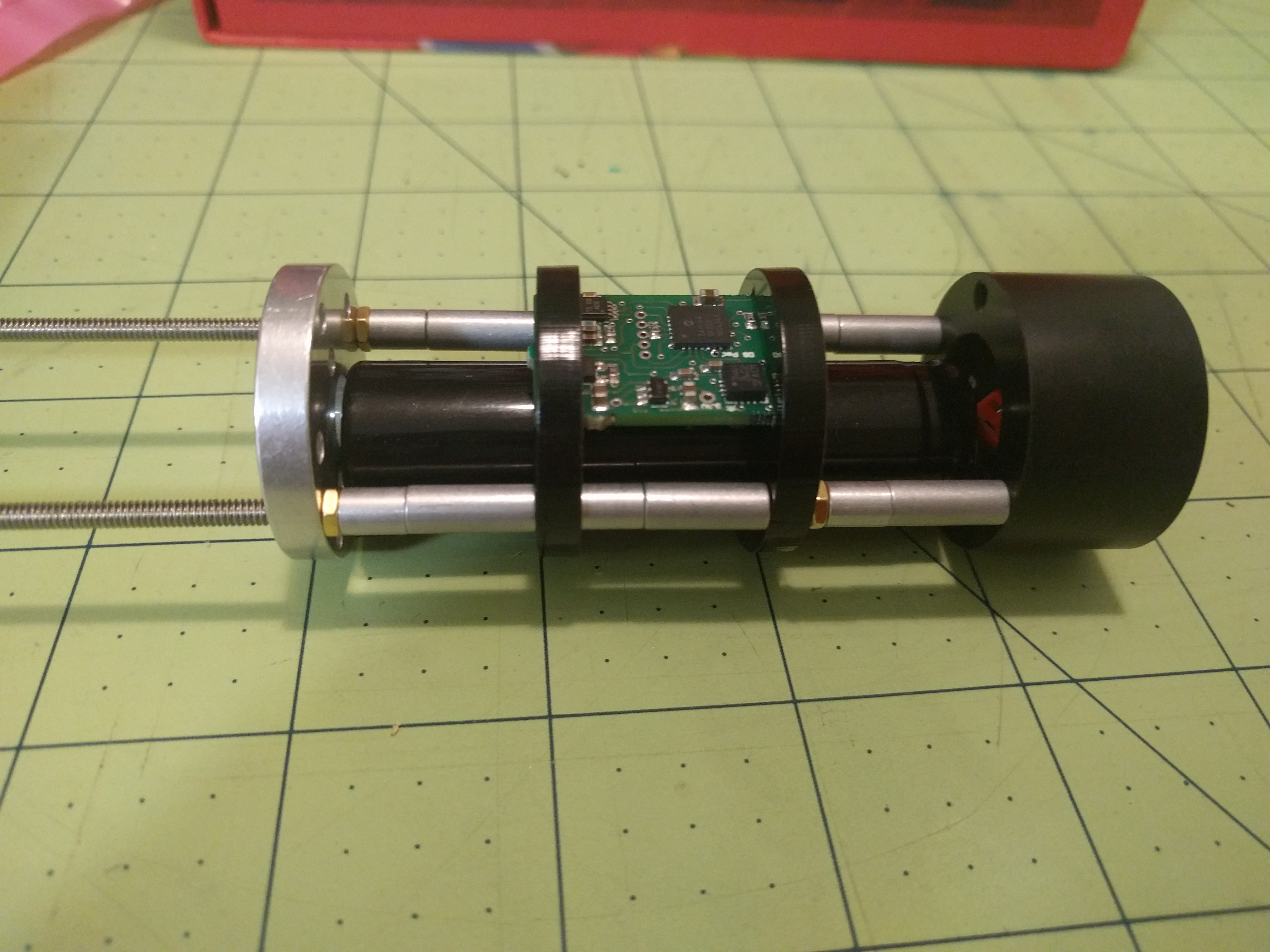

Progress report:
Grips added to lower body
Clamp modified in order to spin lever freely
Button painted to be less shiny
LED tested and wired
Tomorrow, I'll add the resistors, place the LED to the heatsink, and start drilling into the grenade body. Shoot2Thrill's videos are helping immensely. And SoCal Saber's tutorial for using TCSS chassis components instead of Darth Ryo's 3D printed chassis are also helping me out as well. I decided to go that route since I have a 2015 Graflex 2.0.
Was able to figure out the placement for chassis pieces, spacers, and nuts to not only fill the lower cell of the Graflex 2.0, but I'm able to also fit Roy's TFA clamp card without shaving any of it down, and position the grips and clip in the right direction. But it's pretty late, so I'll have to Dremel more tomorrow.

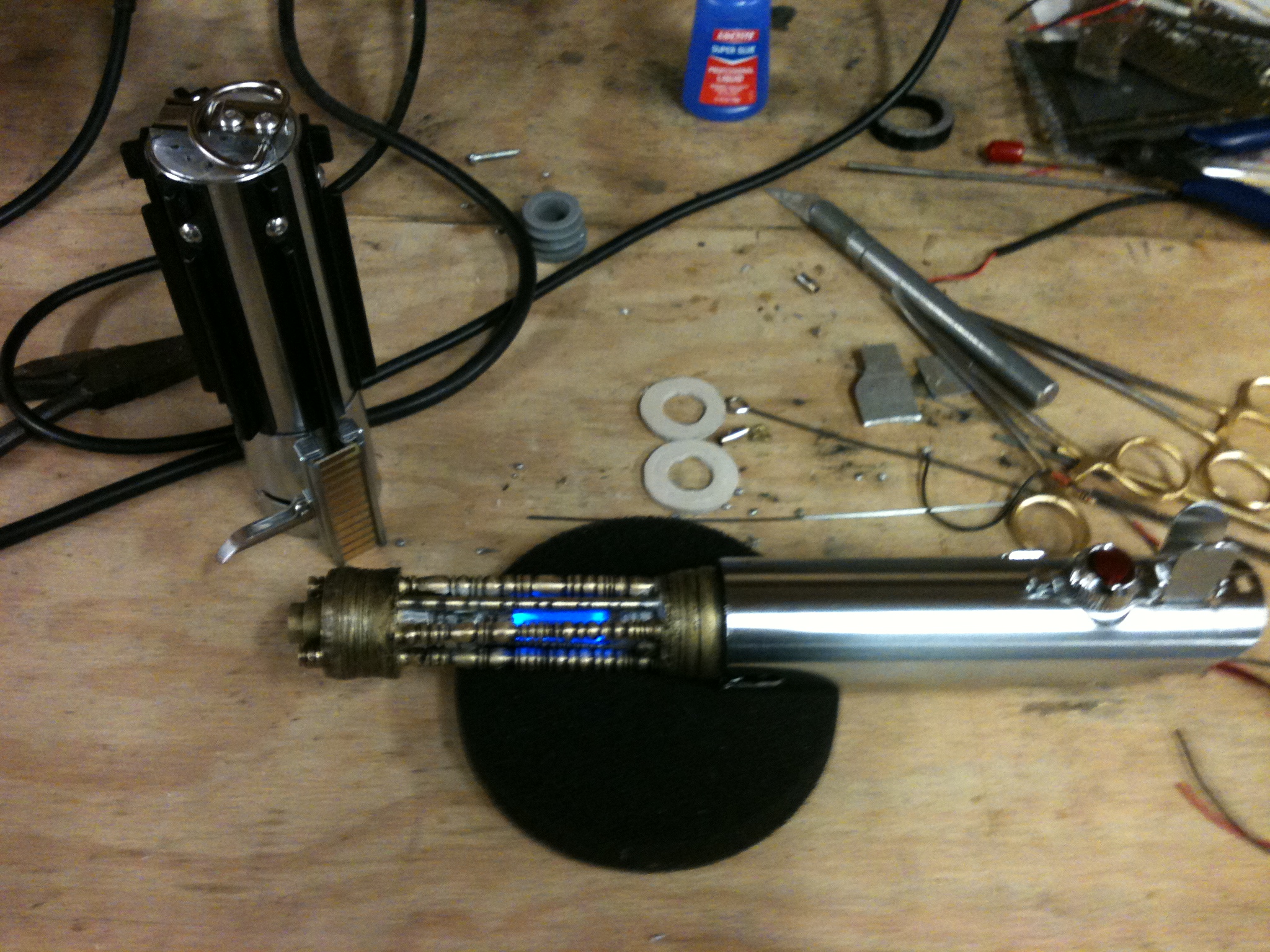

Just tested my LEDs today. Tried with the battery tester I bought to make sure the LEDs actually work (2xAA battery pack with wires, similar to Shoot2Thrill's). LEDs were bright until I put the blade on. Kind of dim.
Then I tested it with the 18650 battery. Yup. That'll do. (My eyes, why god...)
