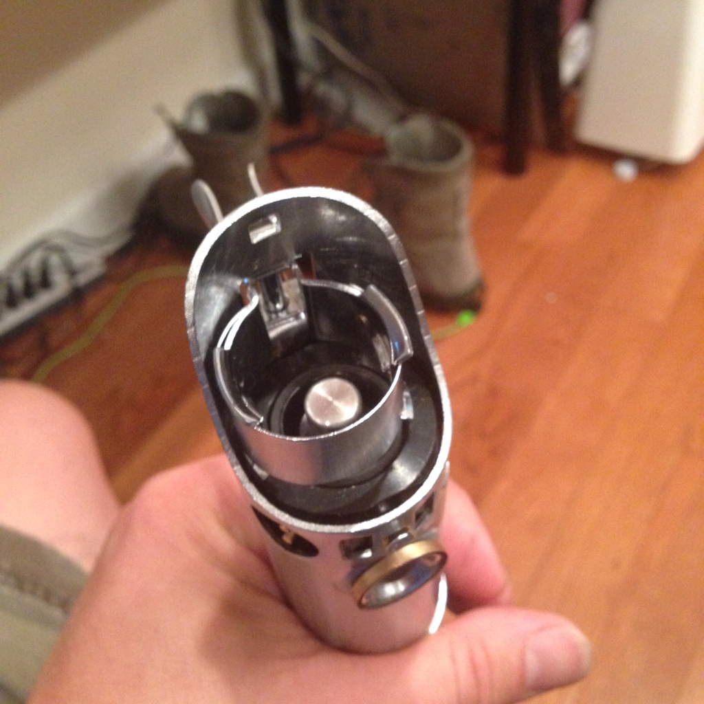

In short, got my kits this weekend. In all, super happy. One of the two is virtually perfect. The 2nd has slight tarnishing on the clamp. Emailed Randy and he said it's been thing of late. TCSS even mentions scuffs and whatnot on their site. Before I even think of troubling him for a replacement, I wanna try to tackle this. If needed, roughing this one up even more and making it my TFA hilt is an option.
I have: Mother's Mag polish, several Dremel polish wheels (research shows divide between greatness and it leaves polish circles), sandpaper between 150 and 320 grit, and I'm willing to try anything homemade to clean. Any tips would be appreciated!
I have the same clamp issue. I don't remember where I read it, some people are just wet sanding it. However, someone went to far and damaged the clamp. I heard someone else use Nevr-Dull and that worked. I'm going to go that route when I get around back to this project.

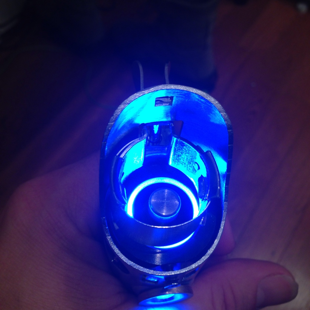

Has anyone been able to successfully fit the 28mm bass speaker from CSS in their 2.0 build? I couldn't get the chassis to close all the way without the speaker buzzing and now I'm having to switch out for the premium speaker... sucks...
I have the bass speaker installed...no buzzing. Did you push the speaker in far enough? I don't have a clearance issue with the crystal chamber part. Got all the wiring stuffed behind the speaker also....think if you can get that speaker pushed back you'll be fine.
