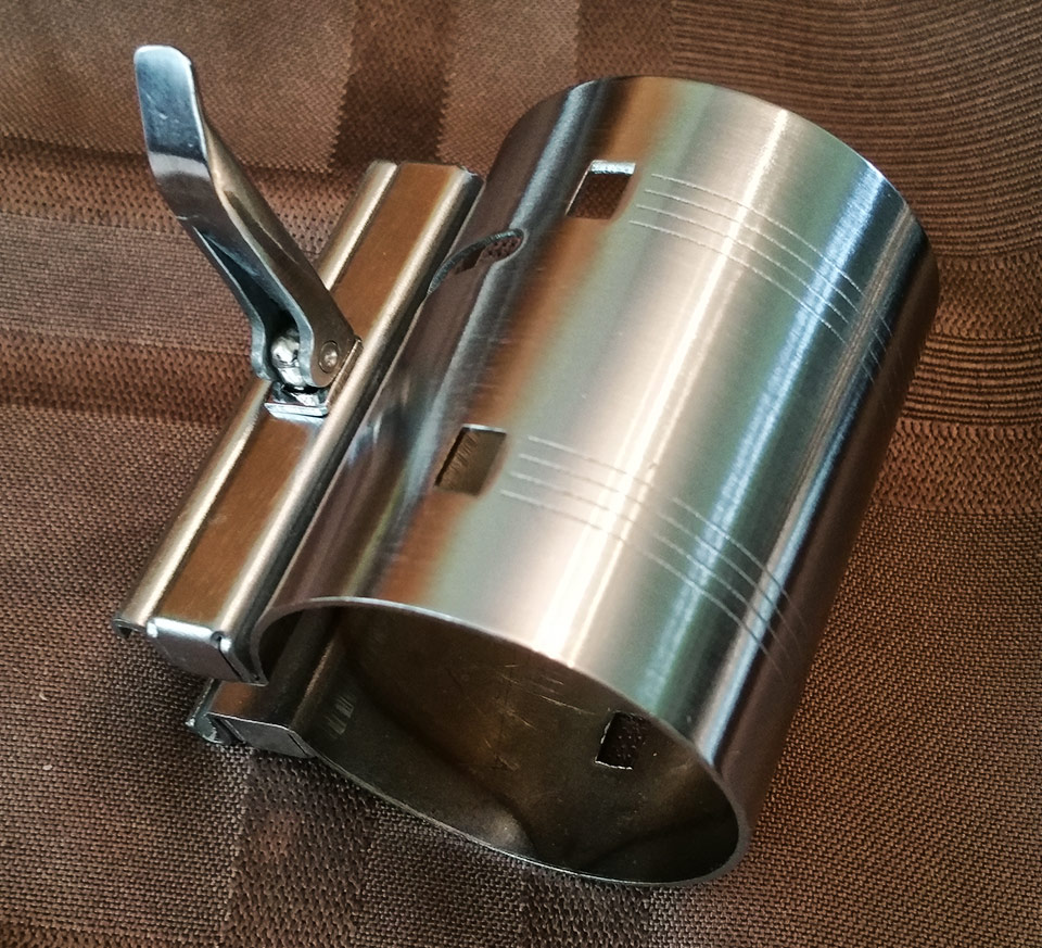

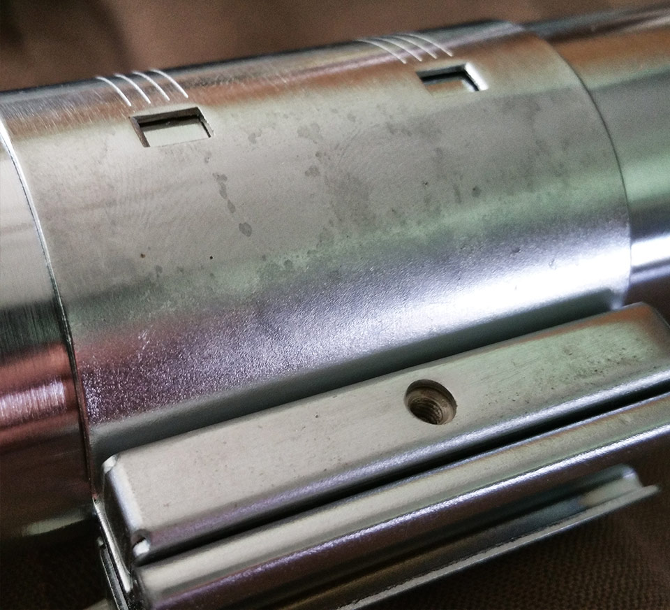

Update on my clamp. I did some gentle wet sanding and cleaning before polishing, using a 320 3M sponge I got at the hobby shop. After that, I used a microfiber cloth and followed the instructions on a can of Mother's. I used it sparingly and didn't overdo it.
Before:
After:
Not a world of difference, but I'm content.

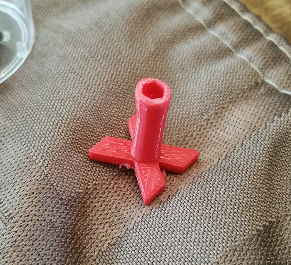

I also got my tool working for the brass pins. Just heated up a 1/8 Allen and jammed it into the previously deformed hex opening.
Nothing major but I found a threaded rivet, worked it on the lathe and came up with this
Also, if anyone needs a pin tool you can get a micro/ precision screwdriver kit from Harbor Freight ($6) or Walgreens ($3). It comes with a 3mm he nut driver.
Awesome work using the allen key!

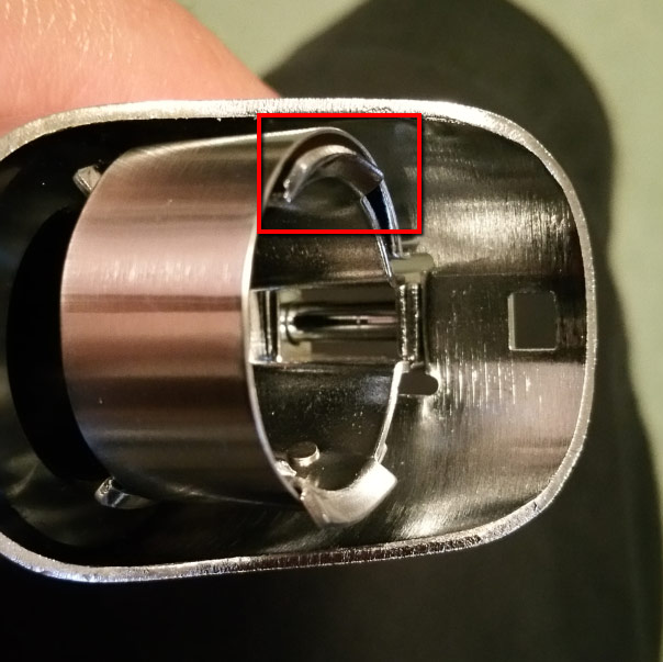

Just about done w/ my ANH display version, and I ran into what I am hoping is my final issue. The 'bunny ears' and the emitter ring have sort of fallen out of sync. When one is perfectly centered, the other is off by a slight but noticeable amount. When I fiddle with the emitter ring and the ears simultaneously, I can get it close, but then the bunny ears looks permanently pinched close together and the emitter ring sways side to side too easily. Then I noticed this:
Thoughts?

...Thoughts?
Ran in to the same thing because I have to pinch my bunny ears to insert/remove blade and blade plug. I just gently bent the ears out a smidge. Fixed it for me. Aluminum is not the best but it's light :/
