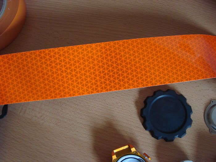

The tape came in today, and it does look pretty cool, but not at all accurate, so I won't be using it. I like the plain orange better. As promised, I took a picture, so I also got one with all my parts.
The aluminum rod isn't polished yet, the orange tape is just temporary. I need to drill some holes in it, then sand, polish, and re-tape it. Then I need to drill all 3 holes in the body, prime, and paint. Then use some metal pegs and epoxy to attach the rod to the body. The cog is a whole other mess. No luck yet finding a watch lens that'll fit and is as flat as the one I already have. Will be stopping by the shop on Sunday to take the silicone and resin home with me, because I practically don't even work there any more and it would take me weeks to make the mold in the shop, but just 3 or 4 days at home.
