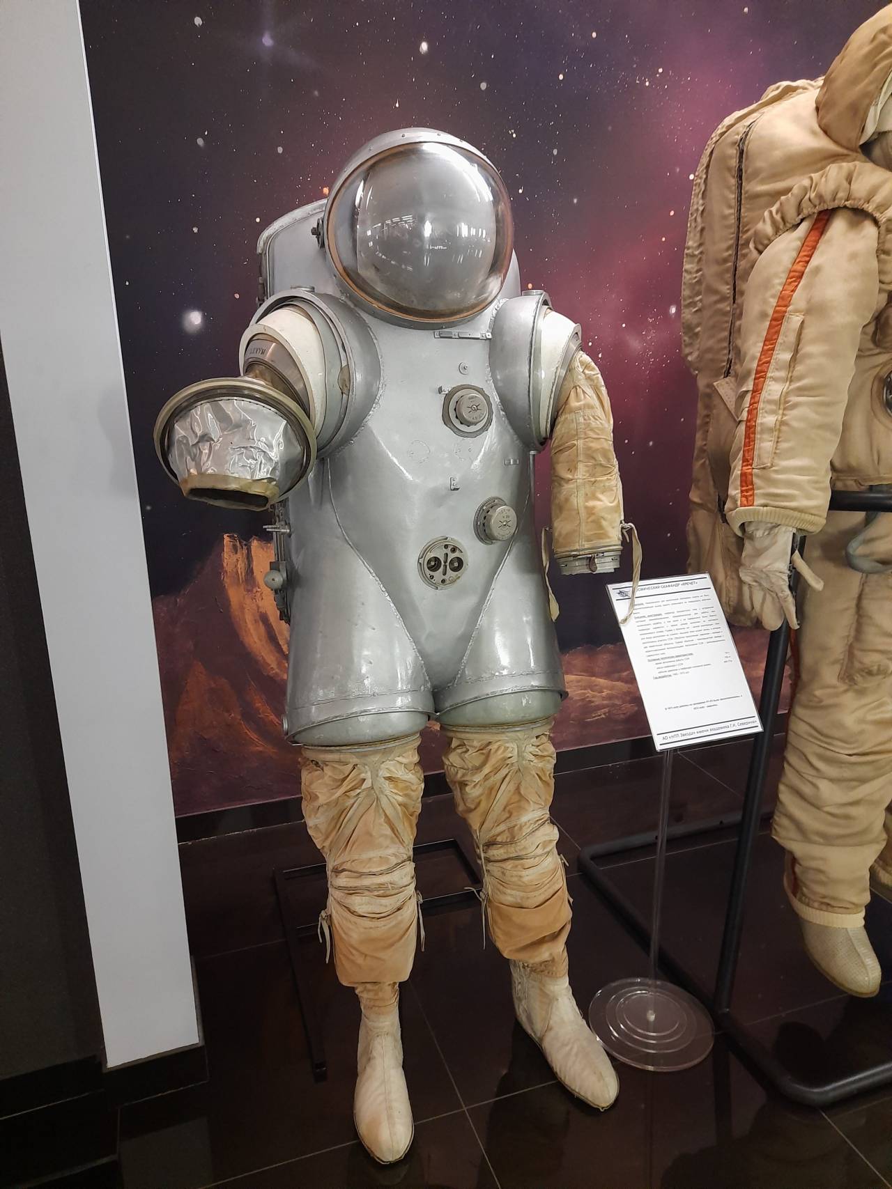

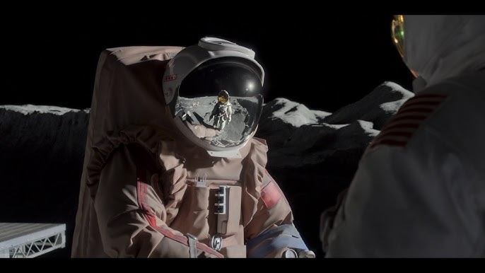

I am a huge and I mean HUGE space fanatic. For years now I've wanted a spacesuit replica more than anything. Well I'll finally try to get to building one of my own (hopefully). I am really interested in Soviet technology, but I also wanted a lunar suit, so after long consideration I decided to make a krechet-94 replica. I thought that since it had way less parts that moved or detached than on the apollo a7l suit (like the gloves or the LEVA) it would be easier to make. The most intimidating things for me however are the hard-body (picture below) and the silver sun-visor (I chose the "For all mankind" design since I liked it more, also picture below). I have an idea on how to make said visor but I'm still pondering on the main body. The only reasonable thing that I came up with was to make a mold of the body from styrofoam and then cover it in fiberglass (or cloth) and cover it in resin. Any other ideas on how to make such a rigid body? Any help will be appreciated.

We made the "For All Mankind" suit, and it is not 100% correct. But I do not believe the real torso in your picture is the real Krechet moon suit torso.
I'm pretty sure the Krechet torso ended at the lower waist.

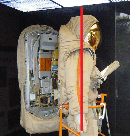

I wanted to split the hard body like in the picture and then connect the two halves with resin. I don't know if it's a good idea tho. Or maybe i should split it like in the second picture. It's hard to decide, since I've never done something like this before. And also I wanted to thank you for your response! I'll definitely check Adams video out. And also I wanted to mention that It's very exciting to talk to you :>.

Well, that's the life support back pack, and how you get into the suit. You will need that to open to put it on, if you plan on making it accurate.
