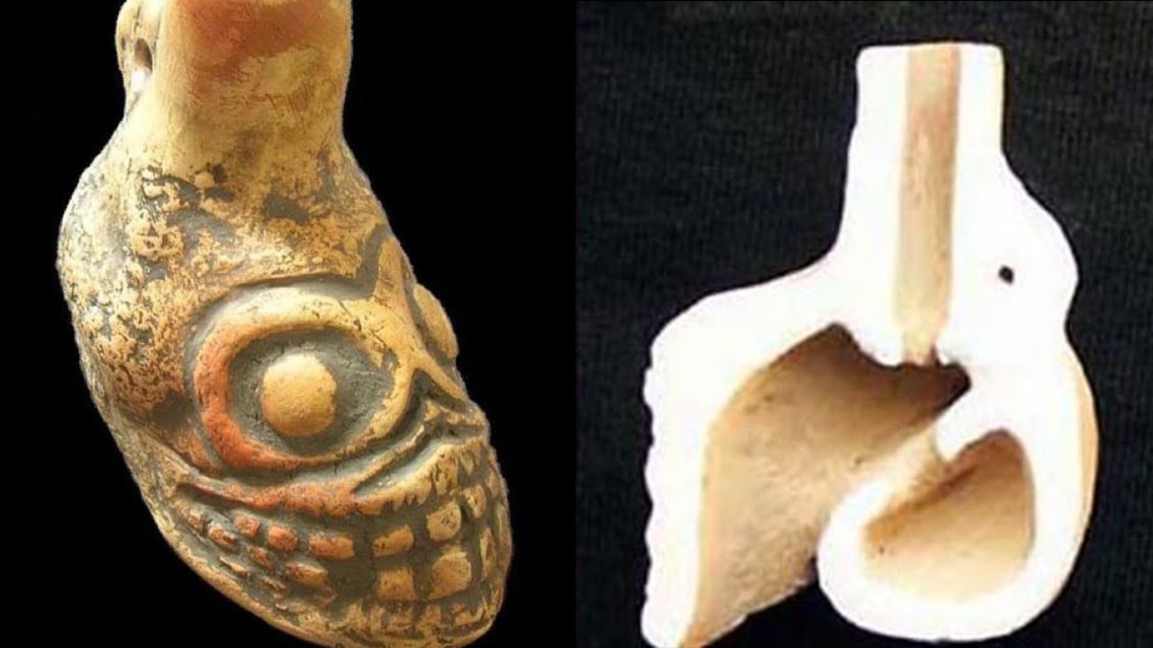

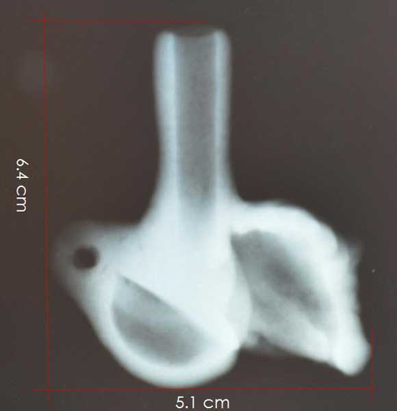

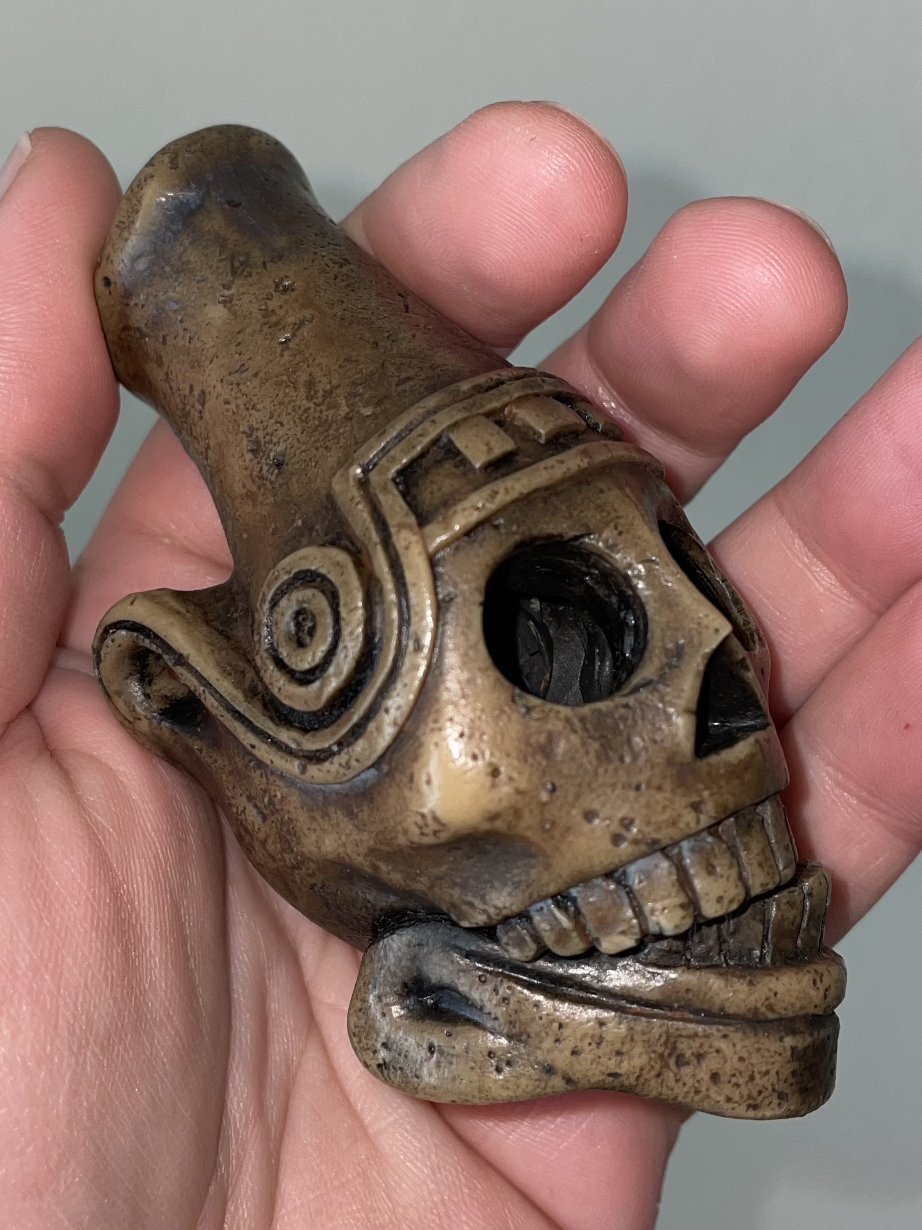

Kylash Here's an X-ray of a legit Death Whistle, and also a cross section of a replica (I think), which kinds of matches with the flipped image.

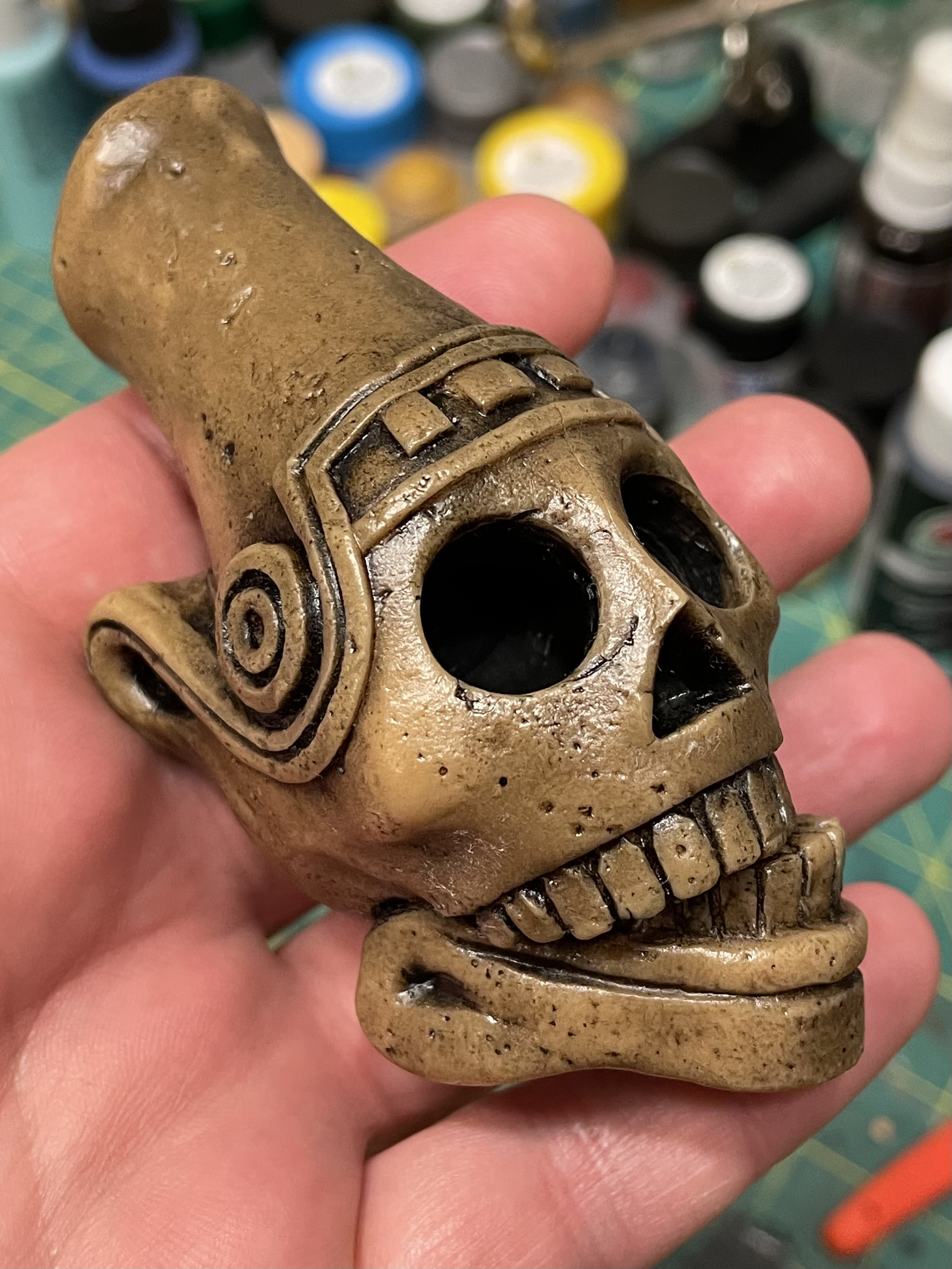

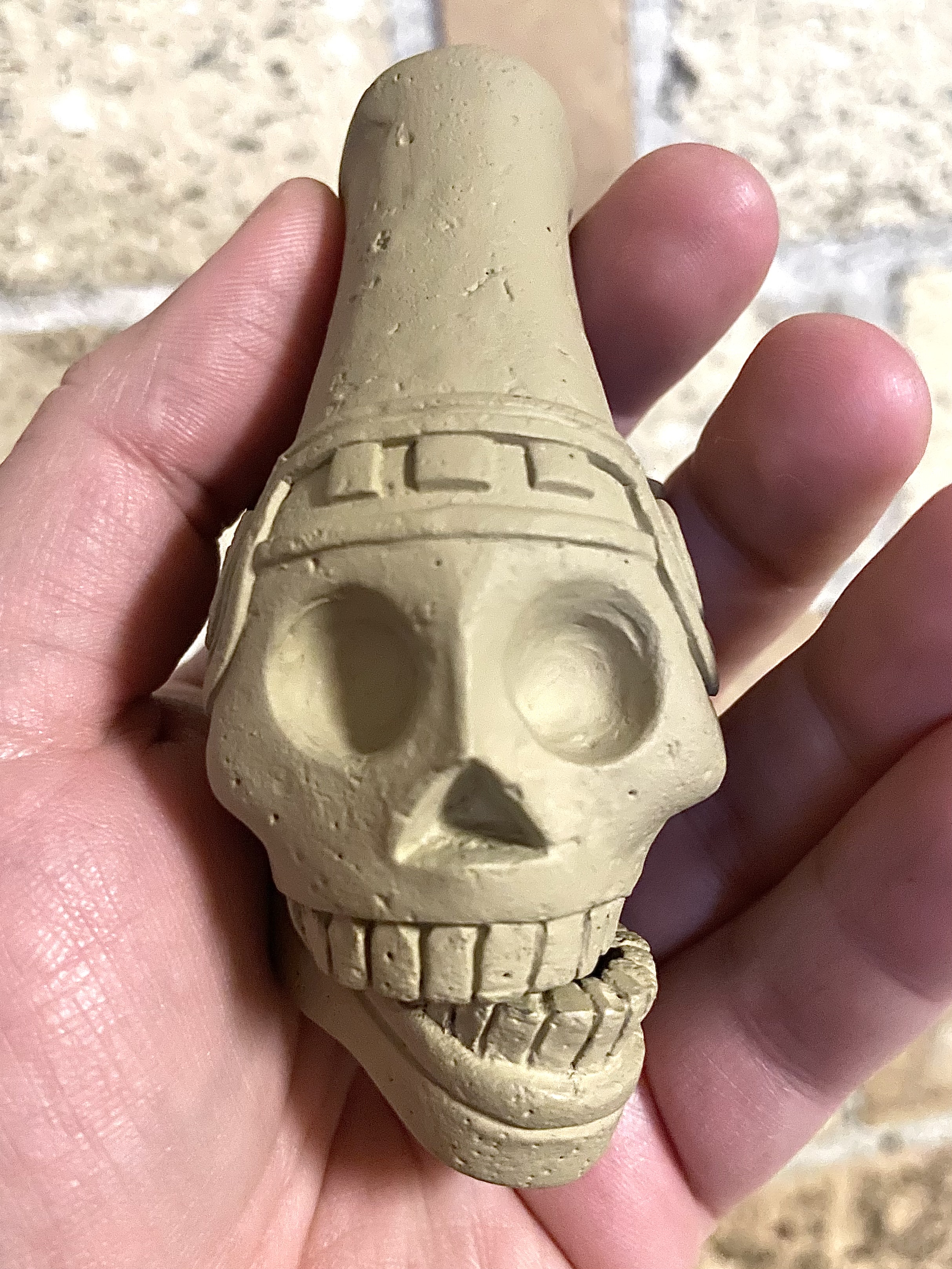

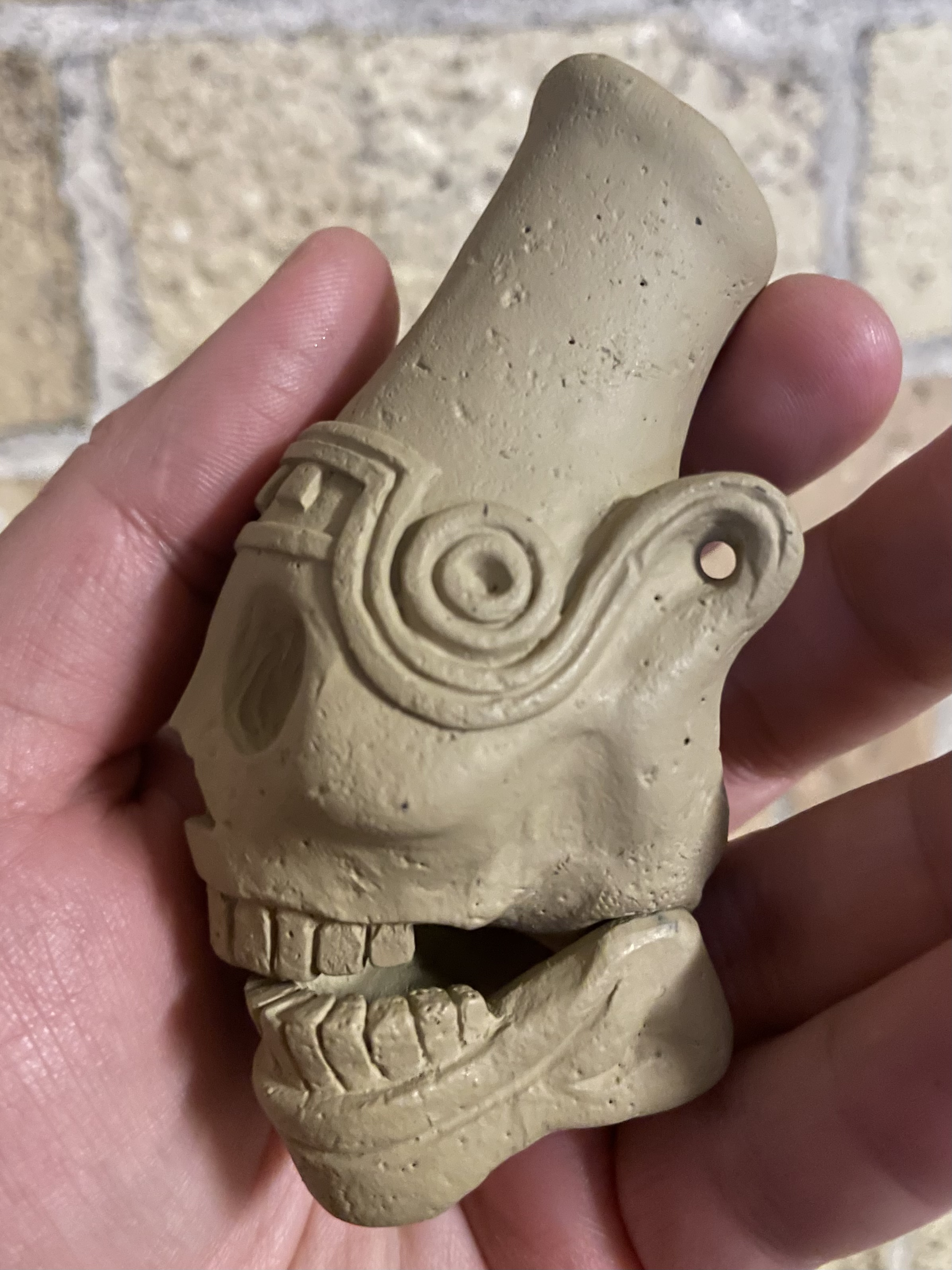

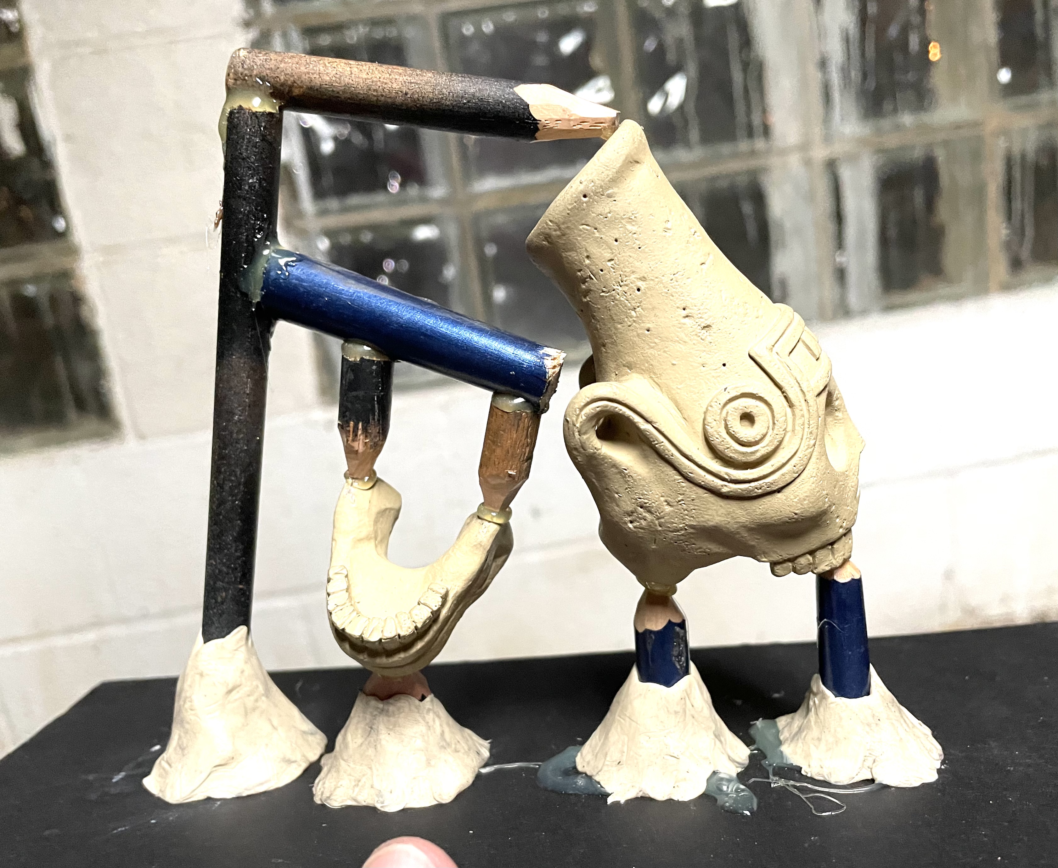

Thanks, yeah I’ve studied various kinds, they do vary, but a couple I’ve printed work with the eyes as holes as well.

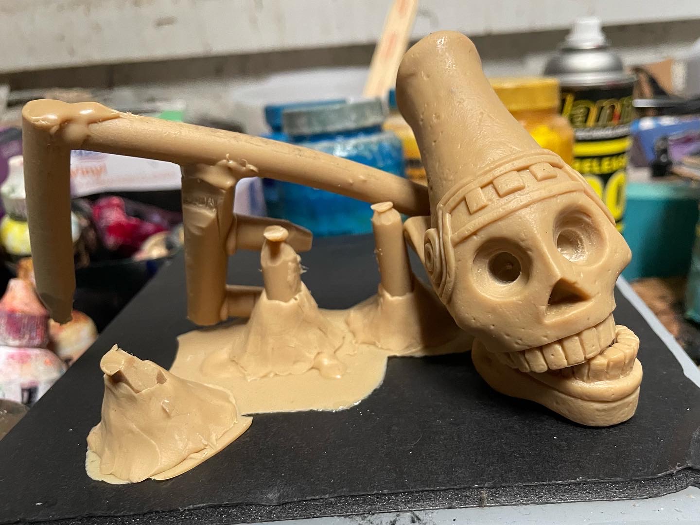

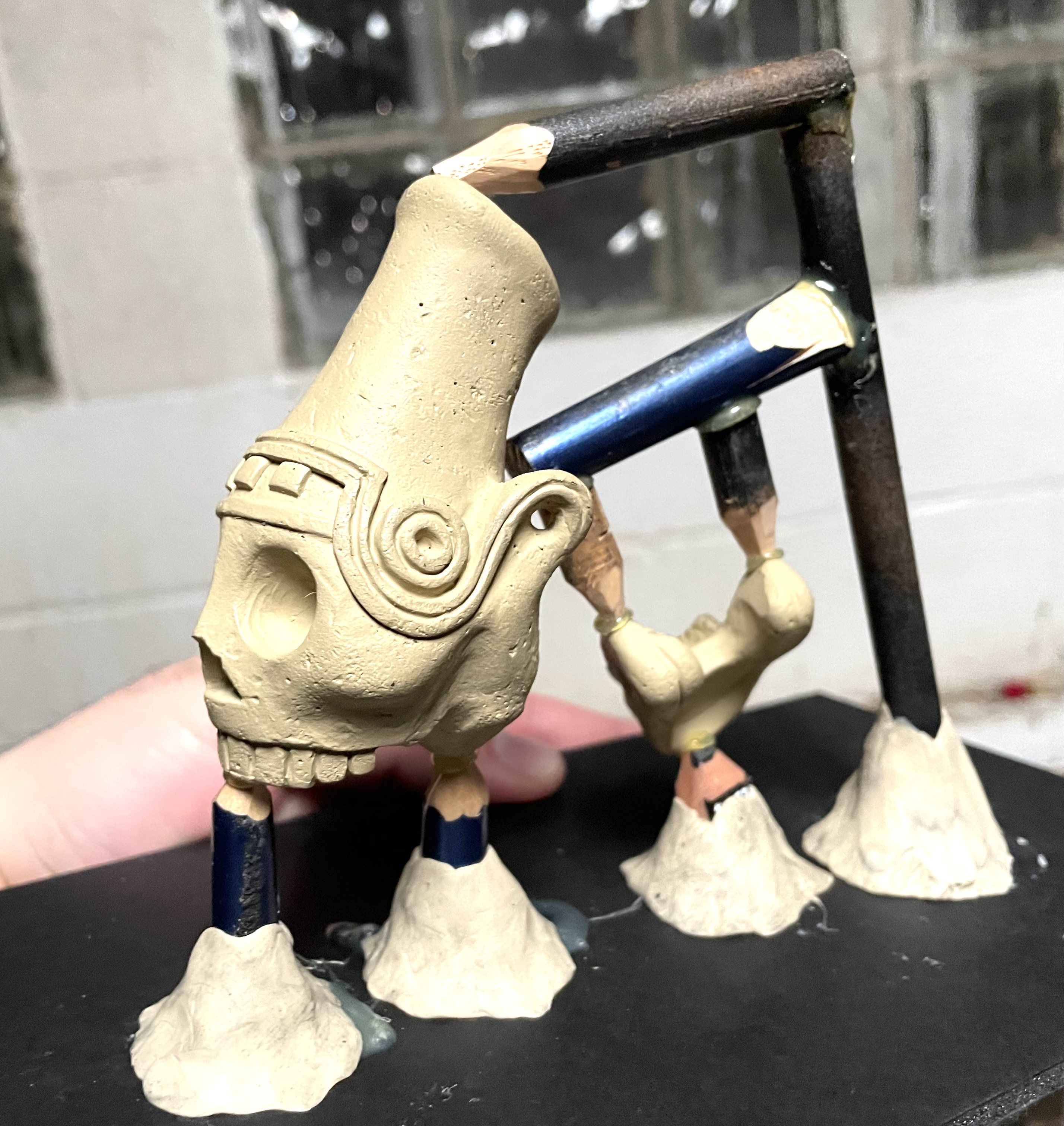

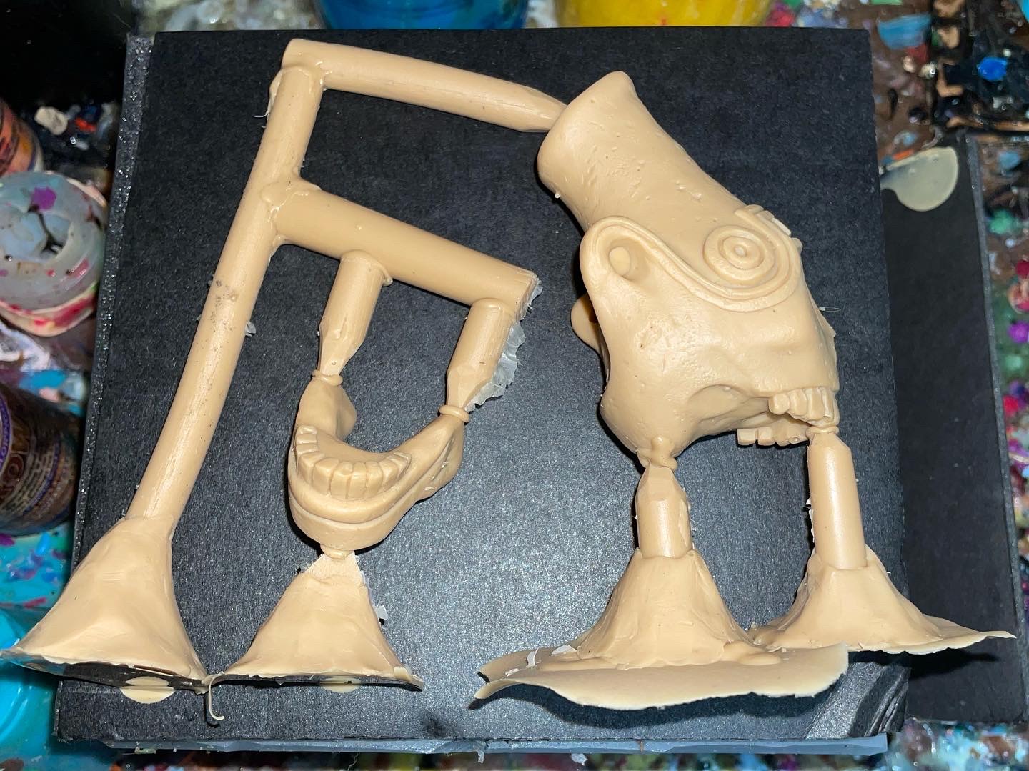

Fingers crossed! Thats always the most harrowing part….pour a huge lot and next day find the neighbours dog in the mold…

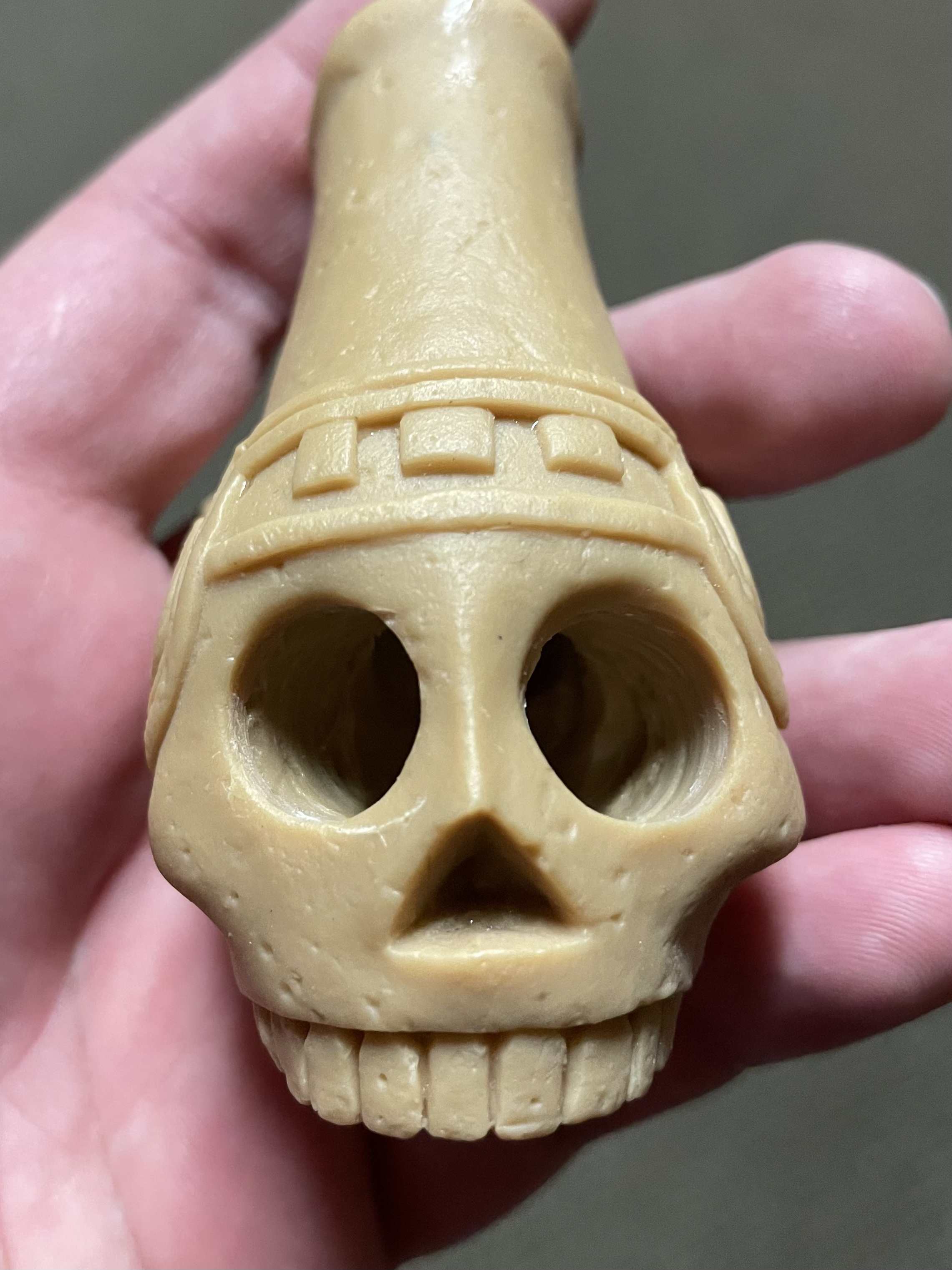

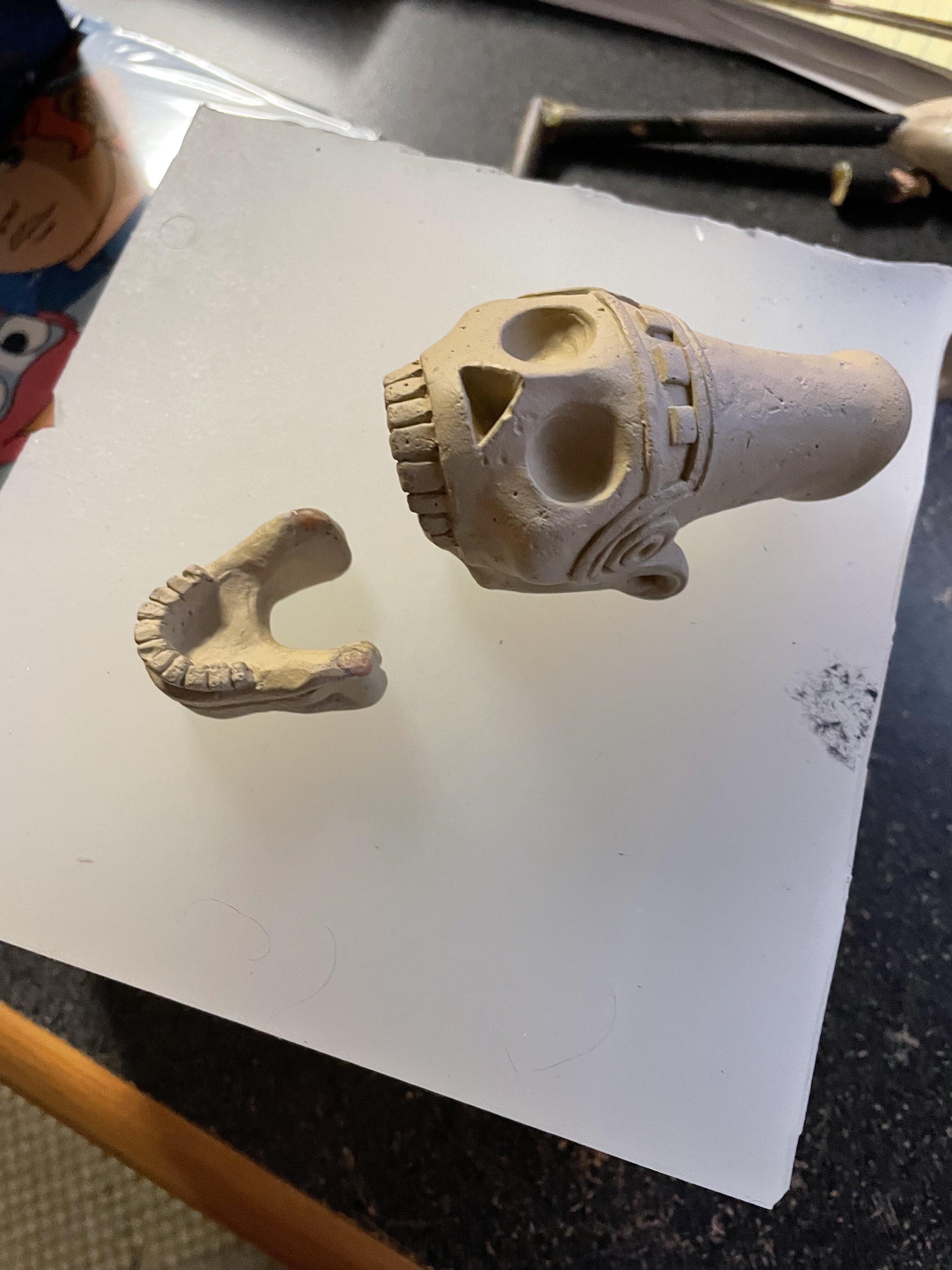

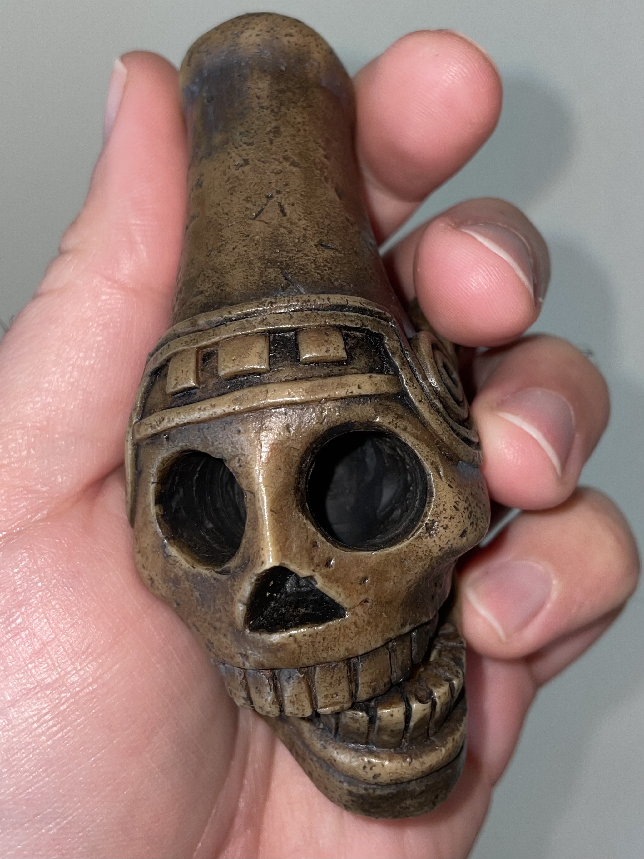

Success! Now I need to see if I can use a forsner bit with my hand drill or if I need to buy a drill press to hollow these out…I may try rotocasting with this mold as well but with the vents I could see that being tricky.
Thanks! Even under 60psi I got some bubbles in the teeth like Adam mentions in his. But not too hard to fill.

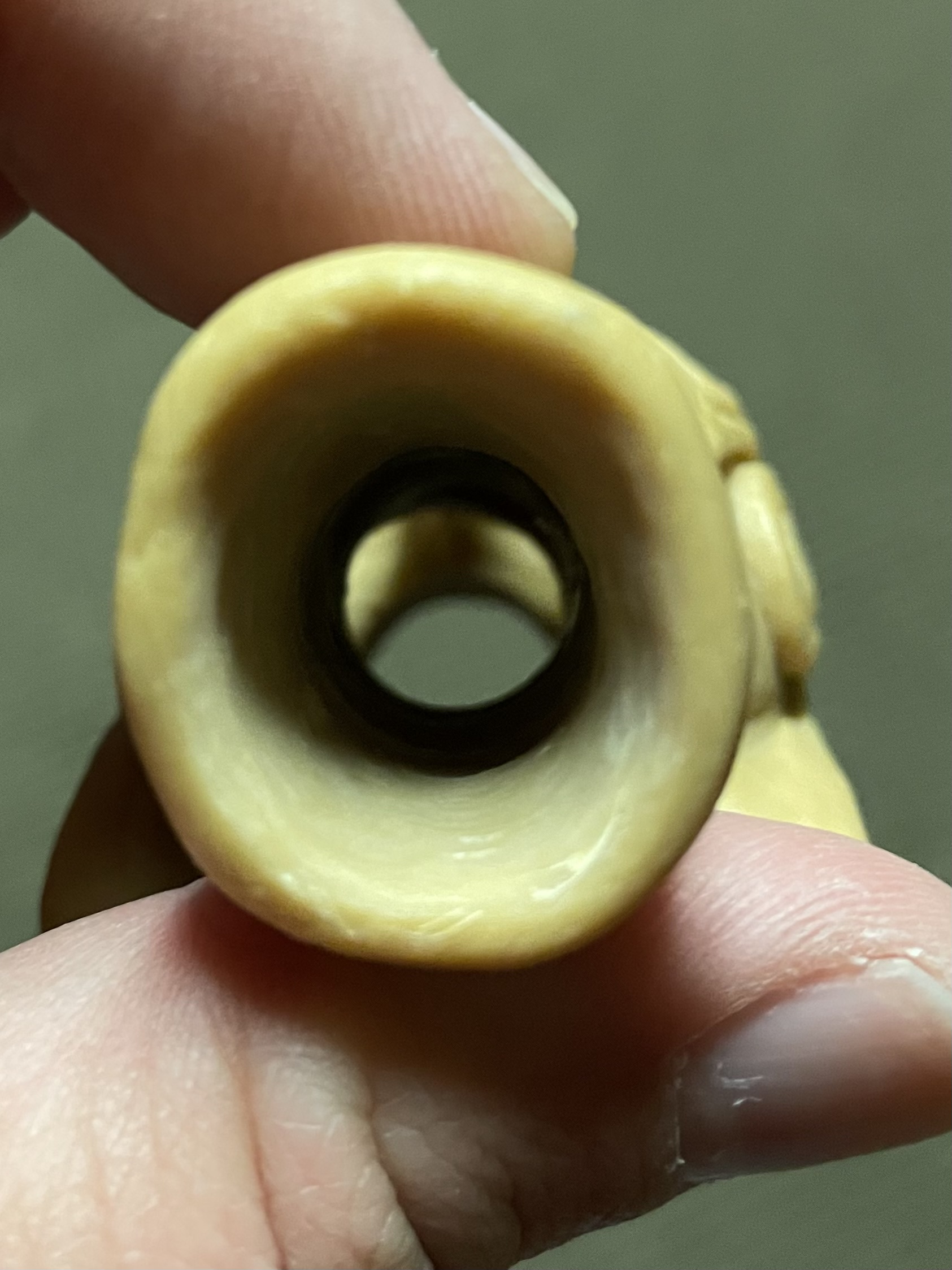

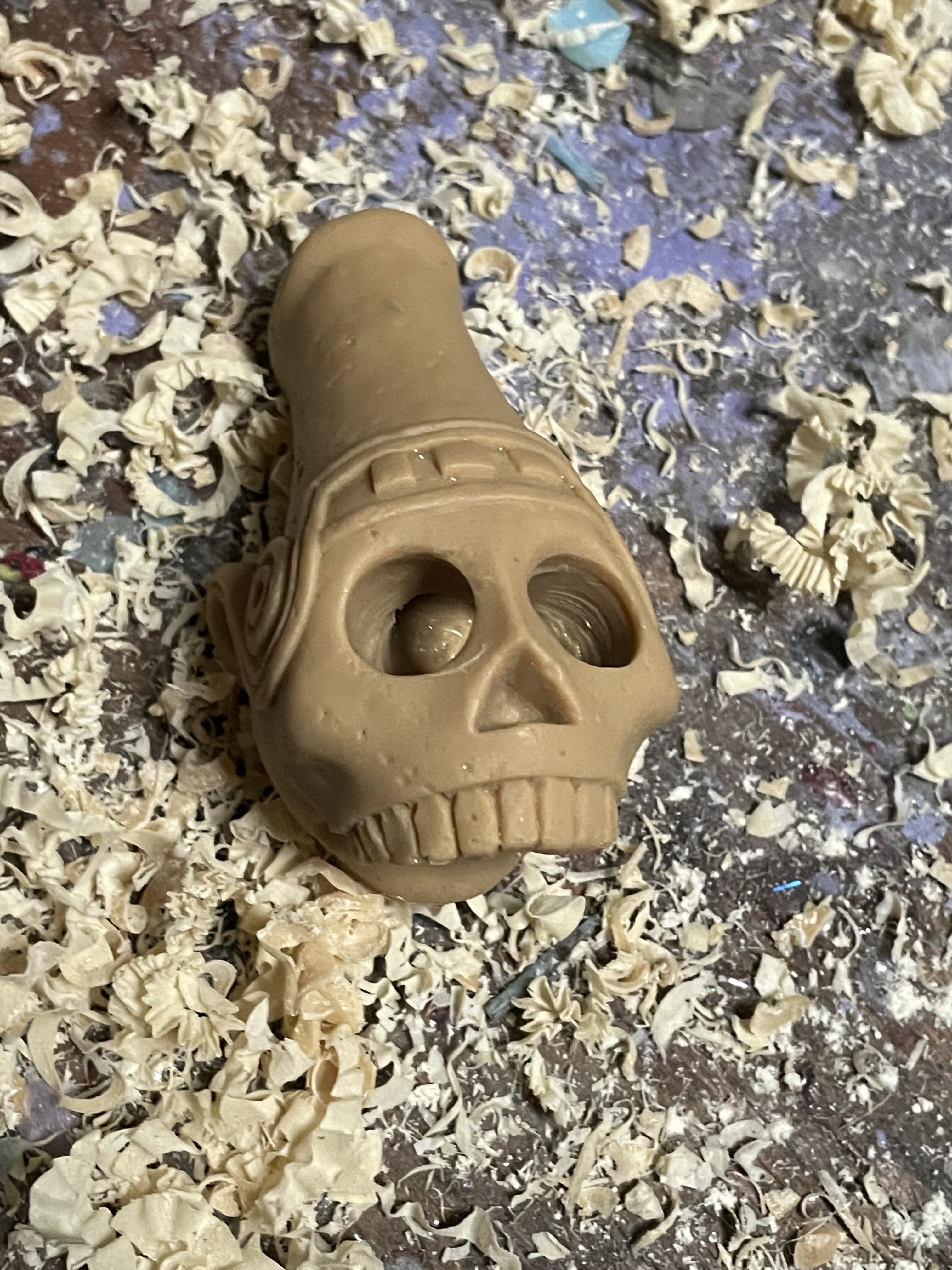

Forstners bit with a handdrill worked! I just need tk get the next step down in size. But here it is all drilled out. As is, doesn’t make any particular sound. Between all the sprue and drill shavings there sure is a lot of wasted resin making these.
