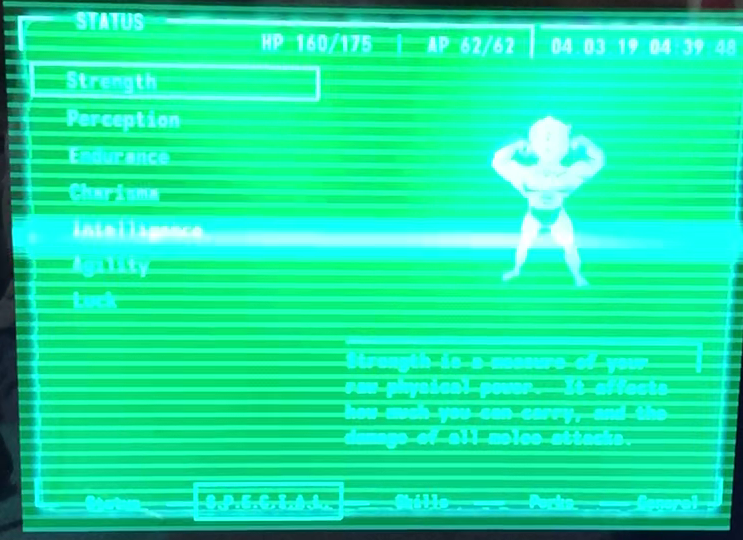

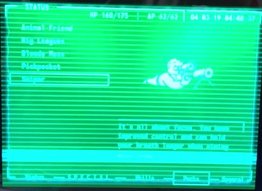

I'm working with it over the past week and started updating it with Fallout 4 graphics. It's not an easy job - lacking artwork, I got ahold of the Pipboy app and extracted everything I needed. Then coded up new stuff to load the animated graphics in place of blank screens and static images. Animations are present for all 80-some-odd perks, all the specials, and the VaultBoy uses the different heads and injured body types. Music and in-game audio for Galaxy News Radio, New Vegas Radio, Enclave, and Mojave Music.
Here's some lousy images I grabbed from a video a short while ago. Needs a bit of cosmetic and a few performance fixes.
