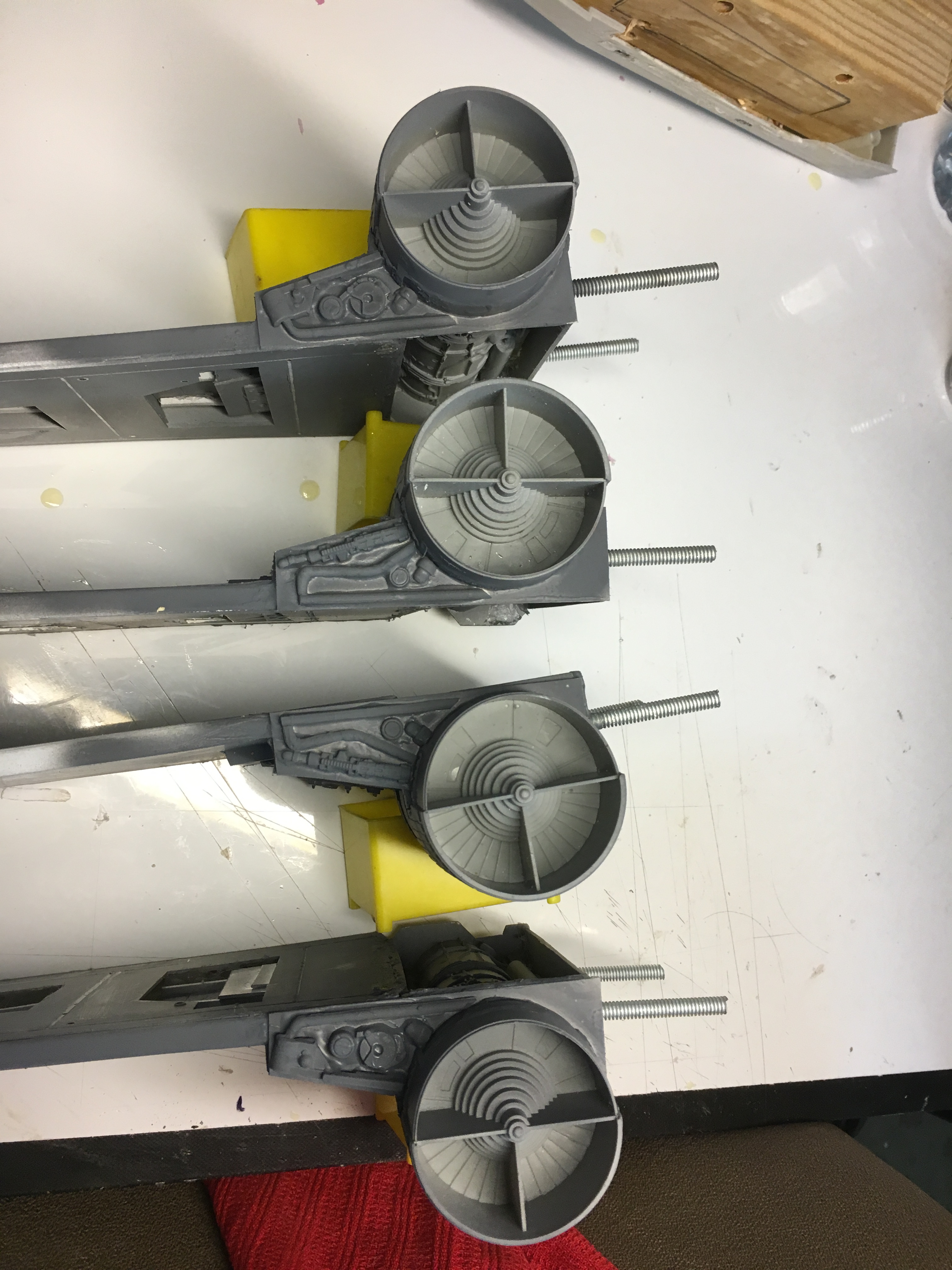

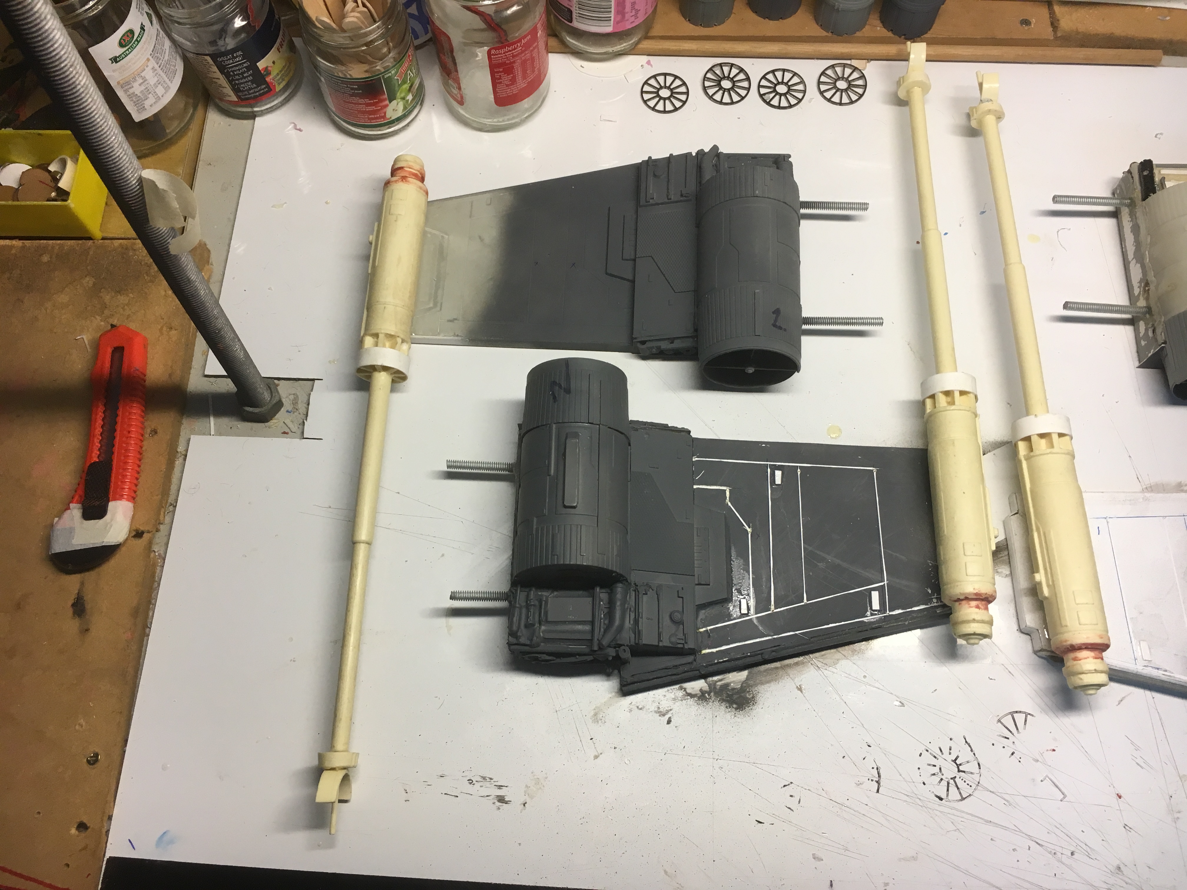

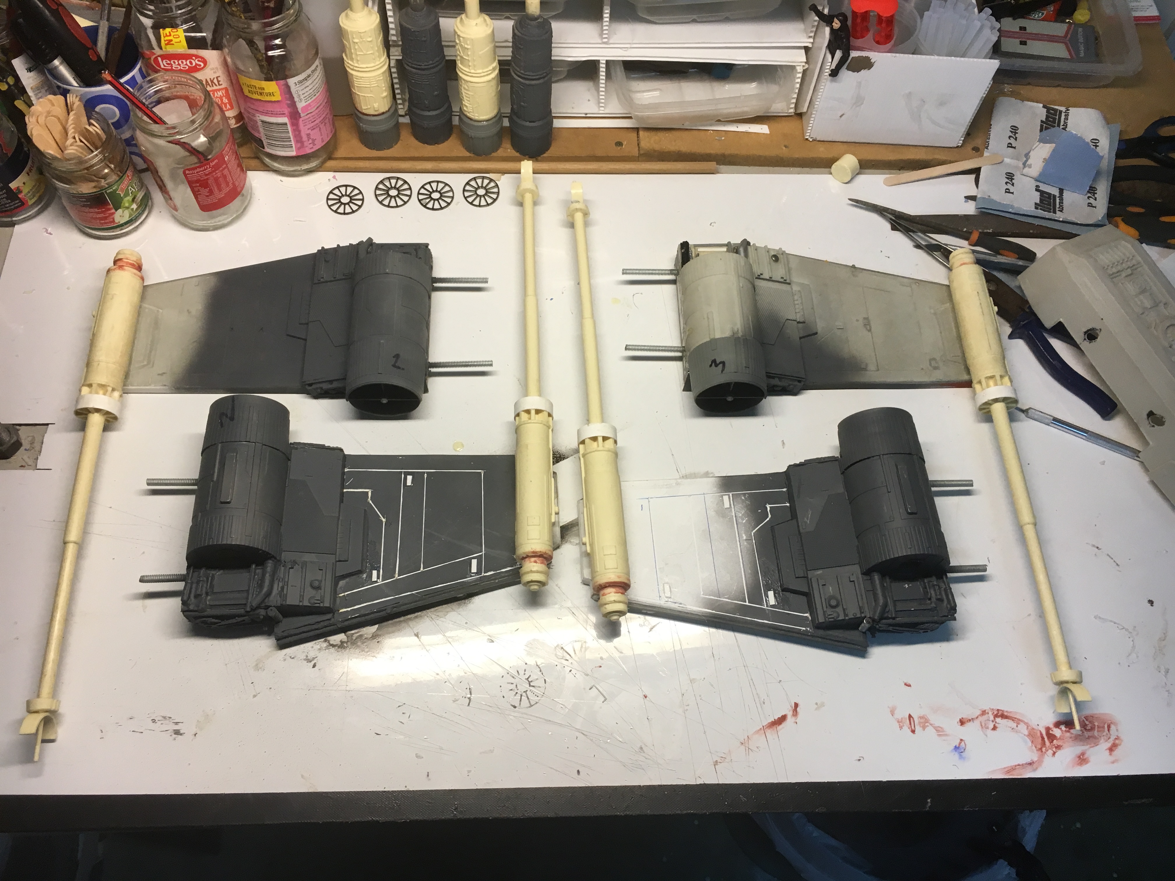

Two down, two to go....

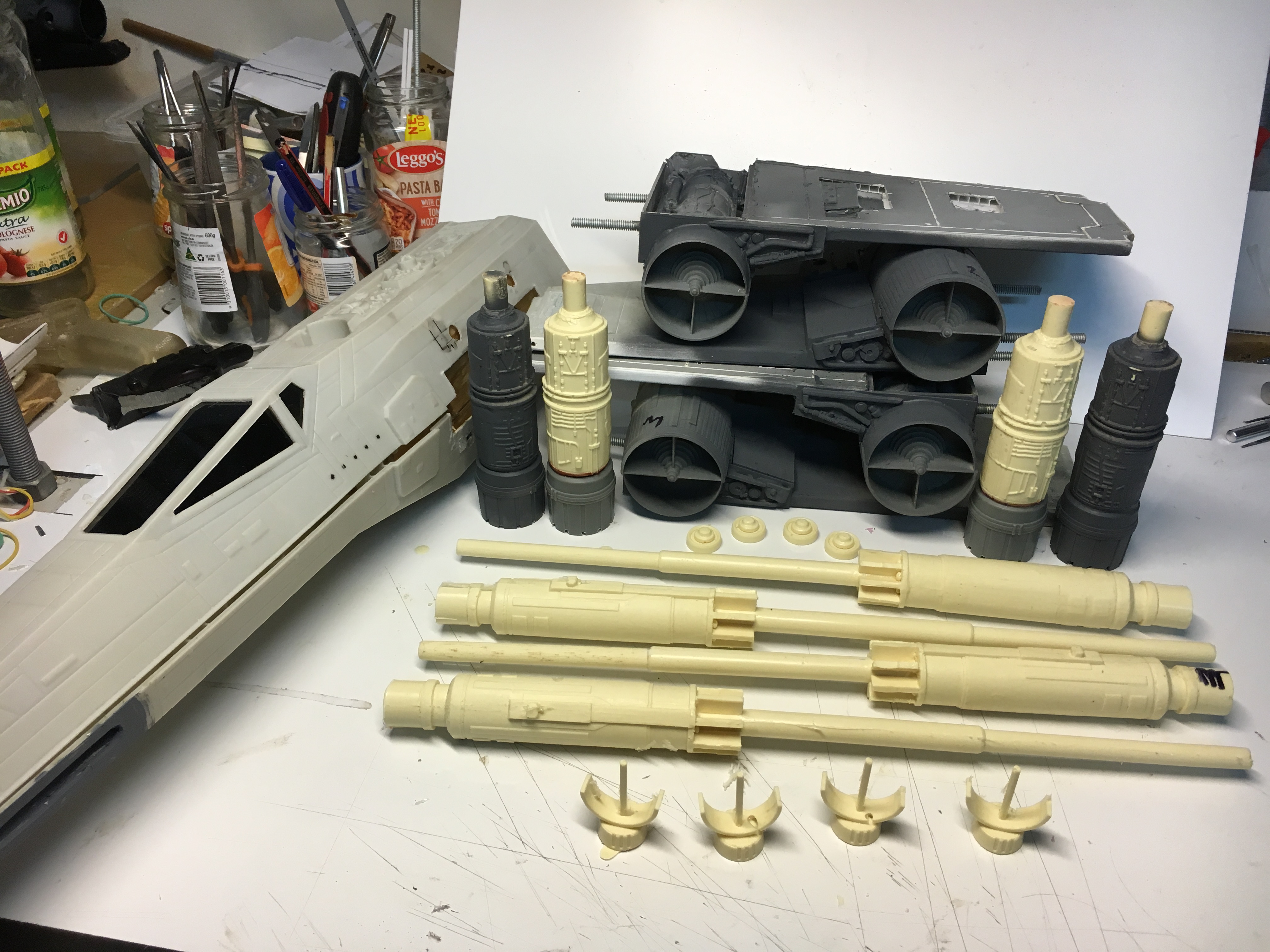

A frustrating beast indeed this is.....;) ....but I've found that as rubbish as the plastic is the shapes are reasonably accurate to build from and create molds to cast which is what I have done to get the overall thing working for me. I'm not going for super accuracy, the sheer size is the interest for me.

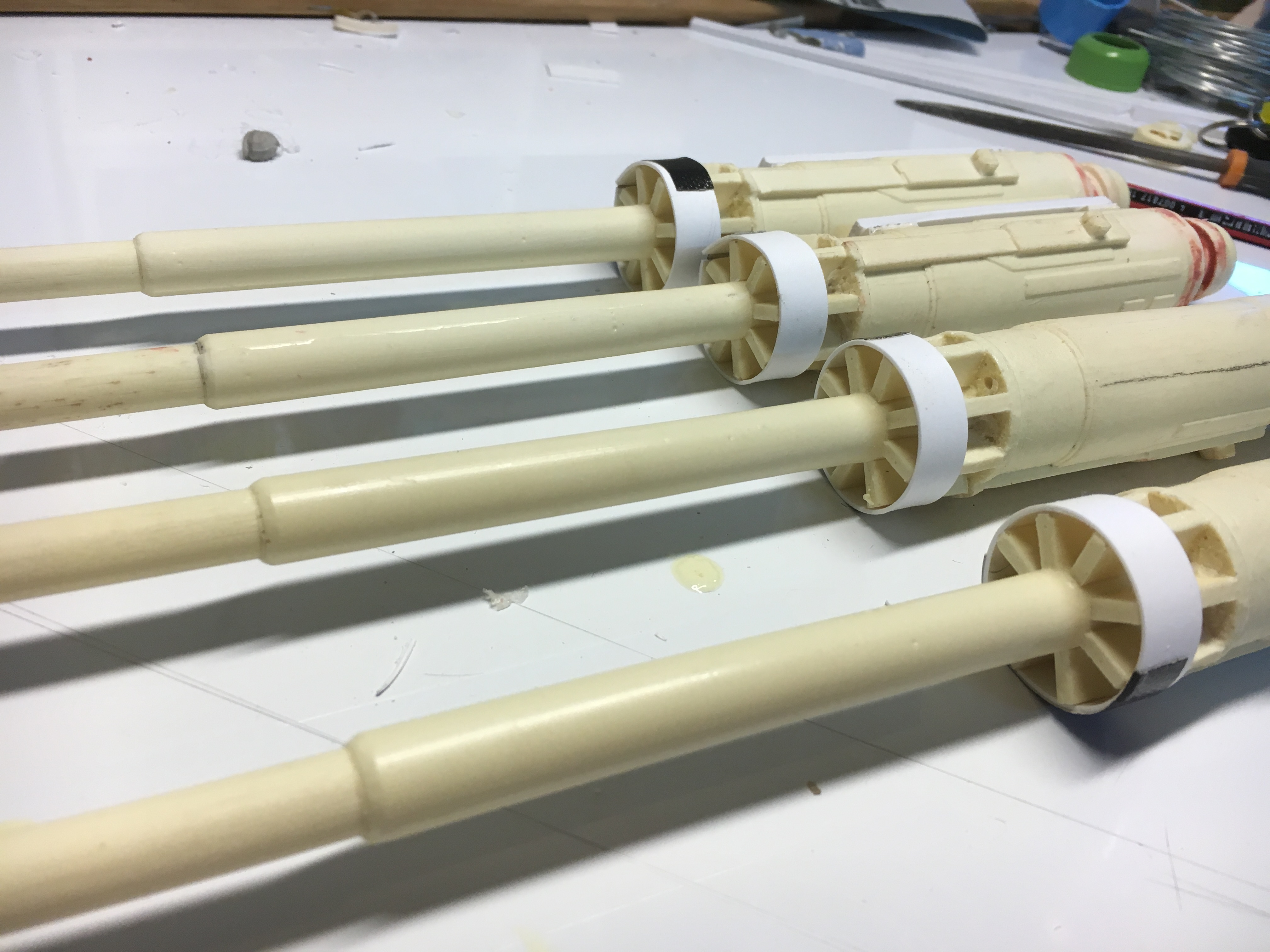

Re: Yaris X Wing - Hasbro Hero- Open Wings & Mods

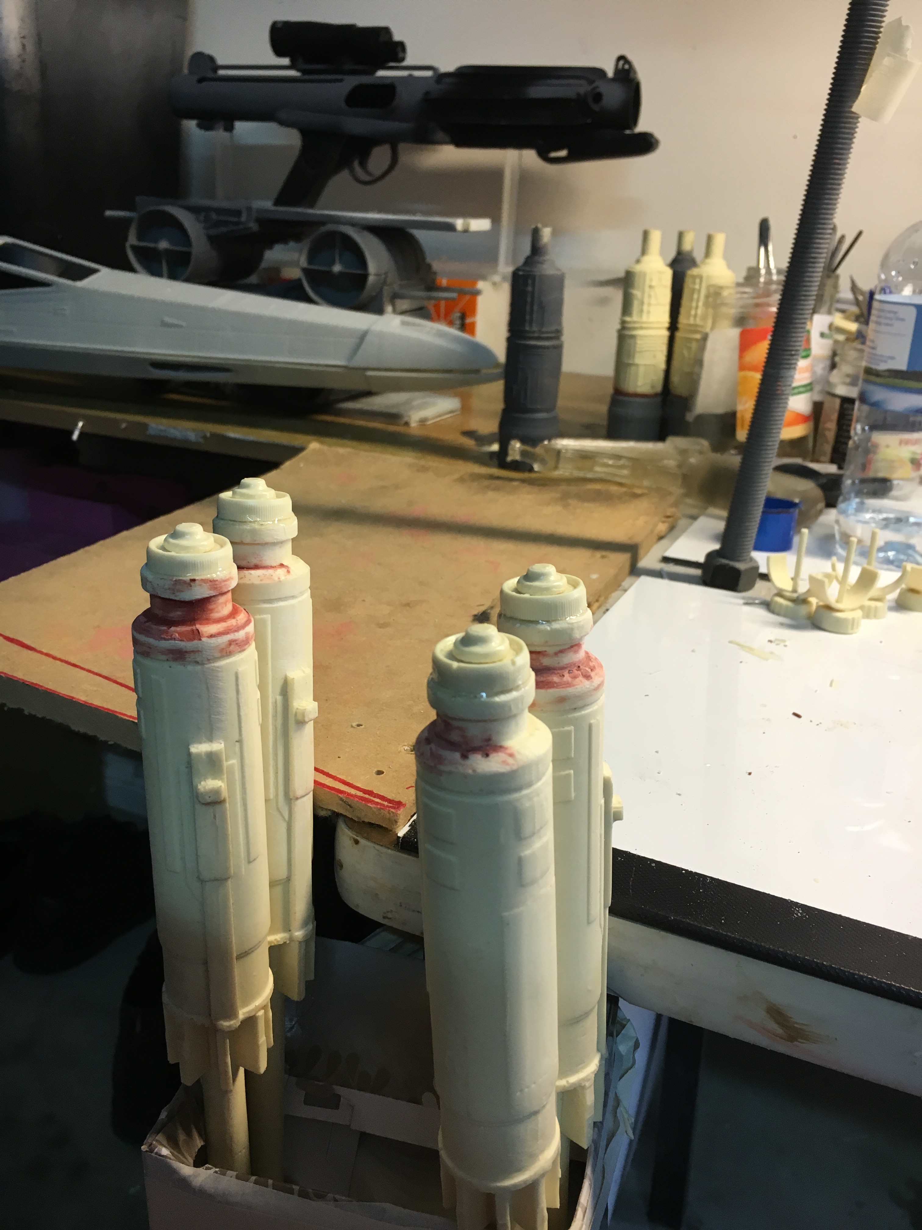

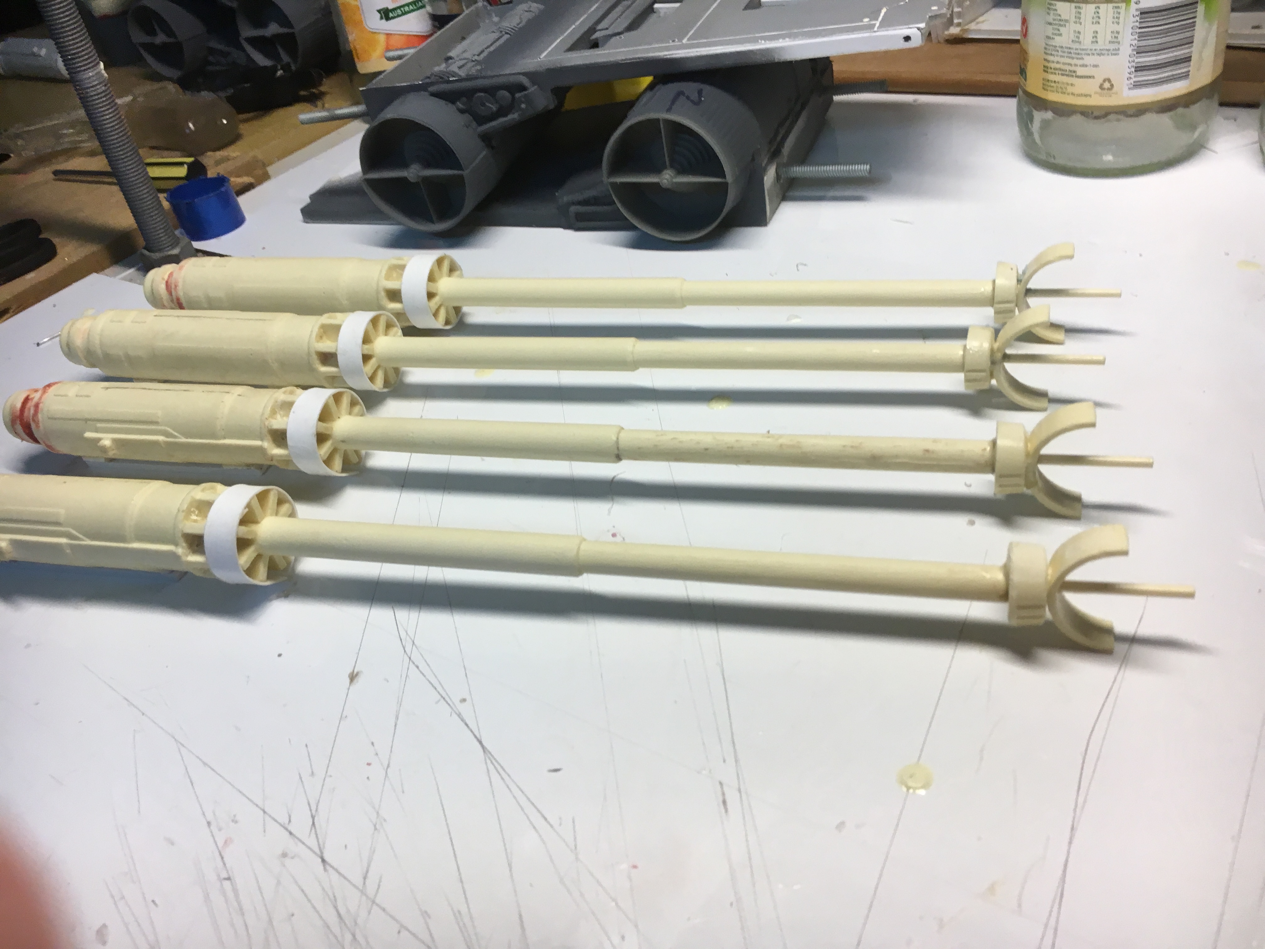

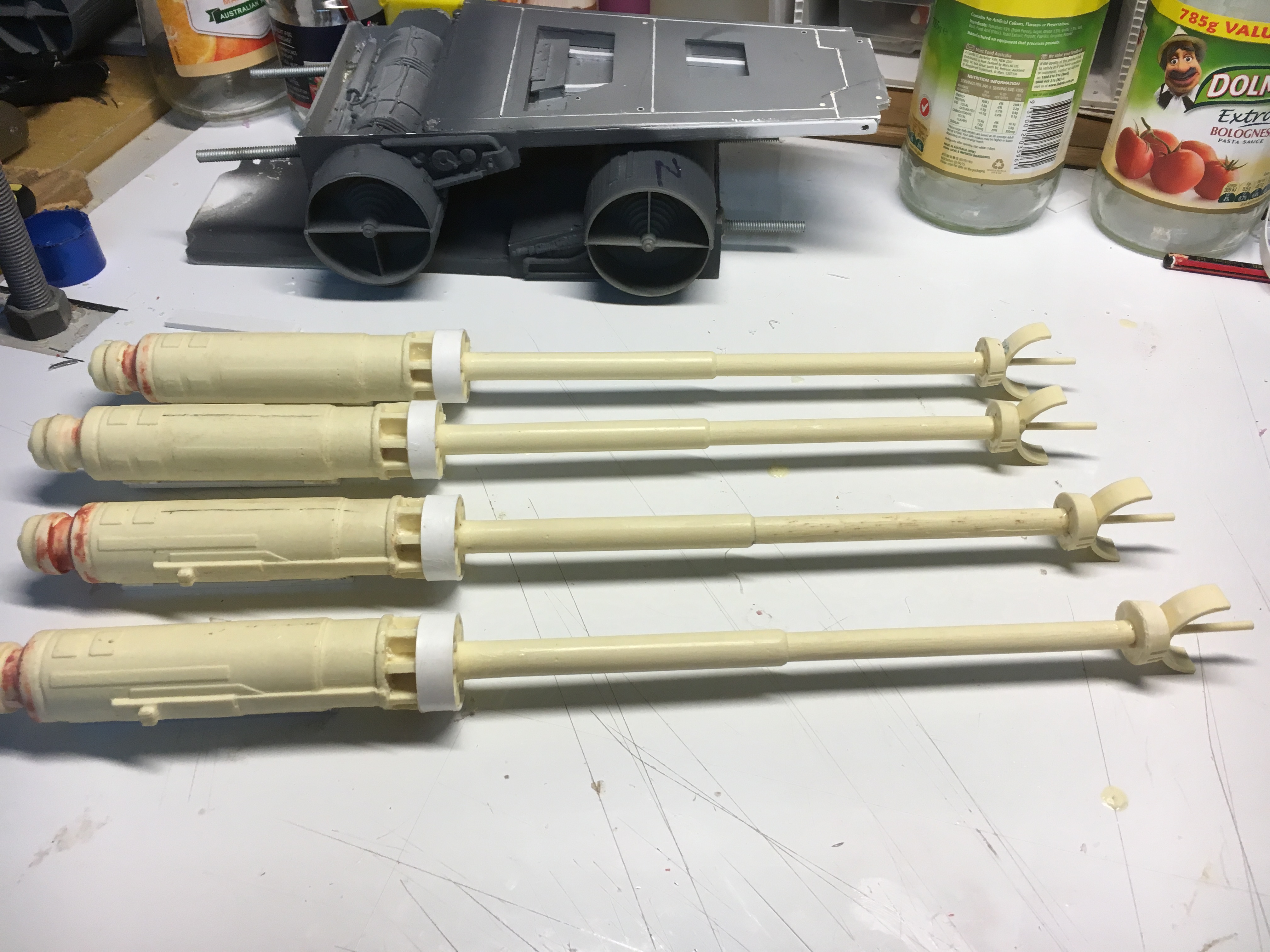

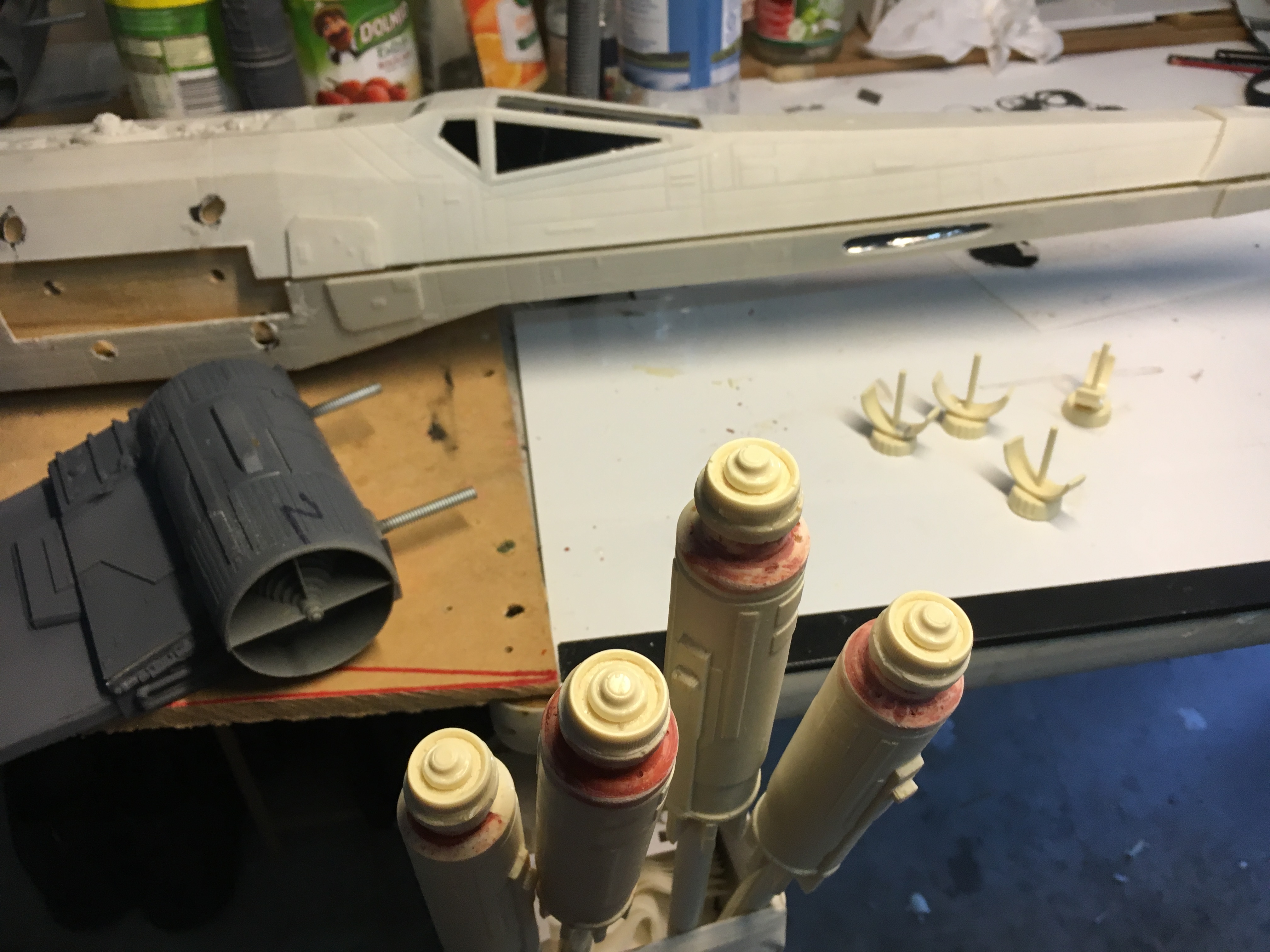

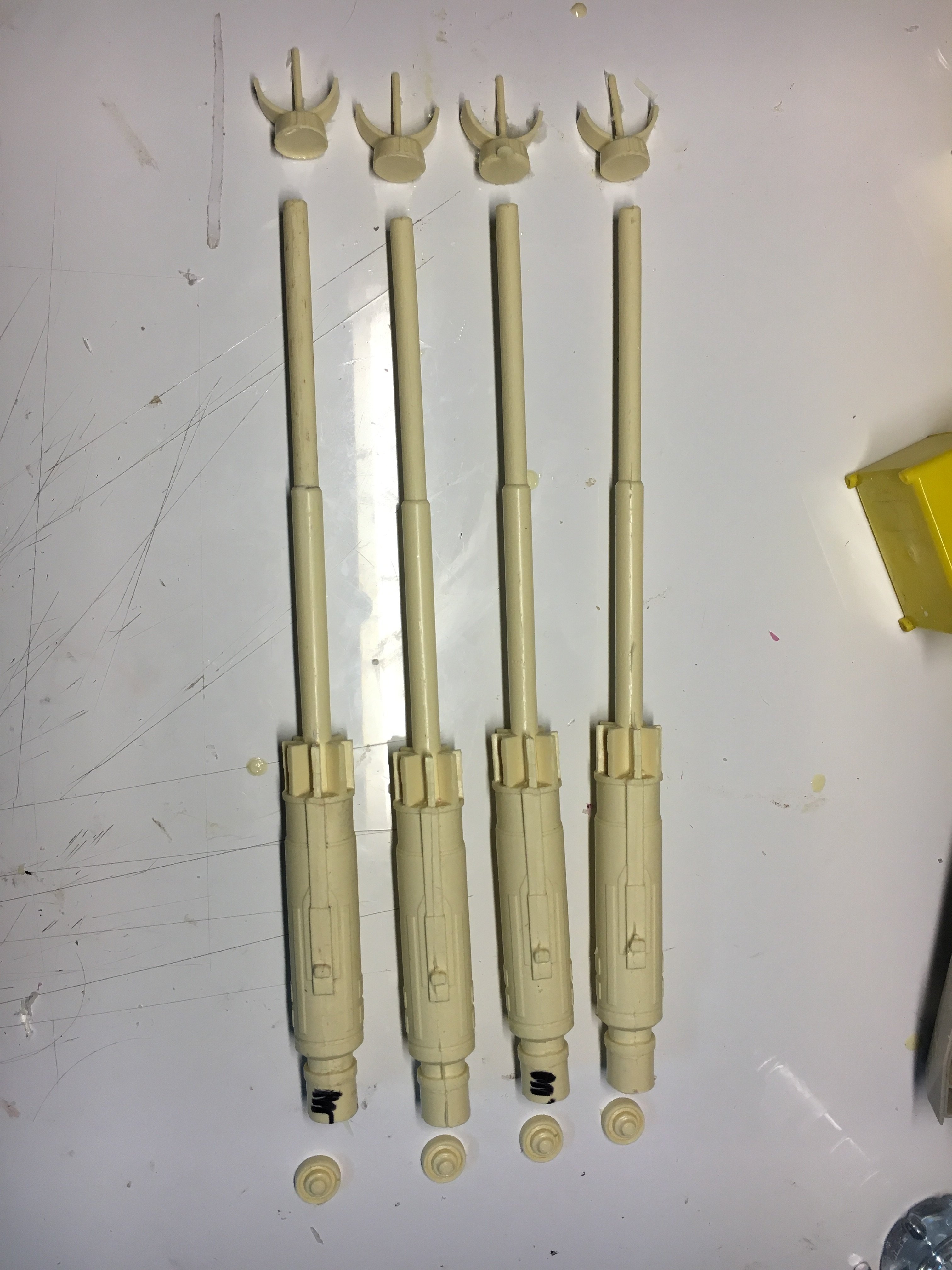

Got all four cannons cast and primed some of the front engine/wing detail to see what it looks like.

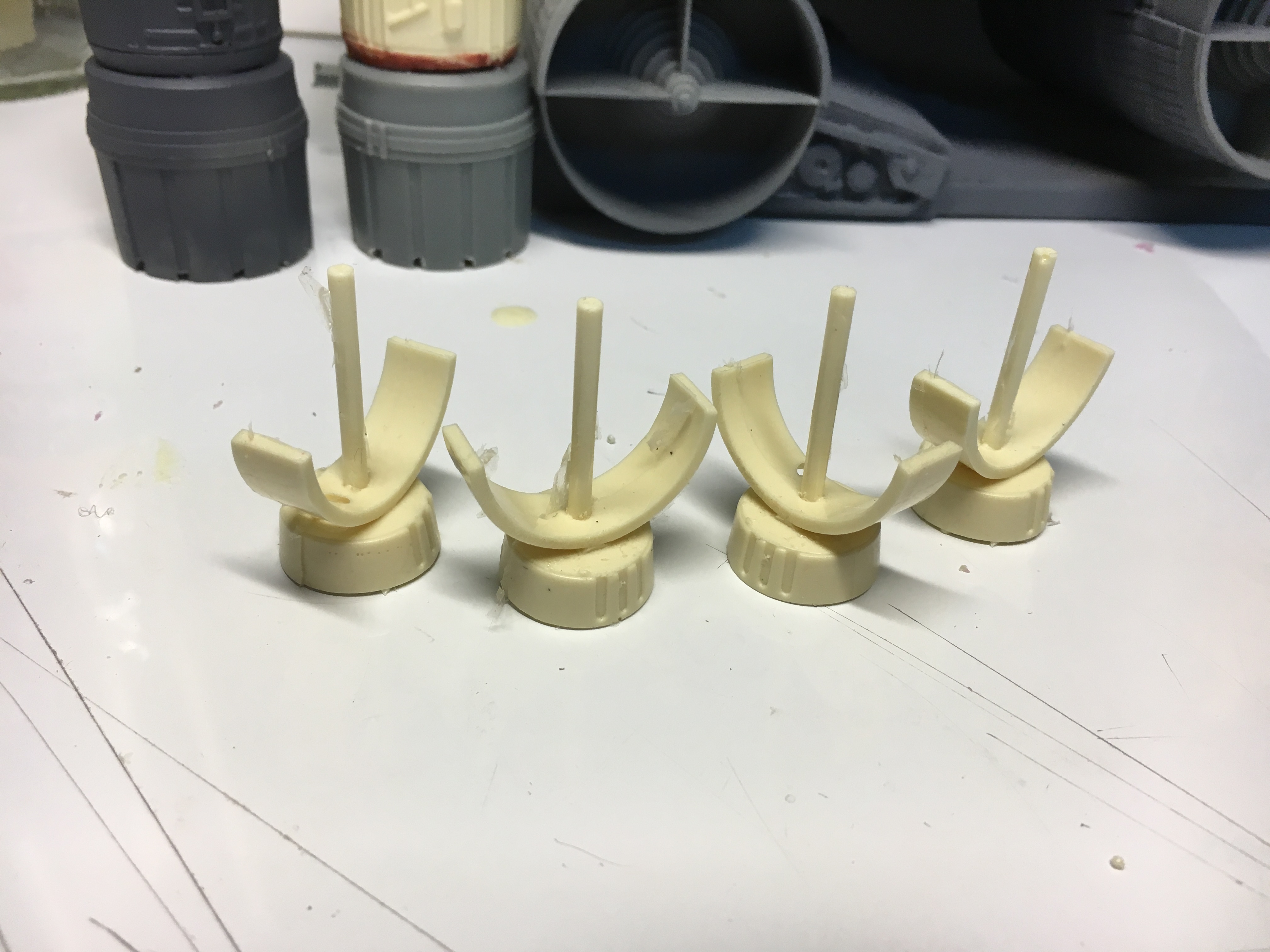

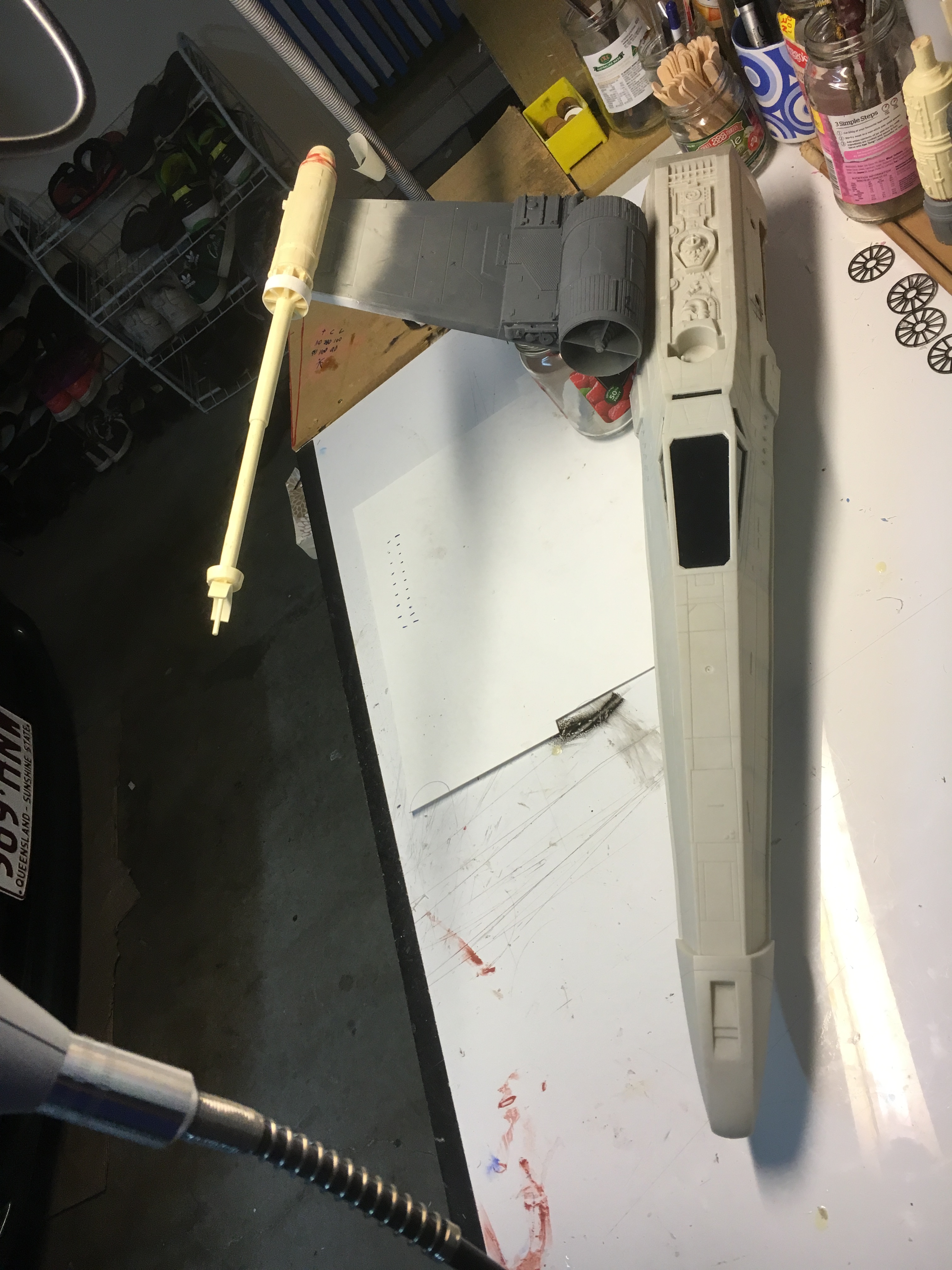

Glued the end cannon pieces on, they are my own interpretation............. like much detail on my build;)

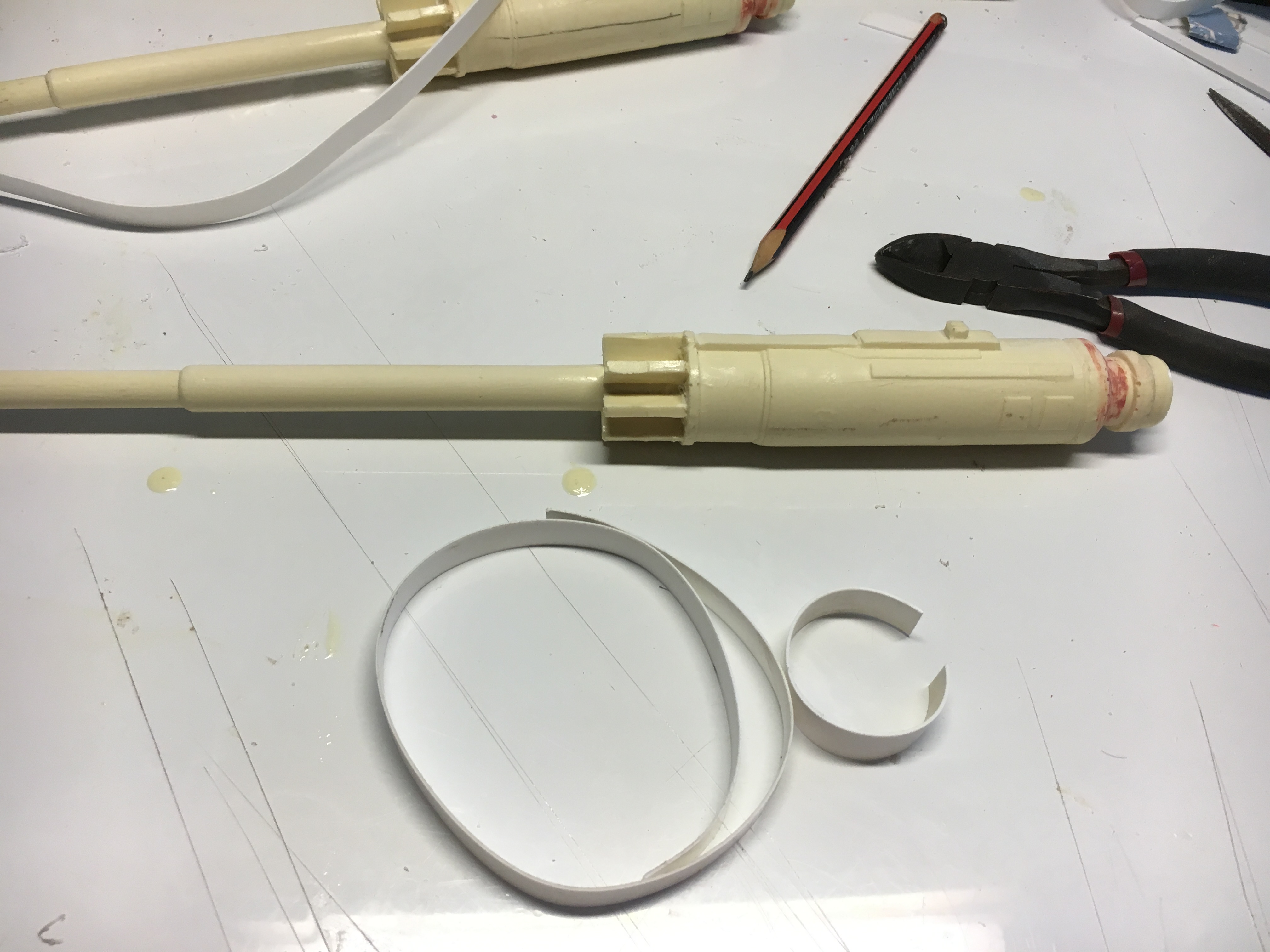

Cannons are done, they need a little sanding, but good enough for me. Heated some 1mm foam PVC for the fin surround to get a curve to make it easier to bend around.

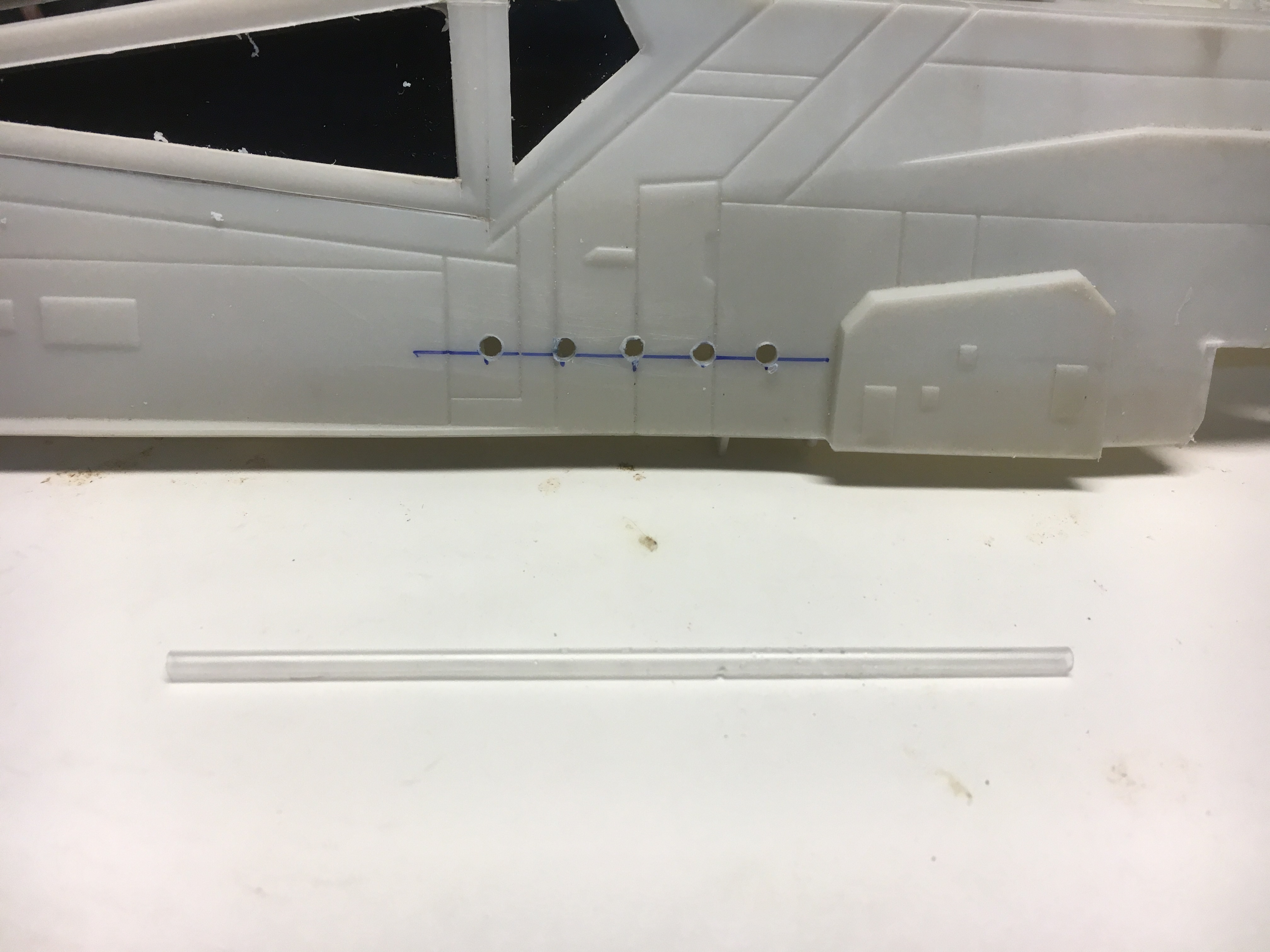

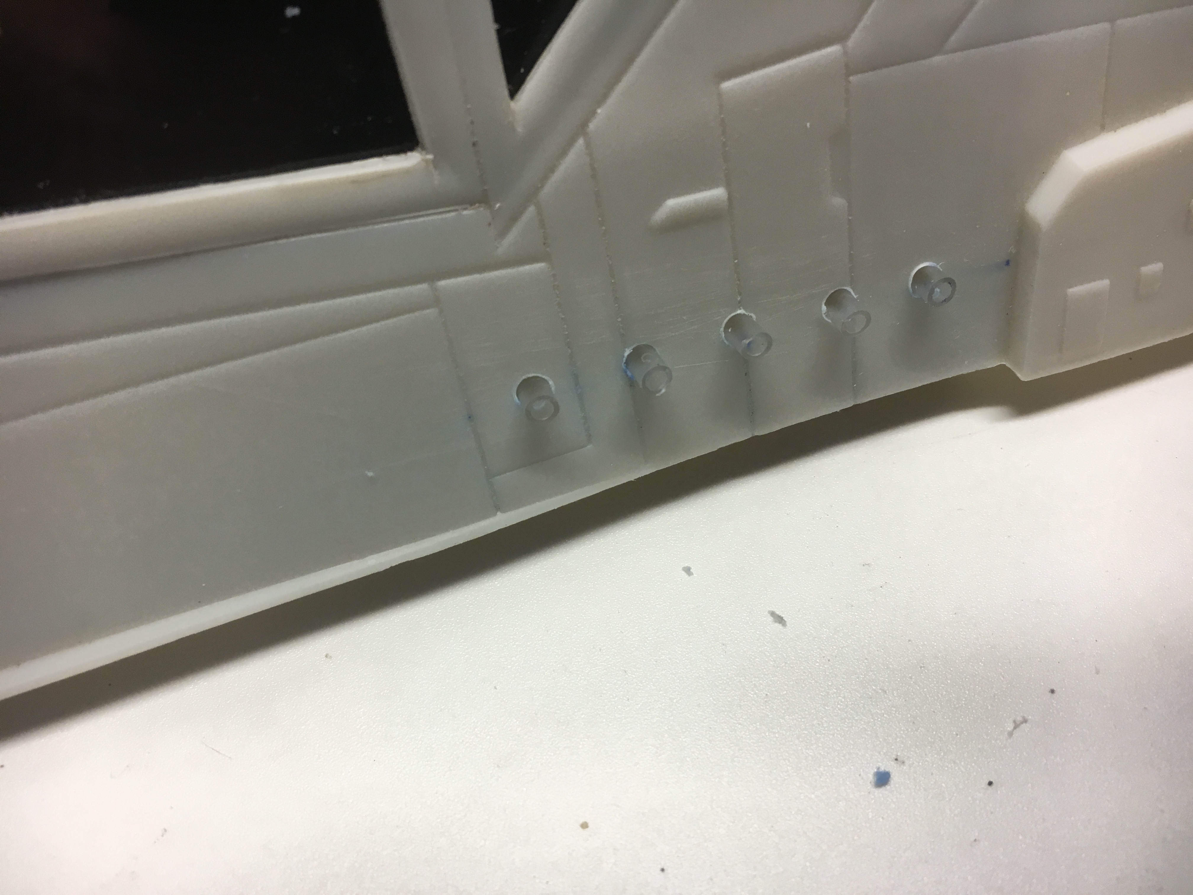

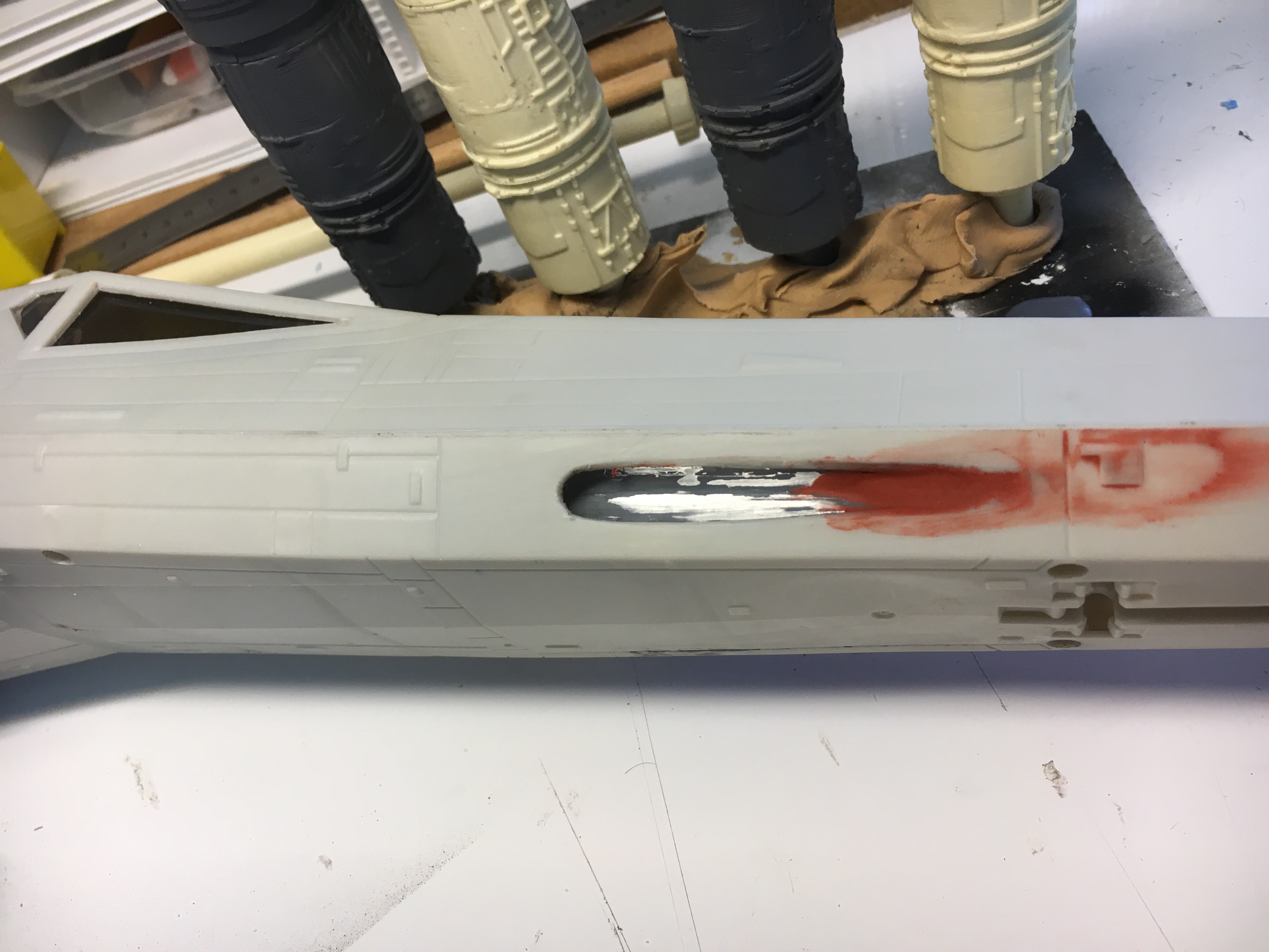

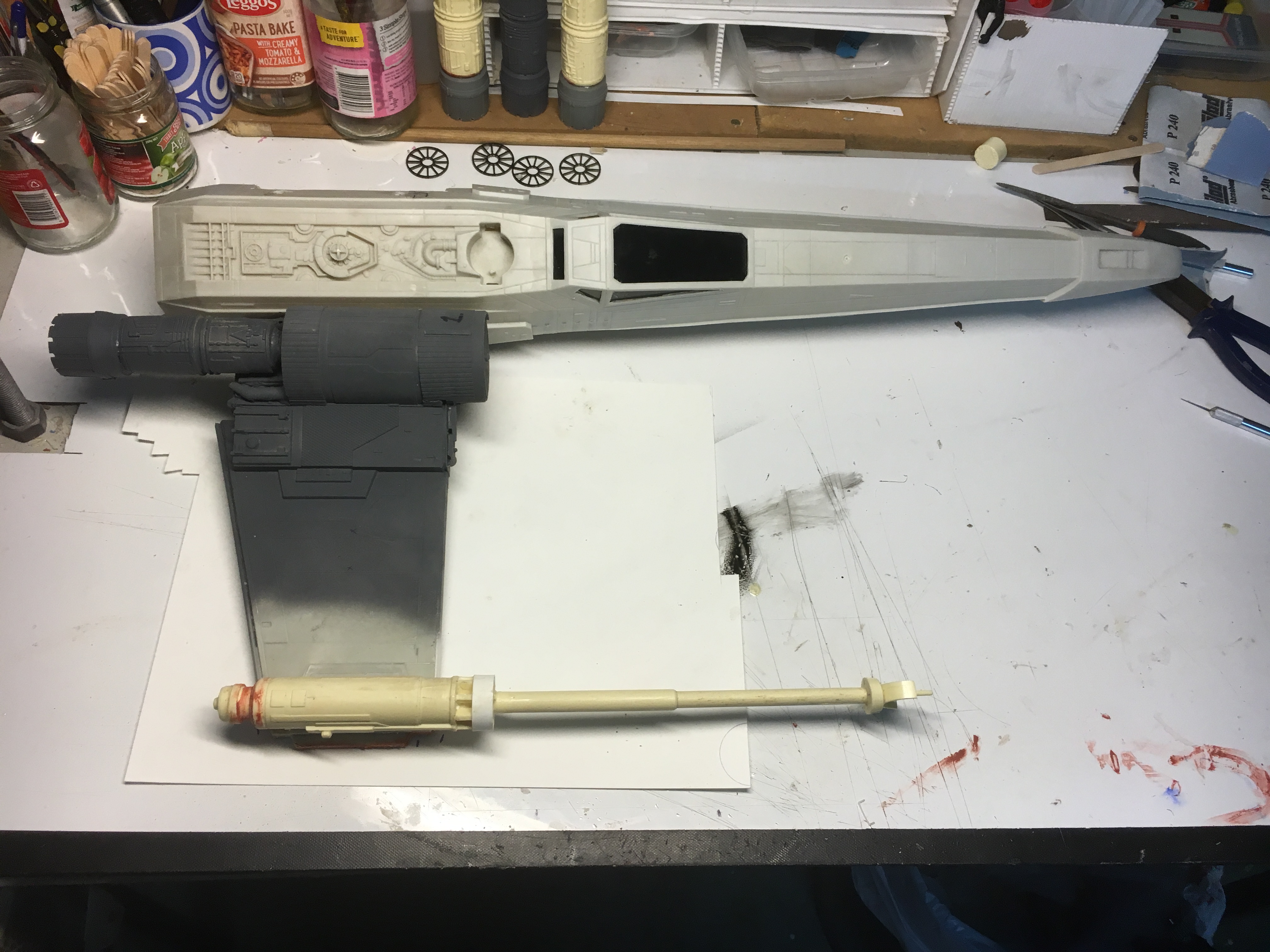

Slowly getting to the end...well paint anyway. Glued the cannons on and drilled the side fuselage holes and stuck some pen tube in the holes. Once painted it'll be fine.....;)

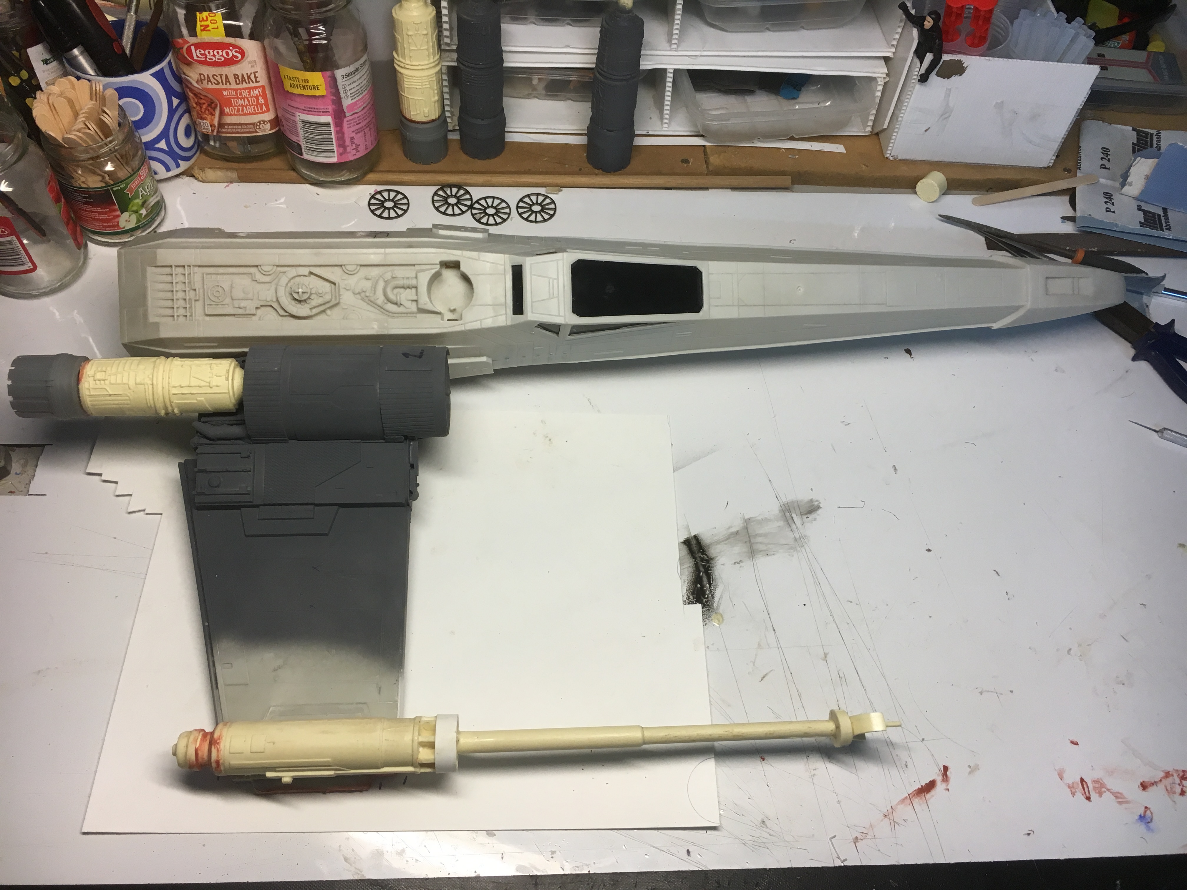

Re: Big X Wing Build - 70cm/28" - Open Wings & Mods

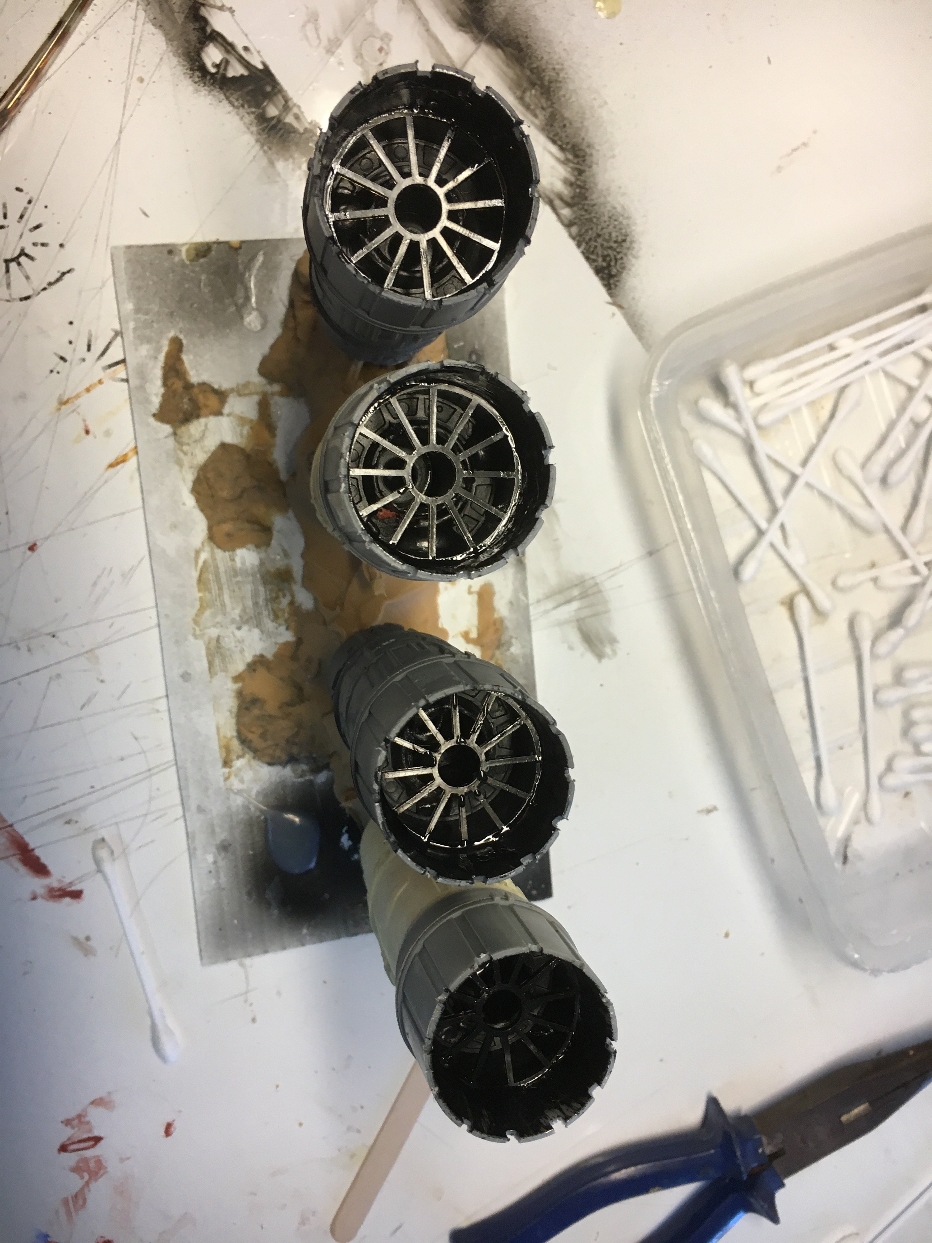

Painted the internal rear engines and glued the inserts in. The torpedo tubes need a bit of smoothing out also.

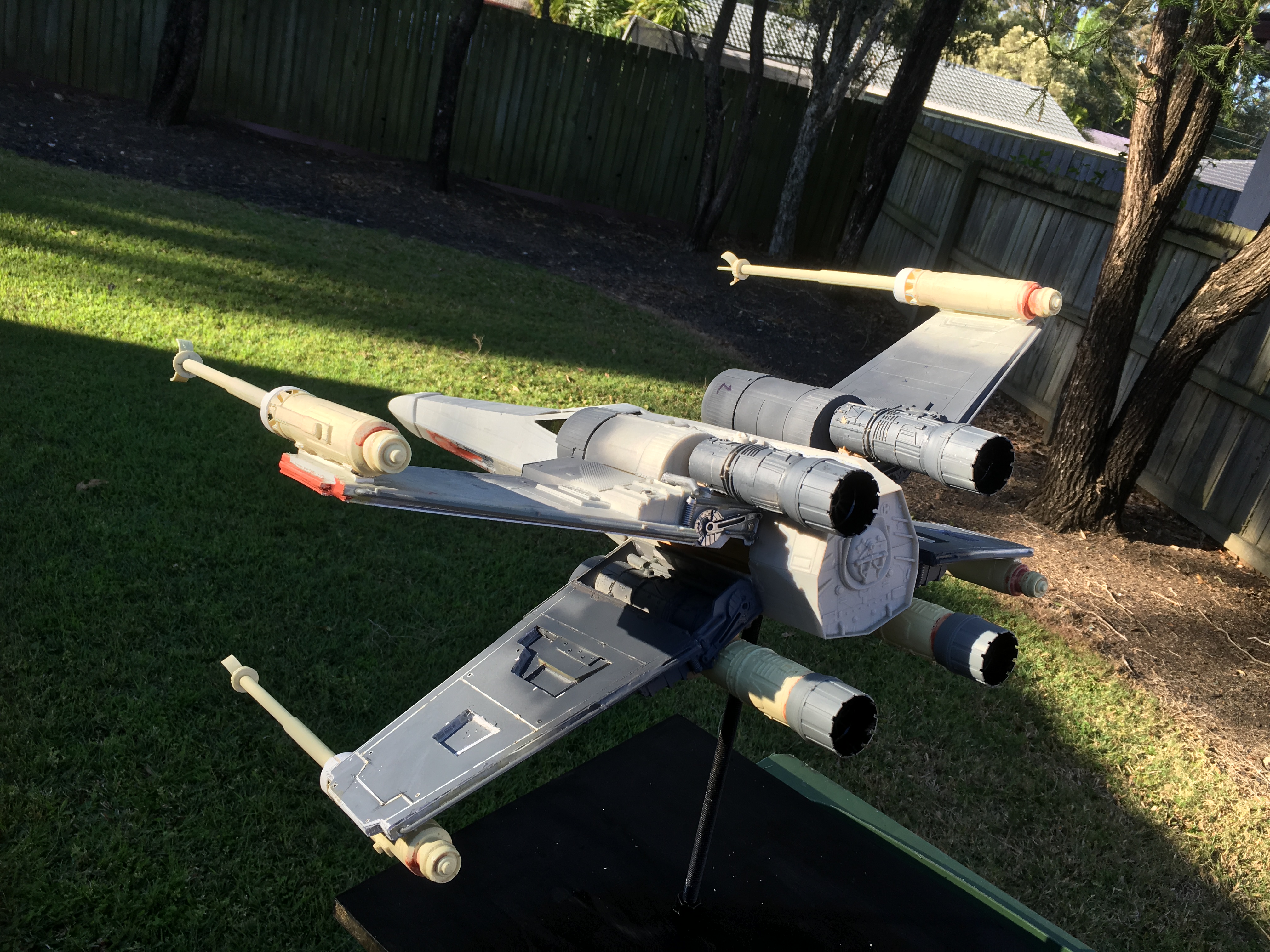

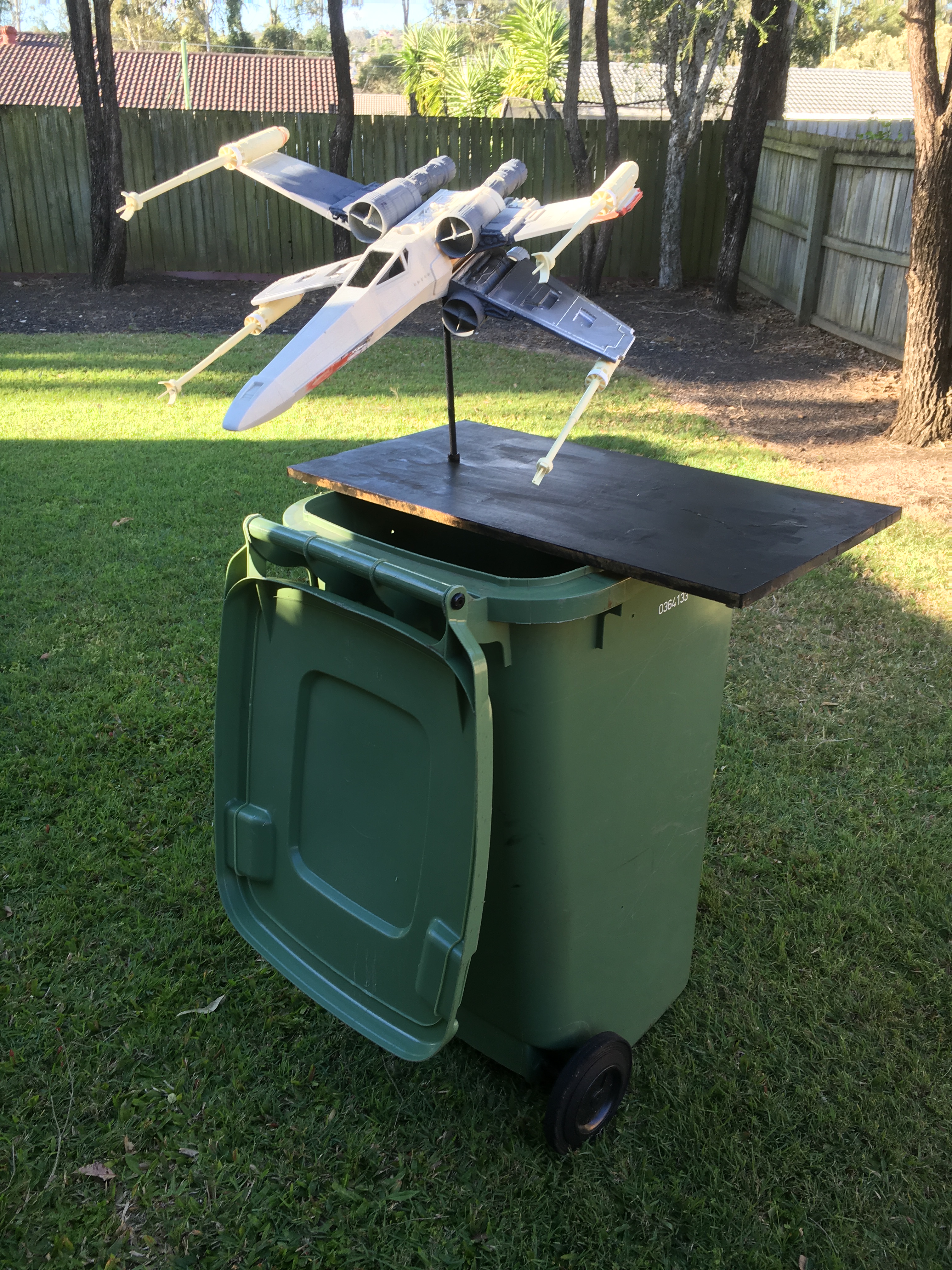

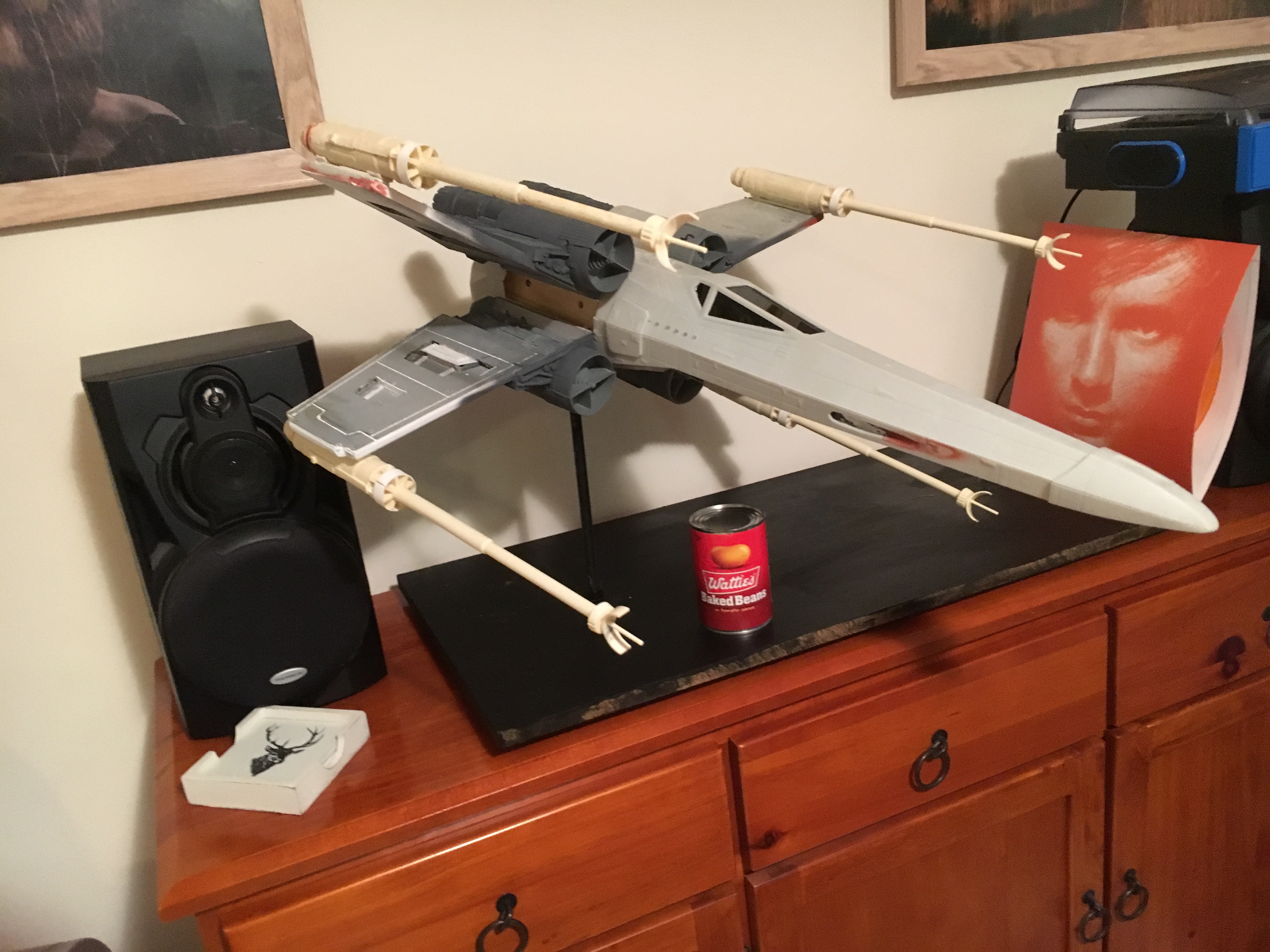

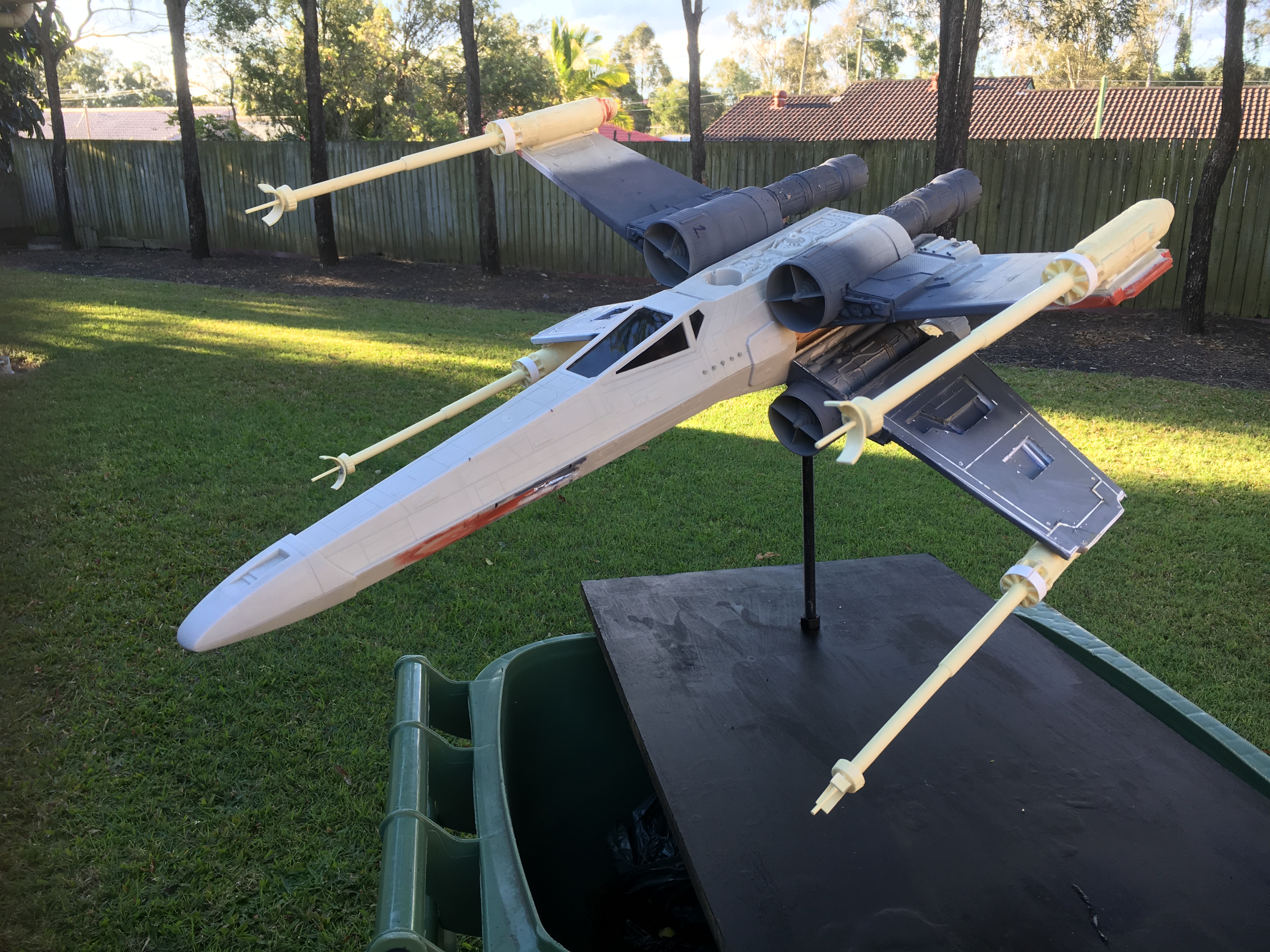

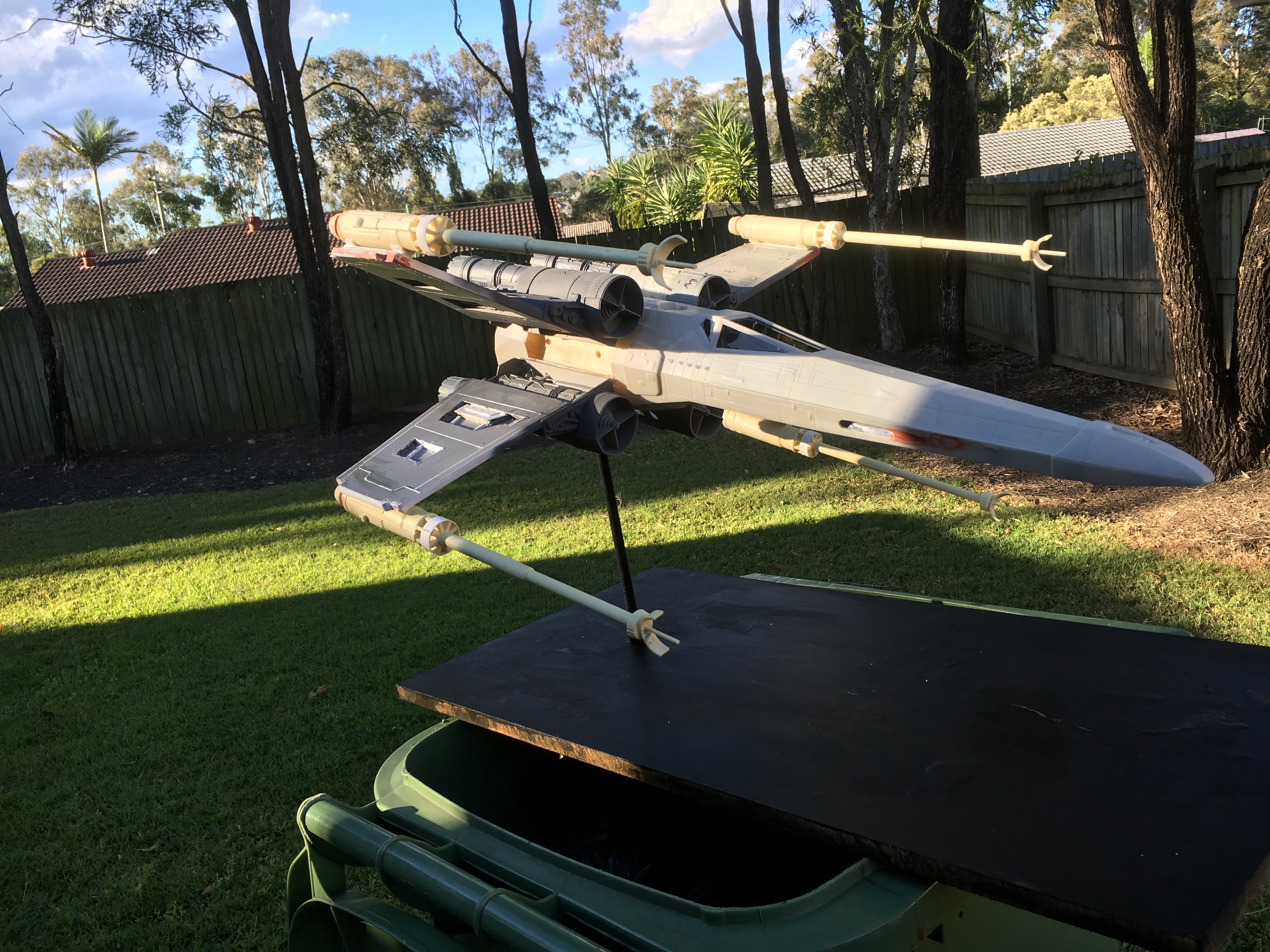

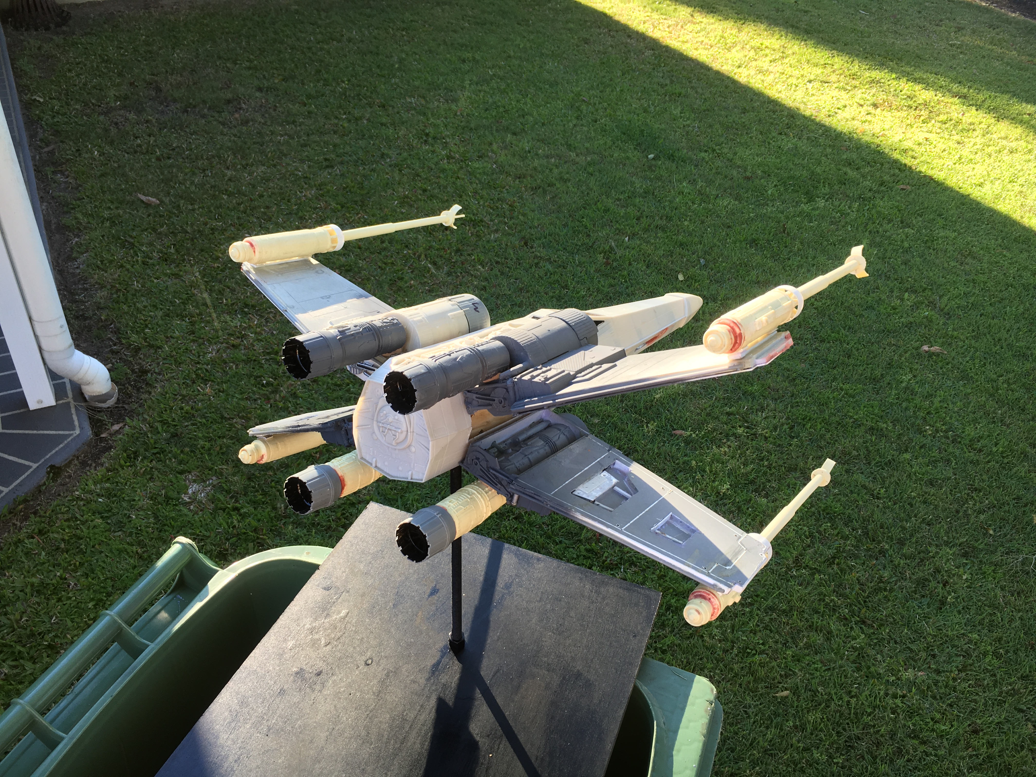

I knew this beast would be big, but crickey it is impressive when assembled ;) I got everything together to see how it fits and now it's a little closer to being done.

Re: Big Hasbro X Wing Build - 70cm/28" - Open Wings & Mods
Most impressive
It's awesome seeing the wings opened up one of these. I have one still in the box and am hoping someday to be going down this same road

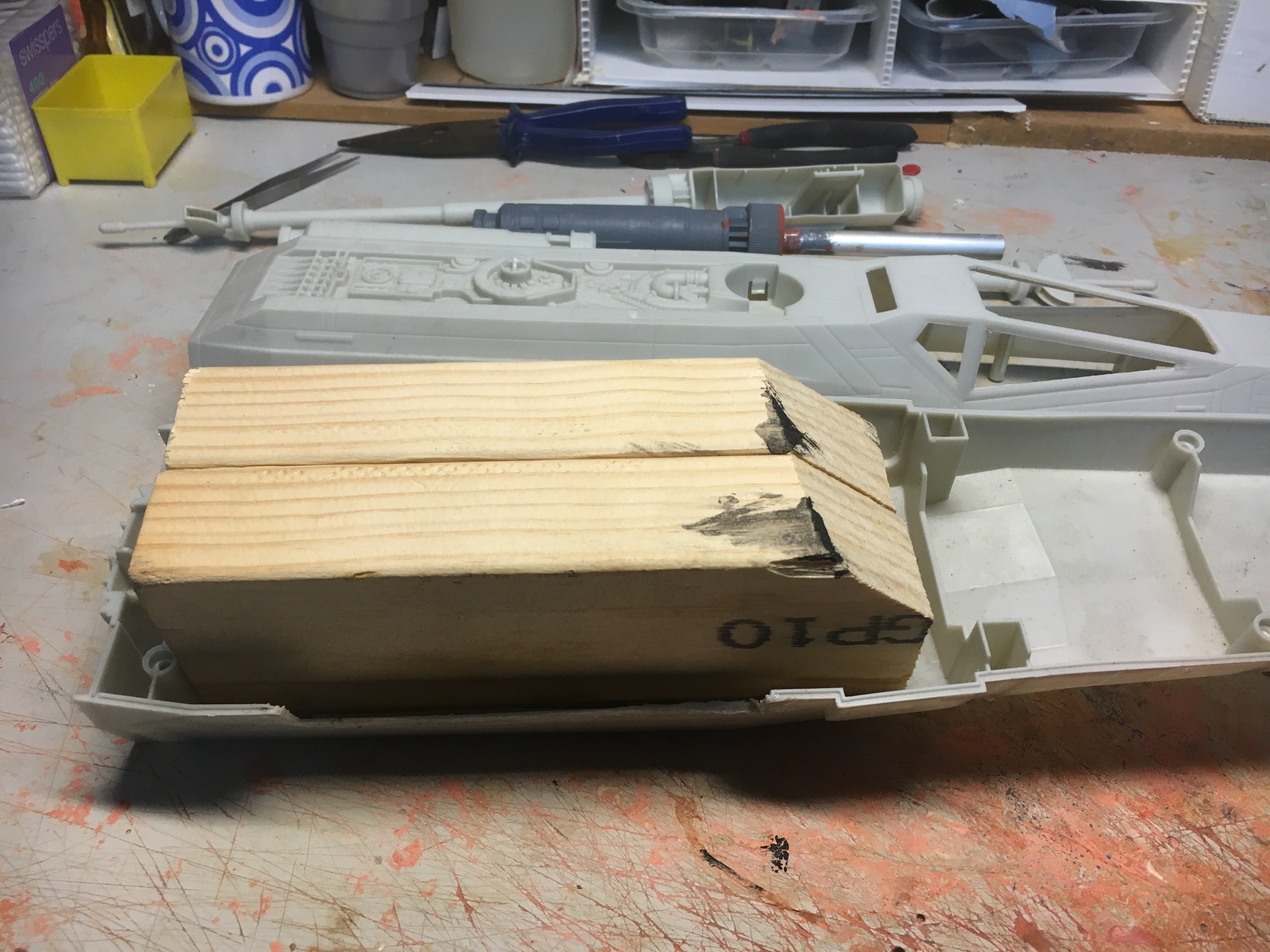

Yaris,
I'm really enjoying watching this build !
Id like to know more about your internal block...how you set it up. How it's attached. How you insert the wings. Is it possible to design a block to display in both open and closed wing configurations? How you use it to set up the mount etc. any info would be really interesting and helpful.
Most impressive
Thx:D I've left it set up inside for a while just to appreciate it's size. I always wanted a bigger X Wing than the sizes available and this 'toy' is quiet accurate in parts and scale and with a little work;) getting the wings open and fixing some other things, it can turn out very nice. I've kept it reasonably simple as I'm not interested in an open cockpit or lighting it, so that saved a ton of work. There's still a fair bit of work to do like paint, weathering and filling the wing intersect parts, but I'm pleased with how it's turning out.
Yaris,

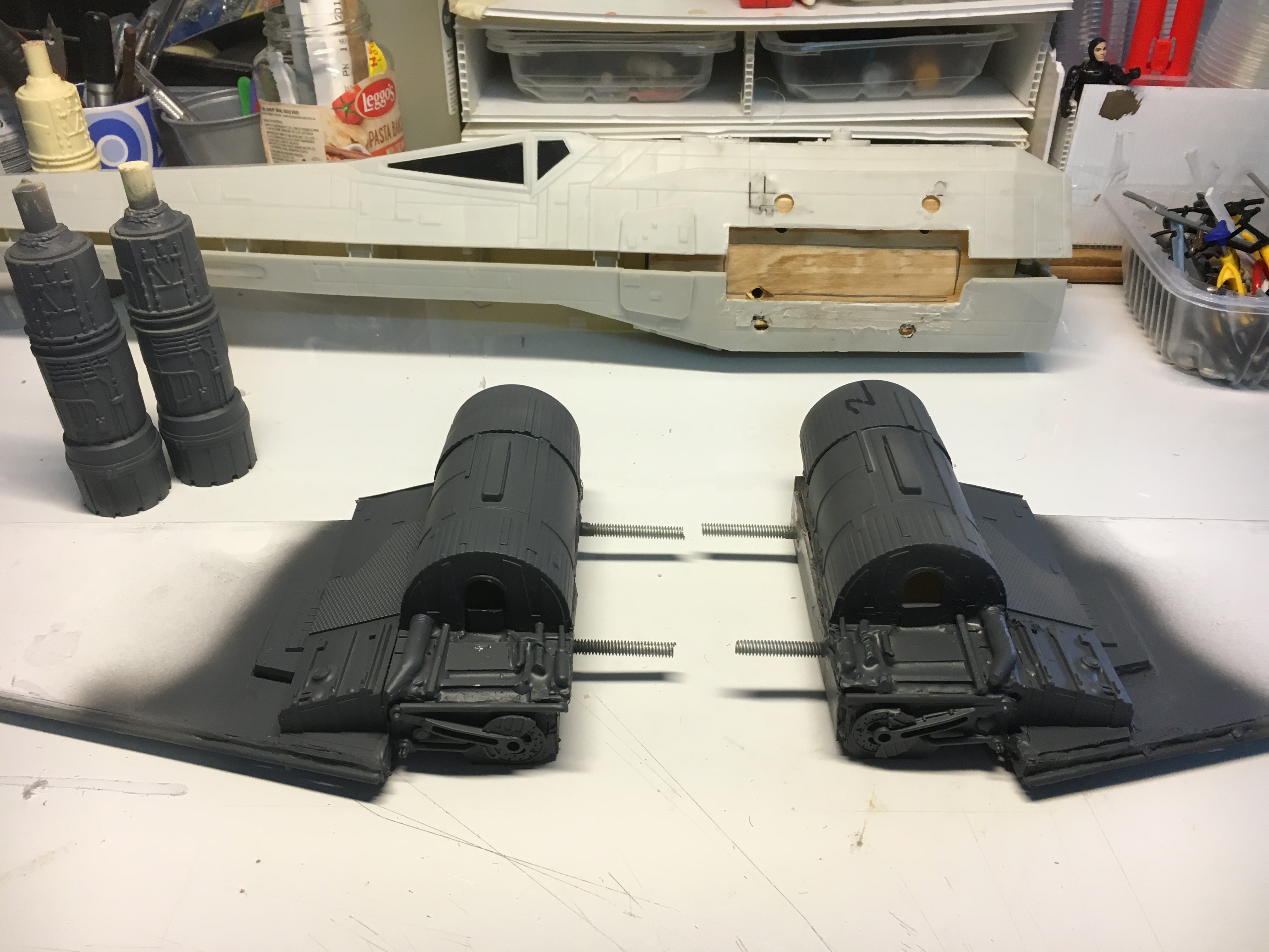

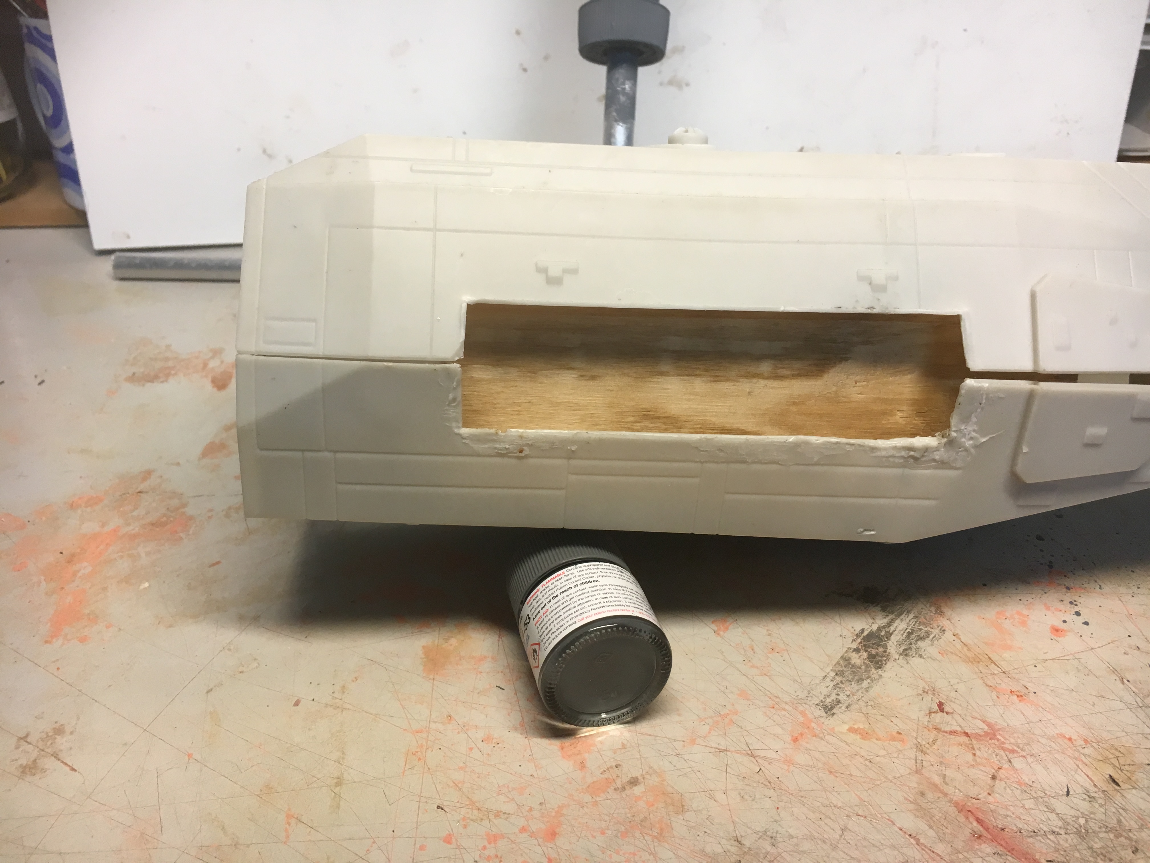

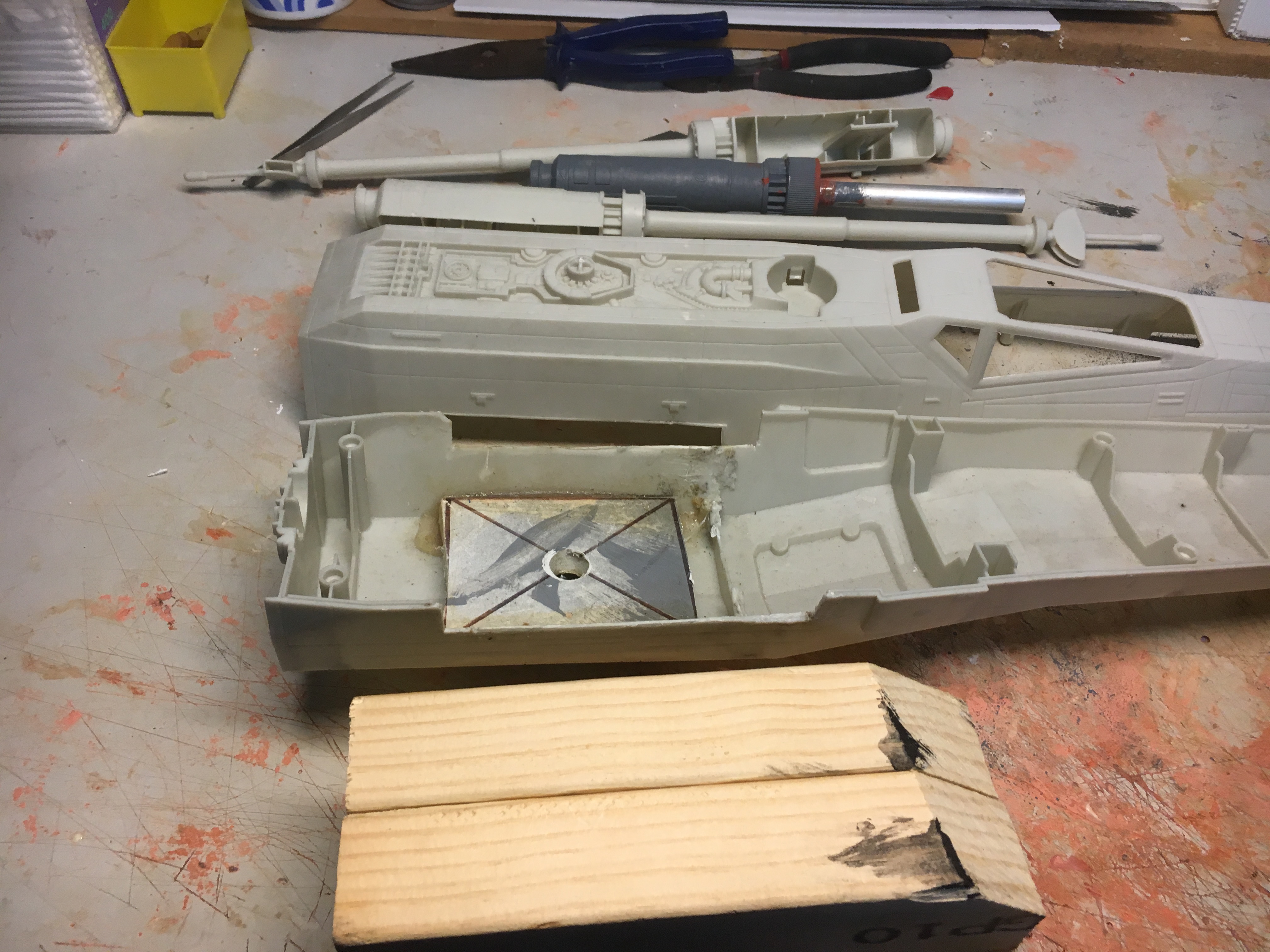

Well, I'm no expert, so I just used two pieces of 70 x 35 framing timber wood to fill the gap where the wings need to be mounted. I made it as big as possible in that space, cut a 10mm plastic base plate for the body mounting rod, glued the base plate to the floor of the fuselage, glued the wood to the plate and then put the fuselage together, lined up the wings and drilled oversized holes for the wing rods to go into the wood.
I used 6mm drill rod for the wing mounts as I thought wood dowel may be to weak, the wings are surprisingly heavy once the cannons, internal and external engines are mounted. I used the hole in the base plate as a guide to drill through the wood block to get depth for the main body mounting rod. That rod is drill rod for now, but it will probably be clear acrylic rod when finished.
I considered having it possible to open and close the wings and it can be done by copying the way some of the smaller kit/models have the wing open/close mechanism. It wouldn't really be that hard. All the X Wings I've ever had have always been mounted or hung in open flying mode. I just like them better that way so no real reason (for me) to have that feature, but it's definitely doable.
Some photos of the block/plate/drill rod/mounting etc.....not pretty, but it's not visible once completed.

I have a couple more questions. What at exactly is the function of ur plastic base plate? Also did u use some sort of jig to assure that you drilled at proper angle ? Also so how did u cut the drill rod? That need a hacksaw?
The base plate gave me a level surface to glue the blocks on to. Without it there isn't really anything flat and solid to glue too, just the inner shell of the fuselage. I didn't use a jig, because over the years I've done a lot of drilling through my job, I just did it by eye, but if it's an issue, right angle drill accessories are cheap or even a small builders square would work.
I cut up all the drill rod in a vice with a hacksaw.
