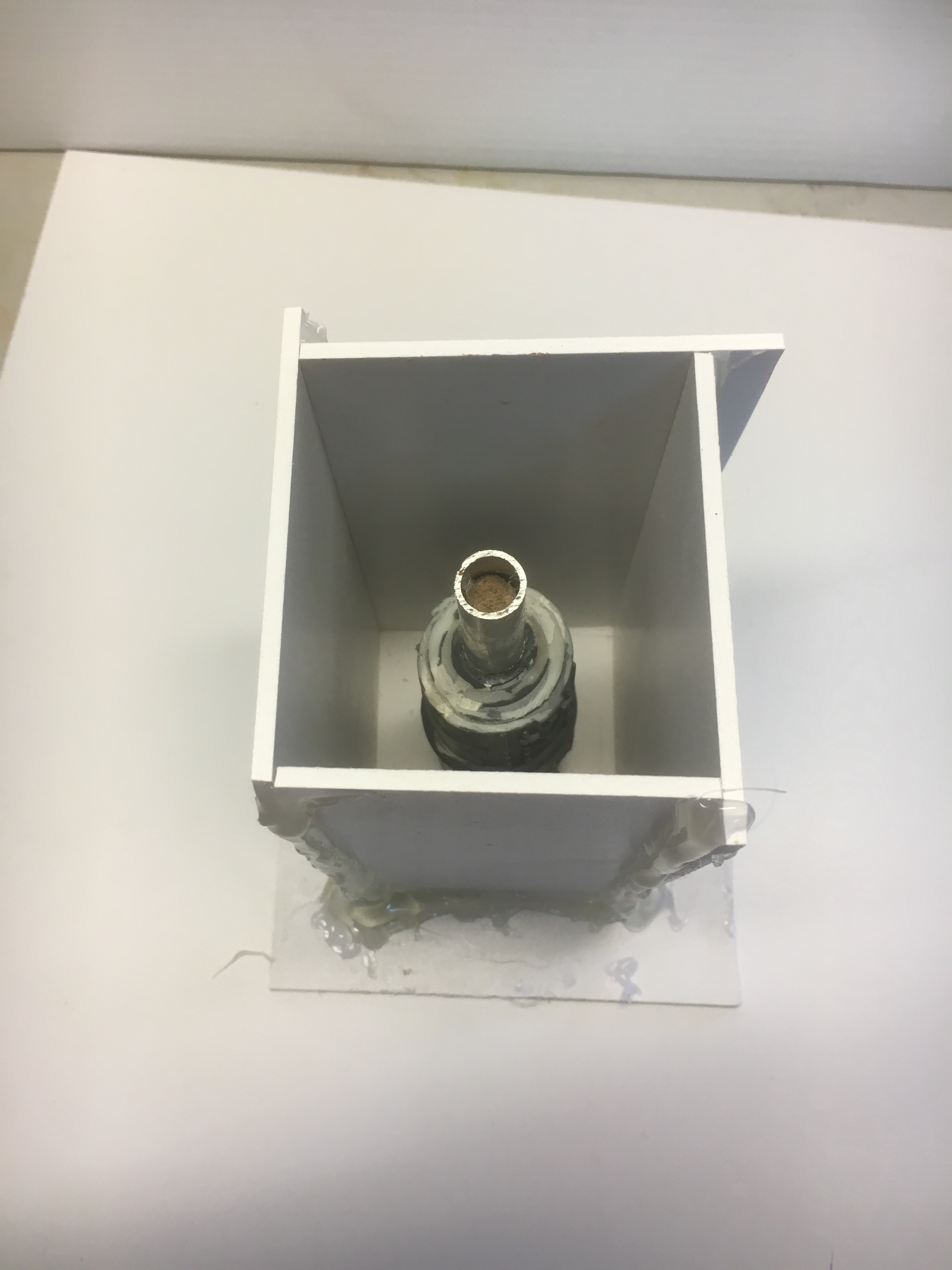

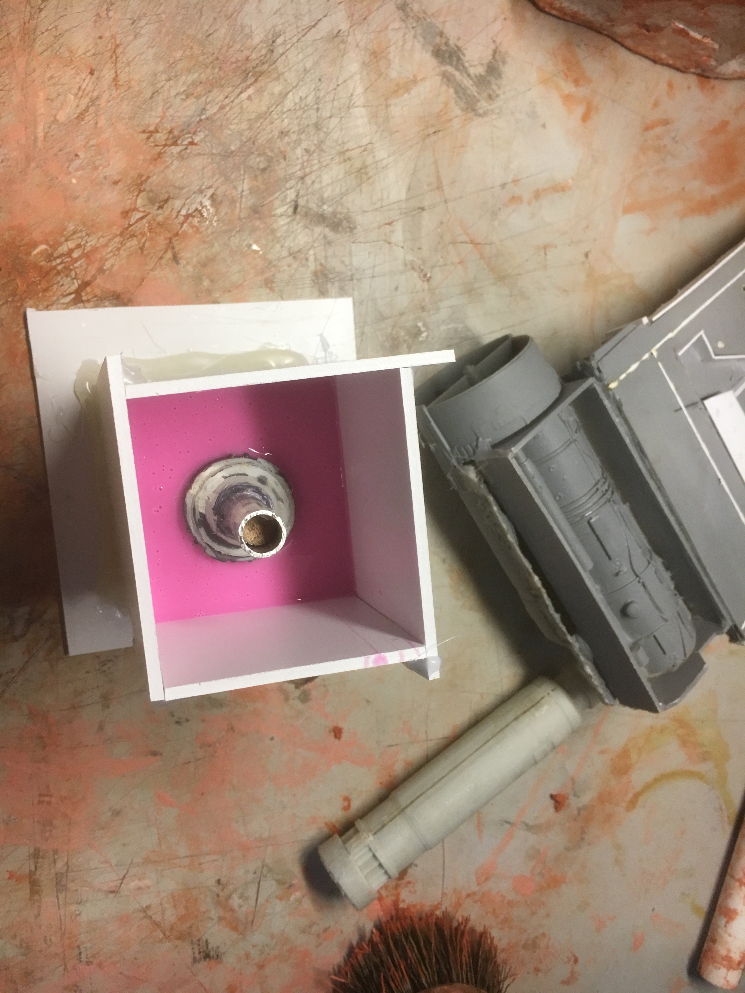

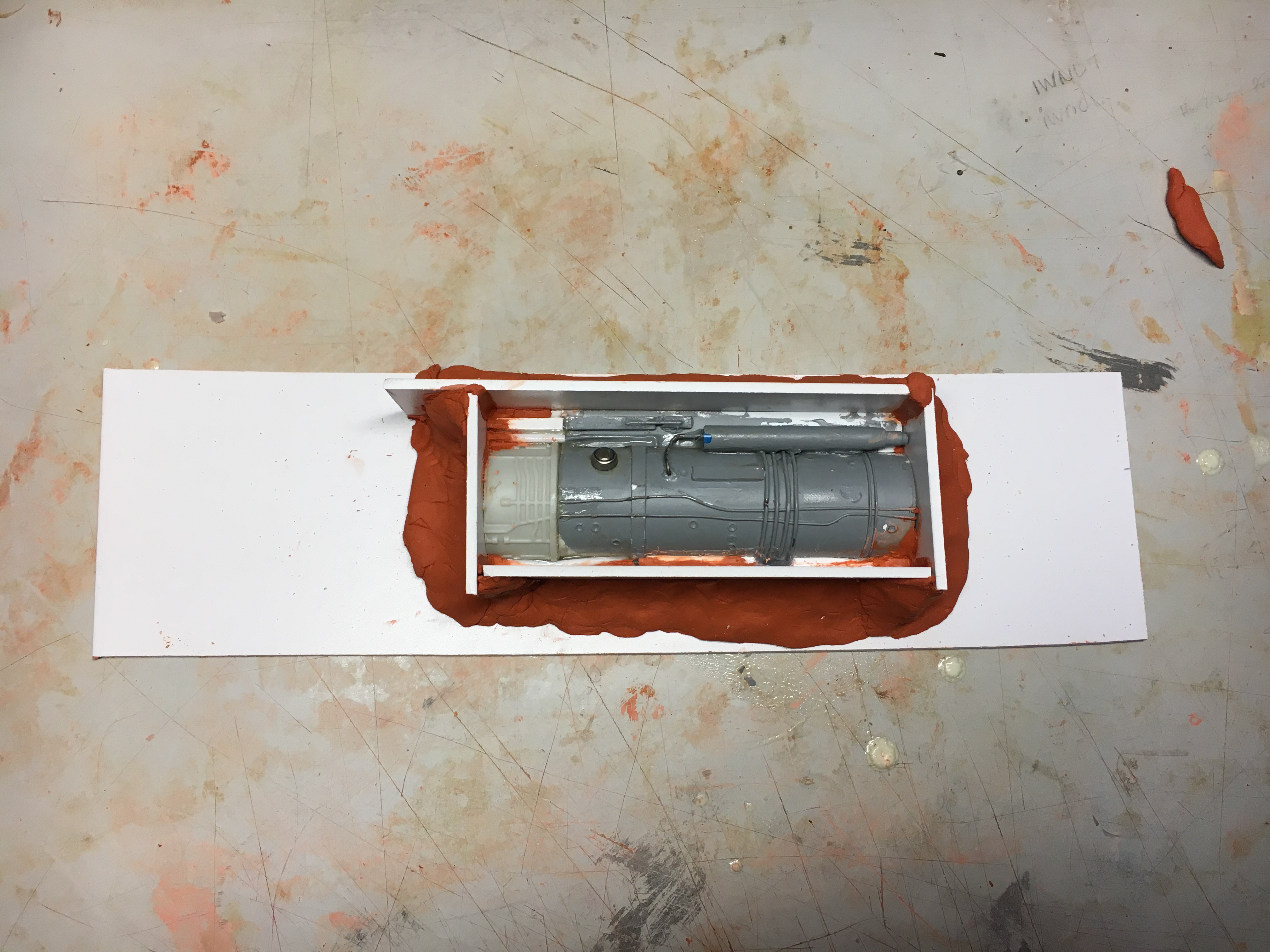

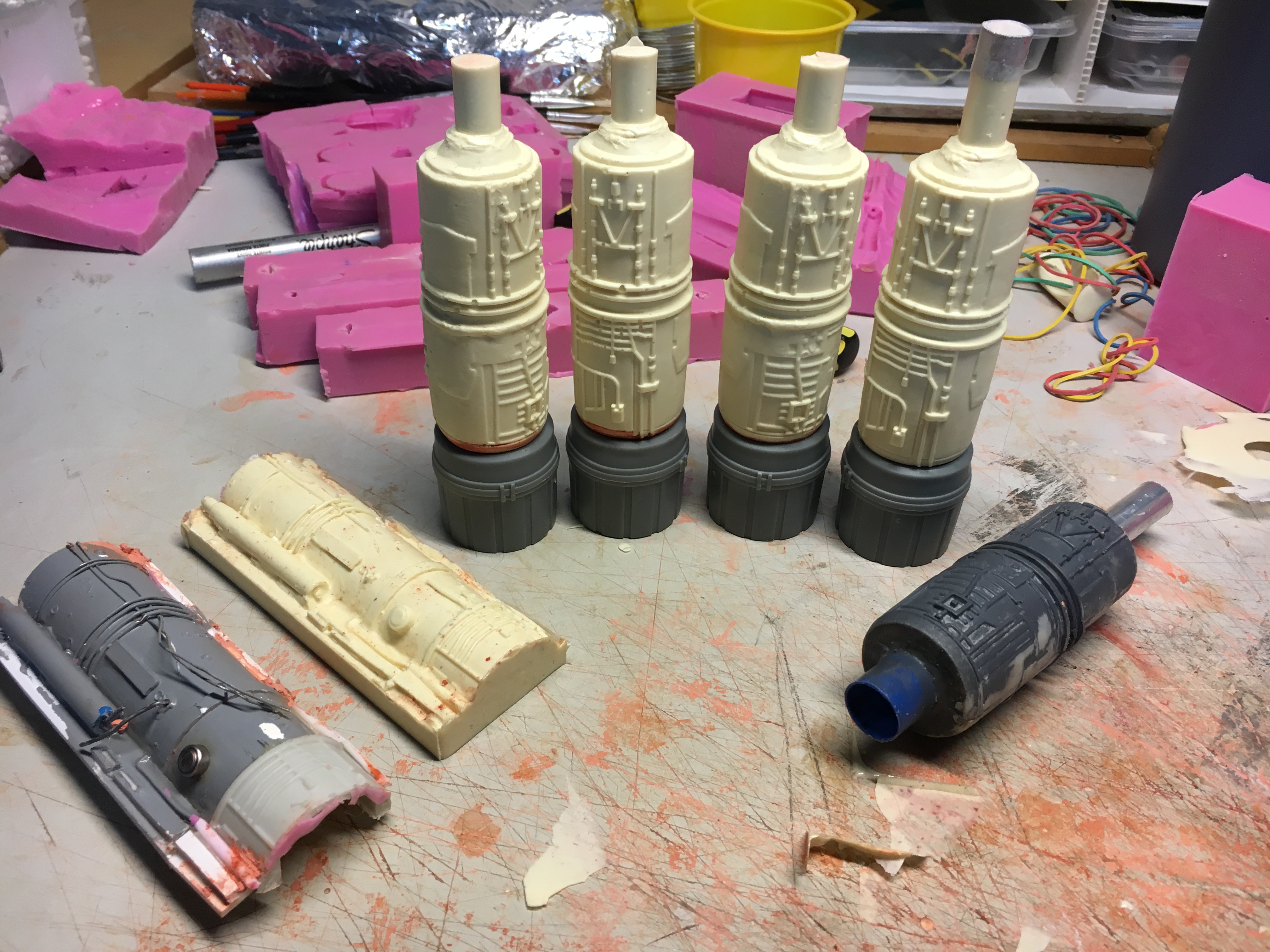

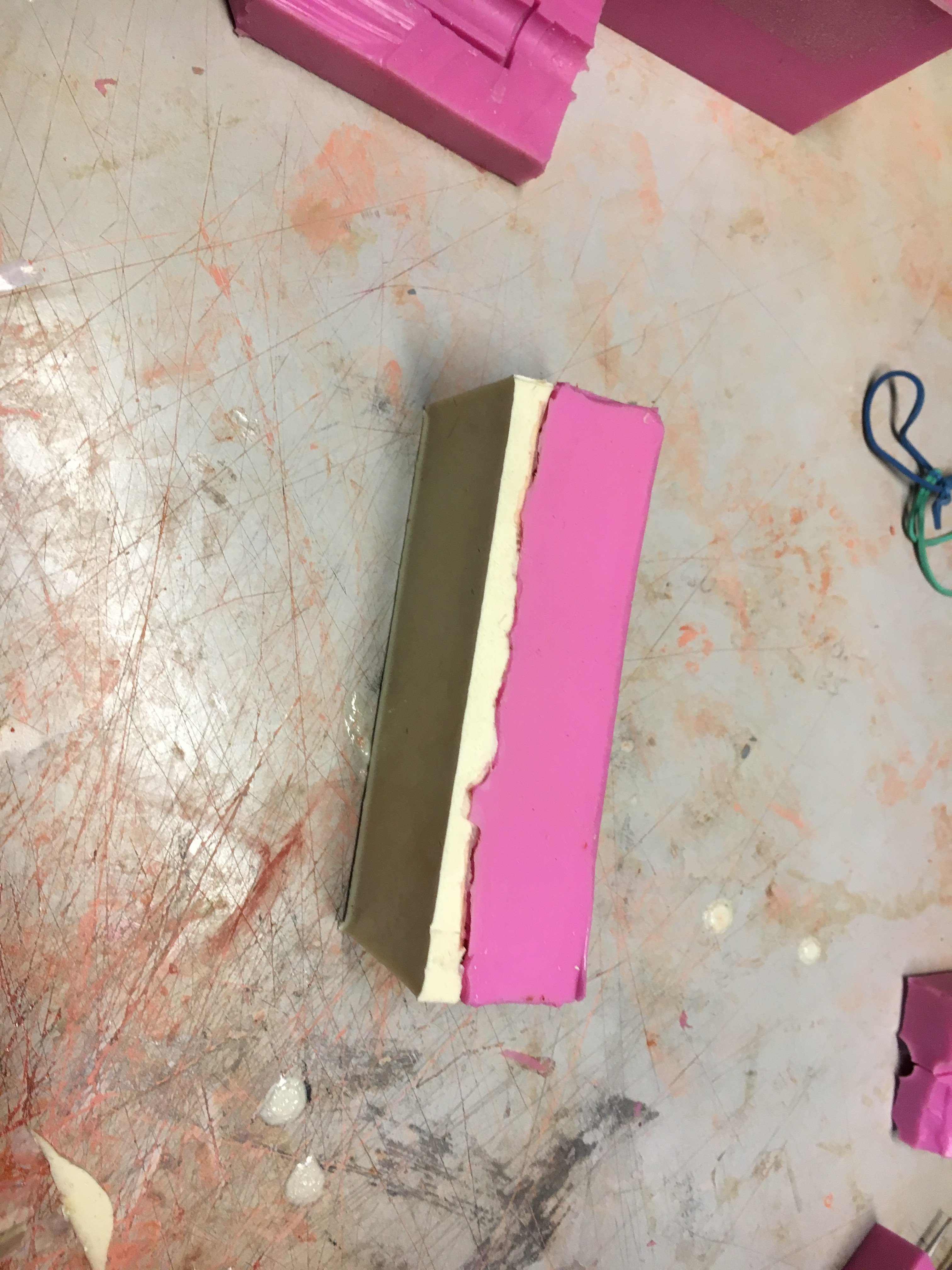

Dam it I ran out of silicon.....:facepalm
I knew it was a mistake to cast square, I looked around for something 'round' a tube of something, but nothing was suitable.
Anyway....not much of an update, I wanted to mold and cast 12 engines because I got the resin for it........frustrating.

Re: X Wing - Big Hasbro - Open Wings
Never fear, the RTV will stick to the original pour when you resume .. as long as using same formula and haven't gotten any mold release contamination on the original pour.
R/ Robert
R/ Robert
Thanks for that, I have researched that as I was worried it would not stick to the old pour, I finally got more silcon so I'll finish up and cast some engines hopefully today.

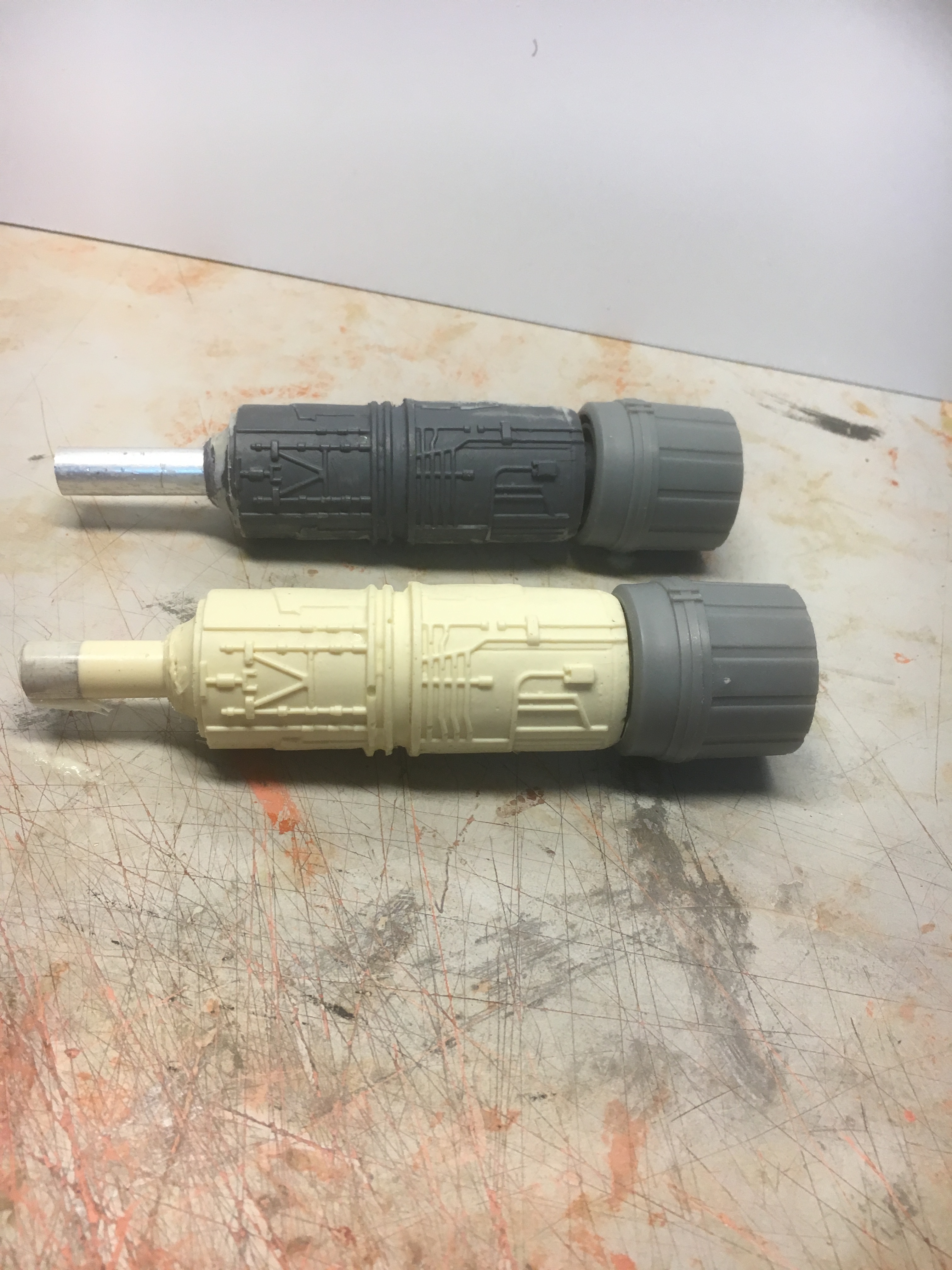

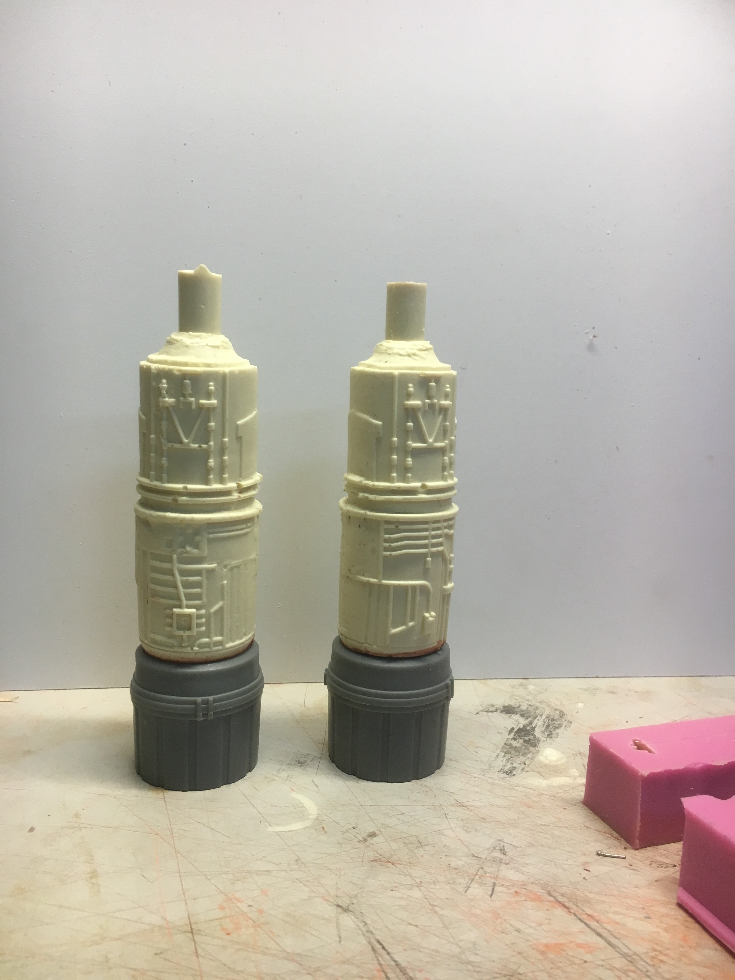

Cast my first engine!!...happy days!!

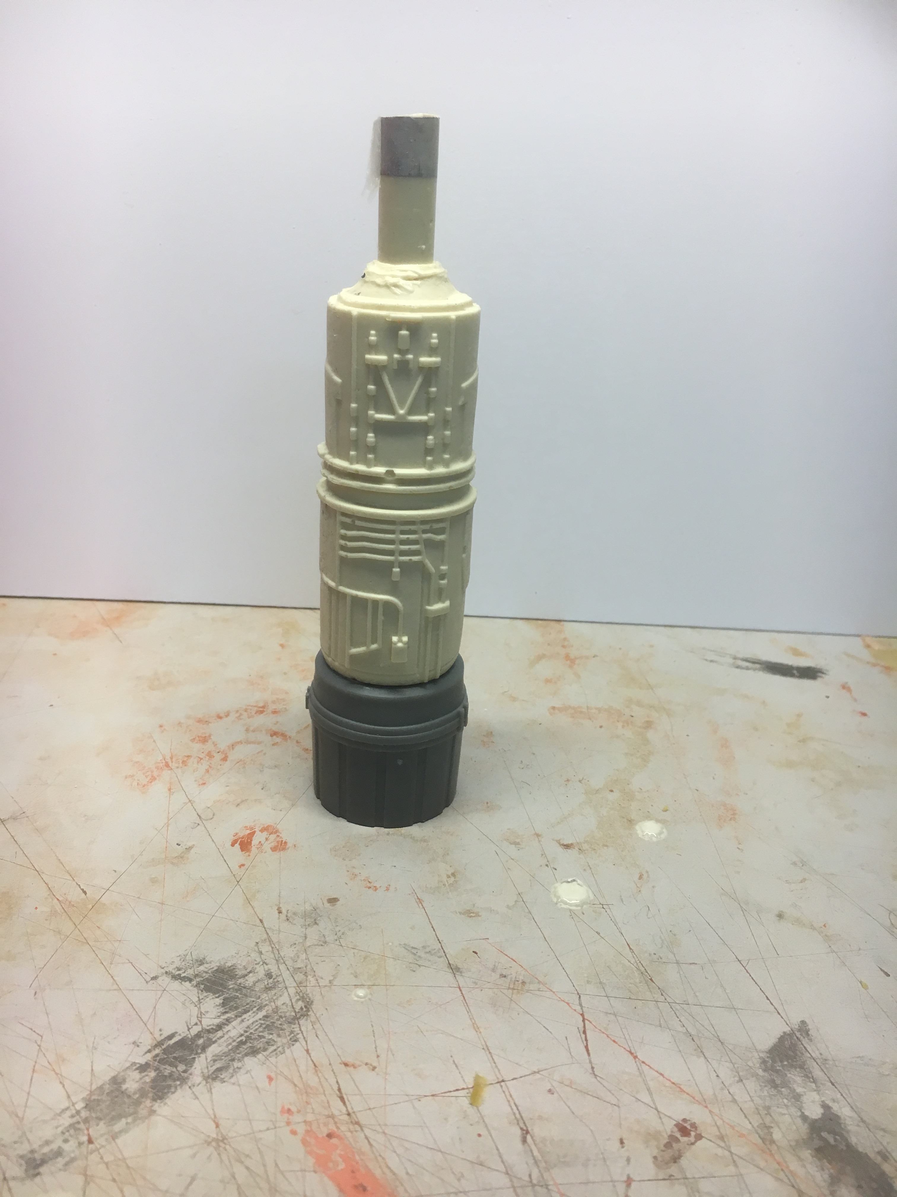

Cast another engine and played around with the internal blank engine that came with the whole bird, added some bits, not accurate I suppose, but look okay to me, so I'm going to cast them and see what they look like.

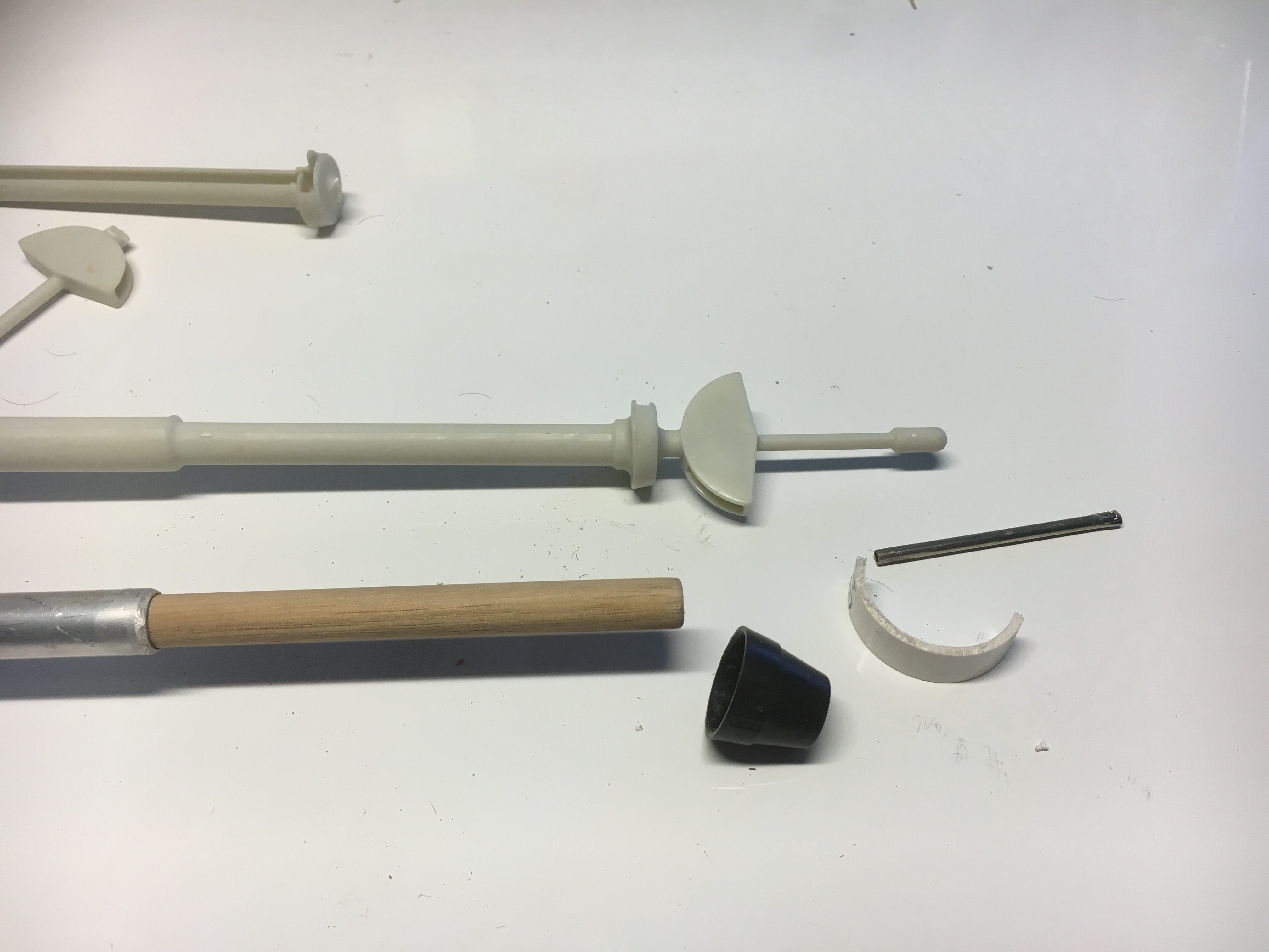

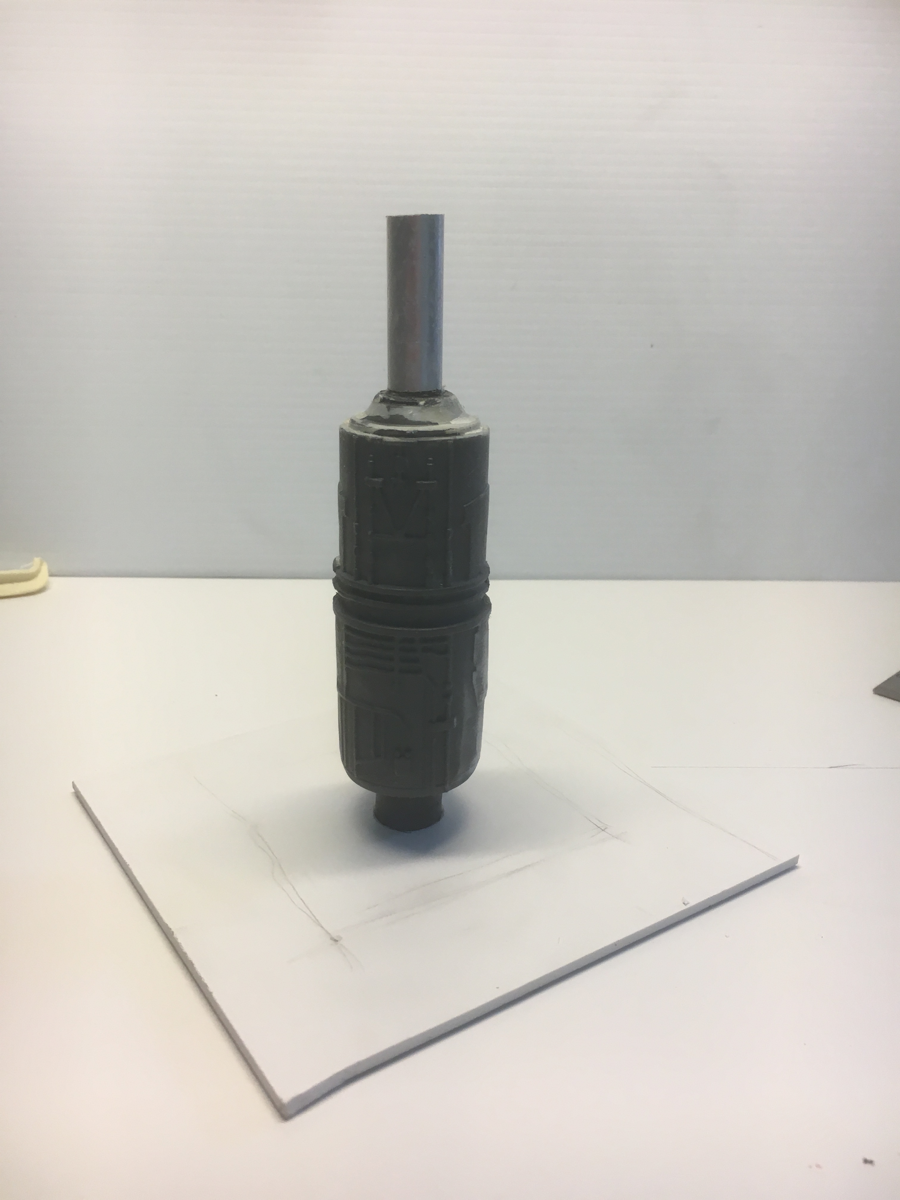

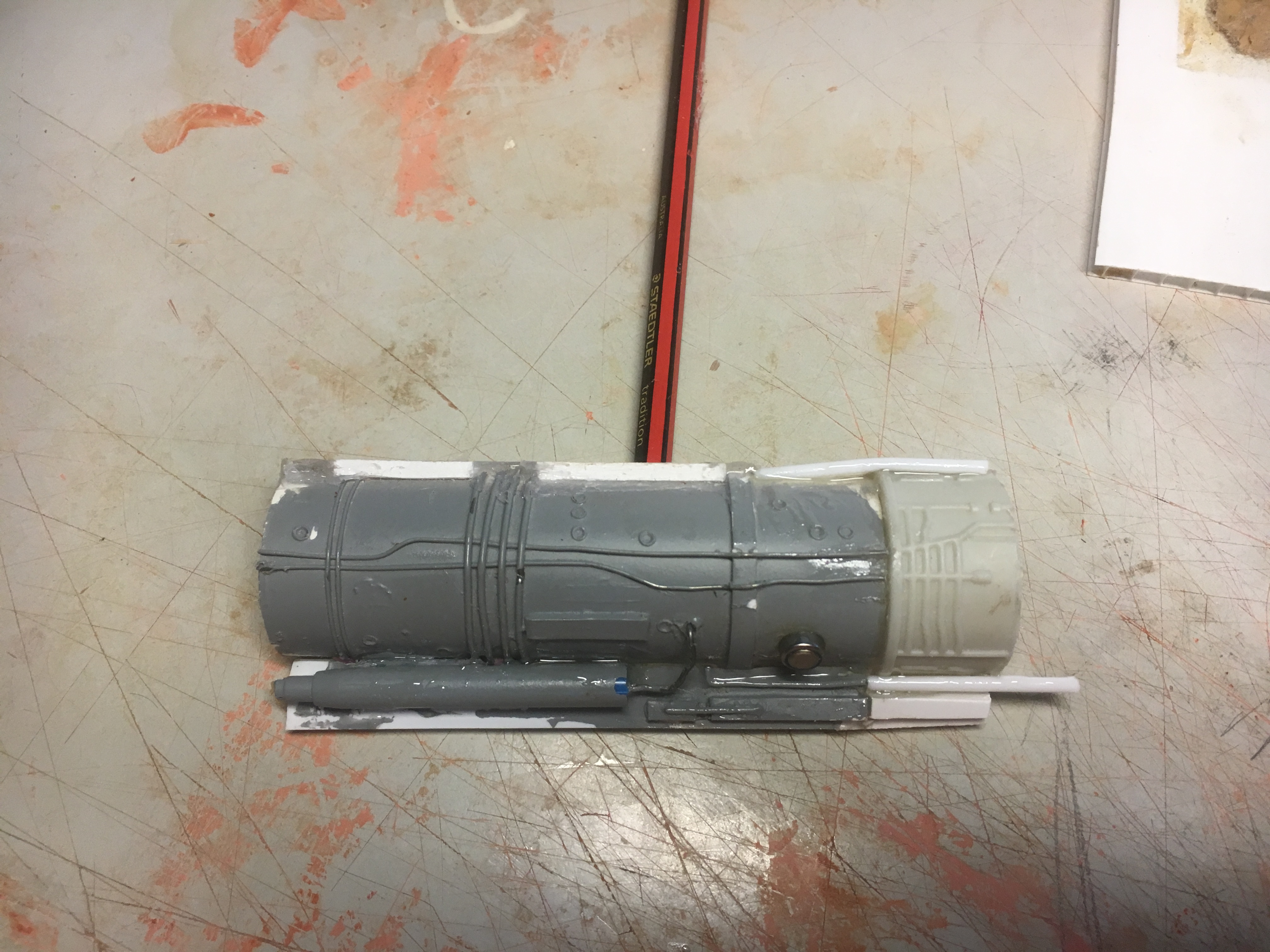

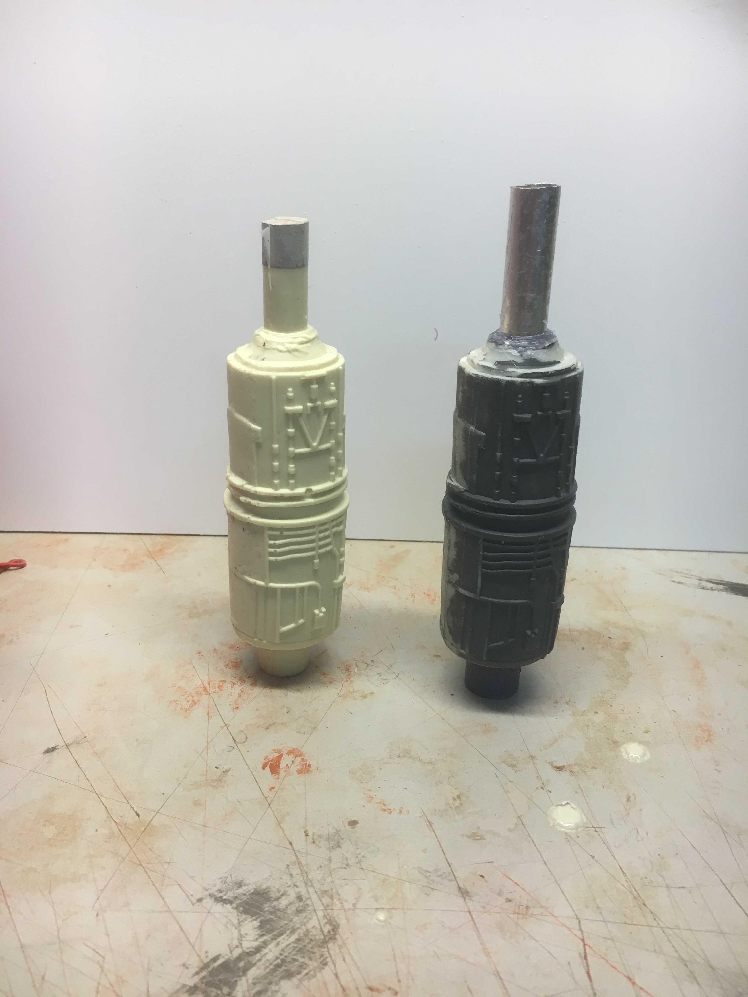

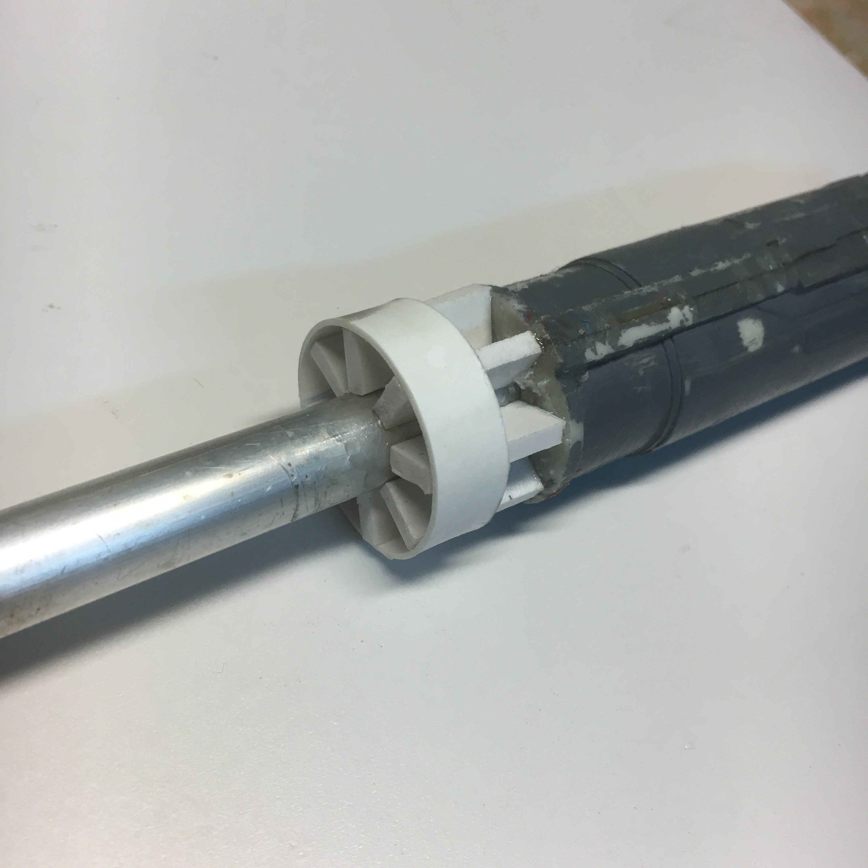

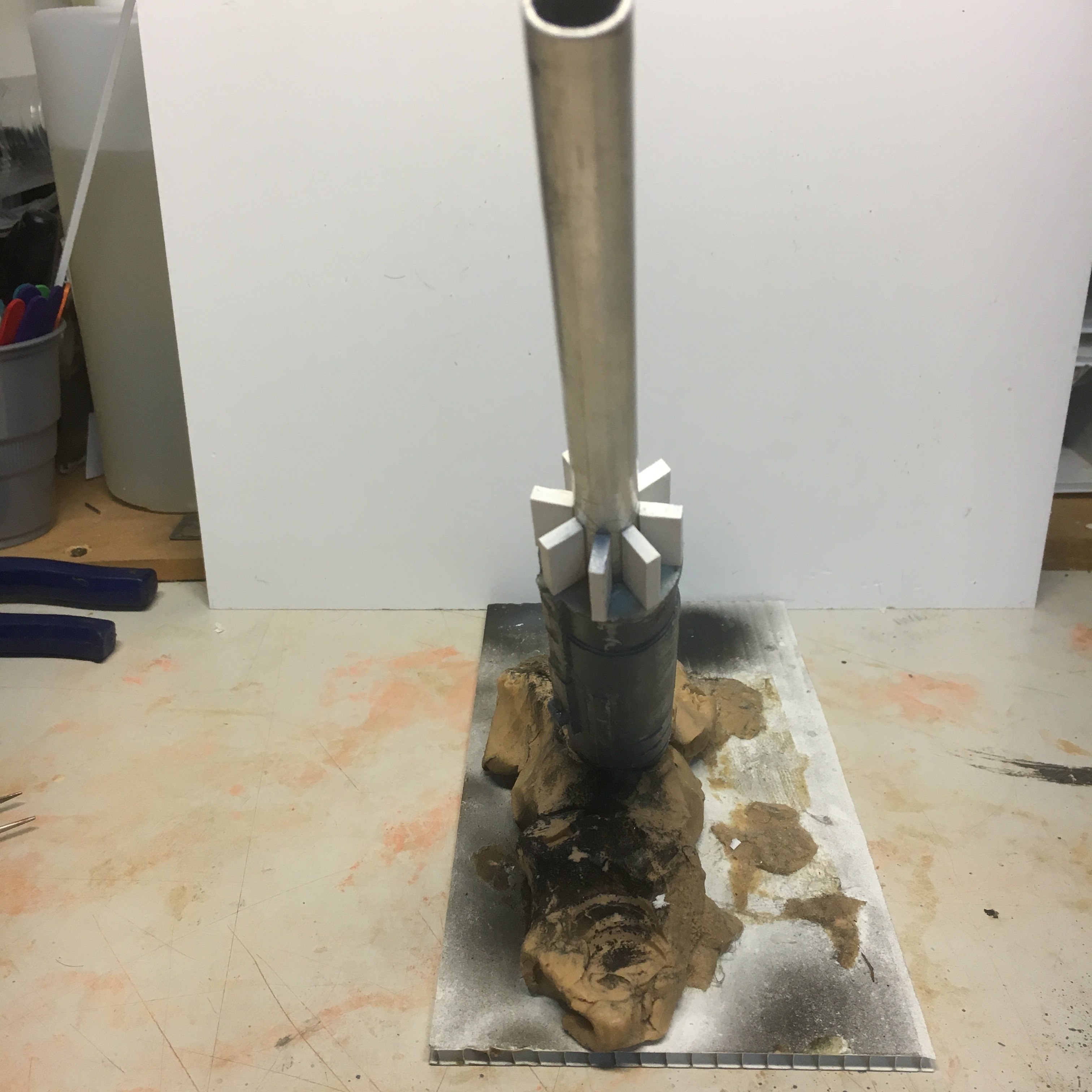

not much of an update, boiling water gets the decals off and thinner washes the glue off, took two cannon bodies and made one complete, for casting, then added the ally tube, the photo makes it look bigger than the plastic one, but its the same diameter, next I'll add the fins and wrap the half of that.

Re: X Wing - Hasbro Hero - With Open Wings & Mods

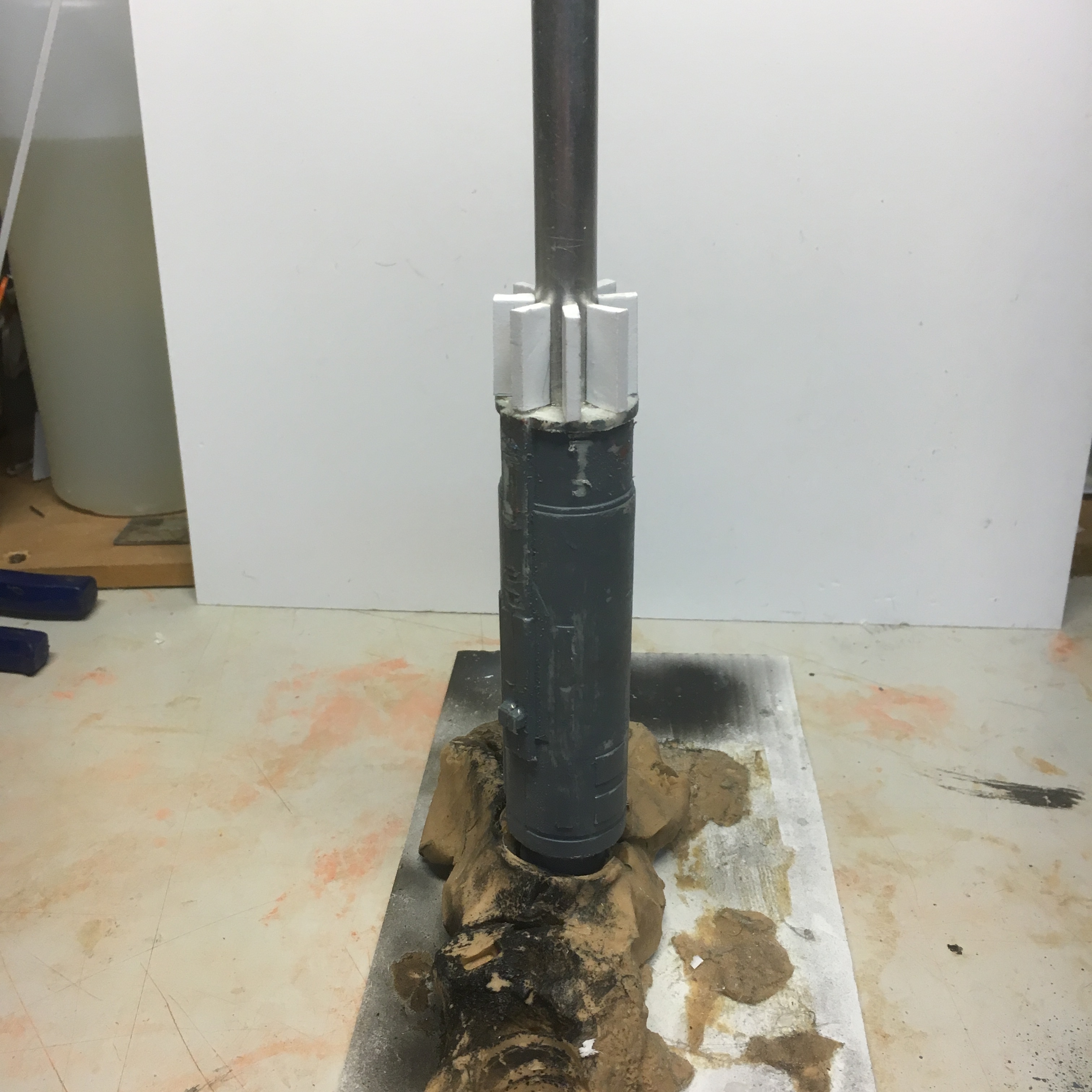

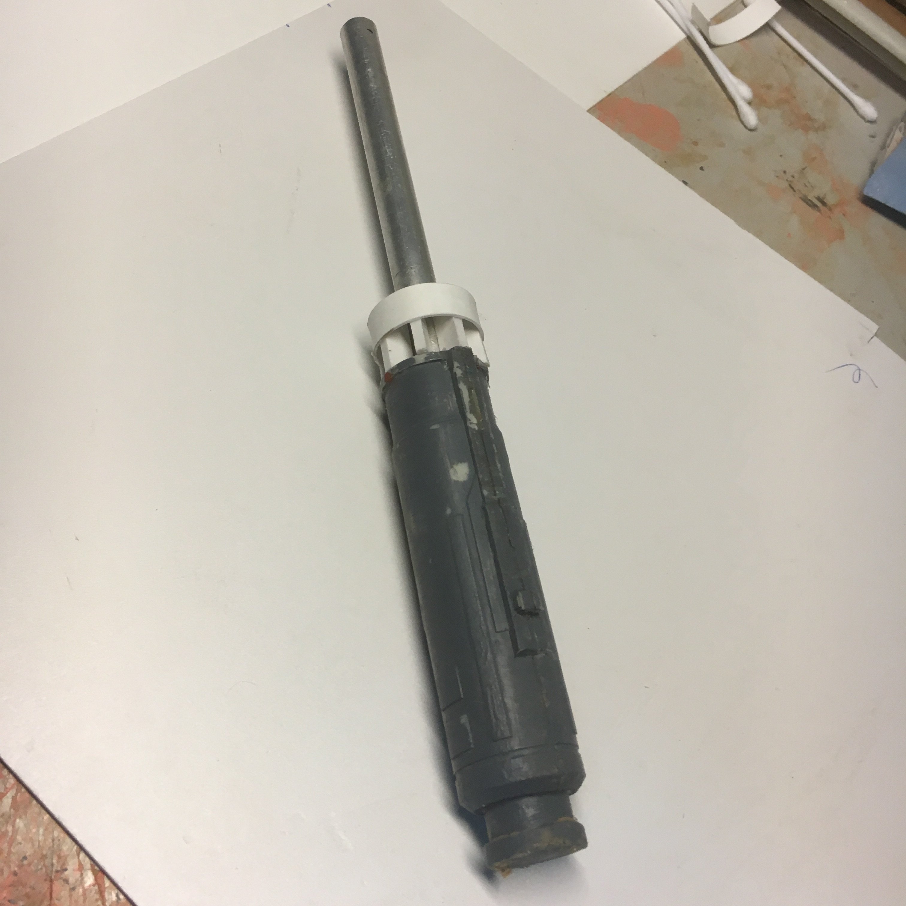

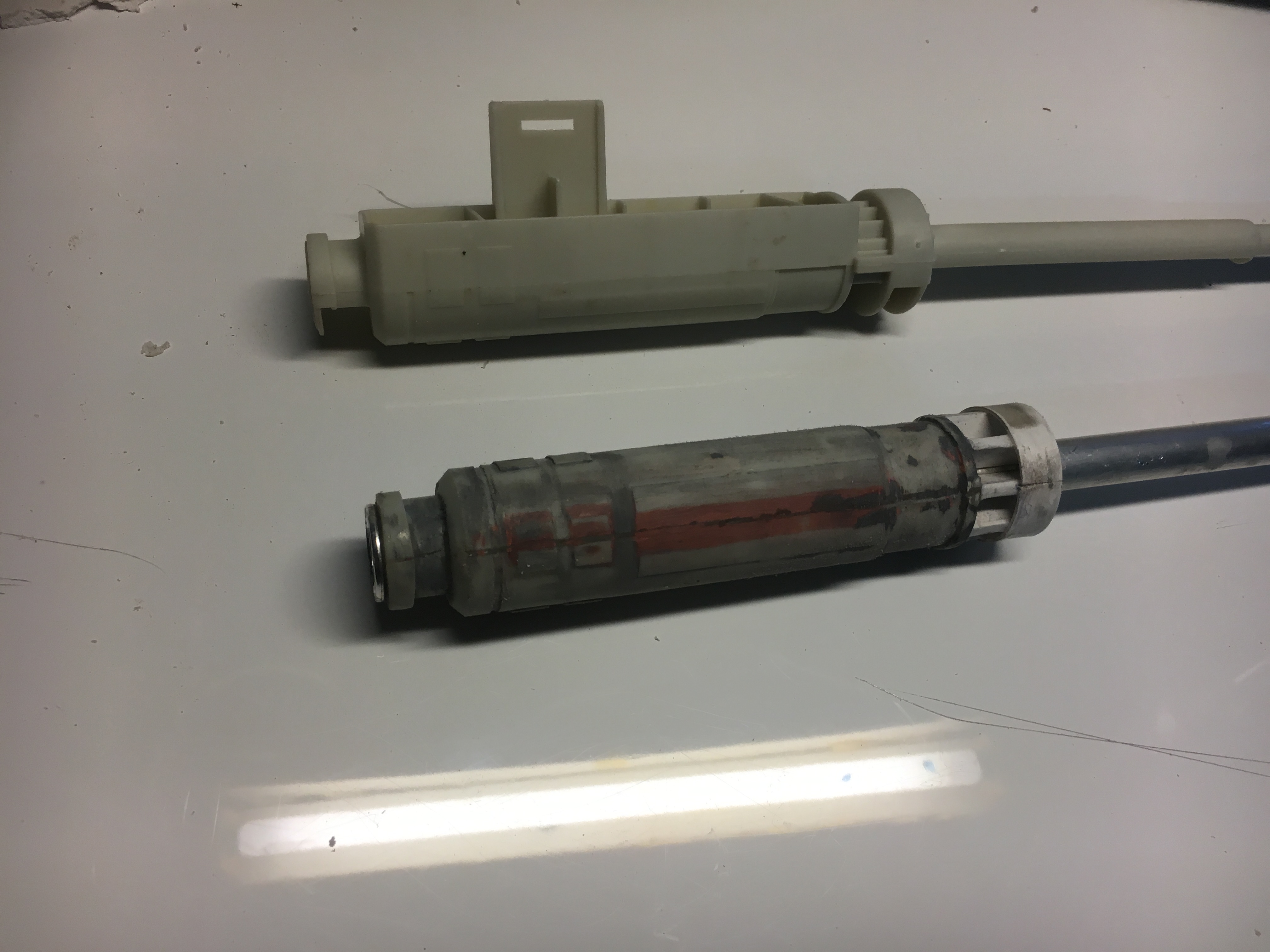

worked a bit more on the cannons, no idea how I will cast them, but I'll give it a go:rolleyes

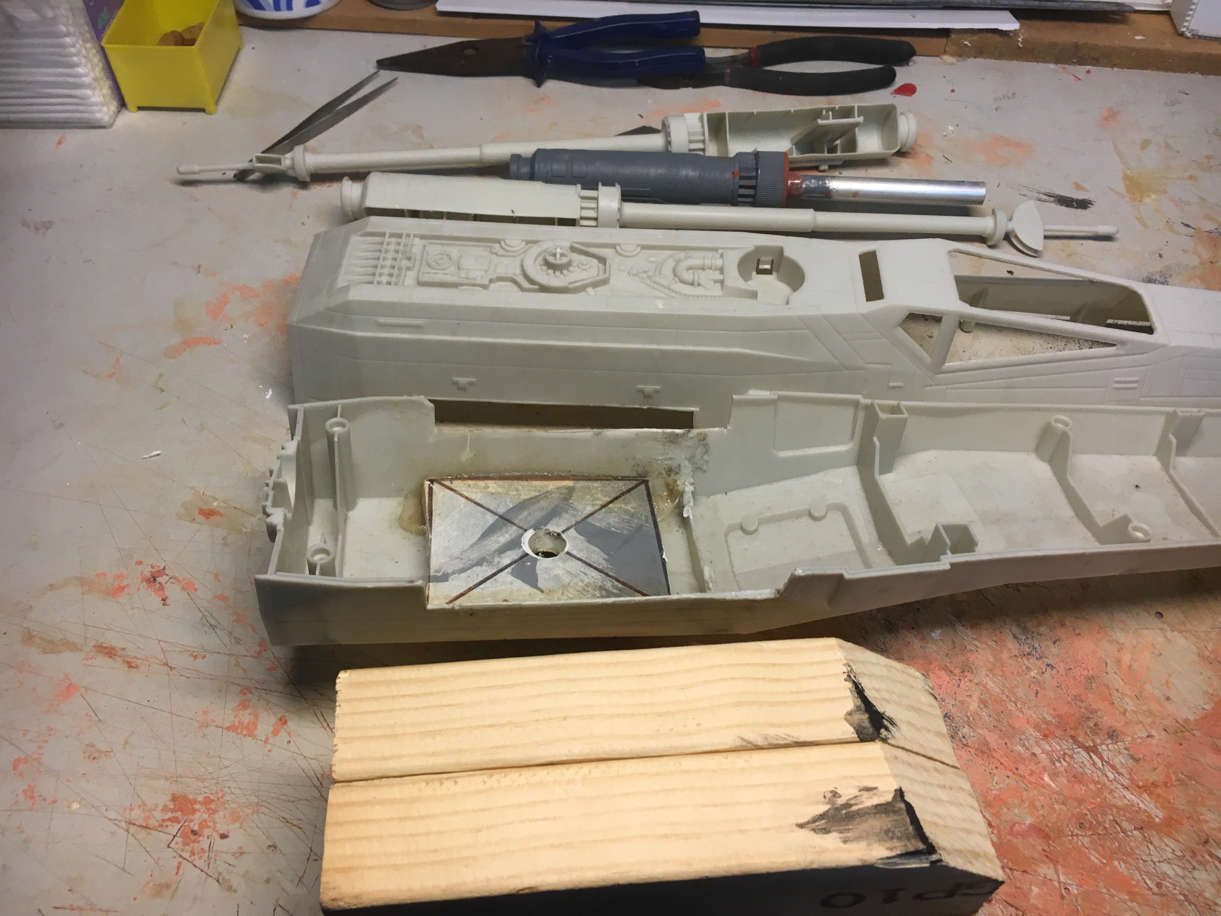

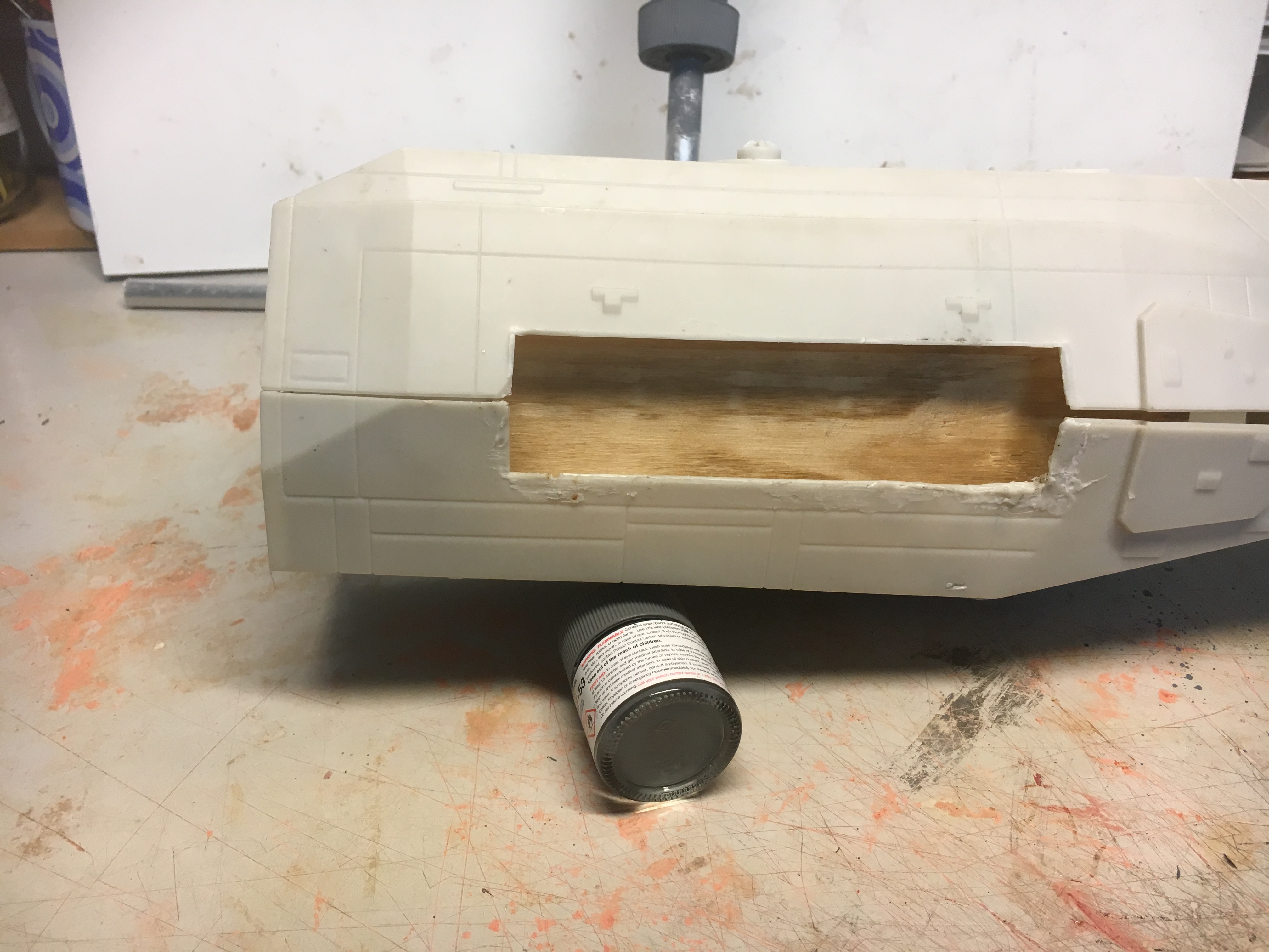

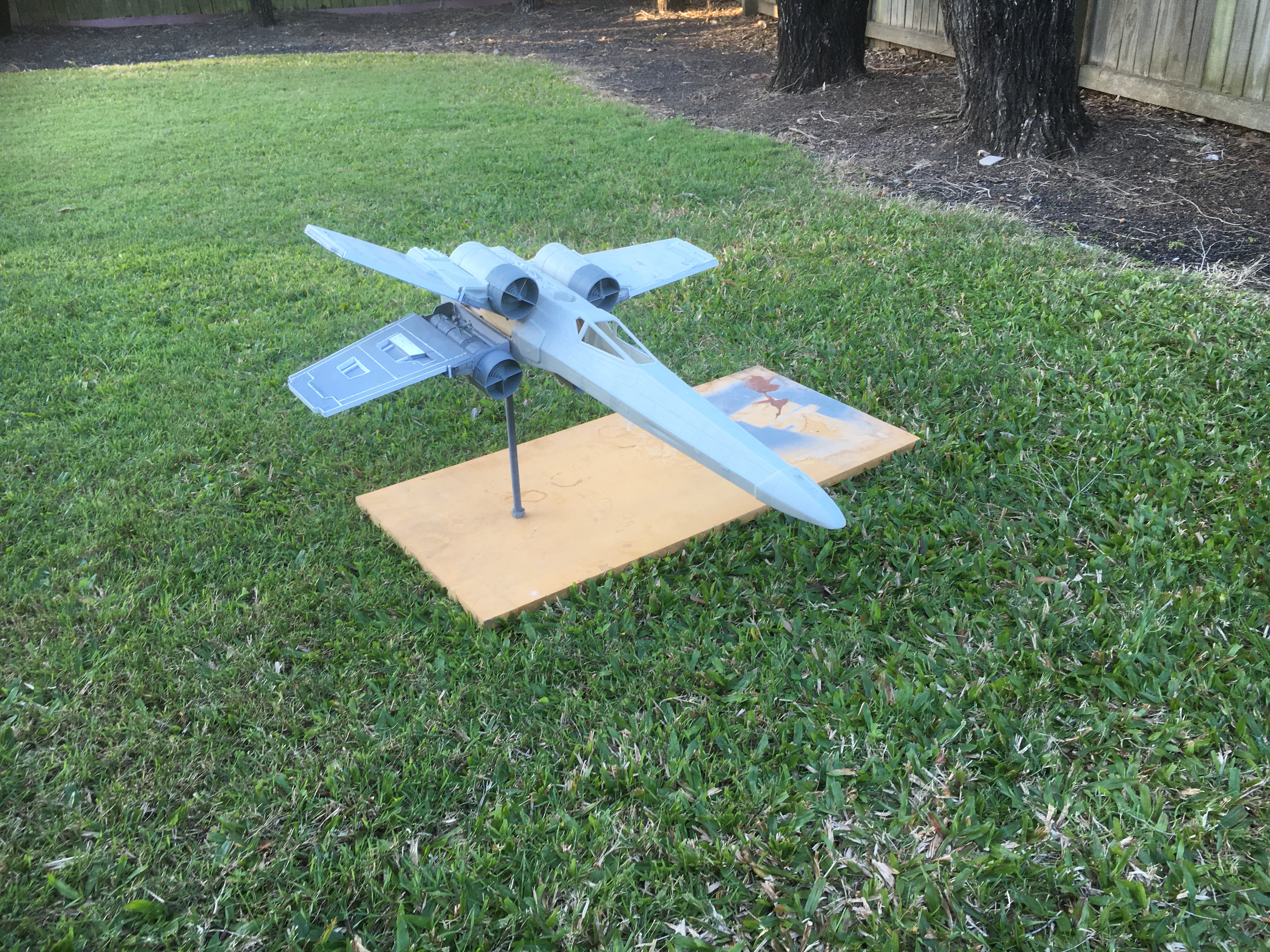

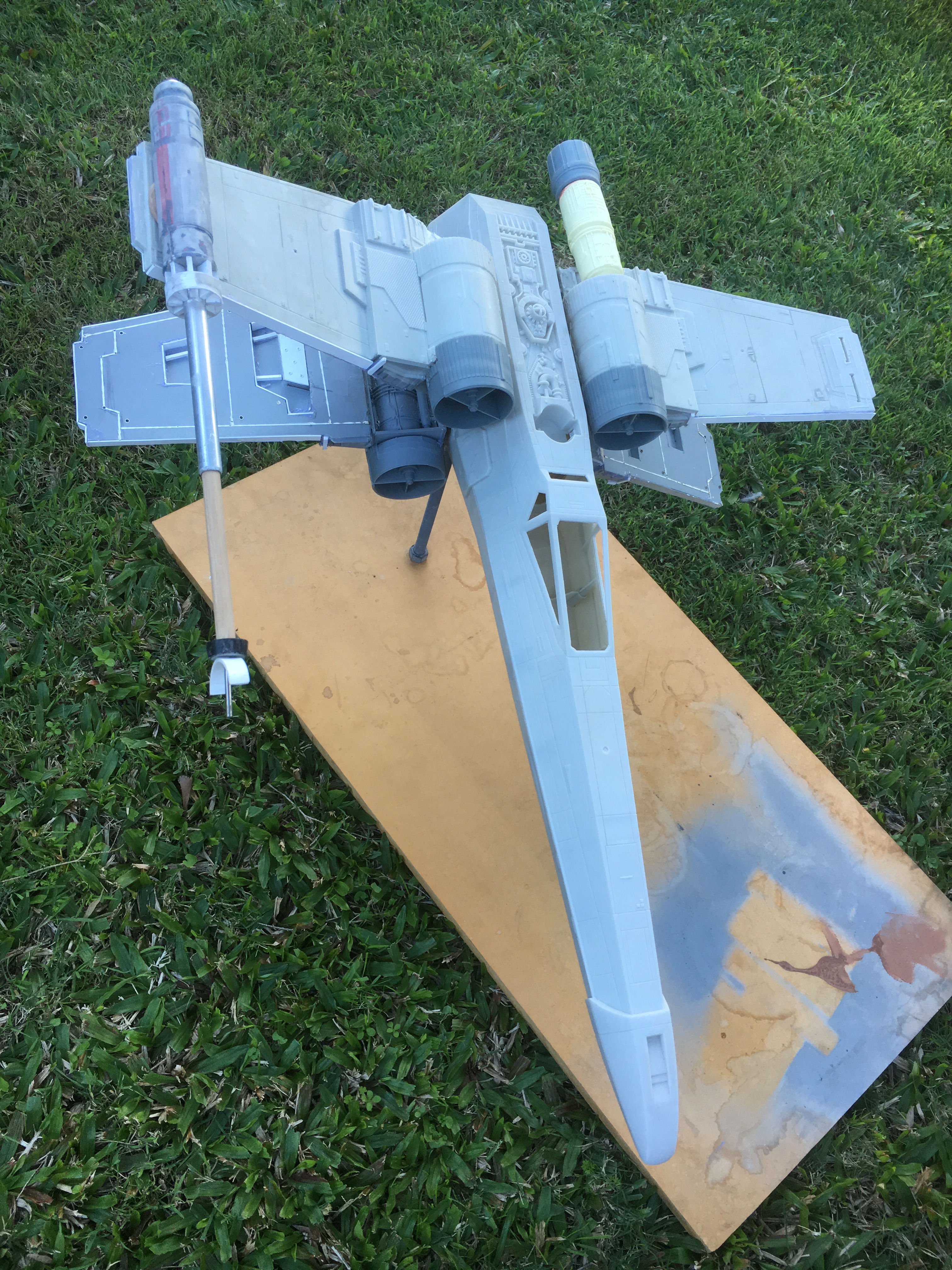

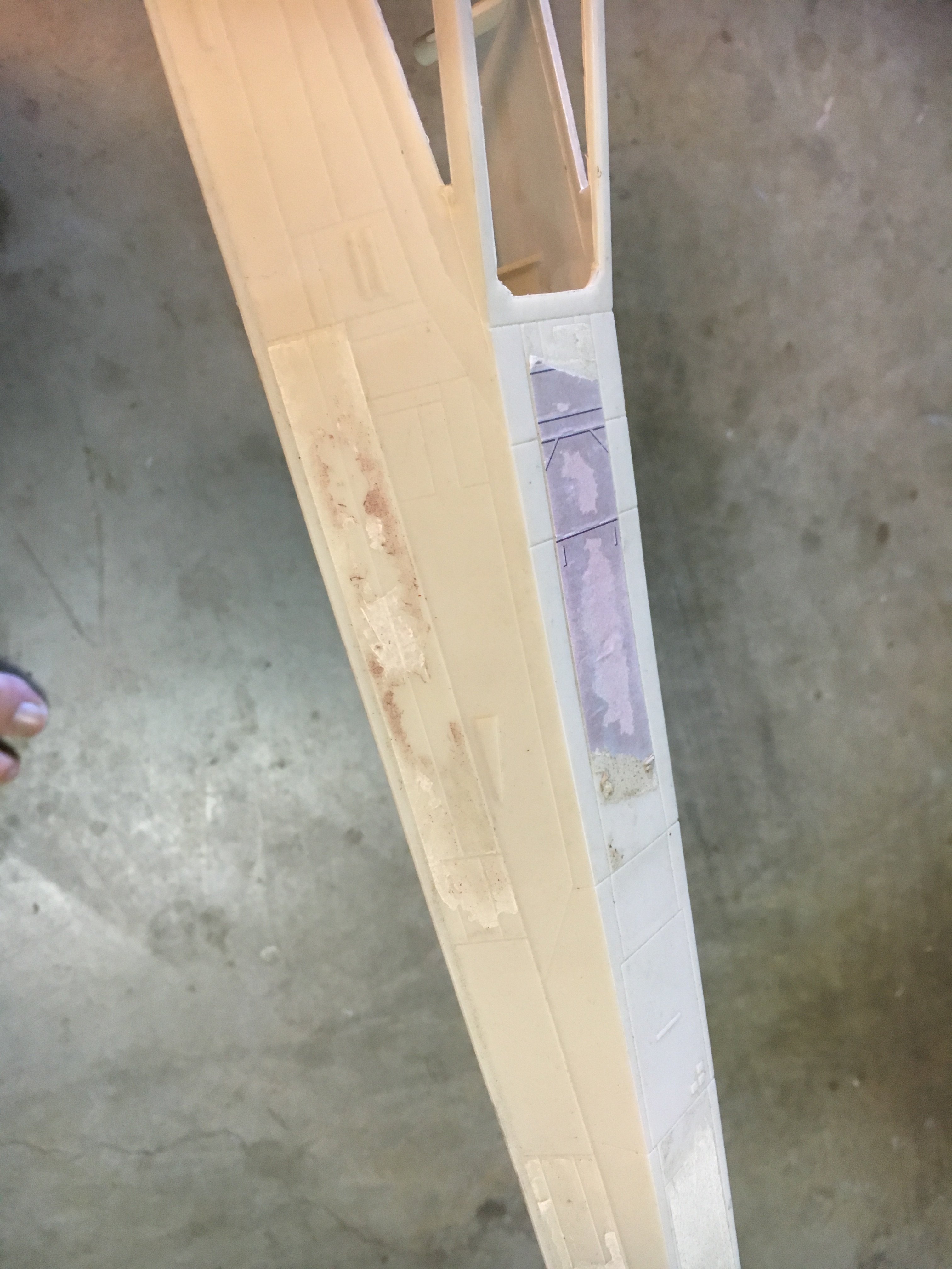

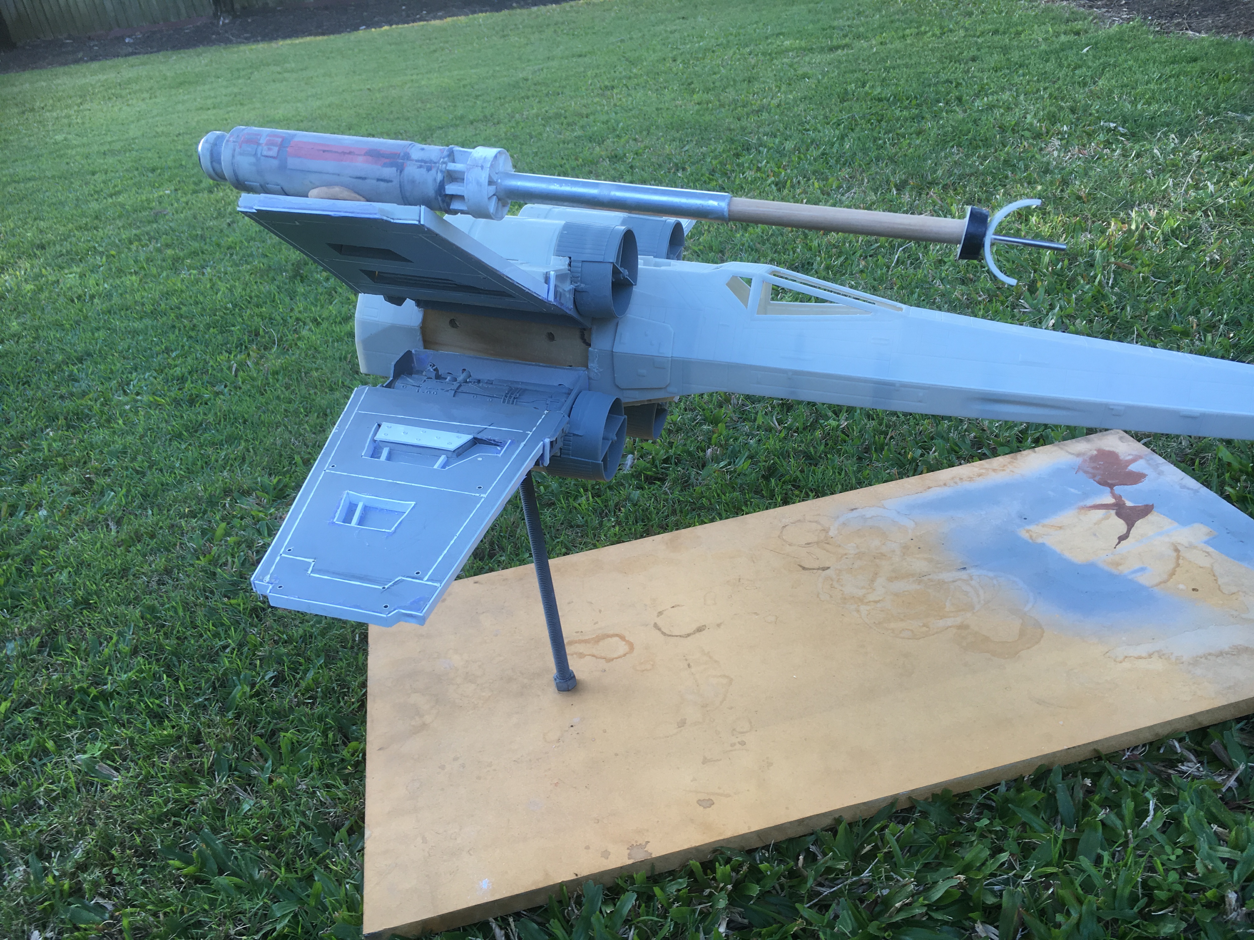

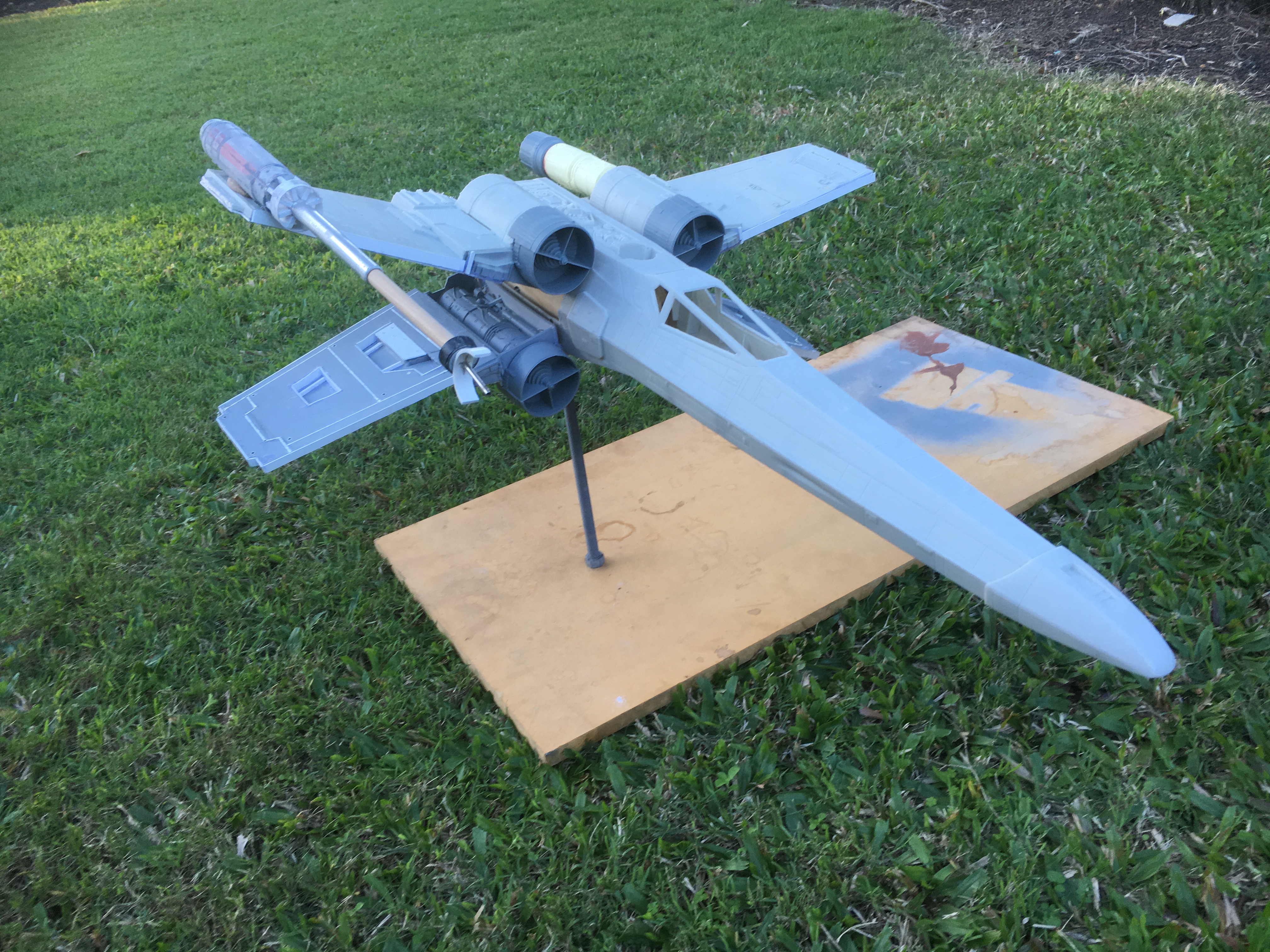

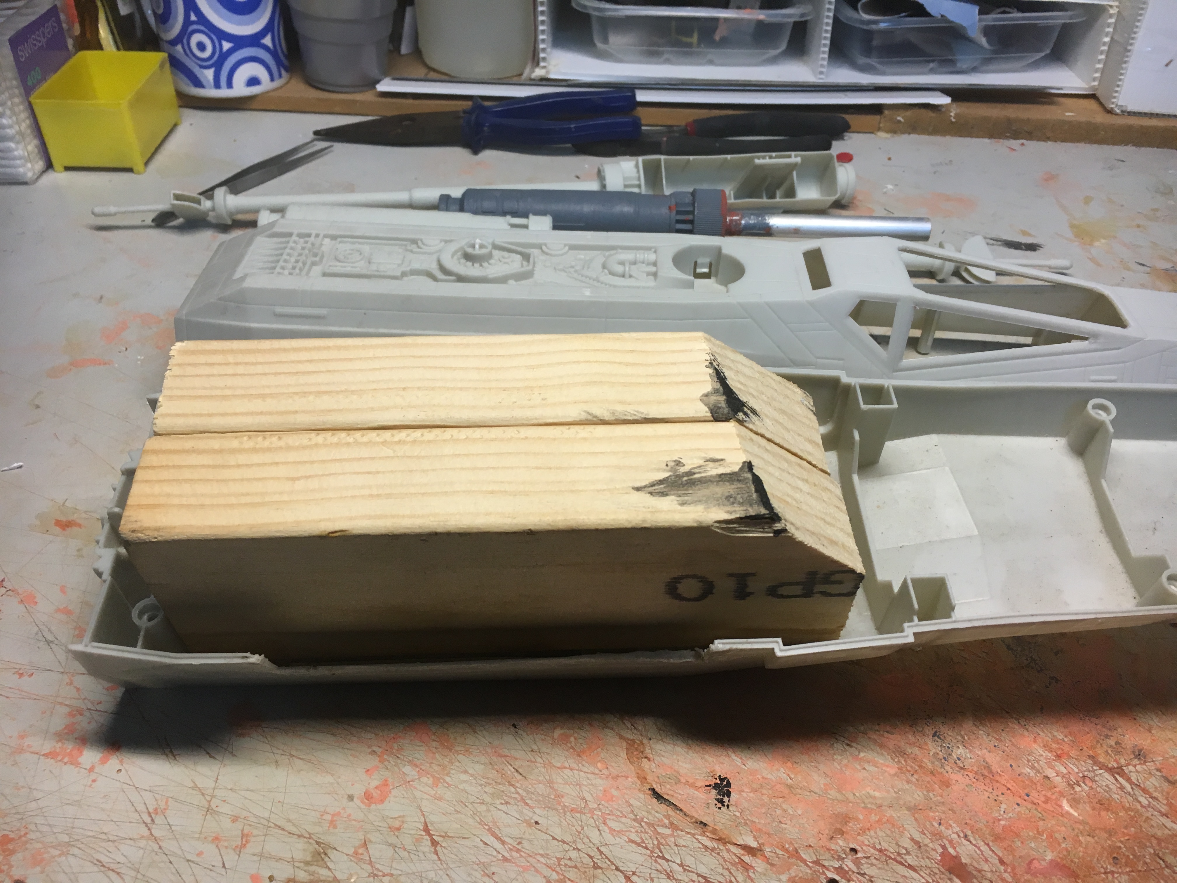

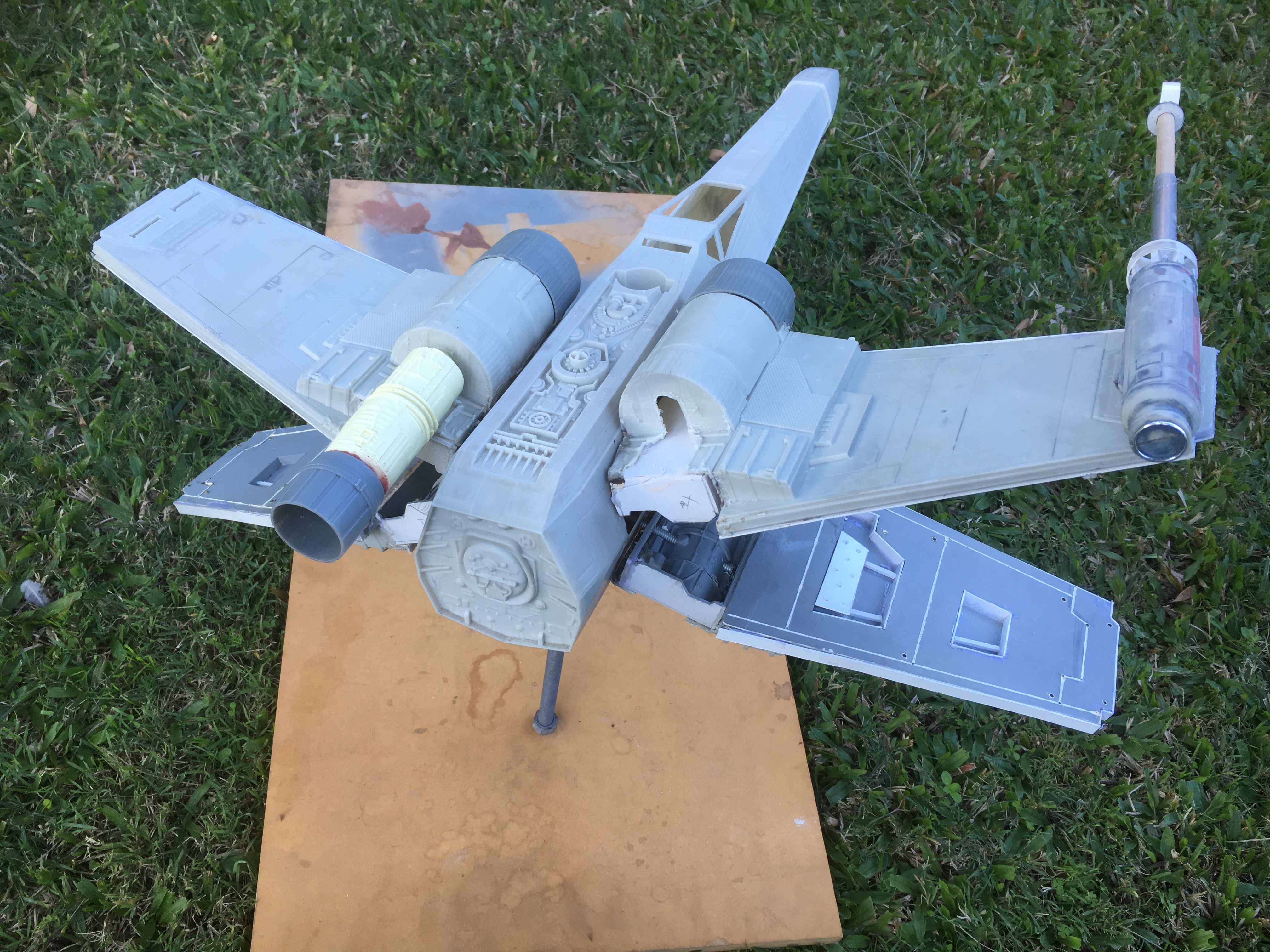

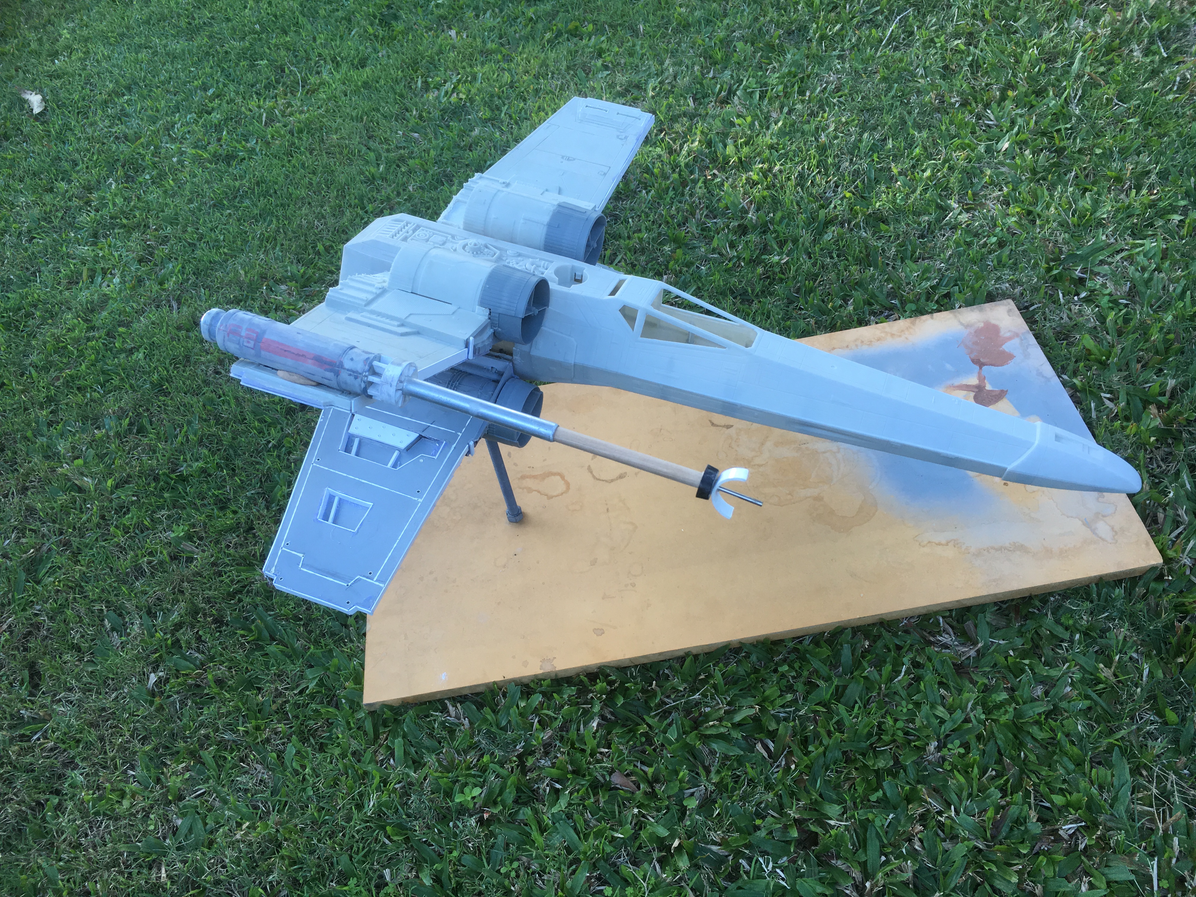

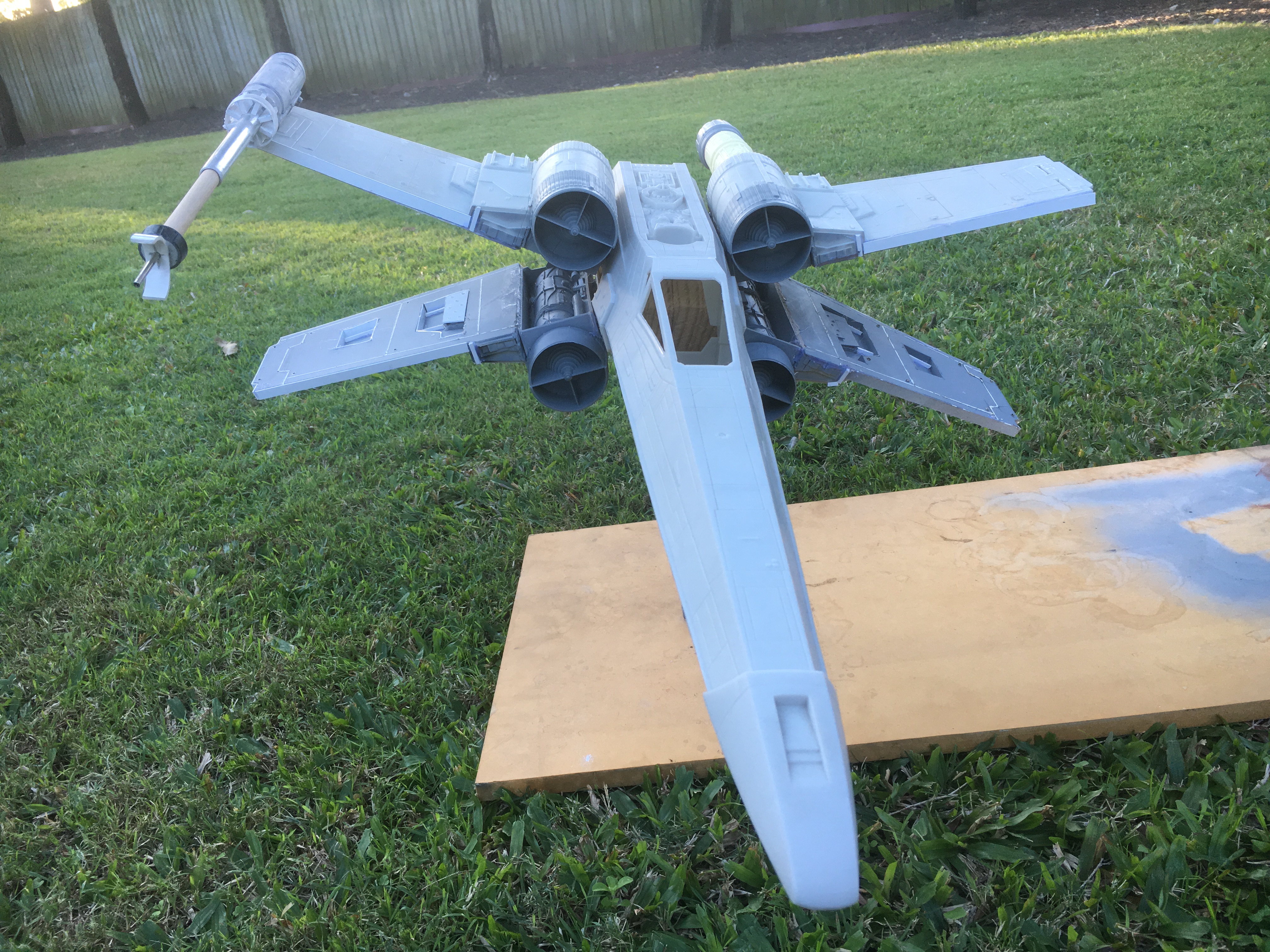

Made the holes for the small drill rod into the wooden internal block and test fit the wings, test fitted a cannon and rear engine, nothing is permanent, just wanted to see what it looked like. Still lots to do, one of the wing internals needs it's walls moved and other stuff. I think I dug myself a hole with the cannon, because I think it may be difficult to cast the way I've built it.:facepalm
I could have been more thorough and detailed by throwing out the entire wings and scratch building a lot more than I did, but I think once finished, painted and weathered it will be good enough for me. The thing I always liked about this was the size, it's pretty big;)
