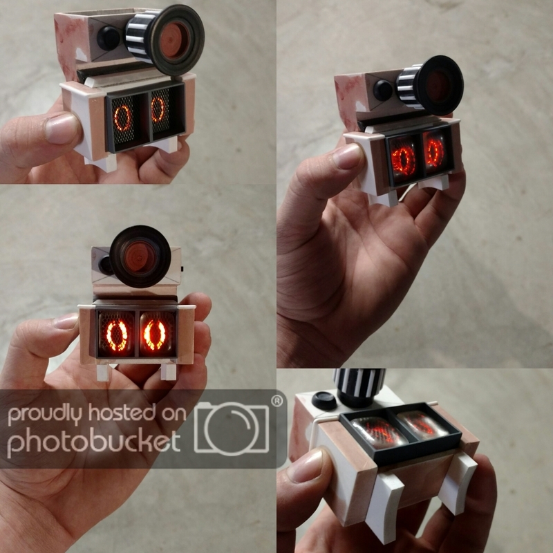

TheAtomicSoul, The nixie tubes start with two orange leds (5mm,30 degree) behind a piece of 1/8" florescent orange acrylic. Glued to the outside facing of the acrylic is a piece of black styrene with the numbers cut out (00 in this case, since that's what the gun sits at unless charging). Then on top of the styrene there is a piece of fine metal mesh, finally covered by two resin cast lenses (about a 1/4" thick).
The picture below shows the work in progress, hope that helps!

@TheAtomicSoul, The nixie tubes start with two orange leds (5mm,30 degree) behind a piece of 1/8" florescent orange acrylic. Glued to the outside facing of the acrylic is a piece of black styrene with the numbers cut out (00 in this case, since that's what the gun sits at unless charging). Then on top of the styrene there is a piece of fine metal mesh, finally covered by two resin cast lenses (about a 1/4" thick).

That is absolutely brilliant and simple. Nixie tubes are getting tricky to source, but you've gotten very close to the look with off-the-shelf parts. Thanks for sharing!
