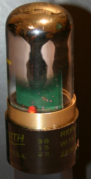

Are the tubes vacuum or nixies? I've messed around with case modding using both. The best vacuum ones have bakelite bases cause they are glued together. You can add an amber LED and an acrylic diffuser. There are several options for a sound board via adafruit or sparkfun depending if you want an arduino involved or not.

The tubes as shown in the trailer are very simple and highly symmetrical. Just a coil of wire up the middle, with a coil of wire in a torus around it. Capped with a small reflector.
I don't think they are a copy of anything off the shelf (That I could find at least). Either they are there just to glow, like the tubes in the original Pip-Boy 2000. Or they could Vue-meter types, that have a glow that travels up/down. I am betting they just glow.
If I were to re-create them: I would take the top off another tube to get the glass. Then build up the inside using magnet wire wrapped around a piece of sanded fiber optic cable. You can then pass light into the end of the fiber optic, and simulate the glow of the wires. At least that is my idea. It would be easy to do at least the center coil this way. Then use other LEDs below to make the rest glow.

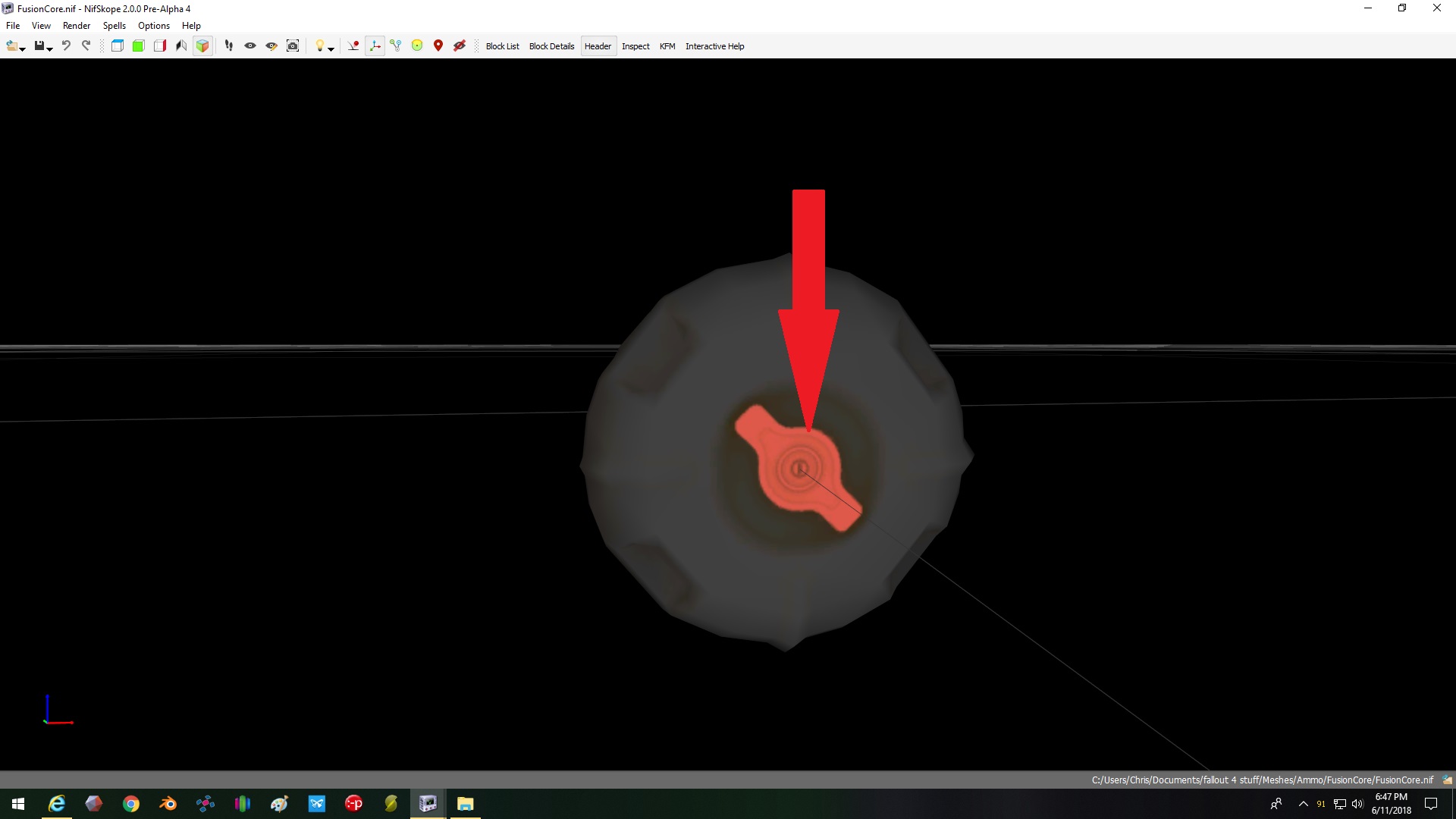

Lilykill's file, however, isn't accurate. I used his file as a base for a run I did, and I had to cut and rotate the bottom 'male end' in the correct position. Also the red switch looking thingy at the top wasn't accurate, I had to model that from scratch. The two main halves also had to be pushed closer together, he had them with some kind of space in between and they aren't like that in the game renders. Sadly, we can't see the red piece on the official one either, for comparison.

Thanks for the tips GhostMinion. I also feel that Lillykill's version may be a tad undersize as the one I printed with no scale changes from the files seems smaller than other versions and indeed when compared to screenshots. Not a problem when printing your own as I did, just I figured if I get an "official" version for scaling I can print some more if I want. I actually used someone else's version for the red switch piece as well.

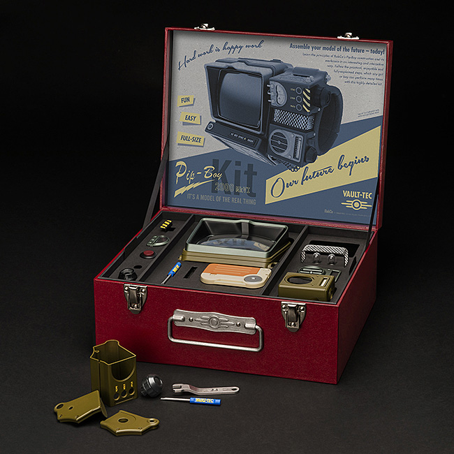

If you take a look at the Wand Companies web site they are the people who are building the Pipboy 2000 Mk Vi for Bethesda and thinkgeek but on the page for the Pipboy (https://www.thewandcompany.com/pip-boy-kit/) they show a diagram of how the screen goes together, hope this helps.

Thank you for posting that link! Finally, we get a bigger, more close up view of these pictures. The Bethesda Store site doesn't expand the pictures.
I see the power button is red and opaque like the Stat/Item/Data buttons. That sucks. Gonna need to make a new orange/translucent one to make it light up. Nice to see that we don't have to worry about the other buttons lighting up, though. Looks like all the others are an opaque red color.

The fact that the screen assembly is made of so many parts gives me some hope. (I have both the Pip-Boy and Power Armor on order anyways)
I re-watched the trailer, and the right-most buttons are not illuminated anyways. The leftmost button is amber in-game. If that button is thin enough, you might be able to illuminate it with a bright yellow LED. It depends on if they used red plastic, or painted some black plastic.
