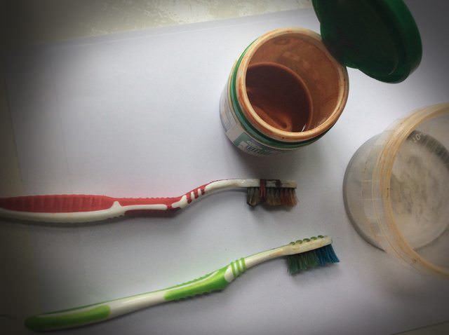

Back on Page 27 l did tests of the 'splatter' effect, after long thought and as mine nears it's near completion.
l decided added just a slight touch of it (call it a happy medium).
lf your going down this path do tests as lve shown and clear the toothbrush lots of paint before flickin :).
Below: Matt Black and Matt Orange 85 Humbrol enamels mixed with white spirit thinner.
Subtle:

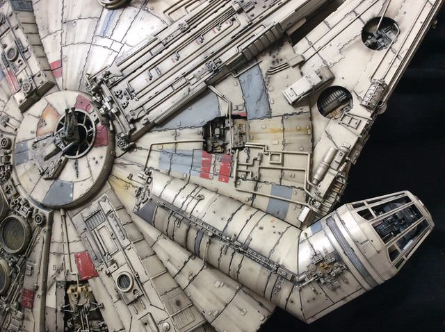

Hi Darkview, your Falcon is coming together nicely. Can I ask what color you used for the red and grey panels?
Sent from my SM-N910V using Tapatalk
Re: FALCON 32" hunk of junk build
Here's where I'm at in the build. Its much darker than what this pic is showing.
Coming together nicely, red looks a spot on base red, I used Humbrol matt 153 Red... Not to bright & not to dark. I then masked them and added weathering/Dremel scratches etc.. think page 2 & 5 somewhere mention it. I used the TAMIYA weathering kits over the masked dried red patched areas, you can tone it to the studio references etc.
Thanks, yeah I'm going to tone the red down. What about your grey?
I used Humbrol Matt grey mixed with a tad Matt white if to dark but Tamiya neutral Grey is as good as any...go with what you eye sees is best while checking studio references, as lve said in the past it's the lighting on the original that can deceive so get as many cross references of the original as possible and get a happy medium.
