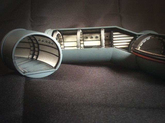

None as yet, but l only added real small dabs of Acrylic for rust effect it's mainly the Tamiya weathering powder.
Just to show how wonderful darkview's techniques work i'd like to show my falcon again
i really appreciate your techniques and only of this my falcon is getting better i ever imagined.
Thanks you so much for sharing your know how with us

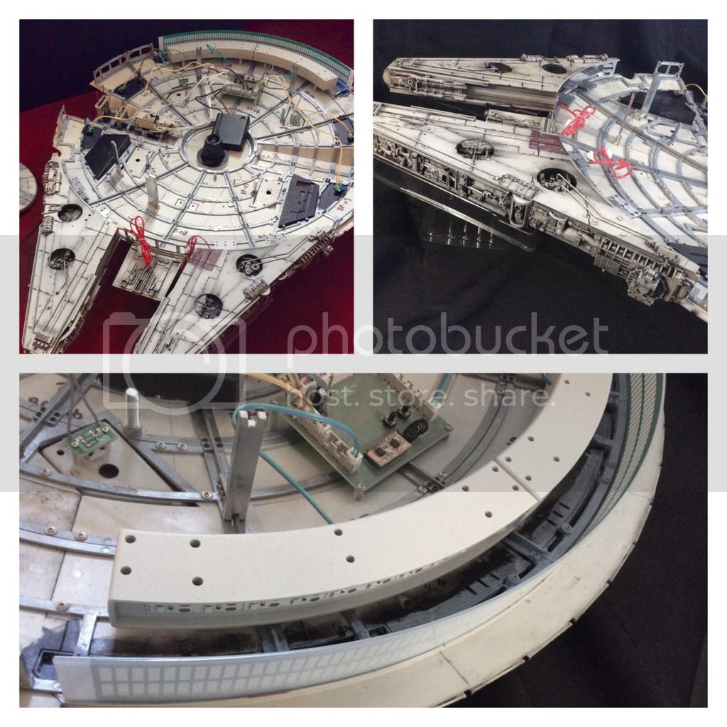

TIPS: To remember.

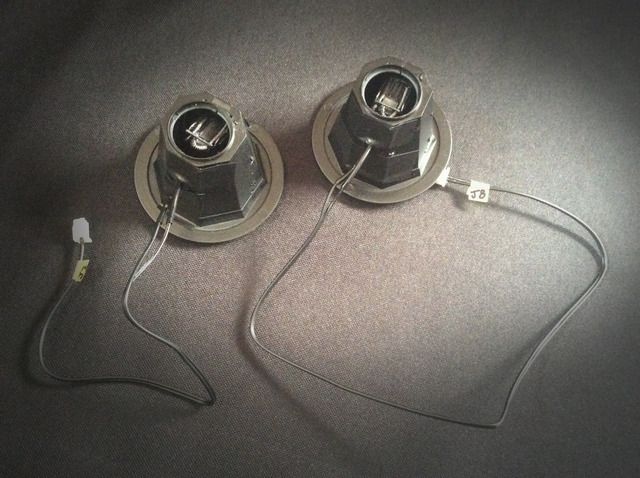

1. The gun turret wells are identical bar the L.E.D. wires, ones long than the other....
J7(shorter) for the bottom of the Falcon.
J8 (longer) for the Top. Presumably due to we lift the top gun turret off to get to display cabin.

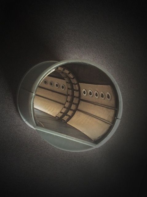

2. Also l've joined & painted/taped turret wells outer shell to make sure of no light leak using quality black electrically tape.
The engine bay light will help by being painted Black on the base with only a tad of dark blue. (bottom pic).
Because the light you see from the Sub Light Engines were mostly pure White in ESB in scenes, never mind SW.
l reckon due to Blue Screening effects of the time you see a light or blue light from time to time!.
Jordan , noticed on your post above that the recessed pits are painted black? , is there any reason for that , you planning to put some lighting in there ? Also , have you come to a decision re; the hold floor ? . Anyhoo, , you're still going great guns . Please keep posting and sharing .
Thanks Gedmac,
It's painted black to insure lights blocked on the outer hull, but I added a tad blue/dark blue to reflect in the light engines when on... stay tuned for other developments like the flooring!.

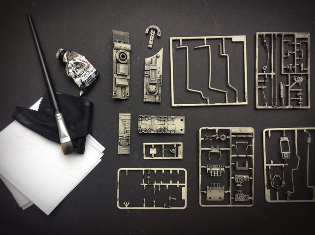

One question I did have. I see you weather the greeblies and pipes while still in the sprues, which is a great idea rather than manhandling these fiddly bits one by one.
Do you have any issue when gluing that they don't stick with the oils on the surface ? Or do you leave the gluing points free of paint/or clean them well ?

Thanks a lot....hope it helps loads....To answer your questions l oil paint on the spurs (same old methods in this thread) if theirs lots to do.... then when I cut/sand them off I superglue then on with ZAP-A-GAP Meduin CA+ It's bloody evil & quite permanent ;-). I do make sure that the glueing ends are sanded and clean 1st.... but do glue what you can down first if is a bigger part that connects well etc...
also the area l cut (that's showing the cuts) I sand/cover with either more oils or Tamiya weathering once smooth.

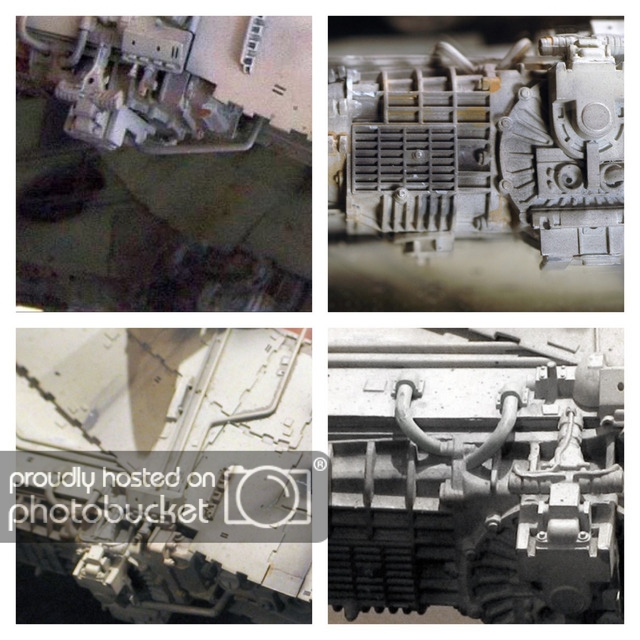

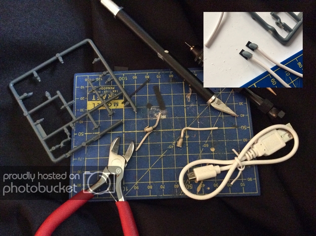

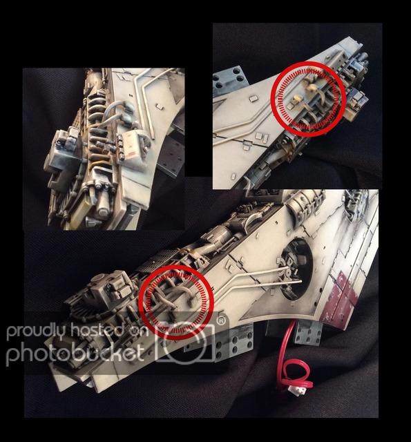

Still waiting for shipments so started to add the 2 pipes that l'm reliably told are missing from the build on the PORT mandibles.
l just used the round ended corners from the runners from issue 40 and short bendy wrap fasteners from a gadget for the pipes
then painted with enamel mix to match the rest and weathered... also cut some thin black plastic card I had in my toolbox.
Turned out ok and all free! It's not exact but little is if you study the ultra details.
Below some studio shots l used for ref:
The parts were kitbashed originally and spotted byJunk Pilot from a Tamiya's 1/35 Sd.Kfz 222. model. Check out Ktaylor thread for insanely good details from kitbashing.

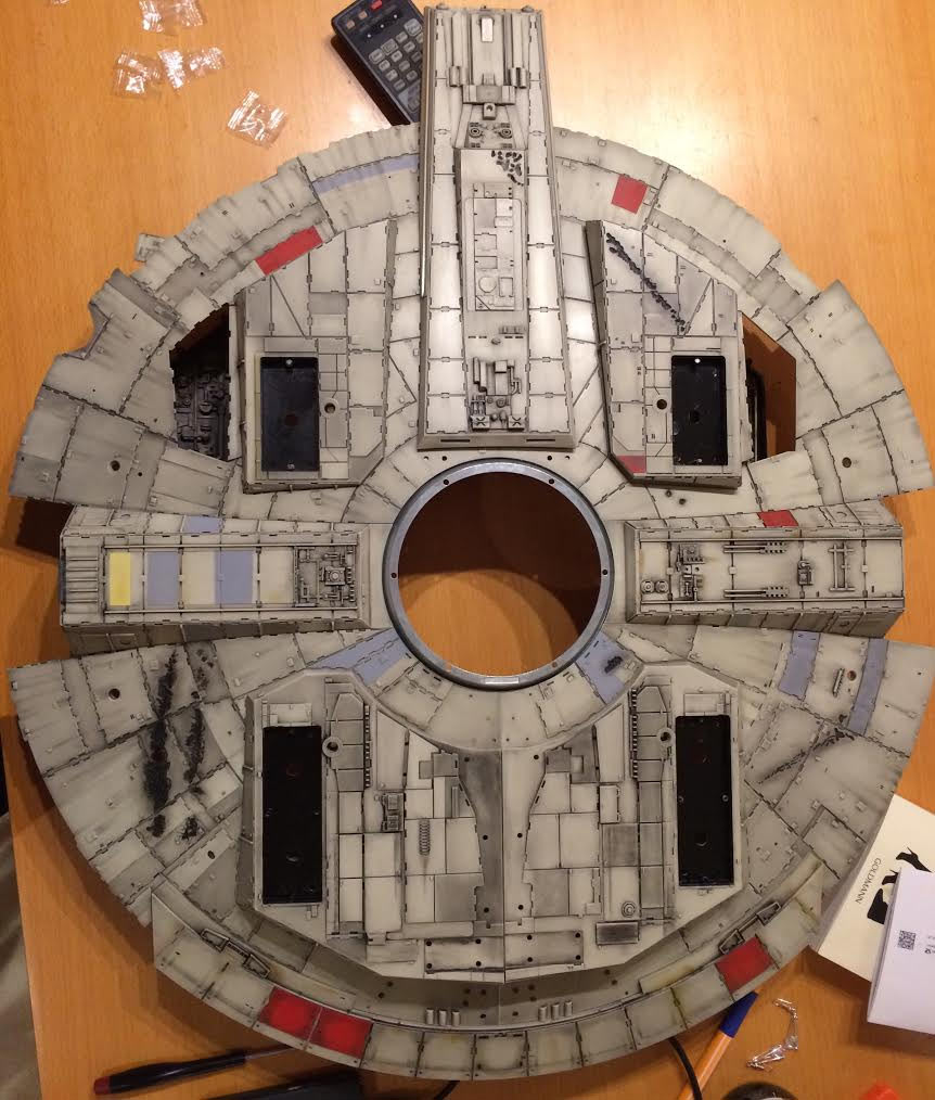

My day off somewhat so spent it 1st weathering level of greebies for later. Took about an hour or so.
l'm at 93 but getting these done will help more defining detailing later... it's the same methods I've used throughout the thread...
