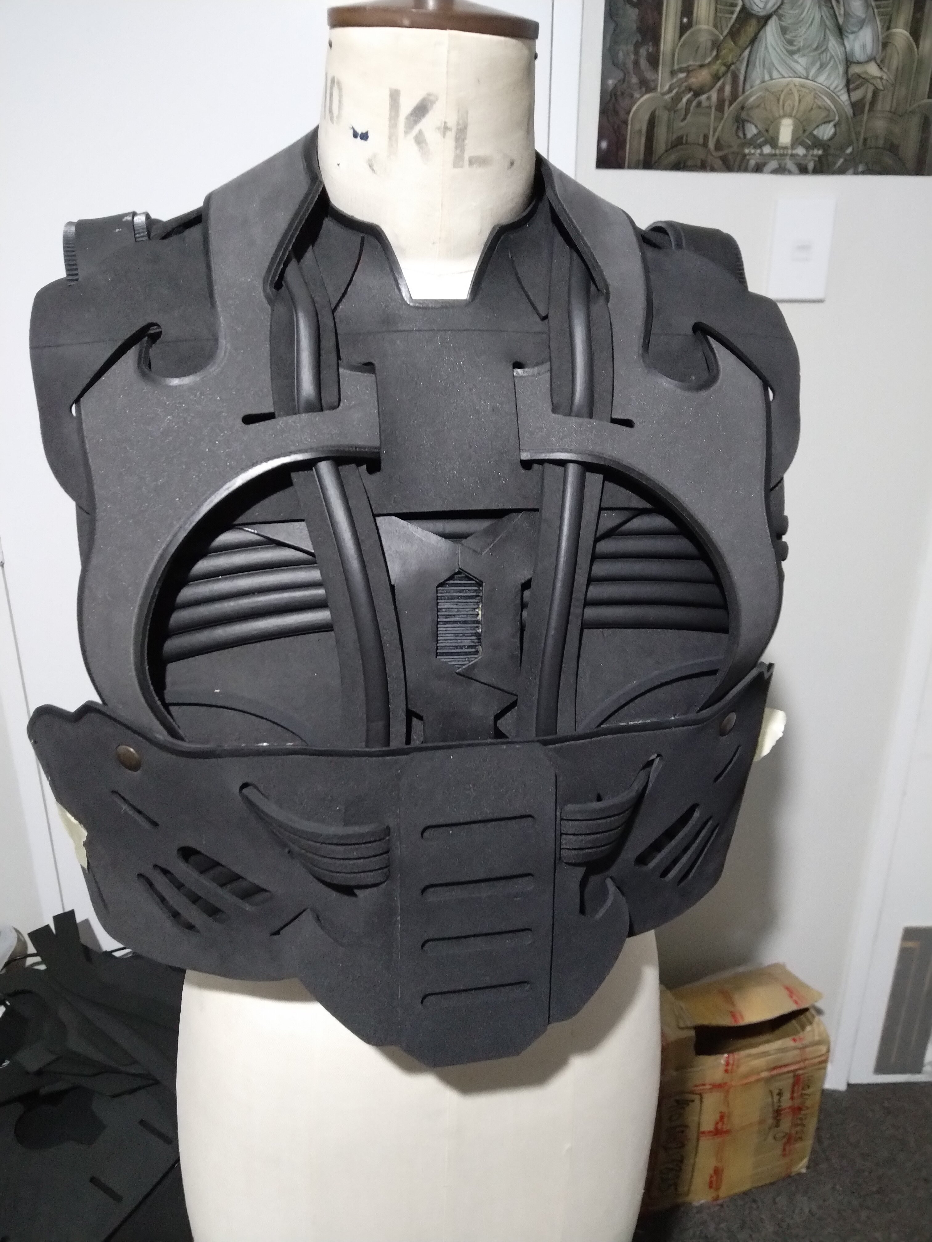

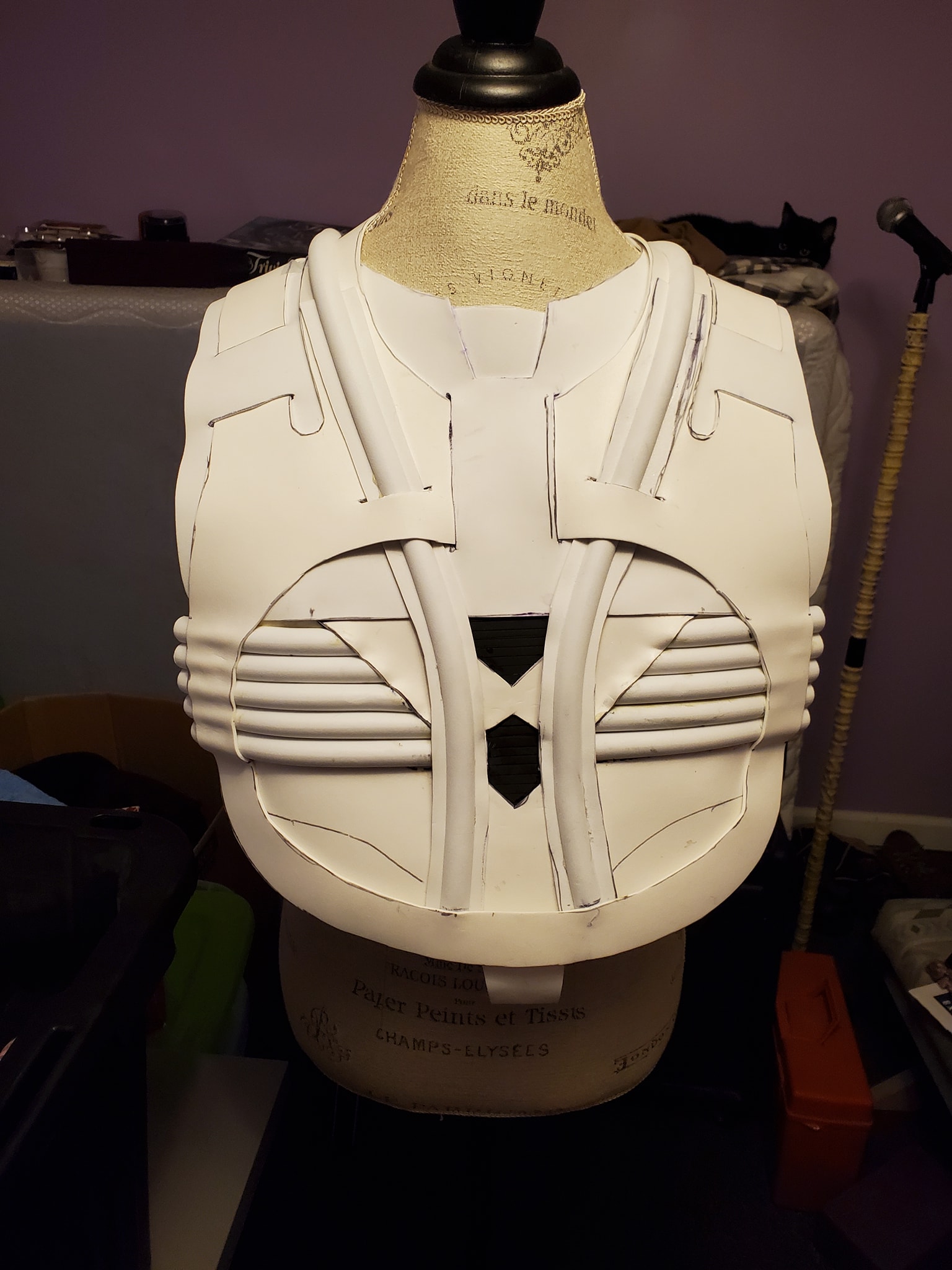

So far i have made the following vest to my size with the Tabbitha templates. for the most part they are a good start but you really need to mod the crap out of them if ur not a 5'10 hot chick lol but i got it workin so far!

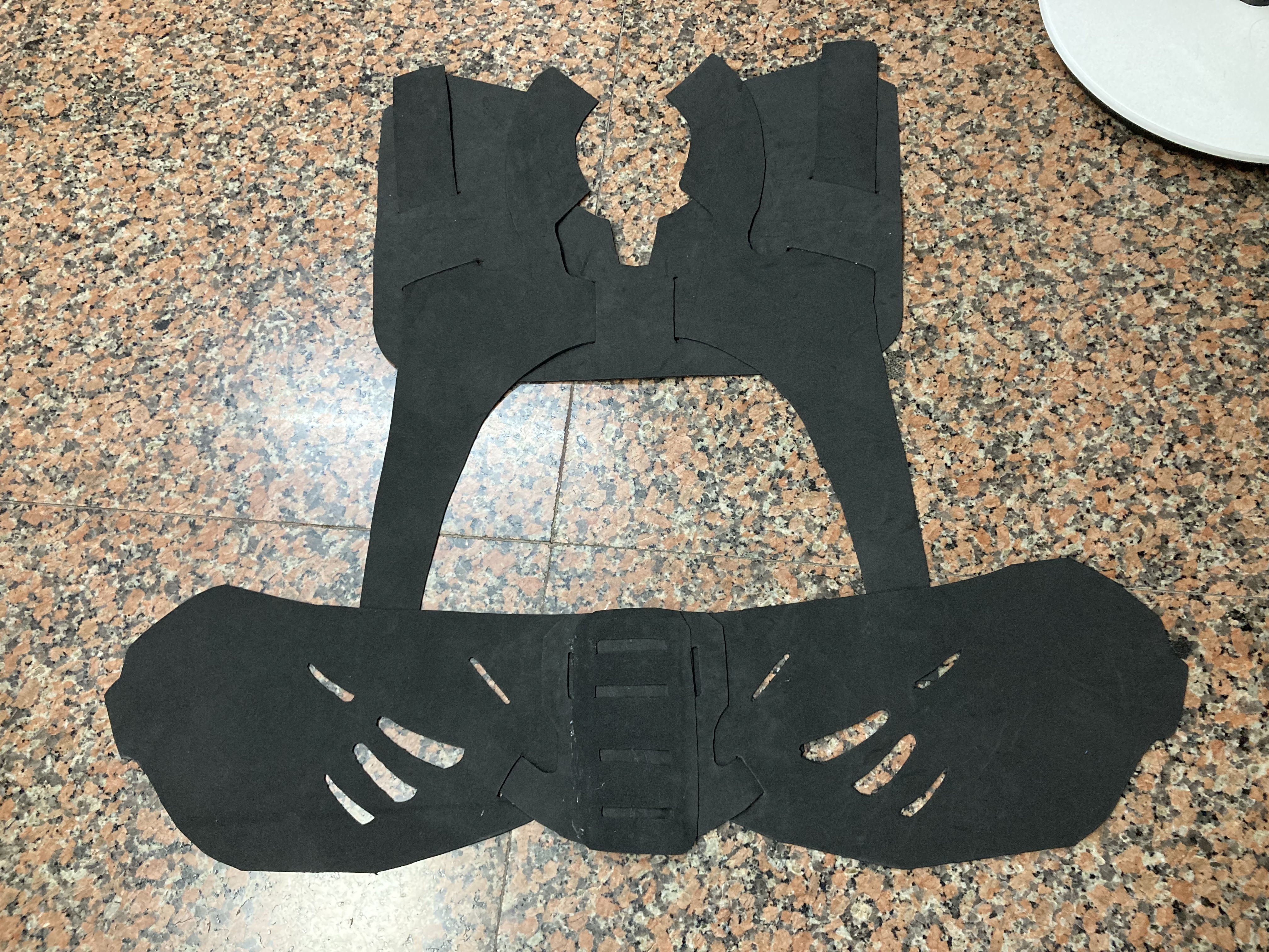

Hey everyone sorry for the lack of updates but here's a BIG one.
"Final" edits made to patterns and applied to latest builds (see first picture)
Making the screen accurate neoprene kits now (see second picture) this is heavy compared to foam (about the same weight as veg tanned leather)
Sorry for the files being unavailable , I have been getting slammed at work and with orders churning out two to three suit tops a week I will update the files soon.

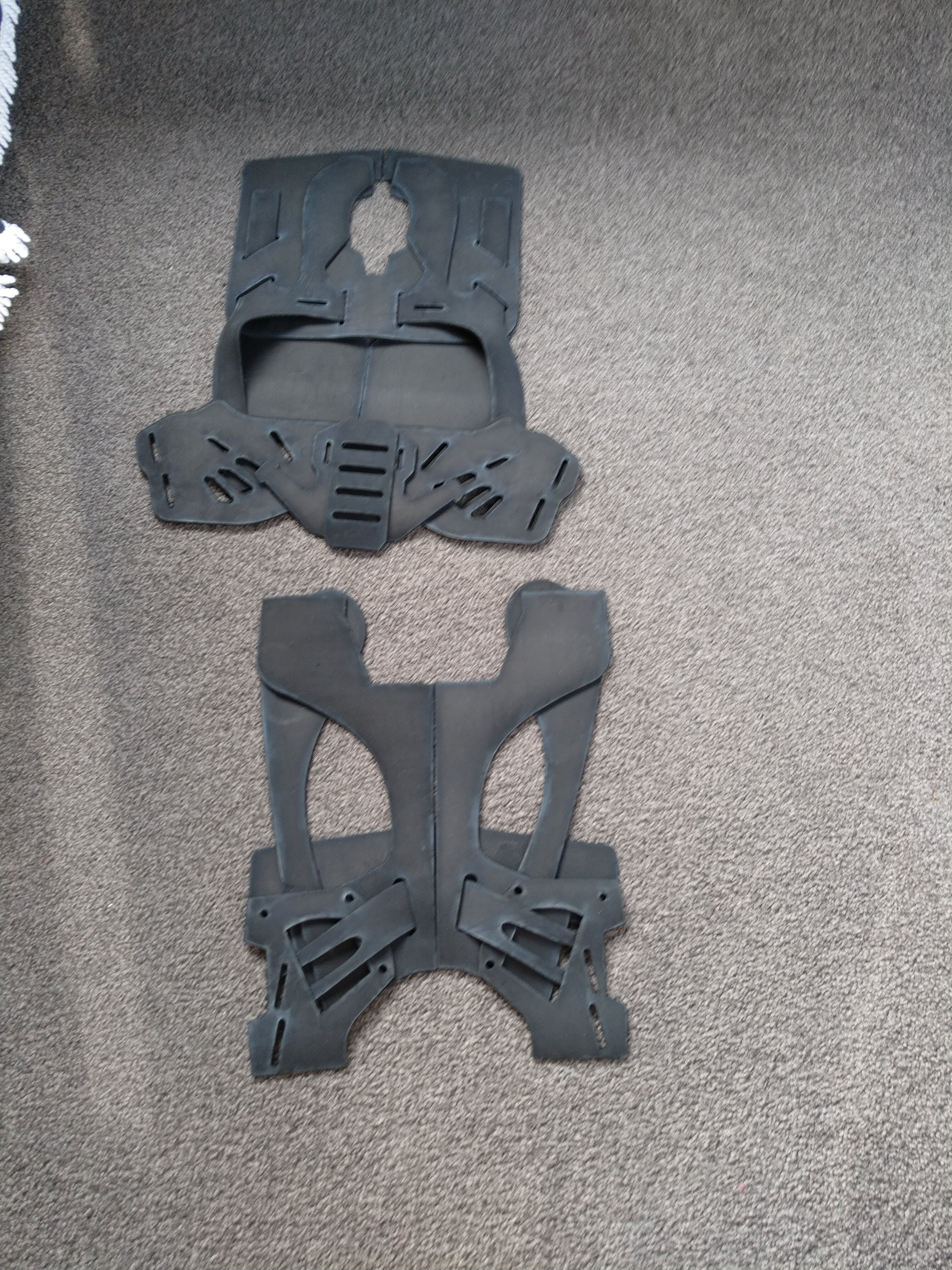

Ok so for everyone interested.
In a few days I will share a combination of STL files and vector files (for laser cutting) of the entire padded areas of the costume in extremely high detail.
Also here is a picture of what the costume looks like under the chest piece (makes things much easier)
I’m really looking forward to your files. Are they completed?
Yes most is rubber but you can use the files to cast what ever soft parts you may need if you do not want to do the foam route.
