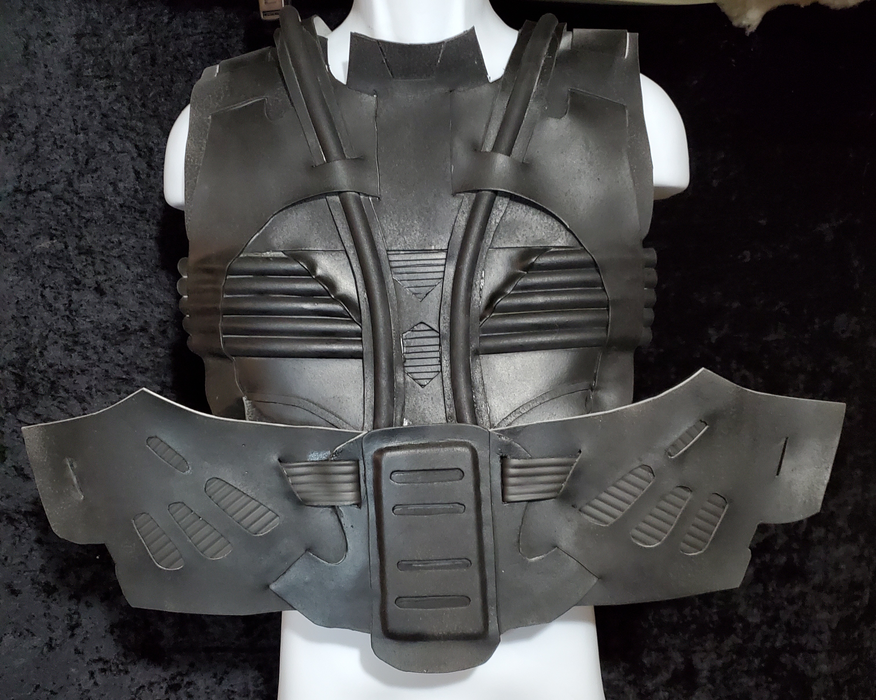

Looking to start this build soon. Does anyone have thoughts or experience on using Neoprene foam instead of EVA foam?
Seems like it might be more durable than eva? but cheaper than the screen accurate stuff XavNZ92 found?
I am thinking about in 1/8 inch (3mm) then 1/16 for the edging trim/raised portions.

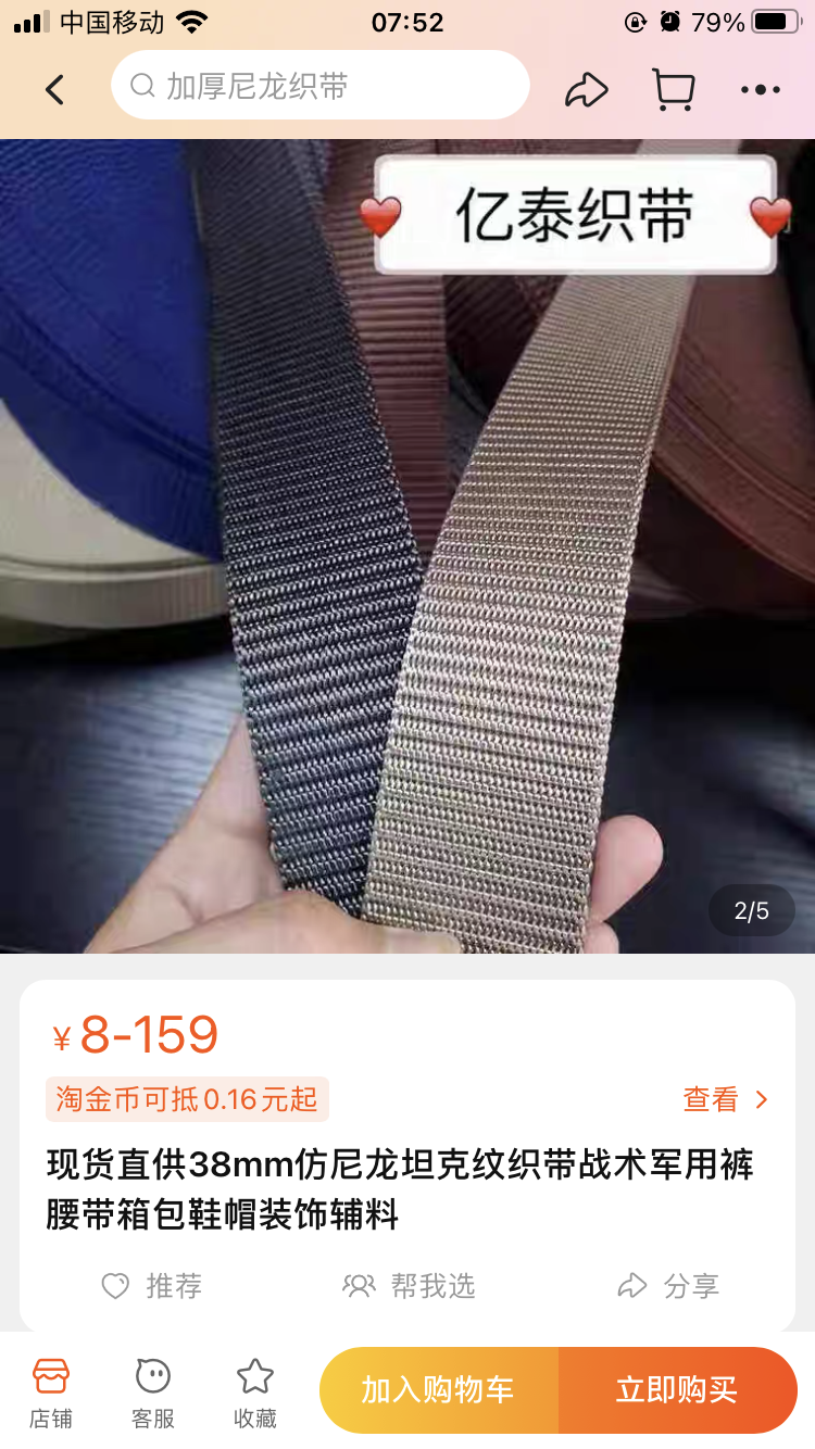

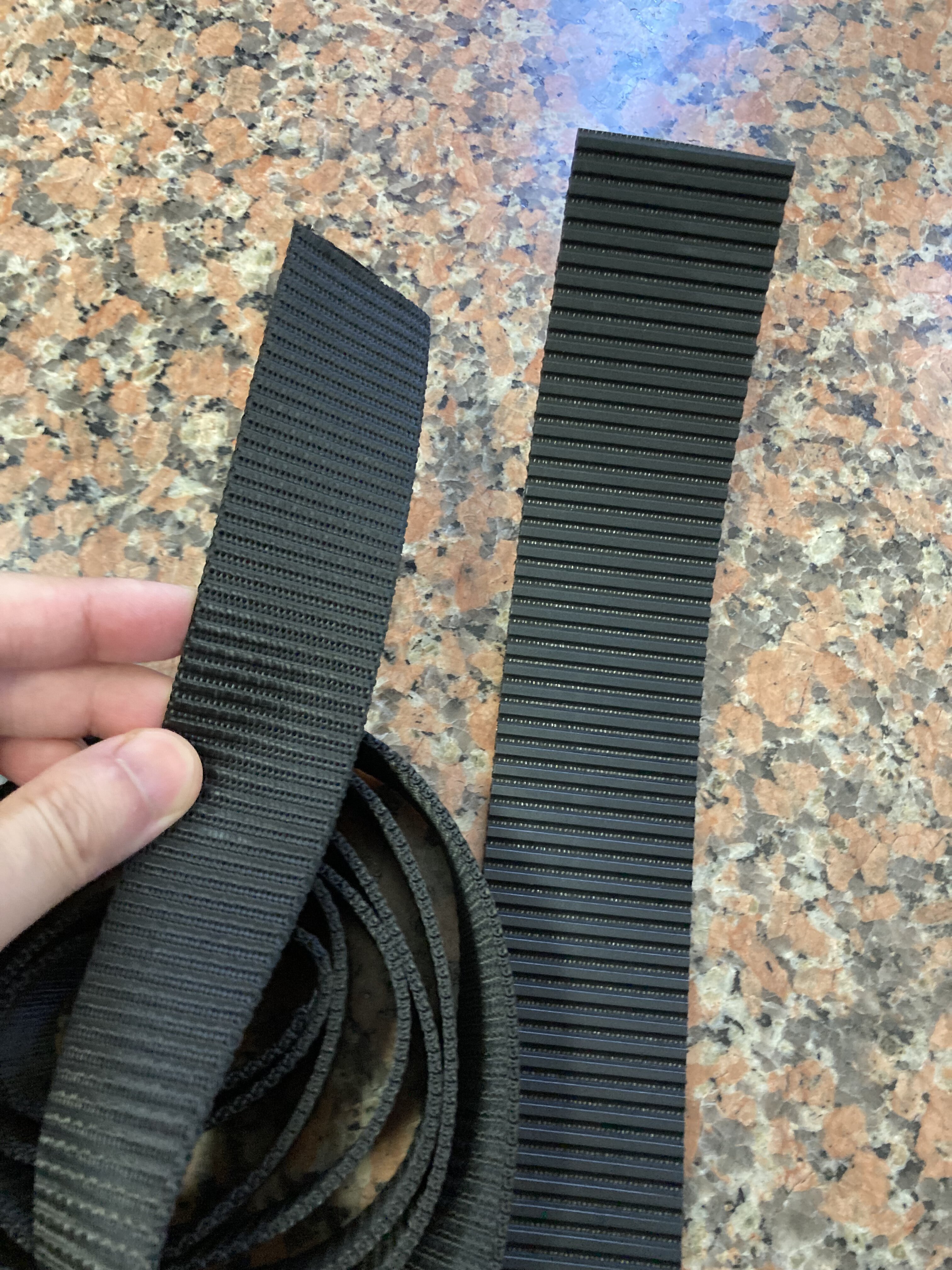

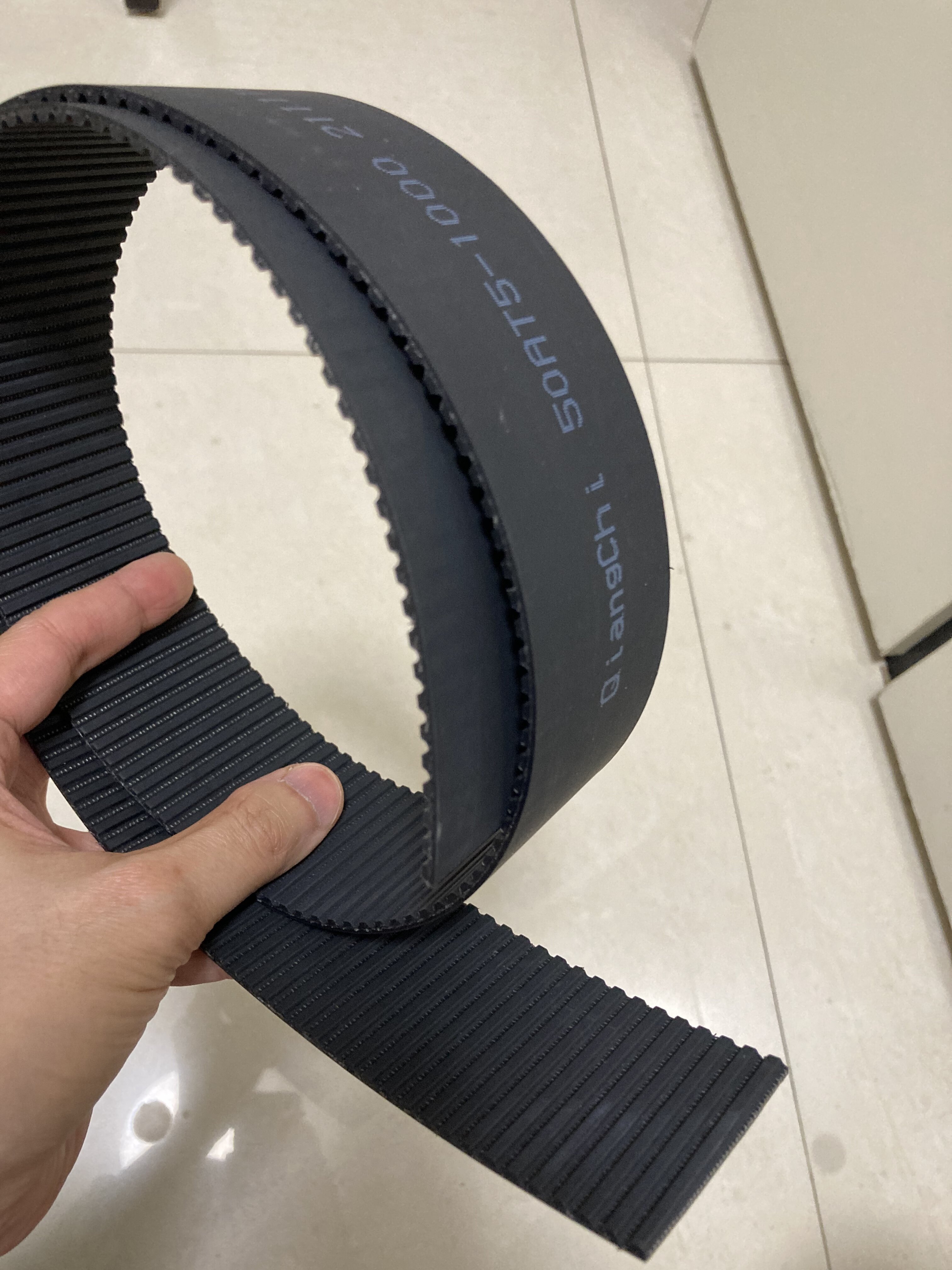

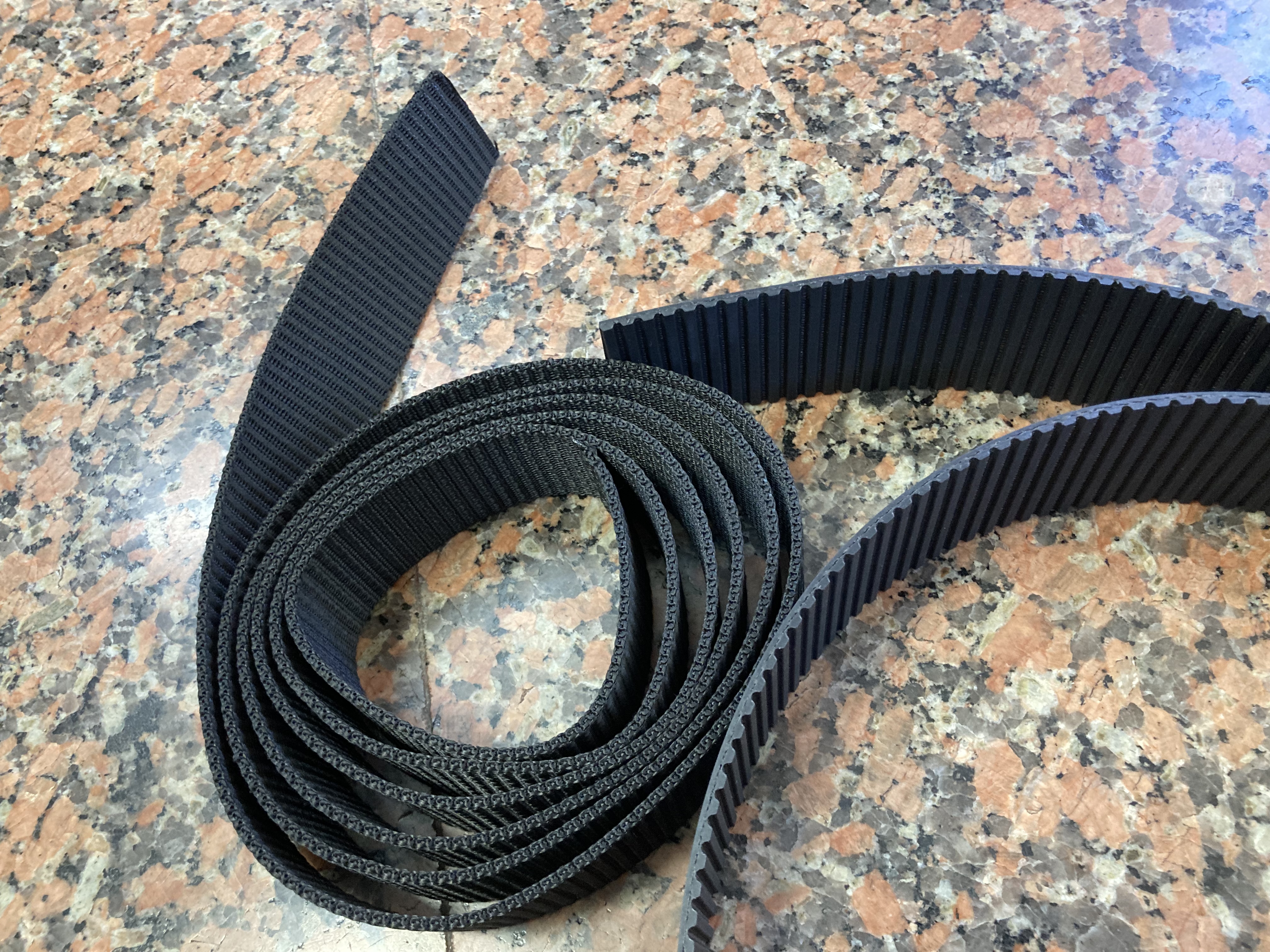

I also have the same issue when I got my timing belt, although the pattern looks great, but it’s too hard to bend.
6436A198-7F84-4190-934C-2D9AEF1BD7C6.jpeg 403122E5-1832-4D7F-8BCF-364F98083E8B.jpeg

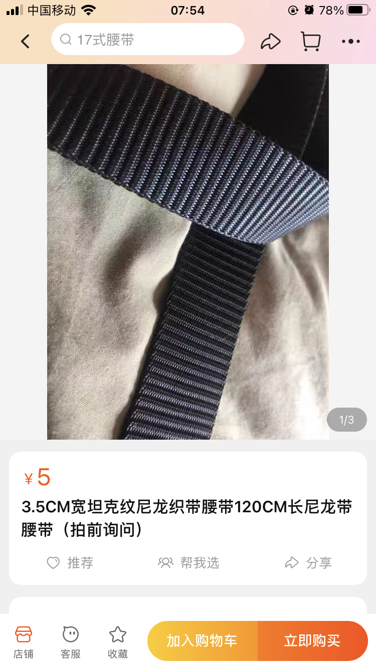

So I’ll suggest use nylon belt with ‘tank track’ patterns, which look more accurate to screen props. Usually they’re up to 38mm wide, should be ok for the cos. If you’re looking for wider one, just use regular nylon belt without tank track patterns.

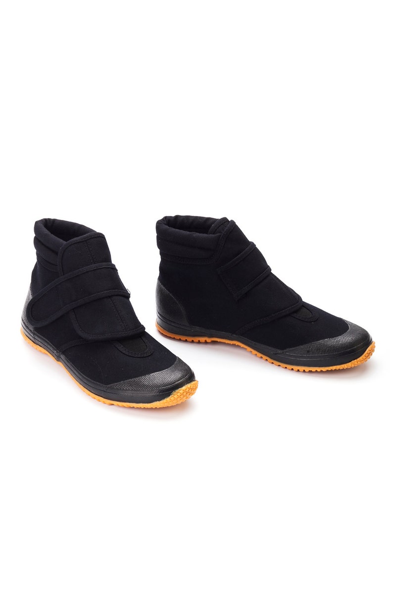

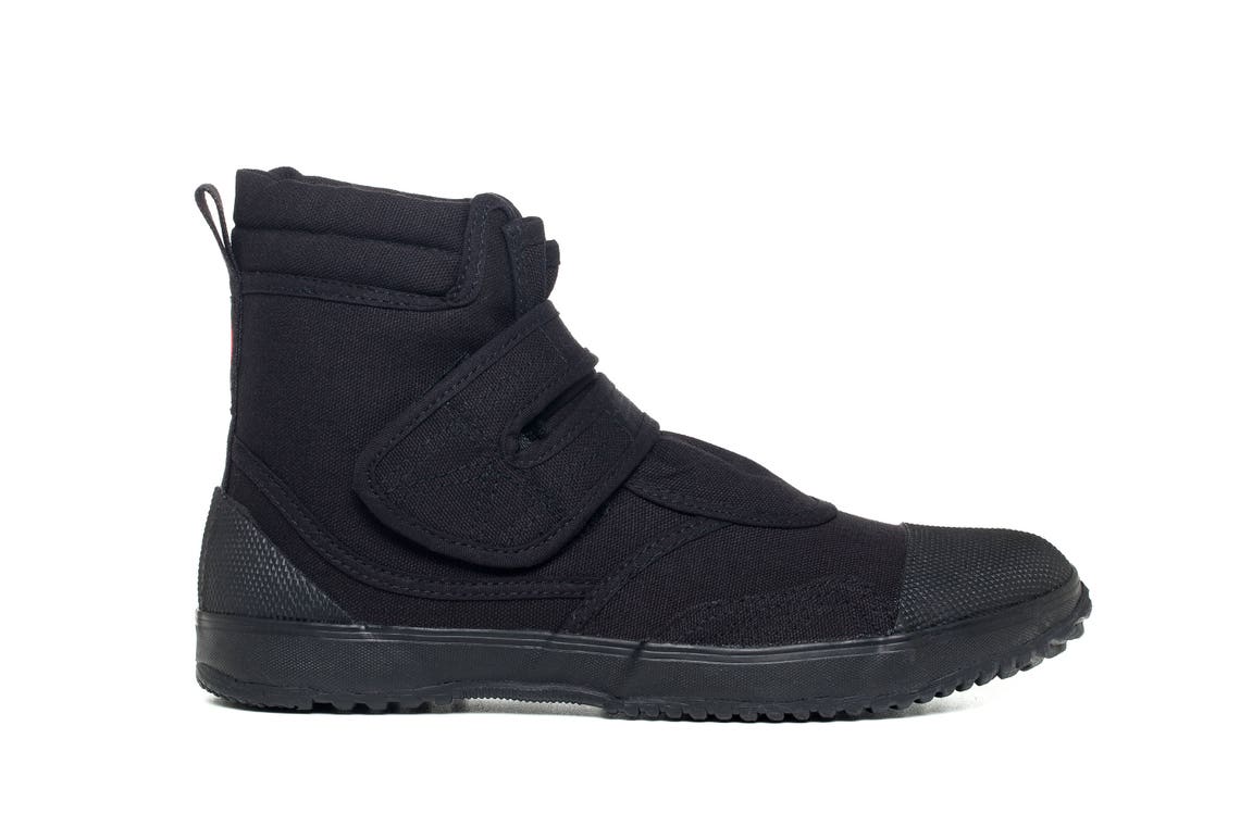

They are on Etsy. Seller is cooljapaneseshoes.
Fugu Ka-Ni cool japanese boots VEGAN black UNISEX. They are going for $109.​
They were on sale for $89. I got a pair 6 days after ordering. They are actually made quite well and are true to size. I have a lot of boot makers around me so i am going to take a couple pictures that are posted to see what they think. I believe they are a better start than regular workout shoes. In most of the pictures of the shoes you can make out a toe cap.
XavNZ92
Happy to hear that because I just ordered some !
They seem to be a great base and these Japanese shoes tend to be comfy.
Honestly I'll see what I do about the shoes might use them as they are as shoes are usually the thing where I go with comfort over accuracy with because bad shoes can really ruin your day even if they are accurate.
Might make that heel part and Velcro it on if anything.
Those soles are a mystery as I got a police officer freind to run them on a police forensic database and the only partial result was some Reebok shoe but only very partial.

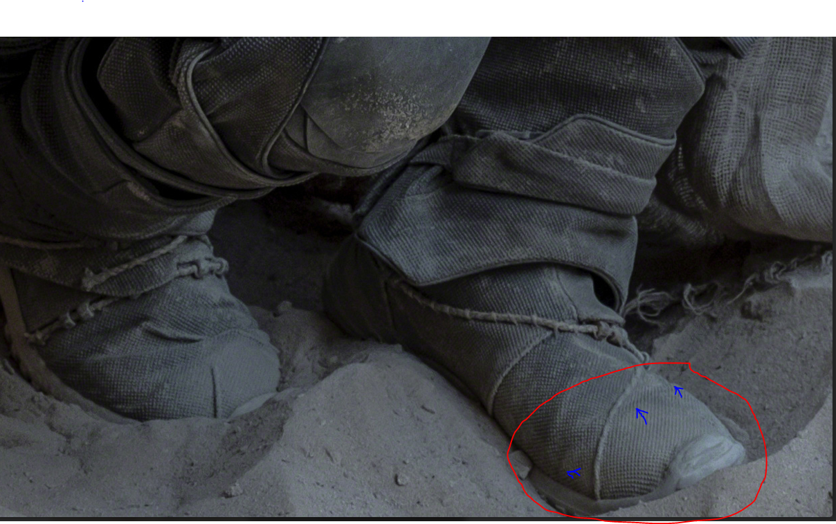

blue arrows show edge of toe cap
Keep in mind that while there is value in looking at the design of the shoes, there is no evidence at all that any part of the upper (the non-sole part of the shoes) is based on an existing design. They've been completely covered in the same fabric as the whole still suit, and likely are an entirely custom shoe design, not matching wherever the soles came from.
