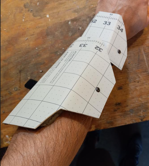

I haven't figured out this black base piece yet, but I did assemble the 2 grey pieces. I used a 2 layer system of grey anti-fatigue mat ($10 at job lot of harbor freight) with a layer of Fiskers self healing cutting mat on top ($50 for the 2'x3' piece, hopefully the largest expenditure for this build) I did this because I wanted this to be somewhat functional. The mat provides blunt force protection, and the self healing mat is pretty cut resistant. It won't stop a lasgun, but it might stop a slash from a Harkonnen blade. It's also light grey on one side and dark grey on the other, so if the paint chips off, it will still look mostly the right color.

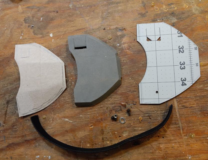

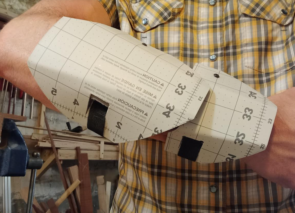

Step 1 is make a carboard template, then cut it into the foam, slightly smaller then the template, then cut the self healing mat on the scroll saw. I couldn't find any pictures of how the black strap attaches to the black underlayer, so I went with double sided velcro strap. it looks good and is the simplest attachment solution. The strap is visible and goes through both layers of armor on the medial side (refer to your anatomical charts if necessary) but appears to come out under the self healing mat and on top of the anti-fatigue. To keep it all together I used a small black fastener on the lateral side. This isn't screen accurate but the pauldrons have small black fasteners so I didn't think one on the gauntlet would be too far from in-universe acceptable. The image below shows the rough steps I took, before painting (it's outside drying now).
Unfinished result:
not great pics, but hopefully I can show you something more finished soon.

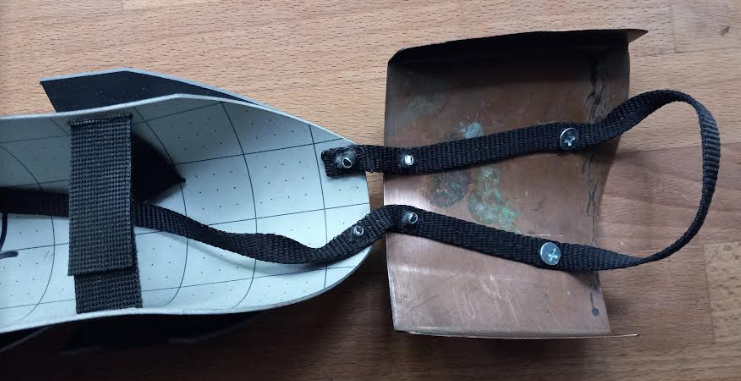

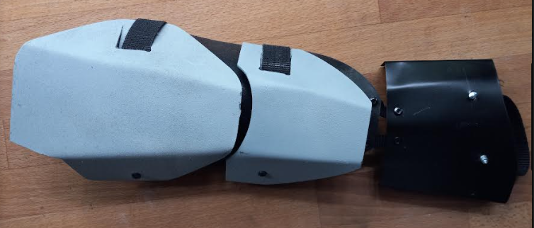

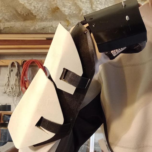

Just assembled the mostly complete L side. For the black base piece I settled on the self healing mat, which I will now refer to as PVC because that's probably what it's made from. I I wanted to save the PVC for exterior pieces but this seemed the best option, as I needed a rigid base that wasn't thick or heavy. I heated it in water and placed bands around it to get it to curve, though I could have done a bit more to form to my arm. The grey elbow piece was cut down in length, while it seems to me that you don't want gaps in your armor, this is how it is on the film armor, so that's what I tried to achieve. I used 'misty grey' chalk pain for the forearm pads, so that they don't look smooth and have that slightly mottled look. The dorsum of the hand is made of copper sheeting that my neighbor left outside for 3 weeks before it found a new home. This is attached to the forearm piece with 1/2" nylon webbing, riveted on. The webbing also loops around the middle and ring fingers, so that the dorsum piece doesn't flap around.
You'll notice 2 screws securing the webbing and popping up through the dorsum, aside from being a fiercesome backhand, the screws will serve as attachment for whatever I decided to do for the ridge that runs along the dorsum. I haven't figured this out yet. I feel like I need something pliable that I can sculpt. JB weld maybe? Ideas welcome.

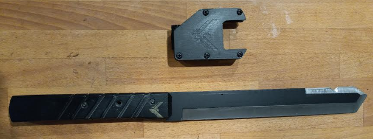

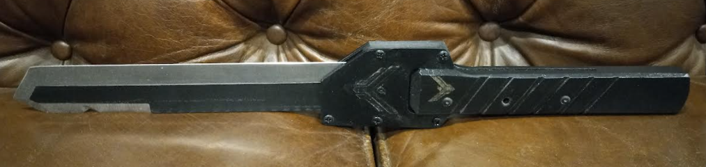

Part of this costume is the weapon, which is actually what started me on this path. Woodcraft had a kit of the Camillus Carnivore Inject, where you add your own handle. I ground off the saw teeth on the back, gave it an edge on the top spine, and painted it black. The handle is ok, except that I drilled 3 pin holes but lost a pin :( I think I'll redo the handle anyway to something more katana like, as in the films. This blade is not a replica so much as what you might call an 'in universe' prop. Gurney's blade is much shorter than most and there are at least 3 types of blades in the film, most of them being the longer style you see Duncan salute with right before he puts down 19 Sarduakar for a dirt nap. So let's pretend my blade is custom made for a specific soldier.
The scabbard is layers of 1/8" hobby ply, with 2 layers making up the slot for the blade, as the blade itself is 1/8" thick but actually a little more due to the paint layers. To make up the difference there is some nylon webbing going through the blade slot, and a metal spring clip on the back to attach to a belt. I think the hawk logo on the scabbard is recessed in the film, mine is flat black prayed over a sticker, which was placed on gloss black. The effect isn't exactly what I wanted.
I have to say though that this scabbard design is...dumb. It seems to me that a scabbard has 2 jobs: 1) protect the user from the blade, and 2) protect the blade from the world. This scabbard does neither. If you try to draw the blade but don't grab the scabbard properly, you'll cut yourself. The blade will bounce around as you walk and bump into chairs, walls, or your armor, which will obviously dull the blade. It looks cool...I guess...but it doesn't seem very functional.

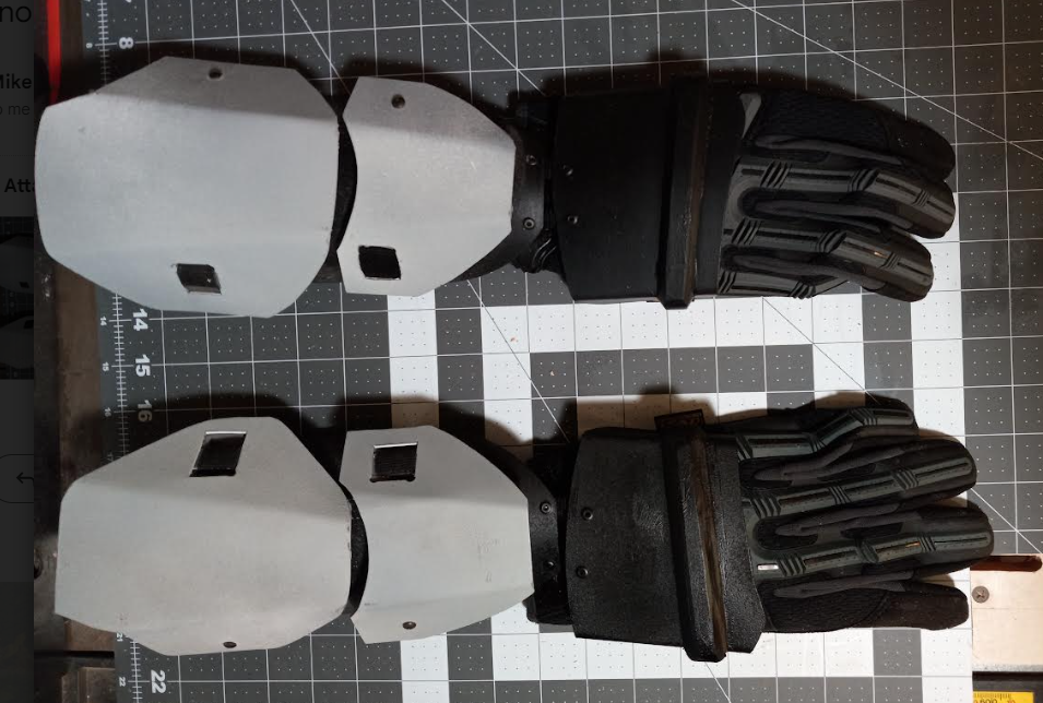

I finished the piece for the dorsum of the right hand and bit the bullet and bought more accurate gloves for $48 (ridiculous) only to find the next day that even MORE accurate gloves were on sale on the website, so I'll wait for those to come in before I don the vambraces I've made and show you that. I also ended up using the PVC material for that dorsum piece as well, it's easier to shape and the copper sheet was too flexible. That was a dumb idea. In the mean time here's this:

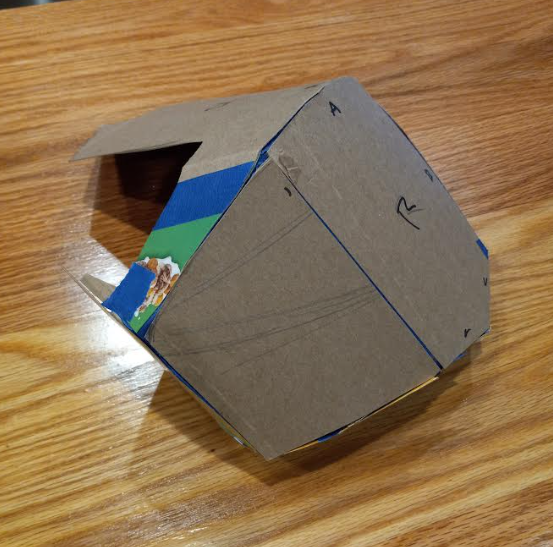

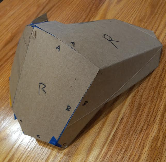

In the meantime I can show the progress on the pauldrons. I'm in the template stage and I have to admit it seems to be coming along well. One website said this would be an easy halloween costume because it's all just hard angles, but when you actually work on it you start to realize how many facets and layers it has, you see that it's anything but easy. So the template for the largest part of the pauldron is done and I'm happy with it, but there are other pieces to form, and then I need to watch the video to see if they're statically connected to each other or if they all articulate.
