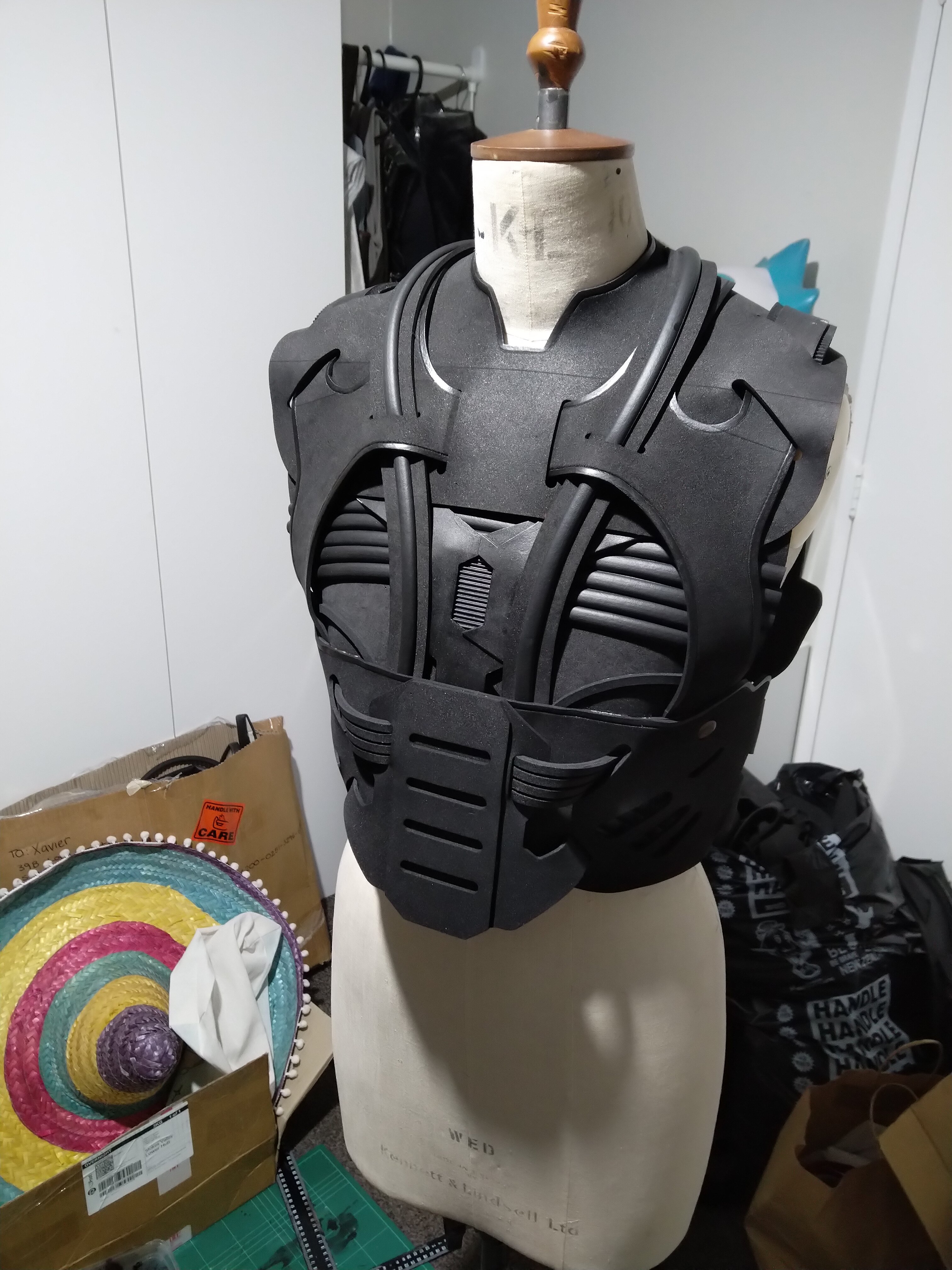

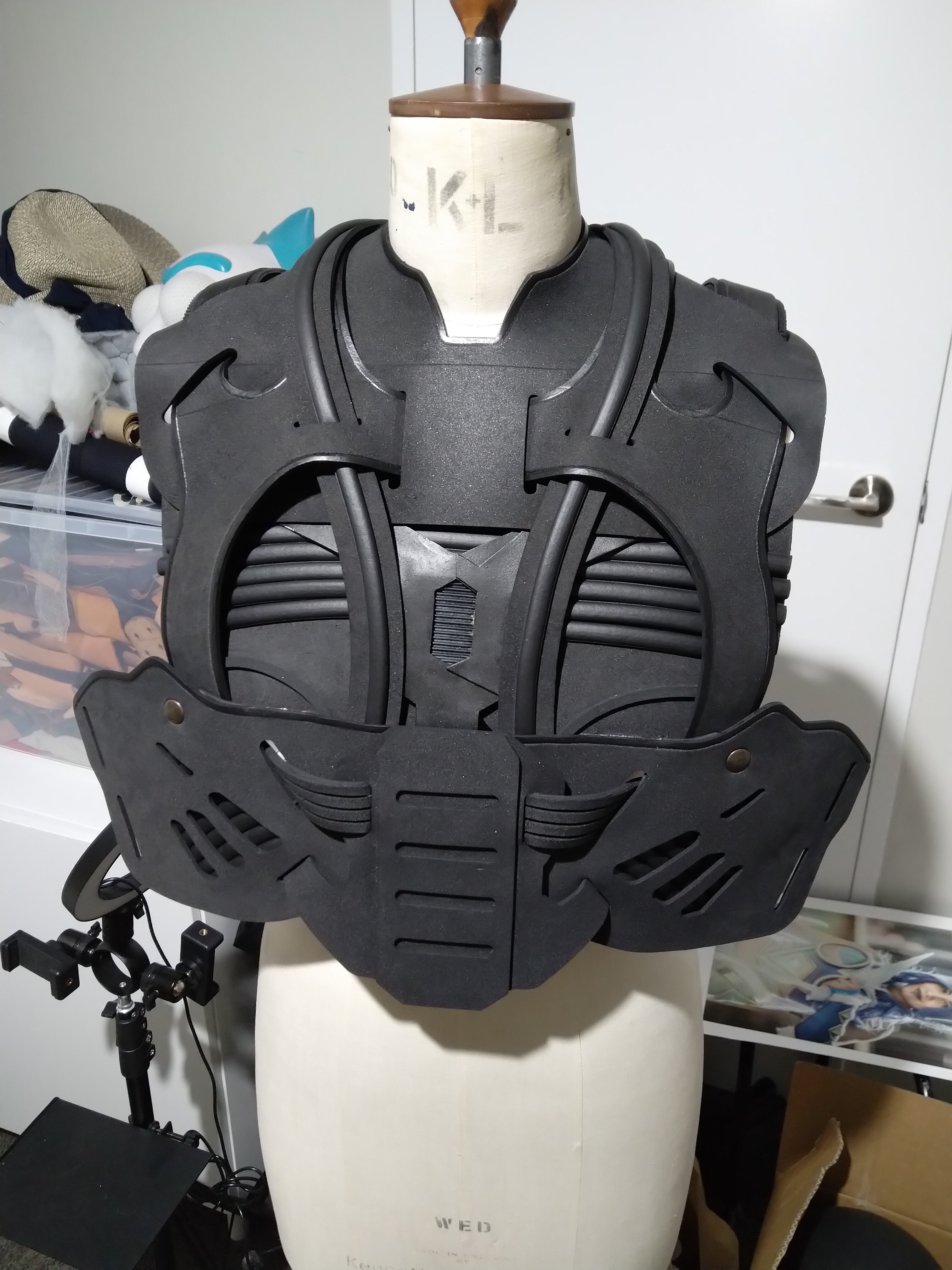

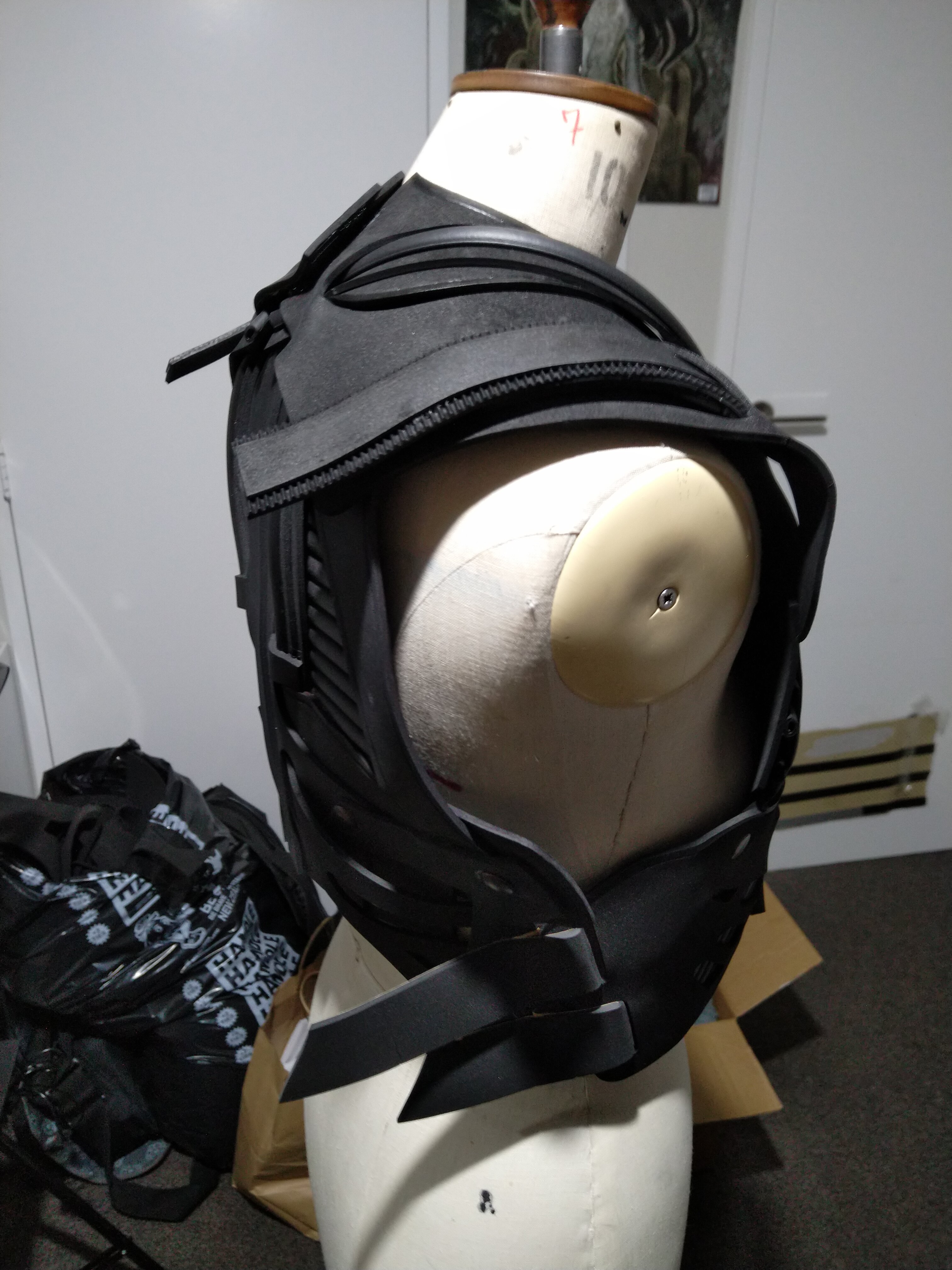

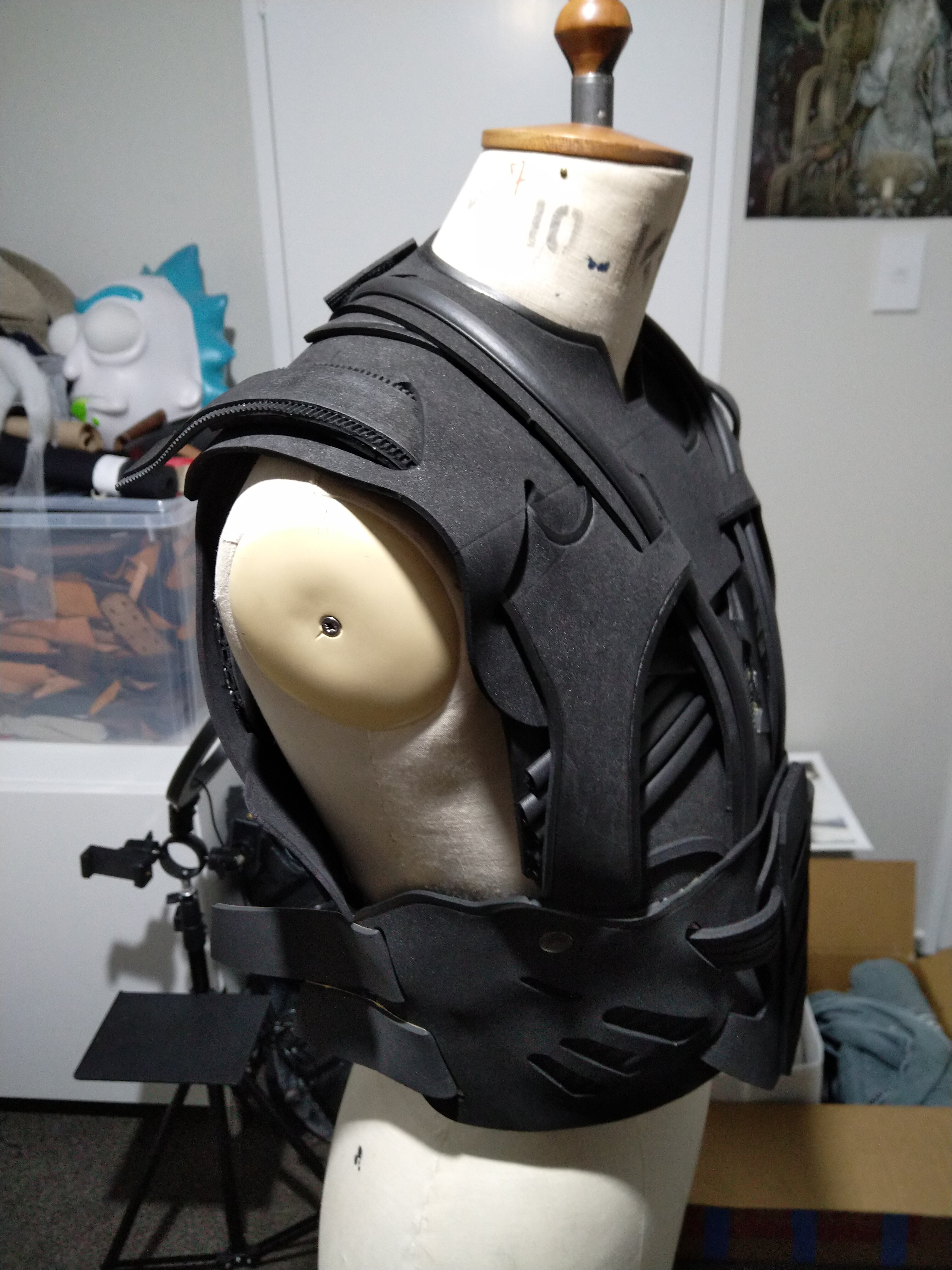

This is my almost finished chest.
The edging trim is fantastic. How did you do that?
Everything is great the tubes and lines on the inner layers, the belting…. Man this fantastic.
This build is just beautiful, wow! Do you mind sharing what you used under the shoulder straps with the foam to get the ridge effect? It looks to be used on the front abdomen middle section as well if I’m not mistaken?
Ribbed nitrile rubber floor matting !
No really that is what it is , most of the tubing is either insulation tubing or rubber channels used for car doors.
There's also a few neoprene bits and the rest is plain EVA
And ……. It’s all freaking awesome!!

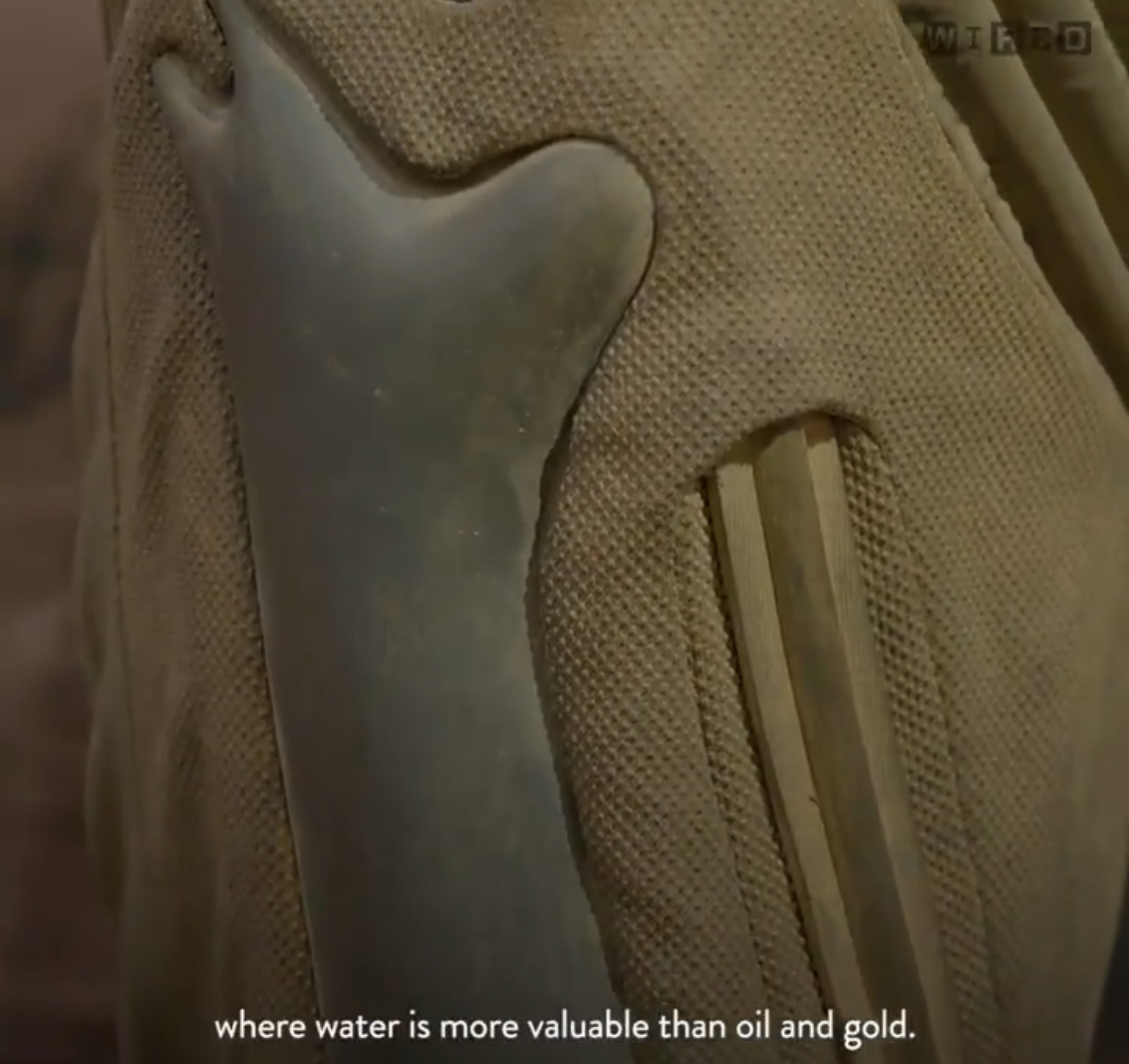

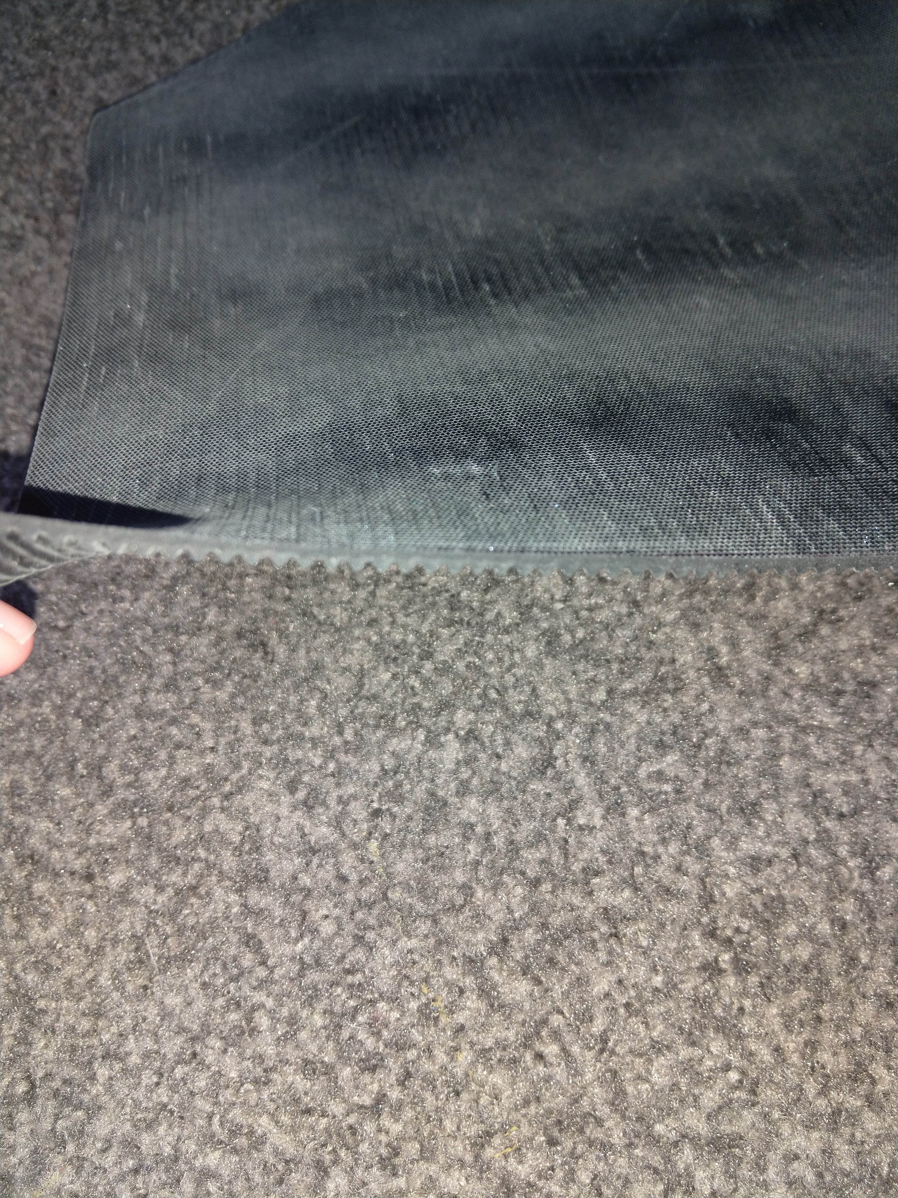

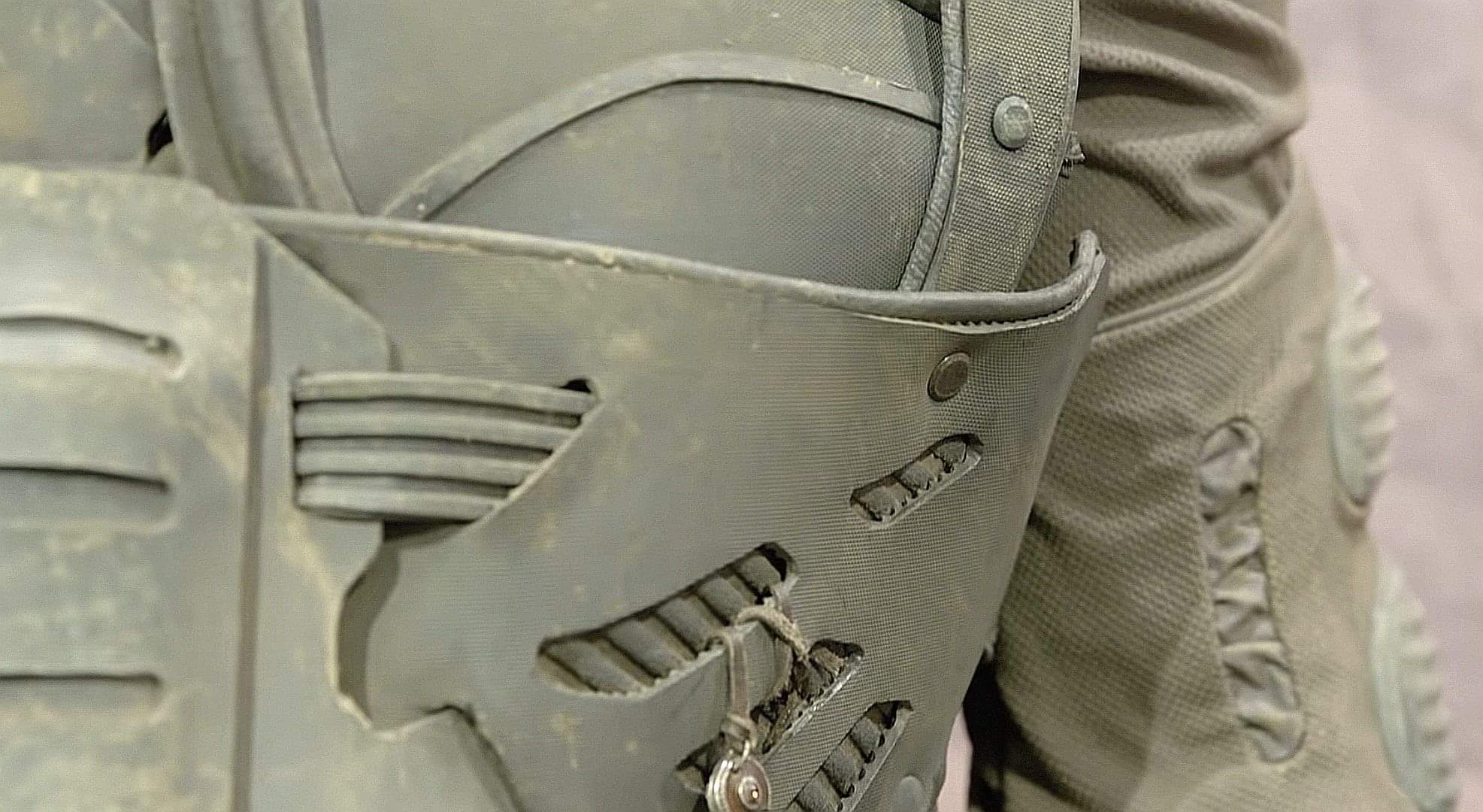

I officially found exactly what was used for the "foam" parts of the stillsuits.
It is ribbed neoprene with the ribbing on the "inside" and the back on the outside (see HD picture of the original and pictures of the material I found)
Good news it's easy and safe to laser cut.
Bad news it's expensive AF compared to EVA.

At least its something that cuts fine on a CO2 laser and that is the good news !

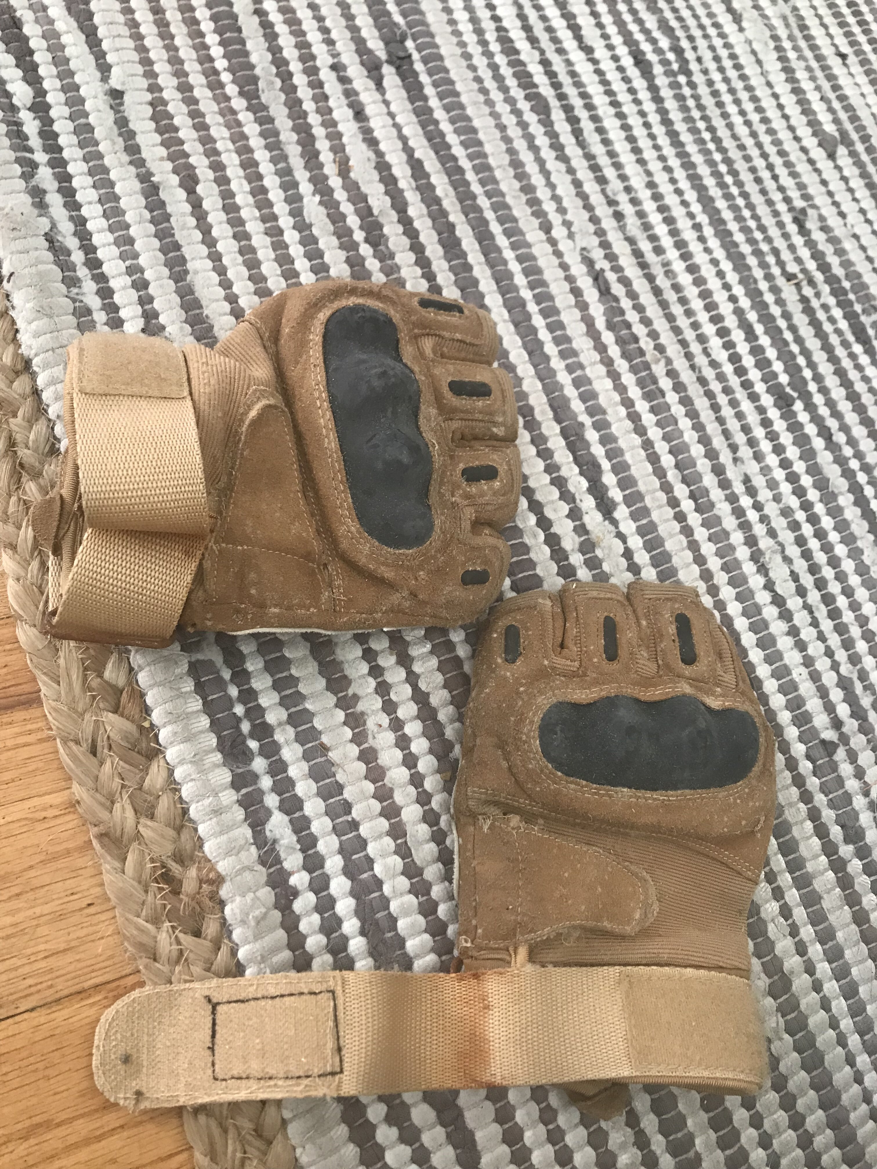

i have made a very very small start..... i found these in my airsoft bin.....
