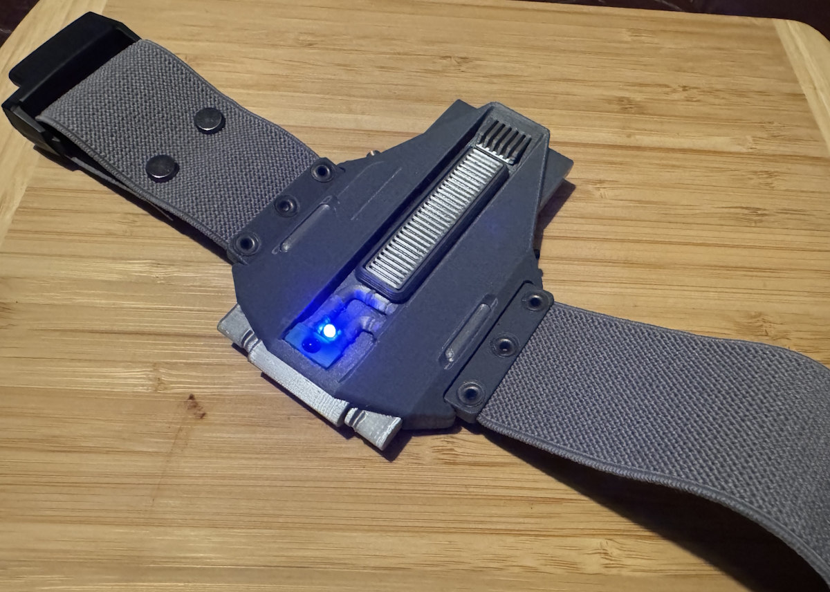

I did eventually do myself a version with a hand built pcb in it and a couple of other off the shelf modules to make a 'working' version. Working as in it can send coded IR pulses to my lasertag sensor to activate its shield mode :) Oh and do some sound playback etc while doing so using a WT588D module and a small 20x30mm oval speaker.
Added a TP4056 module to charge up a small Lipo cell for power and hid the USB C port behind the front silver section which I made removeable. Held on with magnets.
I'm not aware of a 1st run lol.

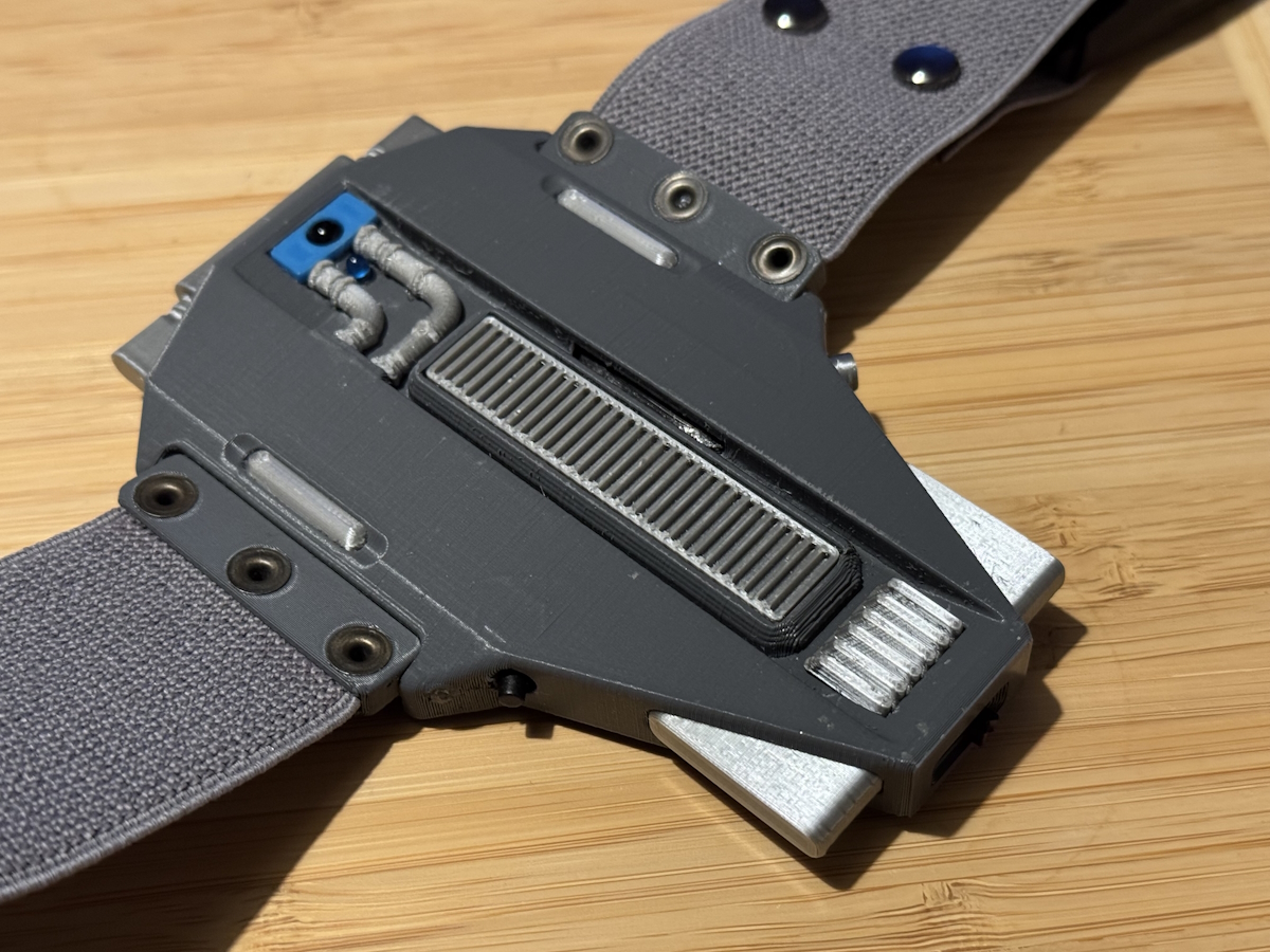

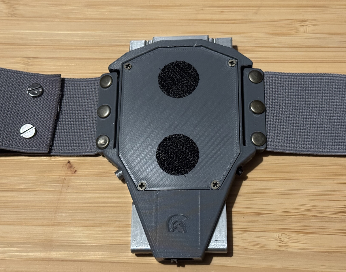

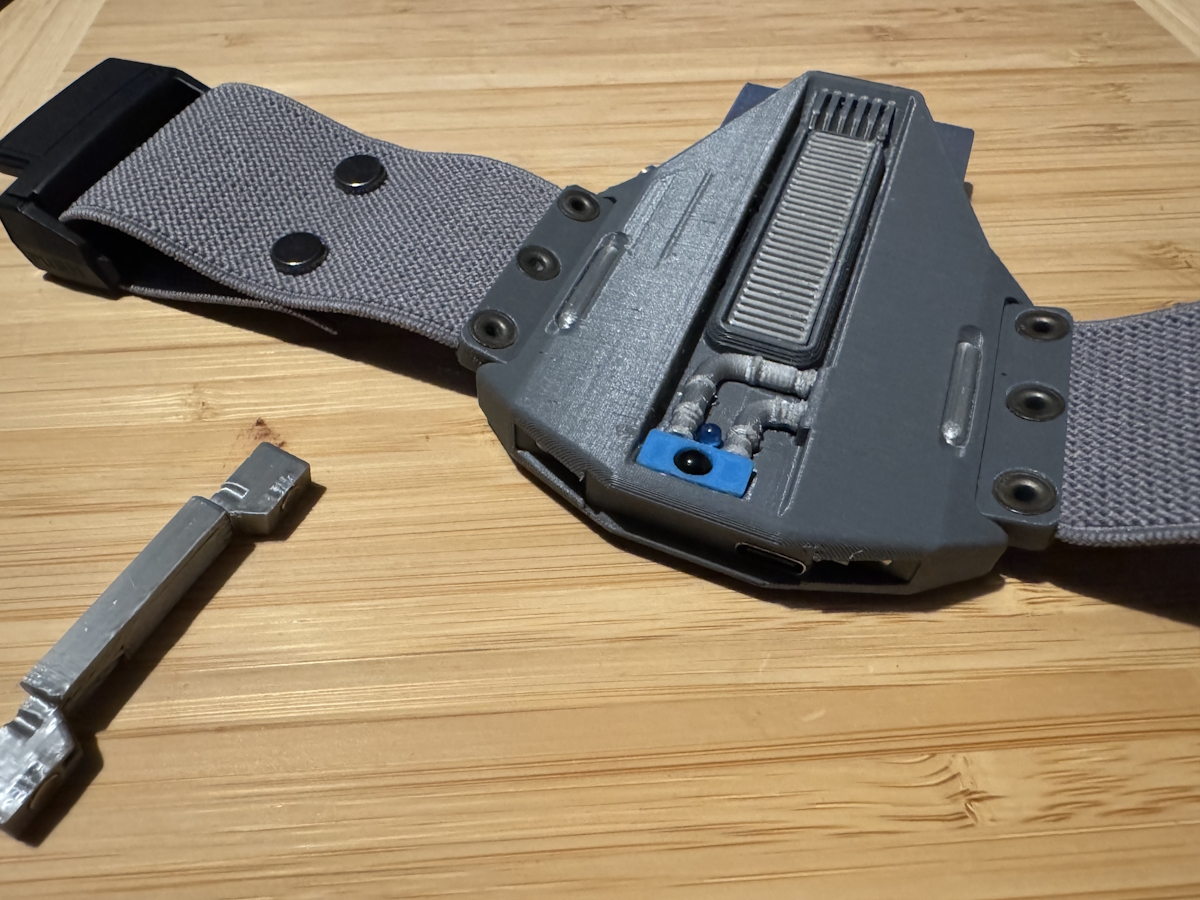

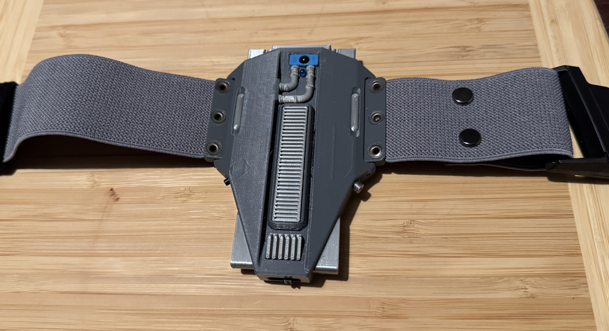

I have now uploaded the extra stl files for the hollowed out version to the Printables site Dune 2021 Shield Generator by Neophyl | Download free STL model | Printables.com should anyone wish to use them. Updated pics are also on there but here you go -
Again I wish I had a resin printer for this as even though I made the main body a few mm thicker some of the walls are quite thin and you can see some ghosting from the internal voids on the surface. Unfortunately its the best my printer could do.
