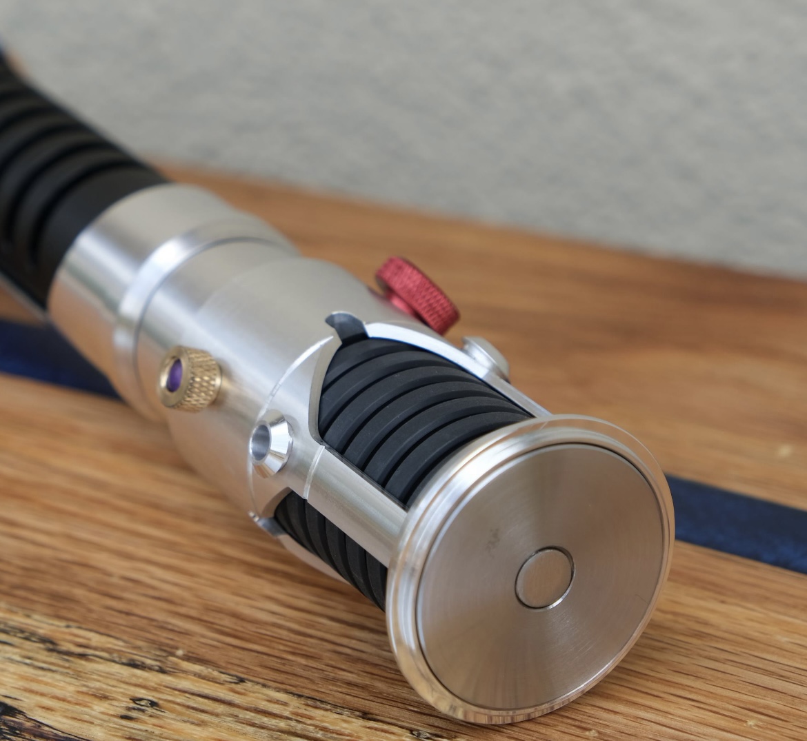

RE: The angled emitter plate. I can’t remember if it’s been said, but what’s the timeline on that? Made wonky? Damaged before principle photography, during principle, after principle?
I guess my main question is which way is screen accurate, or is it both?

I think most likely both are screen accurate. The picture of the saber on the ground before Maul launches it into the abyss looks straight-ish to me. However, I can’t do a reliable perspective match without several high resolution images from different angles.

All the resin castings have the offset emitter, but do not have the pommel damage. So, it had to be early

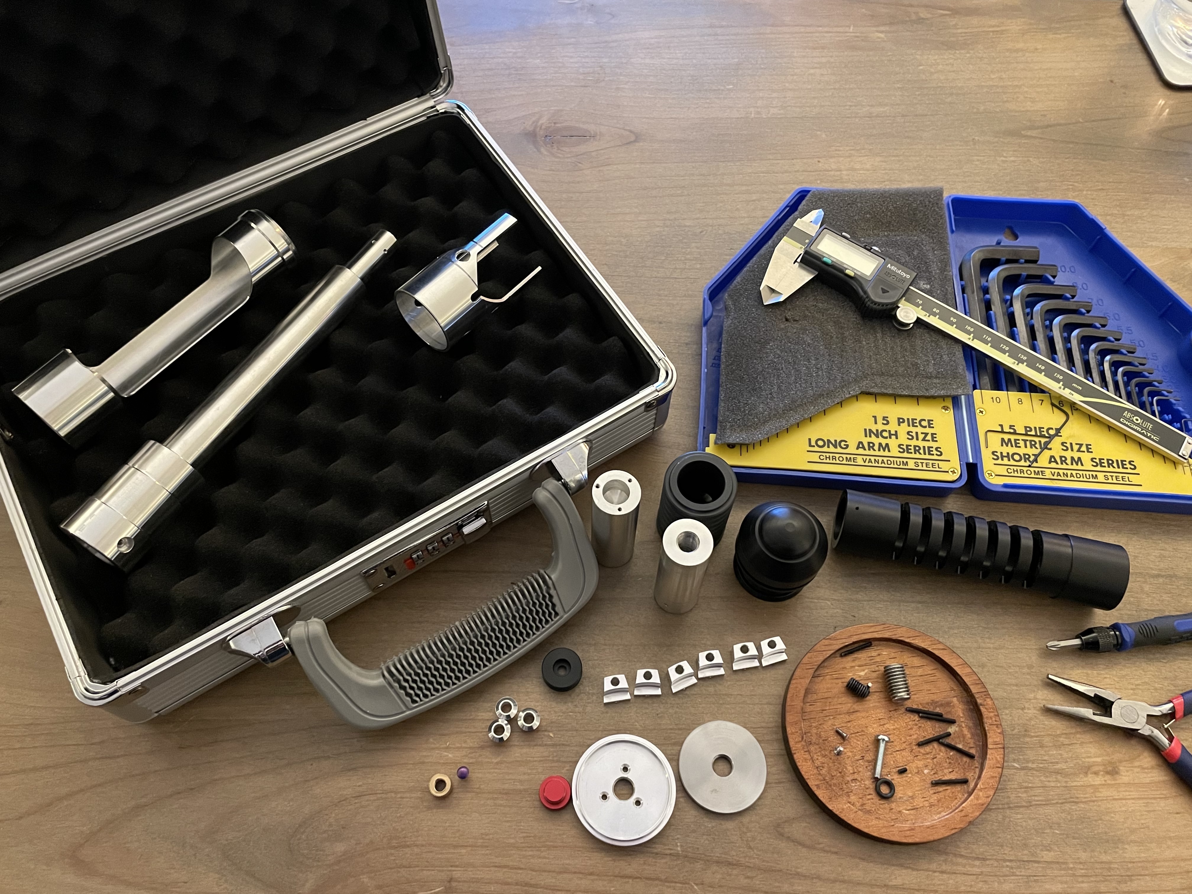

This saber will not be built around a threaded rod. While that was the original intent, we decided that the only way to get everything positioned and clocked exactly as it is in the model (that I spent so many hours perspective matching and tweaking) was to have a precision machined solid “core”. If you notice in the exploded view I posted a few weeks ago there is a duplicate silver cylindrical part in the emitter. Our hope is to have this saber be buildable in two versions: one with the emitter bezel off center and at a slight angle (as is seen in our reference photos), and one with the emitter bezel centered and flat as it probably was when the prop was first built.

I forgot that these beveled rings were just that, with a little flange. Maybe glued to the steel plate and we’re able to be knocked loose. Unless there’s info suggesting it was a plate, sandwiched against the resin emitter section?
