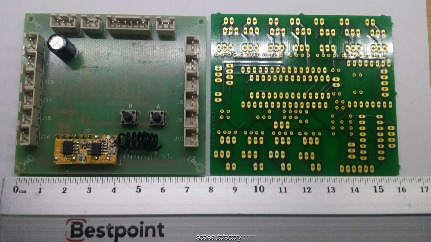

What kind of amps can this thing handle? The 3 transistors on the stock Deago board are rated at 500ma each, though I suspect the actual rating is far less.
I split the lights of the falcon into 6 channels (landing, cockpit, head, turret, engine, ramp) - each channel can handle 500mA.
i plan optional expansion ports with 1.5A to increase the current for a selected channel. Its possible to add upto 3 expansion ports to the board.
Optional parts: mp3-soundmodul and bluetooth modul with android app or windows pc app.

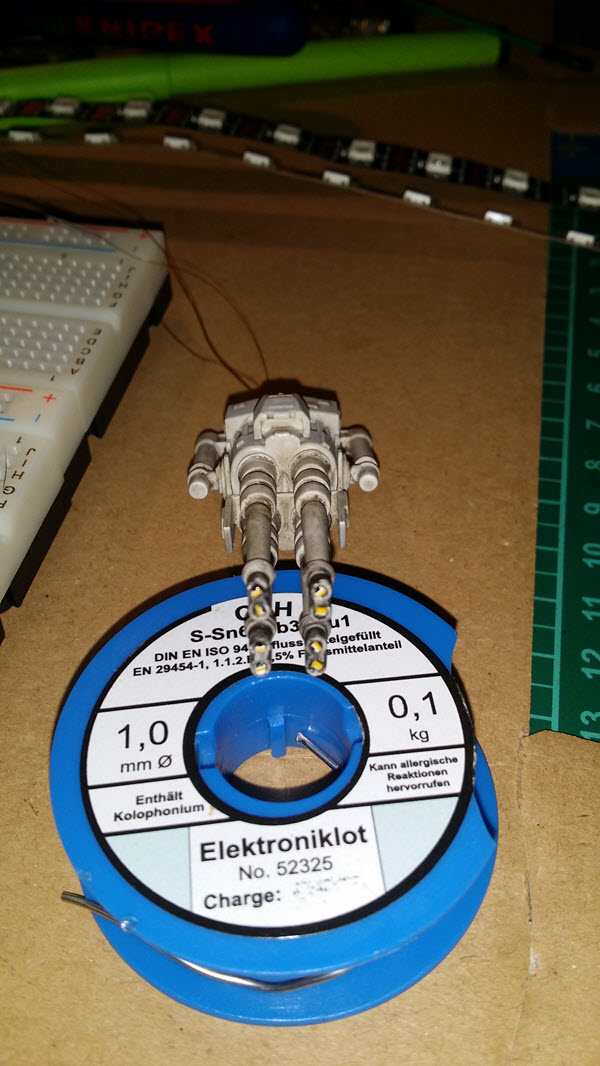

My Support Board for the Falcon:
Replaces the two led strips from deAgo with a 22 RGB-LED-Strip (Neopixel WS2812b) and can drive additional lights with max. current of 5A.
The support board and the deAgo board uses the same power line and can be switched on/off with the deAgo RC.

Been working on my Falcon lighting, sound and ramp control via Bluetooth for a few months and finally made enough progress to have some prototype PCBs made.
Im utilising an Arduino Mega to carry out 90% of the work and an Arduino Trinket controlling the engine lighting (Neopixel strip). I’ve utilised the Blynk smartphone app to control everything, the first vid shows the proof of concept, the second my current PCB set up. The board consists of 13x 12V output lines for various lighting circuits, and 7x 5V outputs all via 2 pin JST connectors, the 12V lines can handle up to 500mA each and the board total is 5A so more than enough for my needs :D

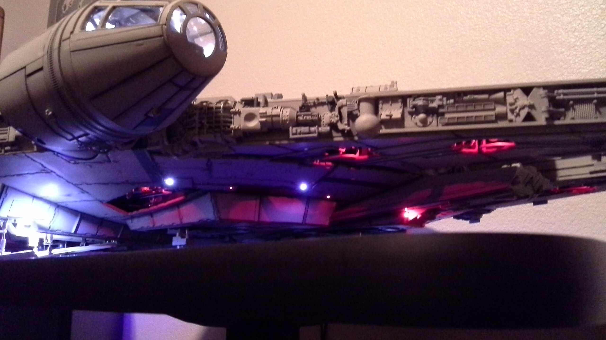

You can file a claim with your payment company for fraud to get your money back and build your Falcon with your own lights. Taking money for a product and not delivering it is fraud plain and simple whatever the excuse is. I've heard other people complain about his lack of communication and slow shipping which prompted me to avoid purchasing one of his kits for my own build. Here is a picture of my completed Deagostini Falcon which was built with nothing from Chris Holland.
