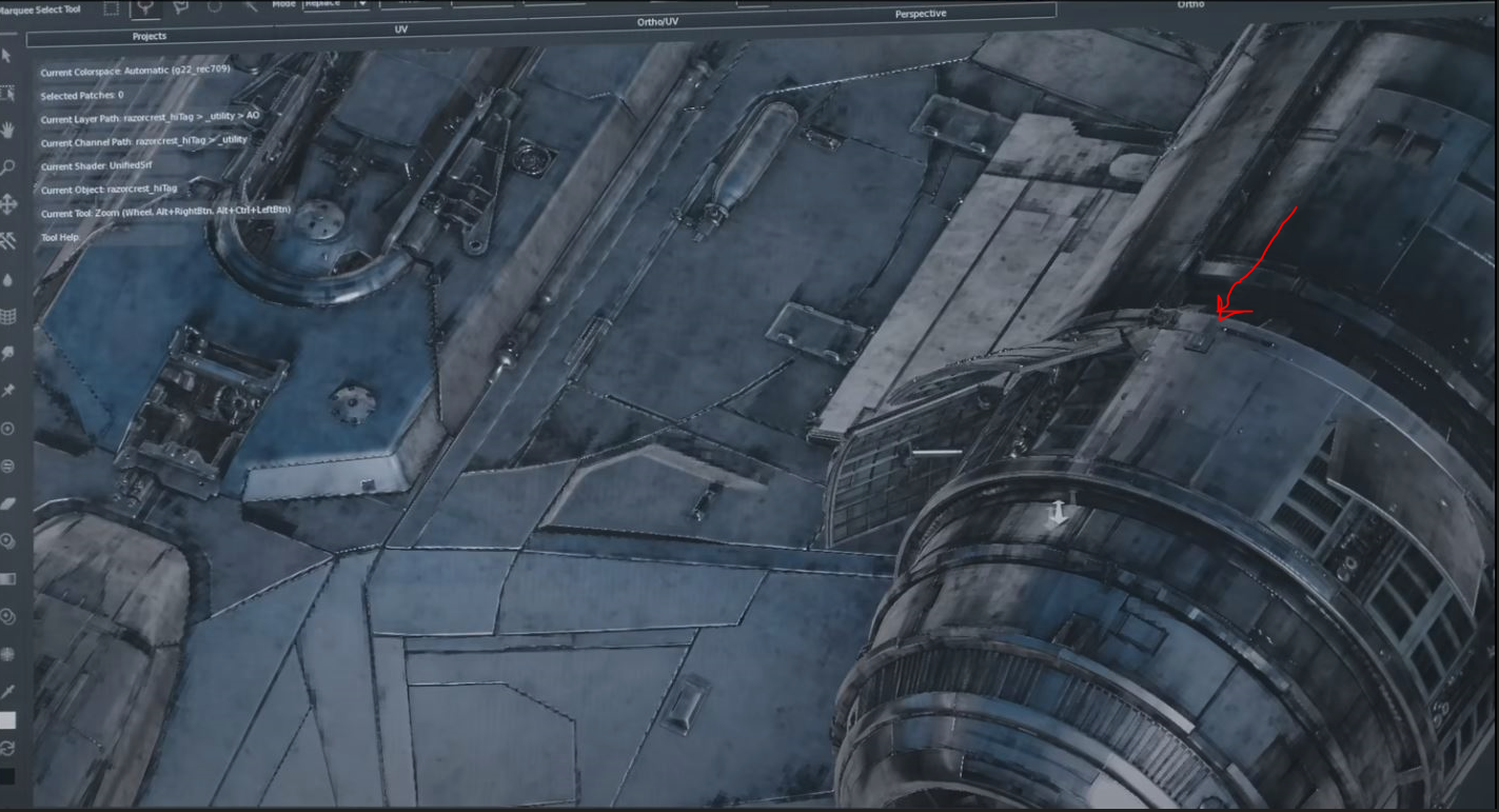

I wanted a decently lit cockpit, nose and engine navigation lights and of course engine lights.

I knew the forward navigation lights would be an issue to wire once the cockpit was in place so ran 2 fiber optics back to a 3mm LED and fitted them to the forward panel.
