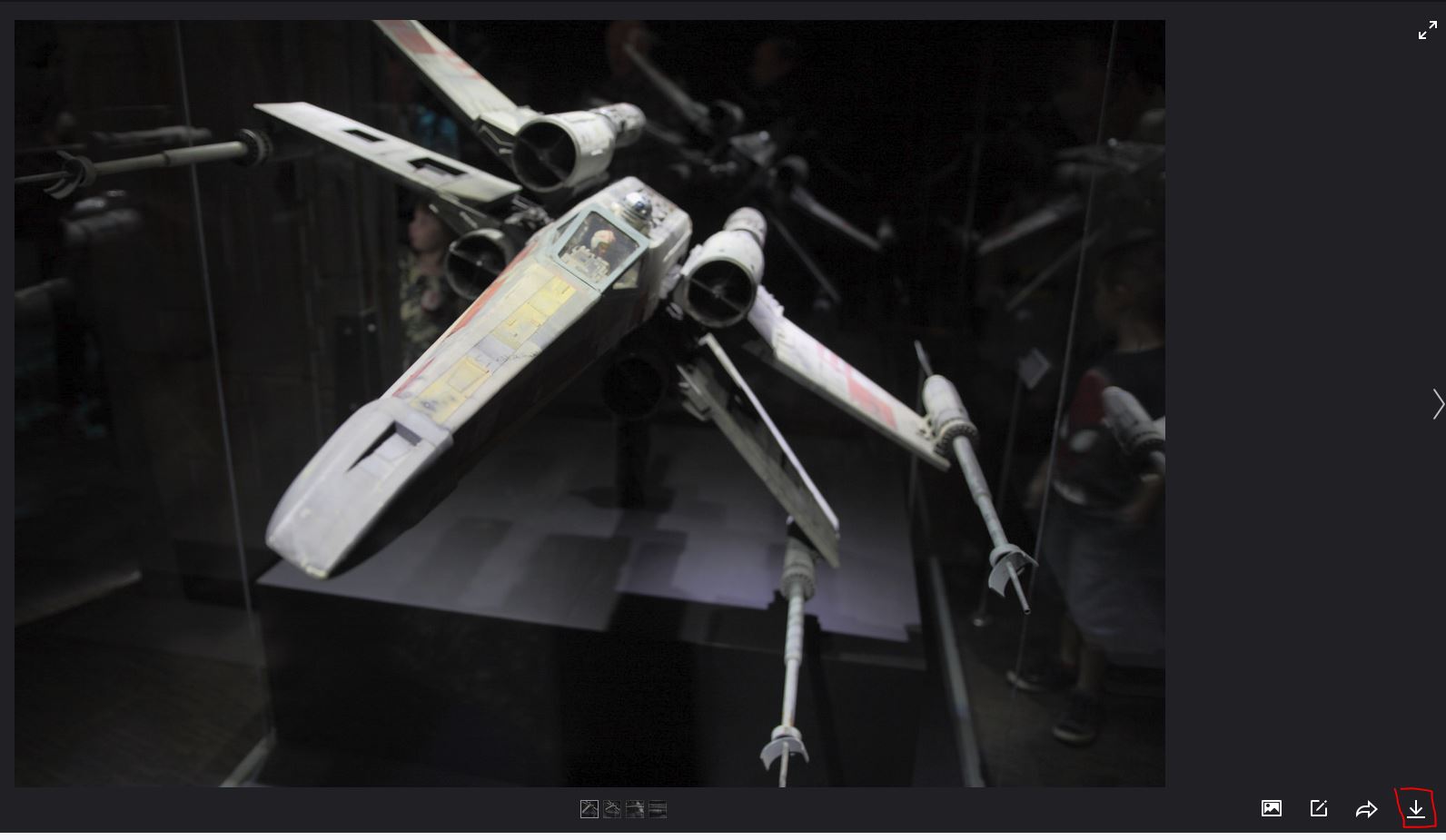

Hey mktodd, great photos of the ANH falcon and much more! Any way you can set your Flickr account to allow downloads?
You should be able to already
If you look in the lower right corner there should be an arrow that downloads the photo when you click it..

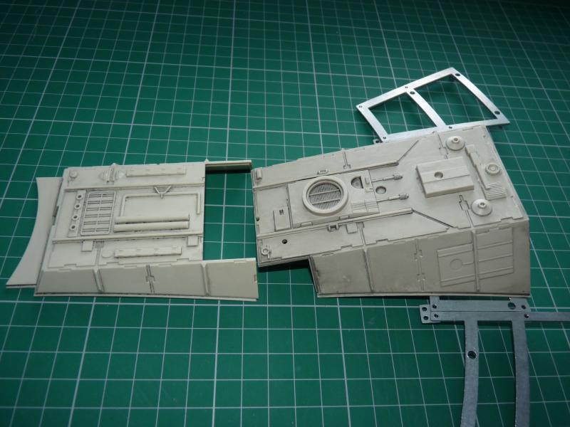

The two panels I've had so far.....the second one on the left is much lighter than the first, not a problem as I'm repainting them all but for anyone building it as it comes it could end up looking like a patchwork quilt....

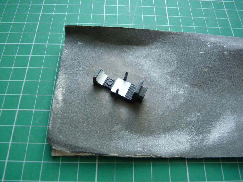

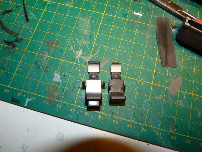

The rear passenger seats were sanded lightly on the backs to level them off....
One simple improvement is to sand the headrests to the shape seen on the real thing...I also removed the boxy plinth under the seat....the arms looked too high to me so I cut them off, sanded them thinner, then repositioned them...

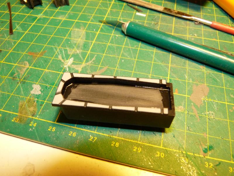

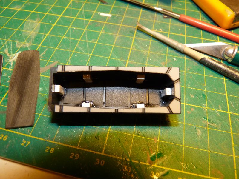

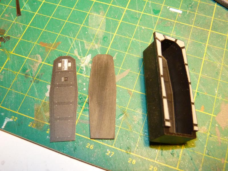

The cabin door is way too deep compared to the set....I suspect this was to allow DeAg to position the lighting module away from the bulkhead as it attaches to the back of the door....I used the sticker (still on it's backing) as a template to fabricate another door from styrene sheet....
Small sections of styrene strip were cemented inside the doorway to act as supports for the new door....am I the only person that thinks this part looks like a coffin?
The new door cemented in place....the sticker will be applied once I repaint the door surround....

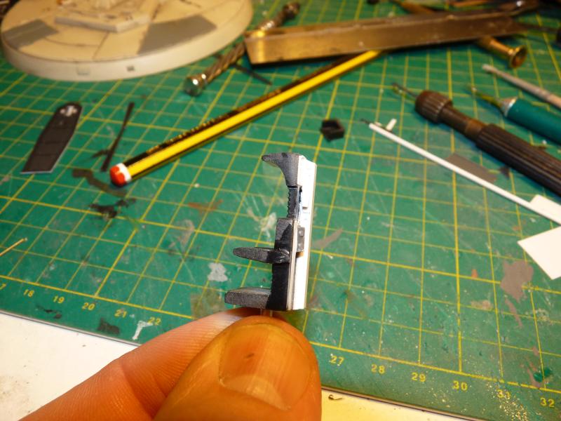

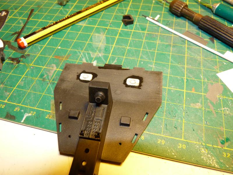

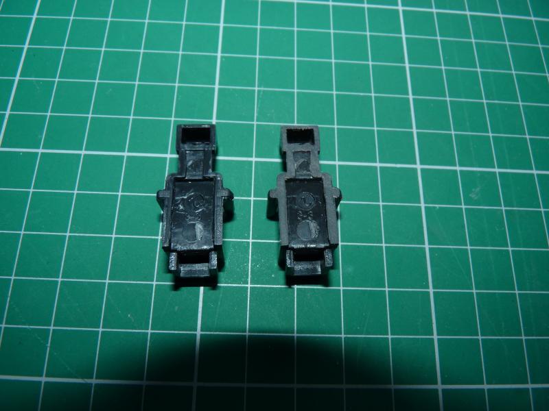

The locating blocks for the rear seats were removed and replaced by a simple styrene plate with a thin section of aluminium tubing to act as a socket...

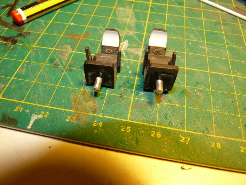

The rear seats had a column attached to the underside made from styrene rod and aluminium tube...

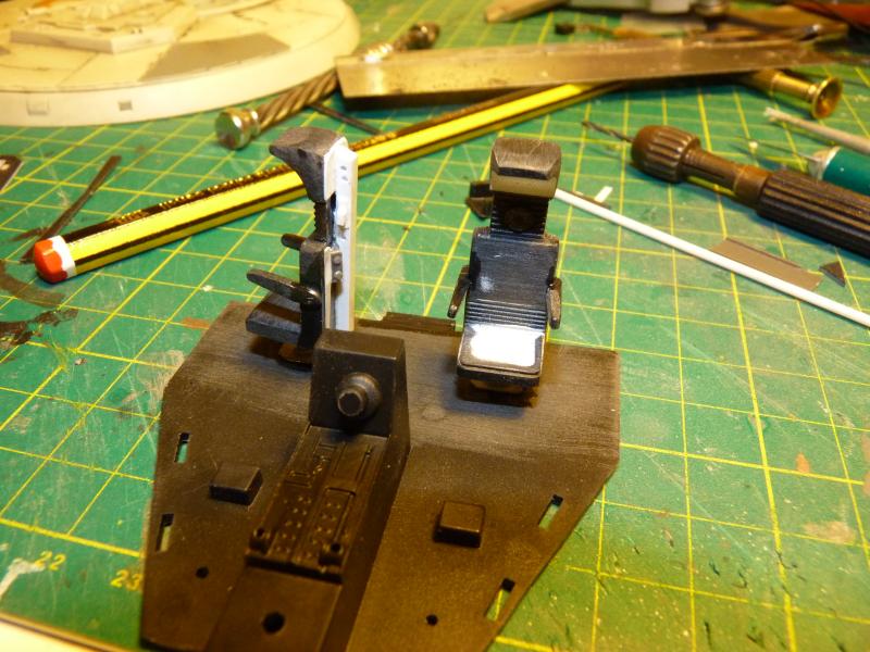

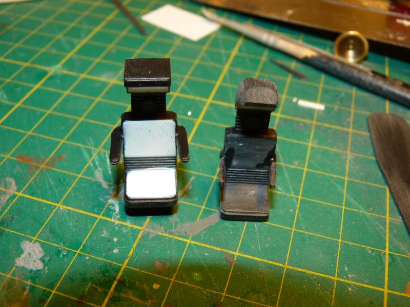

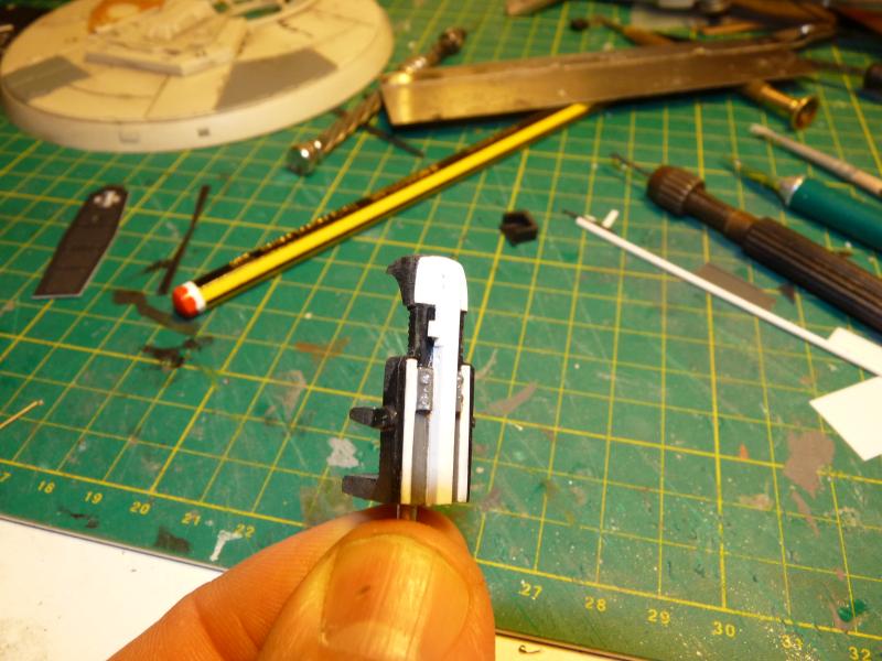

One seat was detailed on the back with styrene strip and rod to replicate the ones used on the set....
Seats placed in position...having one facing the side console adds some animation to the cockpit....
