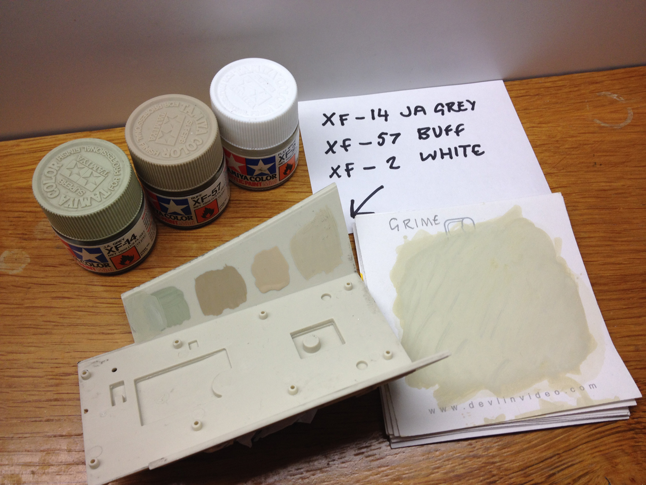

As I live in the UK the only access I have to Floquil "Grime" is a sample I made on holiday a few years ago (they don't like you taking paints on planes!). I've been playing around trying to find a mix with Tamiya flat acrylics. The raw plastic of the Deagostini parts seem to be a fair match for Grime.
My closest bet in Tamiya is:
33% FX-14 JA Grey (gives it the green hue that Grime seems to have)
33% FX-57 Buff
33% FX-2 White
In the photo you'll see several swatches painted on the hull part, they are in order:
1. JA Grey + white and JA Grey undiluted
2. Buff
3. Buff + white
4. My mix of JA Grey, Buff and white.
I wish there was a simpler answer Vacformedhero!!!!!
Thank you GrahamT that is excellent and seeing Floquil Grime sample next to the deagostini part shows how accurate it is, I can use the parts I have as a guide for my hasbro .
