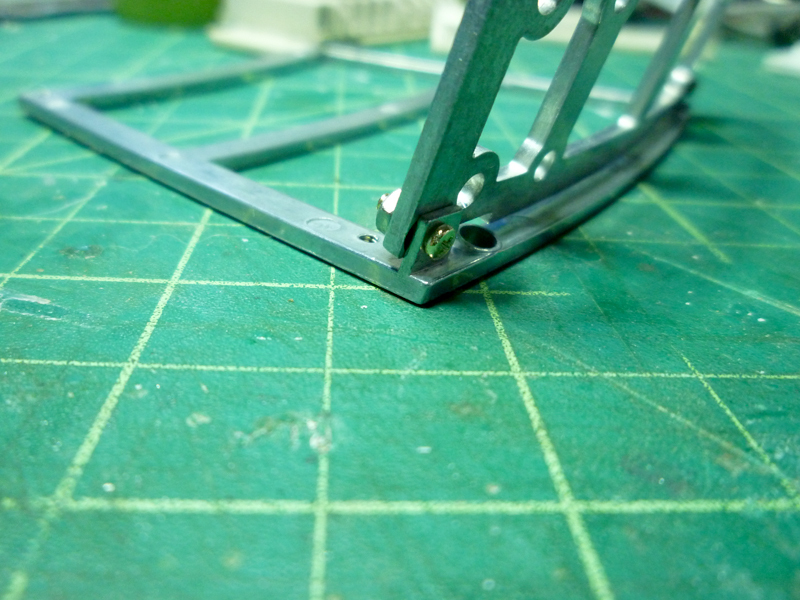

I never found how anyone else did it, but here is my approach.
I've collected many extra issues along the way, so I have extra parts, screws, etc. to experiment with.

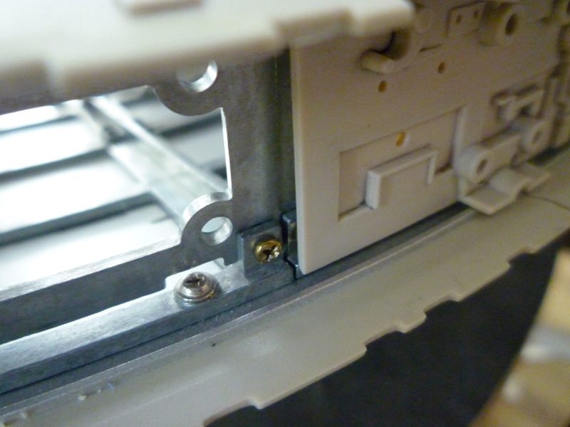

My first test was using the longer, fine thread screws used to connect the rib sections and to attach the mandibles to attach the side frame parts on the INSIDE of the tabs, instead of outside. I also backed it up with a nut.
I attached the side frames all the way around with no issue, The only structural mod at this point was to grind back about .5mm from the end of a couple of the ribs to make room for the nuts.
I gained about 4mm in depth.
I still have to pull out the rest of the side panel parts and test fit them all. The first two I've tested worked fine.
I still need to remove the 'lip' around the edge,
The only other mod I may have to make is to shorten the outer most vertical edges of each side panel to compensate the circumference change, but it’s not much.
I have yet to see what's going to happen where the sides meet the mandibles and cockpit tube.
I found these parts on Shapeways to help finish the edge. DeAgo Millennium Falcon sheets for side panels mod by bluevoice on Shapeways

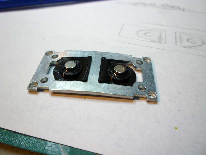

I also 3D printed some magnet clips to help attach the panels, sans glue.

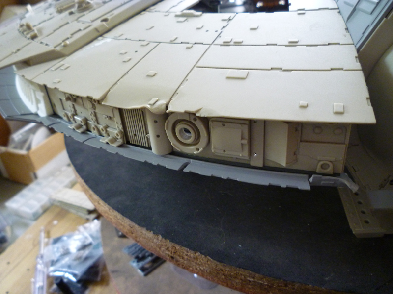

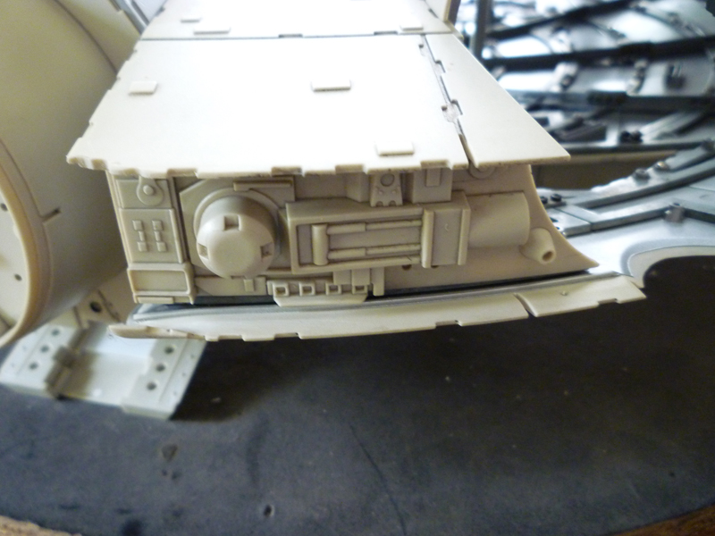

Further testing. Still looks workable.
The 3D printed edge trim will be in Monday. I'll determine any final adjustments then.
As David3 mentioned, I could gain up to another 1mm by trimming back the mounting pegs on the side panels.

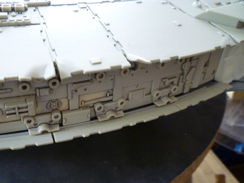

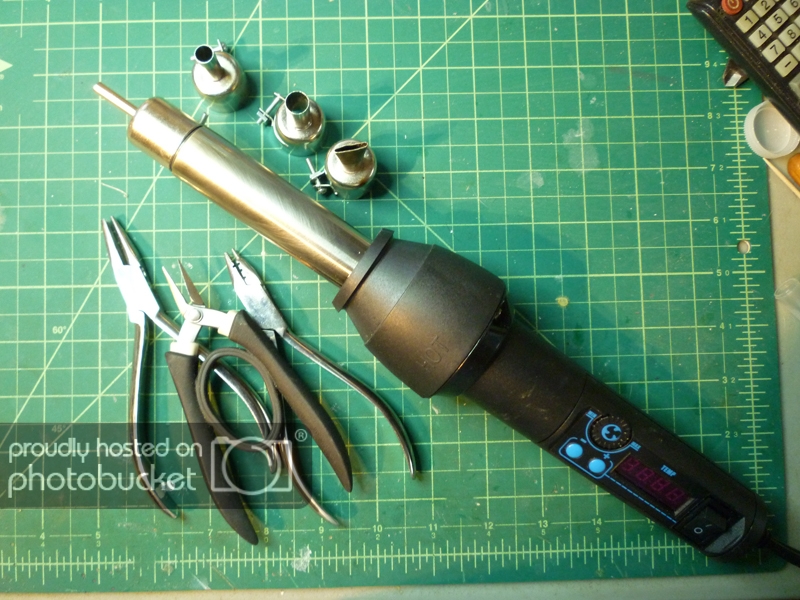

Oh wow! That must be nerve wracking distorting the edges. Did you use a heat source for this?
Yes, I used something called an SMD Rework Station.
It's a mini heat gun used for desoldering surface mounted components from circuit boards (I think). It can go up to 480c and has various tips for directing the adjustable air flow.

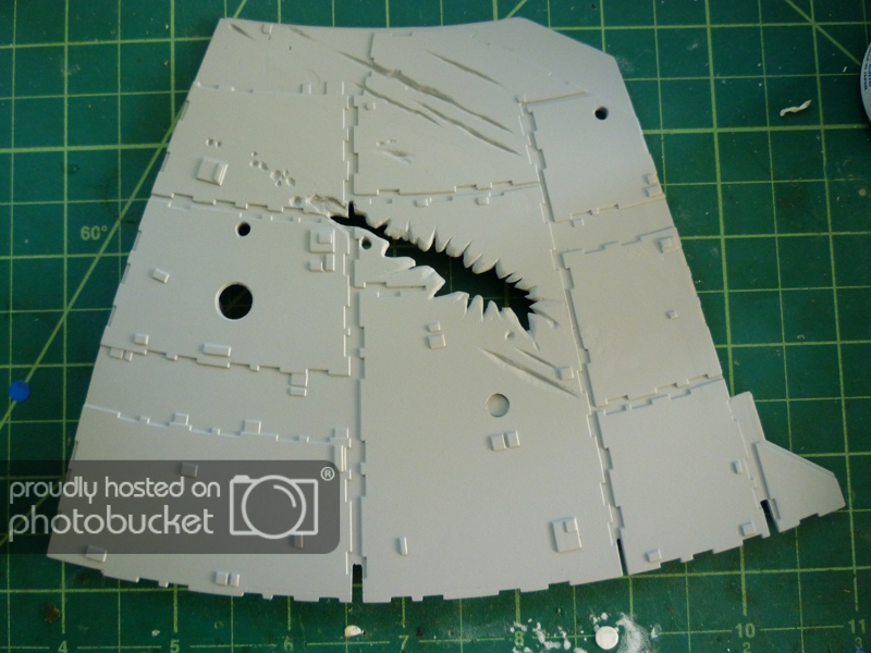

I've been upgrading any damage to the level of the Hero prop.
I realize the 32 inch prop did not have those 'dings', but the 5 footer does.
The Heat "gun" is a cool tool. With a mini attachments. I have the Dremel VersaFlame But it doesn't have a small attachment that that can be use for a small dent. Thanks for the tip. And nice work.
To be clear, the last photos were just examples of the damage 'upgrade' I referred to.
I did not use the heat gun for those details. Most of that was with a Dremel.
I only used the heat gun on the bent edges.
