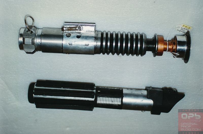

If it helps, I'm 90% sure they used double sided scrim tape to stick a circuit board on - not to screw with you this late lol
so what we see is the cross-stitch of fibers in the tape that was left over, or some kind of adhesive
MCM
That would make A LOT of sense. From the pics I've seen, it definitely looks like some kind of adhesive tape residue stuck down in there; I thought it was some kind of bungled up foil mesh tape or something. Funnily enough, I've seen this picture and have it on one of my hard drives, but I was more focused on the shared stunt and totally glossed over that circuit board. I can totally draw up a new one this evening.
