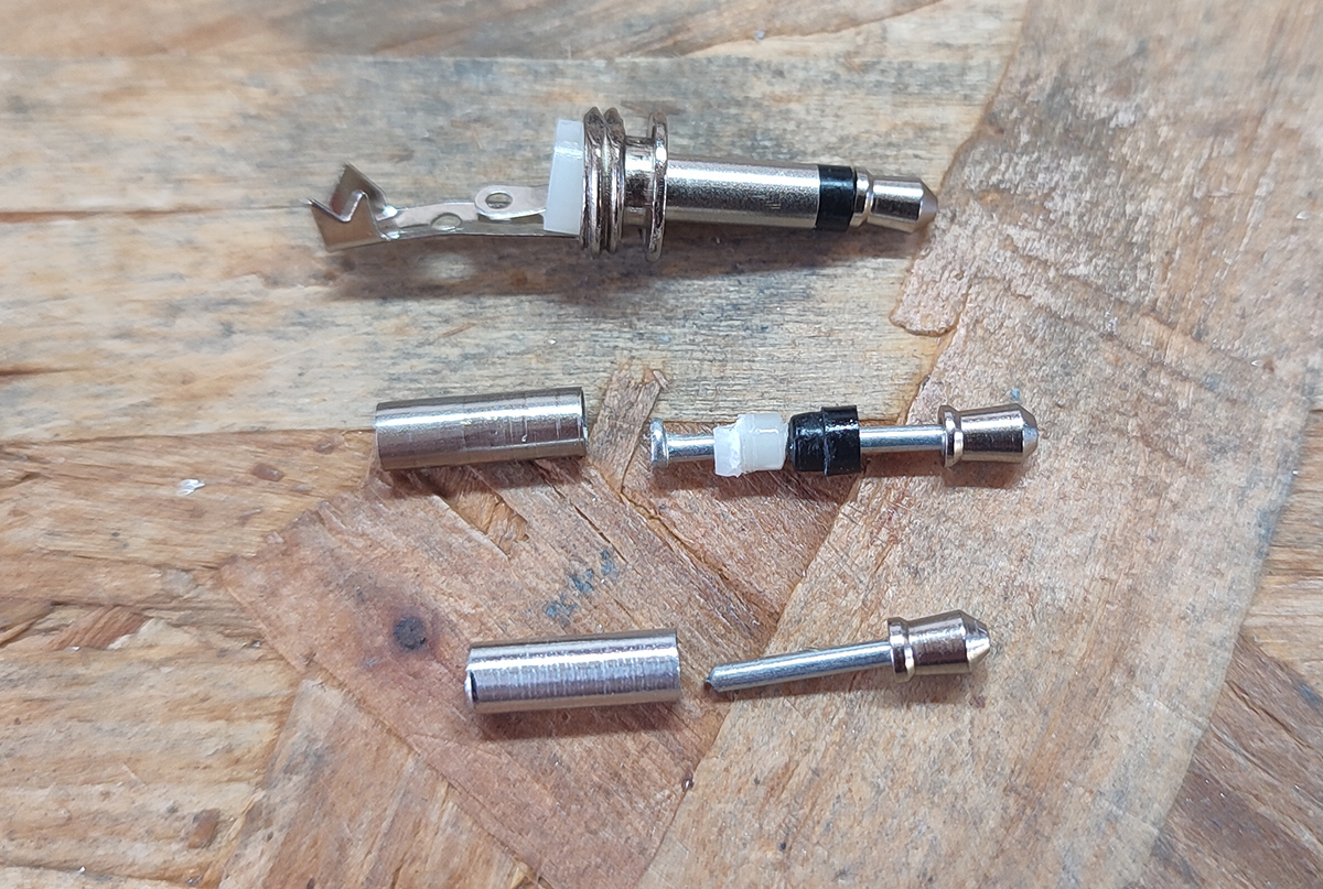

I said I ordered real 3.5mm jacks for the tip of the scope, well I received them and it's not working. It really looks like they used this as the shape and size are the same, but doing a run with those is not going to work.
When you disassemble the jacks, they fall appart, so it's not really doable to reattach them to our scope tip.
I have tried below, I replaced the thin sleeve in the middle here with a turned aluminium rod with a hole in the center, it takes a lot of time and I'm not super happy with the result in the end...
this is the result, it's a lot of work for a 2 part thing that looks like it's just one part on the original:
so, this was just a waste of time and money sadly, just got excited for a minute when I figured out it was most likely a jack, but I'll just turn those entirely from aluminium, it will be a better result and easier to assemble:

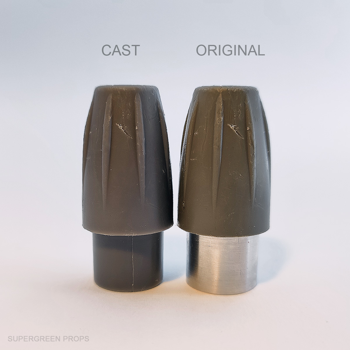

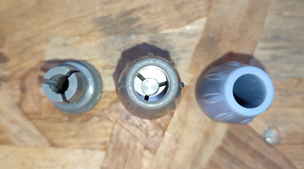

first cast of the Vacuum cleaner part, they look awesome, here with an original, either on the left, or on the right, ahah! it's like holding the real part!

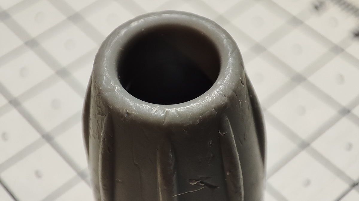

the inside detail came out great as well!
here you can see the original injection molding mark:
the printed part was a real adjusted fit with the RO-72 front sight, those ones will require a bit of glue to hold nicelly, I tried to anticipate the proper size for a perfect fit, and especially didn't want something that would need to be sanded, but those are a nice fit to the sight, but won't hold in place without glue.
once again, a huge thank you to Wonderknight for her amazing castings!
there you go! really cool added realism to the kits, it's not going to get any more authentic that this I think, really happy with how everything turned out :)

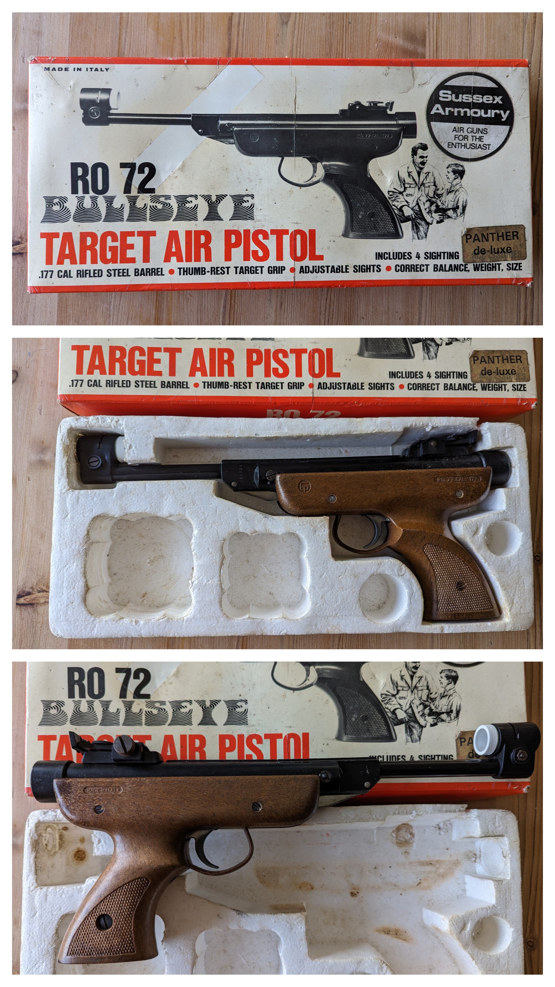

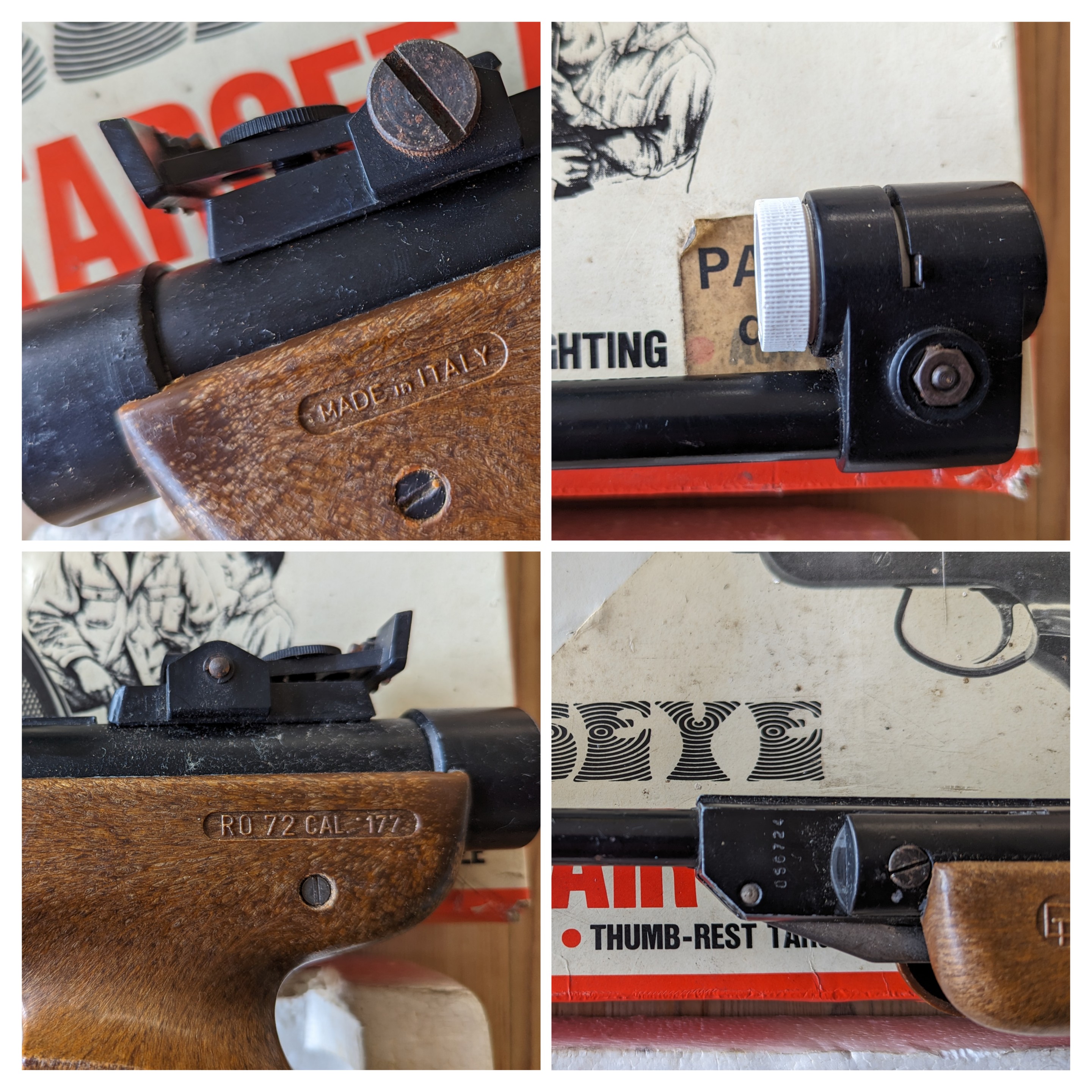

If anyone is interested I have an excellent condition RO72 for sale.
I've owned it since new and still have the box - check out the photos.
Easier to ship within the UK, but if you're in the US I'm sure there's a way.
I'd love to see it converted to a DL18 so let me know.
You should probably create a sale post and not hijack this thread - but I've had success sending these to the US now. So when you create a listing, I'm happy to share the secret :)

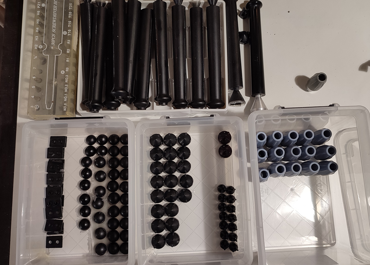

I have spent the last couple days cleaning up thoroughly all the cast parts, removed all the flashing on the bases, sanded them (more) flat and polished the missiles to get the same shine as the original parts :)
I don't usually offer resin parts, so, please rest assured that my wife and I both made sure that those were the best resin parts possible and i'm really happy about the kits!
same here, removed flashing, sanded flat on the base and glued the jacks with a tiny bit of superglue

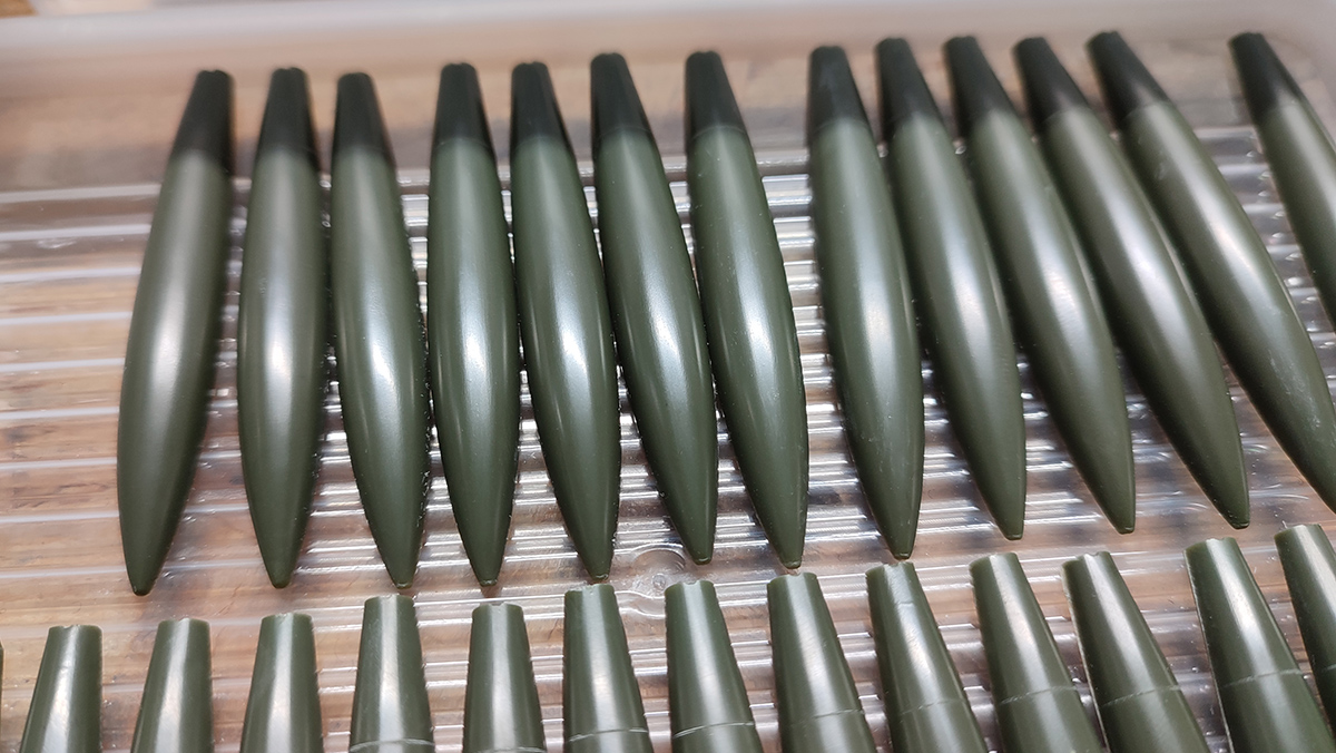

color matched as best as possible, cleaned up, polished missiles :)
