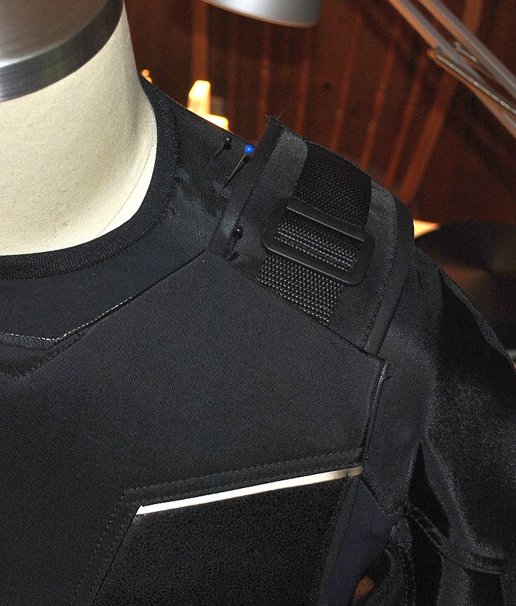

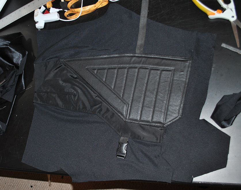

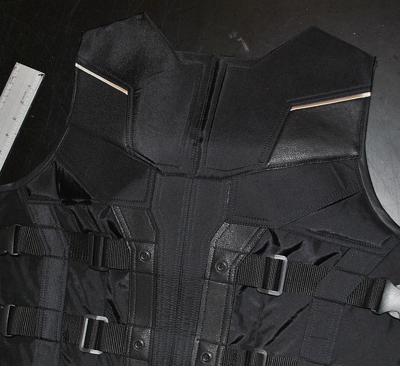

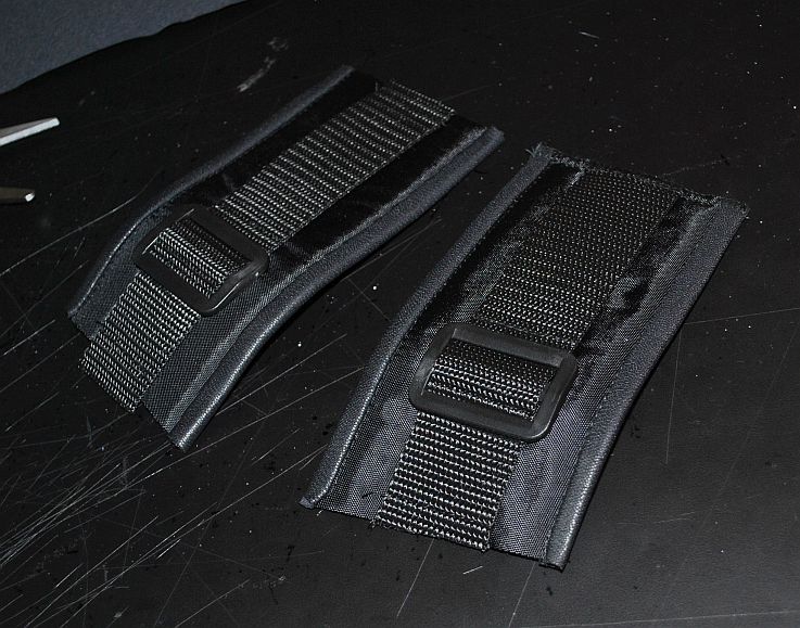

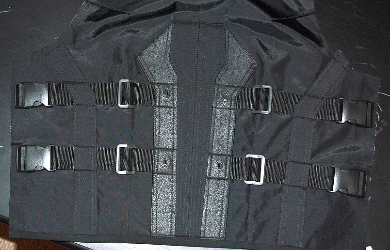

So, continuing on Bullseye where I left off, the next step on the vest was to add the the lower straps and the padded chest plates.
The straps were next. These were lightly padded with headliner foam and decorative webbing and tri-glides were sewn to the top. These were then attached to the front under the chest plates.

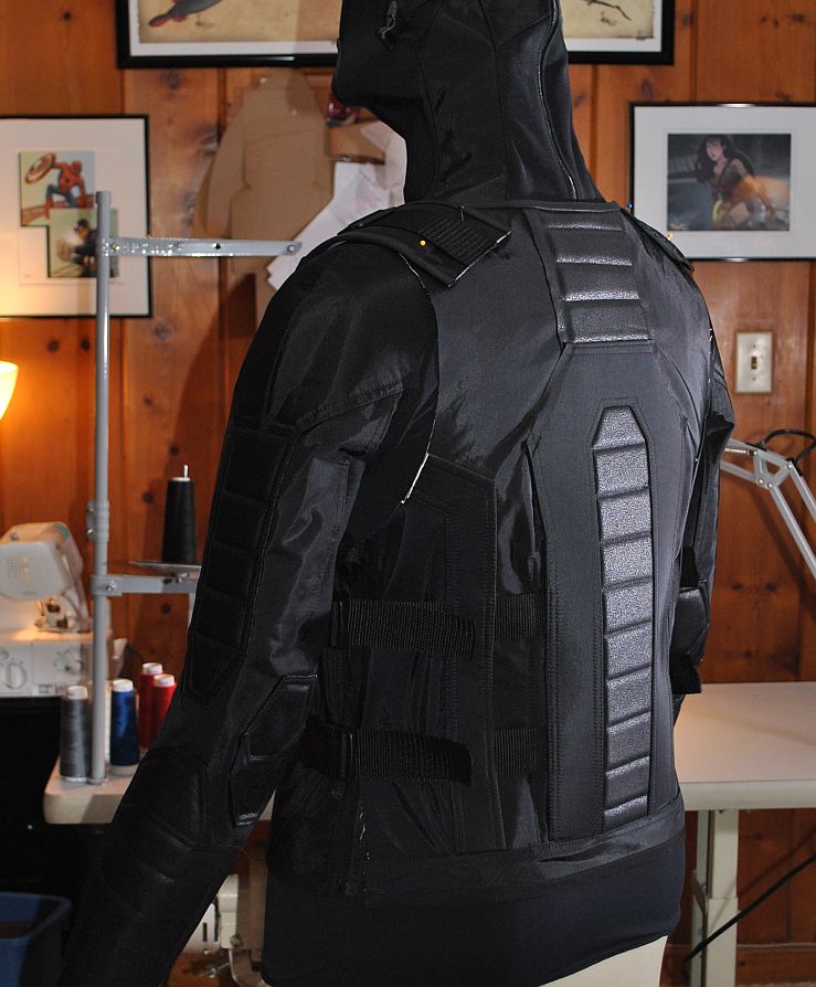

To complete the vest, I built the back. Though there are no pictures of the build process for the back, it was done in the same manner as the front – a lined cordura base with the details built up from headliner foam, 2mm craft foam, cordura and faux leather.
The image below shows the vest before the shoulder blades were added. Once complete, the back was attached at the shoulders and side zippers were added.

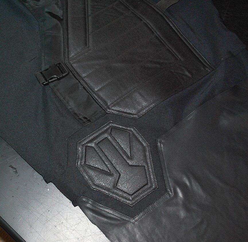

Once the top of the costume was complete. I moved on the the pants. The pants have faux leather details that tie-into the vest, cordura panels with angled seam lines, feature stretch panels in the crotch and lower legs and have elastic straps and clips around the thighs as in the source artwork.
