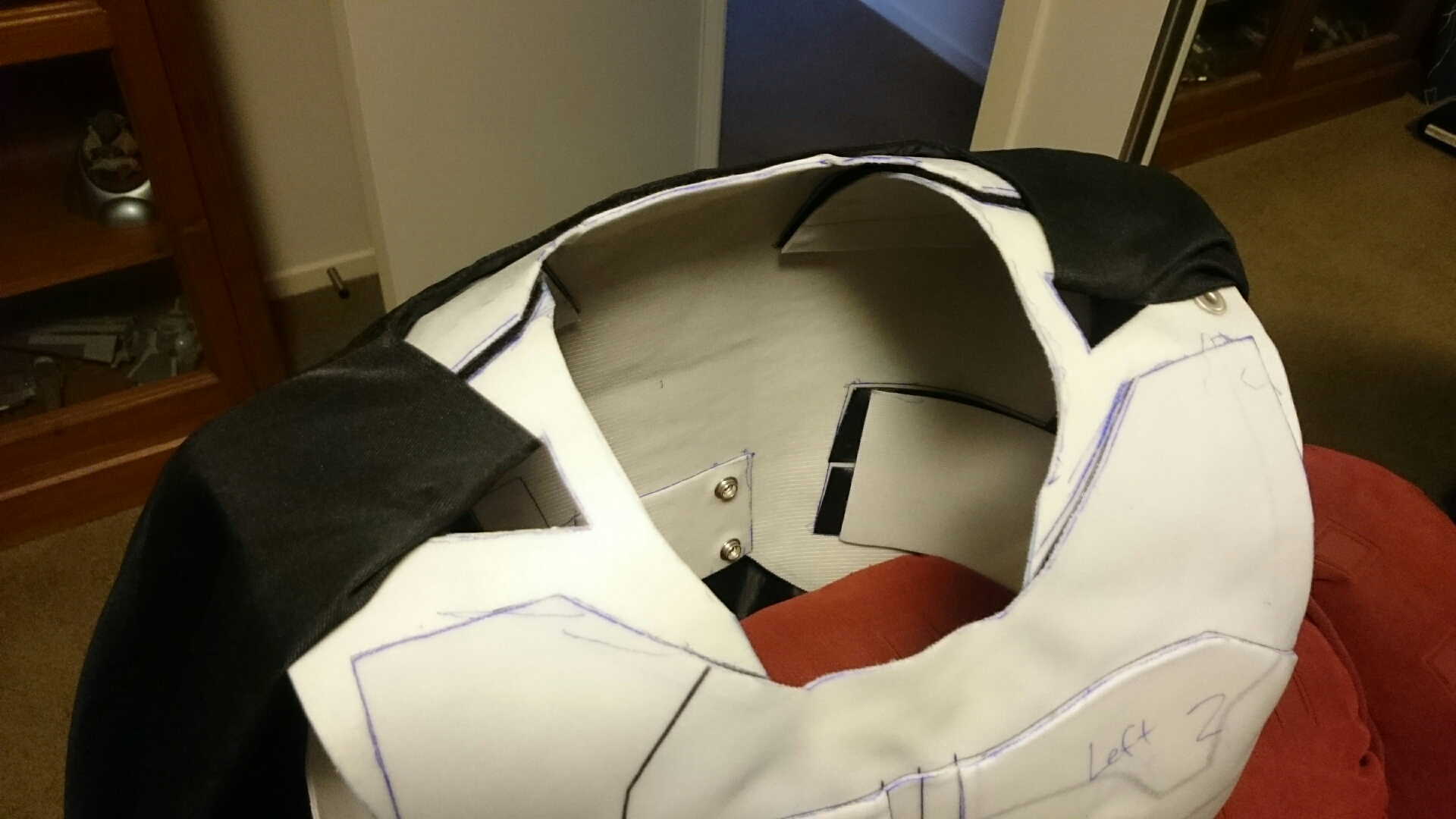

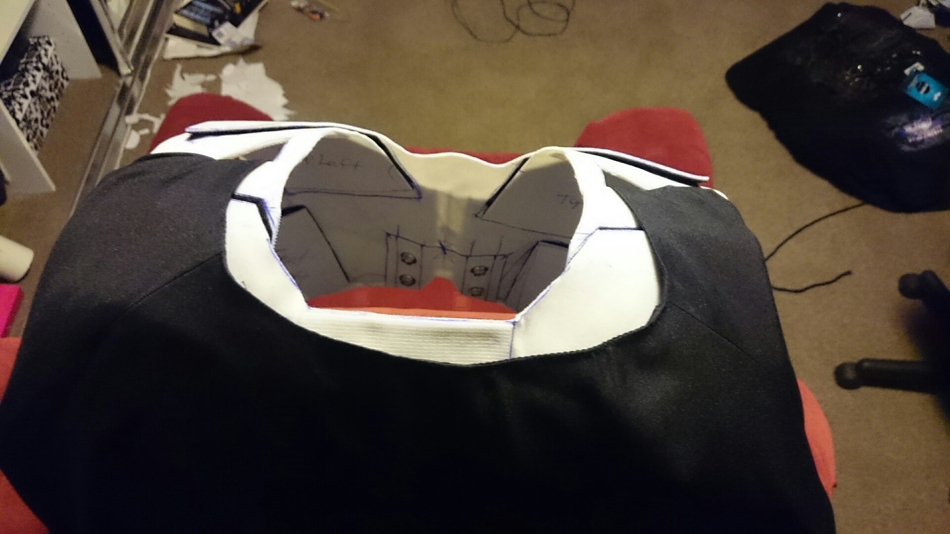

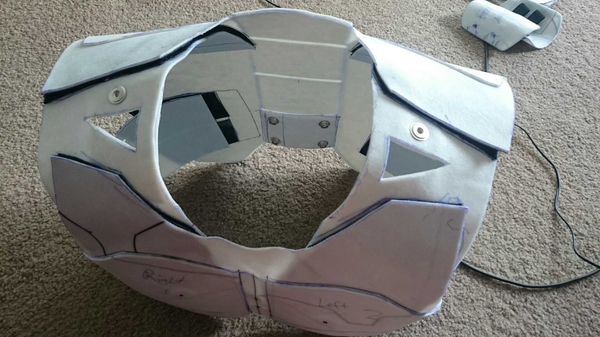

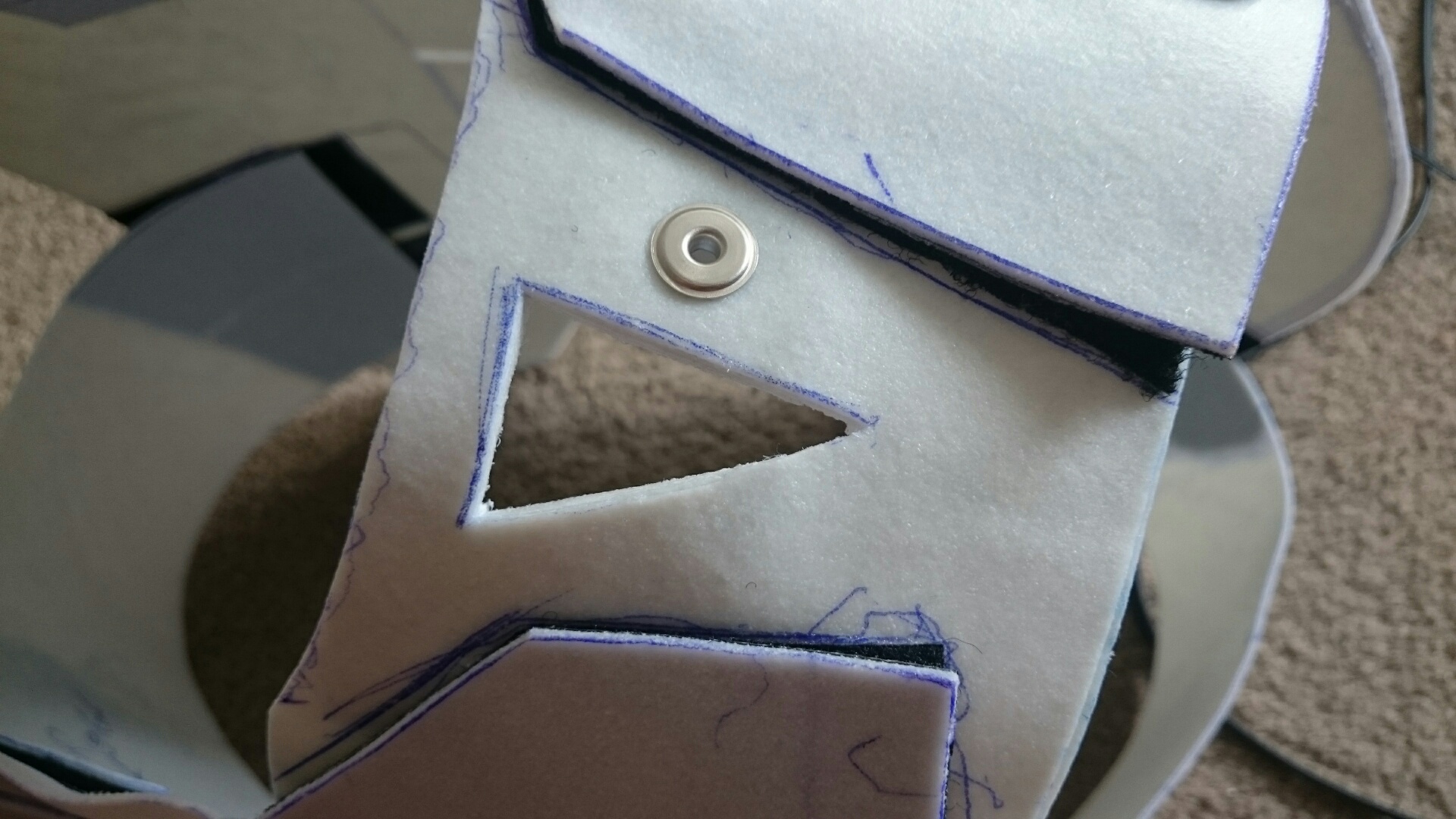

So, I added slits and snaps in the top of the torso part so that the cape can be inserted into the torso armour and snap to the underside.
It worked really well, although I did have to reinforce the straps a bit because as you can see, that hole is pretty big and it didn't leave much in the way of structural integrity.
So, that's the first thing I did.

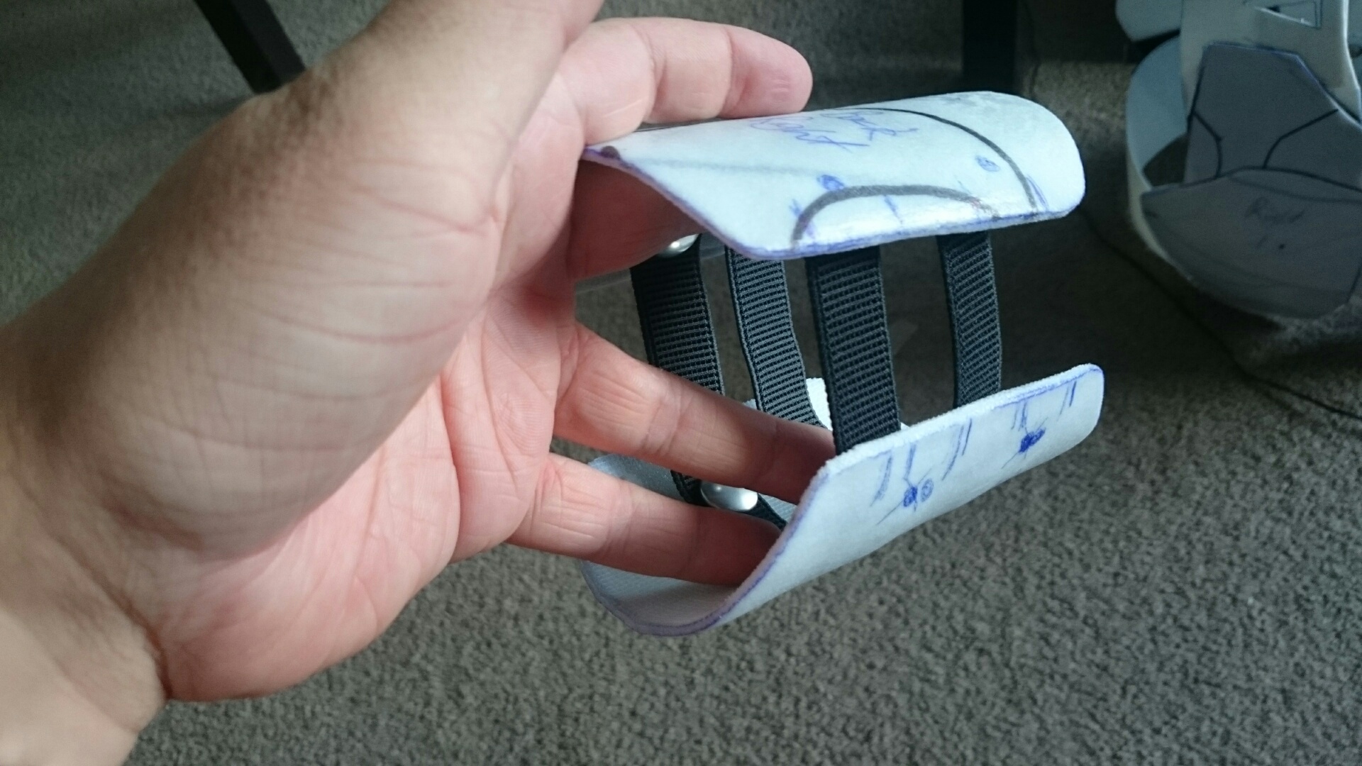

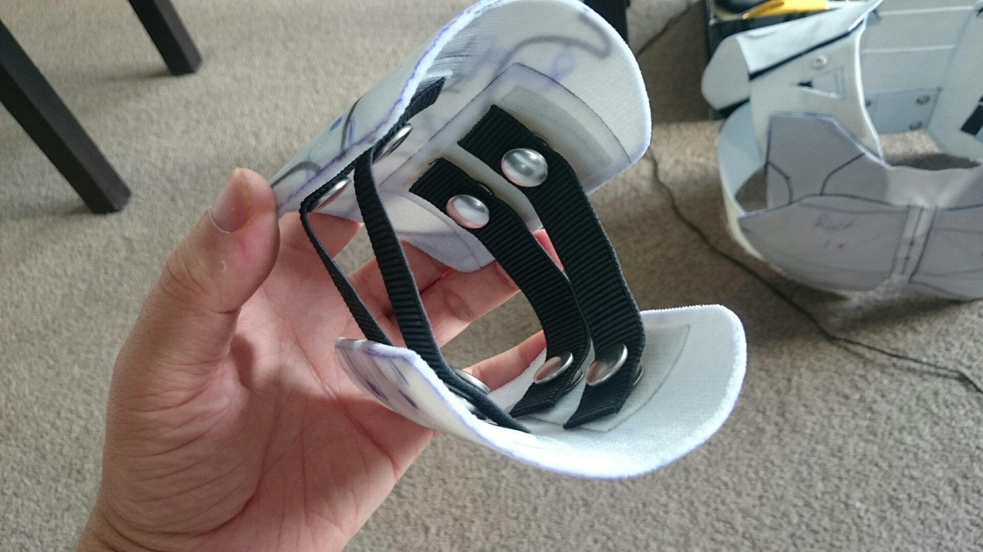

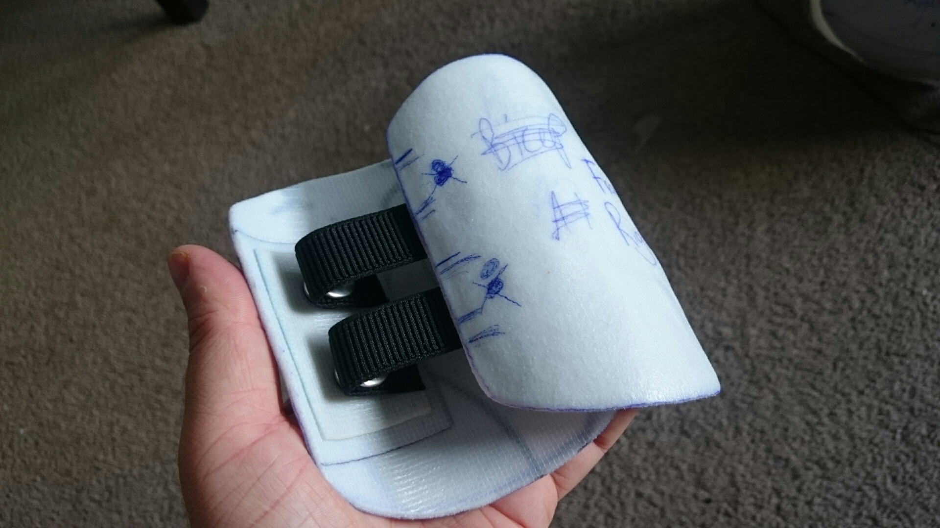

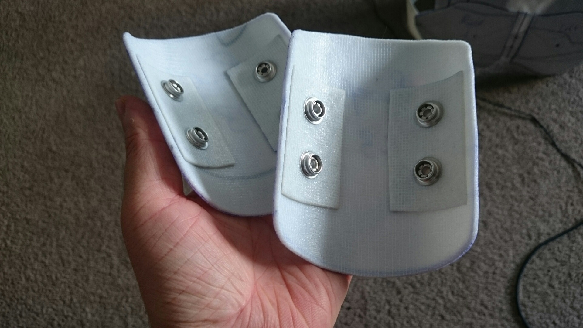

Then, I finally did some work with the fabric side of things, installing snaps into some short elastic straps to finish off the bicep pieces. I wasn't sure how to attach the biceps to the rest of it, but luckily I didn't have to. The elastic is just tight enough that they actually sit perfectly on my arms and don't need any other attachments.

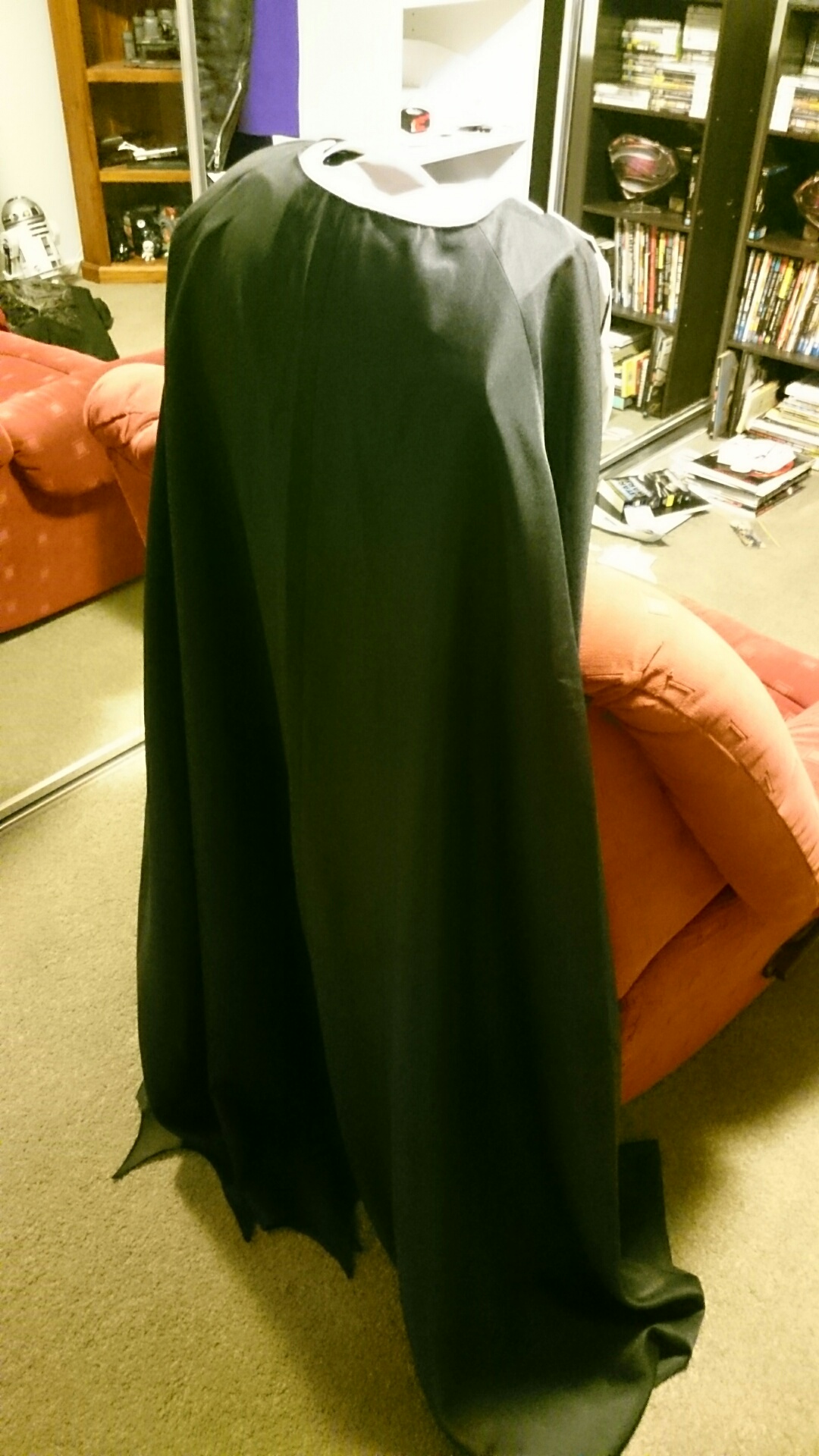

Ok, I've got a few more photos!

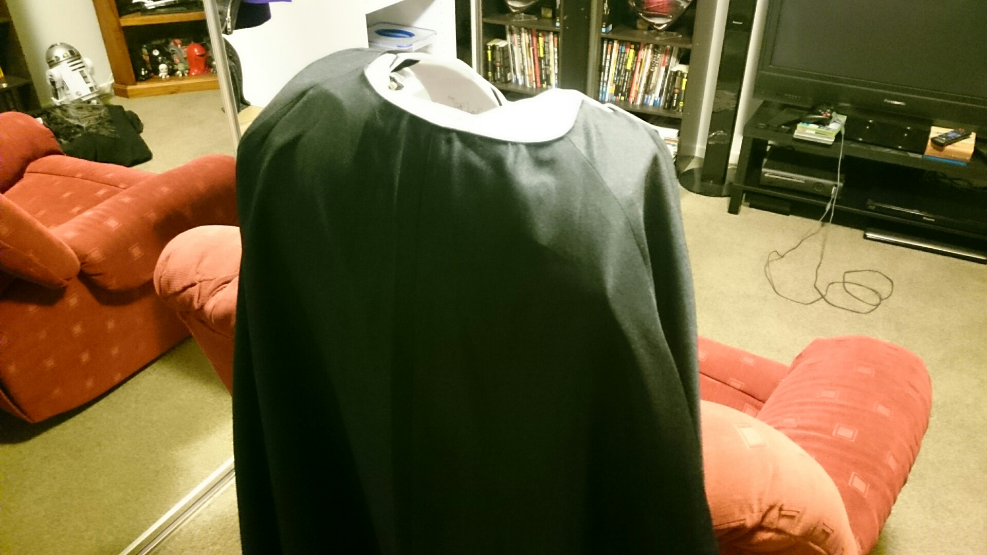

So this is how the cape hangs and how it looks attached to the suit:
Cape Back 01.JPGCape Back 03.JPGCape Back 02.JPGCape Front 01.JPGCape Full Back 01.JPG

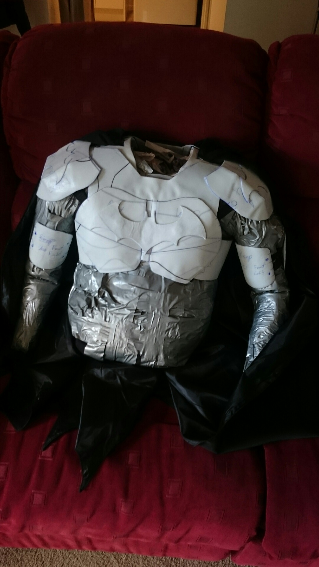

And this is how the shoulders and biceps all fit together with the chest/back piece:
It looks a little crooked there as the mannequin is kinda lumpy and not really a proper "human" shape haha...
But it fits me perfectly, and I'm really happy with it!

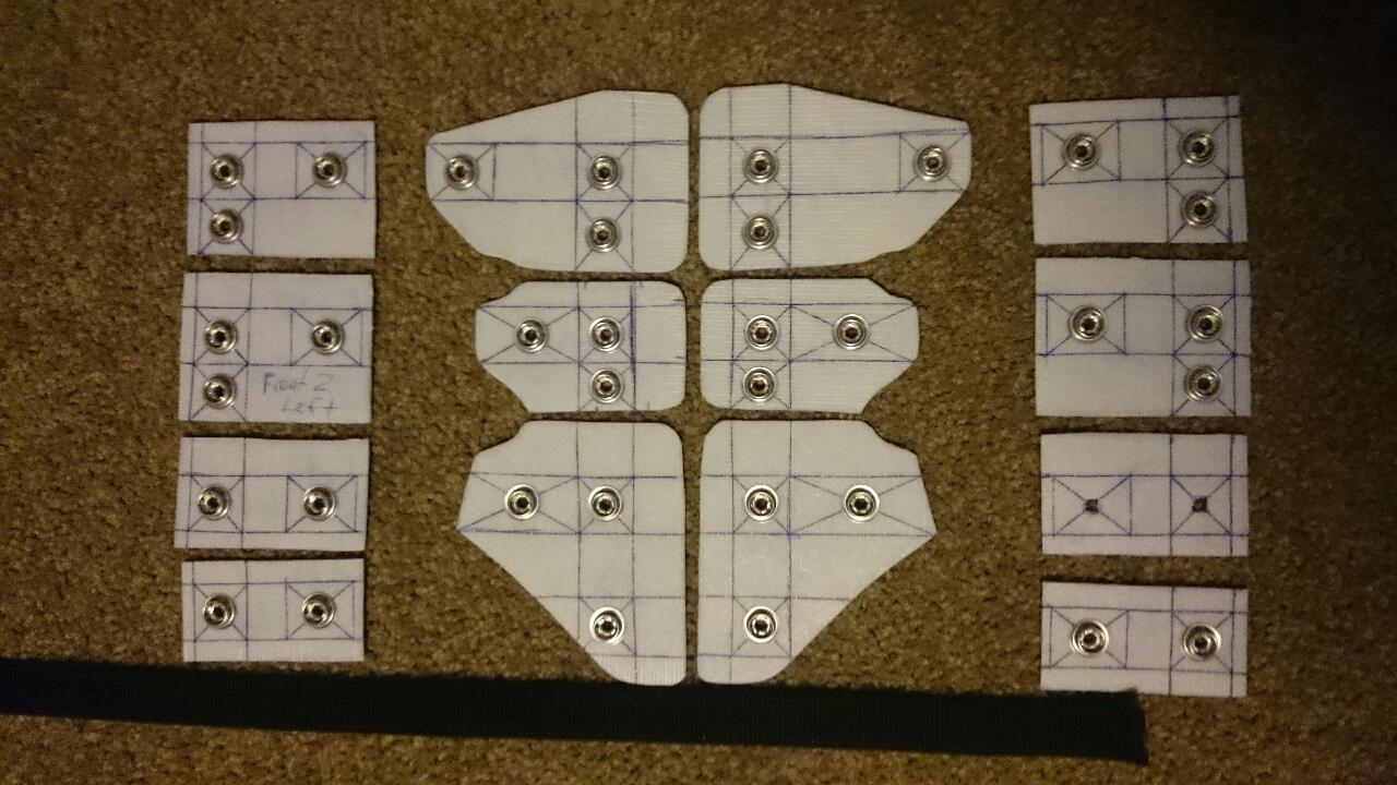

Hey everyone!

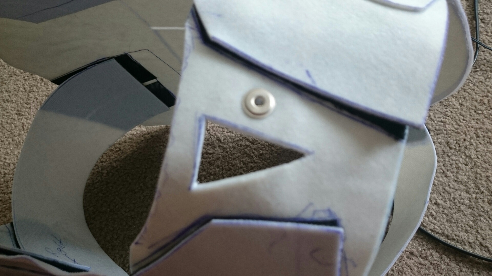

Just a quick update, I've completely built the ab pieces with embedded Chicago screws, but I can't find any eyelets that fit them and also the rounded heads of the screws warped the wonderflex a bit so that you can pretty clearly see where the screws are installed from the outside of the armour.
Basically I'm going to leave them for now and maybe come back to them later, but in the meantime I'm going to build a new set of abs but this time they'll have the snaps installed as they're easier to install and are actually invisible as they have flat heads.
Also, I've started work on the ribs, which is the last piece of actual armour I need to work on. After this I'll just need to sort out the elastic bits that the mid section armour pieces will be attached to, and then I can paint everything. So it shouldn't be long, but the Chicago screws fiasco delayed me a bit.
For the ribs, I've designed fairly boring rectangular shapes, two columns and four rows on each side, I'll post pictures when I've got them finished.
It's all coming together, albeit a little slower than I would've liked, and it's good I don't have a specific deadline!
Thanks for reading everyone, I'll hopefully have more progress pictures for you soon!
Haha, I'll get pictures posted once I've made enough practice, for now everything still looks more or less the same as it did before, so I feel like pictures are kind of useless at this point.
Unless you'd like to see pictures of how crooked the new ab pieces look with the Chicago screws in them? :p
I should have the new ab pieces with snaps done within the next few days as well as the rib pieces. Everything that's left to be done is quite easy, but very time consuming, so it should be slow and steady progress from here on out.

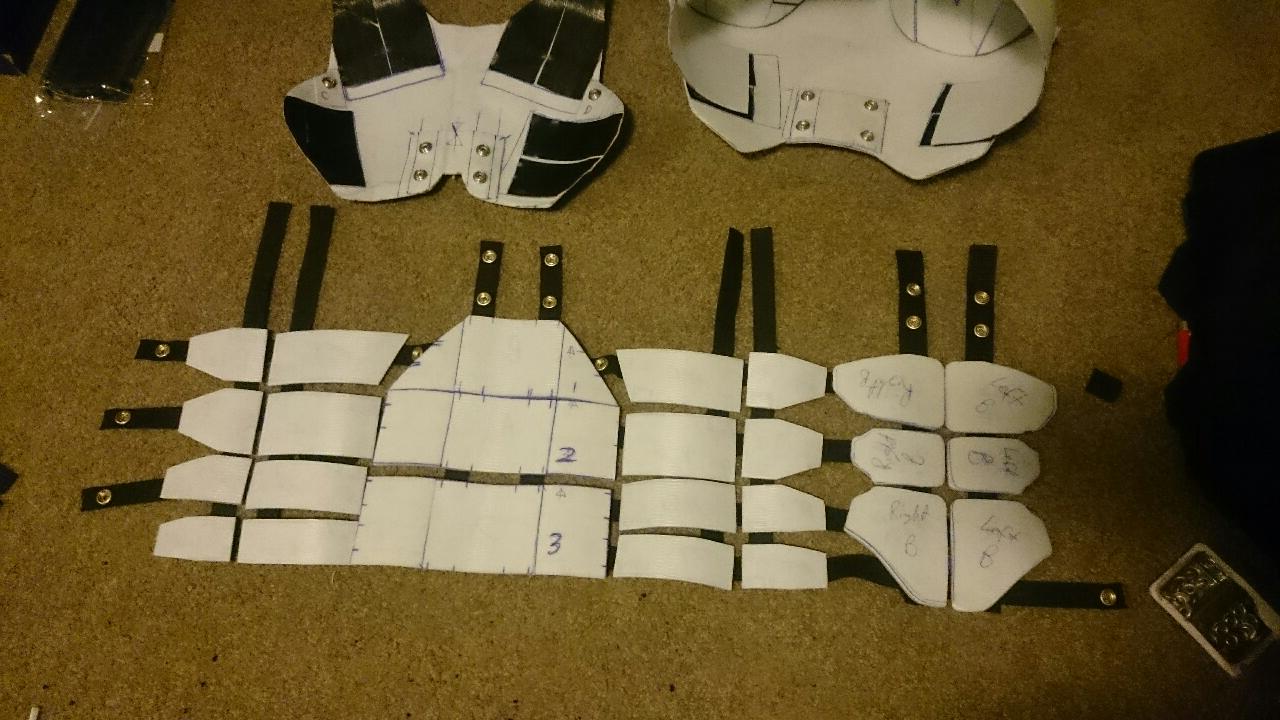

Mid Section - Finished.JPGMid Section - In Progress 01.JPGMid Section - In Progress 02.JPG
That first photo on the left is the finished mid section. I built a harness out of elastic with heavy duty snaps holding it all together. It took ages because it was a trial and error process, and I made quite a few errors to be honest haha. Finally, though, it all came together and is looking like an actual suit of armour. I basically just need to add a few more snaps for extra support on the sides, and then it will be ready for painting. Once it's painted, I'll just need to finalise the other parts (like adding attachment snaps or buckles to the gauntlets and such), and I'll have a complete batsuit!

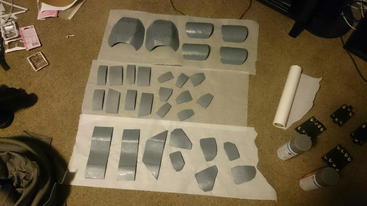

OKAY!
Another update, and I'm getting ridiculously close to being 100% finished with this build!

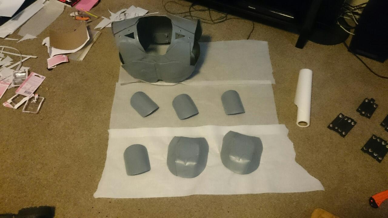

So I've painted most of the armour, the only thing that requires painting now is the two bat symbols I've made, everything else is done:
So basically I couldn't find any flat grey paint, but I realised that there's heaps of flat grey primer, so I just used that haha :\ It worked amazingly well though, it's a nice darkish shade and it's got a great texture to it.
I'll take some close up pictures soon, and I should hopefully be able to post a picture of the full suit relatively soon too!

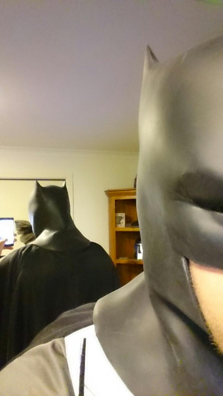

Also, before I painted it I couldn't resist trying the cowl on with the chest and cape. I was a bit worried that the cowl wouldn't cover the back of the neck enough as there's a bit of a gap between my neck and the top of the cape. But it fits really well, and I think it looks amazing!
By the way, that's Rocketeer's Frank Miller style cowl. For anyone who likes it, I recommend speaking to him or heading over to the project runs section, as he has a unlimited run going and this cowl is absolutely beautiful.

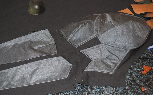

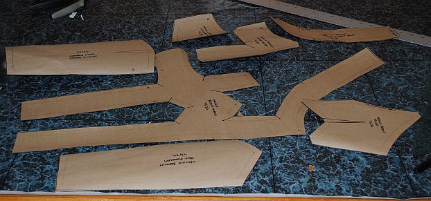

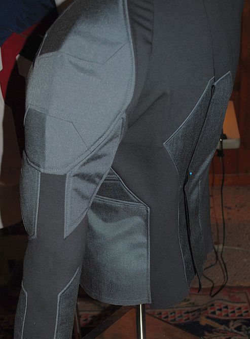

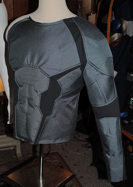

Another quick update. The sleeve pattern has been cut apart and traced onto paper.
All of the Cordura pieces for the sleeves were made first. The biceps and triceps are padded with the same foam as the chest and abs and the forearm pieces are lined with heavy cotton. Once all of those were complete, the stretch pieces were cut and all of the pieces are assembled. Here's the sleeve flat with the shoulder added.
And, the torso with one of the sleeves attached.
Far out Sean, every post just gets better and better!
Those sleeves are amazing! The biceps/triceps blend perfectly with the shoulder, and I love the shape of them!
