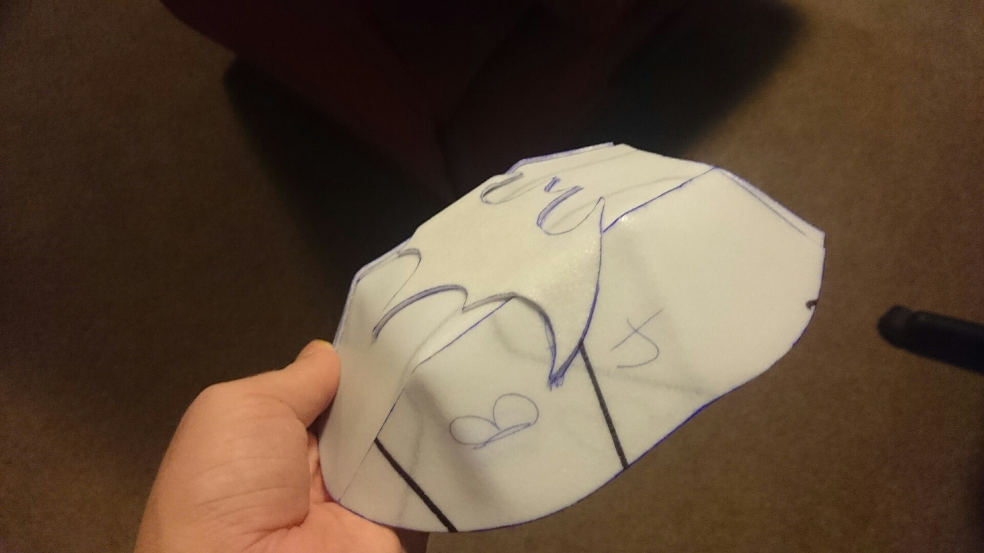

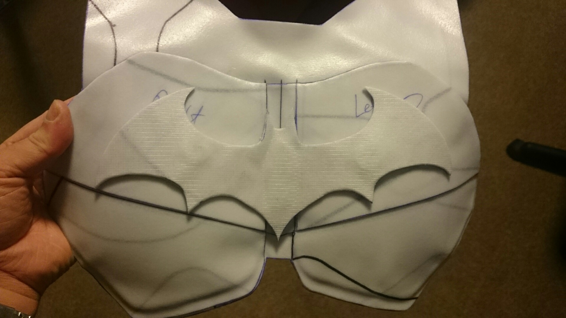

I've also shaped the first bat symbol for the chest:
It fits well, but as you can see it's a bit crooked on the chest:
It's not horrible, but it's noticeable to me. It's just to do with placement of the magnets though, so it's something I can fix with a second attempt.

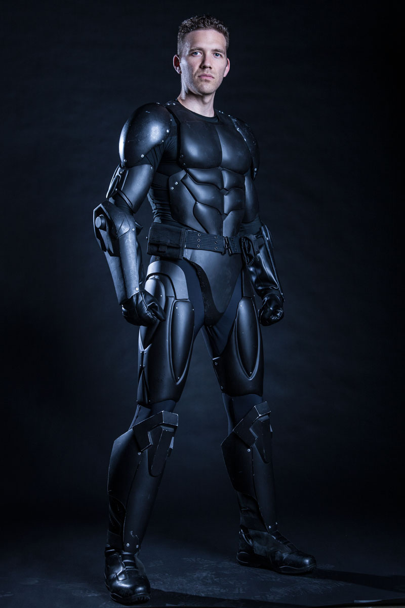

You're doing some cool work there. Here's my two cents on some things you're trying to figure out:
My plan now is to use heavy duty snaps to attach each section of the armour to the fabric components. My original plan was velcro and a fabric wrap around my midsection but now I'm thinking of using a black singlet I've had for a while as it's a nice texture and fits me well. It's really good quality fabric too, so it'll be sturdy, plus if I use snaps instead of velcro the whole piece will be much stronger.

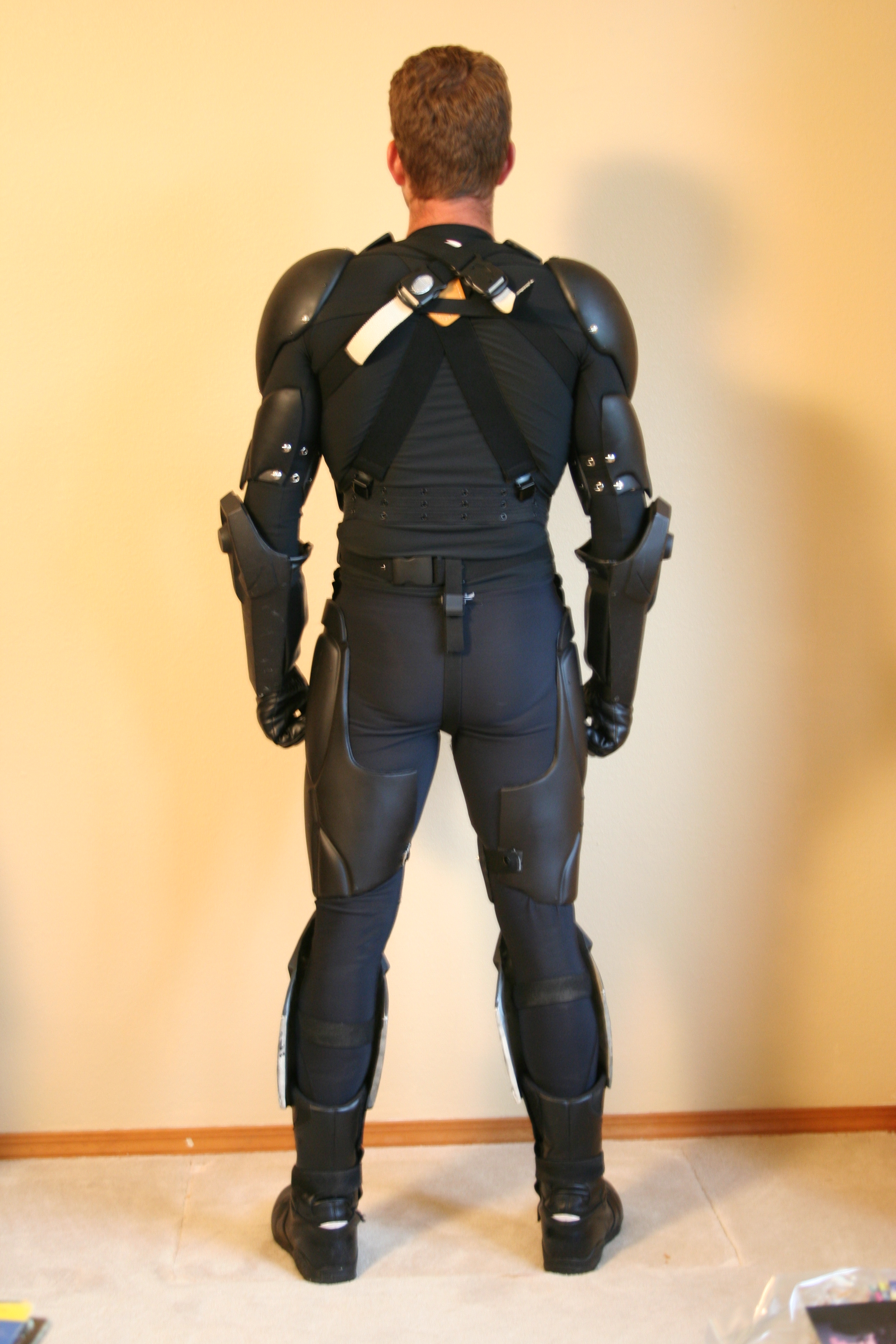

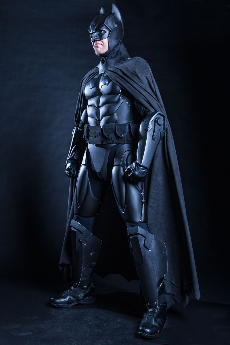

I'm assuming you mean to attach the armor to the under suit fabric. In my experience, if there's enough armor pieces, you don't have to attach any of them to the under suit itself. You can rivet or button snap the pieces together with properly measured out elastic or adjustable if you want to go a step further. Of course you may not want to go this way but I thought I'd just throw it out there in case you wanted to give it a shot. This could help in your ideas of having a more customizable suit. Here's a couple pictures to give you an idea of what I'm talking about:
Here's the suit without the cape cowl and shot of what it looks like from the back side:
I'm still trying to figure out how to attach the arm pieces to each other, I tried making the whole thing one piece but I got the measurements wrong and it didn't keep it's shape at all, so now I've just got separate pieces for the bicep and tricep plates and I'm thinking of using black elastic straps to join them but I'm not sure if that will work or if it'll look good.
I wouldn't sweat it too much. If you're doing it on a black under suit, it will pretty much disappear. If you're doing it over a gray under suit, break up the gray a little bit.
