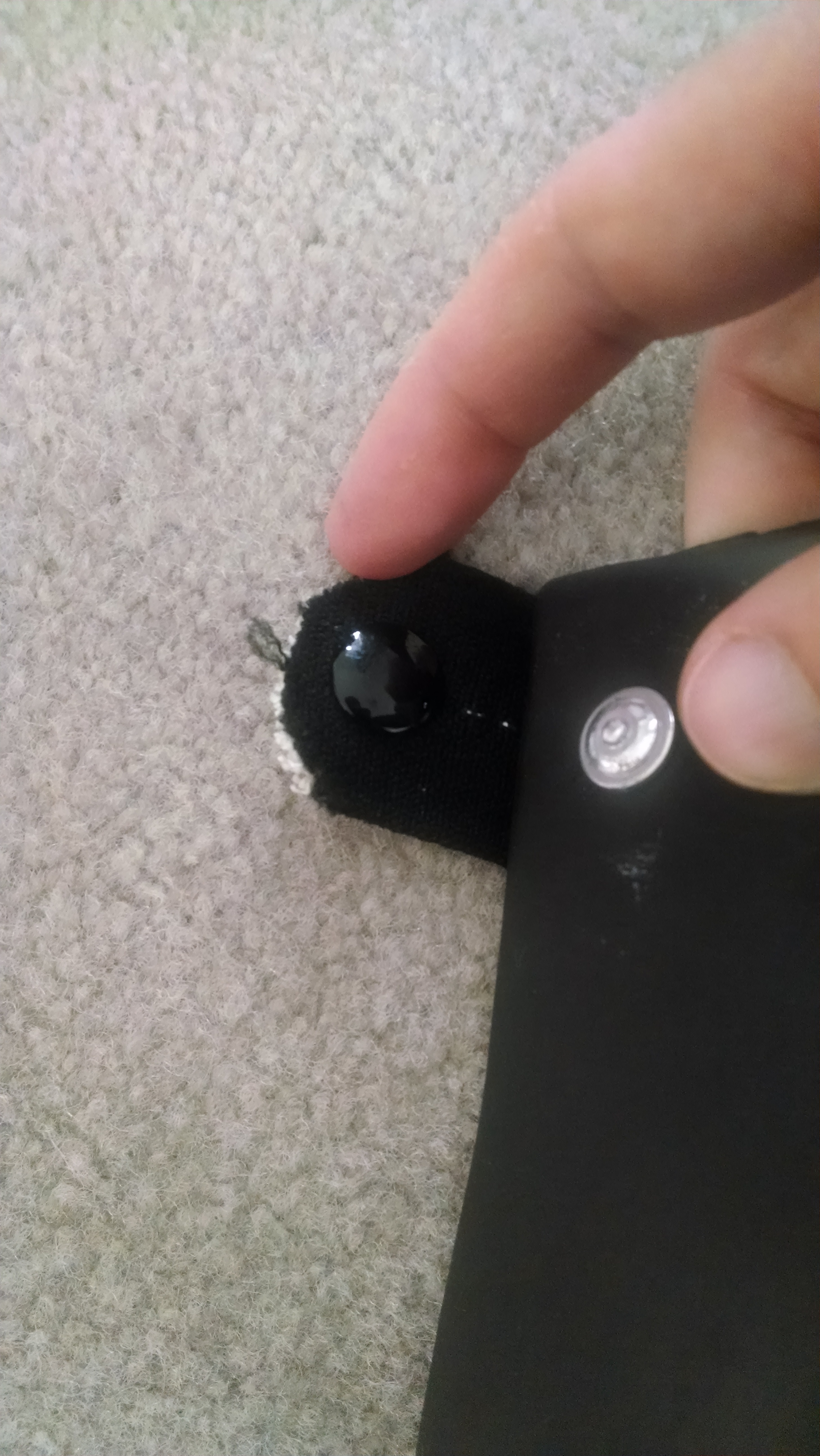

With the armour side though, do you think I could super glue the other side of the snaps onto the back of the armour pieces, or do I need to install them properly?
I don't have a lot of experience with super glue but from my little use with it and my gut tells me it the snaps will likely pop off.
Brandon
Brandon
Hmm ok fair enough, would there be any other kind of adhesive that would keep them on the back of the armour? I still haven't received the snaps in the post yet so I'm not sure what I'm dealing with yet. :/
Thanks heaps for your help and advice!
Weaponx82 is right with chicago screws, they work best for this type of application but you're are going to attempt gluing down half of a snap at least use epoxy, super glue will not hold..
Awesome, thanks for your help!
So now I'm tossing up between trying epoxy with snaps or getting small chicago screws...
What I'd do with the chicago screws is basically hole punch the armour plates I have now and insert the screws, then get a couple more layers of thermoplastic and heat them over the screws so that they are basically permanently installed in the armour, and then all I need to do is install some eyelets or something in the fabric under suit or in some elastic strips and attach them with the other side of the chicago screws...
Which option do you guys think would work better?
I feel like the chicago screws are the way to go, to be honest the only reason I'm hesitating is because I already bought all the heavy duty snaps haha :\
But I can use them for other stuff, this costuming thing is in my blood now and it's not going anywhere, so there'll doubtless be some other project that'll require heavy duty snaps...
Thanks again for your help everyone, you're making a huge difference!

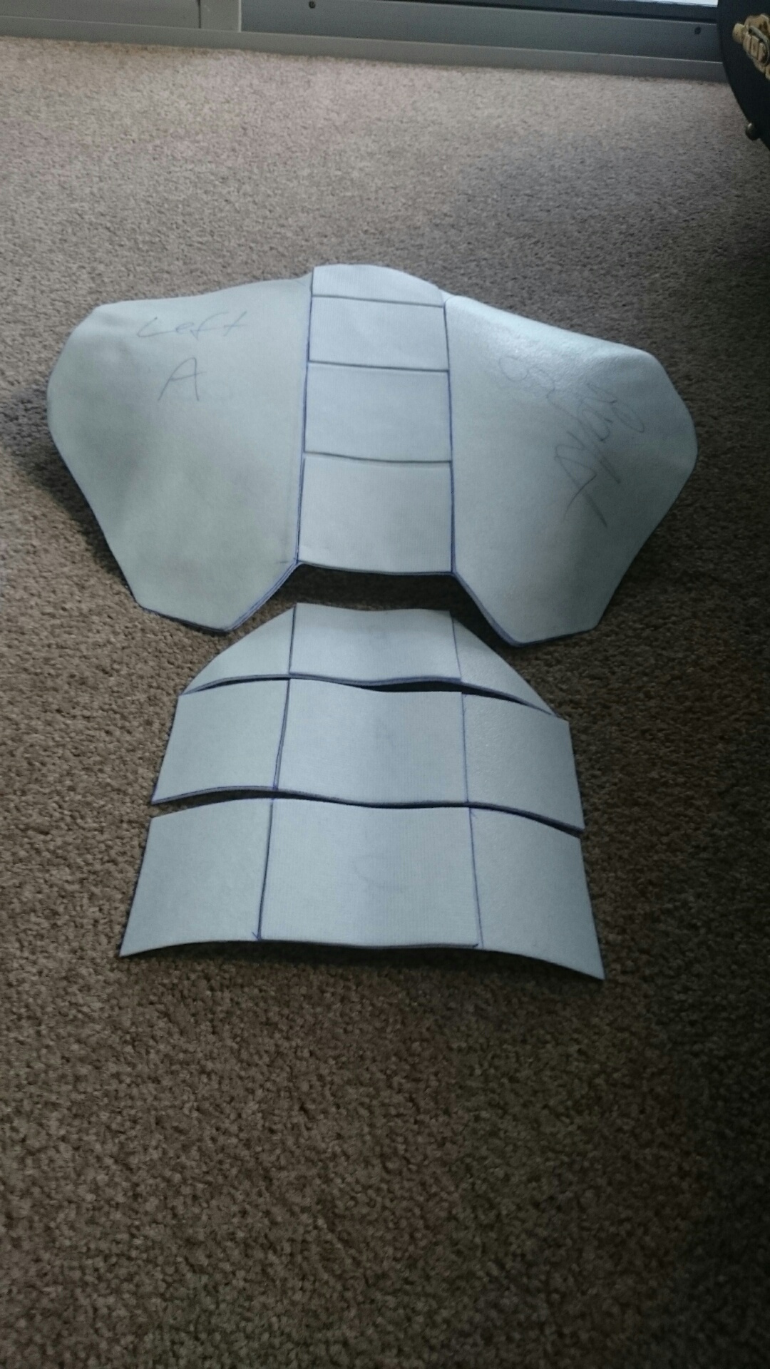

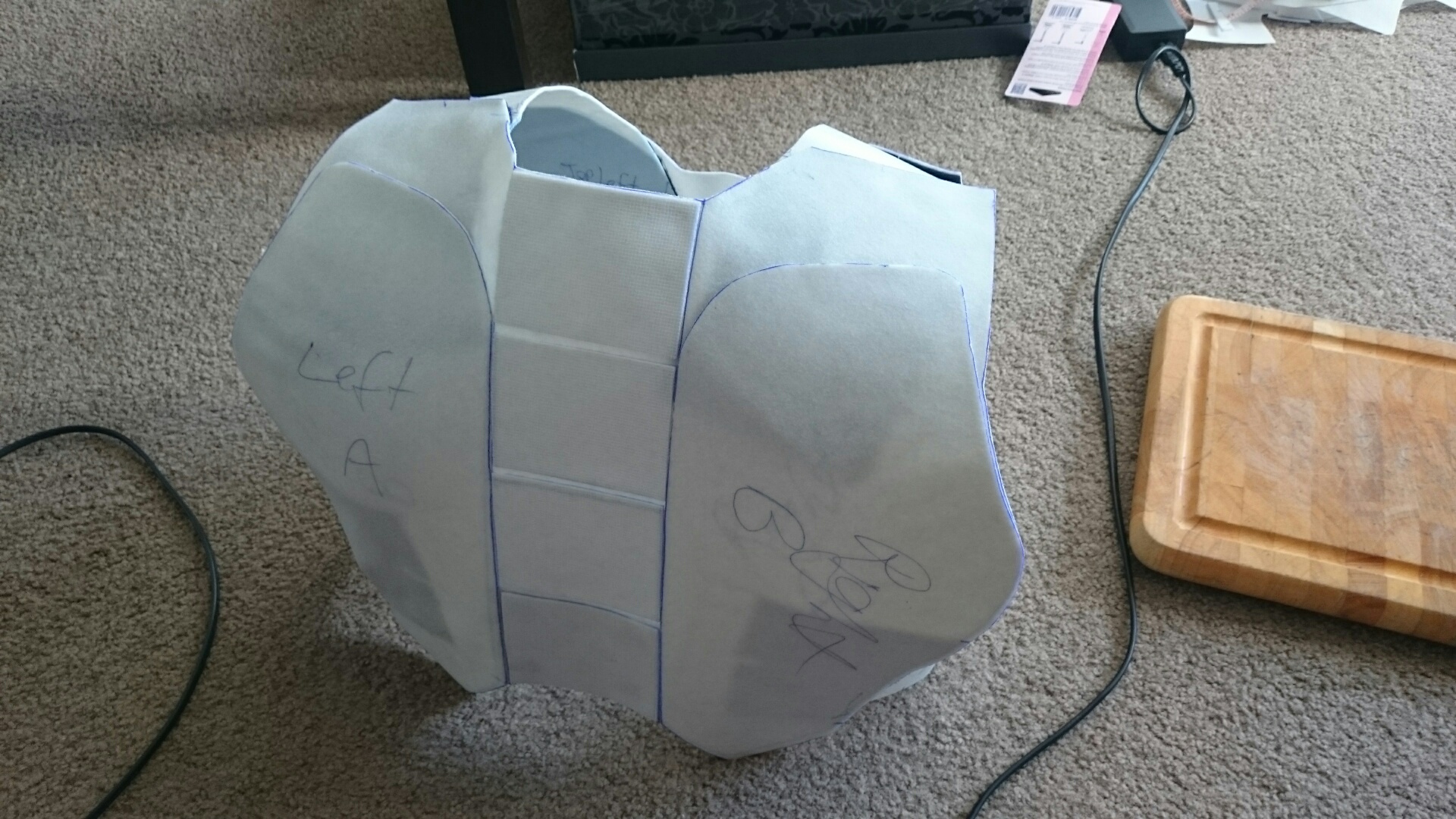

Ok, I have another update!
So I've managed to finish shaping the back armour, and I love how it's turned out!
So as you can see, I've got one big plate for the upper back which will attach to the chest piece using thermoplastic straps over the shoulders and under the arms.
Then I've got the lower back pieces separated into smaller plates to allow for flexibility. These will attach to the mid section in the same way as the abs and ribs, using chicago screws and eyelets screwed into either elastic straps or the black fabric singlet I'm using.

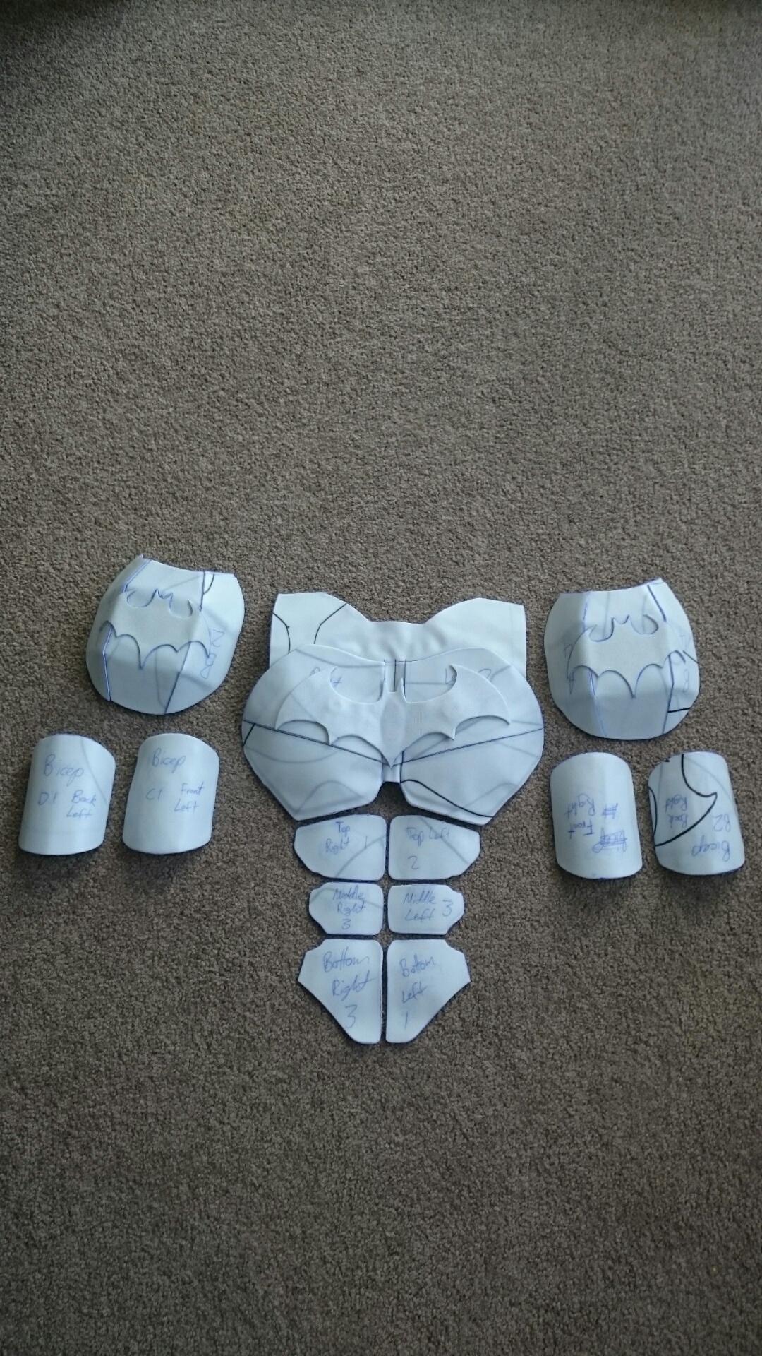

So here's everything I've made so far (except the gauntlets):
All I've got left to do now is:

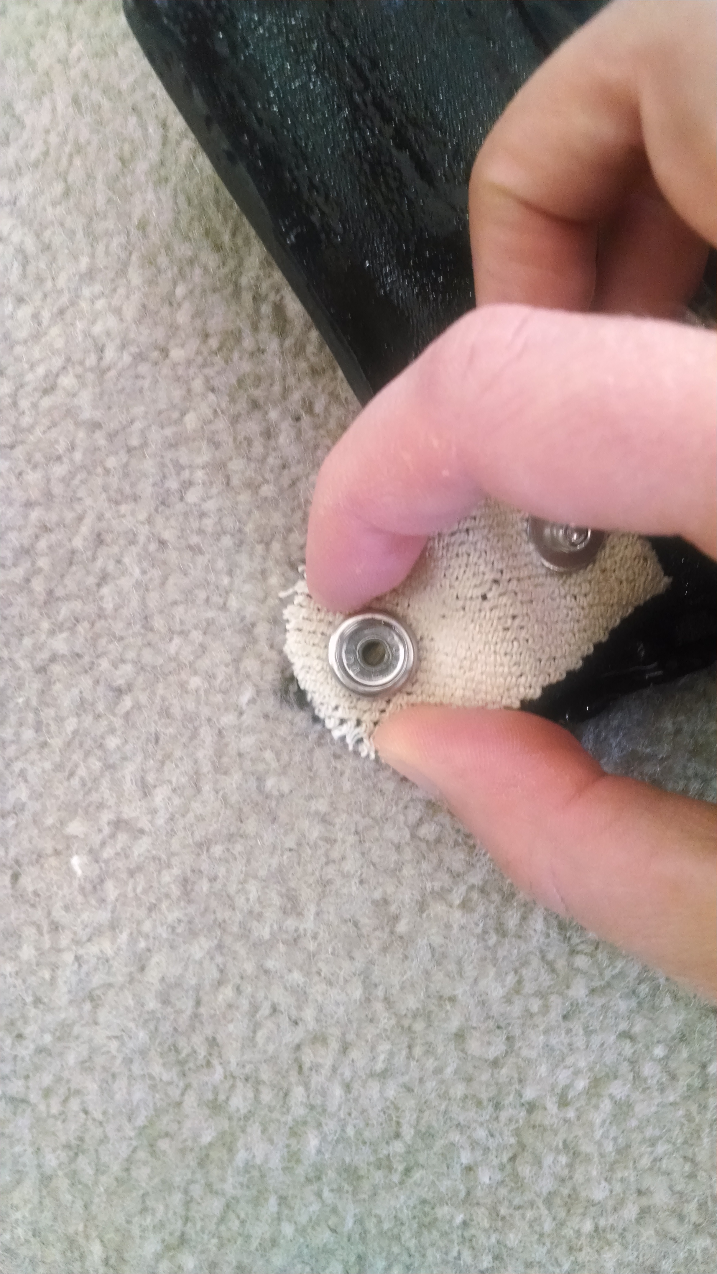

Sorry I'm late in getting back to your questions. I think Judge Spartan has some good points on chicago screws.
I can't say what I prefer over snaps or chicago screws. I think it has to do with their purpose and if you can get it to work in your circumstances. In my suit, I've got rivets in some spots, chicago screws in others and snaps in others.
There's so many different types of snaps out there with different methods to attaching them to materials. I'm not sure what you have.
Here's some pics of the snaps I use on my thigh armor. It helps a lot in getting in and out of them.
IMG_20150119_143715800.jpgIMG_20150119_143726463.jpgIMG_20150119_143738317.jpgIMG_20150119_143753277.jpg

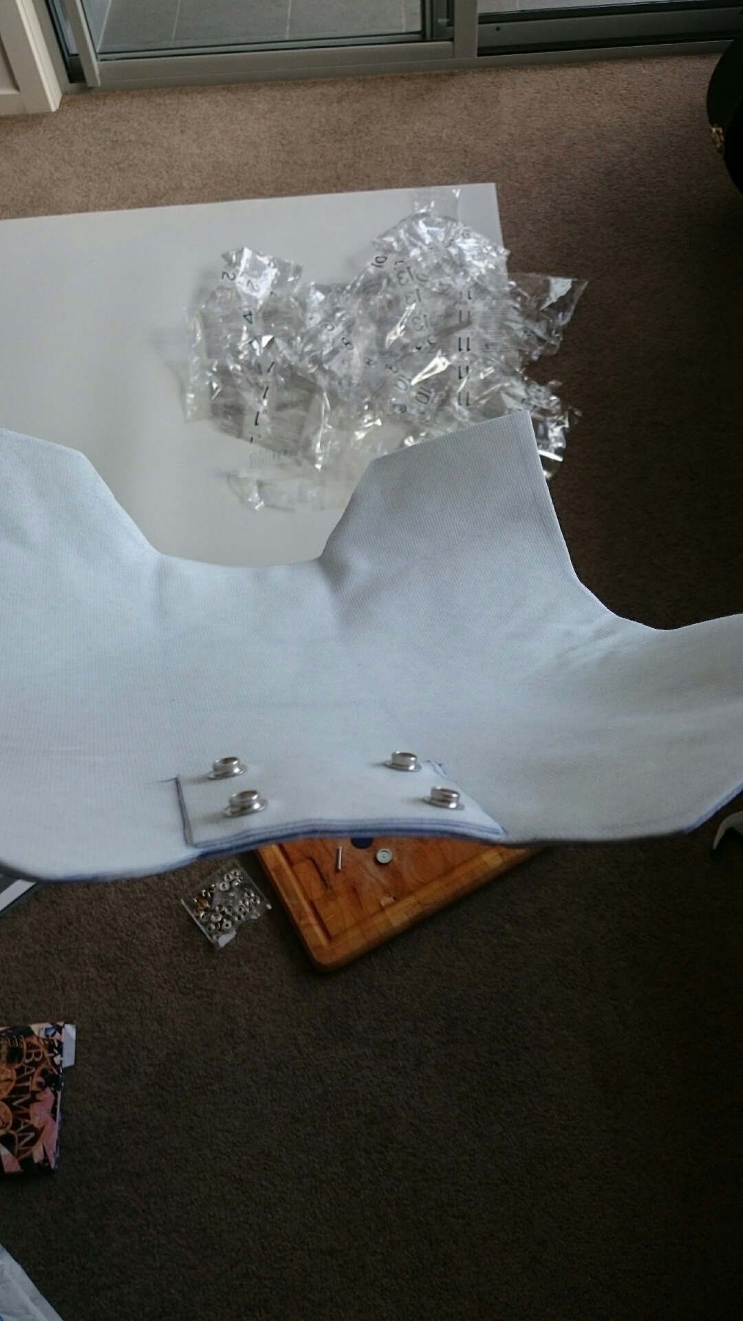

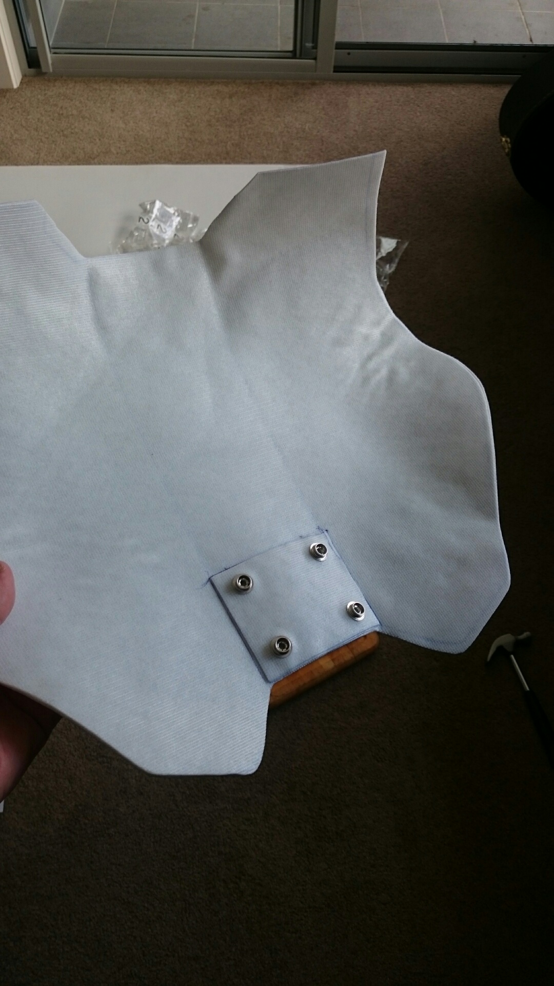

Also, I have an update!

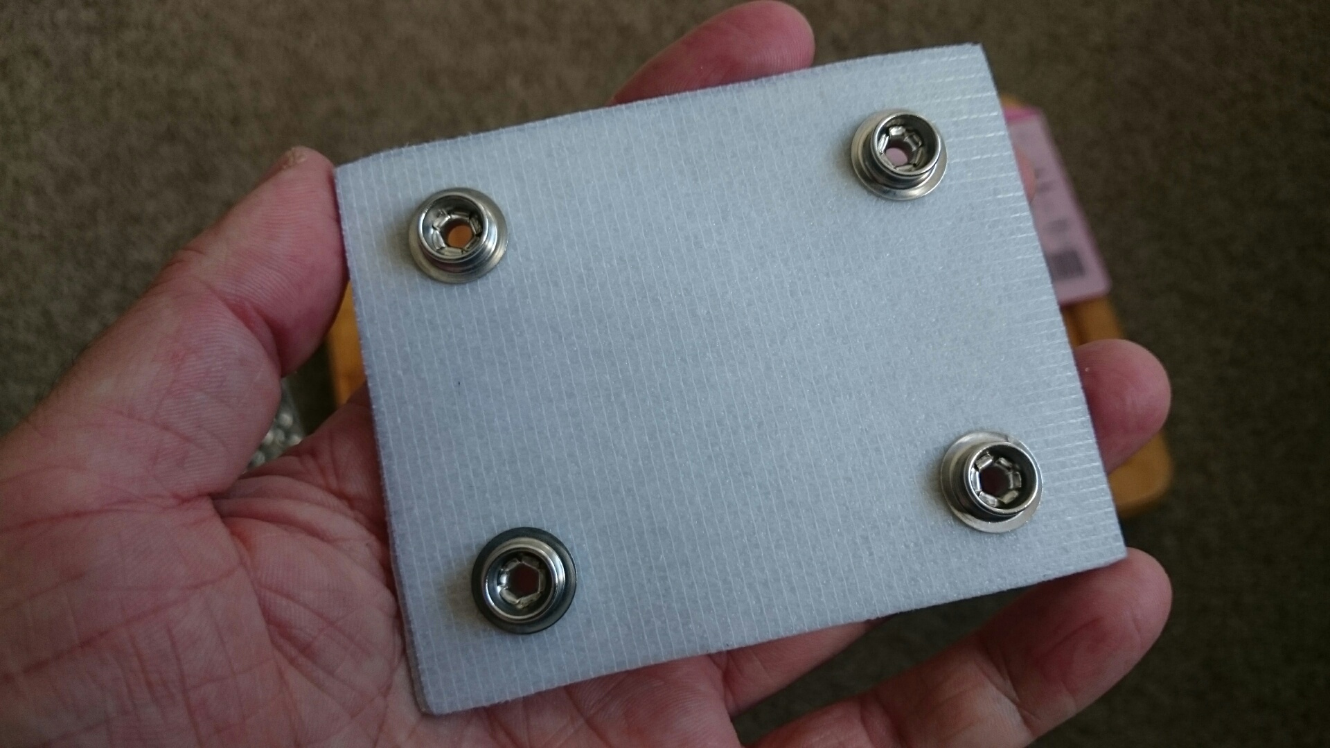

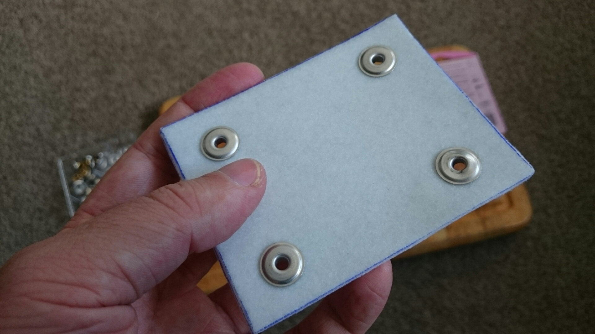

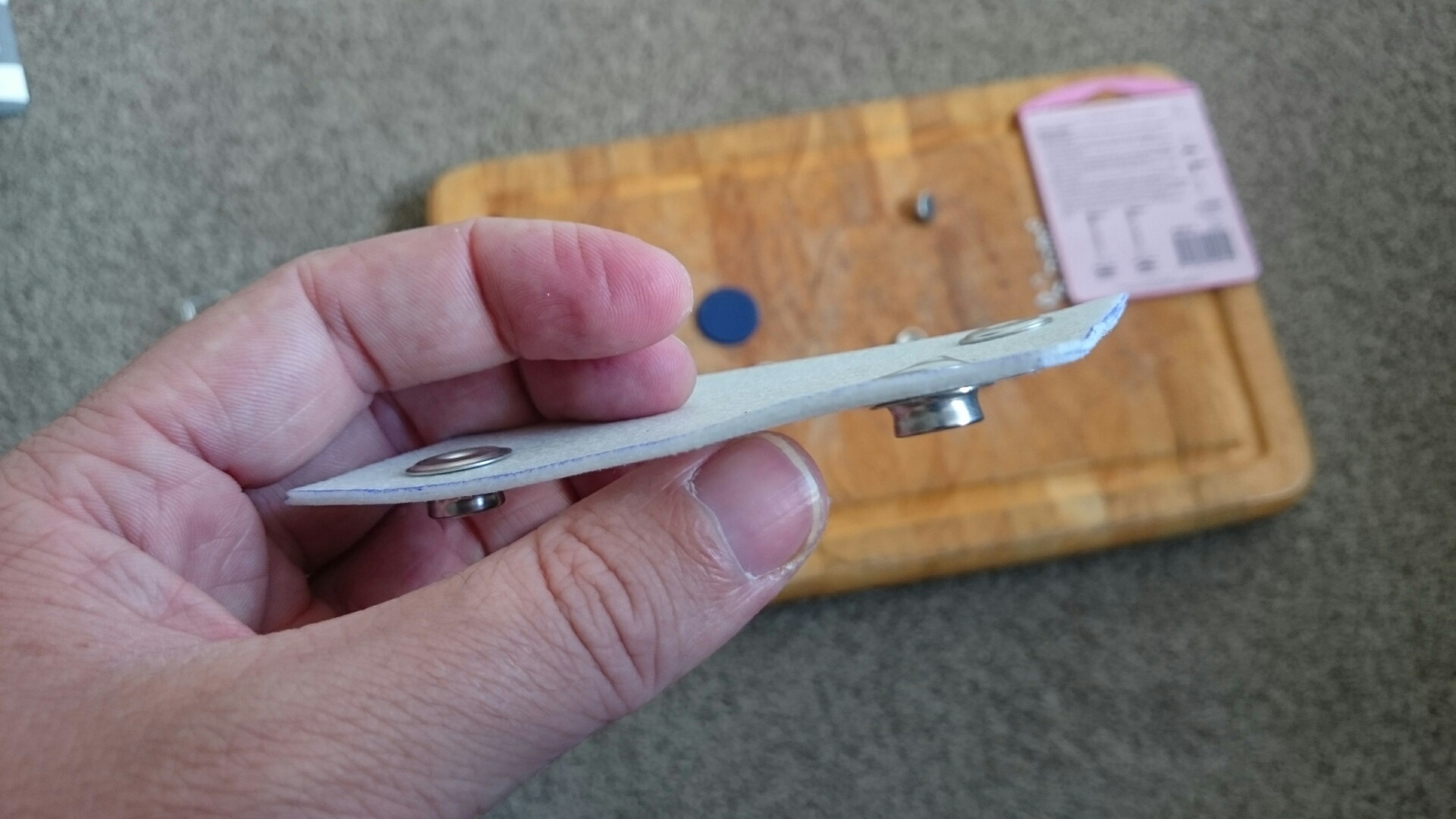

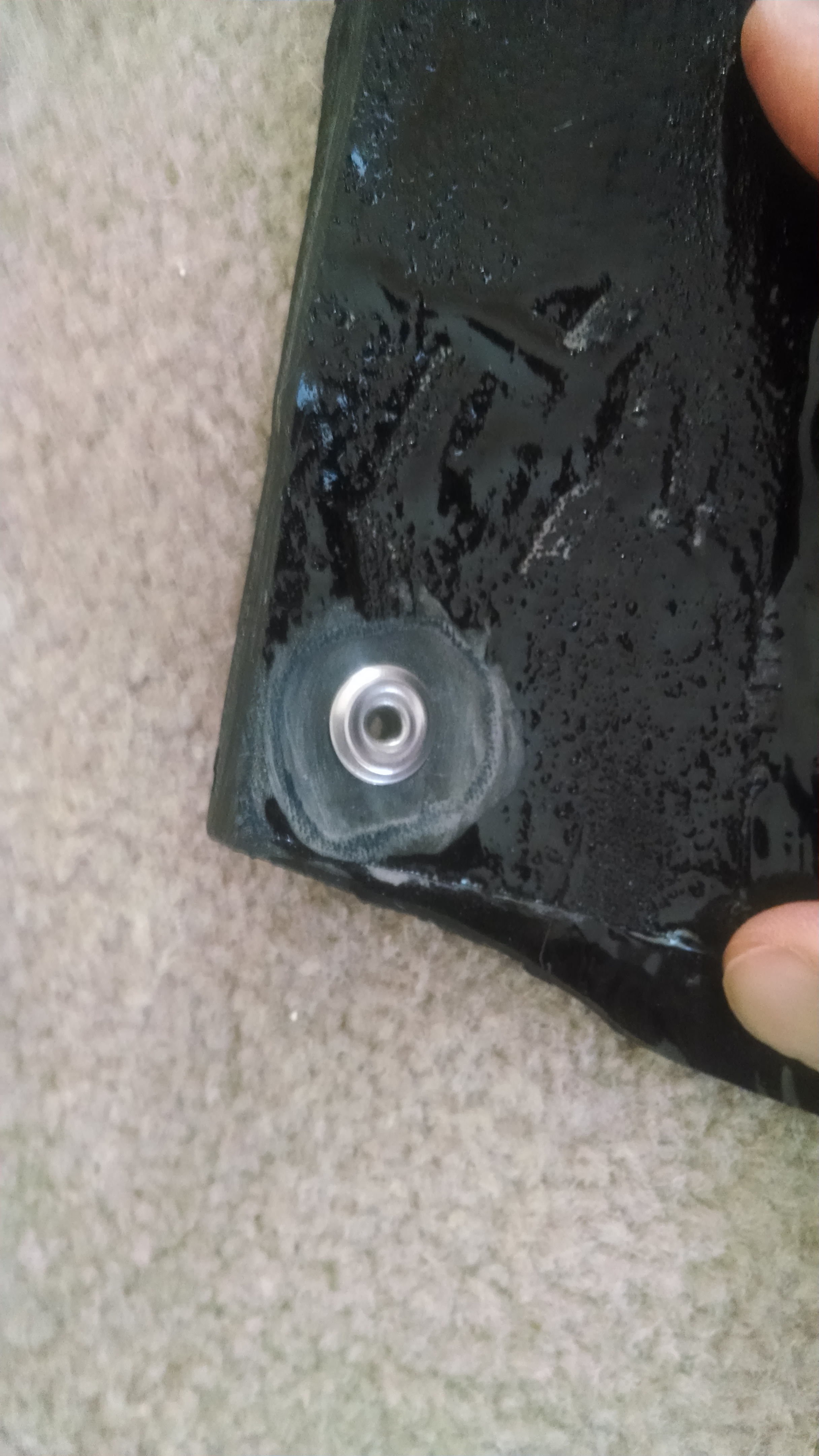

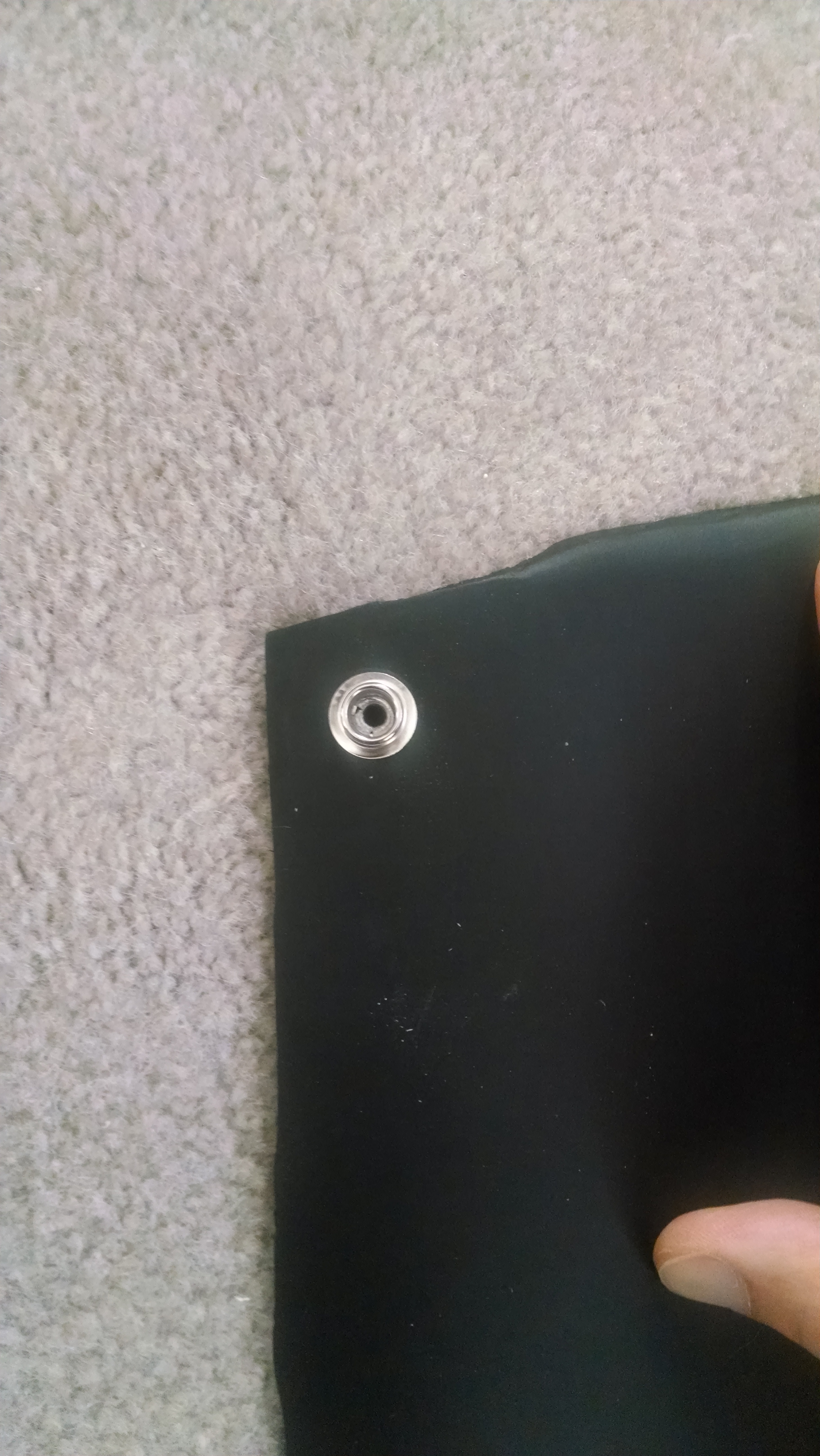

The snaps and chicago screws arrived in the post, and I've successfully installed some snaps in the back armour to attach the elastic straps to.
I realised that snaps will actually be just as easy as chicago screws so this suit is gonna end up being an equal mix between those depending on the situation. My first attempt went surprisingly well, I basically made a small, 2 layered rectangle of thermoplastic and cut four holes into it through which I attached the male end of the snaps:
I then basically heated that and the inside of the back armour and stuck them together, so the snaps are permanently and securely attached:
And as you can see, from the outside they are completely invisible!
Needless to say, I'm really happy with how this turned out and I'm going to be installing all the chicago screws and snaps using this method over the next few days.
That's where I'm up to, hope you guys are enjoying this thread, thanks for reading!

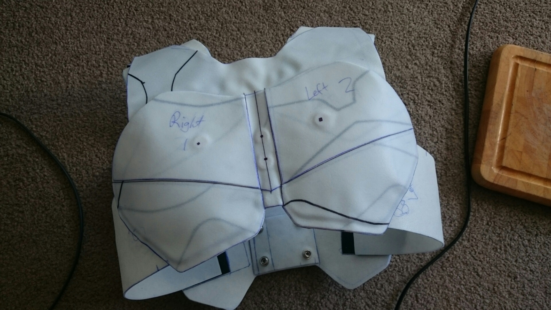

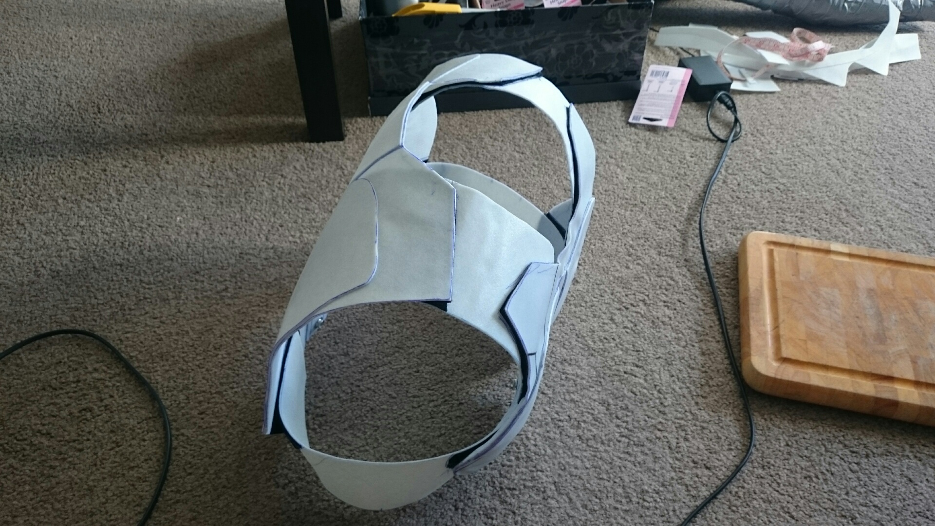

Also, I have an update after the weekend!
I didn't do nearly as much as I wanted to do this weekend, but I still got to tick one thing off my to do list.
I figured out the sizing and attachments of the torso piece so that now it's actually wearable, albeit a fair way from completion.
So even though I originally didn't want to use velcro to attach the armour directly to the fabric, I feel a little better using it for this purpose as I had to fit it myself and I couldn't fit it accurately enough to be able to use snaps or chicago screws. So with the velcro it's easy to put it on and take it off and it's a little adjustable so that helps.
I've also added snaps to the underside of the chest piece the same way I did with the back piece.
My next step will be to add snaps and chicago screws to the rest of the armour, that was my goal for this weekend but fitting the velcro and straps and such actually took a lot of time :\
Anyway, thanks for reading, I hope you're enjoying this thread!
