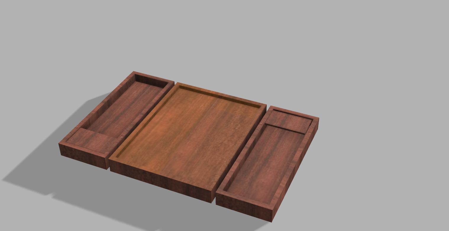

Also, having recently gotten into 3d modeling, I made a mock-up of the board to make it a bit easier to work out sizes of some of the smaller details
51124254_419357982139358_6500041636486053888_o.png?_nc_cat=109&_nc_ht=scontent.fbhx3-1.png
51395715_419357995472690_4678365639100858368_o.png?_nc_cat=110&_nc_ht=scontent.fbhx3-1.png
From this, I could develop the orthographic. Sizes come from using dimensions provided by the Propstore on their previous auction and using this to scale the other dimensions.

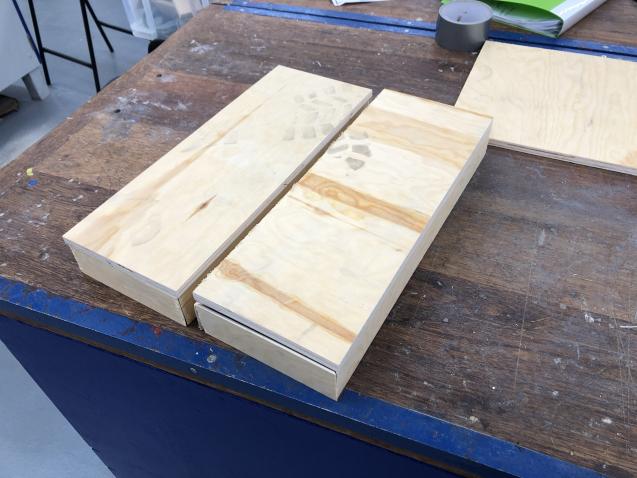

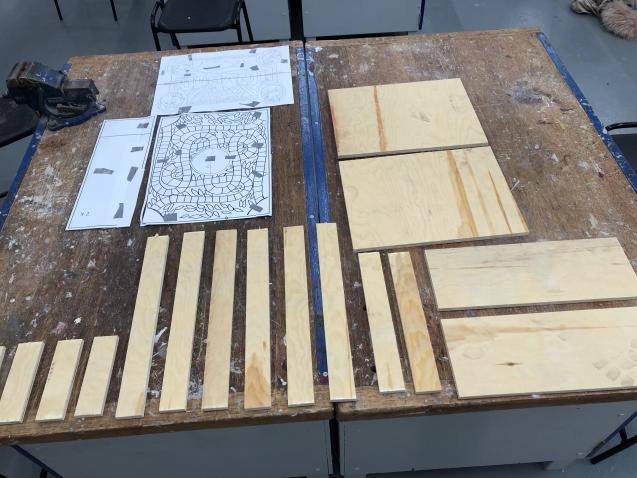

Day 2:
Managed to get a bit of information regarding the original board, and found it was actually made from Ply! So taking my cutting list prepared from the orthographic, I got things cut today!
Im completely new to hard surface modeling, so have been learning a lot already with this build. It was suggested by my tutor to miter the edges as you cant see the join line on the original board.
Nothing has been secured yet, as I need to use the bigger sander to miter the edges of the longer pieces. Once that;s done, I shall begin assembly and working on the hinges!

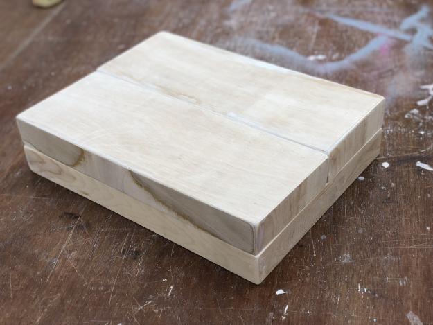

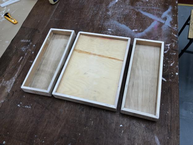

Update!
We have a board!
So it took a lot more attempts than planned, due to issues with mitering the edges, however, I finally made something I'm happy with. It's been sanded and filled, and il now be starting the sculpt details.
