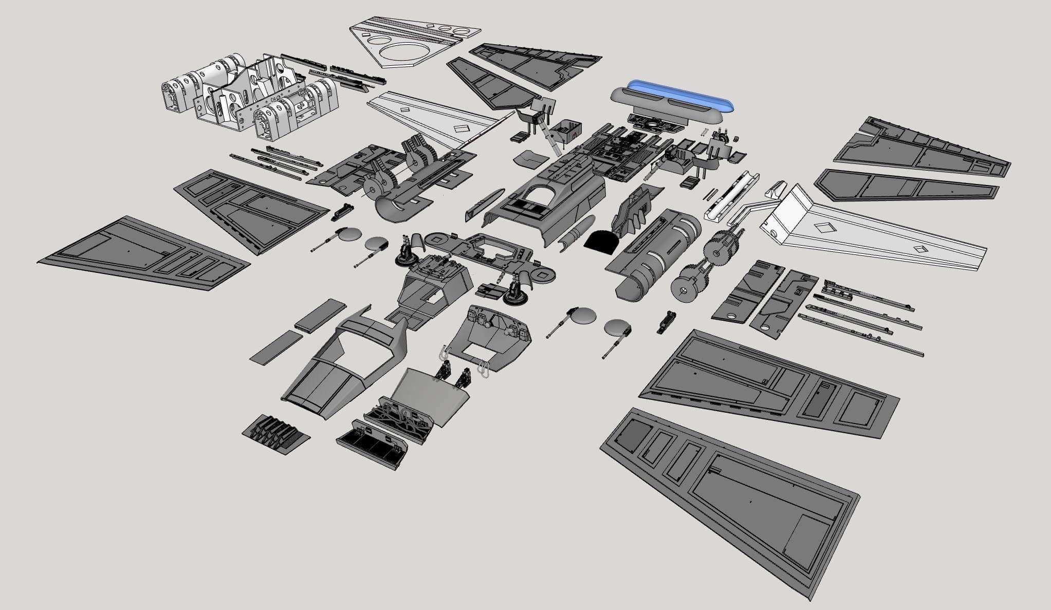

That's amazing ... well done jusdrewit ... now I don't know if you are aware yet Robert James from Robert James Models on Fb has recreated a screen-accurate 3D Shuttle Tyderium ready to be printed in 1/72 or smaller and even in Studio Scale after some adjustments ... check his work in progress out ... it's incredible :)
Here's a teaser picture of all his work :
