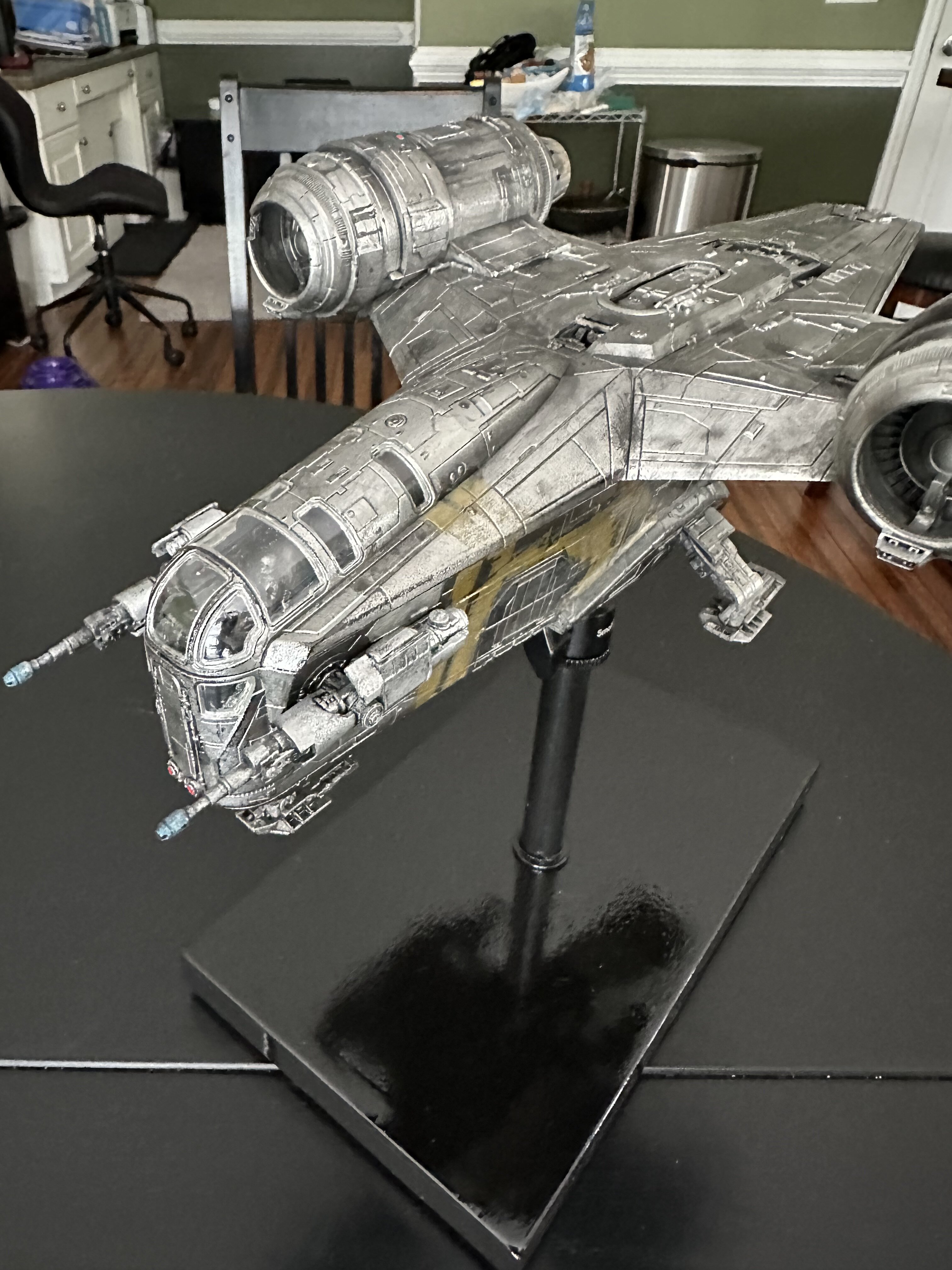

For your information, here’s my amt. for what it’s worth.

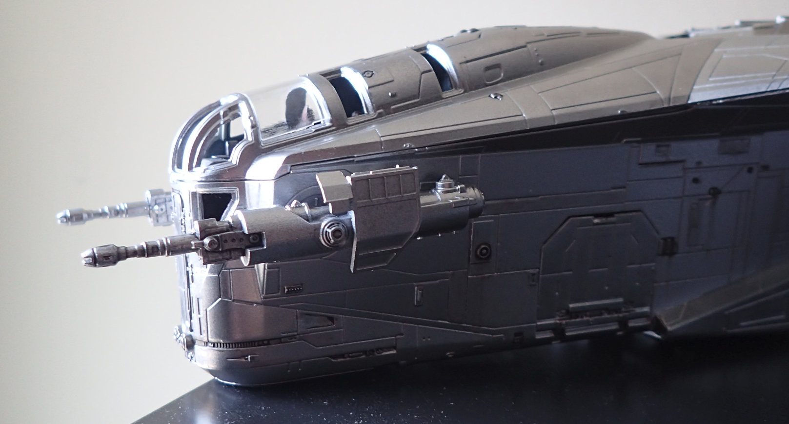

Sorry, been away for a bit and missed this when it came in,
I agree, both kits have their pros and cons
as far as fit with the AMT kit, no problems that I have seen.
I am much farther along with the Revell kit now. The only issue I had with the engines on the Revel kit was the misalignment of some details and the soft detail on the ridges along the side.
That is mainly since they did their engine in 2 halves. AMT has 4 quarters which allows them to keep more raised detail without having to sacrifice it for molding purposes. and it also allows them to be more selective about hiding the seams where panel lines, more natural details would be instead of just bisecting across details
At any rate, this is the Revell with a layer of Tamiya TS-42 Light Gun Metal followed by a coat of Spatzstik Mirror Chrome (both are good old rattle cans)
The metallic look is quite effective, although hard to capture in pictures. I also see no issue with the texture that the Revell kit often gets dinged for. It is very-very subtle and hardly noticeable after a coat of primer and two layers of paint
Note: the top and the one glass piece is only dry fitted so that is why there is gaps. They will be properly glued down later after painting the frames inside and the ramps

That's looking really fantastic, perfect metal finish and aerosols sure do make it easy.
Are you going to decal the stripes or mask and paint? Will that Spatzstik allow you to mask on top without the tape marking it?
After seeing jake88's AMT painted (and thought looked amazing), I decided to bite the bullet and pick up the AMT version. The heavy panel lines dont seem as obnoxious once painted or in person so I am happy enough with them. Also thanks to your comparison Analyzer, for me, the AMT just has sharper detail I prefer plus the engines ready for lighting and overall just seems a better kit. I really like the little Grogu as well. We have 4 days off now for the Easter weekend so I hope to make a start on this.

thanks!
I don't remember masking over Spaztiks chrome causing an issue with either masking tape, or liquid masking fluid (the Microscale stuff)
Note I did not leave the masking on for any length time as I typically mask and paint same day then remove the masking as soon as the paint is dry to the touch. I typically do that to search for leaks that could still possibly be cleaned up while not 100% dry
Although I think I am going to use the decals at least for the Revell kit. The decals are pretty nice and I am also out of Tamiya yellow paint, but have not full decided yet
