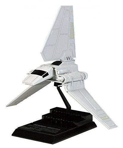

I've waited years for Bandai to make this and sadly it looks like this lovely model will never get made and all studio scale ones are way too pricey for me. All commercial shuttle kits suffer from inaccurate proportions (which appears to be what the full size set in Rotj was based on) rather than the studio scale model which to me looks way better and much more graceful to (see below)

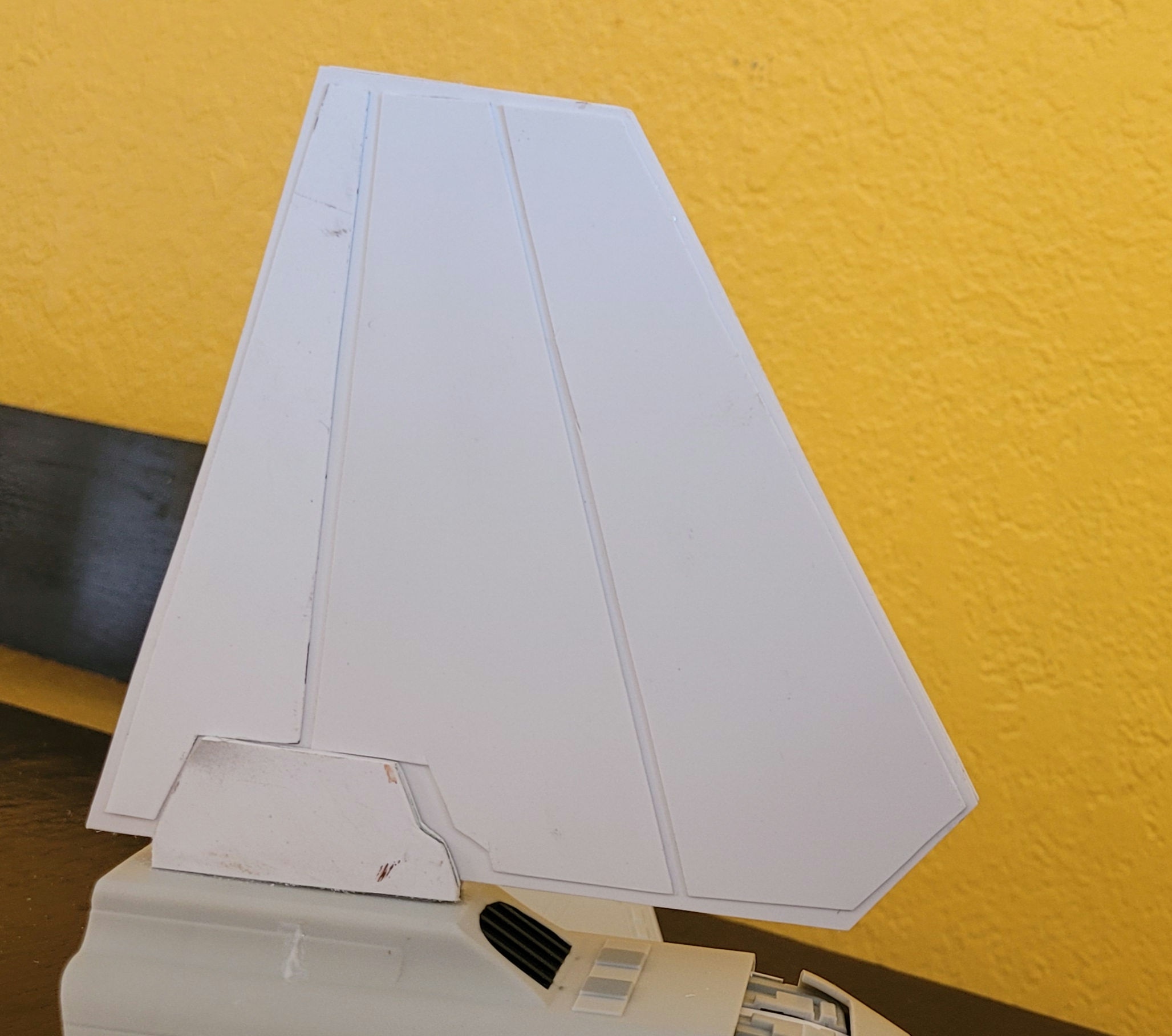

Next onto the main dorsel wing. The shape with this one is way off too, even if I trim the kits fin getting the right angles, the panel lines won't match and it will just be ugly, so I'm afraid I'll have to recreate the whole thing from scratch with styrene. Stay tuned! :)
2nd update. I've worked up a major portion of the main dorsel fin, I just need to clean up and sand some of the lines and then add additional panel lines with my scribing tool and add little pieces of styrene later but it's a good rough start.
The cockpit I had to readjust again, but I still haven't glued it yet. Obviously there's a ton of clean up to do here, sanding/filling/and smoothing even the kit parts to make it look better. Everything is just roughly fit together but so far I'm cautiously optimistic how this is looking so far. Thx for looking

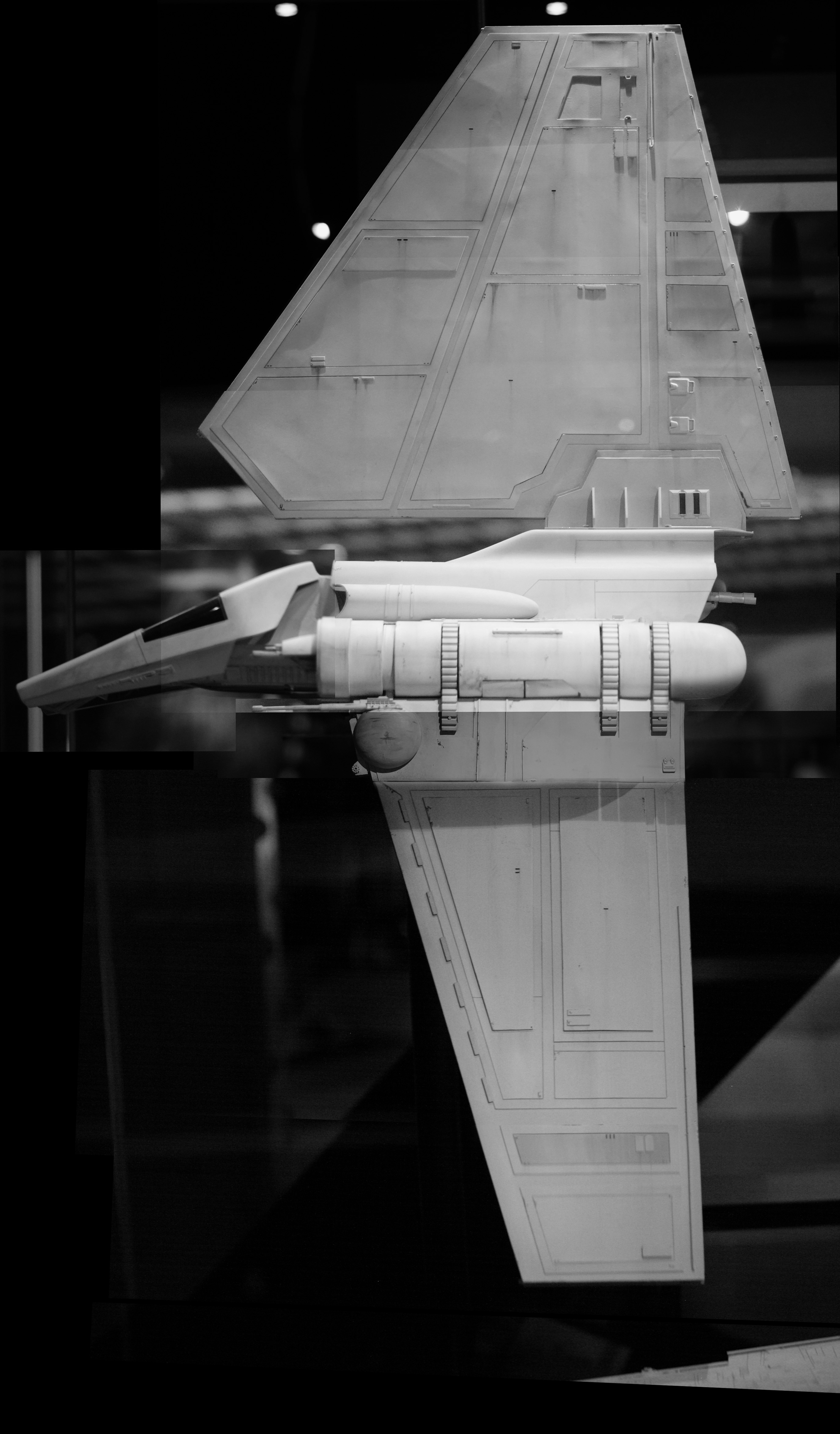

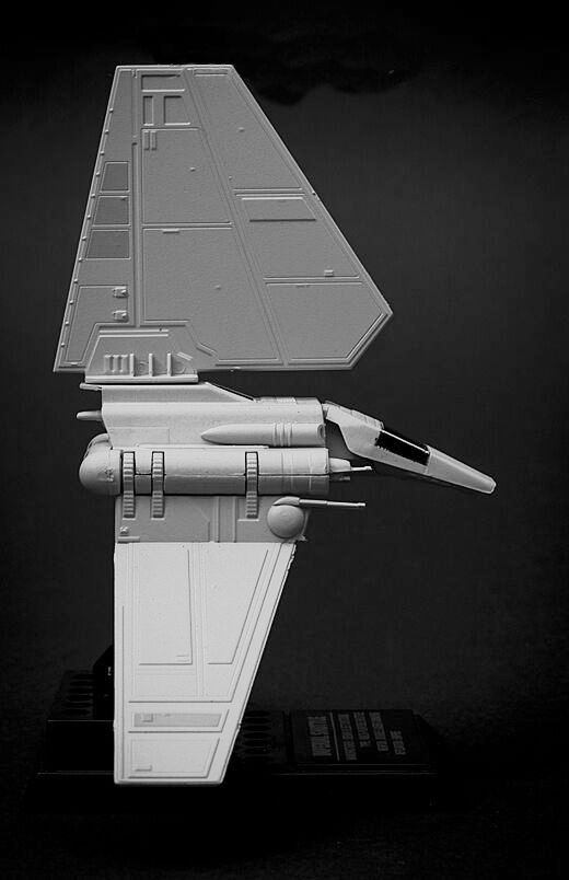

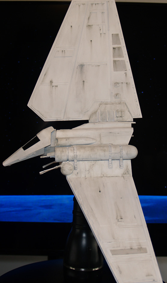

Great progress jusdrewit ... here's a picture of the actual model, you may like, ... you can clearly see the neckpart goes further into the cockpit :

Thanks for the photo! That will help out a lot. Yeah, I first attempted doing massive surgery on the way too tall dorsal fin of the stock part, but after attempting it just didn't look good so I l bit the bullet as 3d printed parts also seemed way to pricey lol I wish I still had my MPC Tydirium, but I sadly threw it away years ago. If you ever take the plunge would love to see your progress!

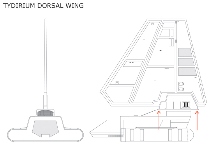

Looking again at your scratched dorsal wing . . . I still think it needs to be slightly enlarged to sit properly . . .
see red arrows on this schematic :

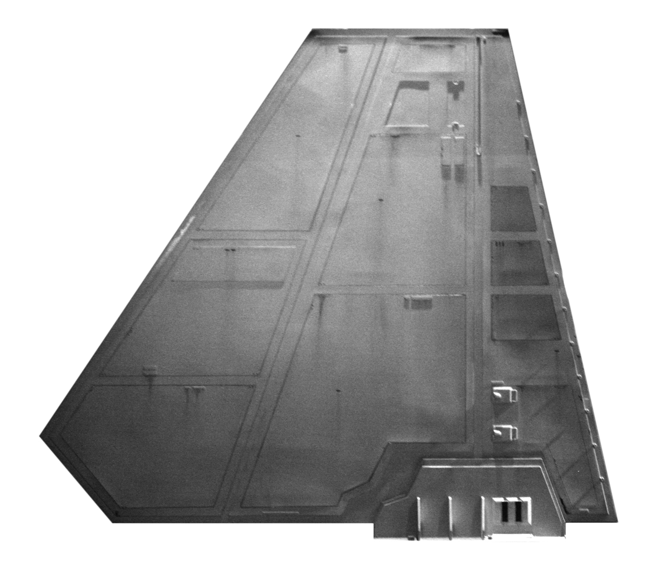

Below is a cut-out I made in photoshop of the actual dorsal fin and perhaps you can still use some of the greeblie parts from you Revell dorsal fin, right?

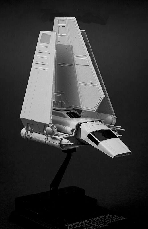

Some more pictures of the actual model :
As you can see I've done most of the research and build up a file with pictures, if you need more just ask .... and indeed all I need to do now is take the plunge with my MPC, when funds permit ;)

Instead of a schematic ... here's an upgraded large side-shot composite of the original Shuttle Tyderium in black and white :

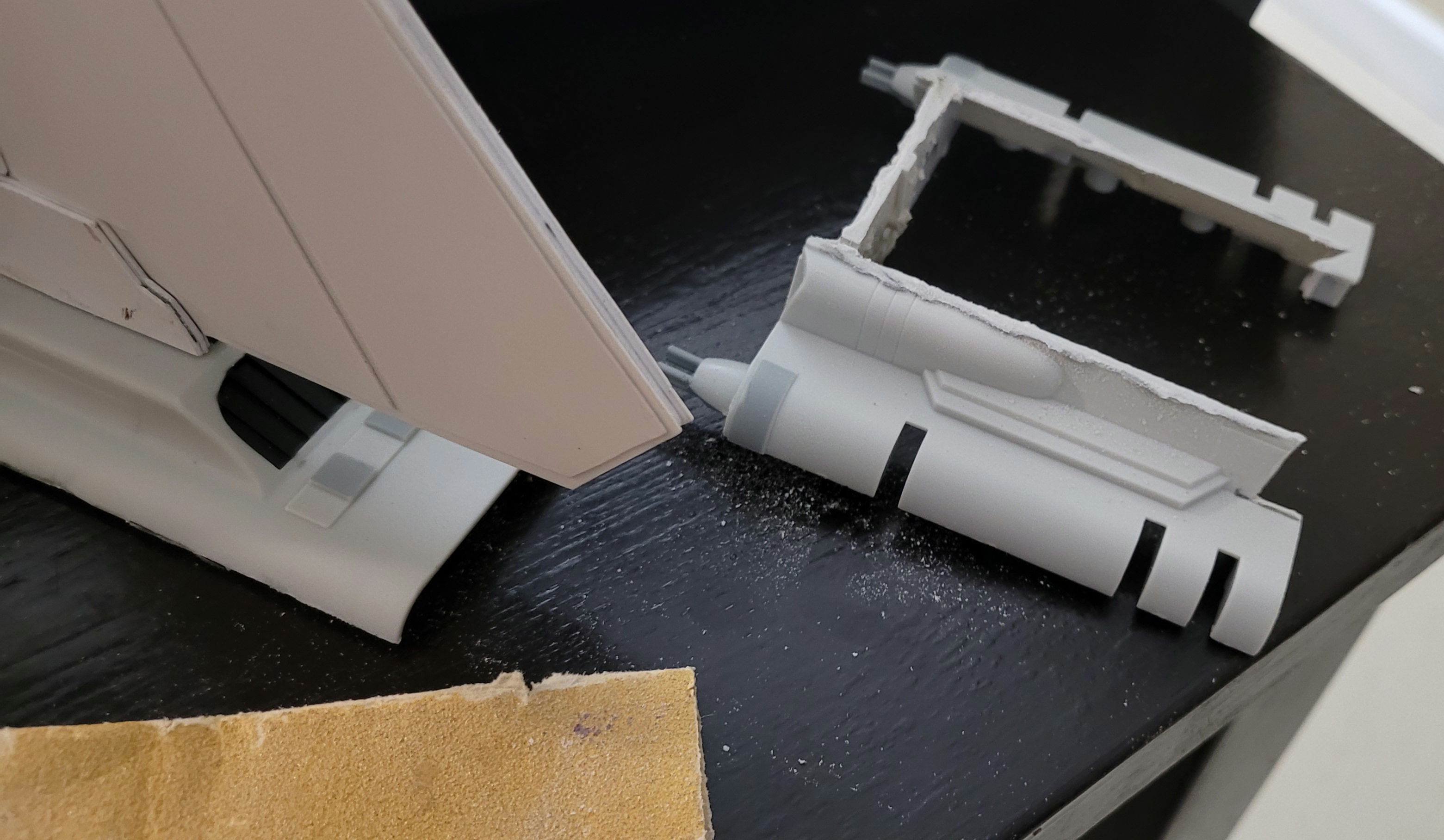

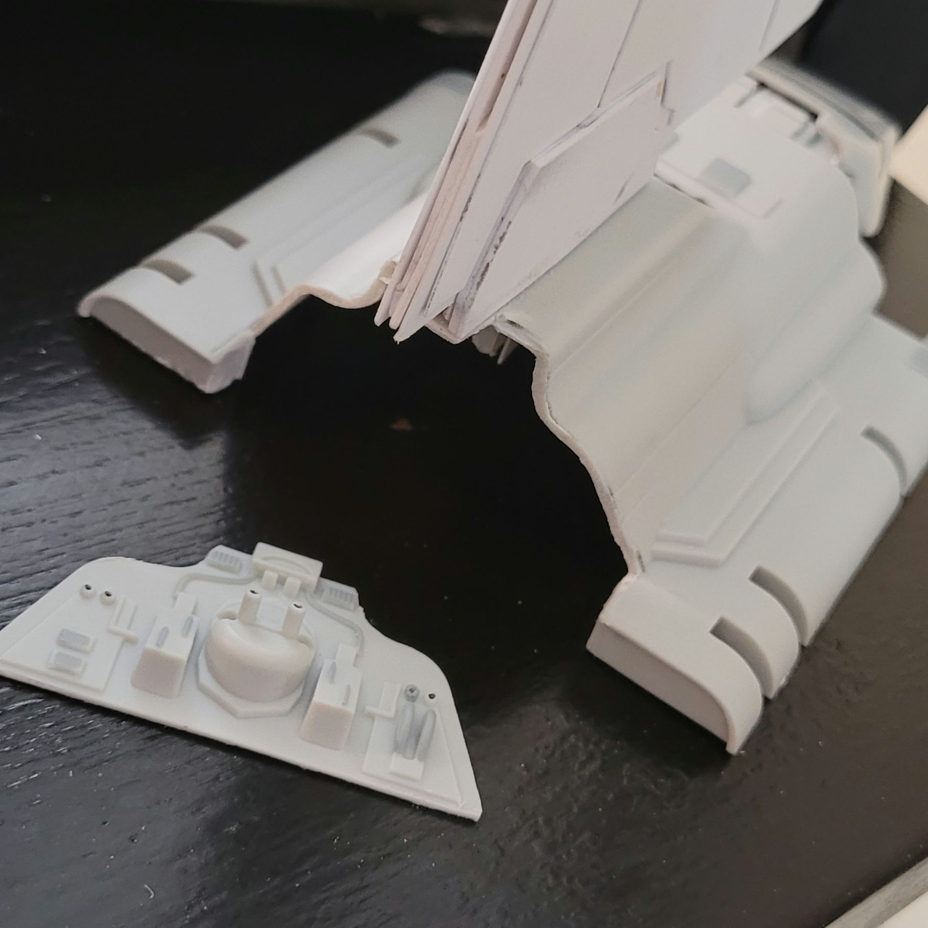

I progressed a bit more today and boy did I perform some major surgery and I hope i haven't bit off more than I can chew...
My first surgery was to shorten the end of the main body as it stuck out to far. I lightly drew where i wanted it cut, and then Dremeled away shaving about 1/4 inch or so.
The second surgery was to slice the entire upper portion of the body horizontally, making it thinner to match my references. Again I sliced about 1/4 inch off and sanded it all it so it fit decently. There's a noticable gap, but I will fill that in with putty and sand it later. This is where I panicked thinking what have i done lol
The last surgery was to Dremel out the rear wall that the back gun plate fit against. My reference pics show it set further back and since I had shortened the outer wall it was set in, it was now too close so I needed to carve that the back wall so the rear gun piece could be repositioned further back.
Lastly, the engine piece also needed to be trimmed due to all my surgeries. There is now a noticable gap on the top but i can easily cover that with styrene later.

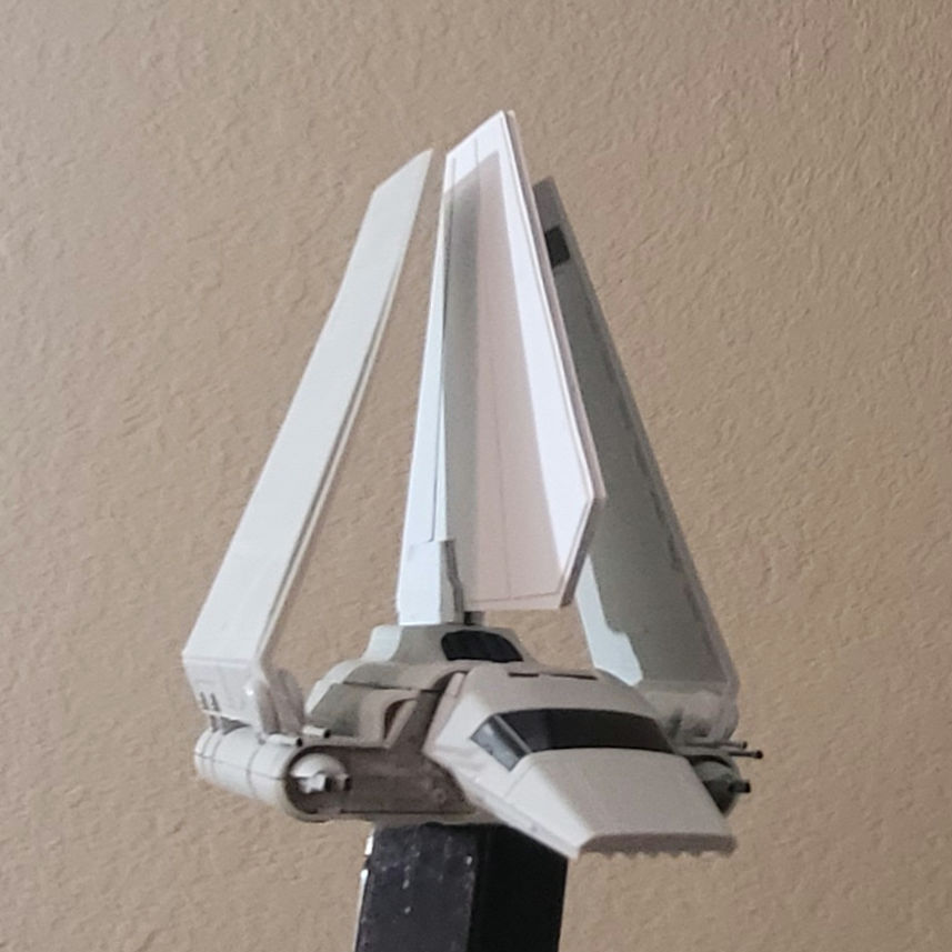

I snapped some pics with the pieces dry fitted together roughly, no glue, just to see where I'm at visually. One of my wings appears to be a bit warped, so I'll need to deal with that later. In terms of accuracy, I haven't even looked at the 2 other wings, but they seem too long or off to my eye slightly? I'll check later but if they are off drastically I have a feeling I might be scratch building those as well. Well, that's all for now!
In the words of Obi-Wan, "He's more machine than man."........its more scratch built that revell....
It looks really good now. Trying to get one of these shuttles to look just right is tricky, so tricky that no model manufacture seems to ever get it right, despite also using the incredibly wrong set piece instead as well.

And yup, the only accurate model I have of the shuttle is my tiny cute F-toy model of it. Did FantasyFlight games ever make an accurate one? I can't remember

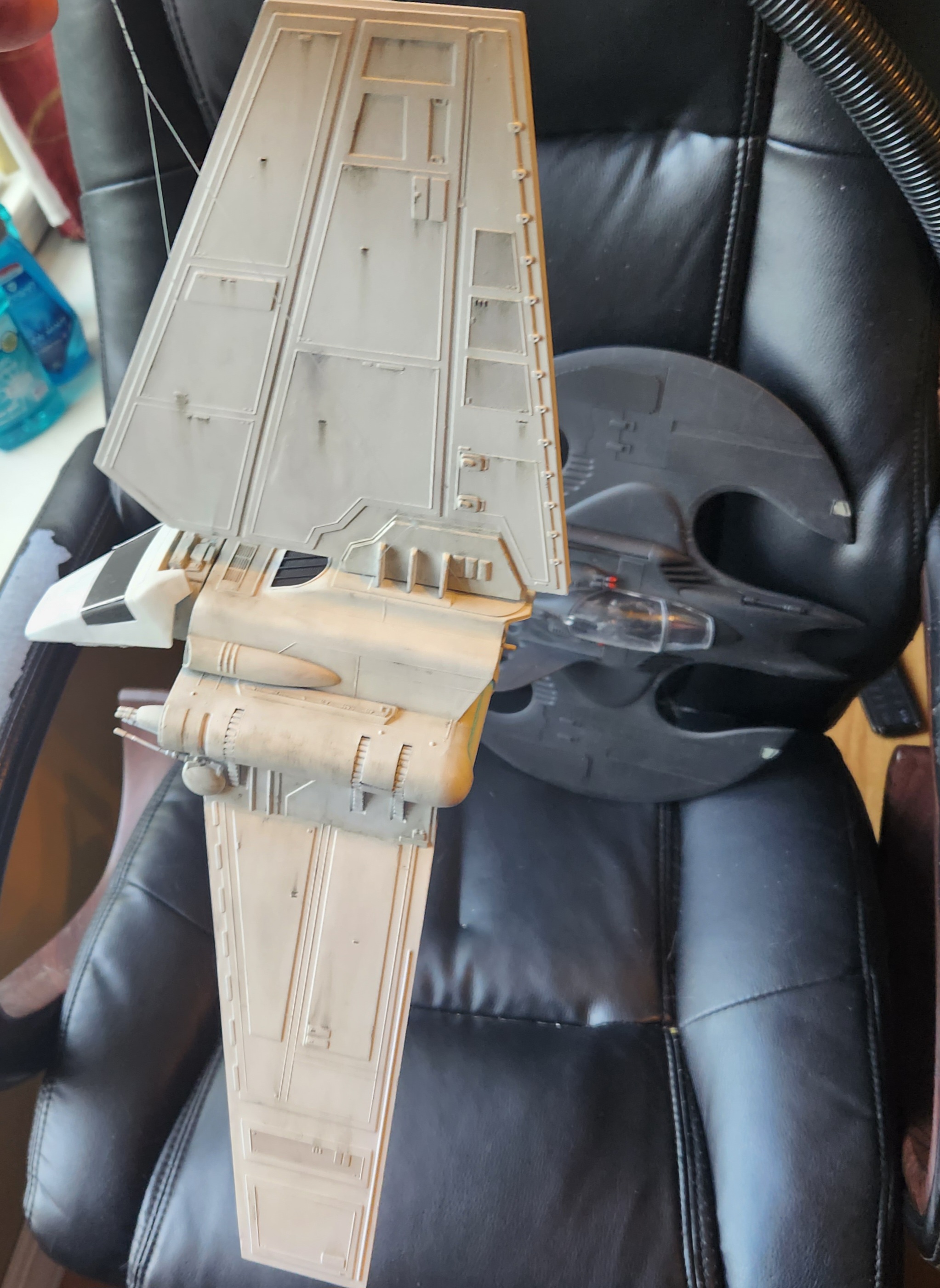

Heres my MPC, with all its issues. When comparing it with the others, you can clearly see the issues, but on its own, its not too bad, the top fin does need to be wider of course, but its that cockpit that really stands out as being the most wrong. Over all, the whole thing needs to be stretched out left and right. I just wanted to build it as is. Although I got that nasty gap around the main body that I fixed with apoxie sculpt. Although, in the years since I've made it, its showing again.

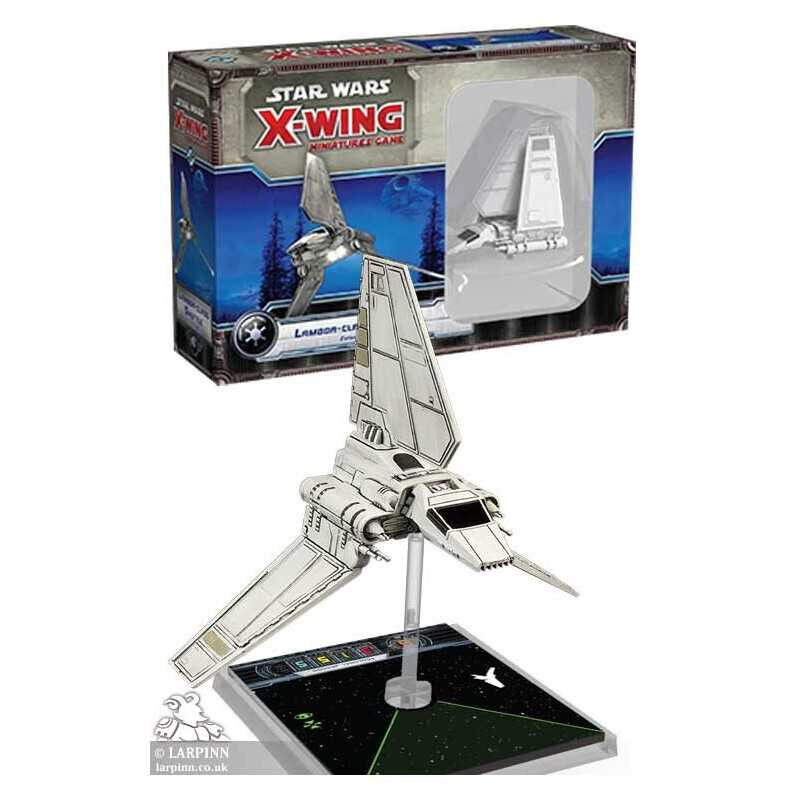

And indeed there has a Fantasy Flight/X-wing Imperial Shuttle been made, alas the cockpit is not quite accurate though :

Yup that's the kit I did as a teen, that nasty side seam plagued me as well. If I hadn't tossed mine in the trash years ago, that would've been the one I would've tried to make accurate instead of this smaller Revell kit. Great job on your paint scheme! What stand did you use?

And ah yes, they got the dorsal fin shape correct and side profile seems good, but that cockpit is off when looking at it from the front. Pity
Thanks. Details and weathering were all hand painted. I don't even have a base, above its just sitting on a flashlight.
So I put fishing string around it and had it hanging in a backroom, but then had a roommate at first come temporarily, as her and her son needed a place, but then covid hit and its turned into long term.
She left it hanging, and others, all that time, but I finally got them out a few months ago.
The gap isn't as bad as I was thinking. About an inch long towards the back.

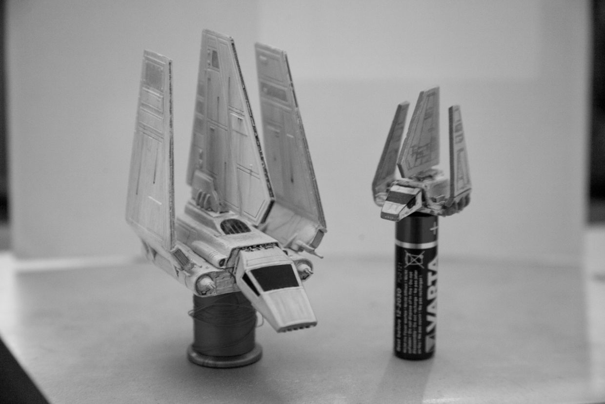

Since we are reminiscing some of our builds from the past . . . a long time ago . . . I made this tiny paper/cardboard Imperial Shuttle seen on the right :
... it stands next to the upgraded/re-painted Hallmark Tyderium ... if you listen very carefully you can here the Imperial March play in the background ;)

Love it! Wow that is tiny, nice job! I think I have somewhere my micromachine Tydirium from when I was a kid, will have to check tonight. I might have to get that Hallmark Shuttle to start a little Tydirium collection going!
