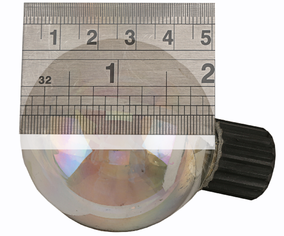

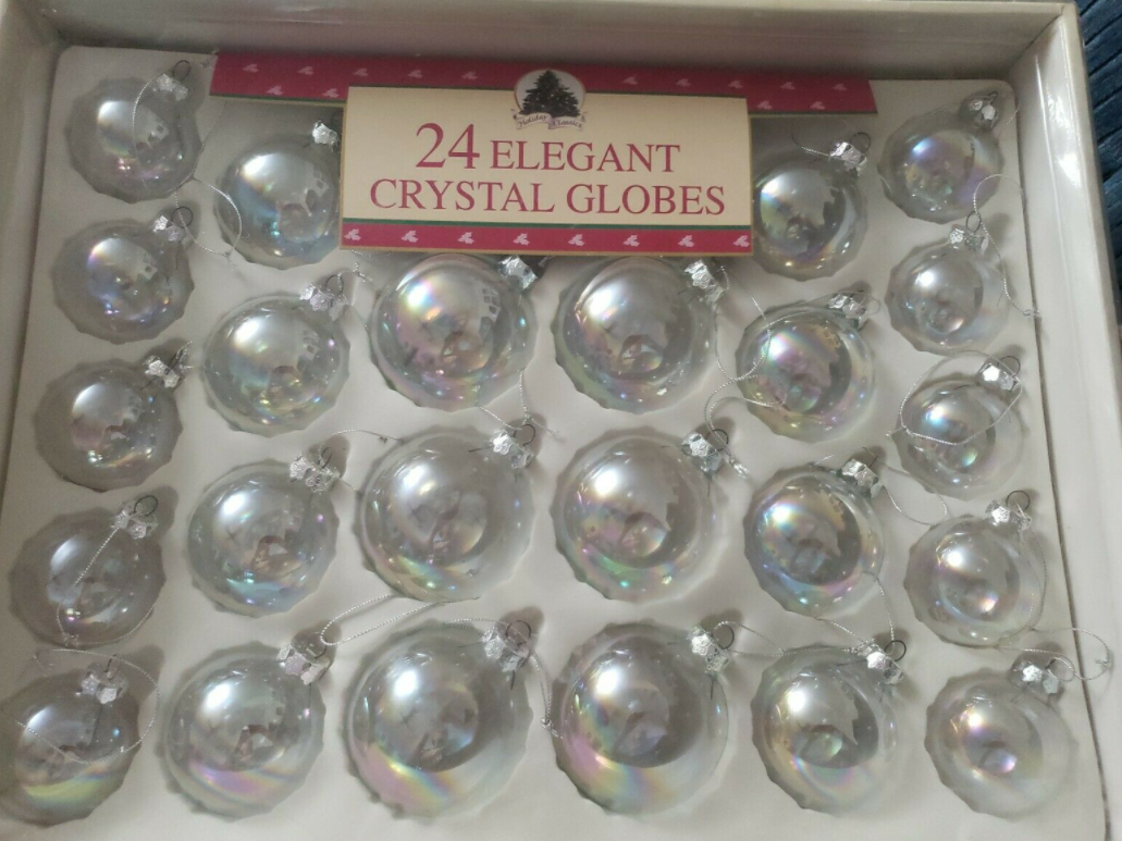

I was able to find the soap bubble iridescent glass ornaments on ebay as a set. I'll post pics once I have them in hand. I could not find them anywhere else.
The auction page images are quite detailed. The close ups on the cap show that they were cast so whatever was the original, if a found object, was duplicated. I'm assuming it was modified from the original injection molded part instead of hand sculpted. If you zoom in, you can see the bubbles left in the cast from incomplete or absent vacuum molding when casting. The bottom shows the sanding lines. I'm guessing that they were cast in an opaque resin with black tint. They look very flat. Also the side looks very straight ie no draft.

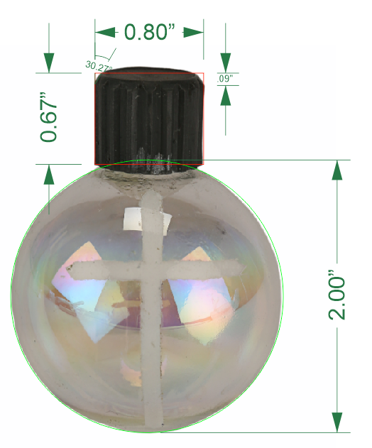

The top bevel is approximately 30 degrees off vertical. Scaling the top for a 2" ball looks like this

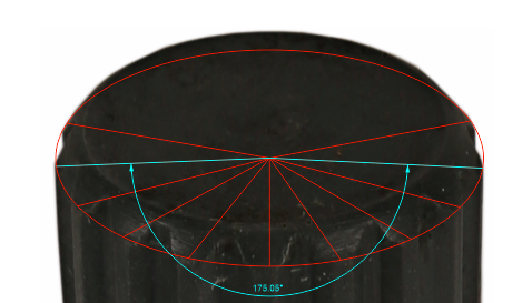

I believe there are 16 "flutes" on the cap assuming equal spacing.

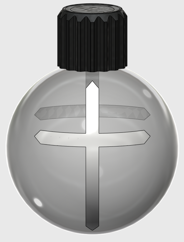

Render with crosses. When I get the new ornaments, I'll print the new caps.

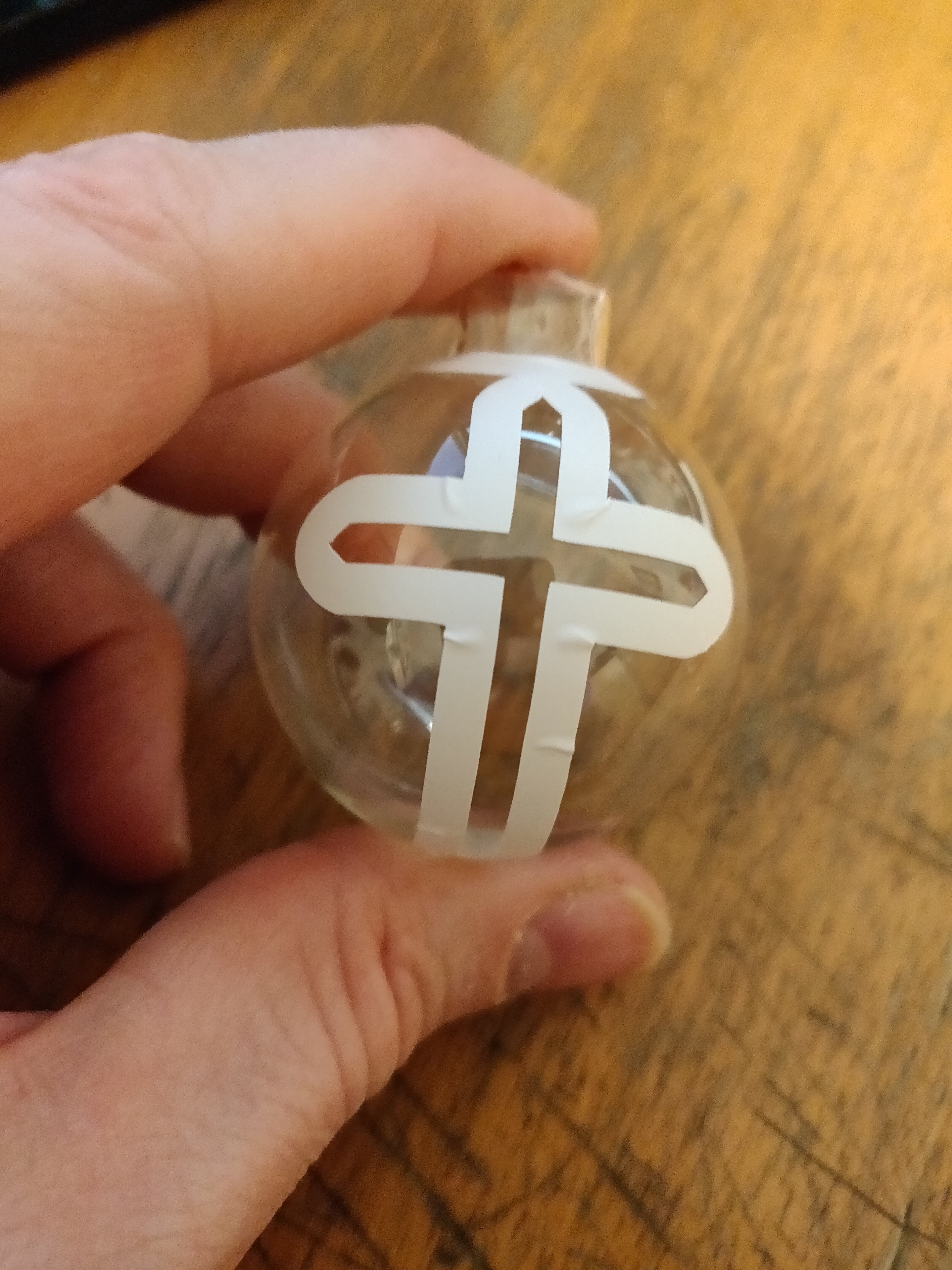

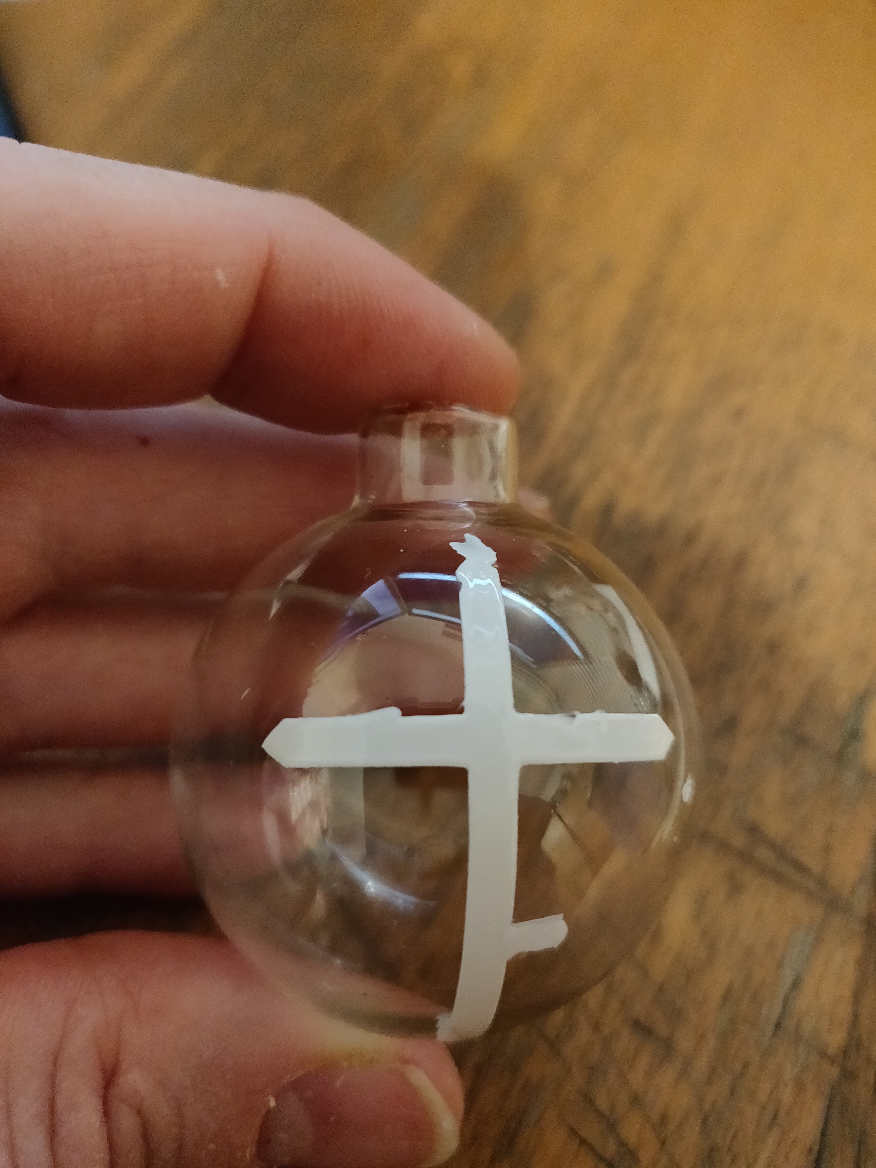

Still waiting on the correct ornaments but the experiments on the 2" clear ones are looking good. I pulled the tape before they were dry to simulate the shredded edges.
