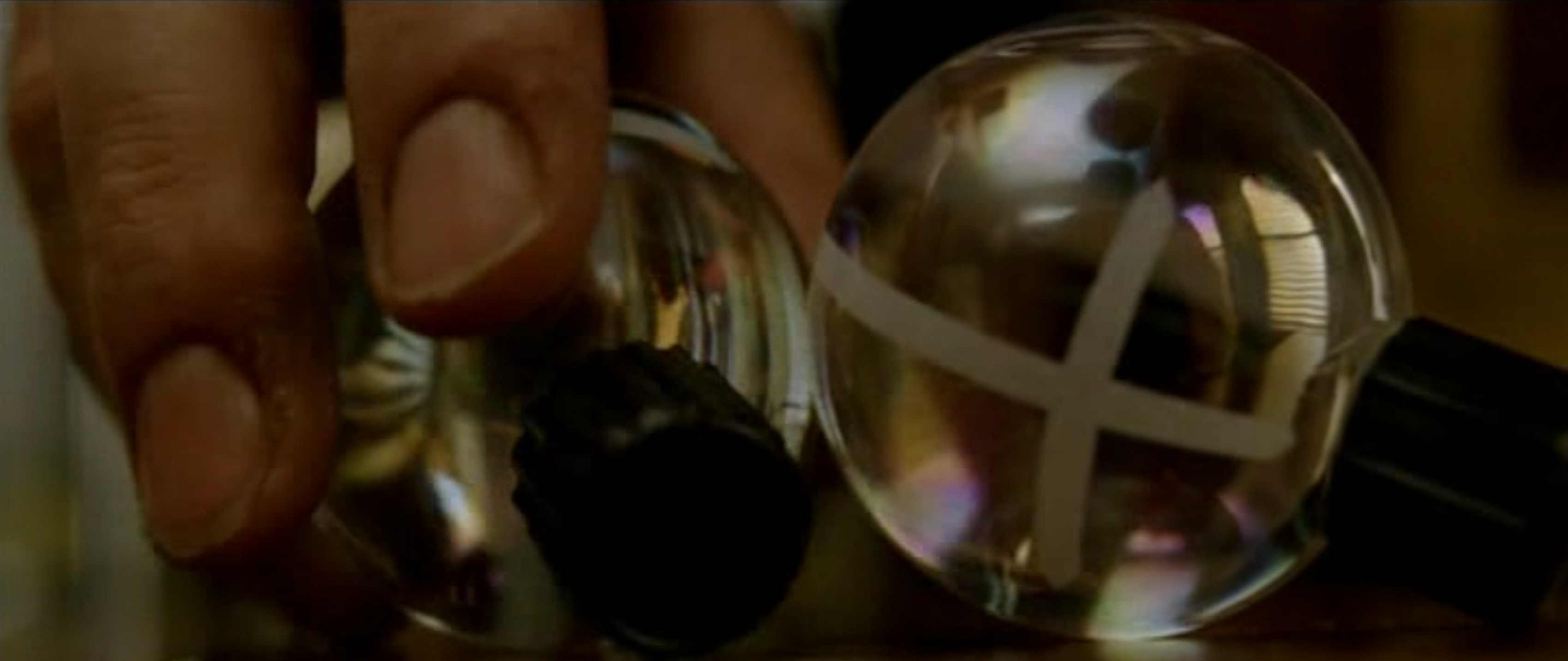

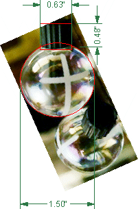

The measurements were bugging me so I went back to size the pictures. 1.5" looks right if the knob is about 1/2".
I grabbed some more screenshots to confirm. I still can't figure out where that other image came from in the movie. I suspect that's a pic of a recreation.
I did see that there are more images from when he's in hell. Beeman fingers for scale.

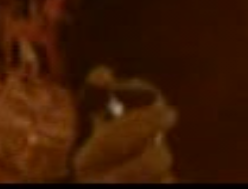

Tough to see on this one - the bluray might show more details. Constantine's holding the ampoule after getting out of the chair in hell.

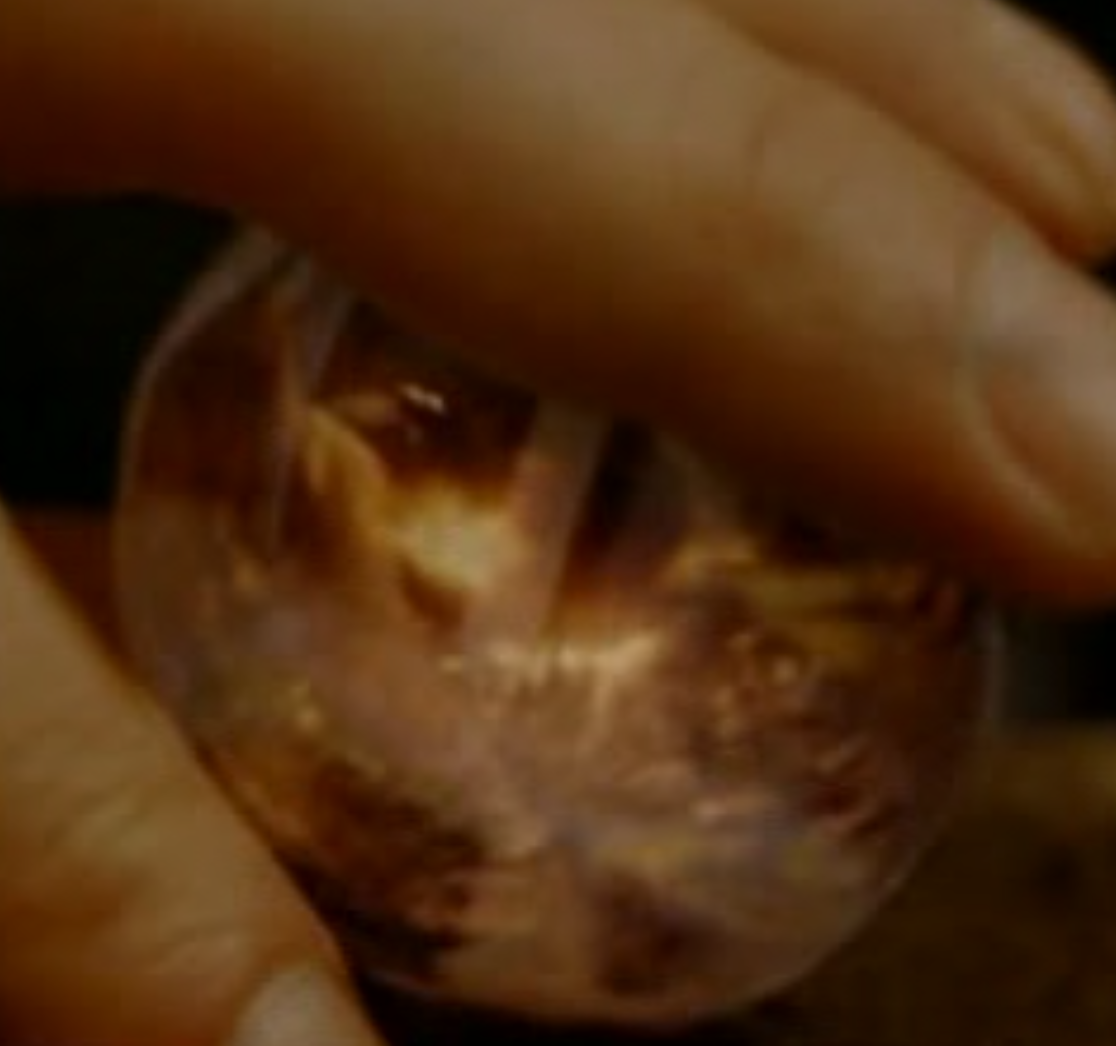

I'm sure this was digitally rendered but the cross is transparent on this shot suggesting etching.

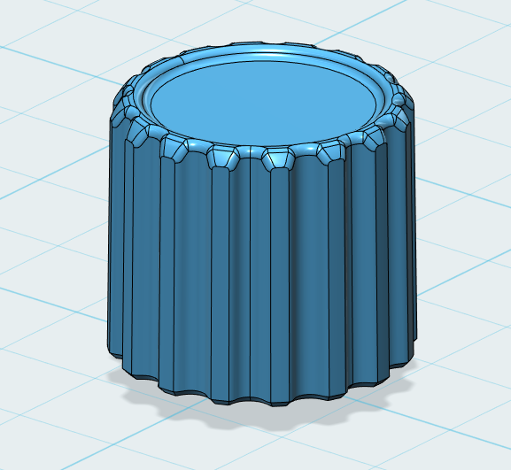

I may have a solution for the tops. How about vapor smoothed, FDM ABS?

I'm testing the knob print now. If they'd work, I've no problem printing them for you.

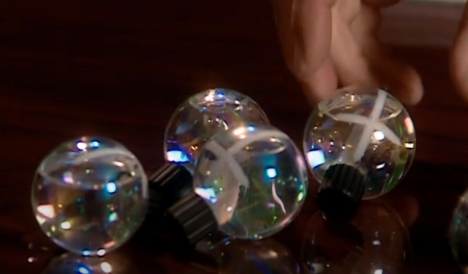

I'm with you on the "wait and see" when you get the parts in hand. On a different note, I found where the other image came from. Its from the DVD Behind the Scenes feature "Holy Relics". Some great close-ups of the crosses.
