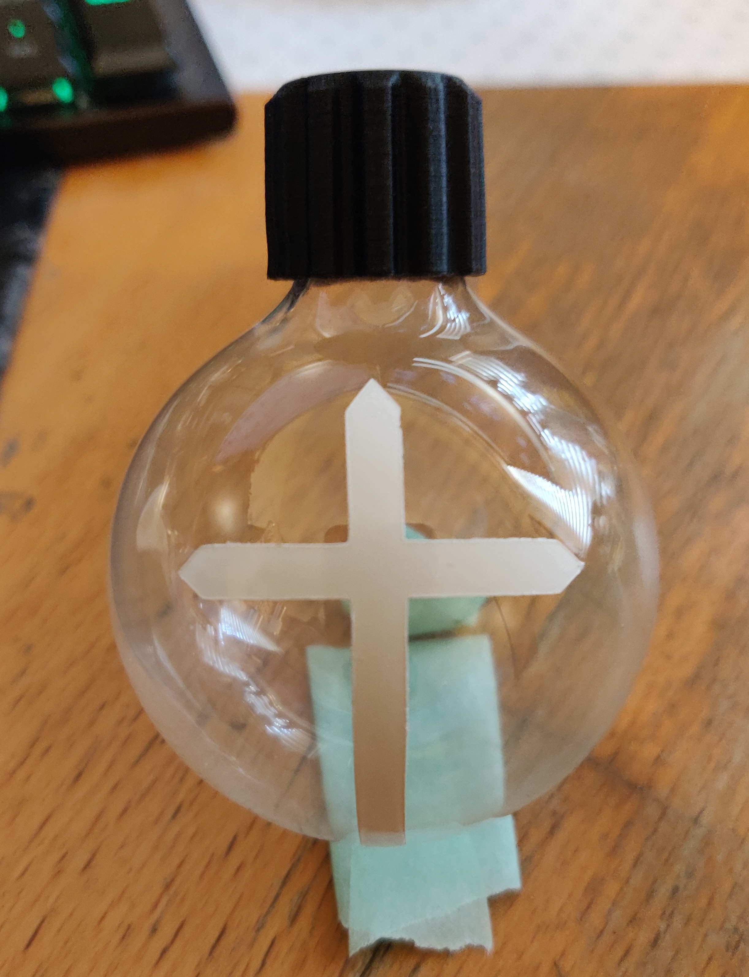

I spent the weekend resin printing caps and masking/painting the clear ornaments. I figured the painting was good practice for when I find the iridescent ornaments. I'm resigned to waiting for Christmas time to find them. The christmas tree is going to be rocking the extra clear ornaments this year as I now have 6-7 boxes of different sized ones. If you're going to use the clear ones shown in the picture below, get them here:
The necks are much straighter than the Christmas by Krebs brand that I previously purchased.

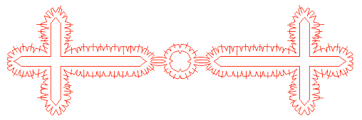

The file that I used for the masking is attached as a zipped SVG. The dimensions are 5" x 1.6". I'm cutting the mask on a vinyl cutter using Oramask 813 stencil film. https://www.amazon.com/gp/product/B079JB36NG. The main challenge is centering each side on the ornament. I weed the stencil then apply transfer tape. I center the stencil on the bottom of the ornament using the center circle and then fold up to the neck of the ornament on both sides. Burnish the edges to make sure the stencil is stuck and then carefully peel the transfer tape. Then remaining uncovered glass with painter's tape. I cut the tape into 1/2" pieces and tiled them on the ornament curves.

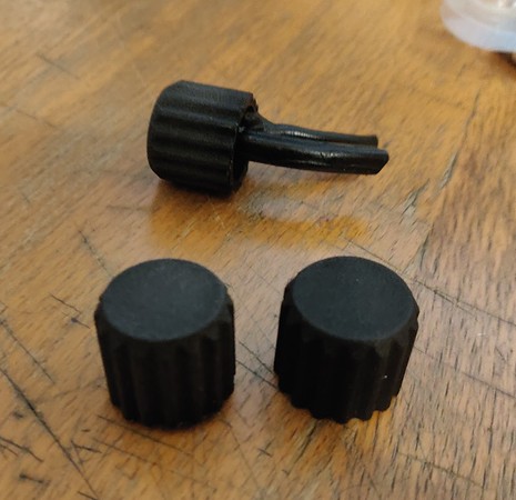

The caps are not resin printing as expected. I'm picking up support side blurriness that I haven't been able to resolve. I'm assuming I'll get it dialed in eventually but also I ordered MJF PA11 printed ones. More on that when I have them in hand. The STL file is attached.

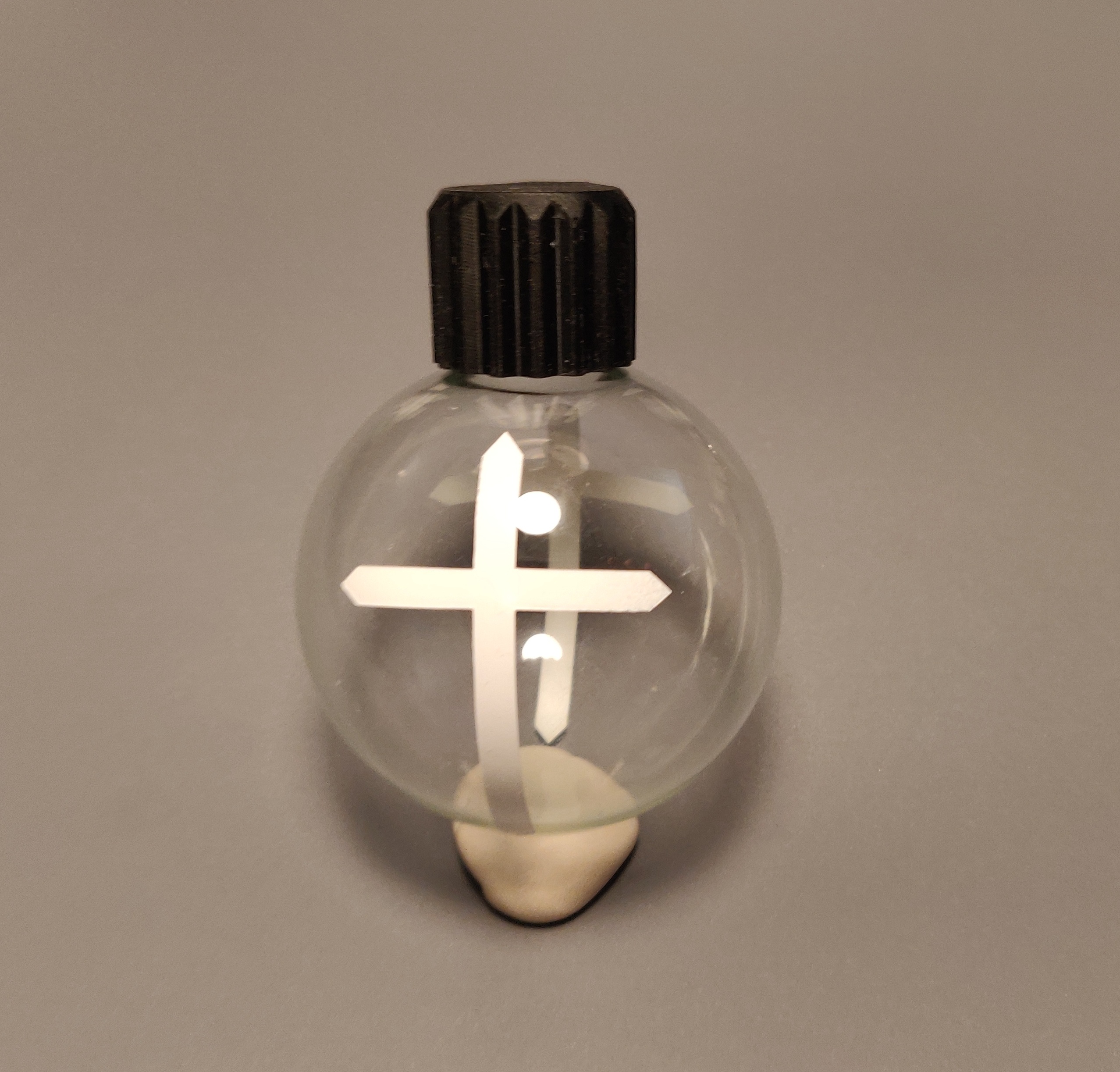

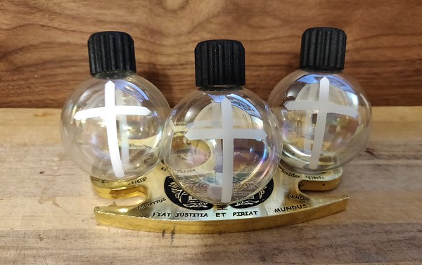

Got sidetracked in the key chain thread. I was able to find the correct soap bubble ornaments in a Christmas shop in Europe. They finally arrived and were masked/painted. The paint is standard rustoleum rattle can - semi gloss white. Aligning the mask to the center of the spheres required a few jigs to get the placement right.
The SLS printed caps were not color safe around alcohol so they were molded and cast in Smooth-on Onyx casting resin.
The castings are on the left and the originals are on the right. I'm pretty happy with the detail. The simple sprue and riser were done using sticky wax and worked well.
A little dremel clean-up and they'll be good to glue.
