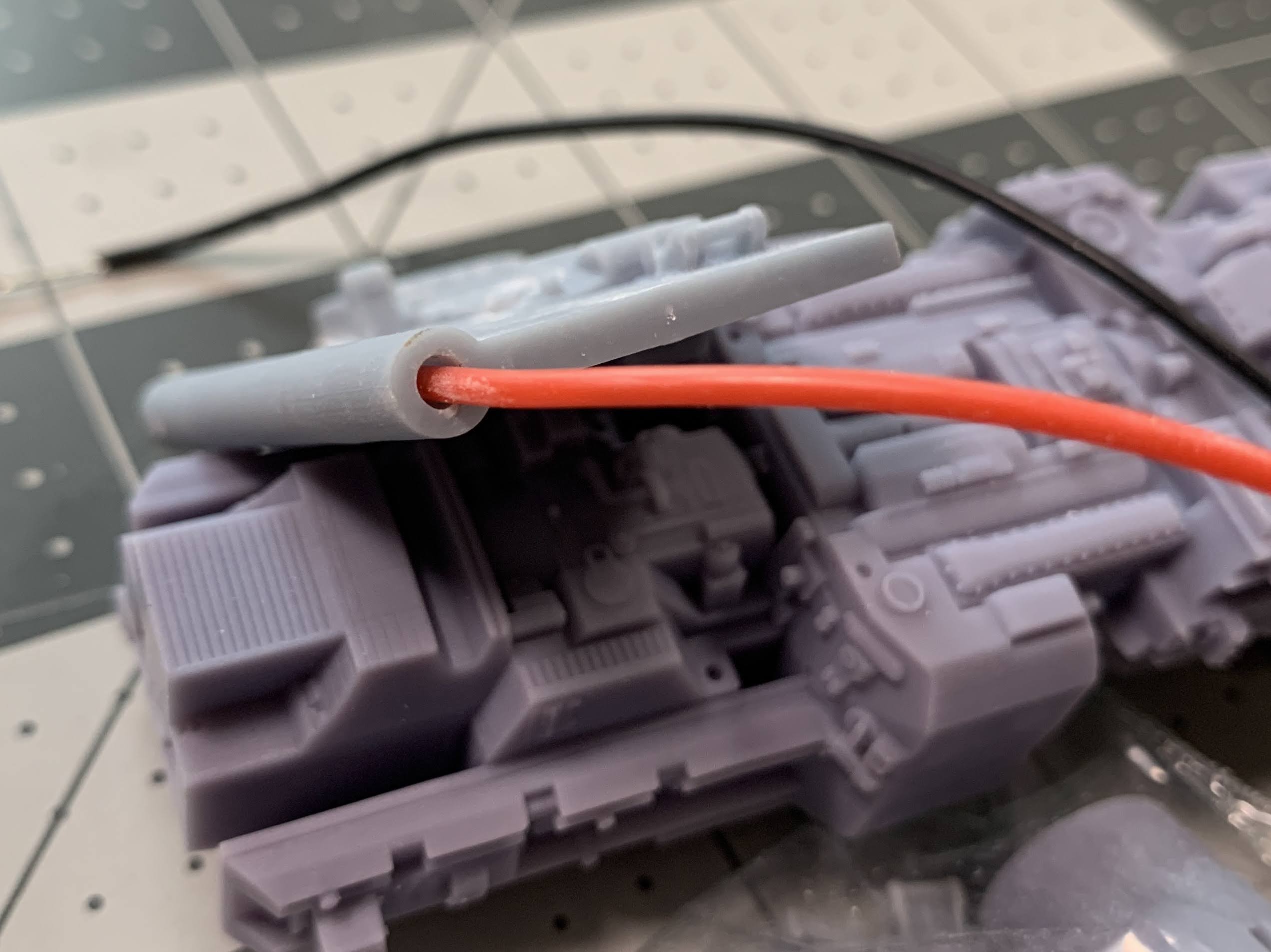

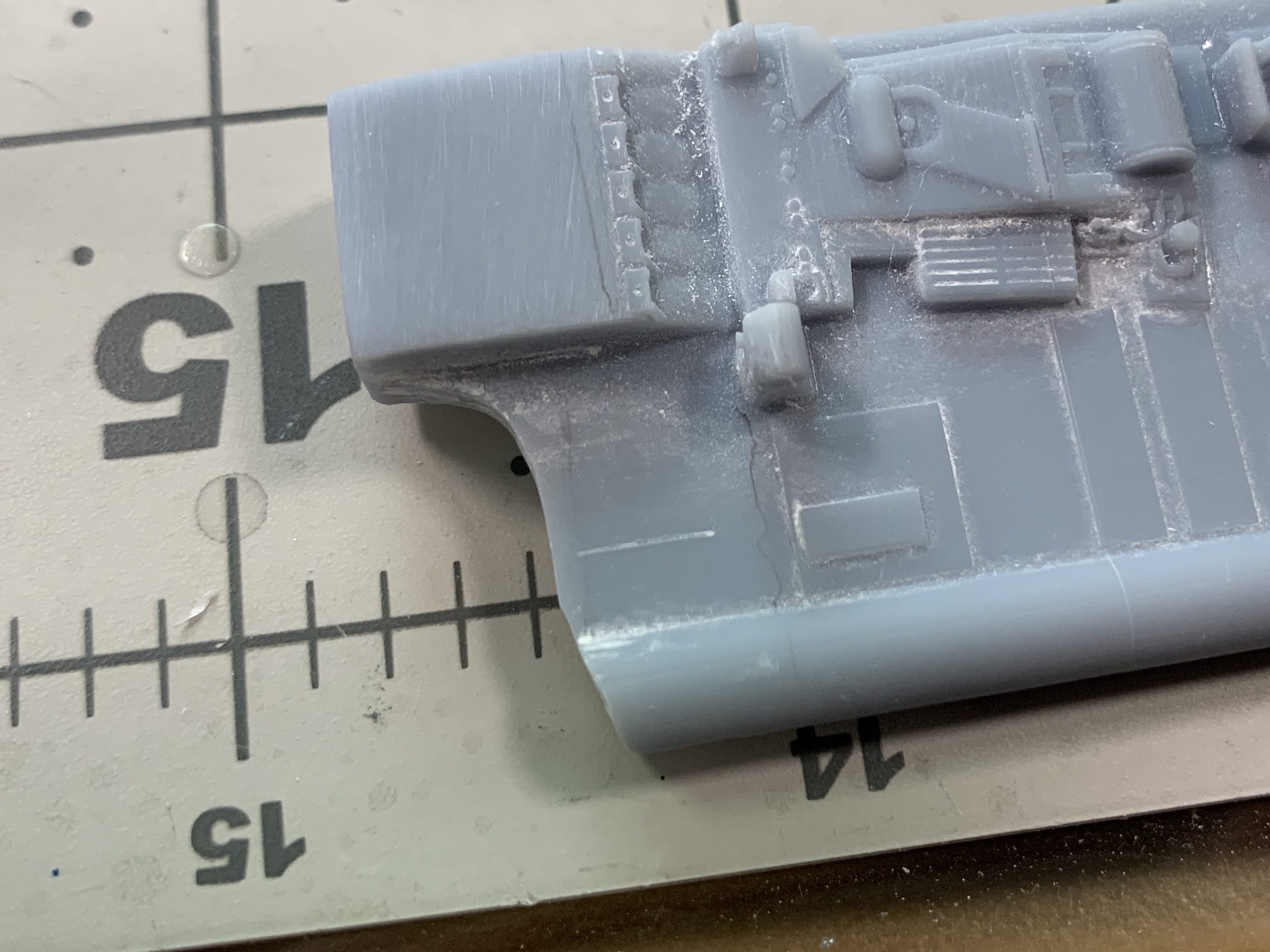

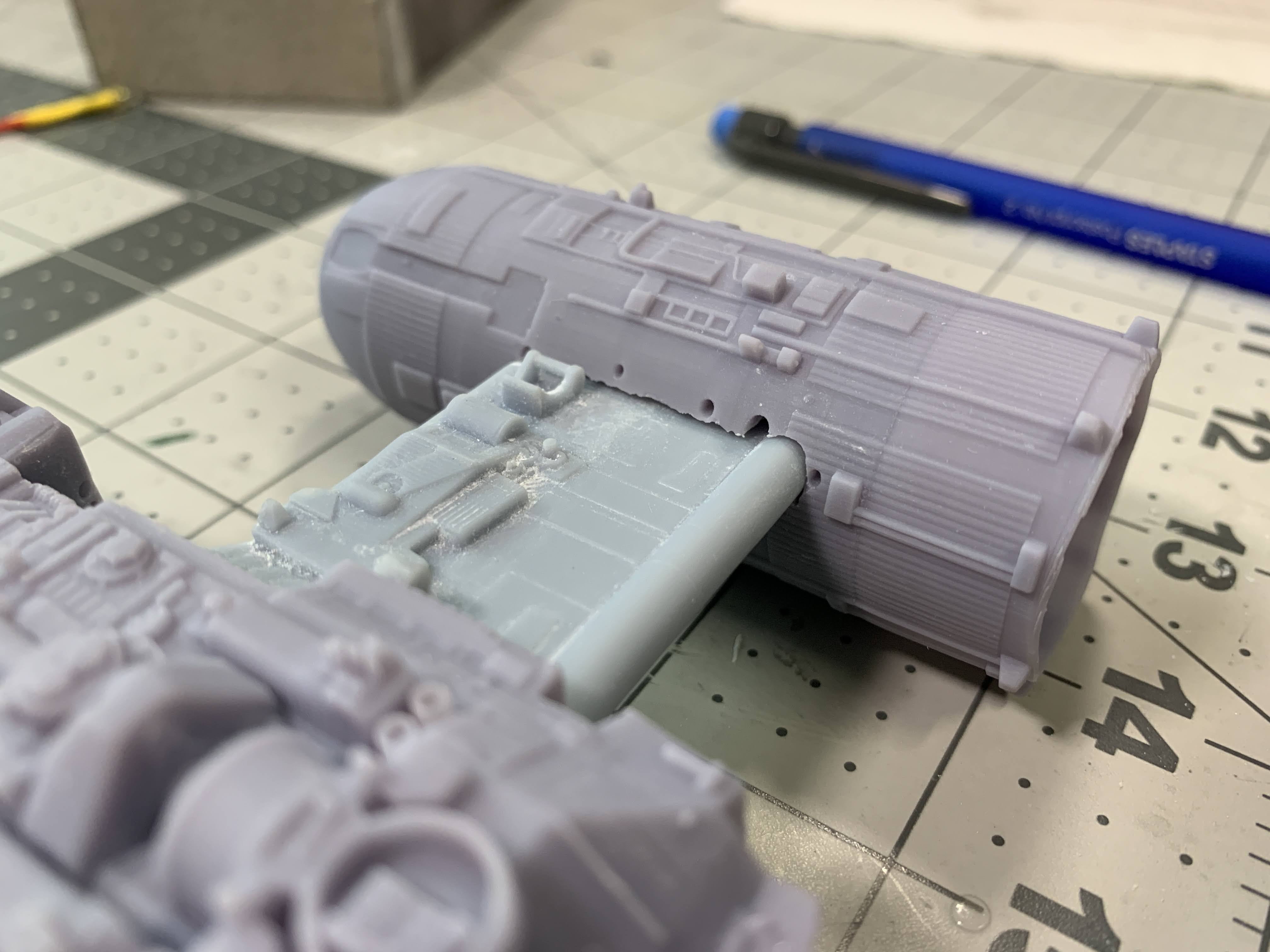

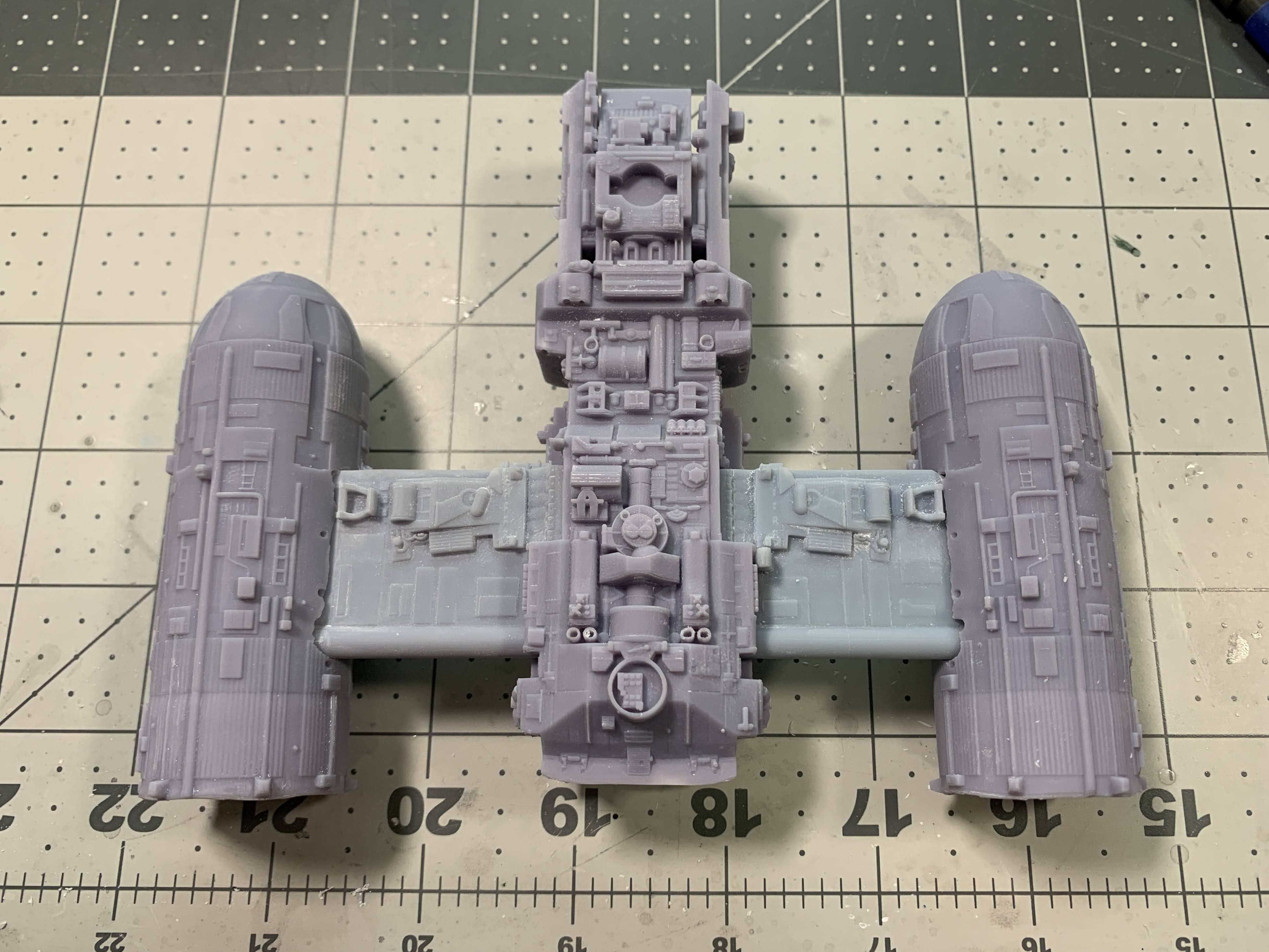

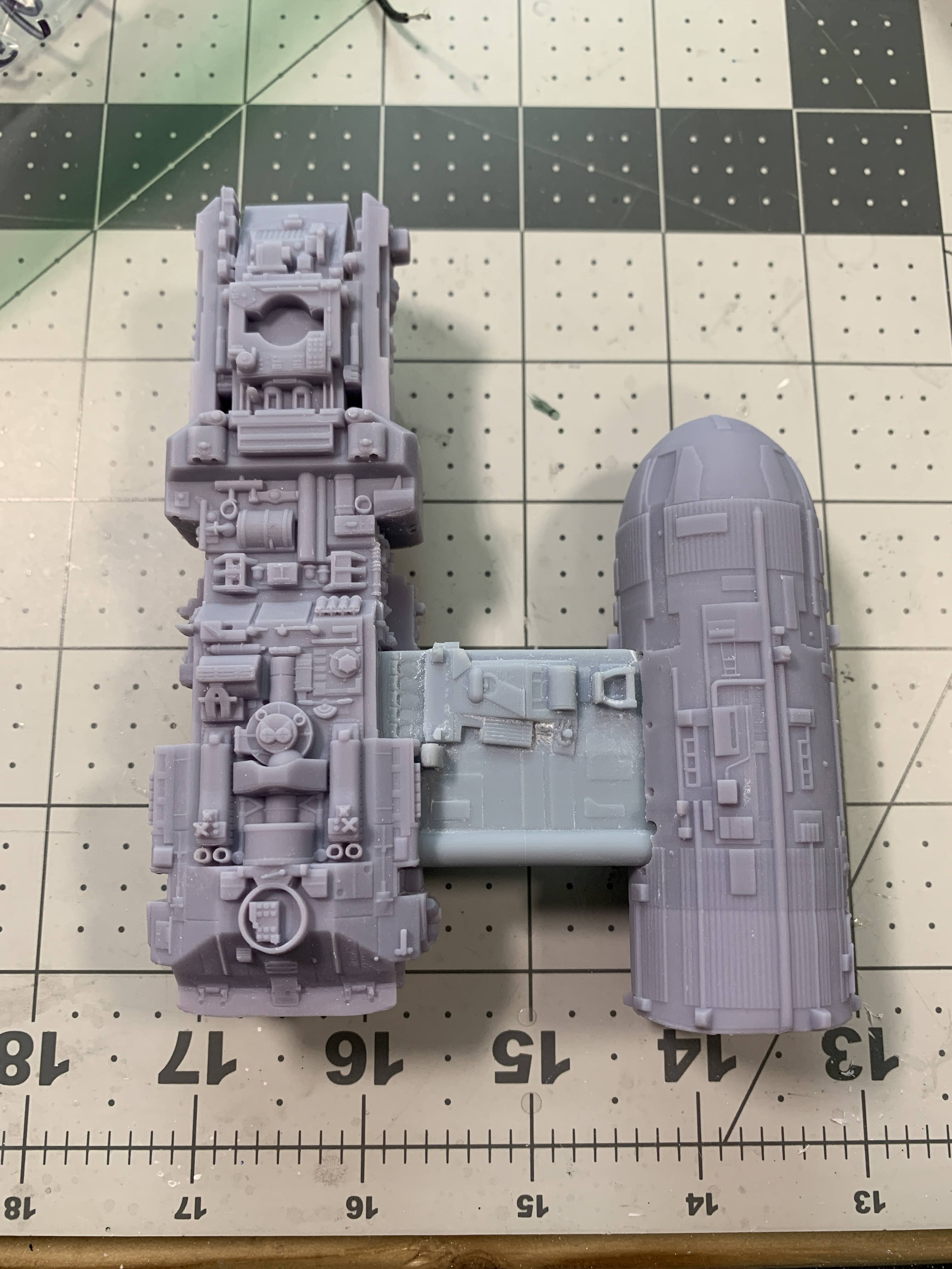

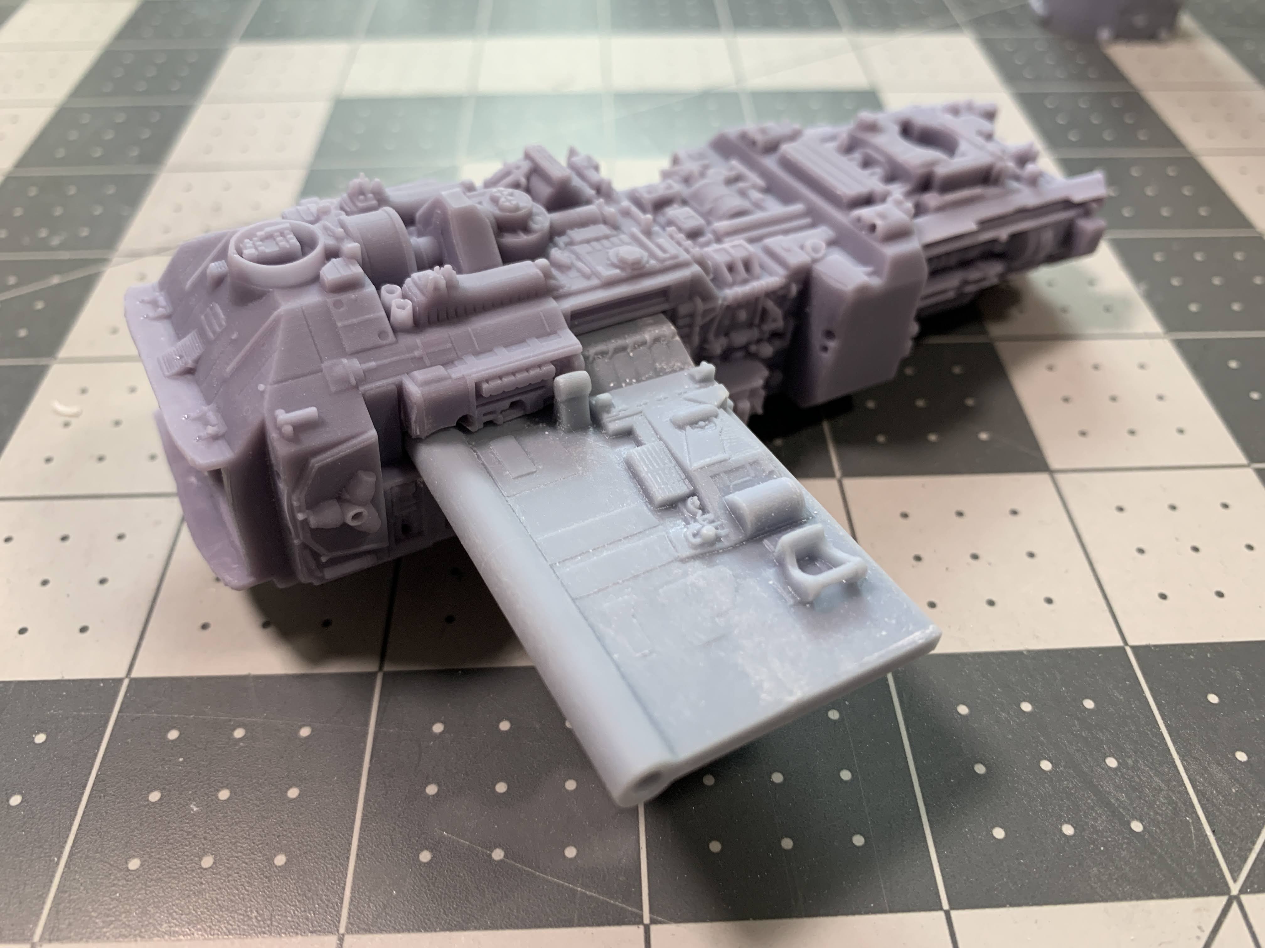

Bit of an update today! I did some work on fitting the wings to the fuselage. The right side went first. Just filing and fitting, and filing and fitting, until I broke out the dremel and just made the opening in the fuselage bigger. I gummed up the edge in the process, but that shouldn't be a problem to fix later. And LOTs of friggen dust. So. Much. Dust.

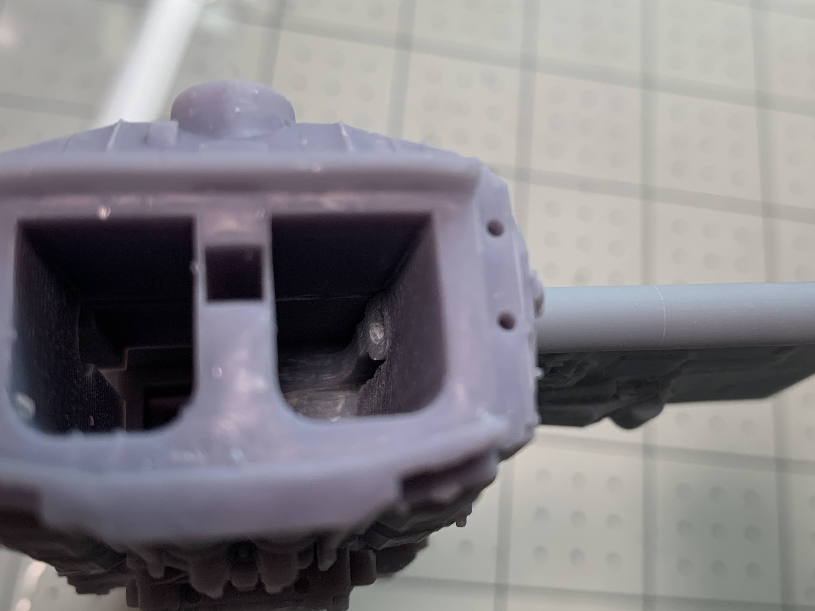

I ground out a notch out of the back of the wing where it is inserted into the fuselage, so that the wires have some room to bend. You can see in the photo above how it sits flush with the internal wall.
I have used 24 gauge wire on all of my lit models so far with no problem, but the hole that runs the span of the wing is too small for two wires to fit through, so I ordered some 30 gauge. Hopefully that works.
And here's the right wing and nacelle fitted:
(again, I gummed up the edge where the pieces mate together. I'll fix that later)
This was a big morale booster for me. This project got a little discouraging for me because things just weren't going together how I'd hoped (hence why I stopped working on it for a while). So I was pretty jazzed when this wing all came together!

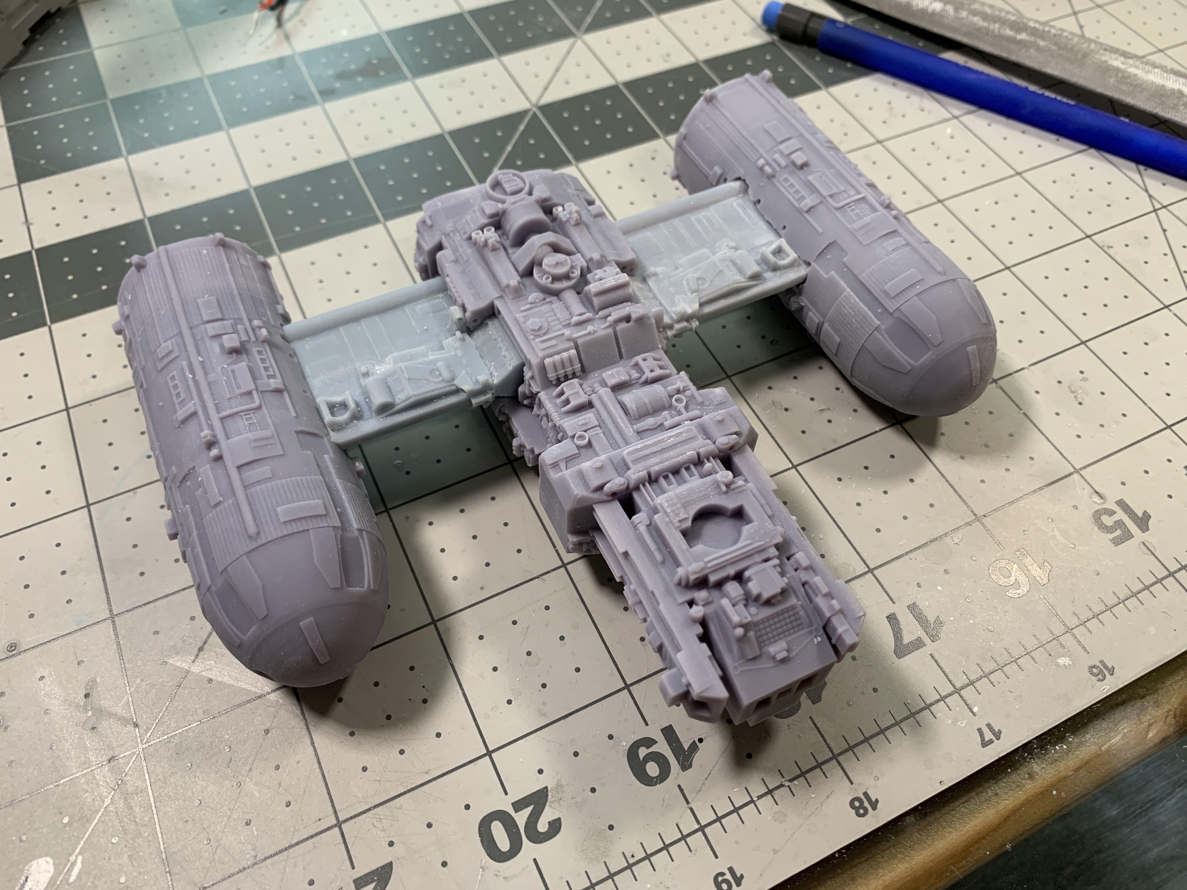

Rinse and repeat for the left side:
It's starting to look like a Y-Wing now! :D

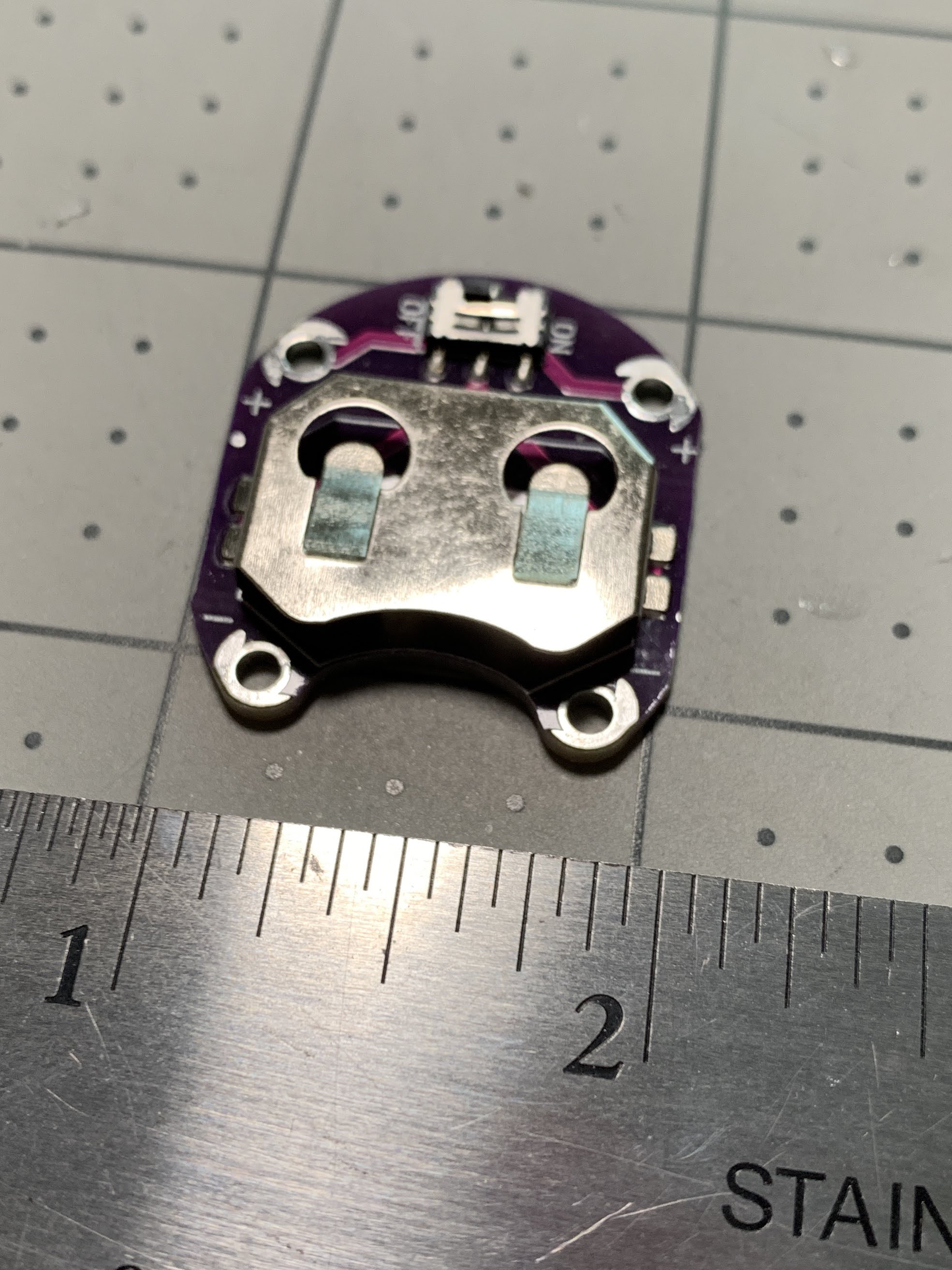

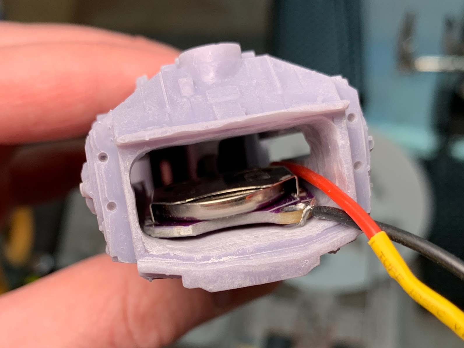

Then I thought a bit about how I'm going to power the two engine LEDs. I have a little coin-cell holder, but it's about 1/4" too wide to fit into the back end here, even after dremeling out a lot of the internal structure (AND LOTS OF DUST!):
Here's the coin-cell holder I have:
It's only an inch wide, but it's still too wide to fit in the back, and I don't want to remove too much material just for structural reasons. So my question is this: is there a smaller way to power (have the model be self-contained) some 3v LEDs? This is pretty small to begin with, but I'm hoping someone here knows a bit more about electronics and wiring than I do.

You can get really tiny lithium polymer batteries which will fit, I think I’ve got one that’s about 50 or 100mah which I plan to put in. The rub is that you have to also fit in a charger board, eg adafruit’s micro USB lipo charger. Should be possible to fit both in though. It will probably be easier to pop the back panel off and plug a USB in than change a coin cell battery as well.

Oooooooohhhh I like this idea for the batteries. Do you know which ones you have, by chance? I'll do some research on some. I have absolutely no idea about adafruit things or programming anything. I assume it's just a simple solder job.

Yes, if you get the adafruit lipo charger board you just get all your red wires and solder them to the power pin and all your black to the ground. Battery then just plugs in. Obviously you may want to add in an on/off switch. Adafruit Micro-Lipo Charger for LiPo/LiIon Batt w/MicroUSB Jack
The one I have in my electronics box is now out of stock where I got it, but this looks very similar: Verify your identity
I believe a lot of these small batteries are for remote control helicopters or drones, so if you have somewhere local that sells them you could try it.
I agree that you probably don't want your model to set on fire. If you buy a decent quality battery then I would say the risk is pretty low - the decent ones have protection circuits built into the battery. It's a small sample size, but I put lipos in almost all my models and my house hasn't burned down yet. You're quite likely to be carrying around a lipo battery in your pocket about 90% of the time, in your smartphone, after all.
Well, after doing some research last night on LiPo's, I think I'm just going to stick with my CR2032 with on/off switch. I soldered up my two red LEDs with a resistor, and now I just have to carefully remove enough material from the back of the model to fit the holder/switch inside. Thanks for all the comments, though!

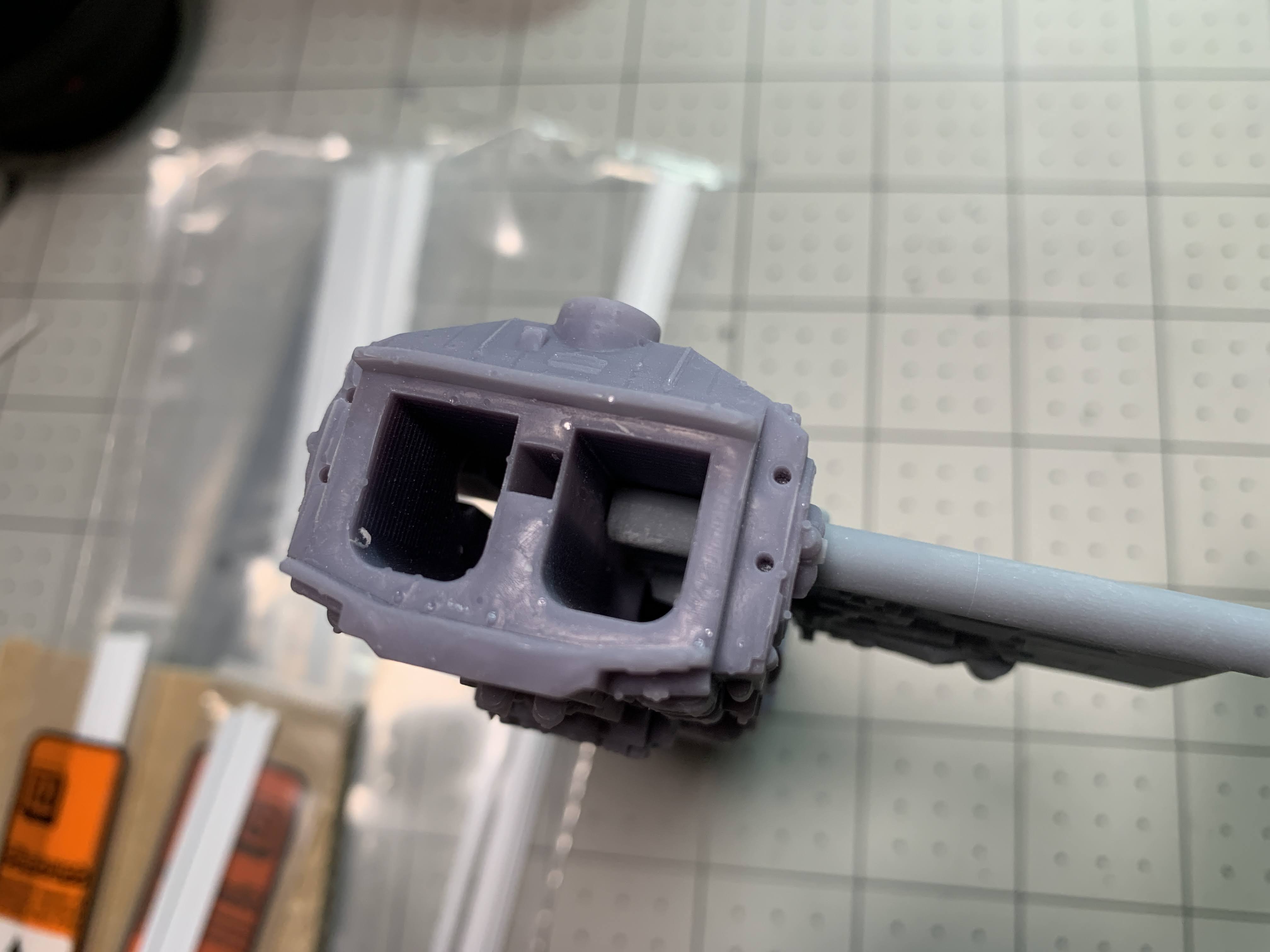

Little update time:

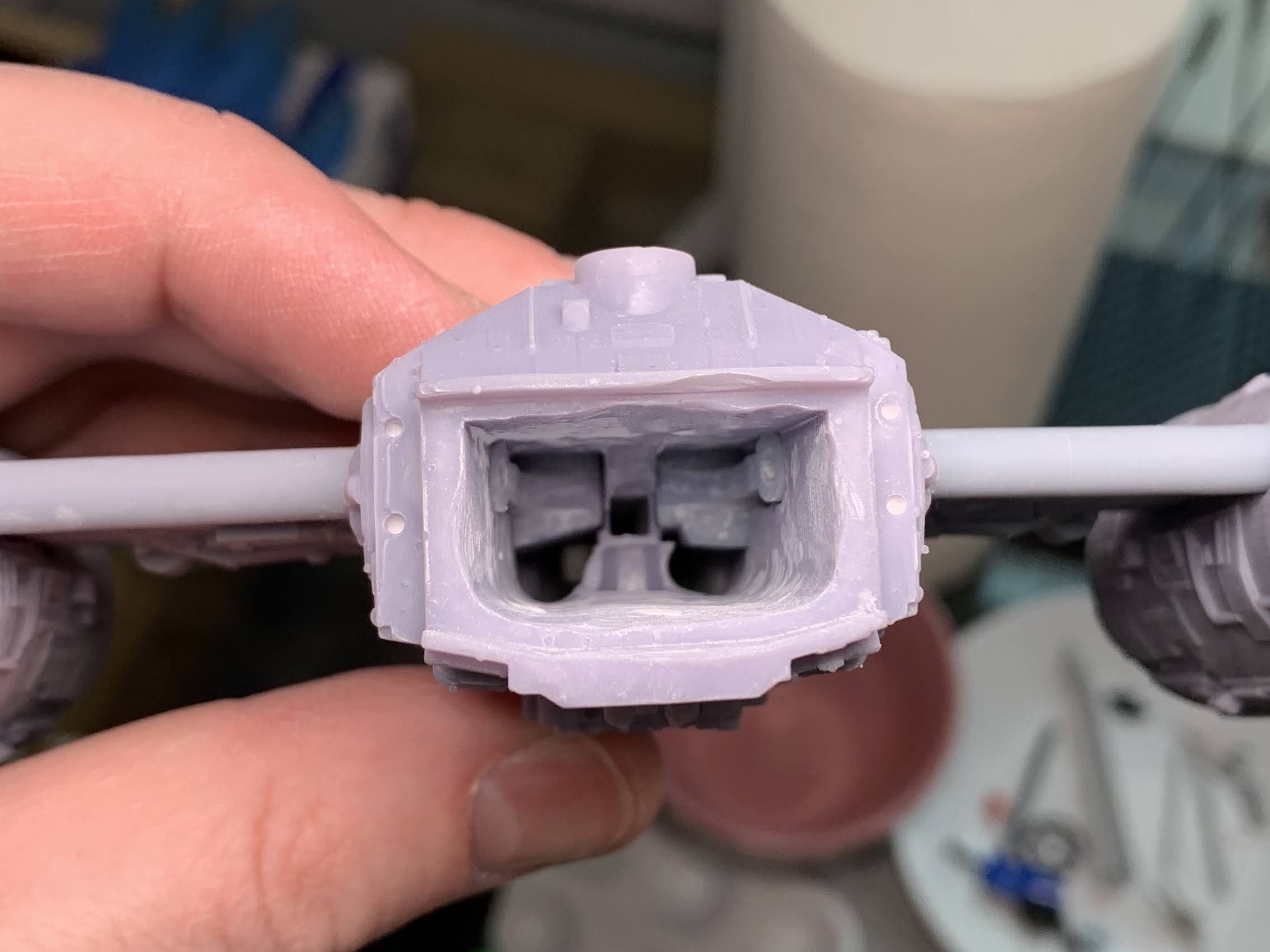

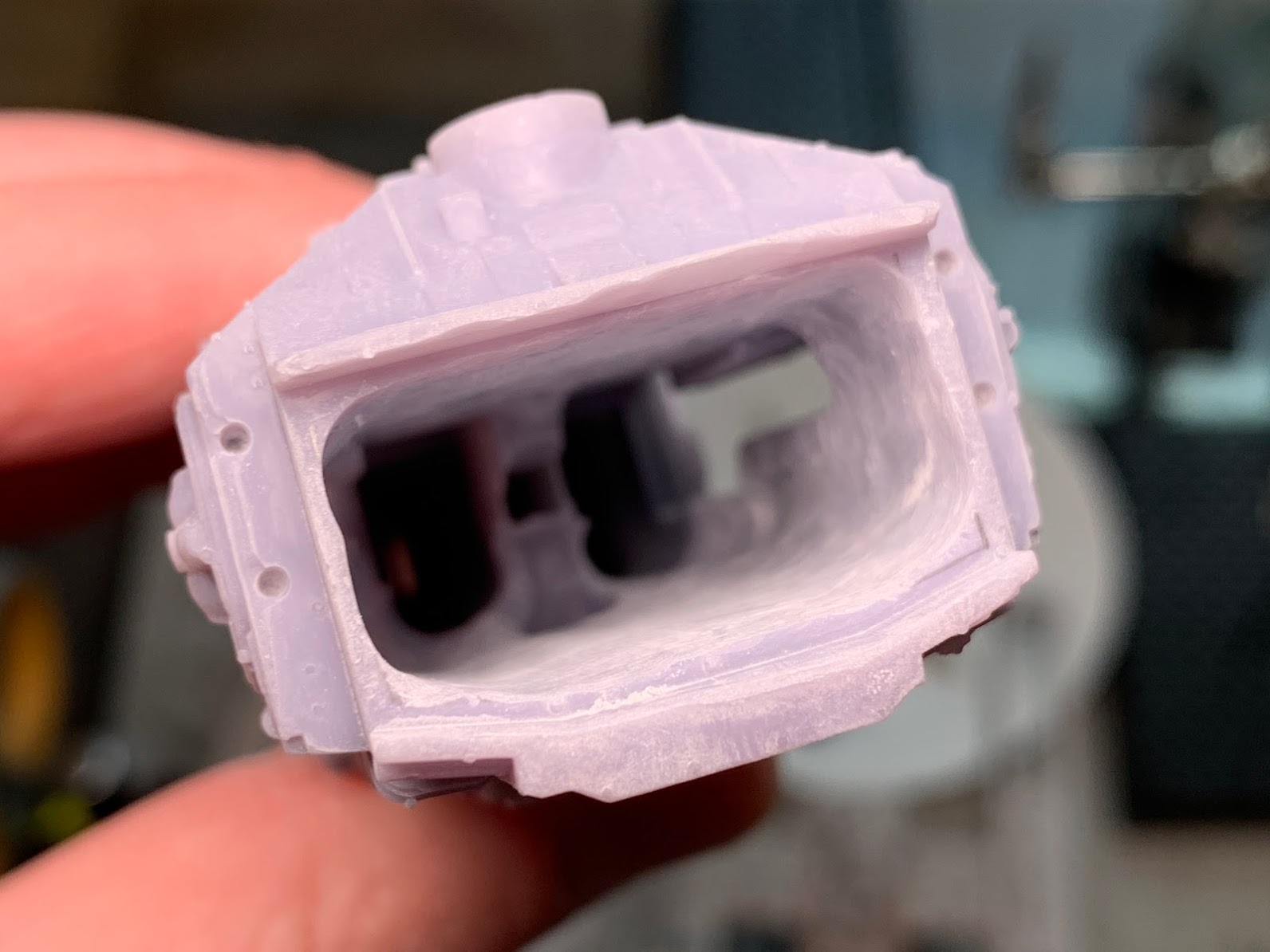

The sun was shining today, so to avoid filling my hobby room with resin dust again, I sat outside and dremeled out the back section of the Y. Got it large enough to fit in my trimmed battery holder. Also did some cleanup on the engine sections. The L'eggs cones had a weird bulge in them, so I filed that out. Now I need to fill the hole in the cone that I made so that the resin could drain out.
Next time (if there IS a next time), it would be way easier to hollow out this back section in the computer. It'd save on resin, as well.

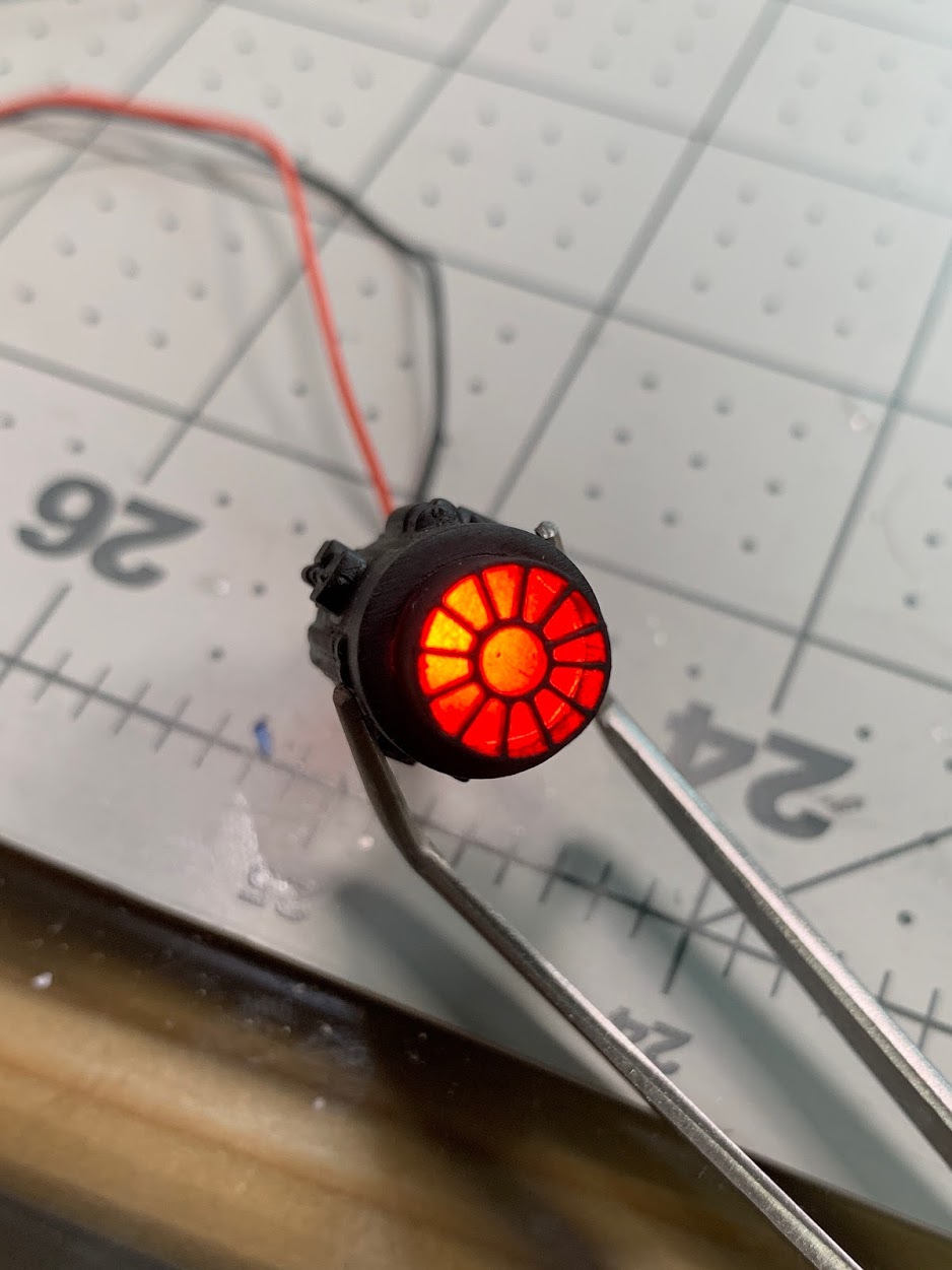

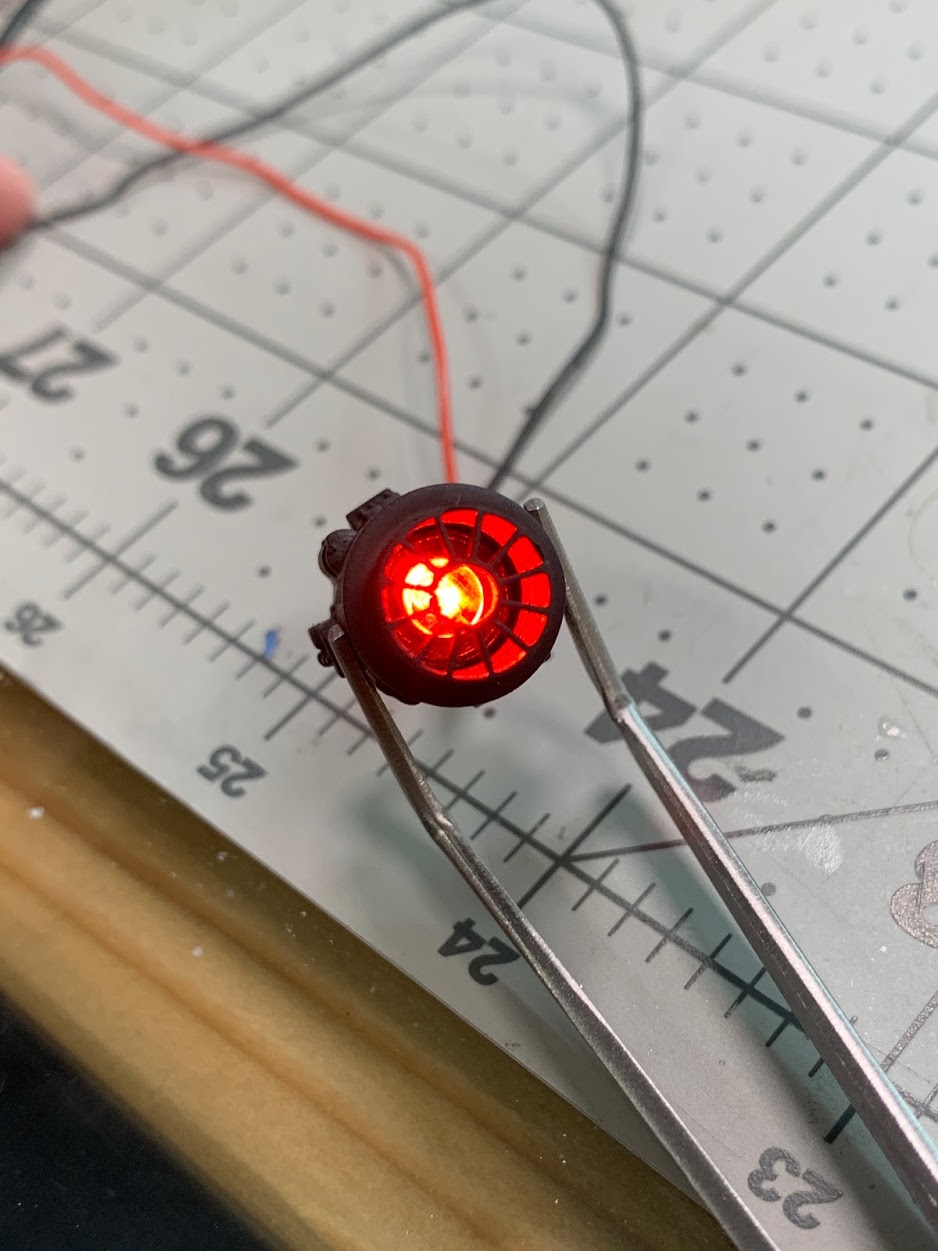

Working a little on the LEDs today. The first shot is the bare LED bulb, and the second shot is with a little bit of sanded plastic added in front as some diffusion. Thoughts on this? Which one do you guys like better?
I like how the bare LED has a white hotspot to it, but I really dislike seeing bare LEDs in model builds. I like how the diffused version hides it all a bit, but it does cut down on the light output somewhat. Thoughts?

I have the same dilemma every time I build a Star Wars model - I like the look with the hot spot, but to some people it does just look like an LED. For what its worth, I usually put a diffuser in - often a transparent piece of plastic with some thin white fabric glued onto it.

When it comes to the LED I like the unfiltered light effect but I know what you mean about bare LED's. Might be a way to get both effects. If a very thin filter is concave (or even a truncated cone) then the center portion closest to the LED will be brighter giving you a "filtered" hot spot and the outer edges that curve or slant away will transmit less light but still glow.

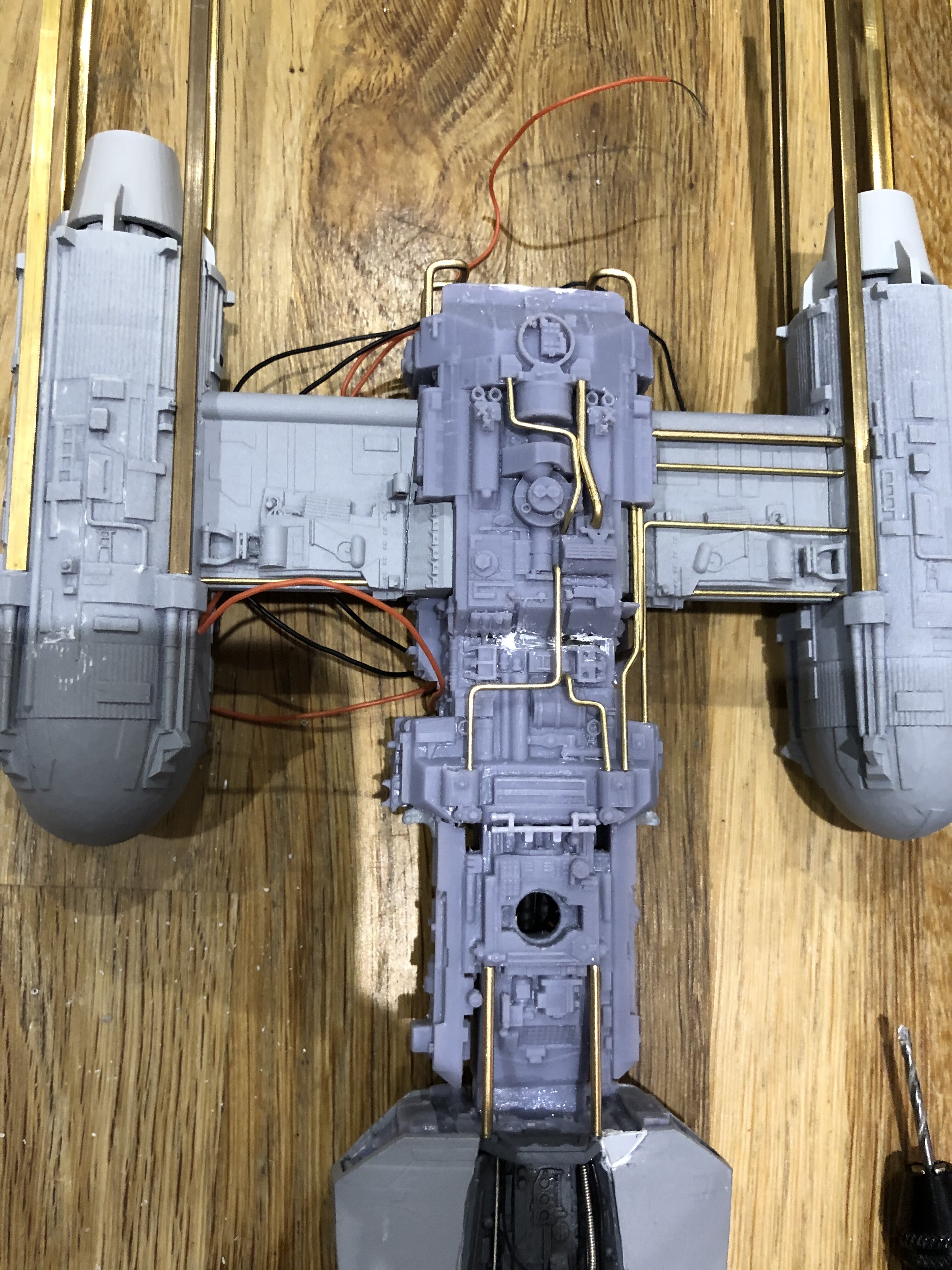

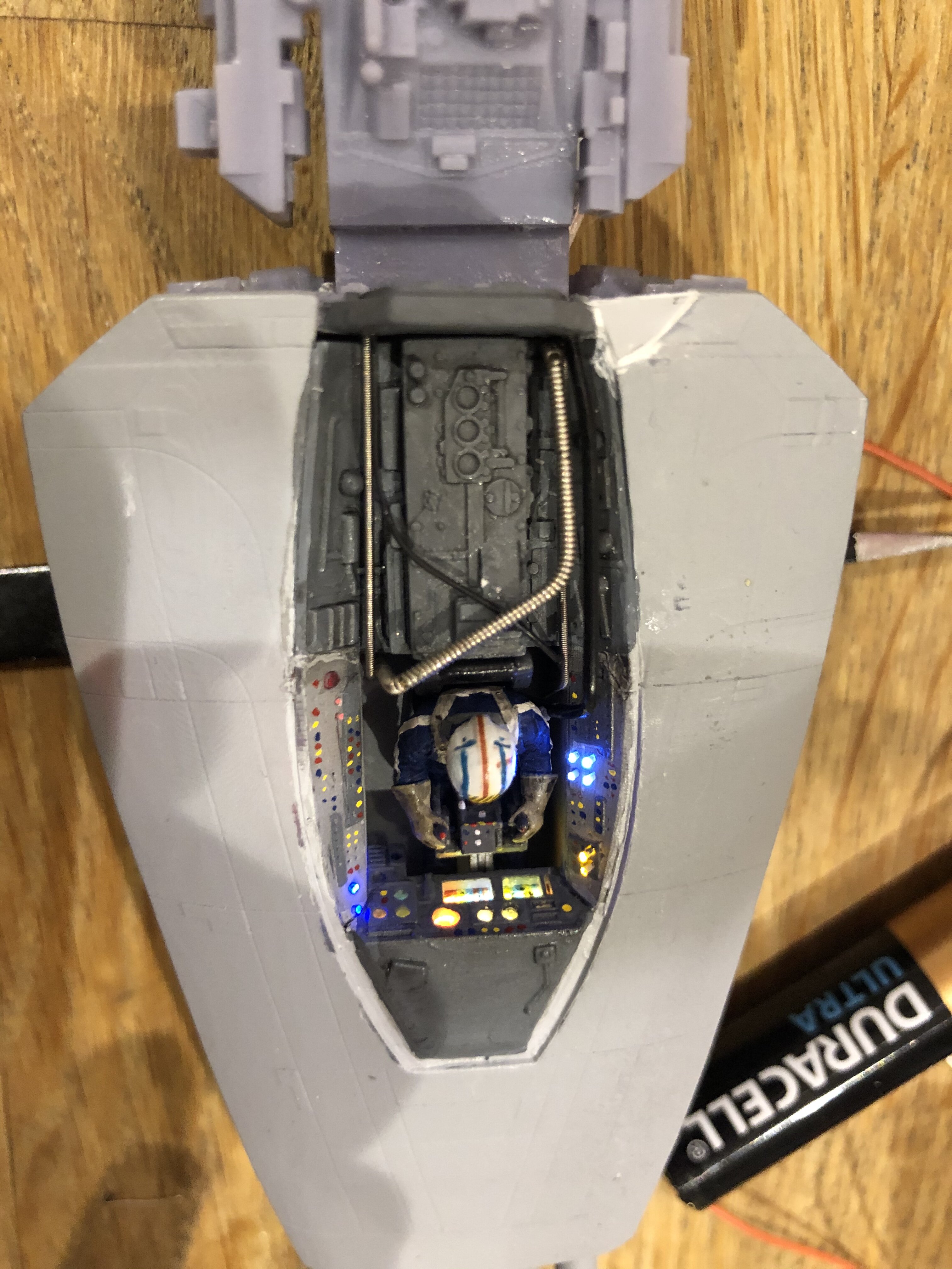

Jeez there are a lot of pipes all over this thing. I’ve started adding them on using a couple of different diameters of brass rod and some stiff wire. Luckily I’m not aiming for complete accuracy, but I’d like it to look pretty close. I’m assuming the Bandai 1/72 is accurate in this regard so I’m using the instructions from that to guide me. So far it’s actually looking a lot less bad than I expected!
also added a few random pipes/wires/guitar strings to the cockpit.
Jimw100 That's looking awesome! You're ahead of me, that's for sure! I went and got some 1/16" styrene to cutout the vanes on the back of the engine, as my parts warped coming off the printer. I had hopes to cut them out using a laser cutter, but that laser seems to be doing more melting than cutting. Maybe I'll have to do it the old skool way. Or just sand the warped parts flat. Gotta make up my mind!
Yours is looking great though! I am definitely going to be following the Bandai instructions for my piping as well. It's a handy little guide, rather than trying to look through years of studio scale build threads where all the photos are missing...

Haha, I was kinda worrying about getting the angles right with all the pipes and then last night I had a look through all the reference I could find for the studio models...turns out they weren’t bothered about making it look neat when they made the originals! So the more wonky mine is the better I think!

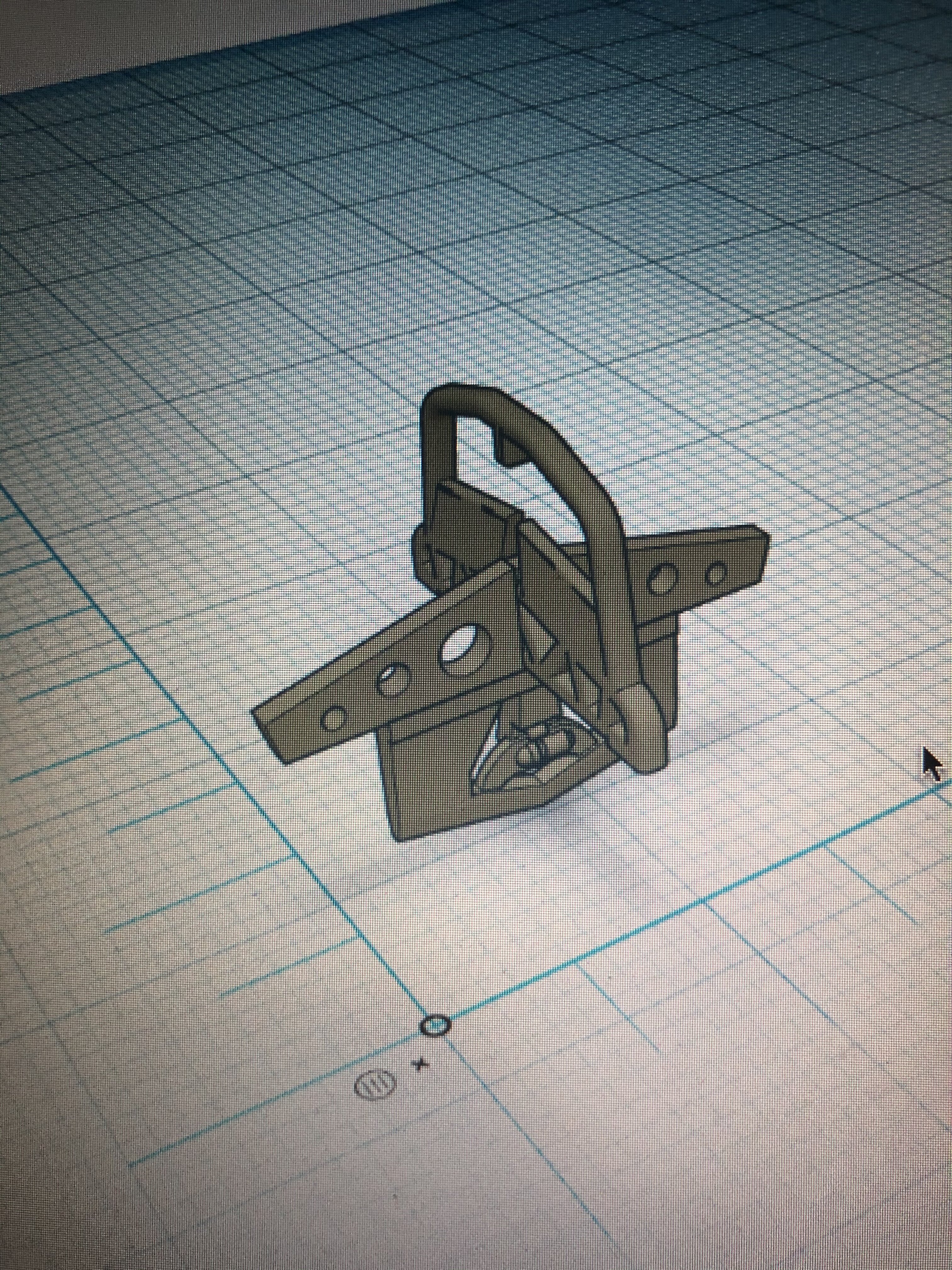

For the vanes I think I combined the two pieces that form a cross shape when viewed from the rear in tinkercad and printed them as one piece for each side, and they came out pretty good with no real warping. I oriented the parts as shown on the screenshot, straight up and down with the most fragile looking bit furthest from the build plate. 0109E5E7-10E9-4CC0-8AE3-AECE9FA9F1F5.jpeg
