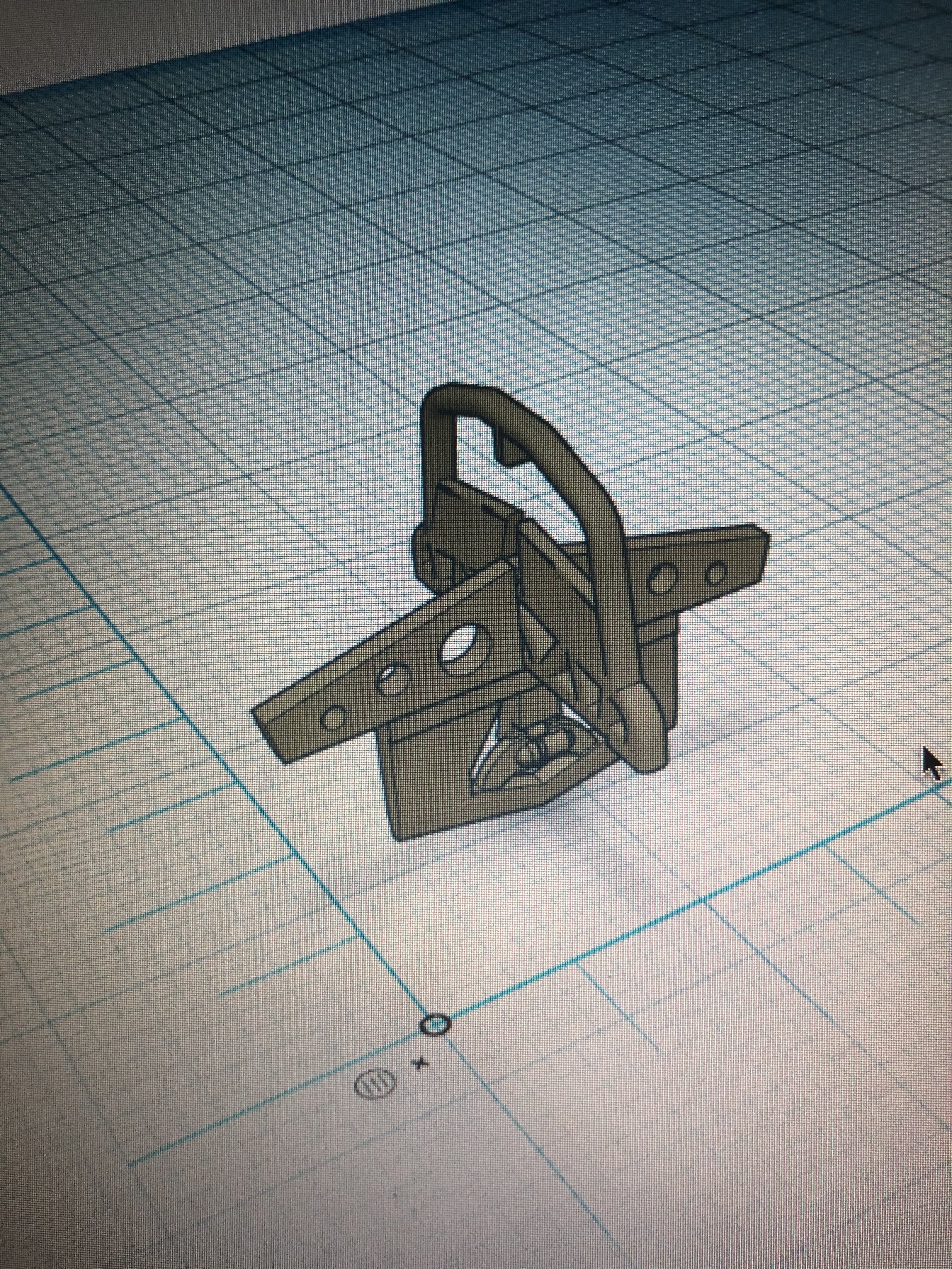

For the vanes I think I combined the two pieces that form a cross shape when viewed from the rear in tinkercad and printed them as one piece for each side, and they came out pretty good with no real warping. I oriented the parts as shown on the screenshot, straight up and down with the most fragile looking bit furthest from the build plate. View attachment 1413120

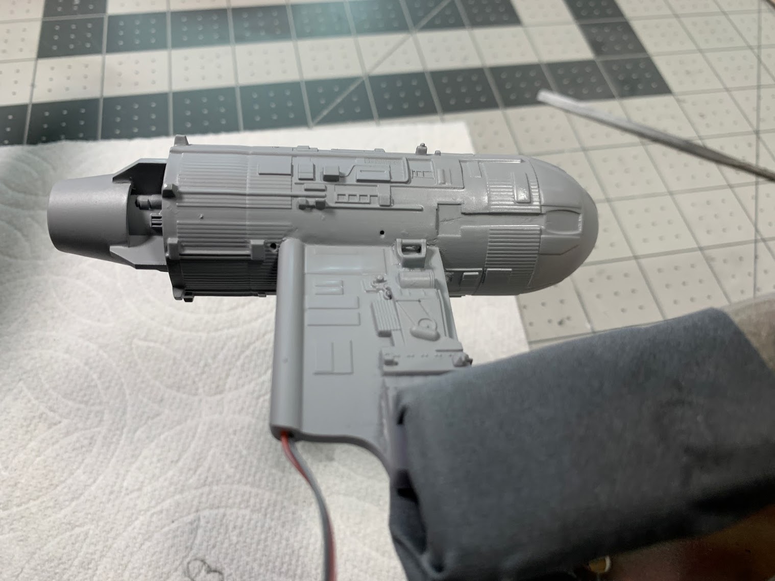

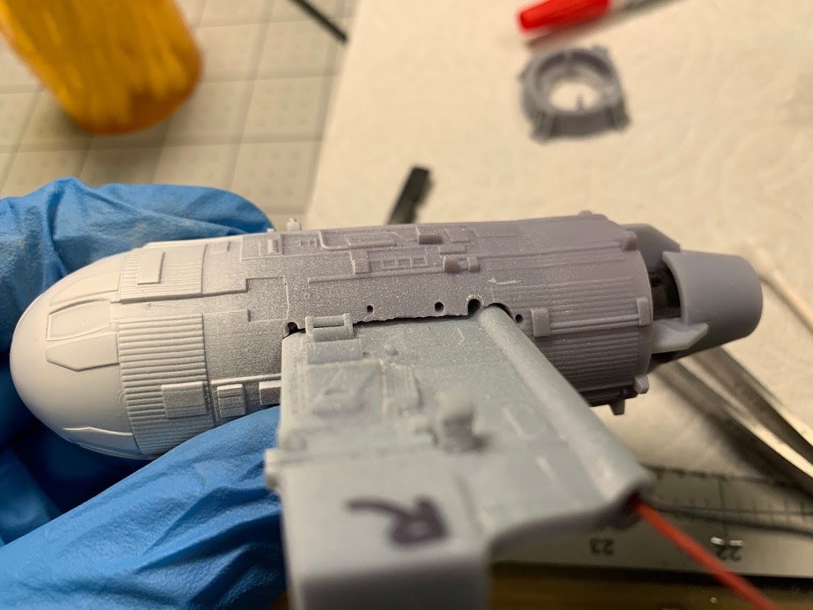

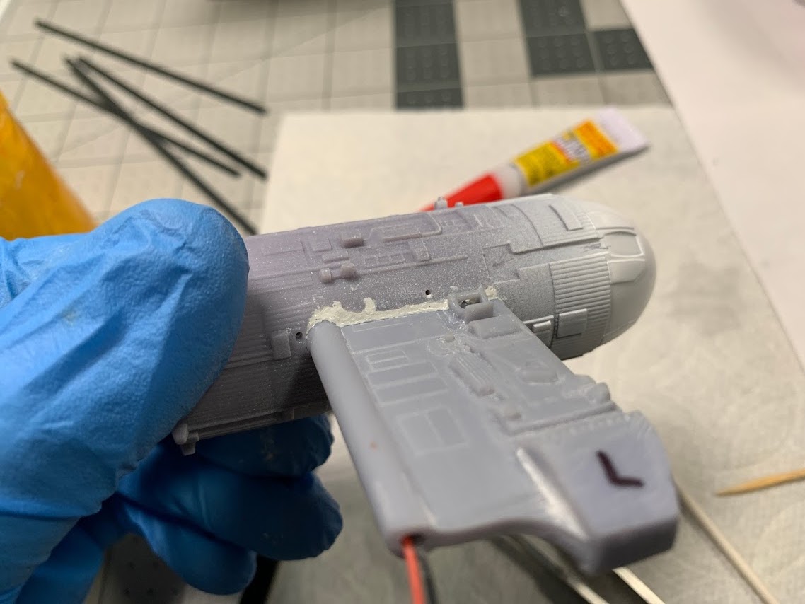

Okay, a little update for today. As I said earlier, I roughed up the edges of the slot in the engines where I had to insert the wing. Next time I will scale the wing part down by one or two percent so that it fits together more easily. So here's the gnarly edge that my dremel created:
I used some Apoxie Sculpt to help reinforce and fill that joint a bit:
And here it is after some sanding and a bit of primer. There's nothing like primer to let you know that your putty job is crap! :lol:

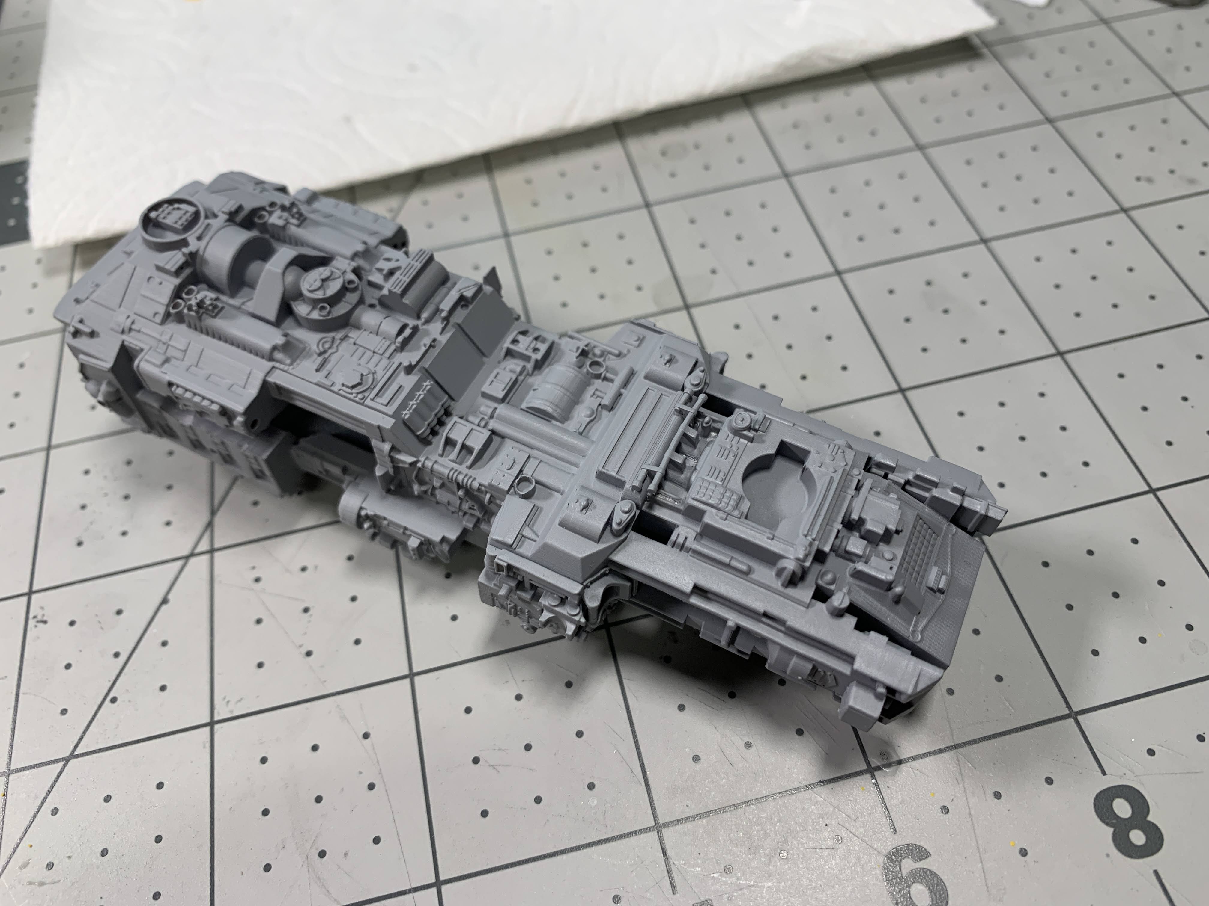

Little update for today. I glued the rest of the greeblies onto the body and hit it with some primer. It really makes the details pop! I'm very happy with how the body is coming out.

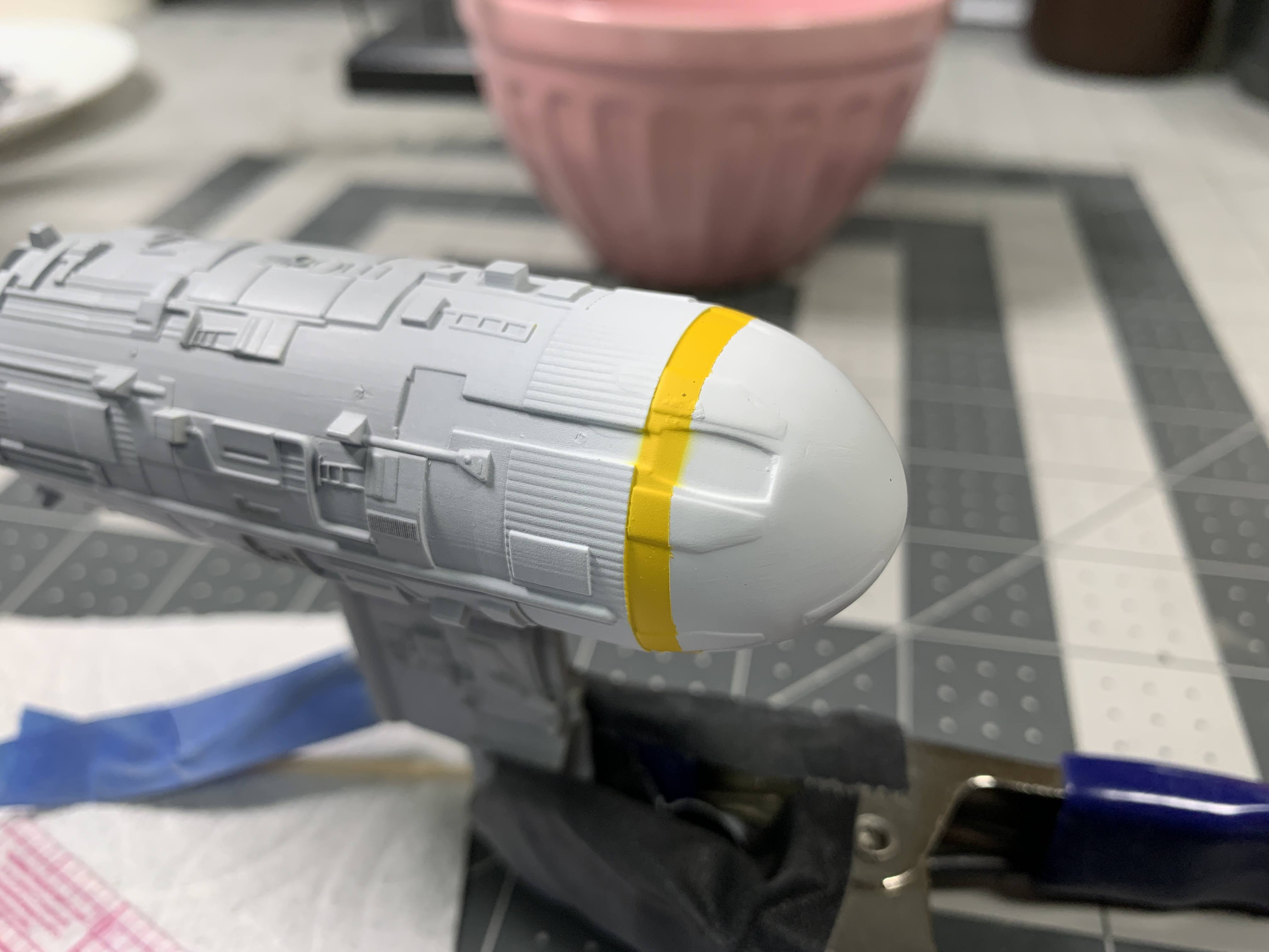

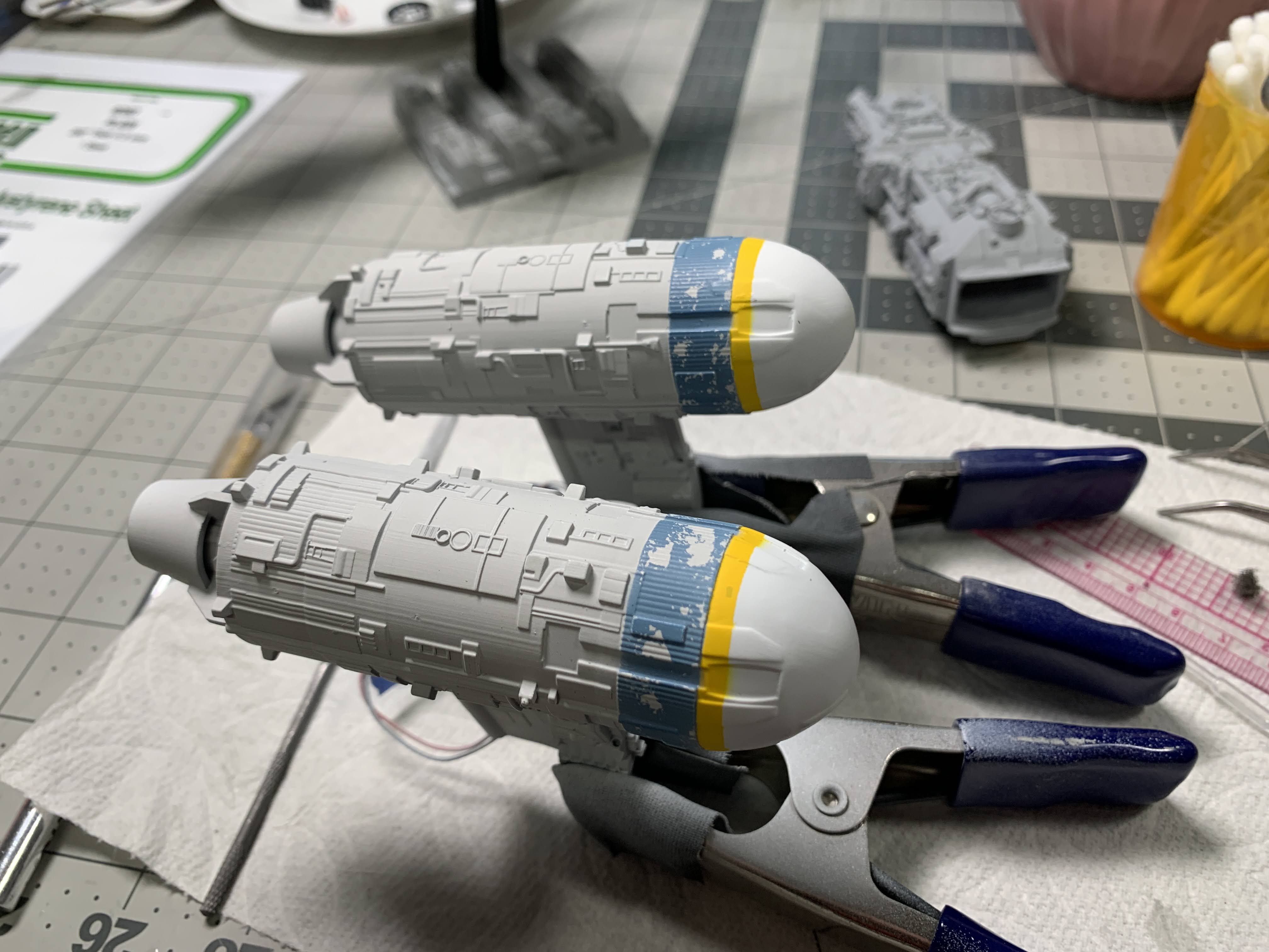

Then I did some masking and painting on the engines. Feels good to get some color down, finally. The blue is waaaay too blue. I'll knock that back with some thinned base color eventually. Hopefully lessen the contrast there.
That's all for now. Next step is to paint the clamps and T-track, and stick 'em on.

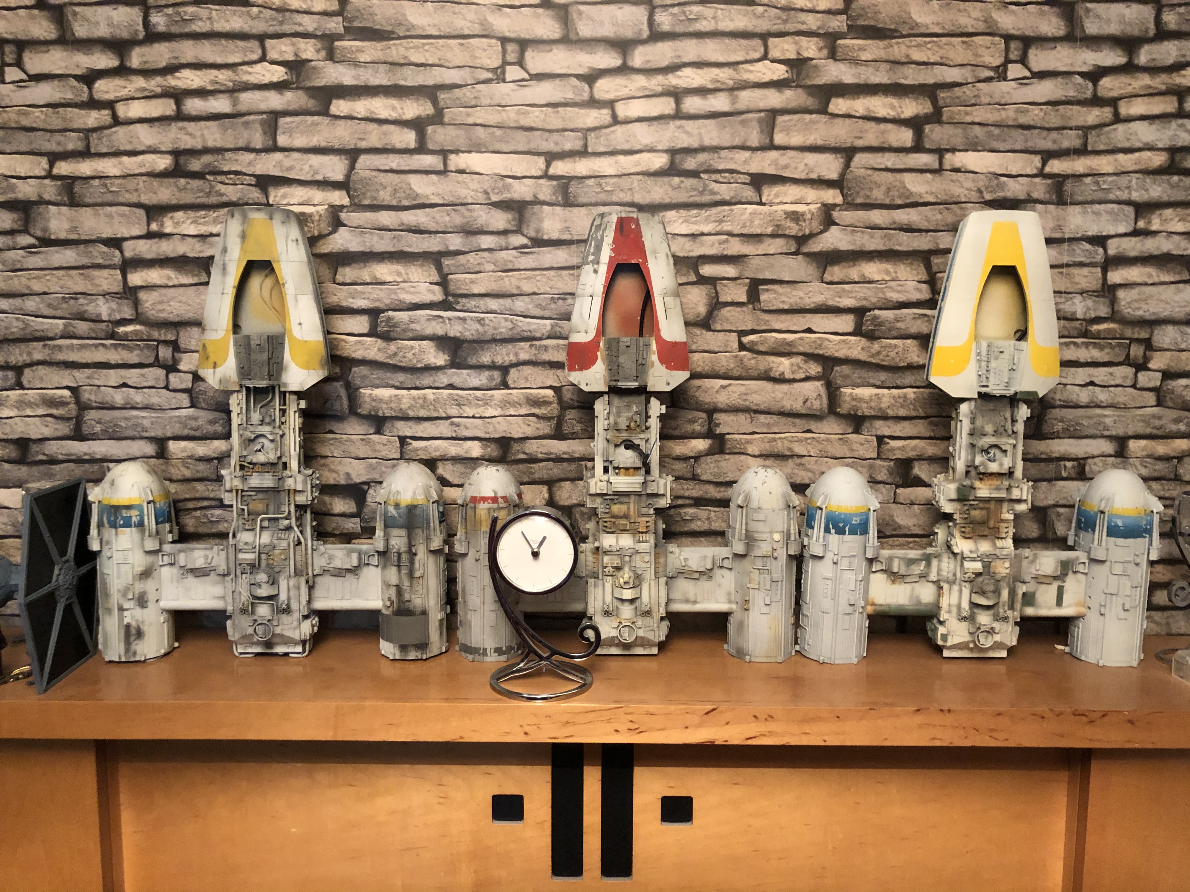

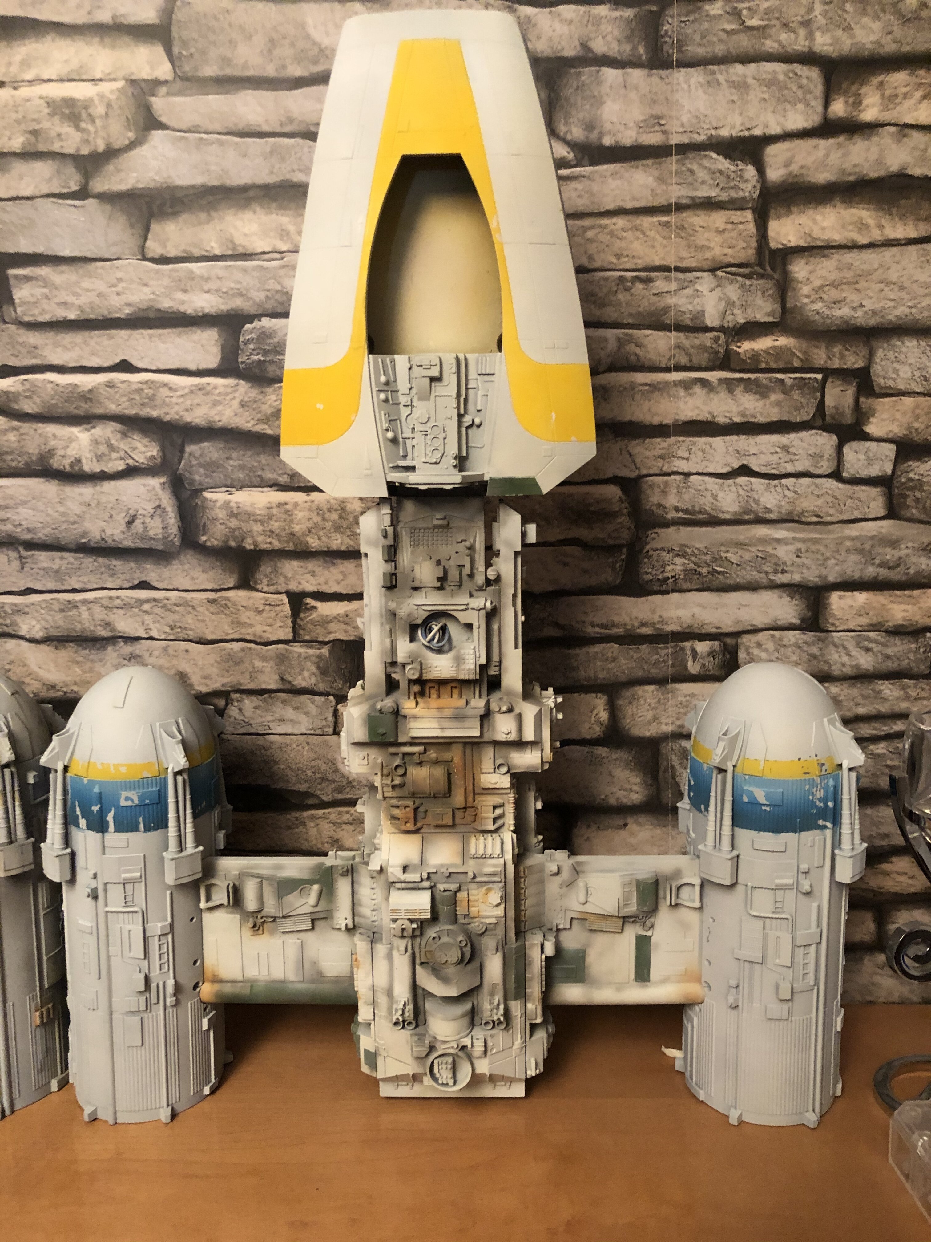

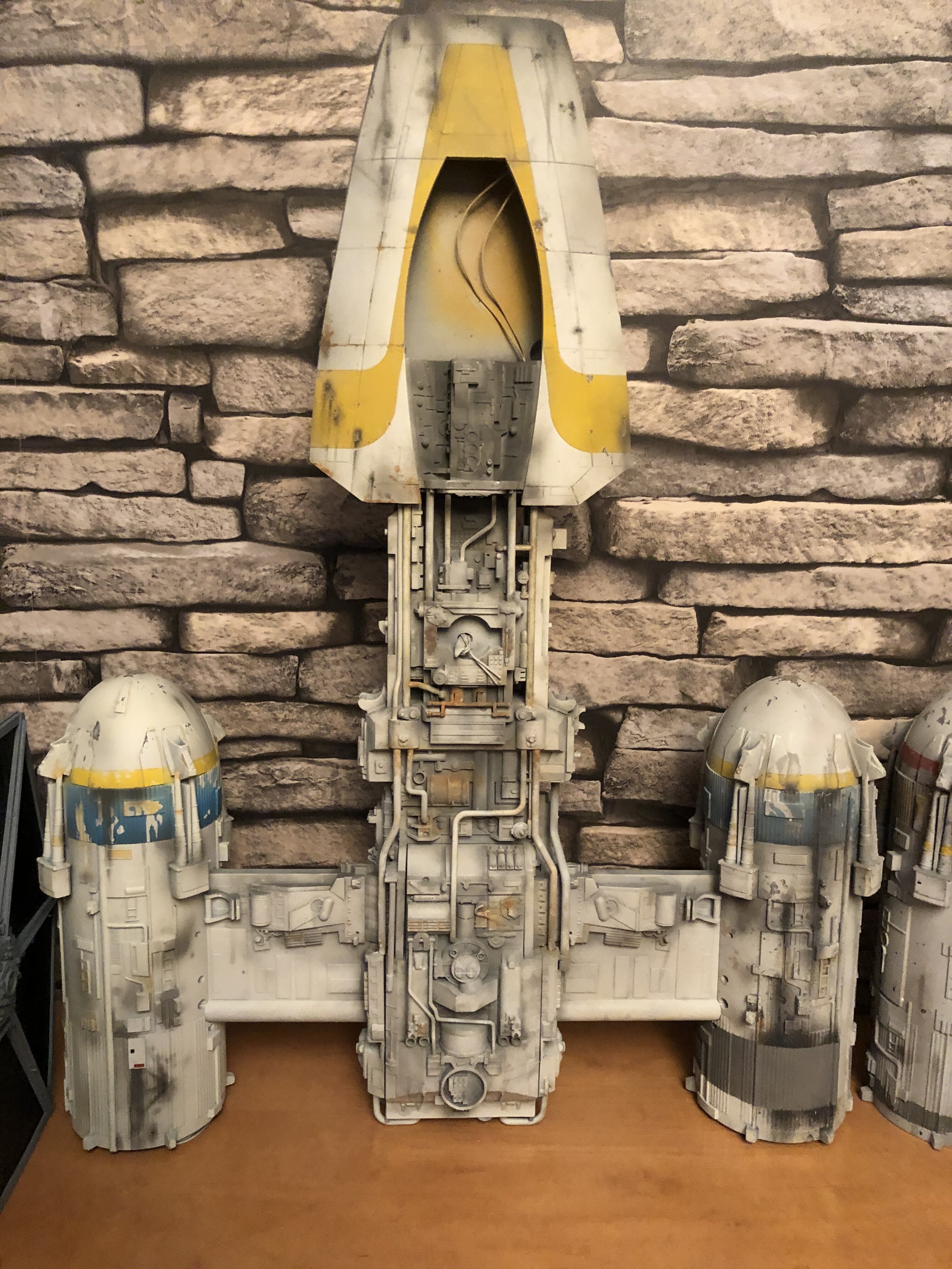

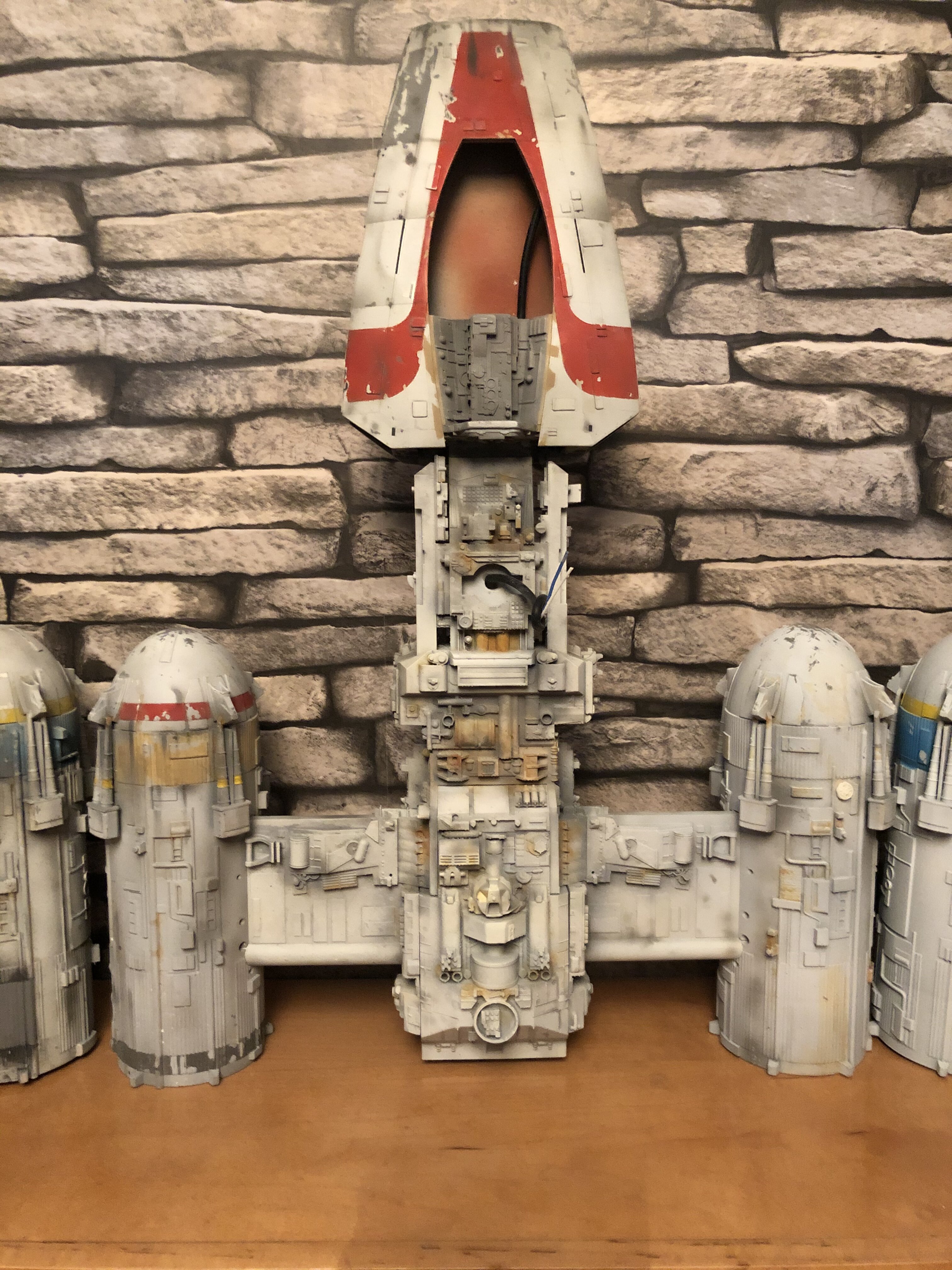

Coming on well StevenBills, I’m working on 3 commissions of the Chris Bibby Y-Wing, 2 of them as Gold Leader (One as the early paint job & the other as the heavier repaint)...& the third as Red Jammer...these are industrial printed at studio scale
John

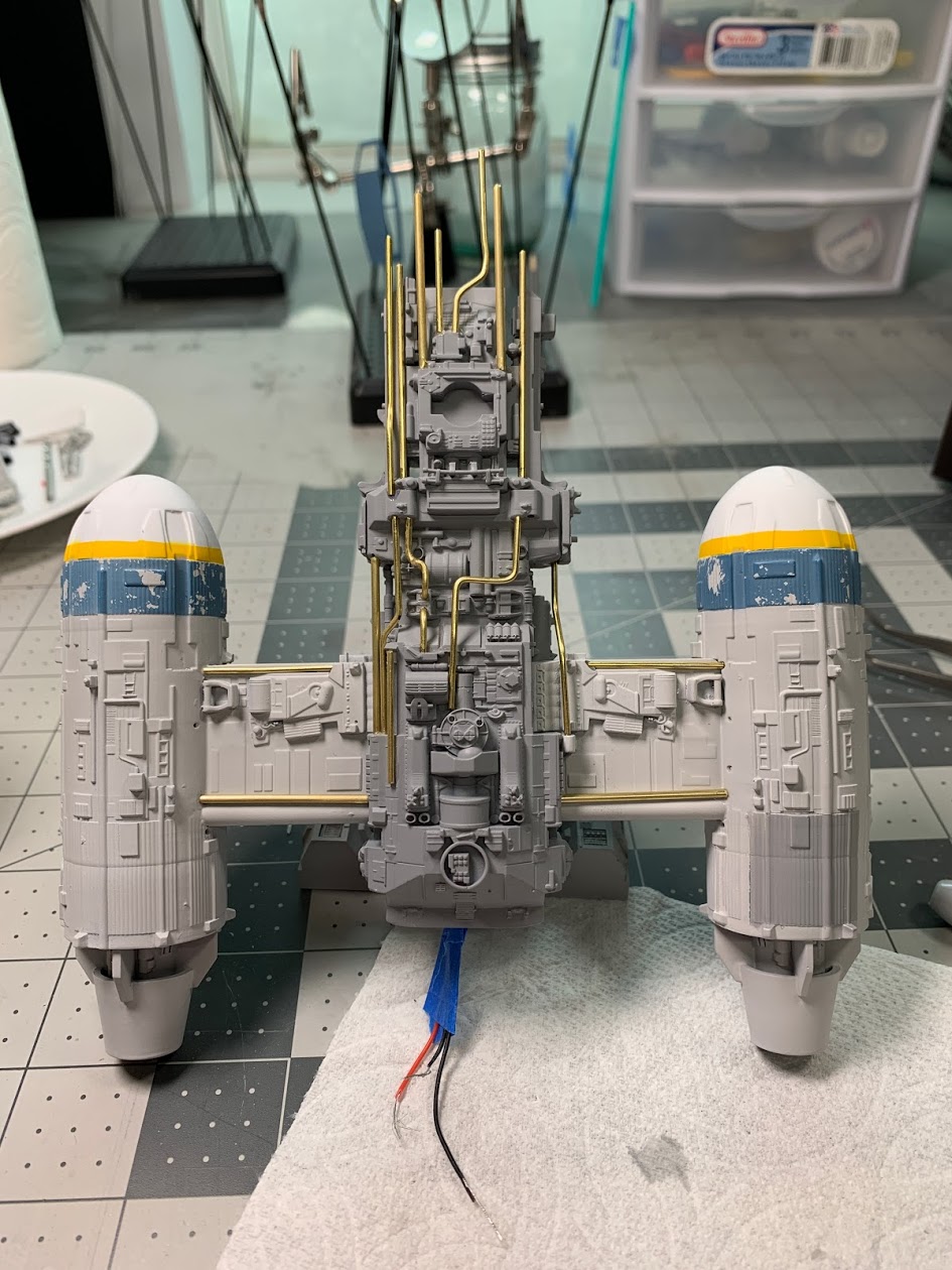

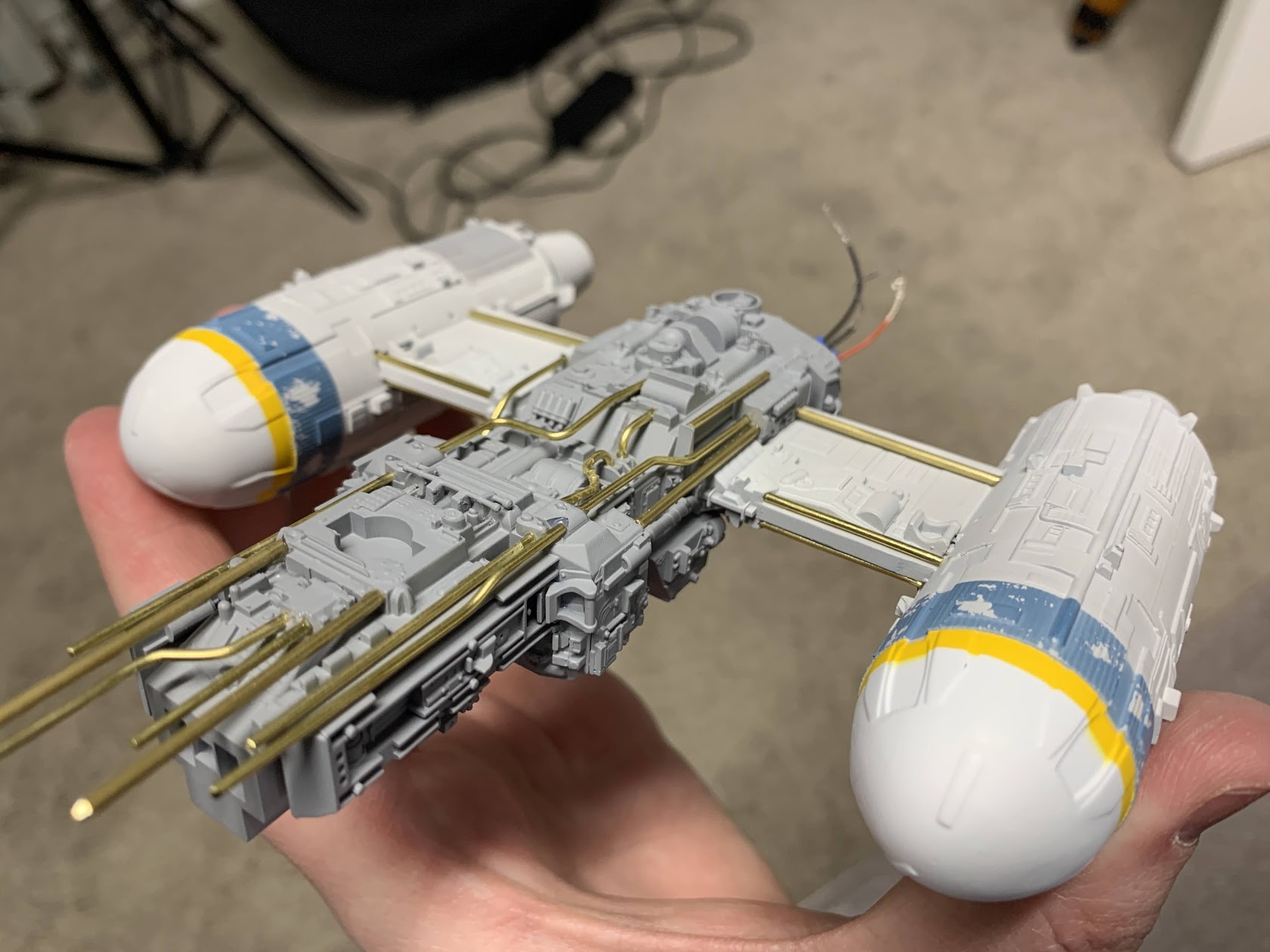

Pipes! So I guess I lied about finishing the engine nacelles and then moving on to the body. I figured it'd be easier to do all of the piping without the brittle t-tracks and engine vane thing on the back. I mixed up some baby powder and some CA glue and made a CA paste. I inserted the paste into the fuselage and stuck the wings in. Then onto the plumbing. I'm using the Bandai Y-Wing instruction manual to see where all of the pipes need to go. I'm using 3/64 brass rod for the main pipes, and 1/16 for the larger stuff. There's a few smaller pipes around the back that I need to figure out, but this is where I am at as of this evening:
This definitely isn't perfect, and there's a few areas I'm not too happy with, but I think it's alright for my first go at it. Maybe I should have attached the cockpit head before fitting the neck pipes? I'm figuring this out as I go along here.

How does it feel to finally have a 1/48 Y-wing?
"finally" is the key word here! It's really cool to have glued the wings/engines onto the main body and see it come together, and then hold it in my hands and heft it's weight. Then set it next to the Bandai 1/72 Y and realize how small that one is! :lol:
In all seriousness though, it's really cool to see this come together. Again, it's not perfect, and it's miles away from being done, but it's getting there. Slowly.

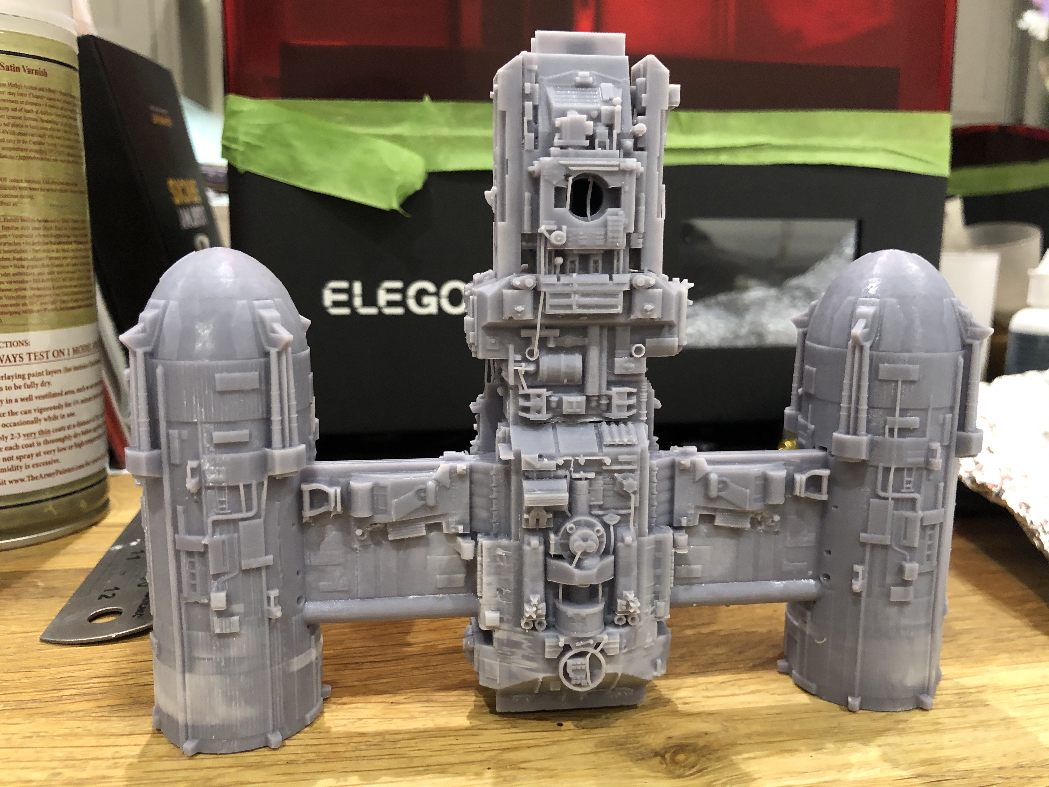

Looking great! I had a bit of a disaster with mine...I tried using a button cell to light up mine but it didn’t put out enough current, so I went back to using a LiPo, and then accidentally connected the LEDs to the 5v output on the lipo charger and burned out the engine LEDs. Oh well. They say necessity is the mother of invention, so I am now printing the entire Y-wing chassis with wings and engines attached, in one piece, on my Saturn. We’ll see how that goes!
Edit: I must say I’m impressed with the Saturn this time around. This only took 9 hours:
Jimw100 ahh shoot! That's too bad about your LEDs. And I guess there is no way to take apart the pieces without breaking them, right? This stuff is pretty brittle. And isn't the Saturn great?!? Was that part oriented straight up and down? That's pretty crazy you got all of that in one print!

Yeah, I oriented it straight up and down to minimise the support marks.
