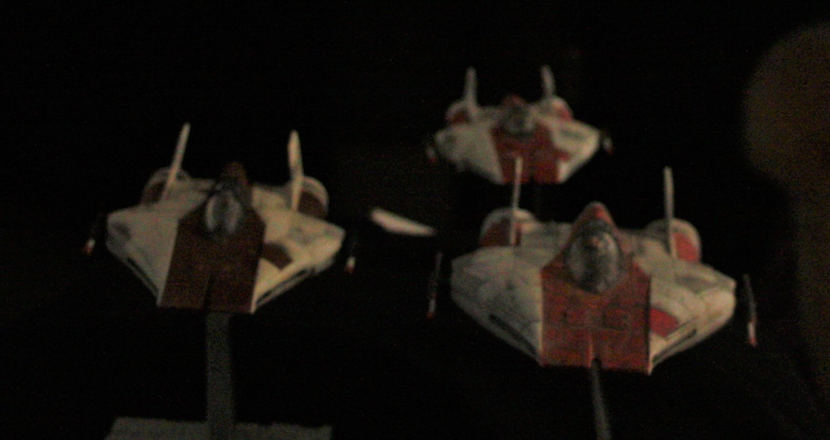

And then there is the forced perspective trick of using different sized models to get he illusion of distance. This is the MPC 1/48(ish), Bandai 1/72 and Fantastic Plastic 1/72 all together (forgive the crappy photo lighting

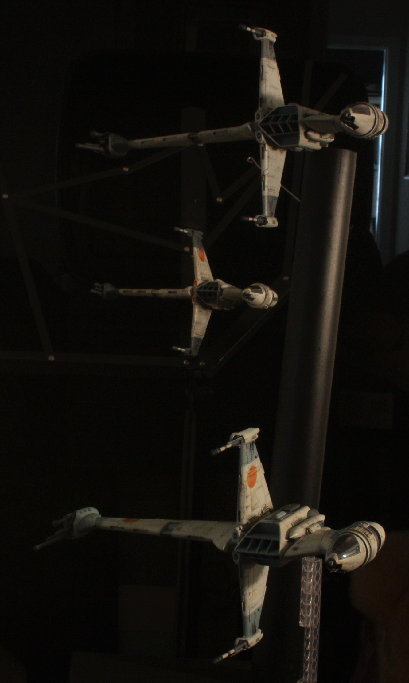

same forced perspective trickery withe Bandai B-wings and the smaller MPC one
Of course that also goes to show why studio models do not necessarily need to be the same scale as each other for shots

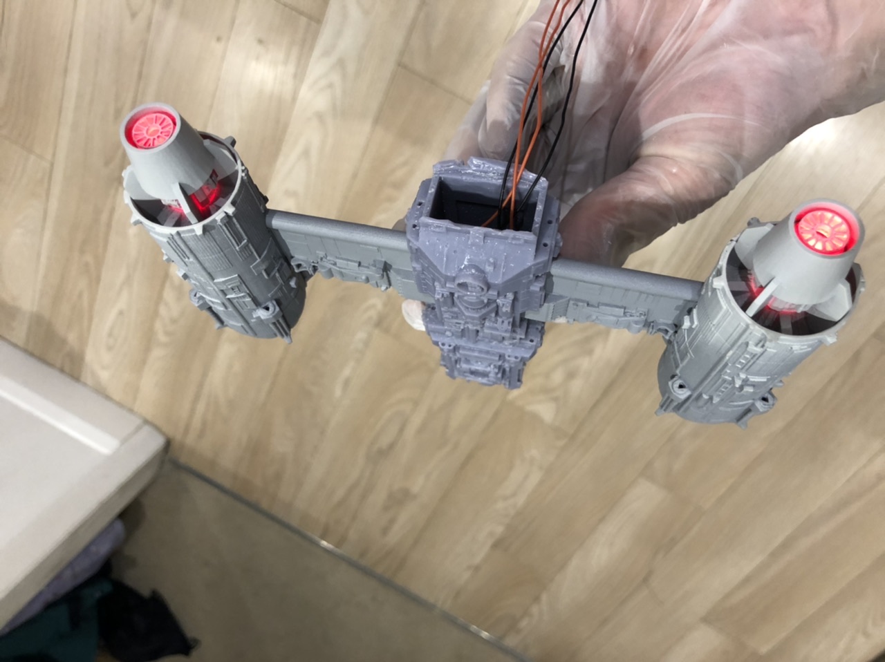

I was just working on this when the falcon3dparts email came in:

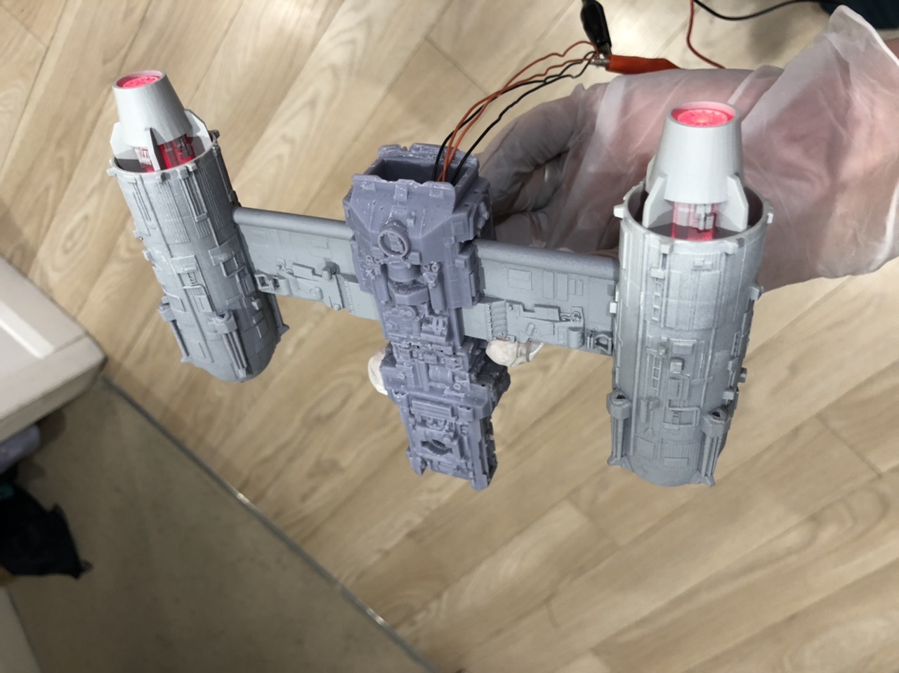

I’ve also cut the 3mm brass right angles that I’m going to use to connect the main engines to the thrust vector-type things, and I think they’re going to work well.
The main thing remaining is working out what size battery I can fit inside if I also put an adafruit itsy bitsy in there. And then the soldering. I hate soldering. But once that’s done it’s just a question of sticking it all together and painting it. And glazing the cockpit.

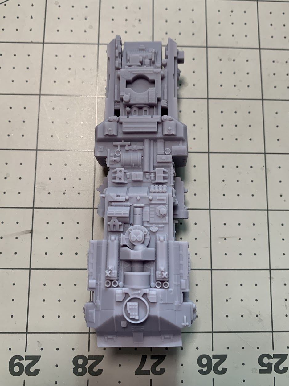

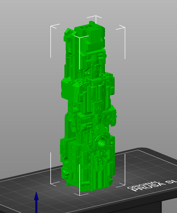

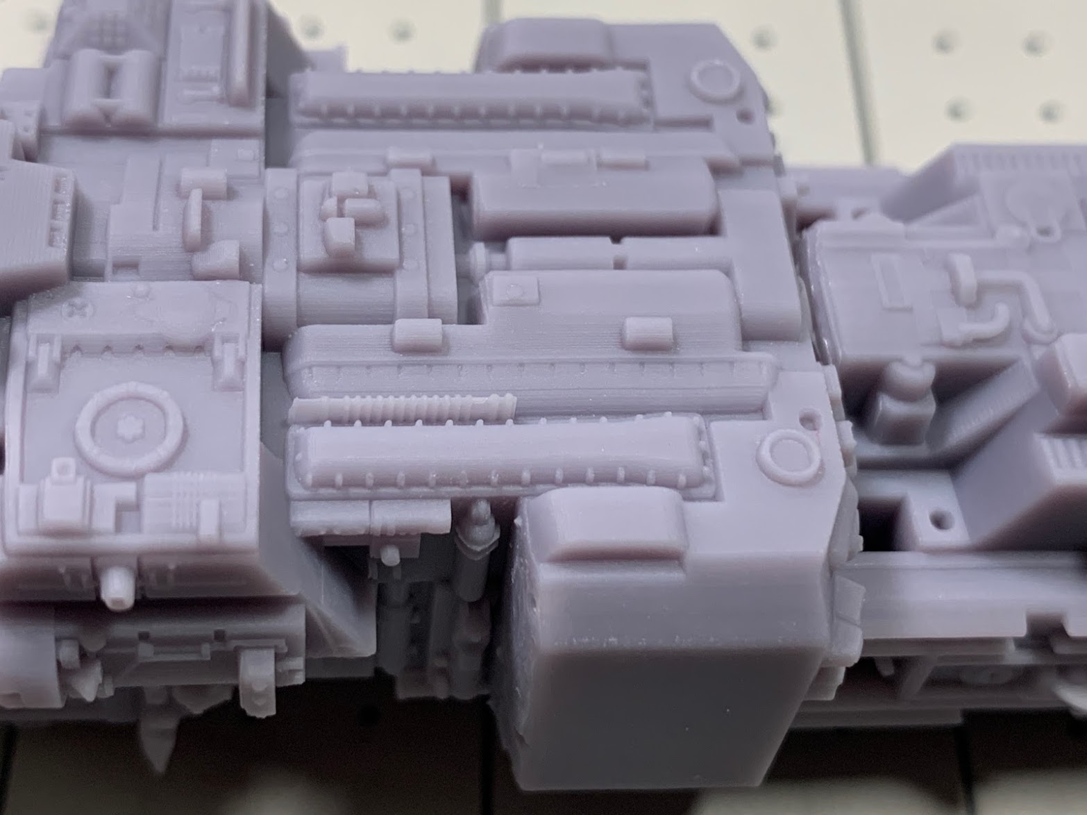

So I was fiddling around with the chassis pieces the other day and noticed that, due to curing or something, many of the pieces are warped. So I went into MeshMixer and combined all of the chassis pieces together into one part, and that is currently on the printer. Should be done in the next two or three hours. Here is a picture pre-supports.
SB
I ended up doing the same, for the same reason.

Yeah, I shouldn't have said that I combined "all" the chassis parts in the post above. Just the larger ones to make it easier for going together. I still have all of the smaller greeblies that I printed earlier. Fear not!

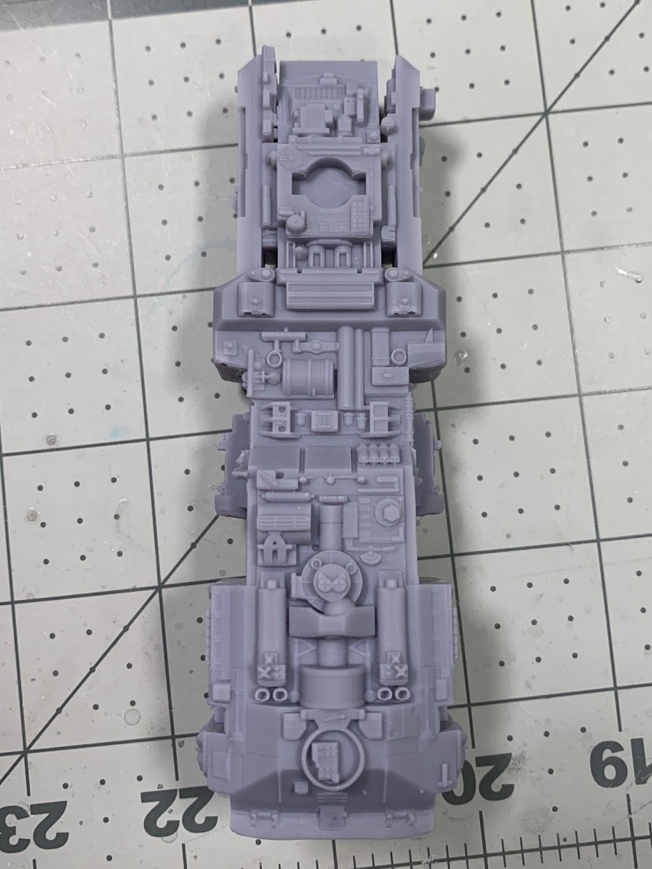

The way I oriented this part on the bed made it bend slightly, and some of the details on the bottom side (the side/corner that faced down onto the plate) were mooshed. The details on the top seemed to work out okay though, so it's not a total loss.
So I re-oriented the part to sit straight up (as in my photo above), and it's currently reprinting. We'll see how it goes in about 18 more hours! :D
SB
Pretty awesome detail on top though! I have re printed a lot of parts trying to find good orientations, its not always easy for sure.
skahtul yes, if there is anything I've learned with 3D printing it's that it is a lesson in patience and wasting material :lol:
My 20 hour print finished! And it looks pretty good! There are a few areas that peeled away because they weren't supported properly, but I'll take what I can get at this point!

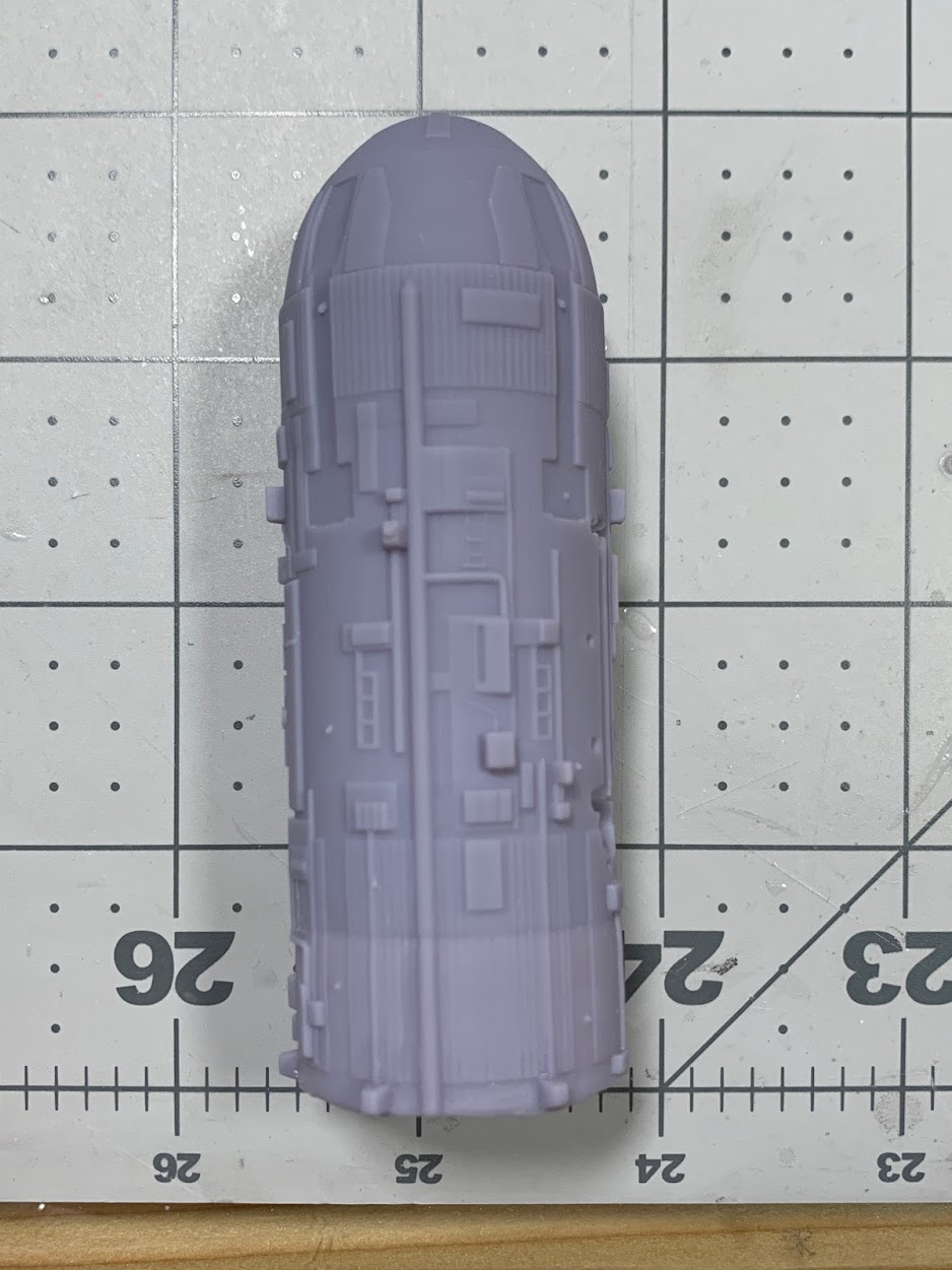

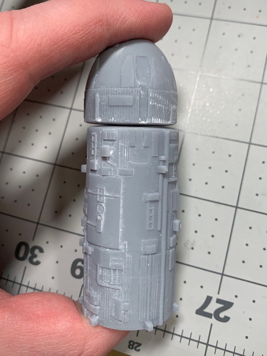

So I keep deciding to reprint parts, but instead of separating the parts out, I am combining them together and THEN printing them as one piece, like I did with the body. So I was working on the engines, and the way that I printed them left their joining surfaces a mess (that's where all of the supports were), so when I put them together, they looked like this:
This is after a bunch of filing and sanding. There would have been a lot more sanding in the future to get these two parts to fit properly. So I combined them in MeshMixer and got this:
I think the distortion is just from the photo. It looks all bendy here, but it's not that way IRL.
So there we are. I'm going to see if there are any other parts that need to be reprinted, and then go from there.
