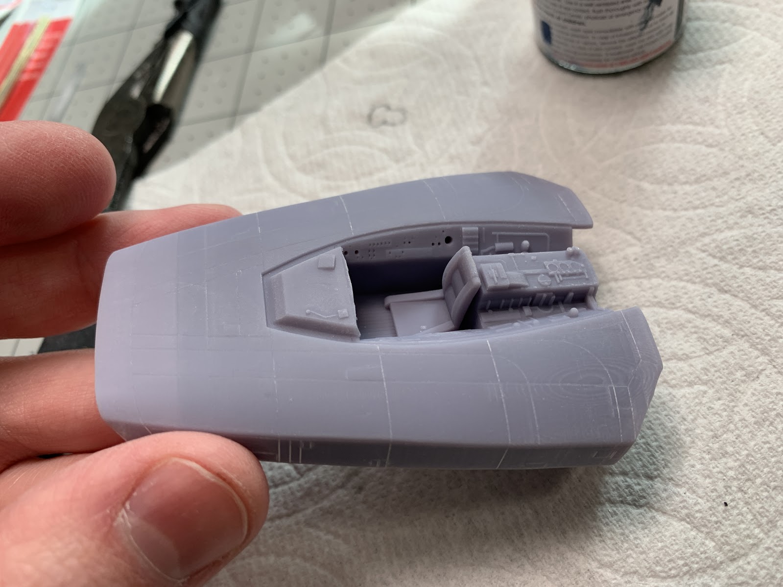

Okay, so I managed to combine all of the cockpit parts together in Meshmixer, so that I didn't have to fiddle around with getting everything to fit right and use lots of putty, sanding, etc... This includes the seat and console and controls, as well as the landing gear pod on the bottom. Here it is lightly sanded, due to some finger-printing:
I'm pretty happy with how this print turned out. I tried printing out the head piece as two separate parts, but I could never get them to line up correctly, and I think the head of the Y-Wing is a very distinct form, so I didn't want it to look too fat or tall or what have you because I couldn't get the parts to line up right. Really glad this print turned out. Next it's on to mating the head with the body. That means trimming a few of the pipes that connect to the rear cockpit bulkhead. I should have connected the head to the body before I did the pipes, but that's easy to fix.

So sweet! I dig the 'mesh' on the domes, it is a happy accident kinda artifact, since it adds just another subtle layer of texture complexity that is perfect in my opinion, if not 'screen accurate', for a 'sensor fairing'.

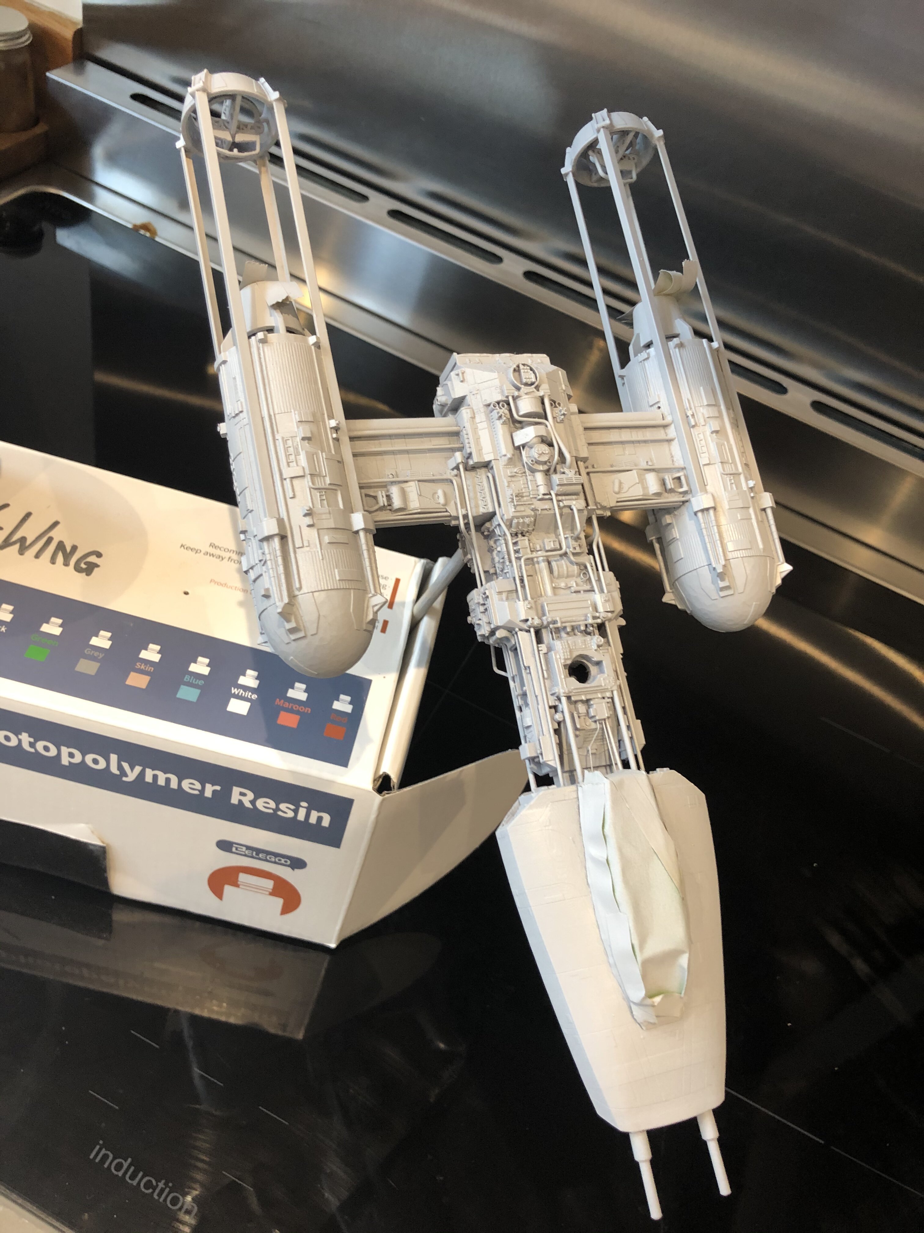

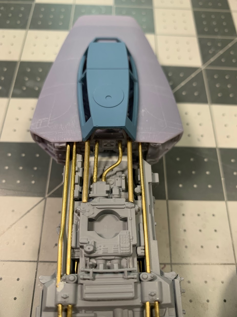

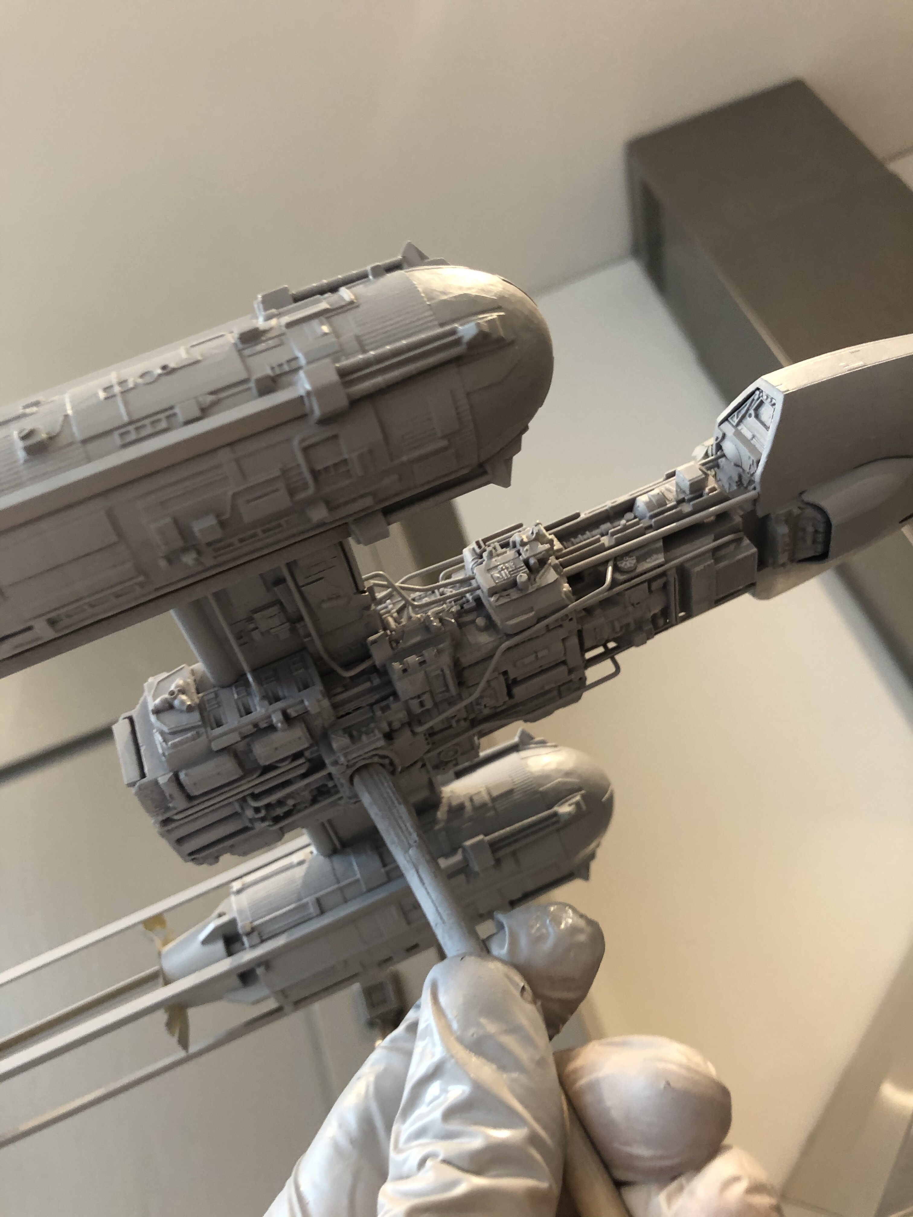

Little update today. Finally had some time to work on this model a bit. I managed to get the head attached with the body. I strengthened the bond with two aluminum tubes that extend back into the body and forward into the cockpit. Didn't take any photos, but it worked. I think I might have made the head stick out a few mm too far from the body, but the pipes kind of hide that.

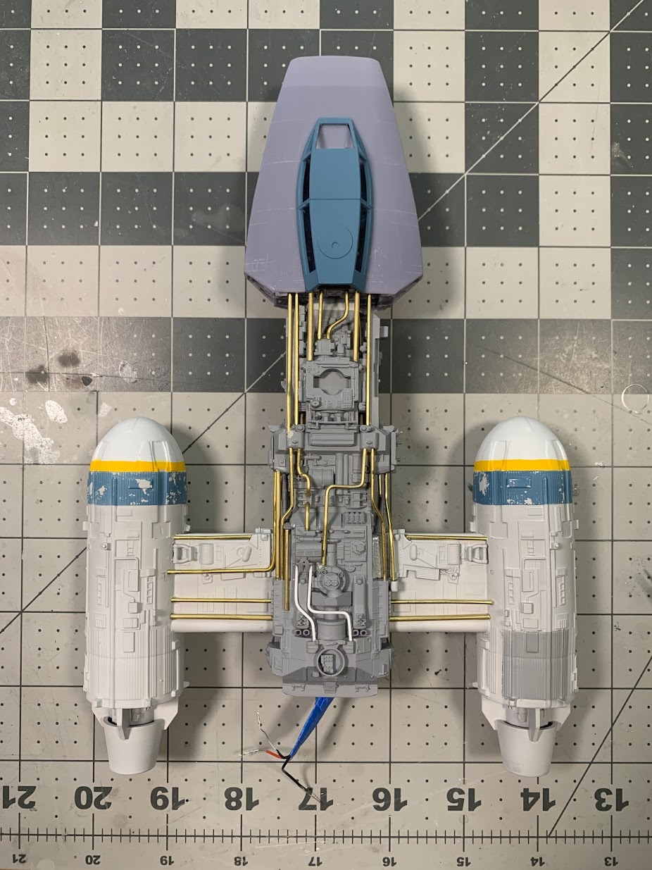

And speaking of pipes, I think that I'm done with the plumbing on this one. It's not ALL of the pipes that are on, say, Gold Leader, but there's enough on there to get the point across. the canopy is just set on for the photos.
It's not the prettiest of jobs, but it works. The next step, after all of this has dried, is to prime the body, plumbing, and cockpit, and see how it looks! It's been a lot of work up to this point, but I'm (mostly) happy with how it is turning out.

That's looking great! I have files for a 1:24 and every time I think about starting to print it I just come look at all the pipework you are doing and I close down the slicer :)

Oh, it wasn't that bad to do. I just followed the instructions for the Bandai Y-Wing and did my best to copy it. Didn't get it exactly right, but close enough for my taste. This model did come with the STL files for the pipes, but I think it would have been an even bigger headache to try and print them out and get the supports right, etc.. And they'd be brittle as all get-out also. The brass wasn't bad at all to bend. I just wrapped the tip of a pair of pliers in some gaff tape to avoid marking the pipes, and then just bent the brass around that. Easy peasy.

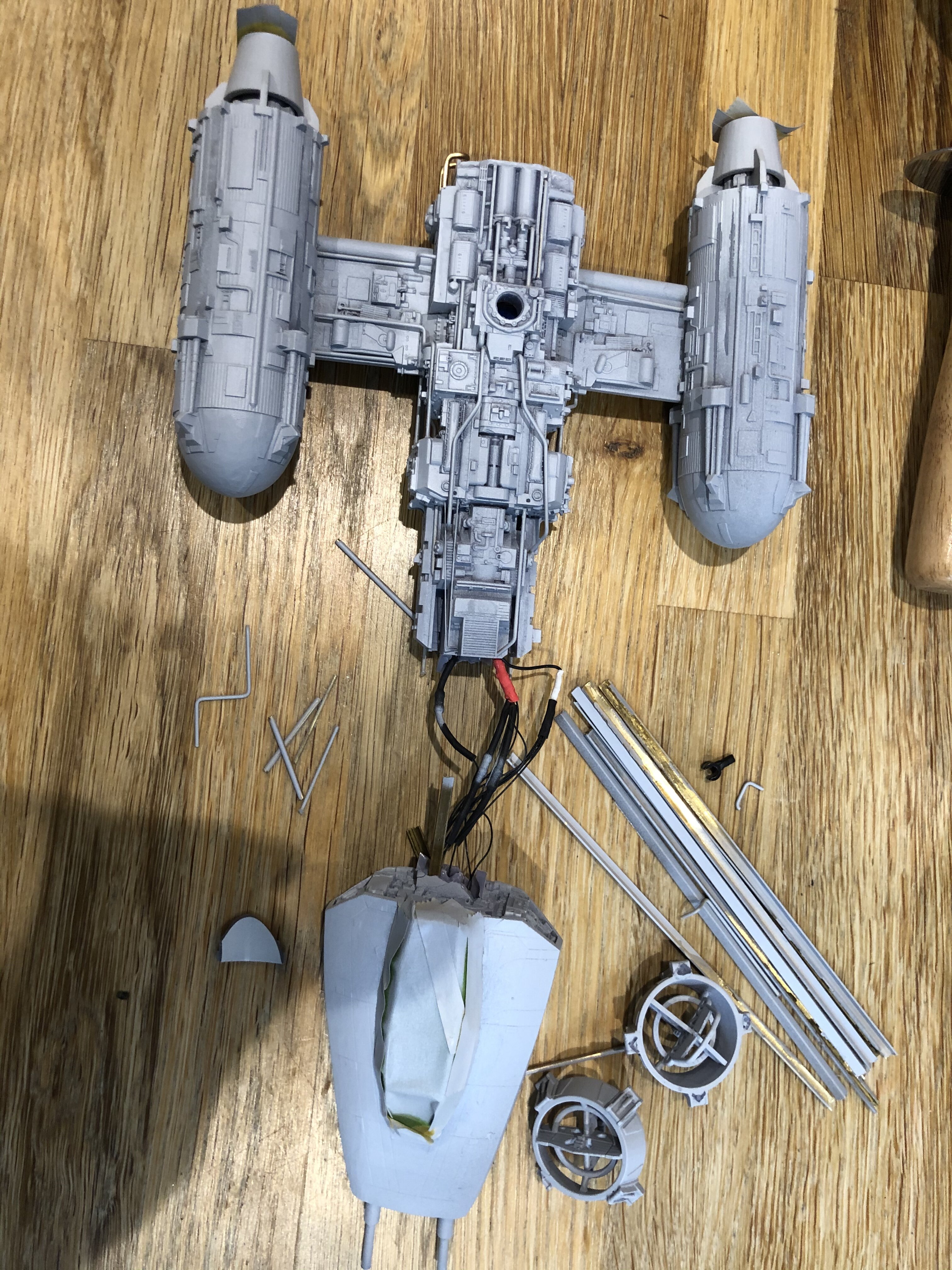

My Y-wing had another fairly disastrous crash landing. I’m beginning to think someone is doing this on purpose...6899D065-033D-4BCD-926A-F605E129DD8B.jpeg
The neck was completely shattered and the negative wire for the cockpit lights had been ripped out, meaning I had to do some pretty delicate soldering inside the actual main body to fix it. The neck is really very awful looking now, but nothing I can do without basically starting over again. Which I’ve already done, but I’ve now convinced myself to do a Death Star diorama with two Y-wings on a bombing run.

My Y-wing had another fairly disastrous crash landing. I’m beginning to think someone is doing this on purpose...View attachment 1431276
It's just one thing after another with your build, isn't it?! I'm sorry about that, man. That sucks. And I honestly think that the connection between the body and the cockpit could have been designed better on this model. I see your metal tube in there. It's too bad that this kind of resin is so darn brittle afterward. My kids keep wanting to hold my model and fly it around the room, but I just don't want to risk it bumping into anything and shattering. It's a shelf-queen, that's for sure, save for when I use it for some composite photos.

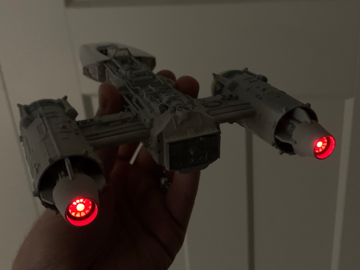

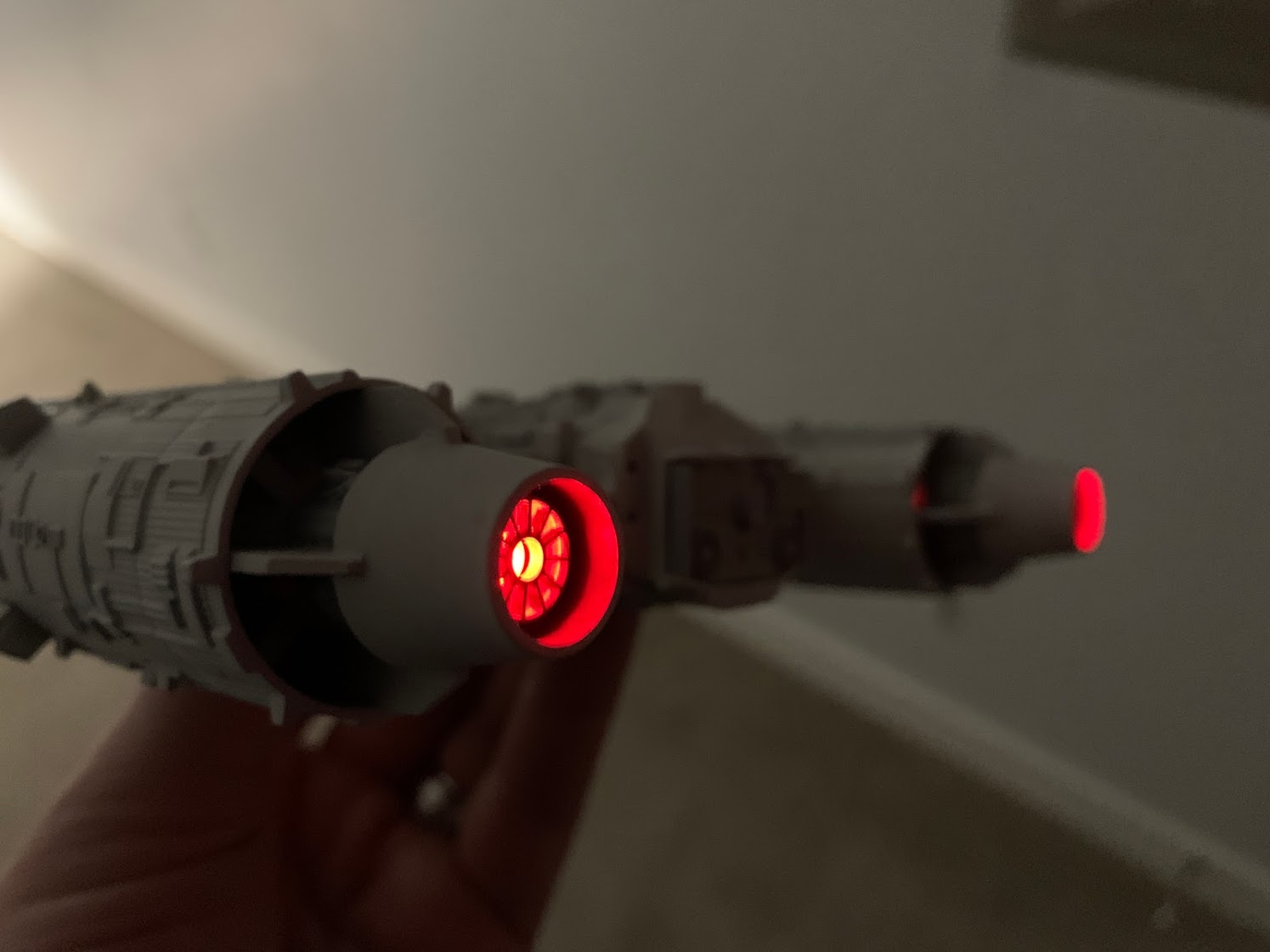

Little update today. I did some soldering and got the engine lights going! And it's all self-contained in the back of the fuselage. Everything fit in there, so all of my work of making space earlier back there paid off. It's hard to photograph the lights, but they turned out exactly as I'd hoped.
I don't think I'm going to put the bent pipes on the back there, as that would extremely restrict my ability to take off the hatch and flip the switch. I'm still debating that, though.

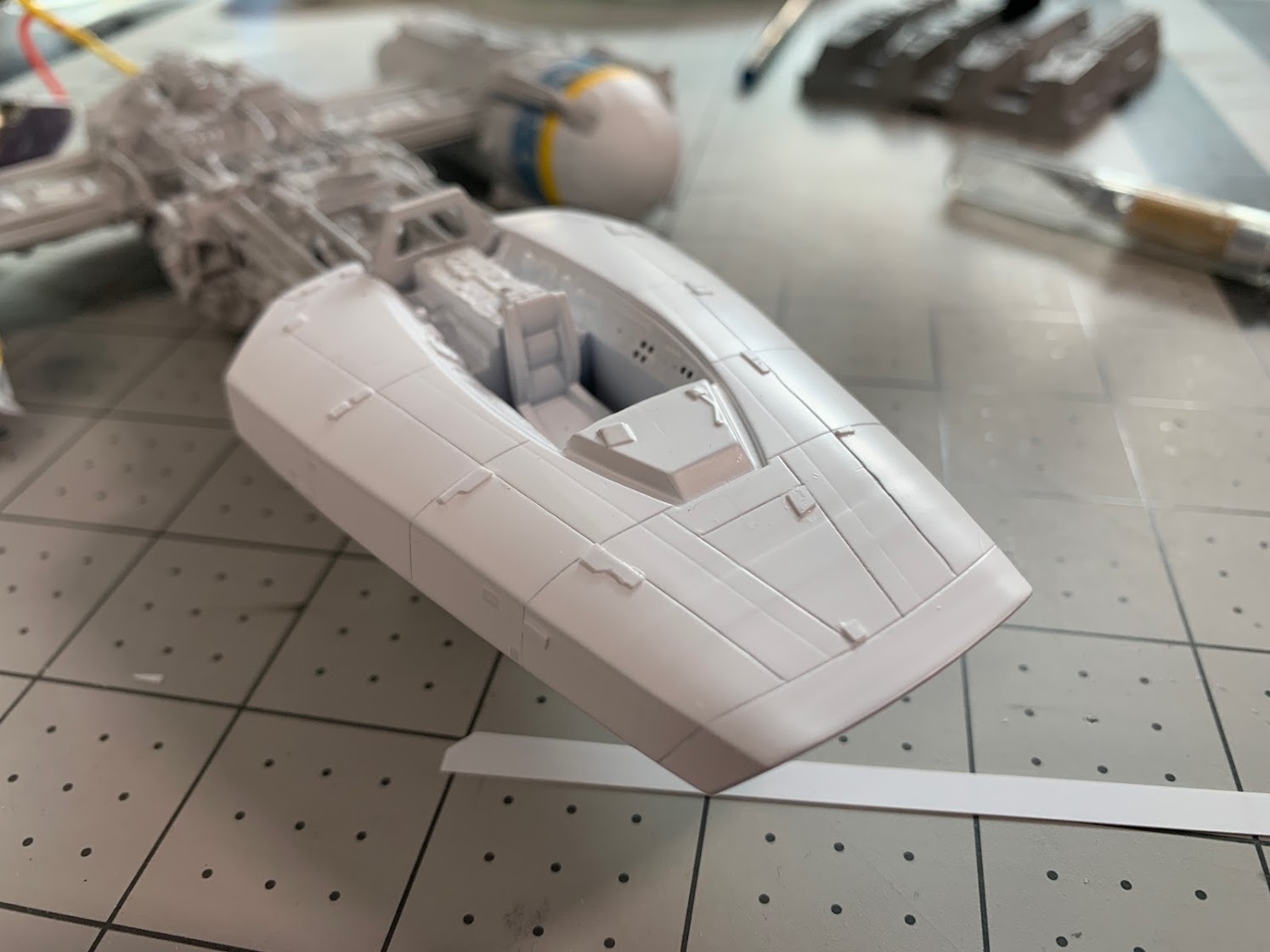

I also worked on adding back a few of the chip panel things on the cockpit as well. These were sanded off when I was working on it the other day. I'm not even sure of the thickness of the styrene I used, but it looked close enough.
I'm hoping they blend in a bit when more paint and weathering is applied. I ordered some Tamiya tape for curves, and I'll use that to paint the Gold Squadron markings on the head in the next few days. I also got the clamps on the L'eggs sections painted and glued on (no photos of that, somehow). It's really starting to look like a Y-Wing now!

Great job on the engine lights. Those look fantastic. Better yet they are exactly what you wanted. That's what rally counts.
What did you end up doing? Raw LED or diffusion filter? They look raw with teh way the light is emitting and reflecting but well enough hidden that I'm not sure. Very nice!
For the bars that bend around the back, might there be a way to attach them to the plate you remove? Extend a locator tab to the point they connect? You've got me thinking as I'm headed down the same path you have bravely paved.
Hagoth I used the bare LED. I 3D printed a little washer to hold the LED into place inside the engine core, and then set it back from the opening about 1cm. Pretty happy with the look, and it should photograph well. And that's a good idea for a locator tab. I'll have to do some thinking with that.

Thanks for the details on how you placed the LED's in the engines. That's a critical detail to the look you achieved. Photographing well? You already proved that point!

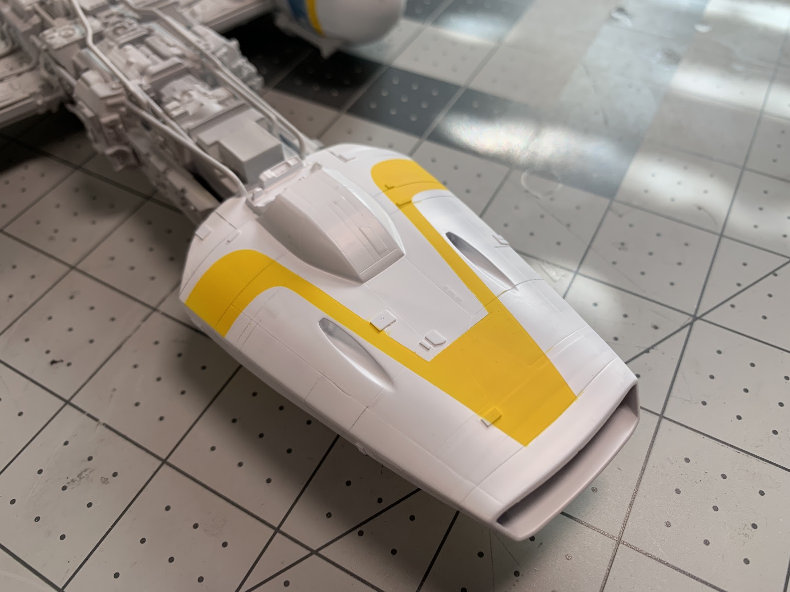

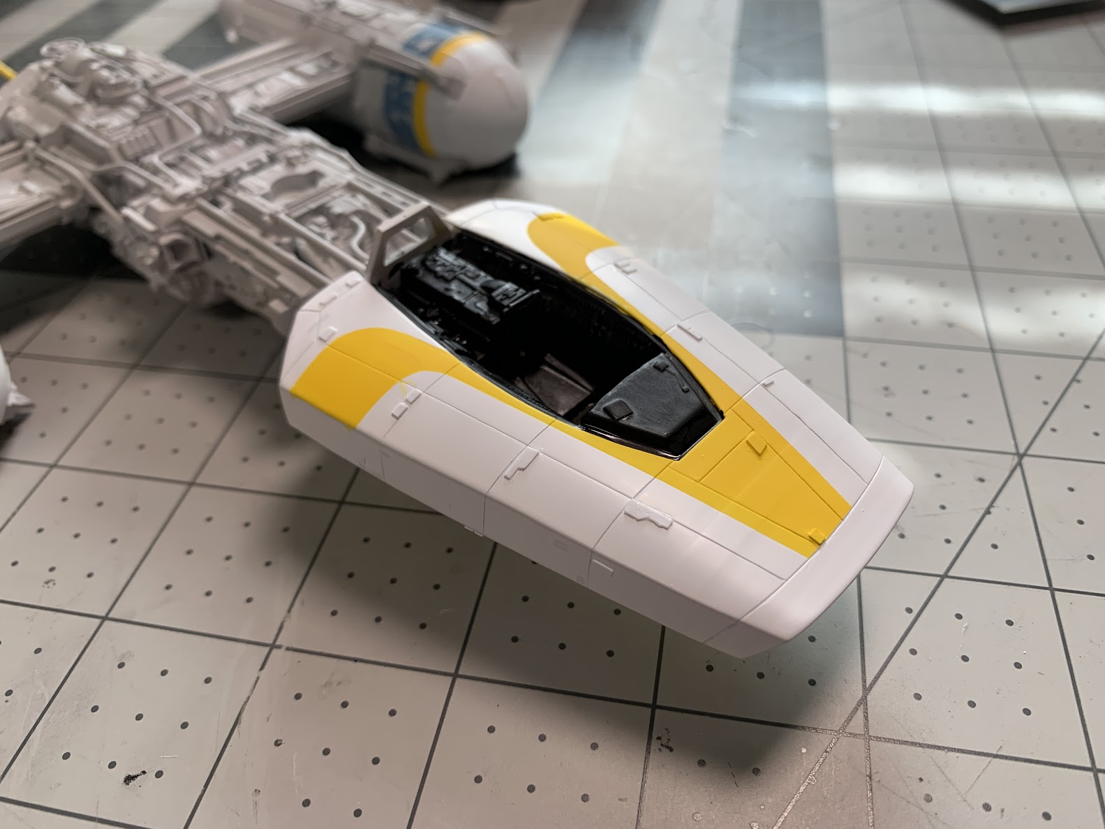

Little update from this morning. I masked and painted the Gold Squadron insignia(?) on the cockpit. This was my first time using Tamiya tape for curves, and it worked really well! I'm very impressed with the stuff.
Need to clean up the edges a bit, but other than that, I'm pretty happy with how these came out. Also painted the base black color in the cockpit. Once that's all dry I'll back with a gray or silver and drybrush some of the raised details. I think the next step for this is to mask and paint the blue pinstripes on the sides of the cockpit. That'll be tricky because I need to match the color of the canopy and the stripes on the engines. OR I can just re-paint the canopy with the new blue color, since it's waaaaay too blue right now... Decisions, decisions...

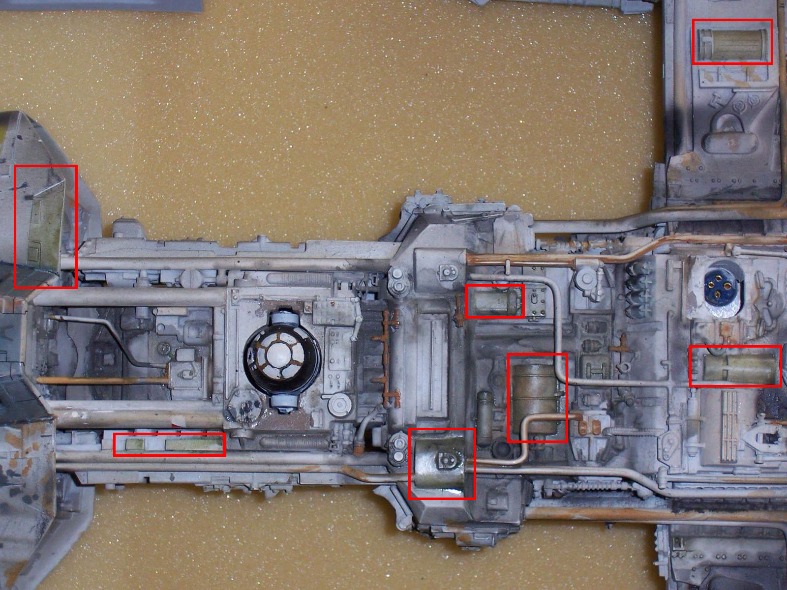

Quick question for anyone in the know: Are these the green spots on Gold Leader that "everybody hates" (I guess not EVERYBODY hates them...) that weren't there when filming ANH? I see people in the SS section referencing all of the green paint that was added later, and was wondering if these spots were them.
