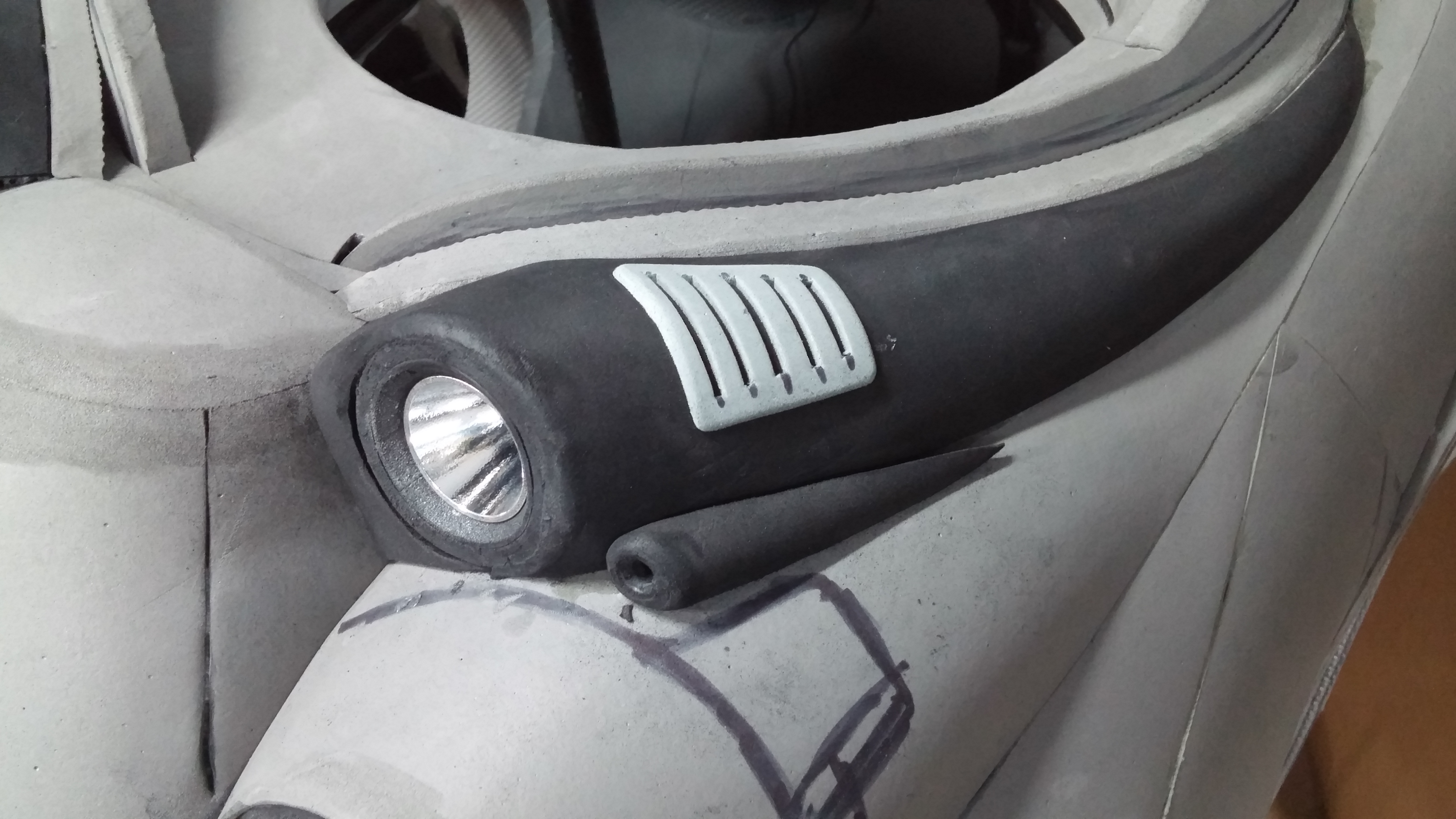

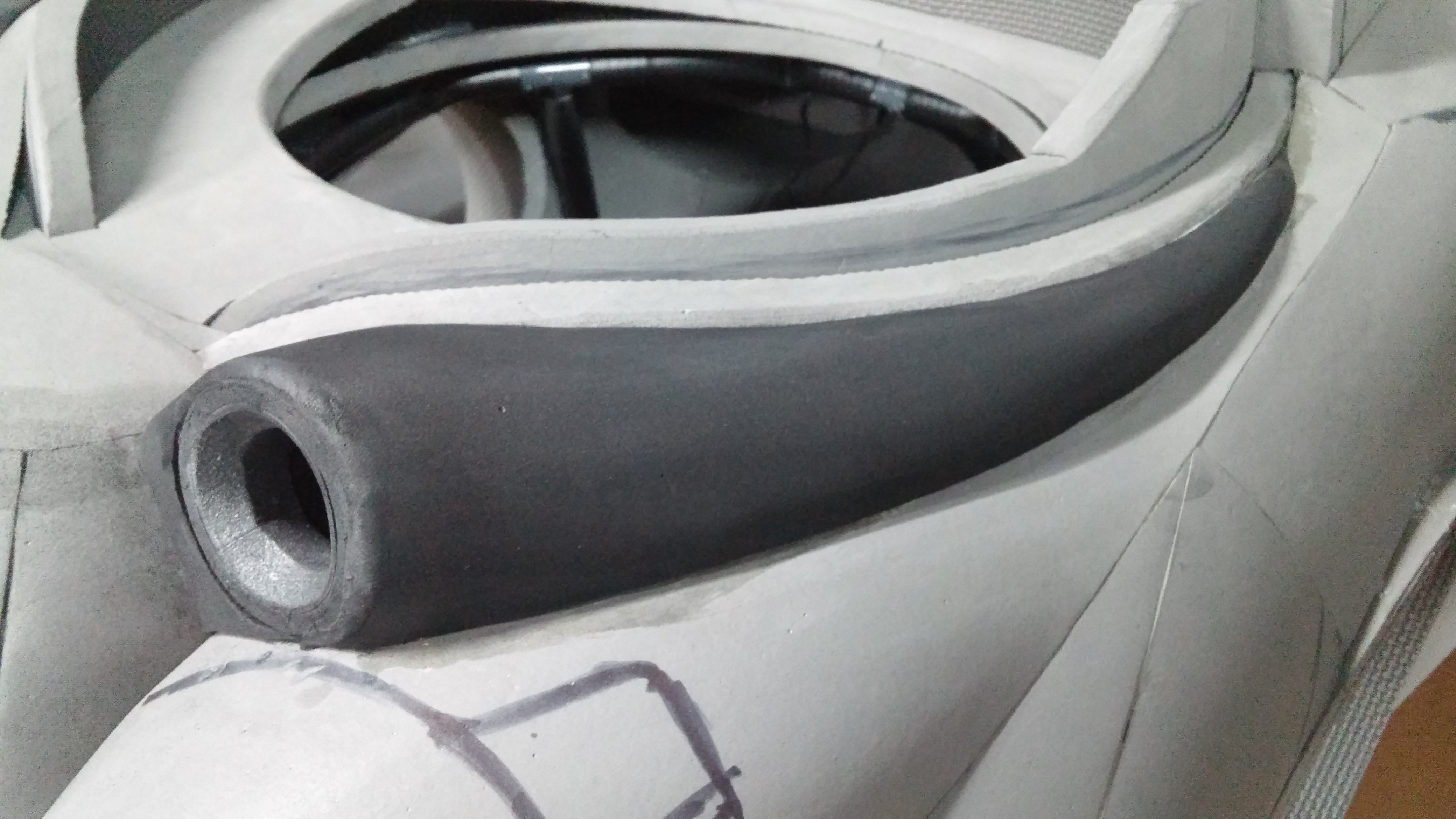

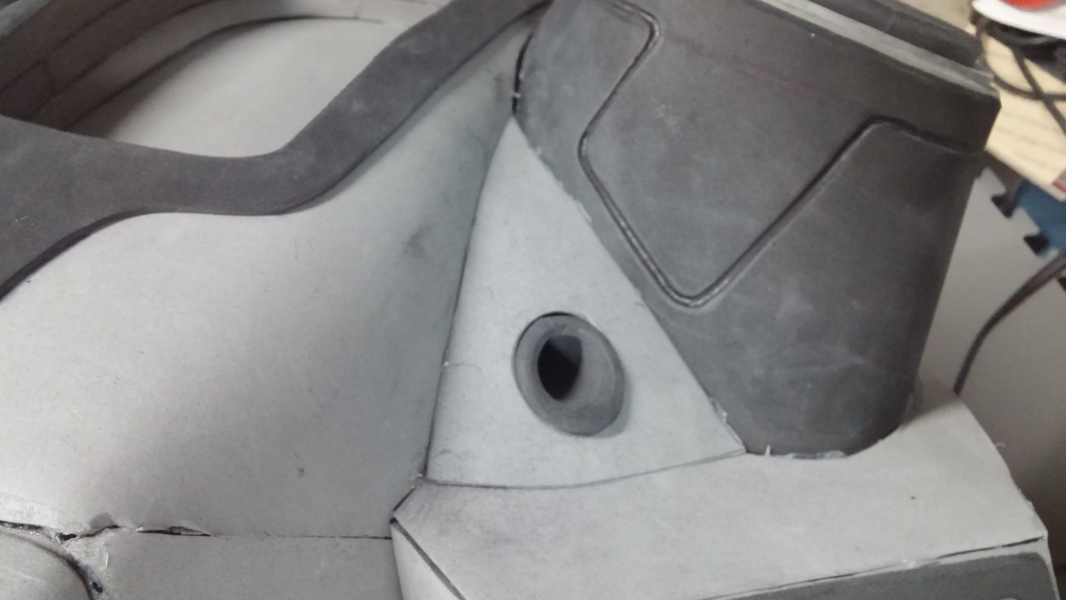

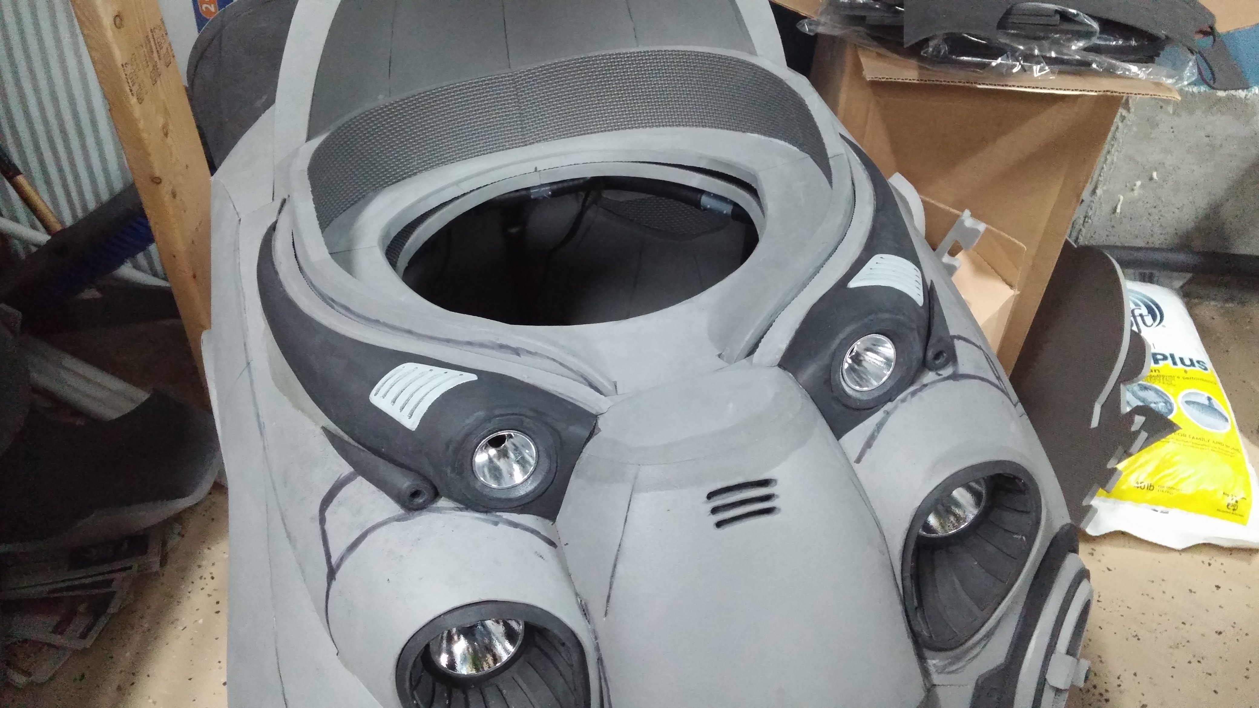

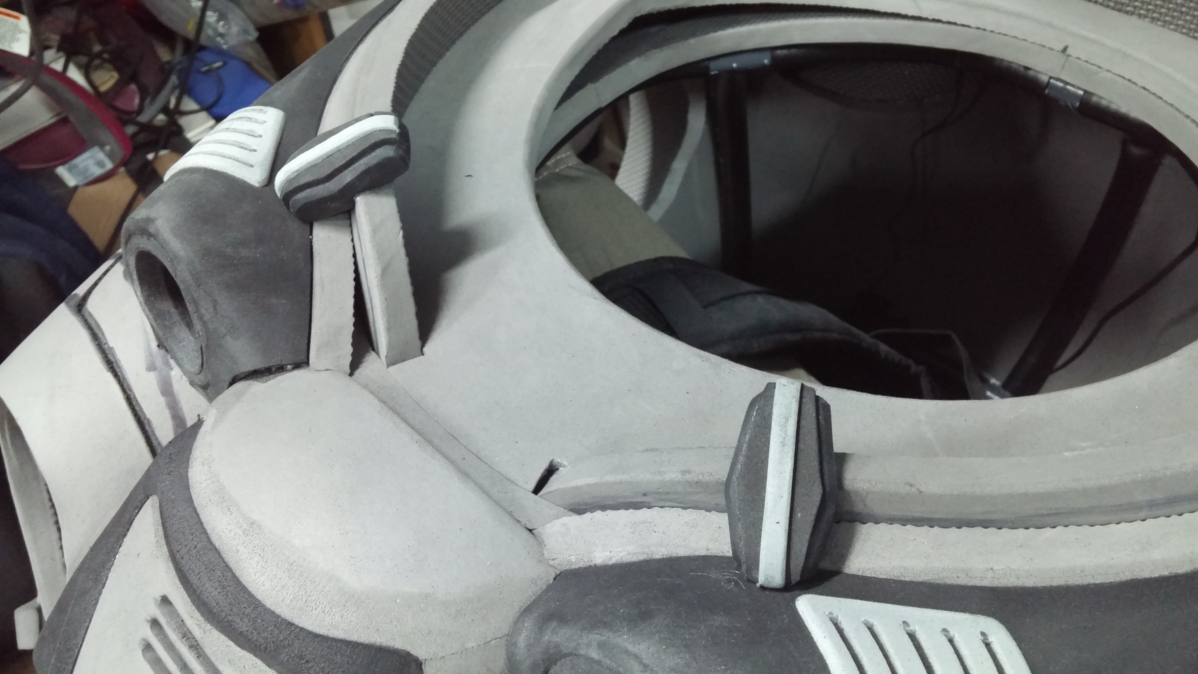

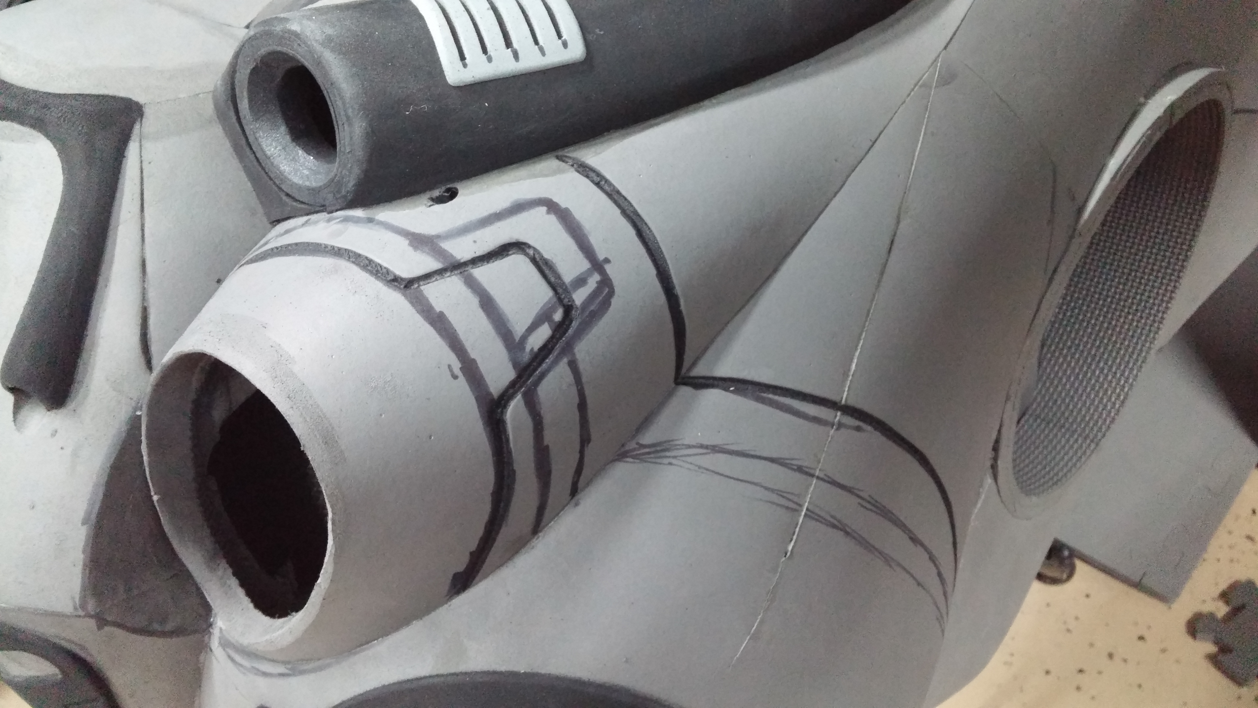

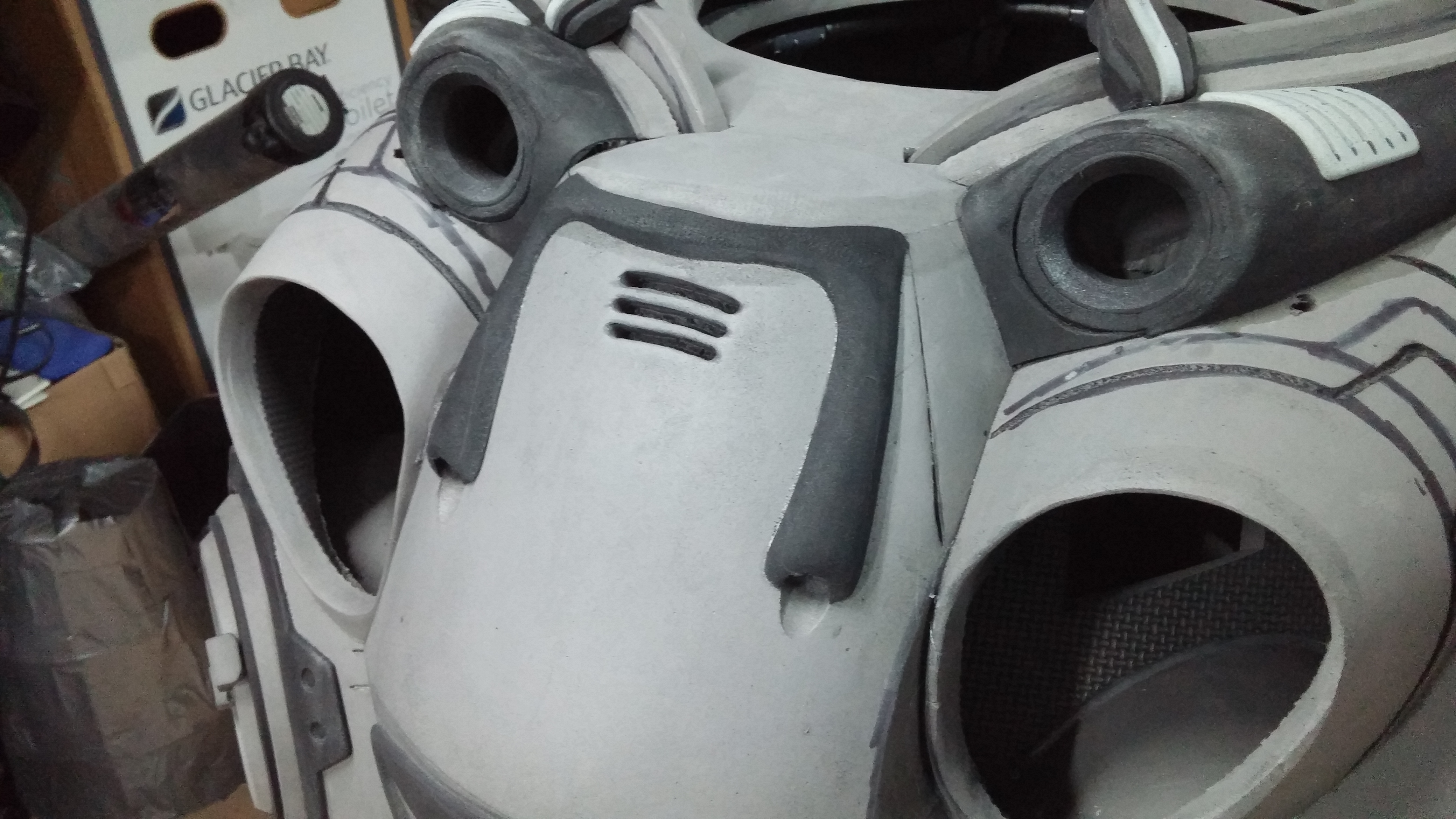

As for the suit itself, not a ton a progress due to the fact that, altho small, the upper light housings were such a huge pain it took several days to work out how to do it, lots of scrapped material and some fudging which was covered up in the final act. All in all, turned out pretty close to how I envisioned, but just like everything else, not completely screen accurate. I'll just call it personalization. :D I started the housings with 1/4" foam sheets rolled into a tube and trimmed to shape in order to fit on top of the lower housings and point in the right direction. No googly-eyes here! Next, I hacked up some small bits of EVA and fitted them between the new housings and the center chest piece to fill in the gap. But how to fill in the rest of the curved housing? I didn't get many "during" pictures because there was so much back and forth, so if anyone wants more detail I'm happy to describe it in more detail, but let's just say for now the first three attempts didn't work out. I finally decided to rough in the shape I wanted with a scrap piece of EVA, spending several hours just sanding it and heat-forming it into the approximate shape I wanted. Next, I covered that in tape to create a flat pattern, trimmed that a little more, transferred that to another piece of EVA and sanded the crap out of that one as well, finally getting the right rounded form contoured to the existing foam. Hugest. Headache. Ever. Next one went surprisingly (and frustratingly) smooth.
Now, up until this point I pick and choose my adhesives based on the function of the part I'm gluing on. For major structural pieces or larger pieces that may see more stress, I use the contact cement. (Again, I use Weldwood, but I hear Barge is a better choice) For smaller pieces that stack on other pieces or large flat areas that need to stick together or even parts I know will have a gap after attaching, I use hot glue. For these housings, I used the contact cement for two reasons. One, I want them to stick really really well. they taper off to almost nothing and I didn't think the heat of the hot glue would do that tip any good, but also it's such a complex shape that I didn't think I'd be able to hold it in the right spot while the glue cooled off. With the cement, as soon as you touch the two pieces together, they're stuck! Handy! And second, these are attached to the tops of the other housings which are large, hollow, and not really attached to anything else around the top so this adds much needed strength to the front.
Finally, after all the trial and error, I covered the housings in tape again to creat yet another flat pettern for the 1/8" foam to wrap over the top of it all in order to cover gaps and smooth the whole thing out aesthetically. For the thin stuff and detail work I like to use spray adhesive. I've tried three different brands so far, Elmer's that I picked up from Joann's, an extra tacky industrial stuff from Harbor Freight, and 3M Super77 that I'm currently using. They're all about the same but the last two seem a tad stronger. Anyway, cut, covered, and sanded into shape. Finally, I added the little details of the vents along the sides. That's just more 1/8" foamies foam. I also built (out of 3mm foamies) the little light housings that go just outside the uppers. I rolled the foam into a small solid tube and trimmed it to fit in the corner. I then drilled a small hole in the middle, which is where I'll mount the little orange lights I've dubbed the "parking" lights. I'm getting closer to the lighting/wiring stage! a few more details and I'll be there!

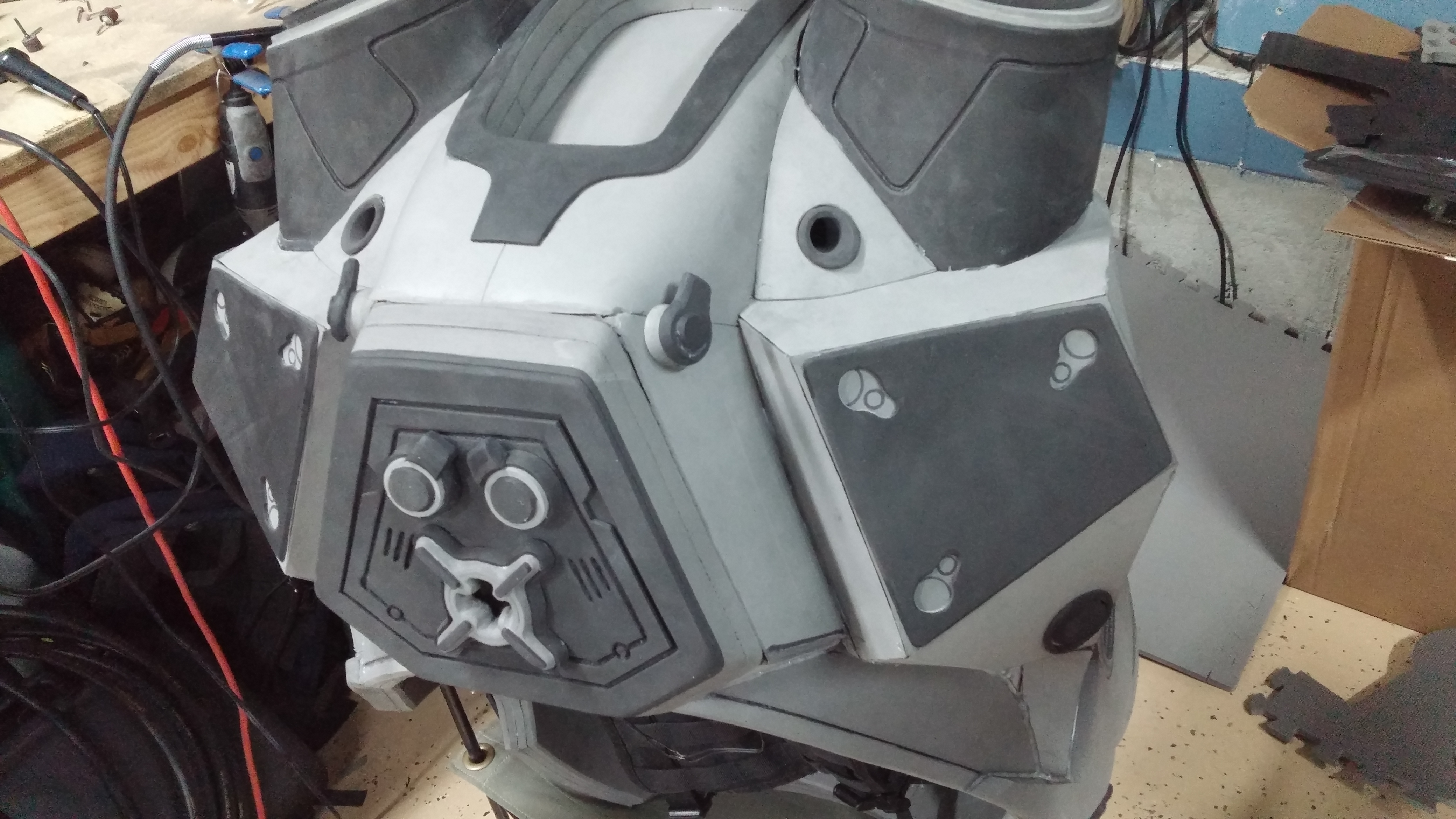

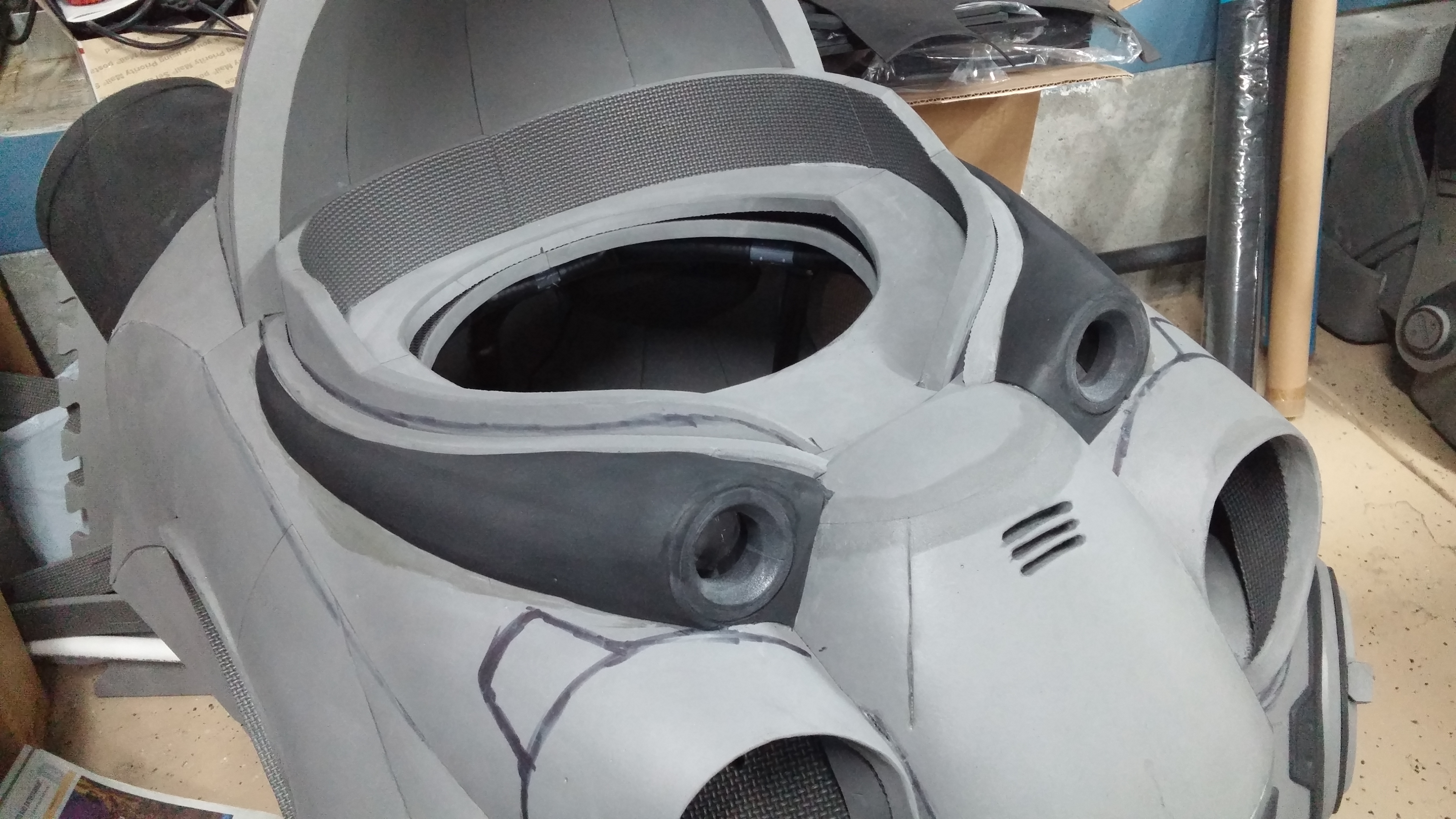

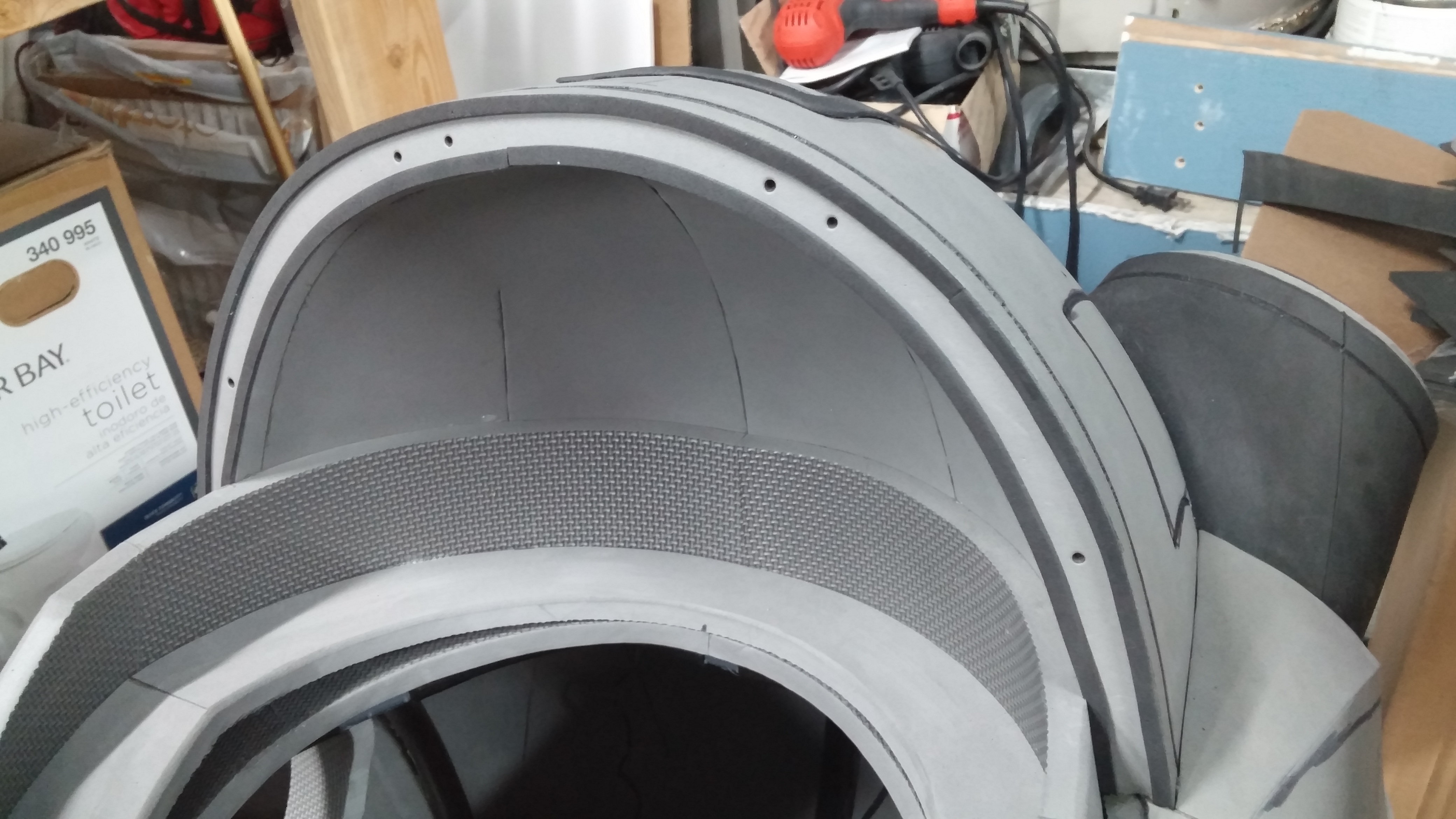

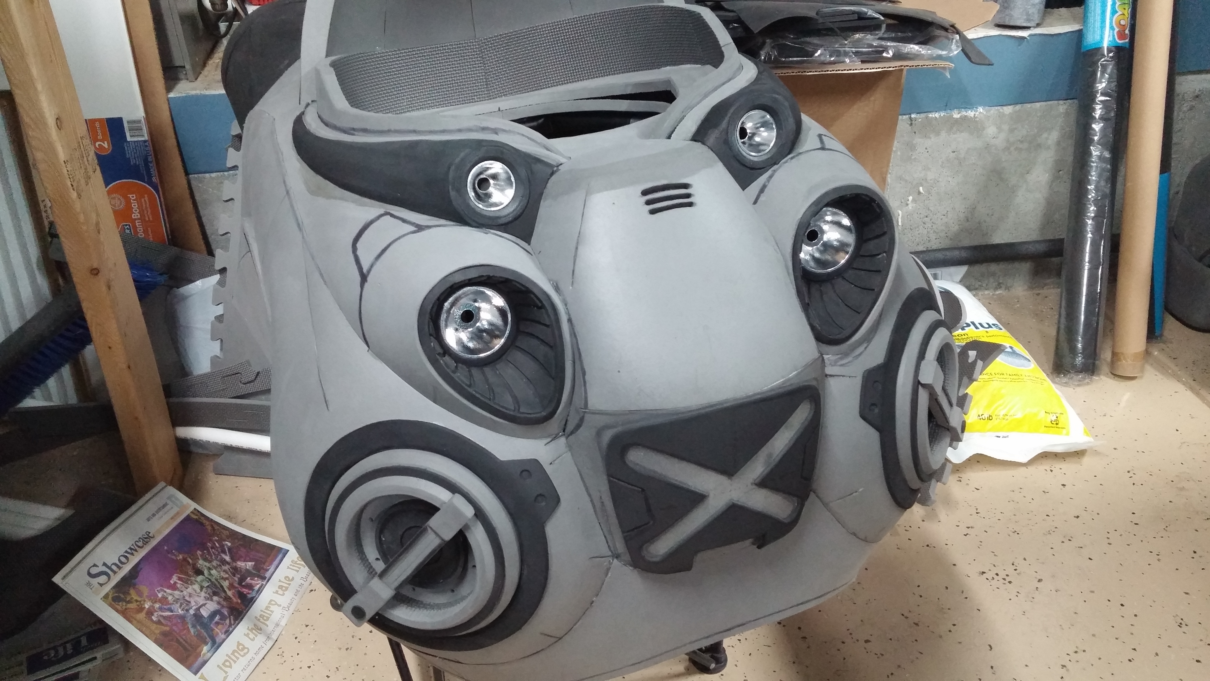

So, small update on the build, mostly just a few detail pieces on the torso. Got the grooves cut, trim pieces attached, and a few small greebiles put on. I even added a piece on the center chest that wasn't even on my original plan. I decided after looking at the game models some more I had to add that detail. I'm thinking the next step is the lighting! Just need to pick up some solder and heat shrink tubing. Stay tuned!
Also, I'm still debating the best option for finishing and sealing the foam. I've heard a lot about Epsilon, anyone had any experience with it? I've been told plastidip right onto the foam before paint, I've heard PVA glue but my few tests prove less than successful. Opinions? This thing is big and won't flex very much but if it still does in places I don't want it to crack or flake. Thanks ahead of time for the help!

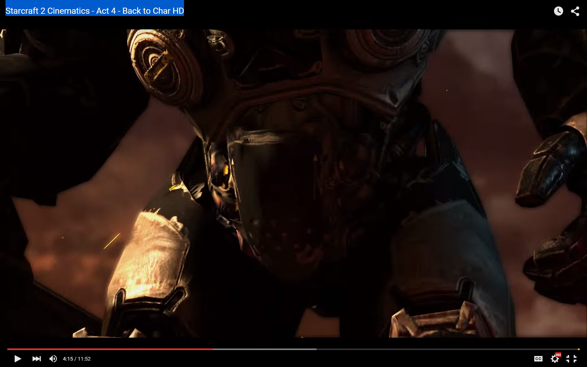

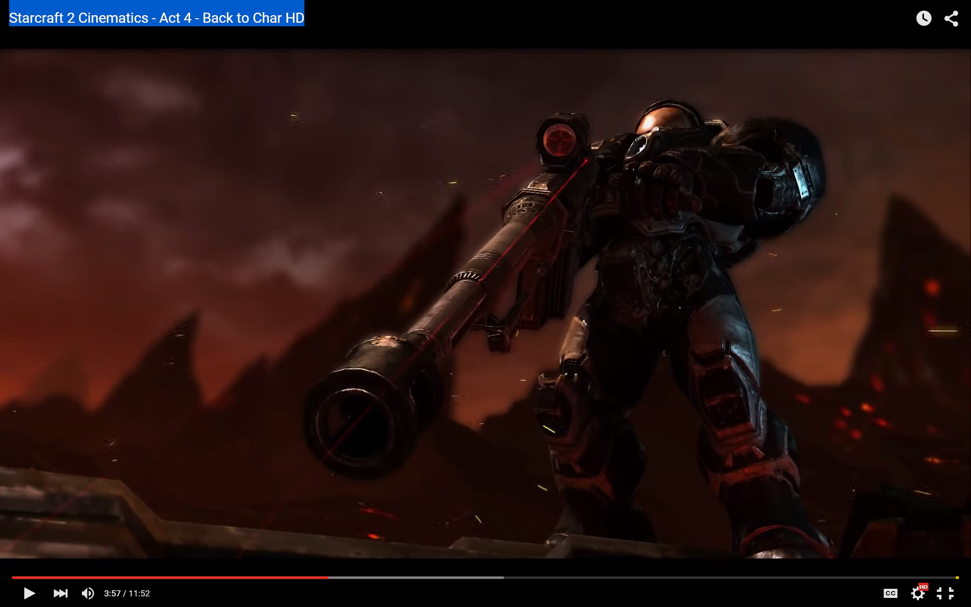

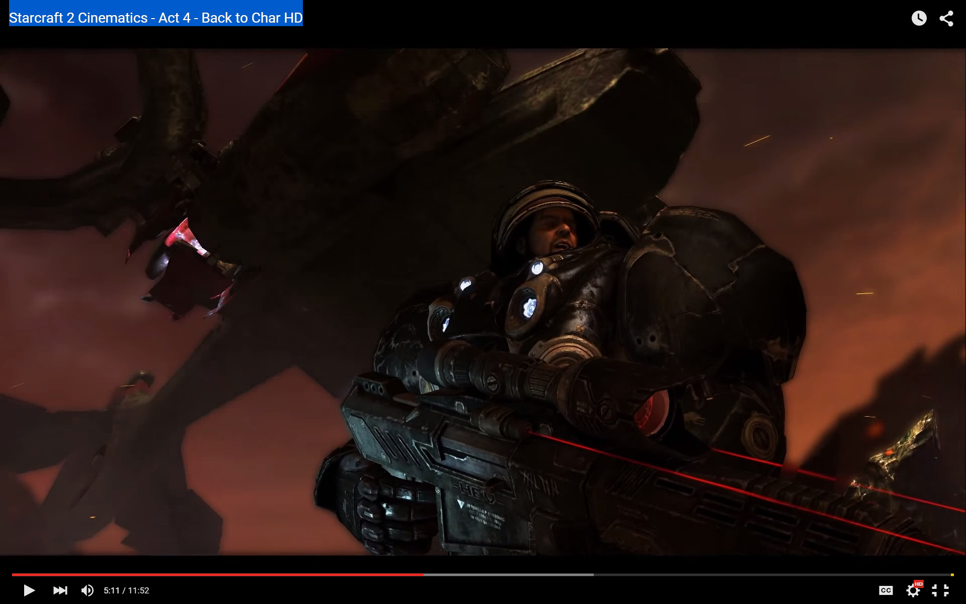

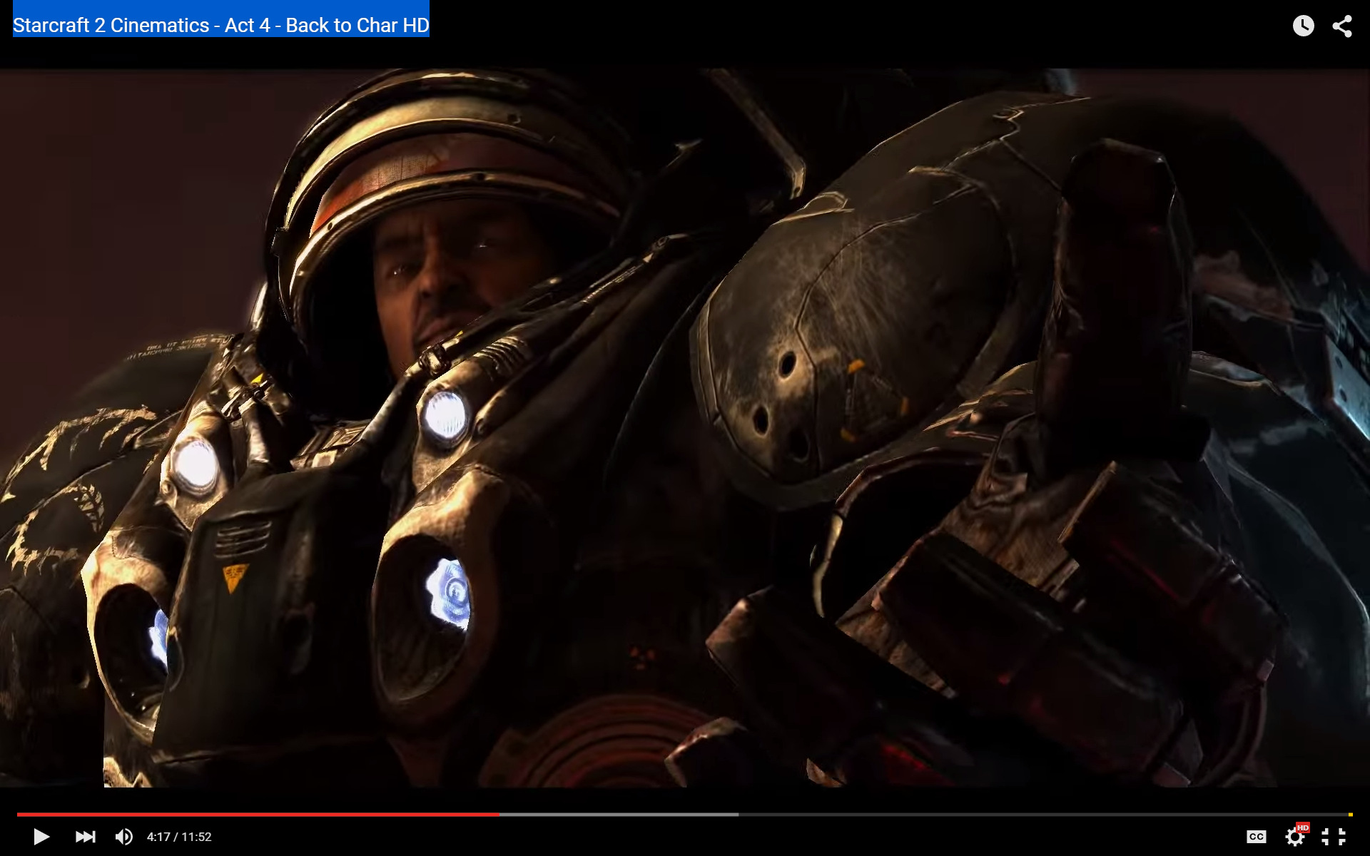

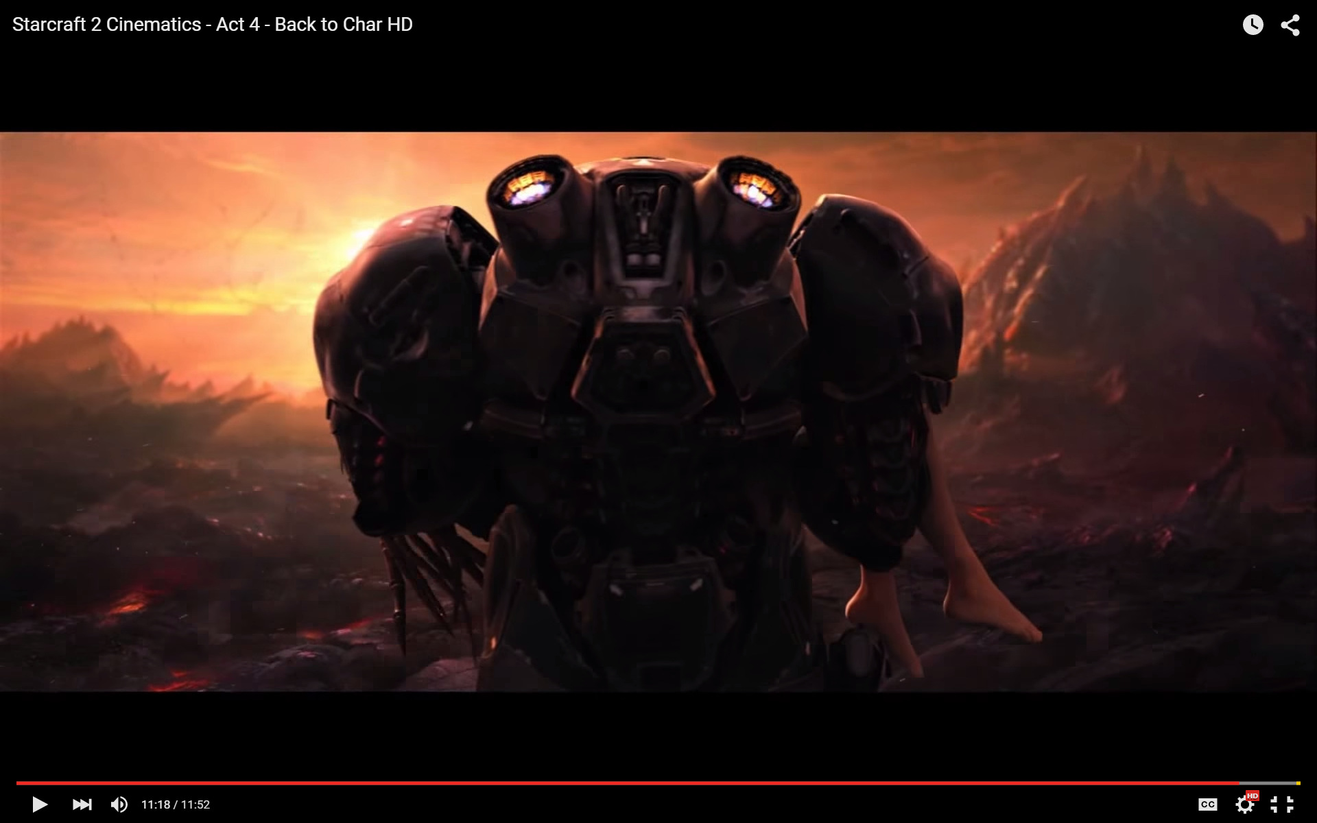

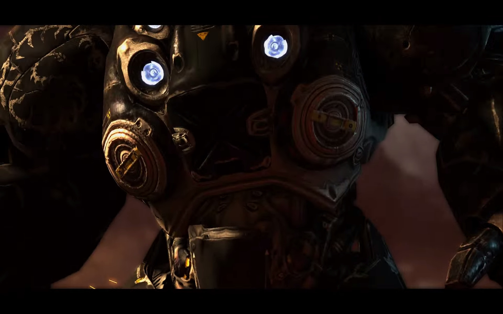

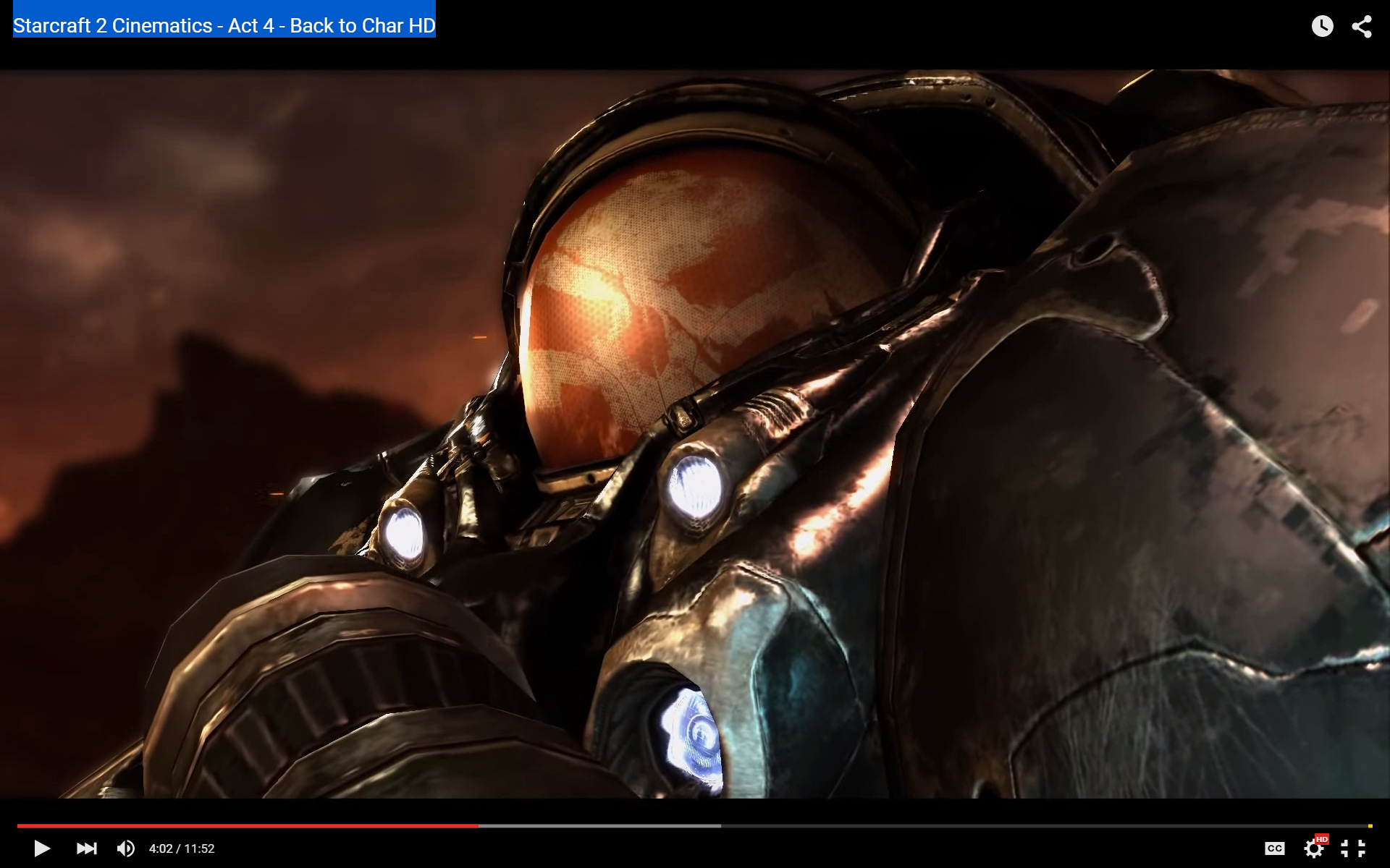

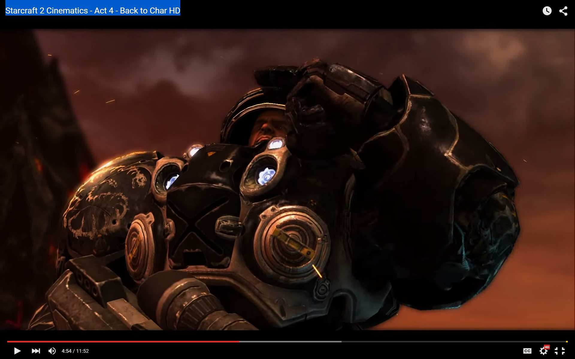

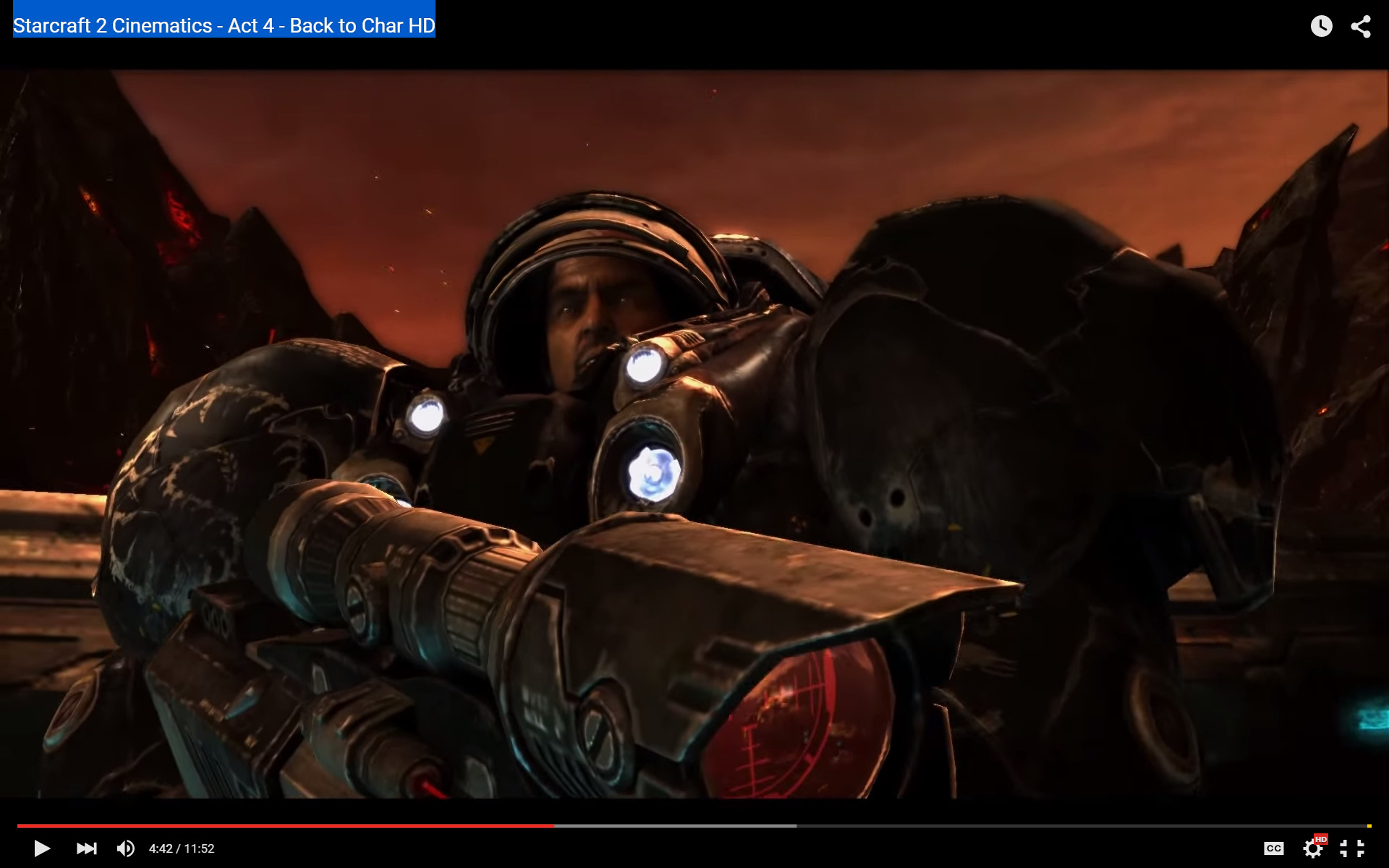

My vote is for the gunmetal grey scheme too, as it reminds me of Raynor's grey scheme (as seen on Char in the Cinematics - below).
I'm certainly not suggesting copying his scheme, but there are some bad-ass features in how the colors are applied, where & highlighting. I would suggest looking at that again, for a references. The other thing I like is the weathering that was applied, the scratches, etc. I'll drop some reference photos (...that you probably already have)
On your visor, are you going with the straight color, or would you perhaps apply an overlay feature? Raynor has the skull, so that's already done.... how about a Tauren Bull Skull? (OK, I'll stop drinking the crazy juice).
Are you definitely going with the Gauss rifle? I like the HEV rifle - and definitely love the 'tick marks' of kills on the side.
As said, keep up the awesome work!
1-Fullscreen capture 1032015 41553 PM.jpg2-Fullscreen capture 1032015 41606 PM.jpg3-Fullscreen capture 1032015 41621 PM.jpg4-Fullscreen capture 1032015 41637 PM.jpg5-Fullscreen capture 1032015 41642 PM.jpg6-Fullscreen capture 1032015 41725 PM.jpg7-Fullscreen capture 1032015 41758 PM.jpg8-Fullscreen capture 1032015 41821 PM.jpg9-Fullscreen capture 1032015 42013 PM.jpg

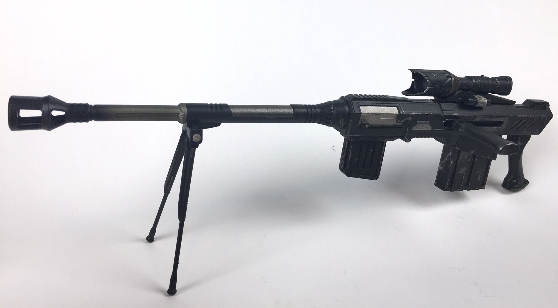

Good on you then! I haven't found much on the HEV, although it's a Sniper Rifle, but not like the ones used by the Ghosts. I'm upping a few pictures - I'm sorry it's not scaled or anything.
BUT, I am bringing Christmas early... Well, OK, maybe just some more pictures. I'm assuming that you've seen the 1:6 articulated figure from Sideshow Collectibles?
It's Incredible - The level of detail is A-MAZE-BALLS!!! But of benefit are the photos... (AND it even comes with the HEV gun!) If I only had an extra 500 dollars laying around.... I'm also including some Tychus reference photos. Take a look at how and where they did the weathering, decal placement, etc. Take a look at the shot of his back - One thing that I really liked was how they treated some of the detailing with the Gold/yellow accents (at the elbow/spine and the center portion between the exhaust ports). It really works with the gray/pewter colors. I hope this helps!
PS. Ummm.. When you're in the suit... How in the heck do you... go to the bathroom? Is that going to be a half-hour process?
(i.e. you ought to have a small, "NO TACOS or CHILI" decal hidden somewhere on the back of the suit!)
Link to Sideshow video: https://youtu.be/Beob2ax-4Mo
Link to Tested's Review video: https://youtu.be/4FJE-vBxIl0
Pics:
HEVRifle_SC2_Phys1.jpg100181-raynor-012.jpg100181-raynor-018.jpgf6adbf0660449083.jpgsc_1_1024x1024.jpg
