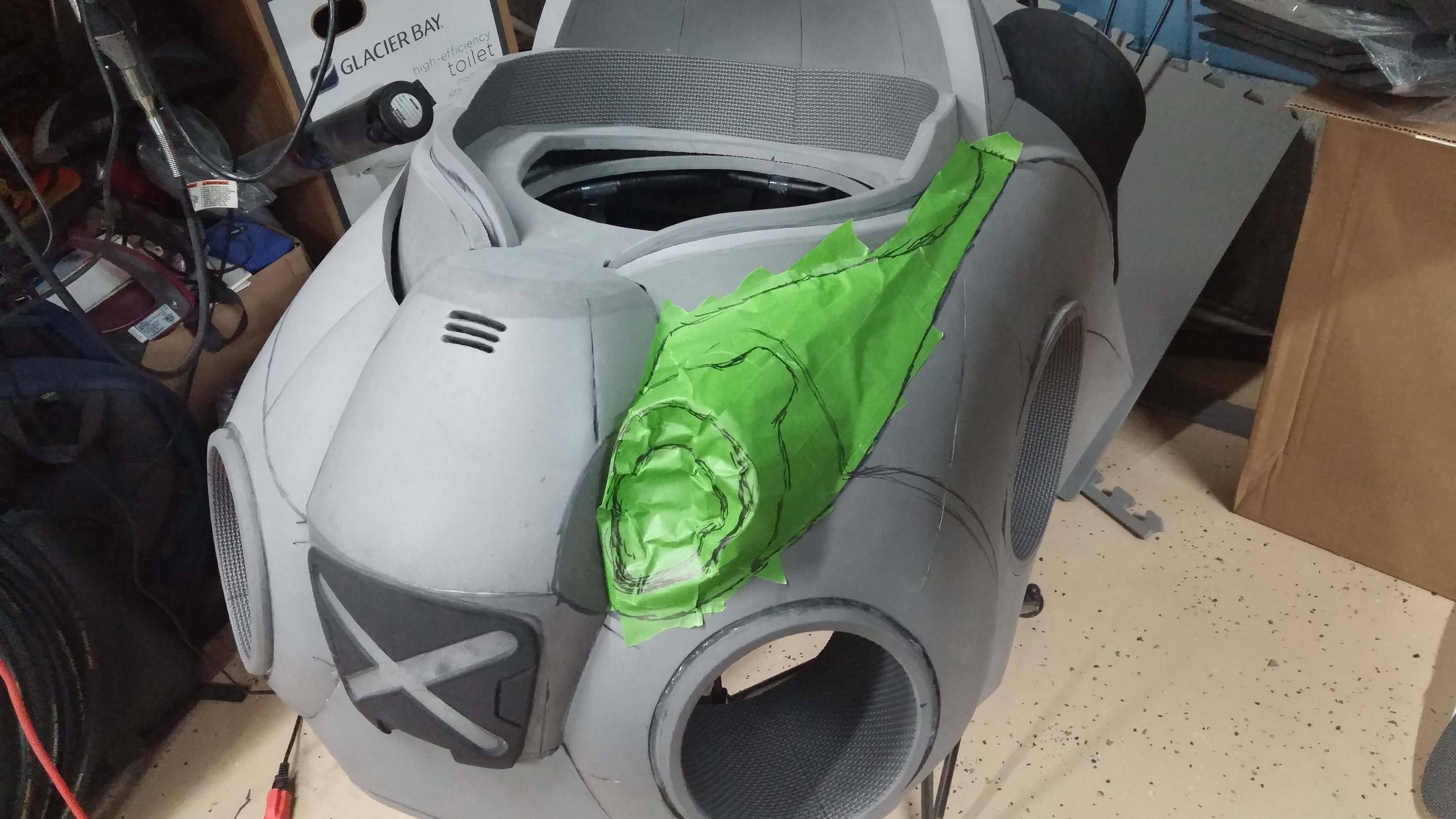

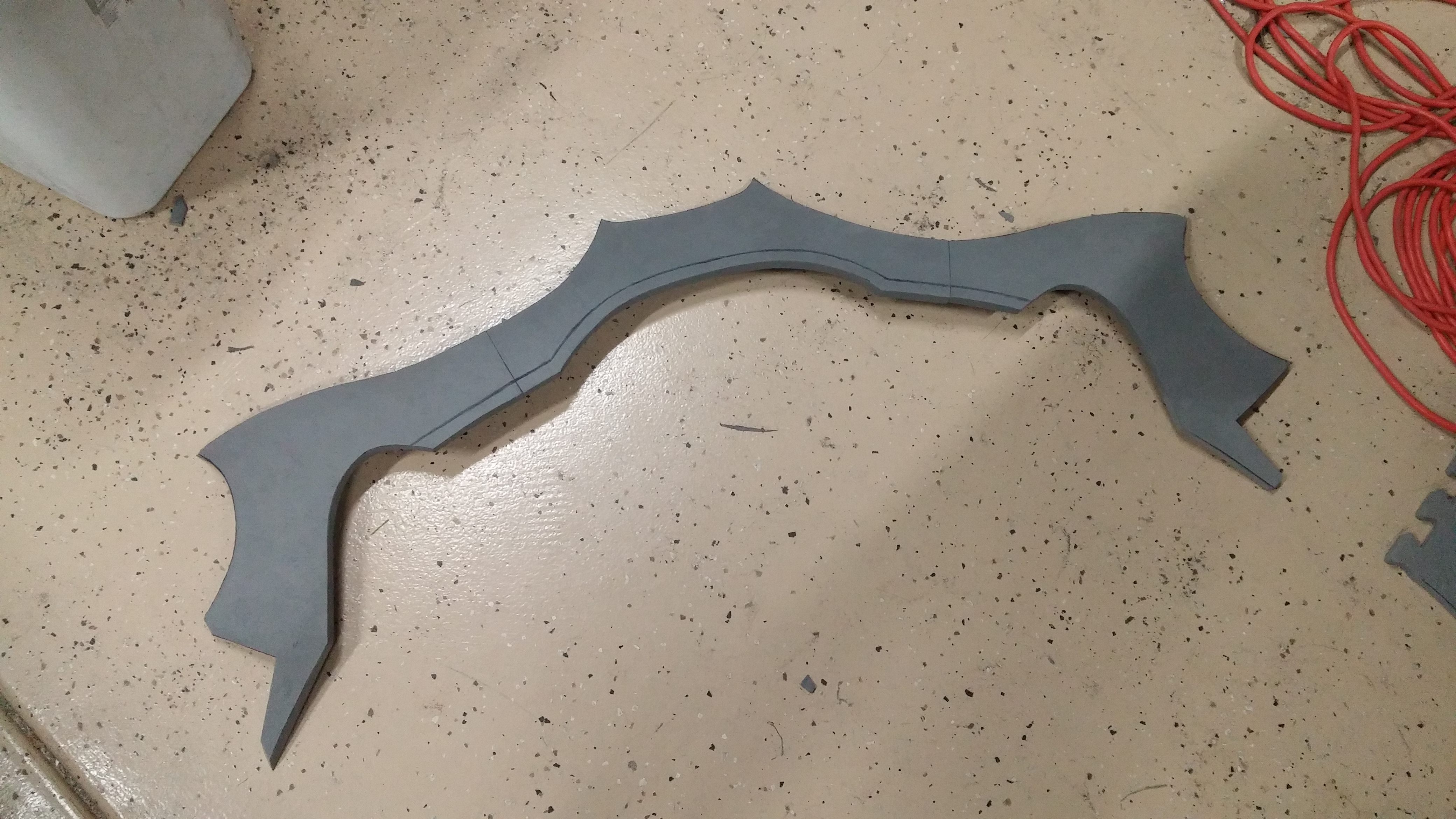

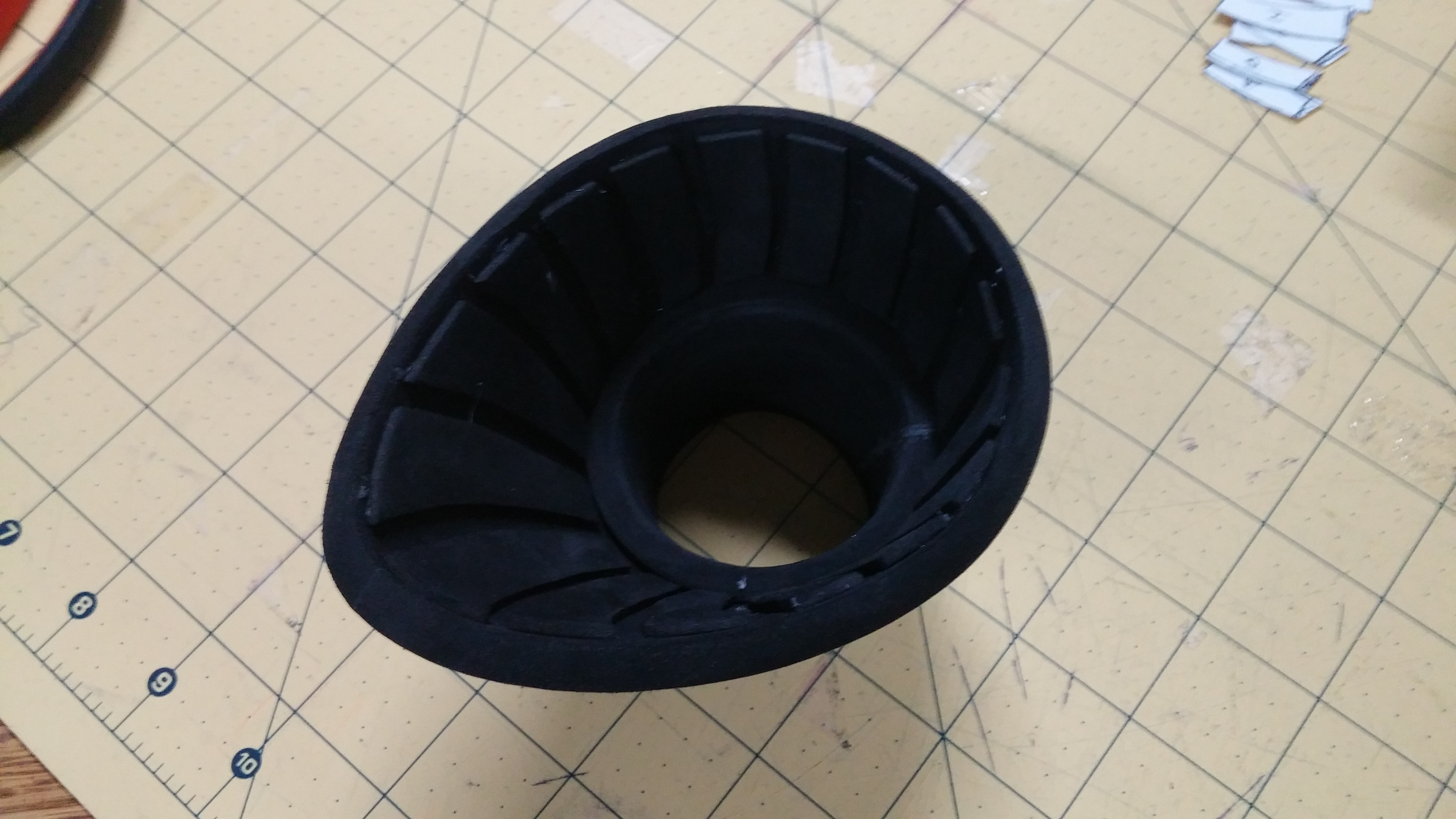

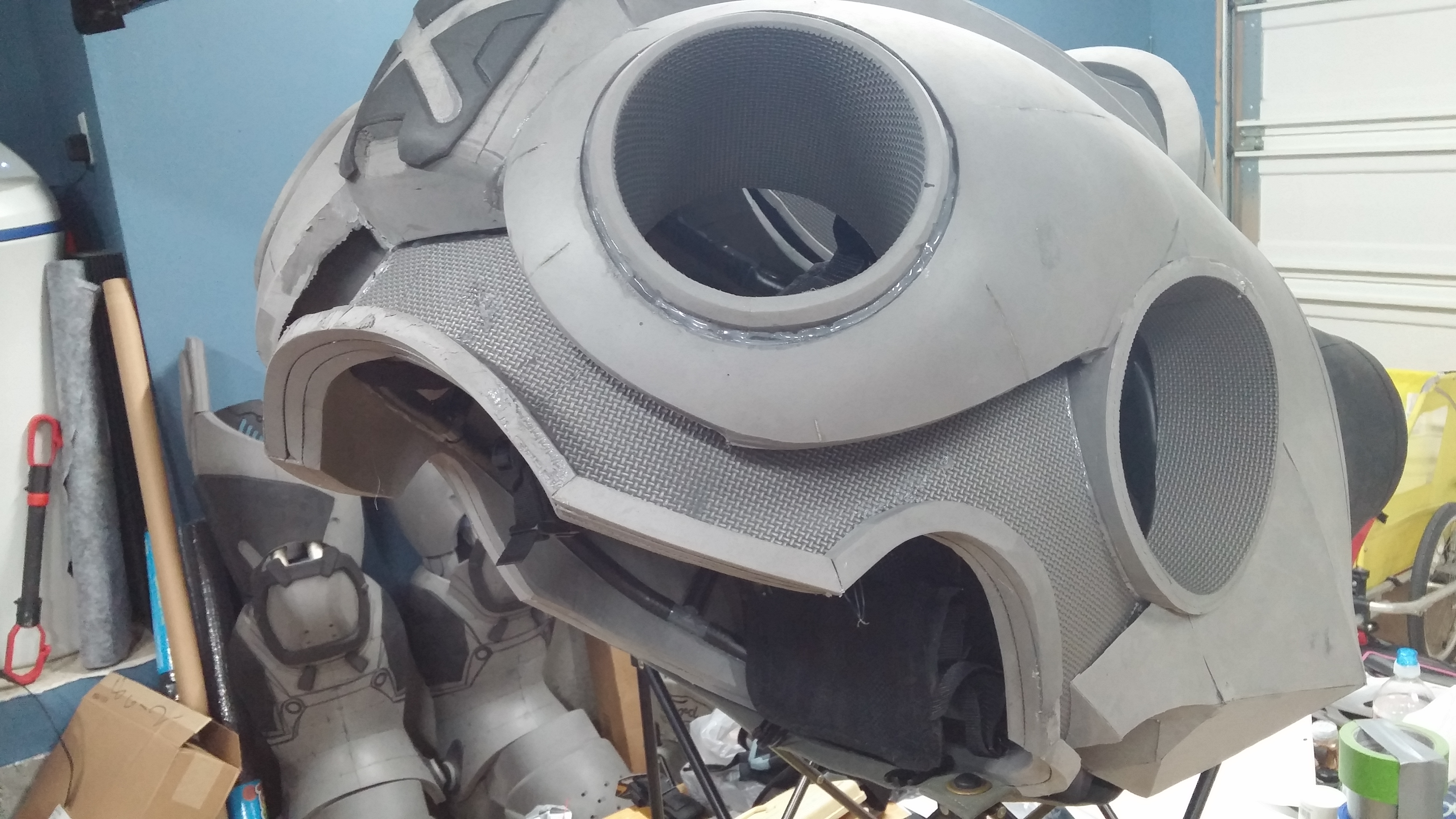

Minor update on the foam work, the trickiest part to date (I know I've said that before but I keep finding new ways to stump myself) is the lower surround to cover the gaps in the front and back. Kind of hard to describe but you'll get it looking at the pictures. I trimmed the existing foam pieces back a bit, added some layers around the lower edge to build up thickness, and used frog tape to create the shape I'd need to cover it all up. Confused yet? Ok pics are worth their weight in words so here they are:
Didn't turn out exactly as I'd planned due to cutting the edges at a tad too sharp of angles, but not too bad, I think. If anyone wants more detail on how I did that I'm happy to oblige.

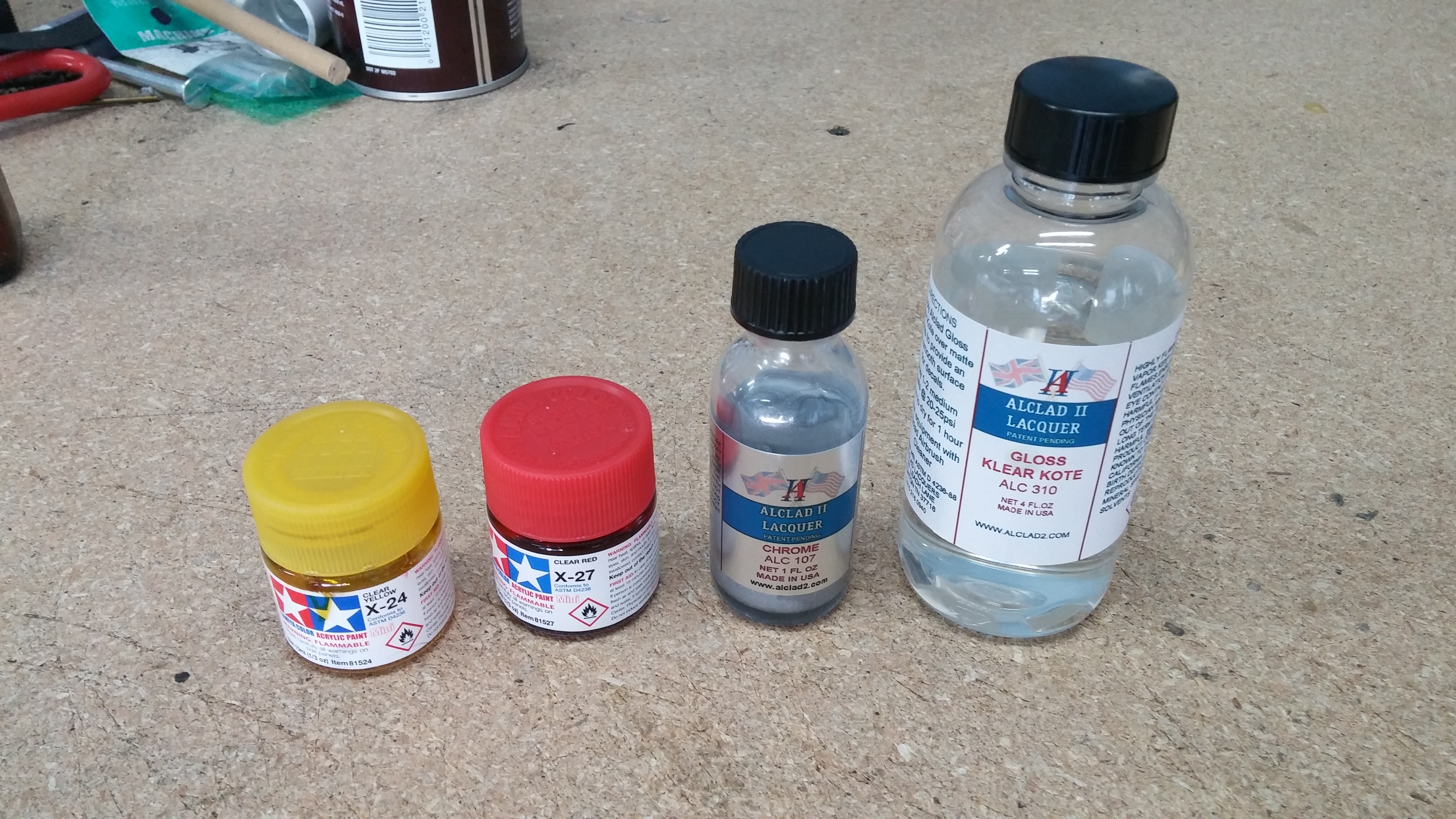

I bought 4 kinds of paint. I have Alclad II Chrome and Klear Kote, and Tamiya clear red and clear yellow acrylic. You'll also need tamiya's acrylic thinner in order to spray the stuff because it's surprisingly thick and will gum up your airbrush. FYI they have many different colors of clear so any color or combination thereof will work, as long as it's the "clear" version and not the "transparent" stuff.
You'll need a good cleaner for the airbrush. the Klear is a laquer so the Tamiya thinner won't work to clean it out of the airbrush. Learned that the hard way.

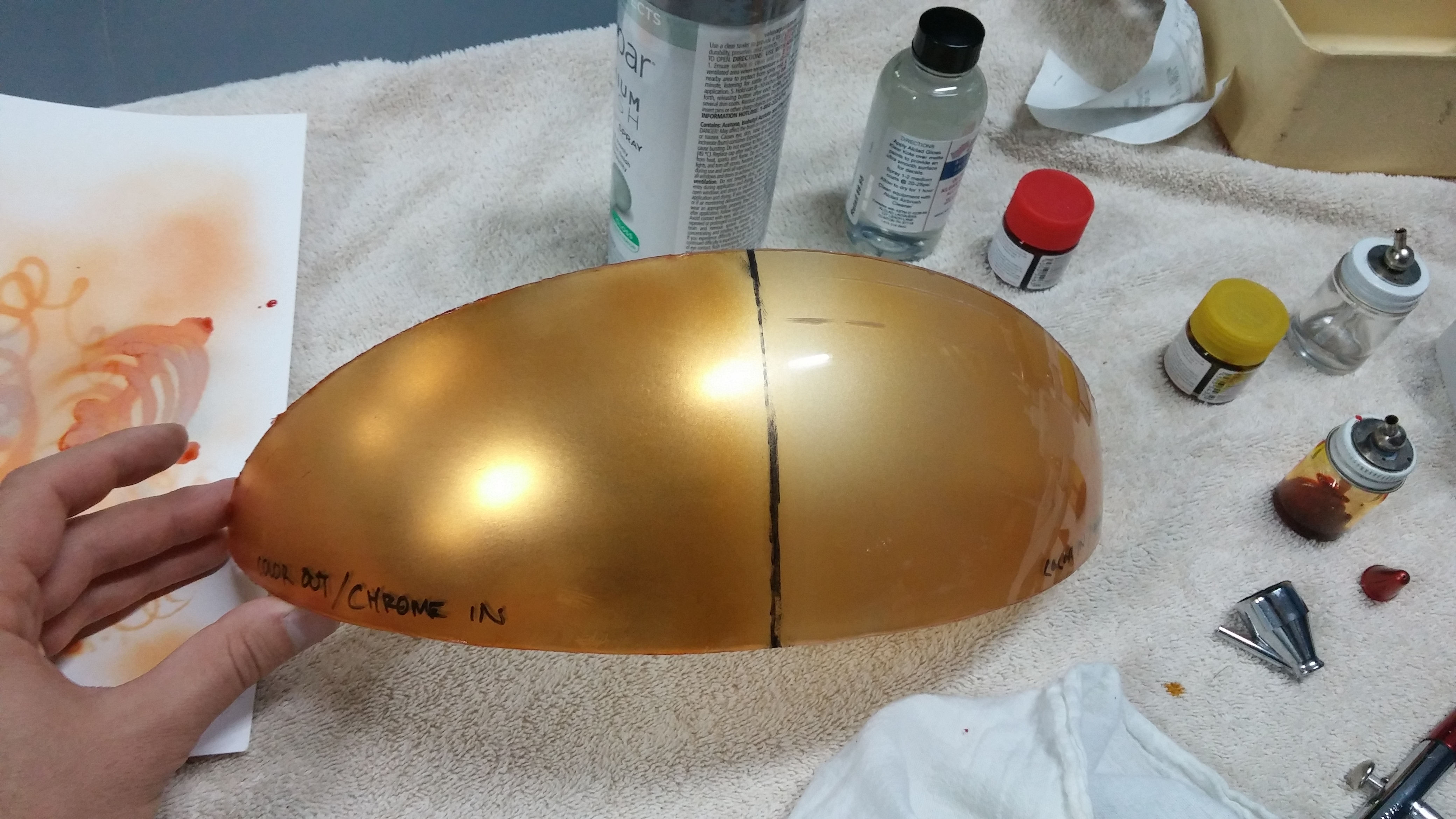

Spray the chrome on the INSIDE of the piece.
The Alclad is airbrush-ready and does not need to be thinned. They recommend between 12-15psi for the chrome. Make sure your piece is VERY clean, with no fingerprints or dust at all! Those will show up at this point if they are present. Spray the chrome on the inside face of your piece as lightly as you can. The idea is to build up several very light layers in order to keep it thin enough to still see through from the back. After several light coats you'll start to see the surface starting to become darker and shinier. At that point, STOP. You've probably got it enough. Any thicker and it will no longer be see-through (as shown by my first test piece). It won't look very mirror-like yet but trust me, it will be. FYI this paint is truley incredible! I thought for sure I'd get the same result as a spray can style chrome that turns out more silver than chrome but YOWZER this stuff could not be closer to real chrome! Just spray it as evenly as you possibly can because you'll be able to see the thin spots. Let the chrome dry for about 15 minutes, but be aware: until you clear coat the stuff it's extremely delecate and will wipe off with just the pressure of you finger.
Step 4:

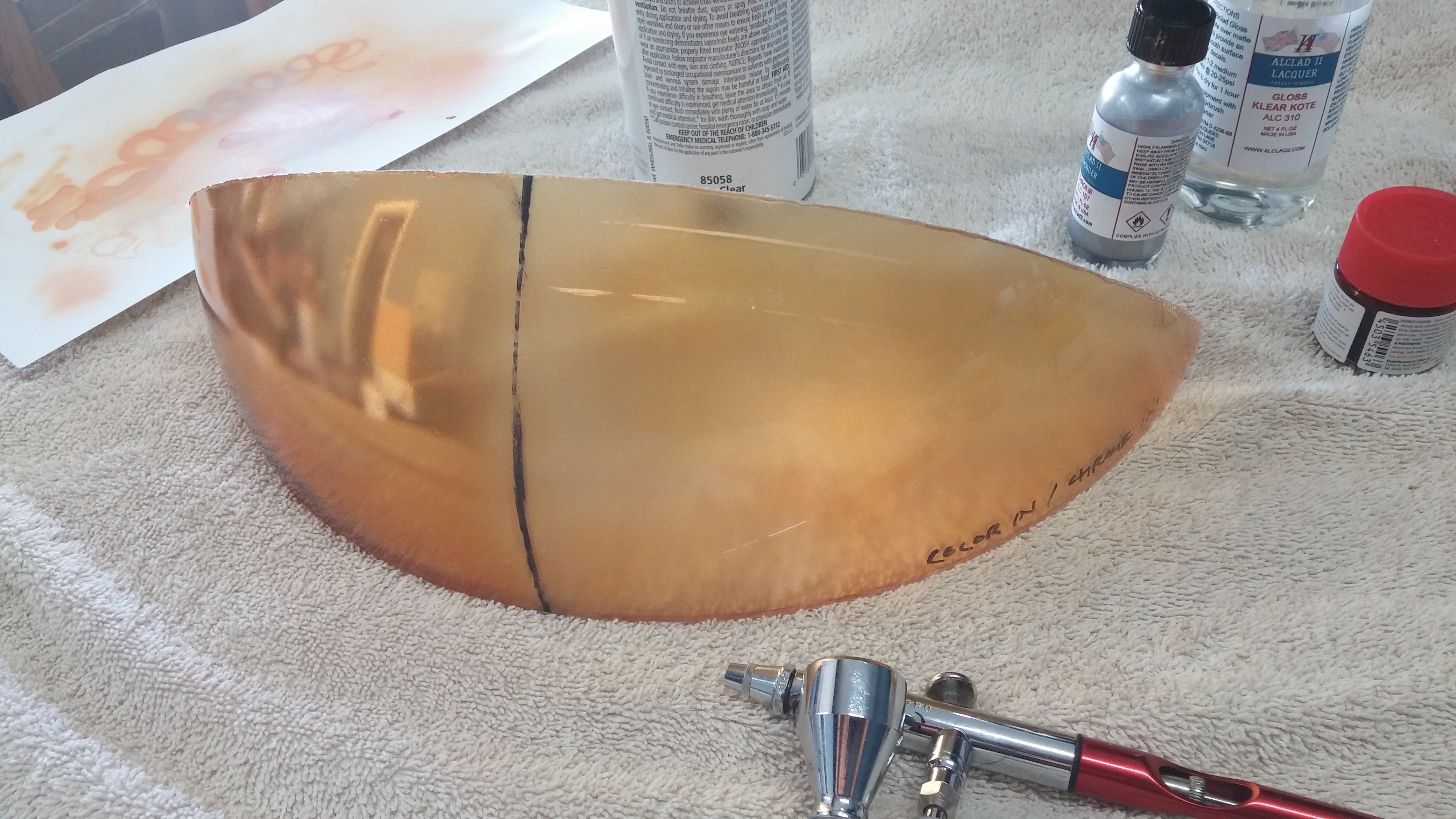

Mix the color acrylics to the shade desired and spray on the outside of the piece.

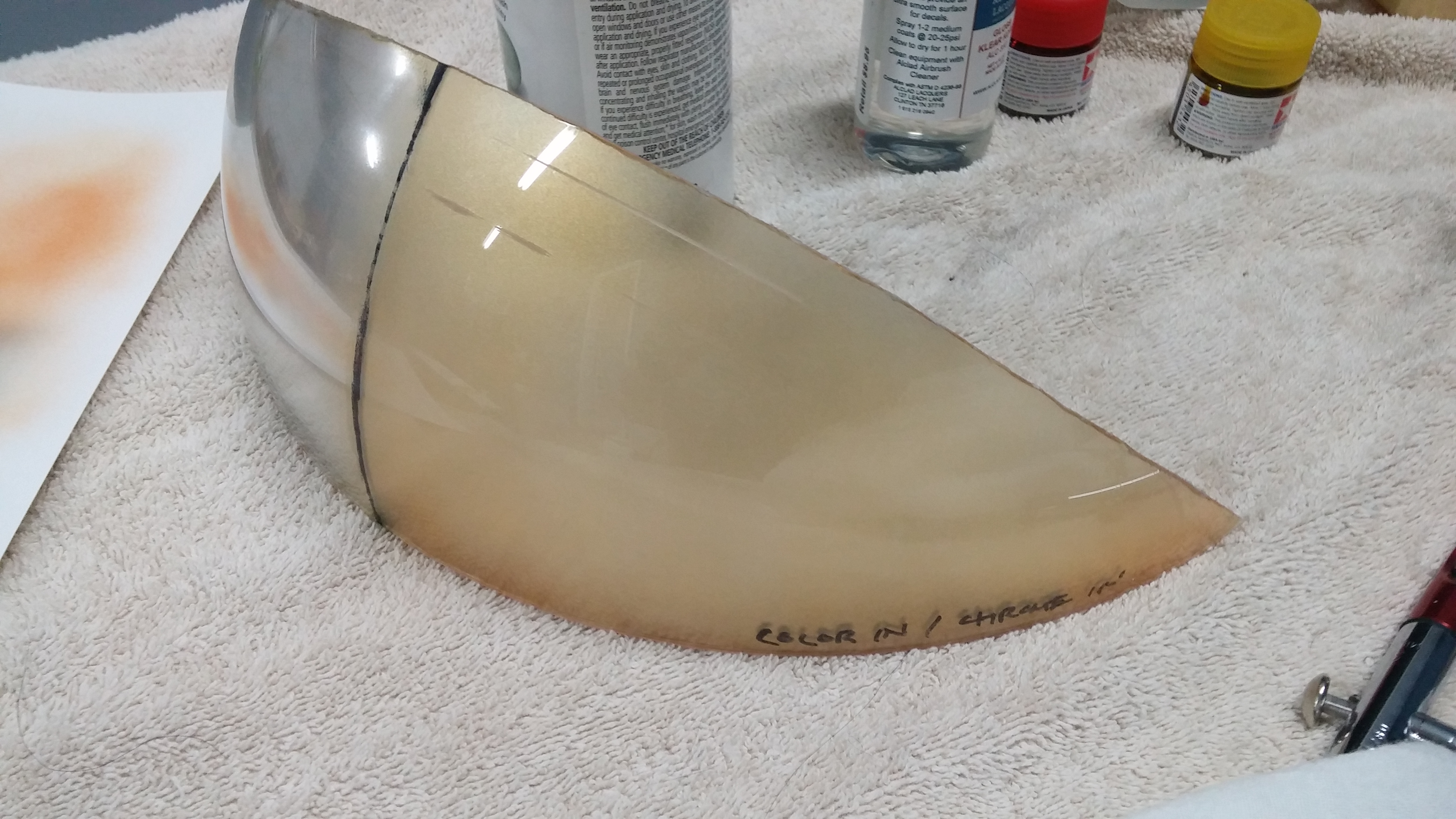

I used about a 4:1 ratio of the yellow to red, and not quite 50/50 with the thinner. I wanted darker than just yellow but not orange, so mixing worked for that. Try spraying a bit on a white piece of paper before you start in on the plastic to make sure the color is what you want, as well as the right consistency to spray evenly thru the gun without droplets forming and making a mess of the surface. The paper is white and opaque so the color will be far bolder than on a clear or reflective surface so try to get it just a bit darker than you want the final result to be. You'll be putting it on thin enough that the darker the color, the less you may have to put on.

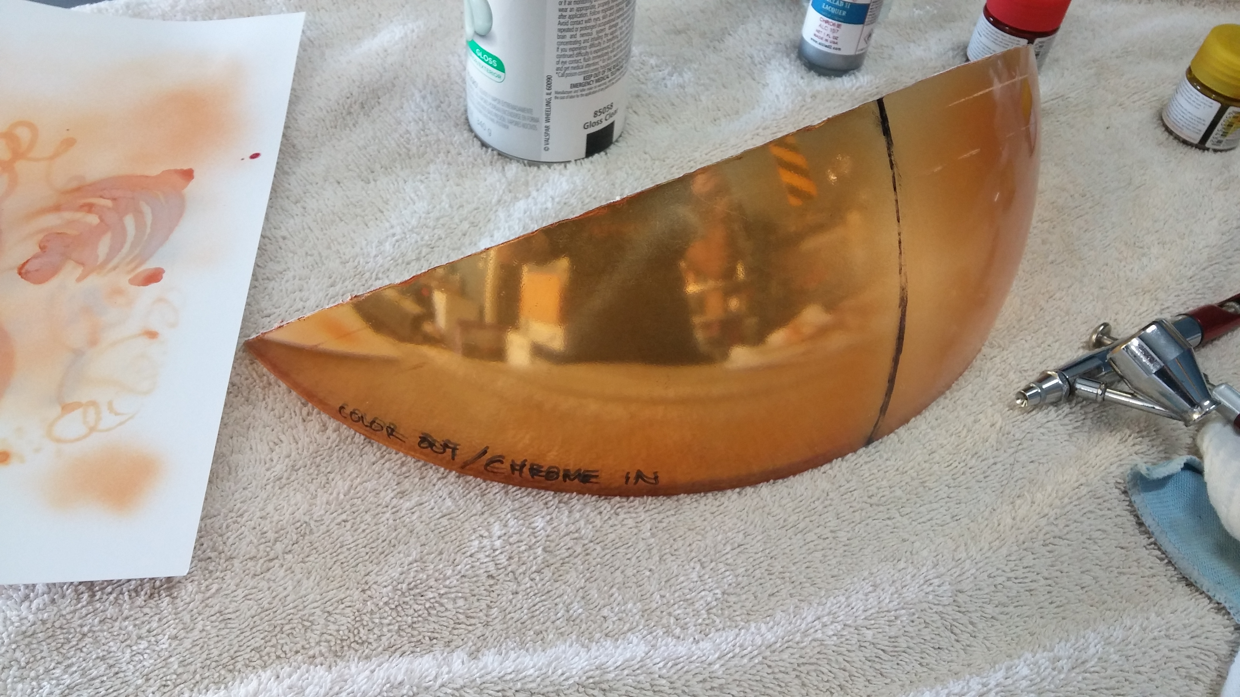

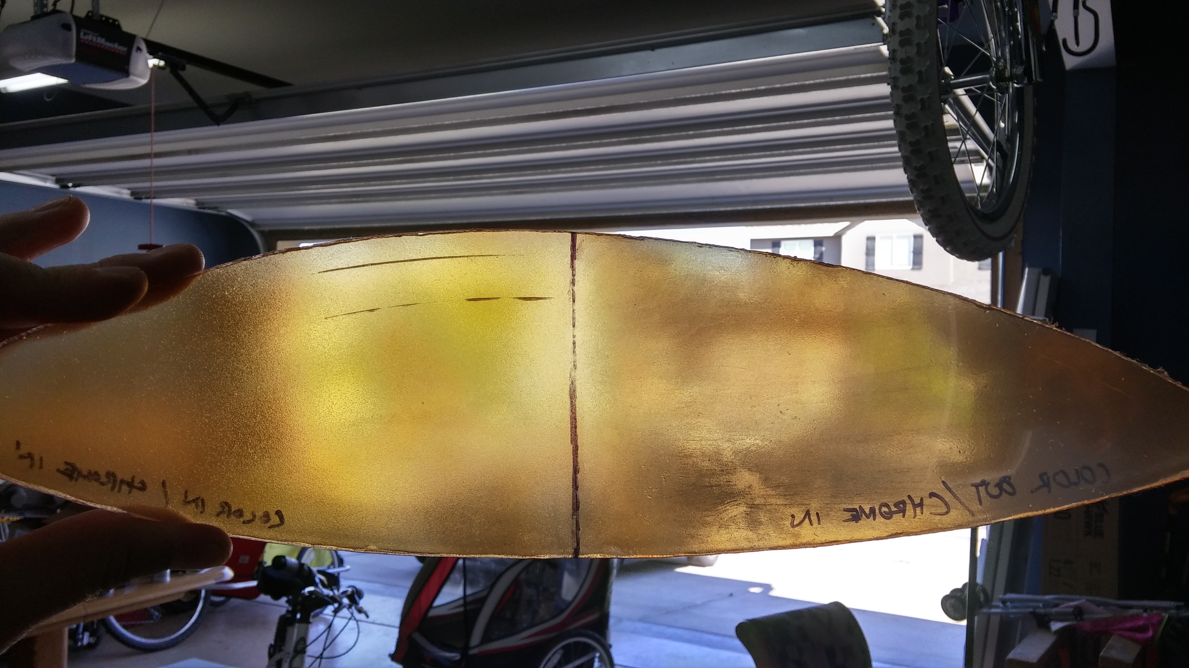

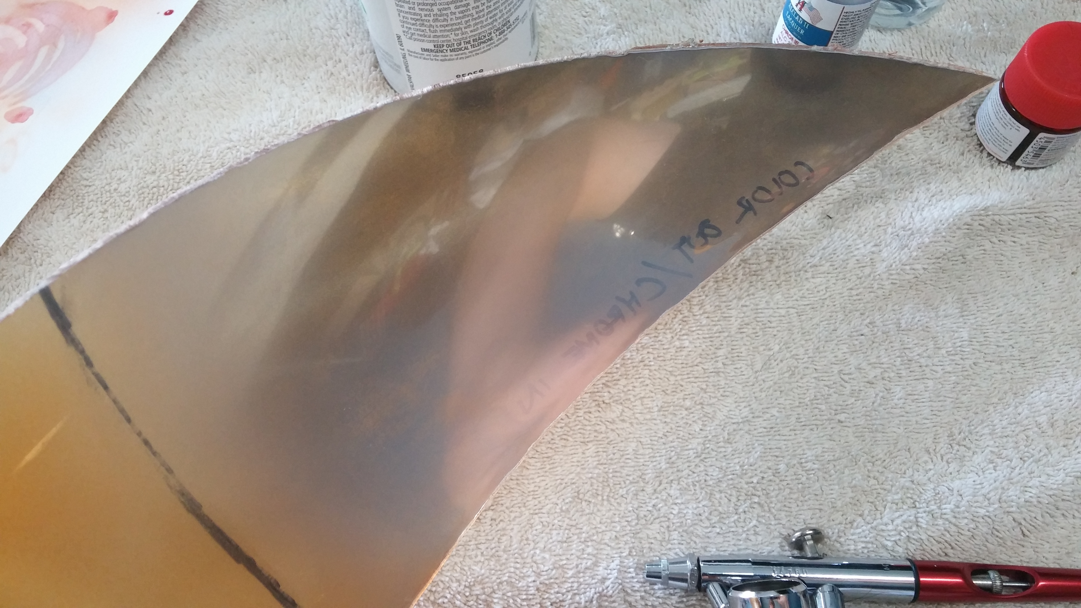

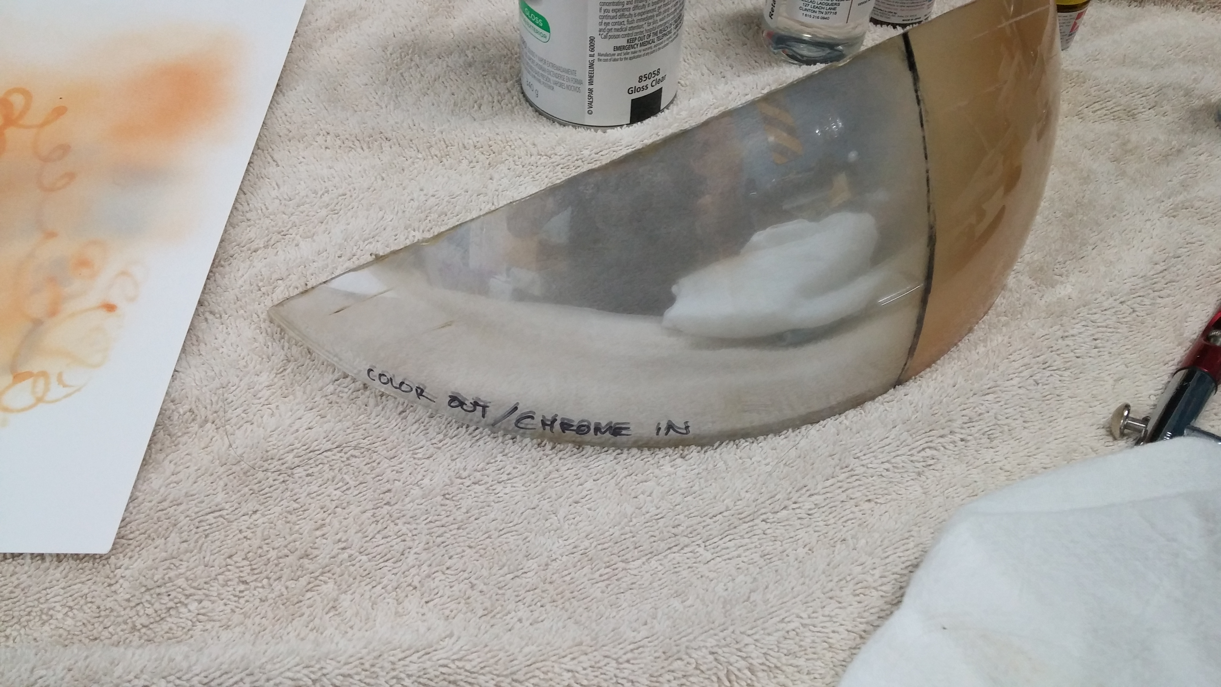

I tried a different method to begin with on my test piece, which was spraying the color on first, half on the outside and half on the inside before the chrome goes on. I was hoping to retain the naturaly shinyness of the dome itsself and thought that I could just spray the chrome on over the top of the color to make that happen. That... didn't work. It looks ok from the outside but visibility is next to nothing and the surface finish is terrible. Also, I sprayed the chome on way too thick to begin with. Take it slow with that stuff. A little bit goes a long way!
20150907_103842.jpg 20150907_103852.jpg 20150907_105239.jpg 20150907_105252.jpg
As you can see, visibility on the test was.. well... non-existent. Slightly better on the side with the chrome inside/color outside however. Stick with that method. The key is a noce smooth surface for the chrome to stick too. The color coat on the inside makes is rough so the chrome can't coat evenly and lay flat like it's supposed to. That wreaks havok on the surface finish and thus, visibility.
Now I know what you're thinking, it's not shiny enough! Or see-through enough! Your are correct, but that's where the next bit comes in:
Step 5:
Clear coat!
Like you, at this point I had my doubts and couldn't imagine I'd done anything right up to this point. But I plowed on, hoping at some point it'd be ok.
Crank the psi on the compressor up to 20-25psi for the clear and hose the piece down with 2 medium thick coats. Not enough that it runs but enough to glossify the surface. This fills in the spaces between paint particles and adds thickness to the finish which shines up beautifully without even buffing! Later on if you like, (I will) you can go back with very fine sandpaper and buff this thing to a mirror-like finish like you would a car. Wet-sanding tecniques and whatnot. I haven't done that part yet but when I get to it I'll detail that as well. Let the clear dry for at least an hour before touching it as it's very tacky stuff and will accept fingerprints with no argument.
No polishing at all! Just clear coat! As you can see, didn't work too well on the other side. Surprisingly enough, this cleared up the vision a lot! I forgot to get pictures in my excitement that I'd actually done something right, but I could see through the piece well enough to avoid people and obstacles fairly well! Remember tho, I sprayed the chrome on way too thick, so visibility behind the real piece is even better. Looks nice, but too much.

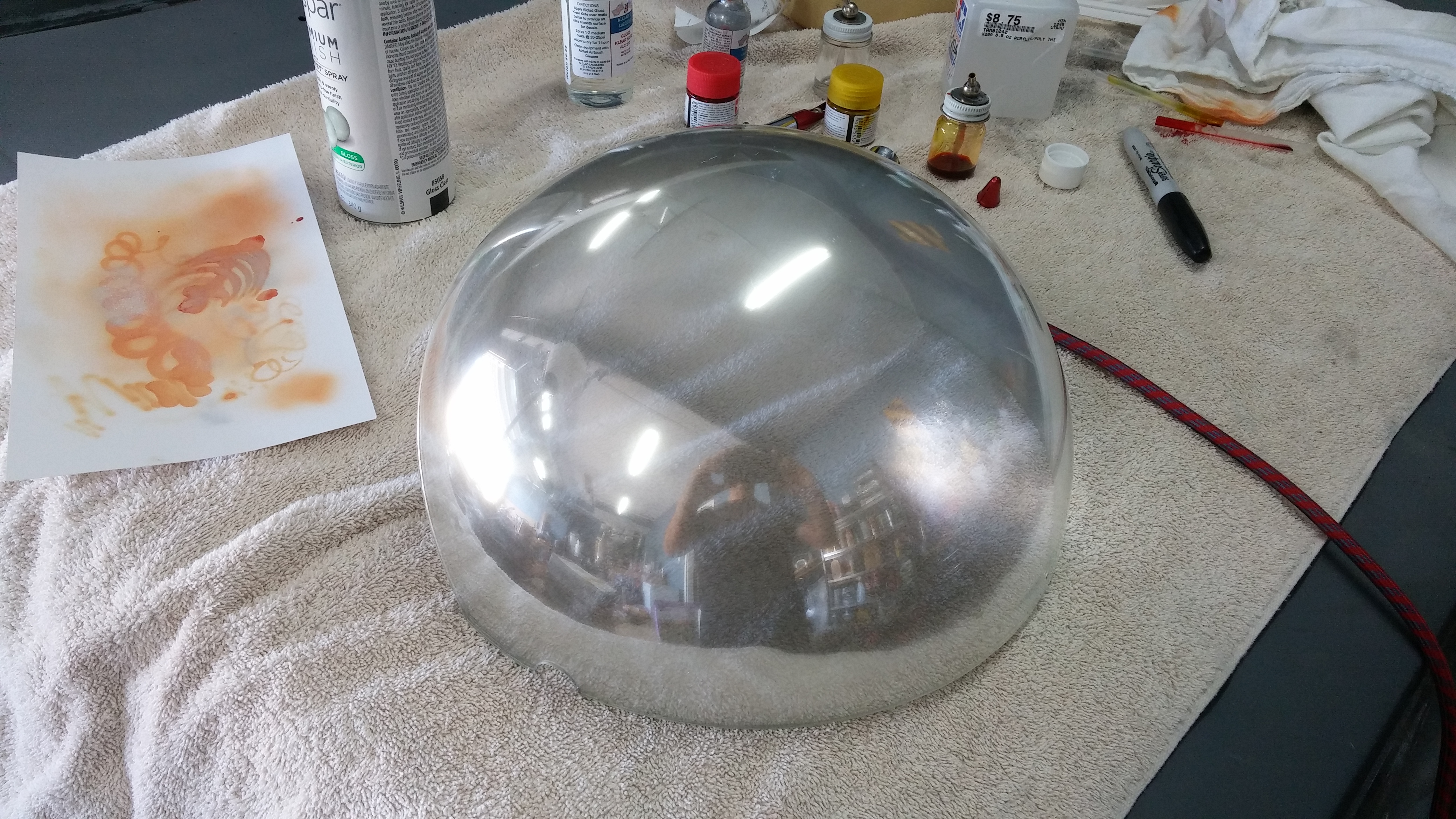

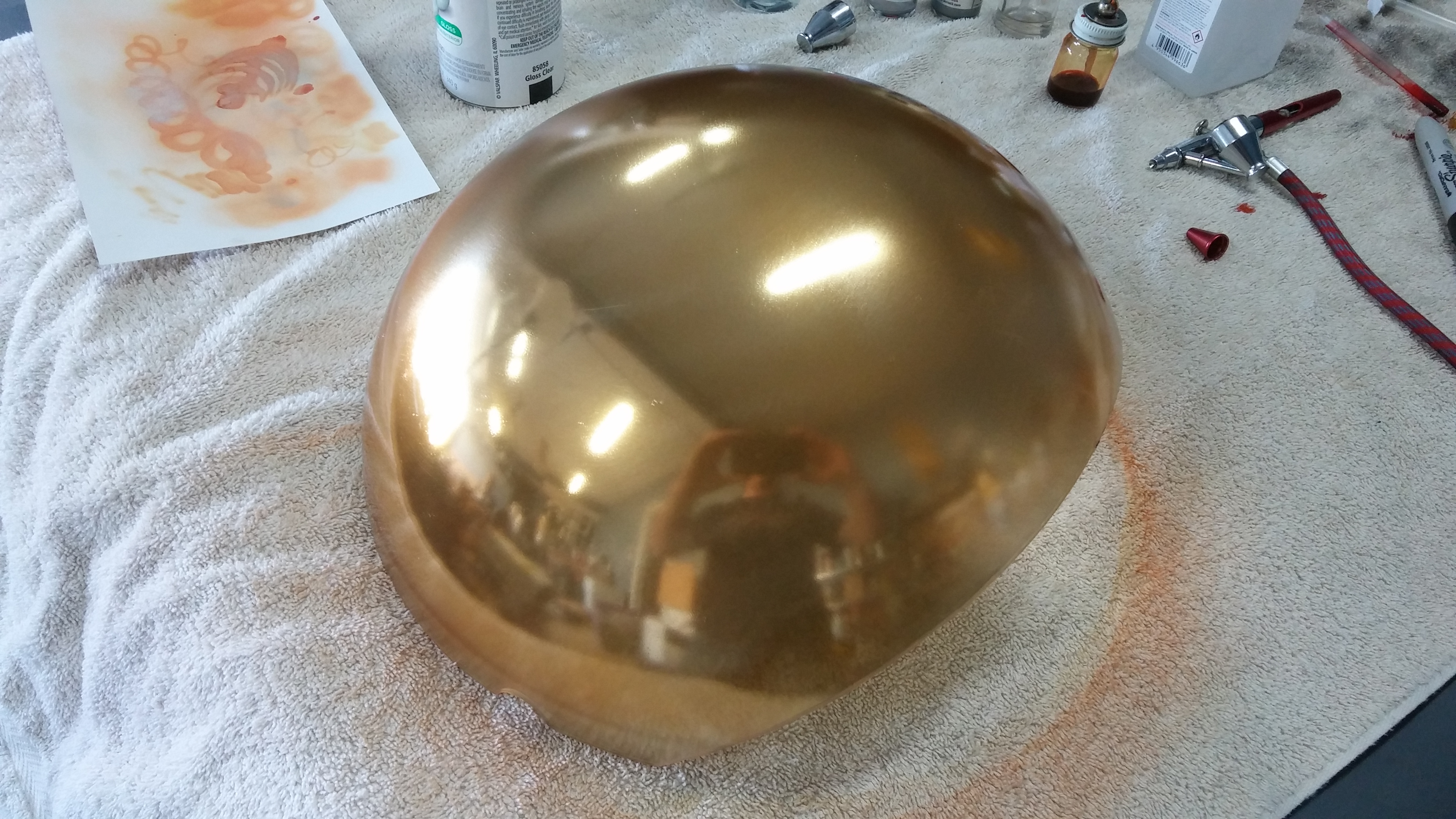

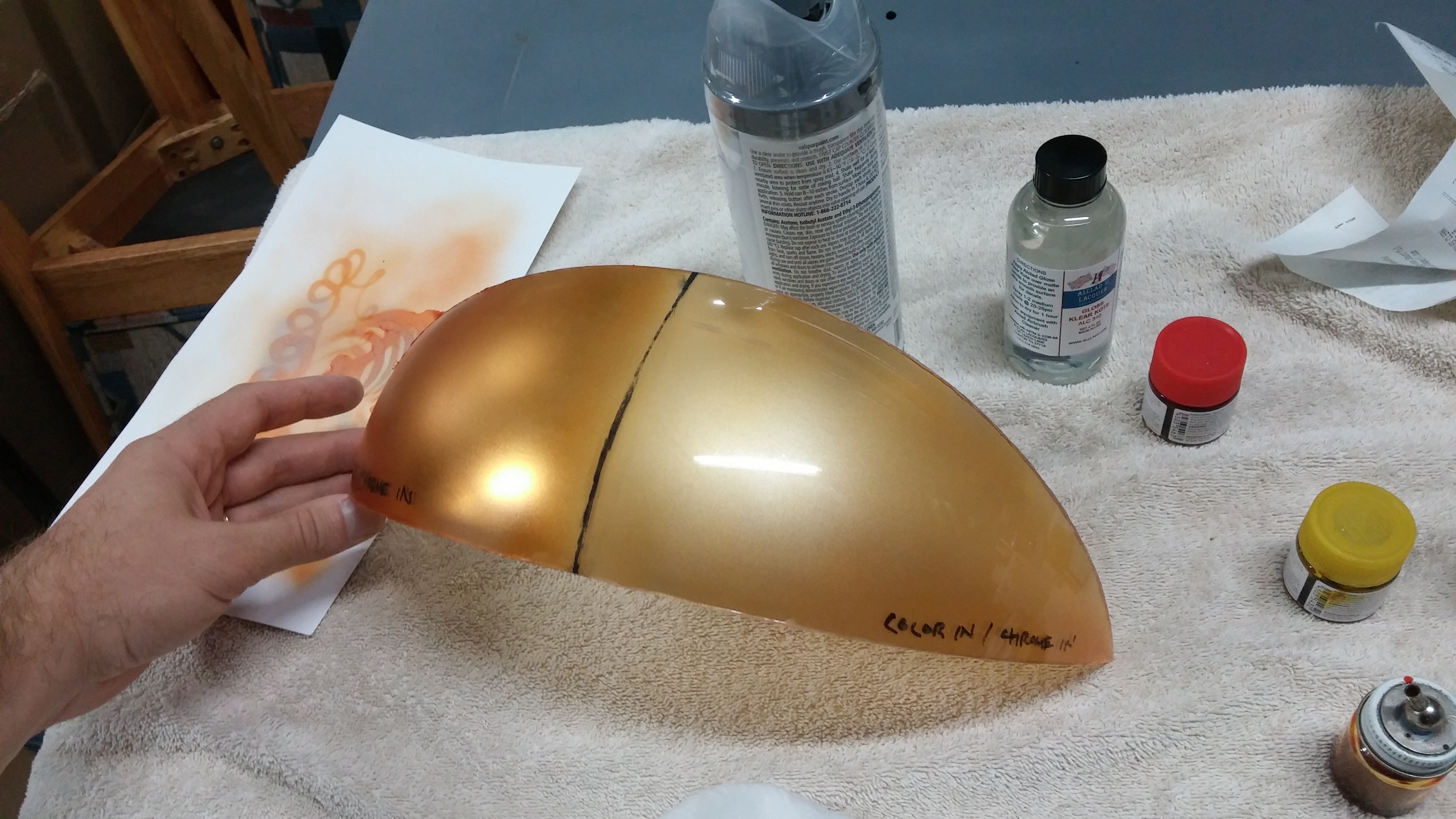

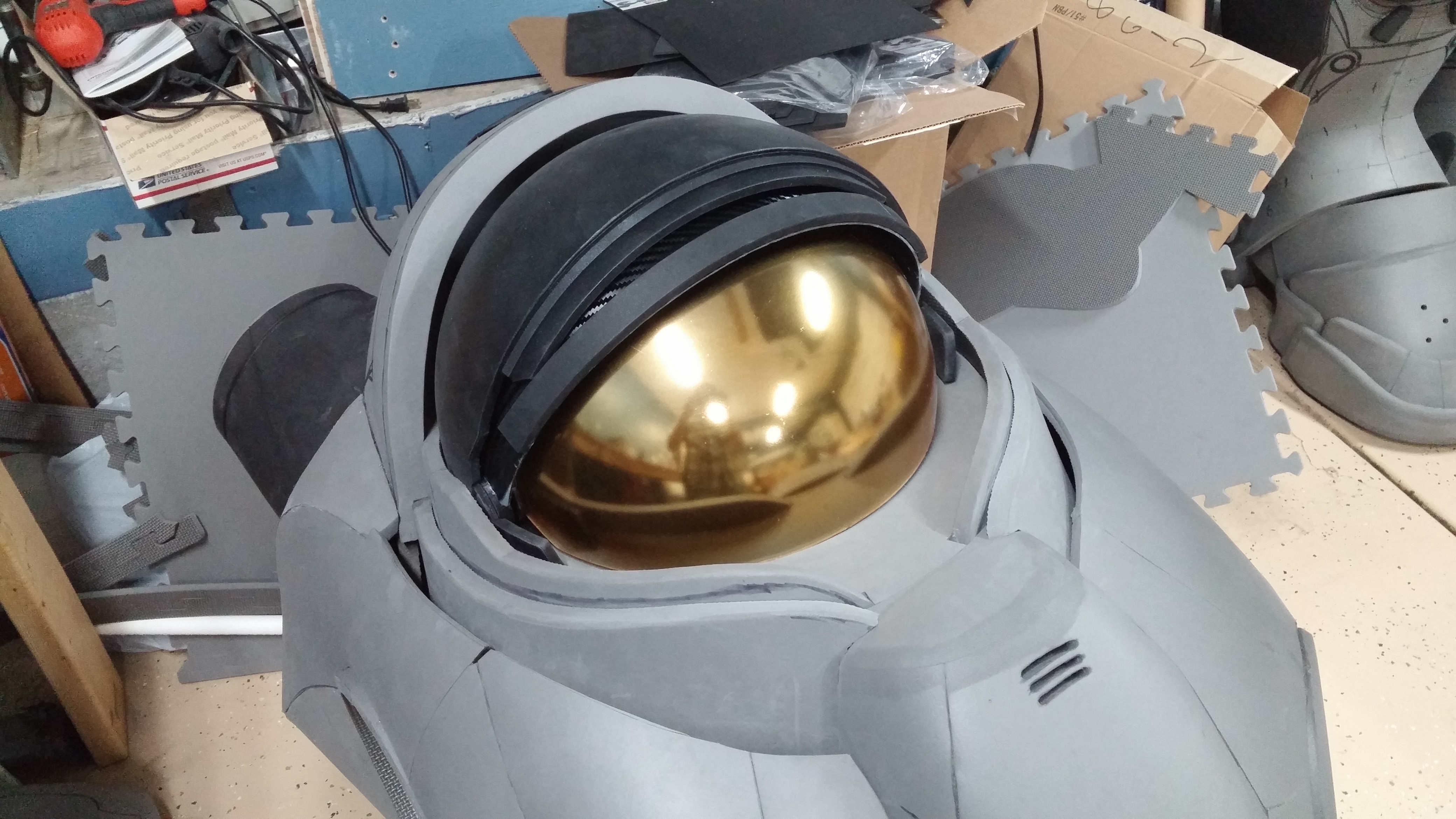

SO! on to the real piece!
Chrome on the inside, lighter this time. So pretty! I was tempted to just stop at this point.

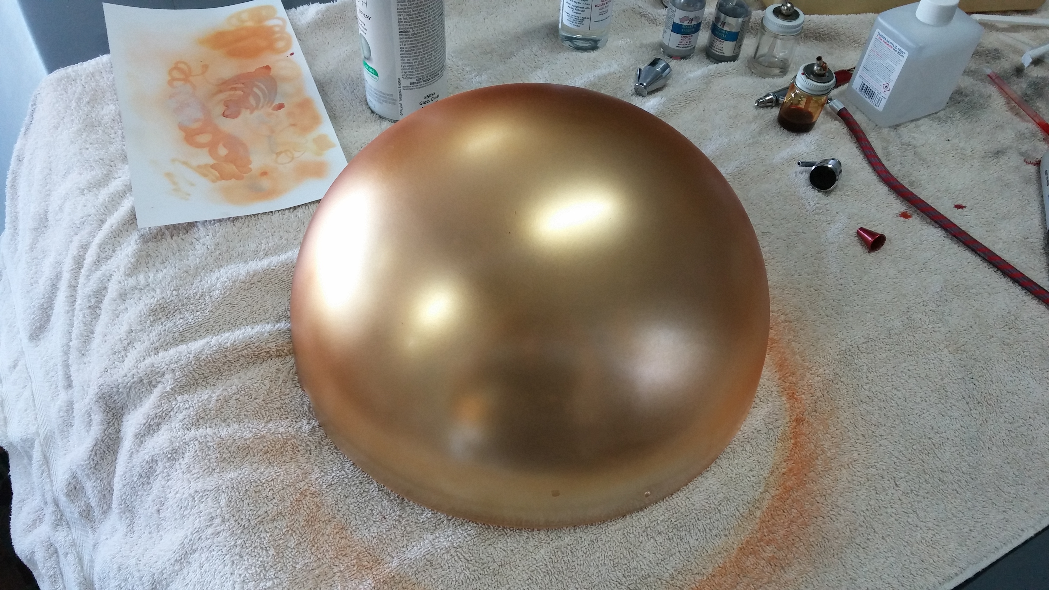

Color on the outside, lighter again this time. Again, not looking great in the visibility department. Time for clear!
First coat of clear! I mocked it up to check reflectivity and decided on another coat of clear, so I'll post a visibility update later.
Also, i plan on picking up some 1200 and 2000 grit sandpaper to really shine this thing up! I'll let you know how that turns out. Hope this helped, if I've left anything out let me know!

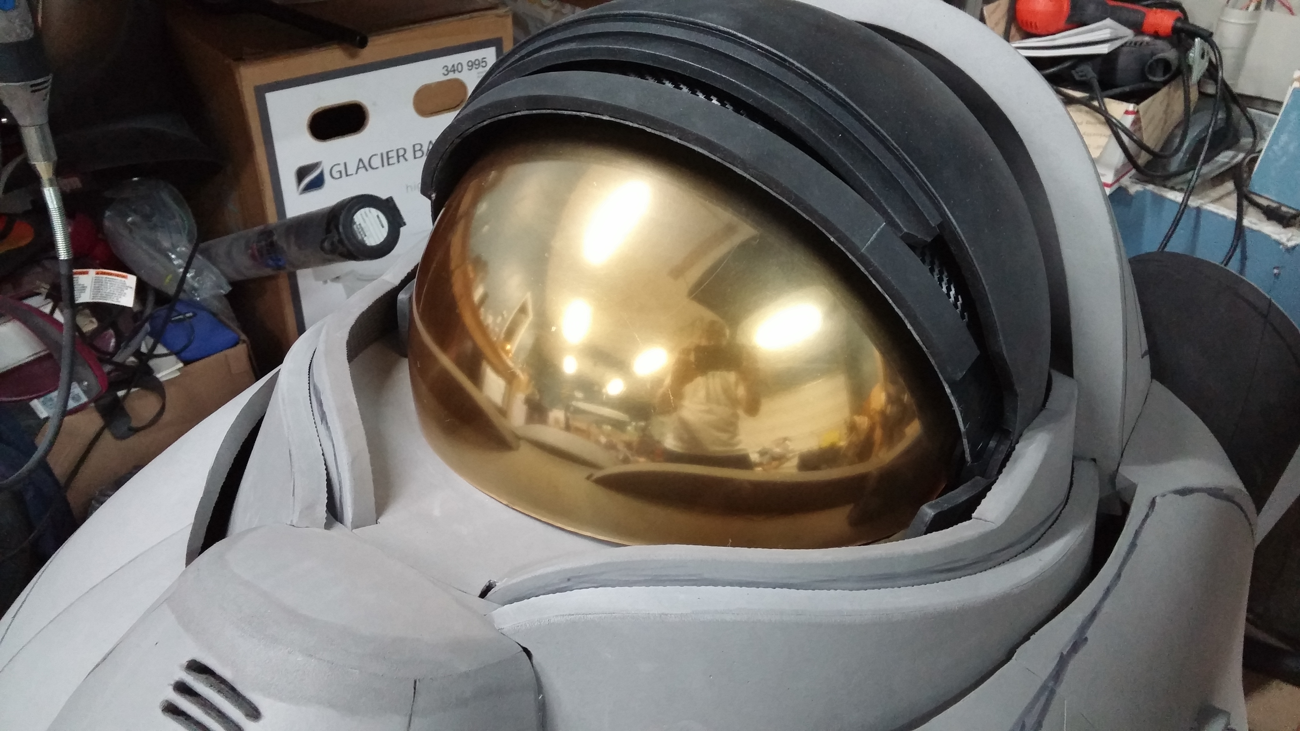

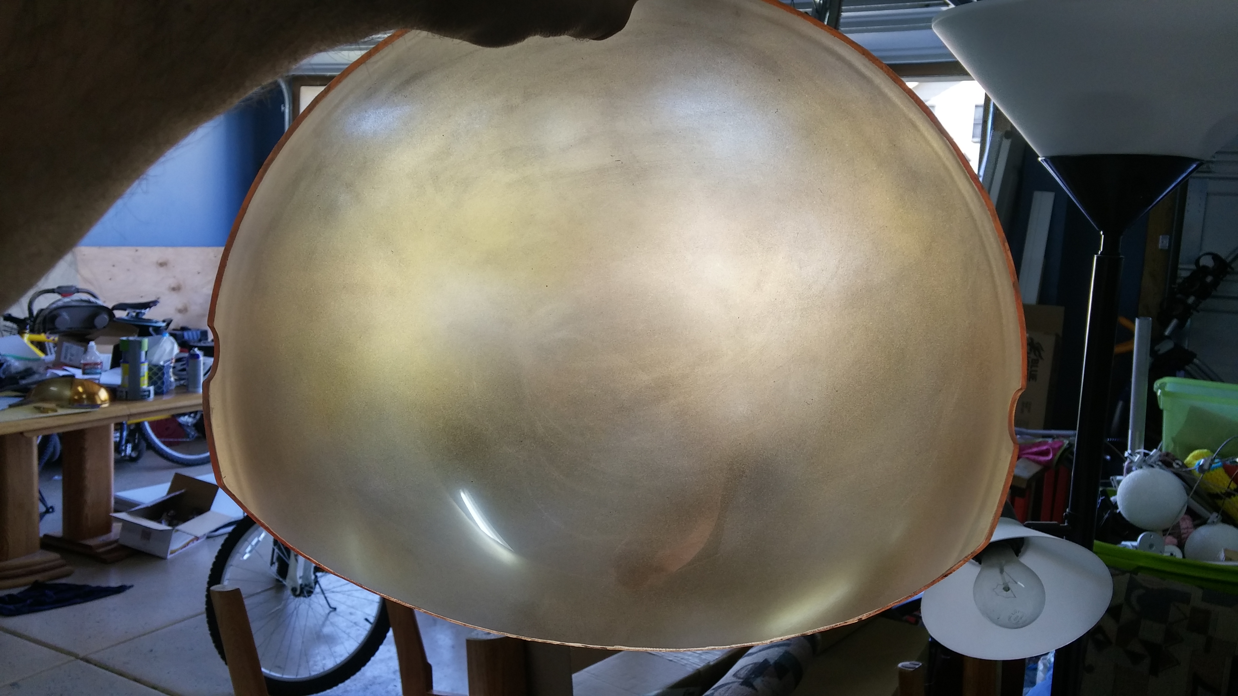

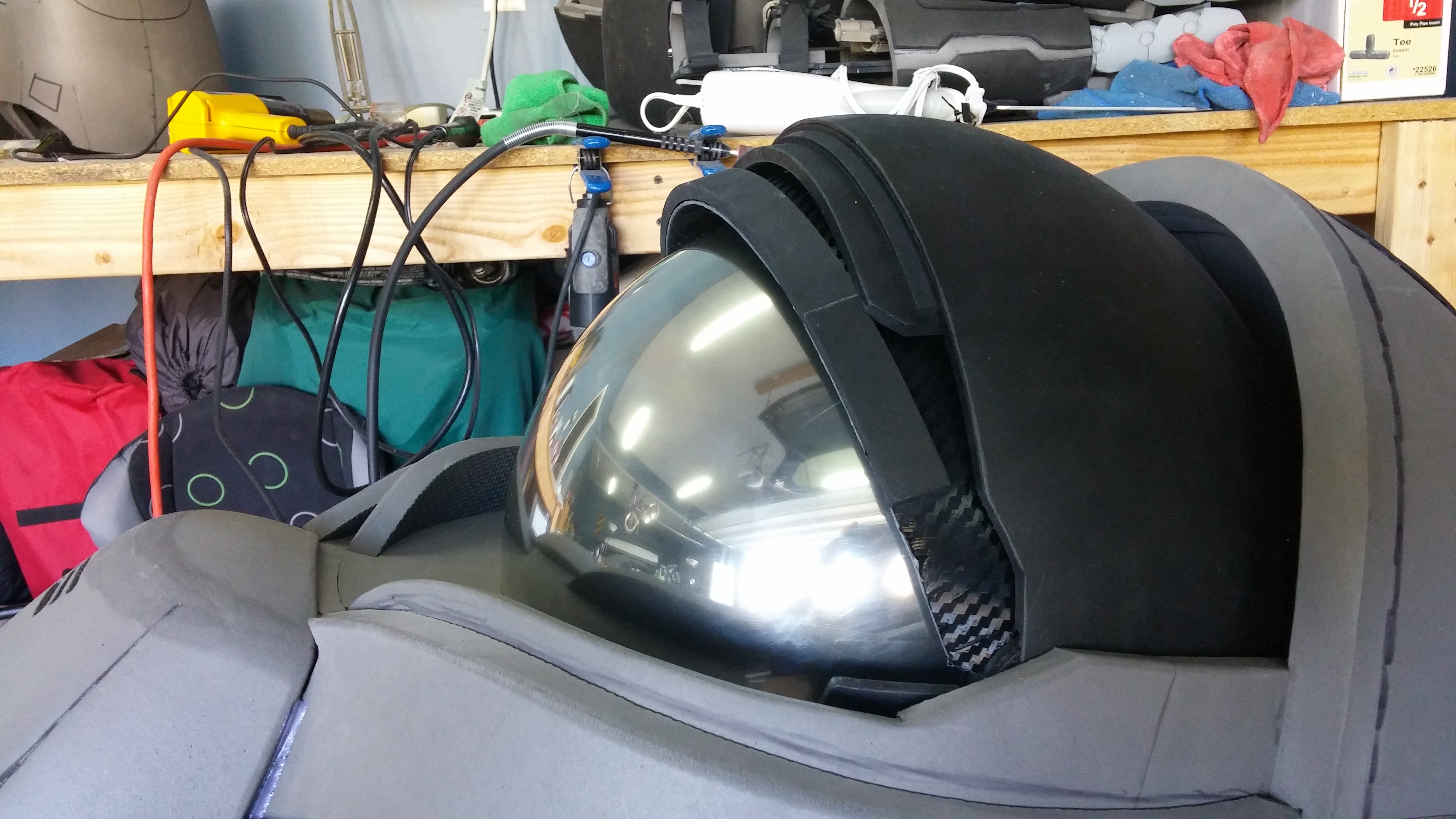

I promised updated pictures so here they are:
I spent an hour or so sanding the helmet smooth, started with 1000 grit then 2000 then 4000 then 6000, then used a rubbing compound to polish it back up to gloss. No more subtle texture on the outside and it greatly increased see-through-ability! Even more so than it already was. Behold!
Nope, that's not a Photoshop filter, that's really how well I can see thru a reflective painted surface. I don't think I could be any happier with the result! Well, maybe a little, but hey for my first time trying this it's not too shabby! You can't tell from the picture really but I focused the sanding in the middle of the visible part of the visor and feathered it out a bit to leaving it pretty rough around the edges for kind of a dusty battle-worn look. Maybe it's too subtle... I'll probably rough it up more in the weathering stage. Anyway hope you like it! TTFN

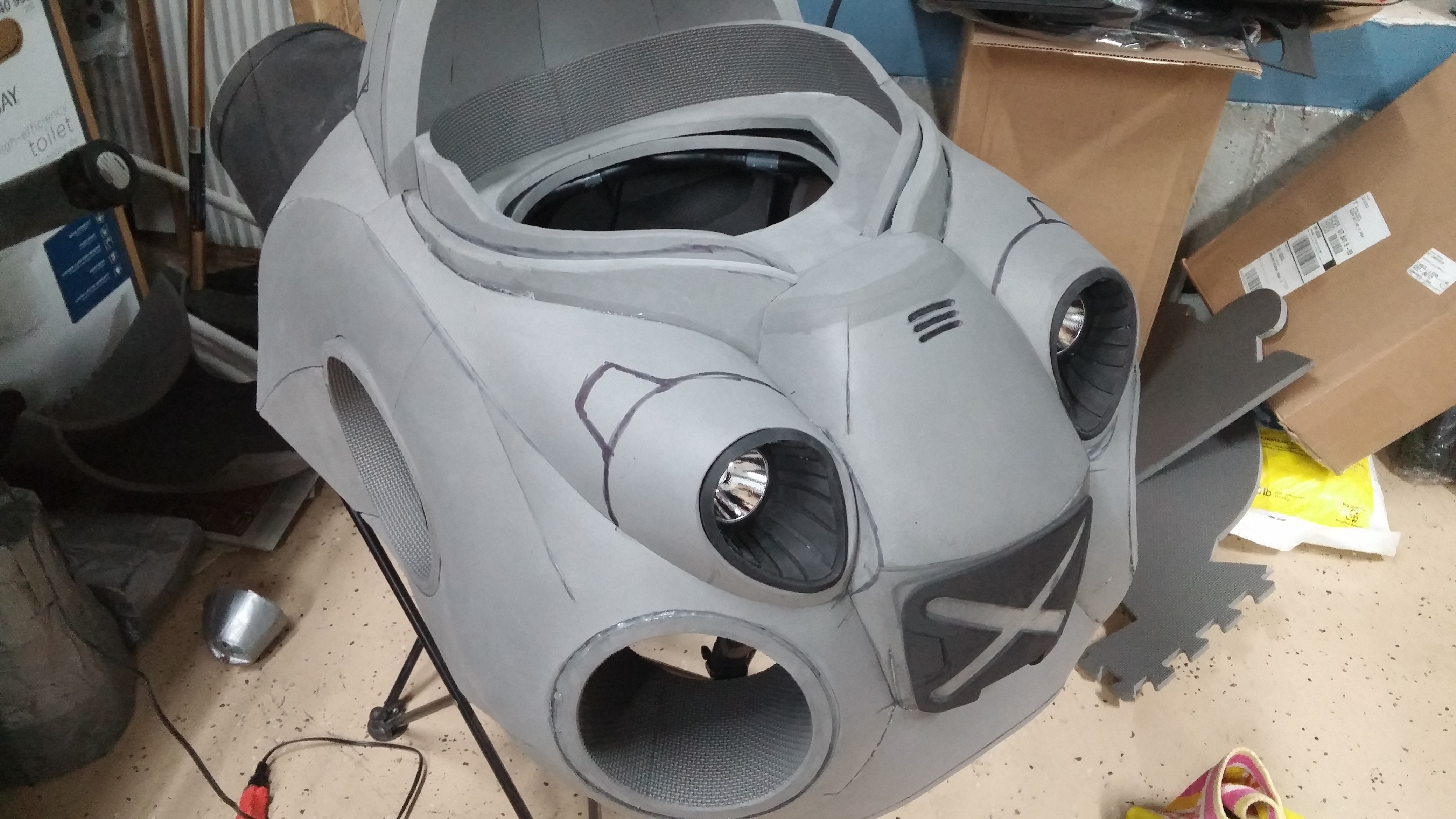

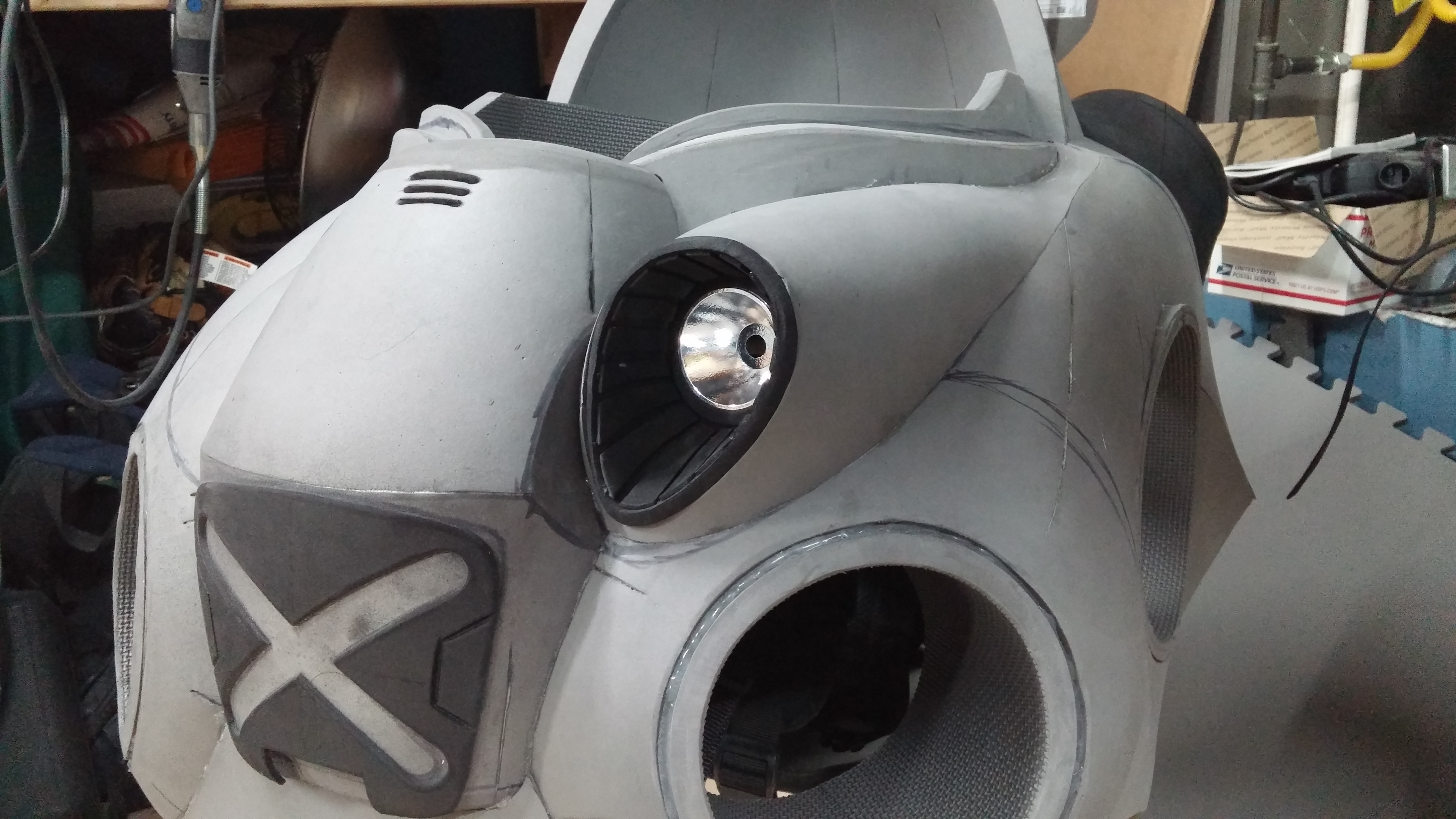

On to the weekend update!

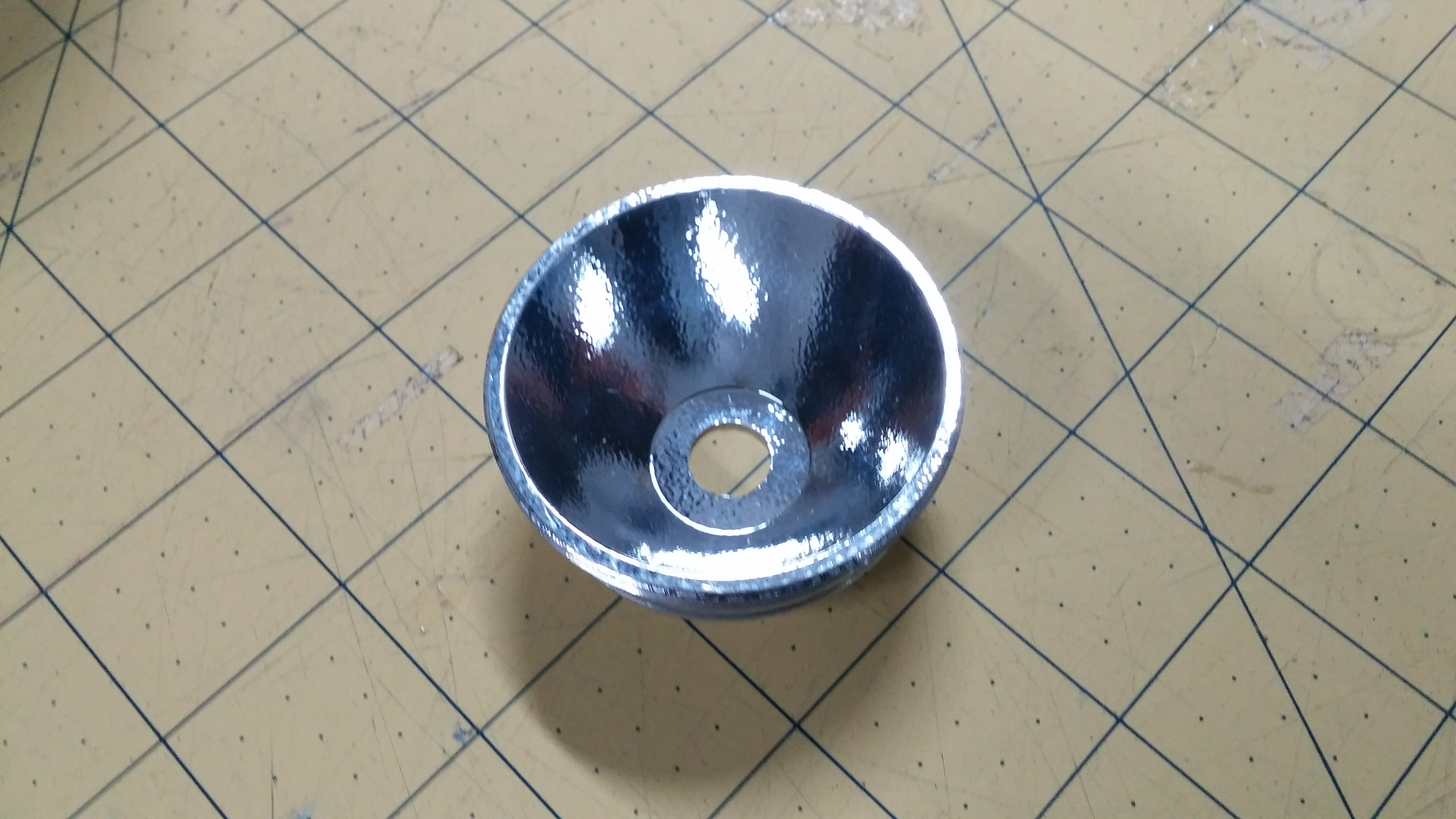

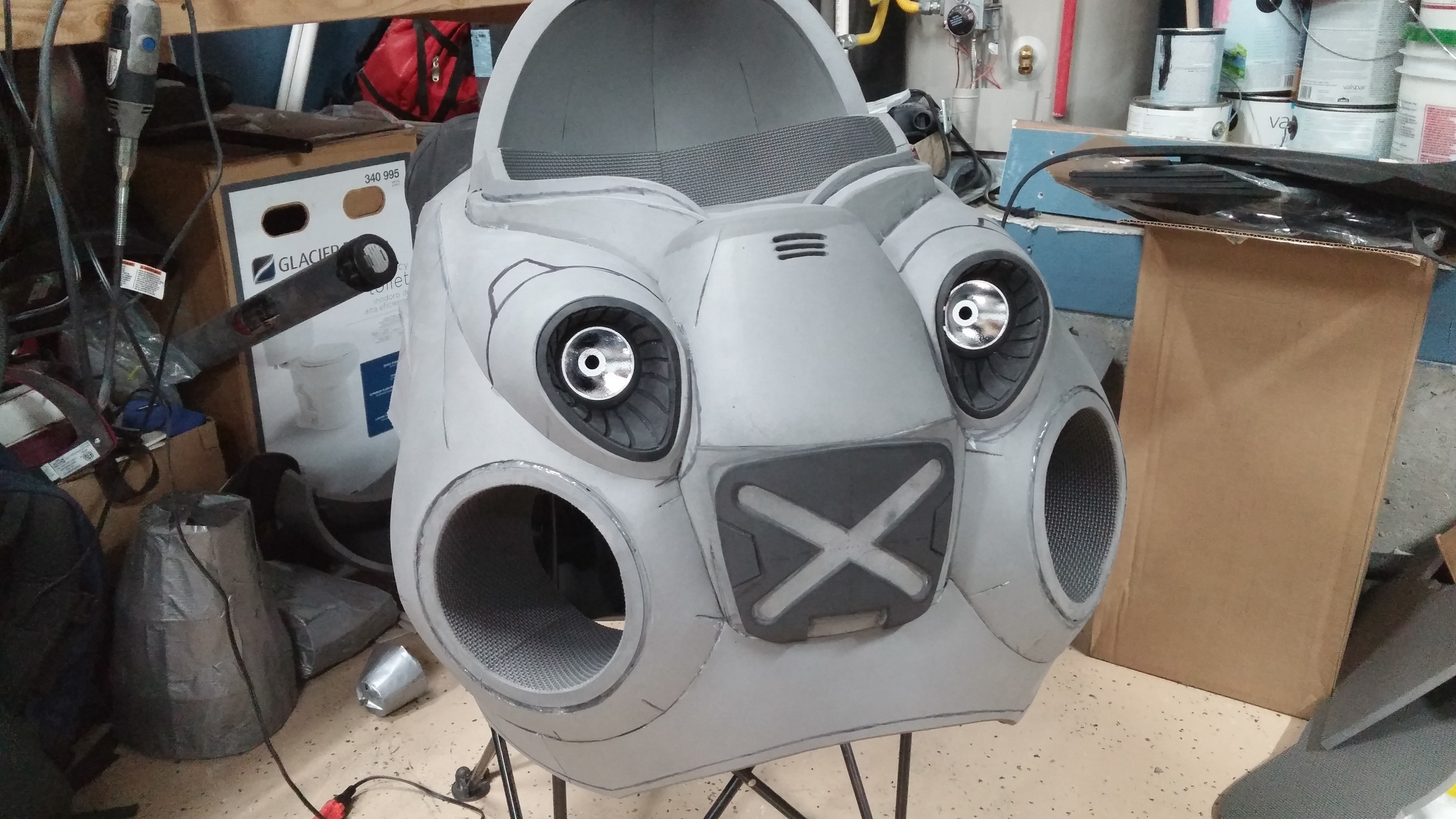

I foucused on the first set of lights on the torso and got the housings built out of 1/4" foamies, then added 1/8" foamies to the inside for the detail work. They're not easy to get to stay in the right shape without some support, but I figure the chest piece will help keep them in line. I found a 2" flashlight reflector online and got it to fit perfectly inside the housing.

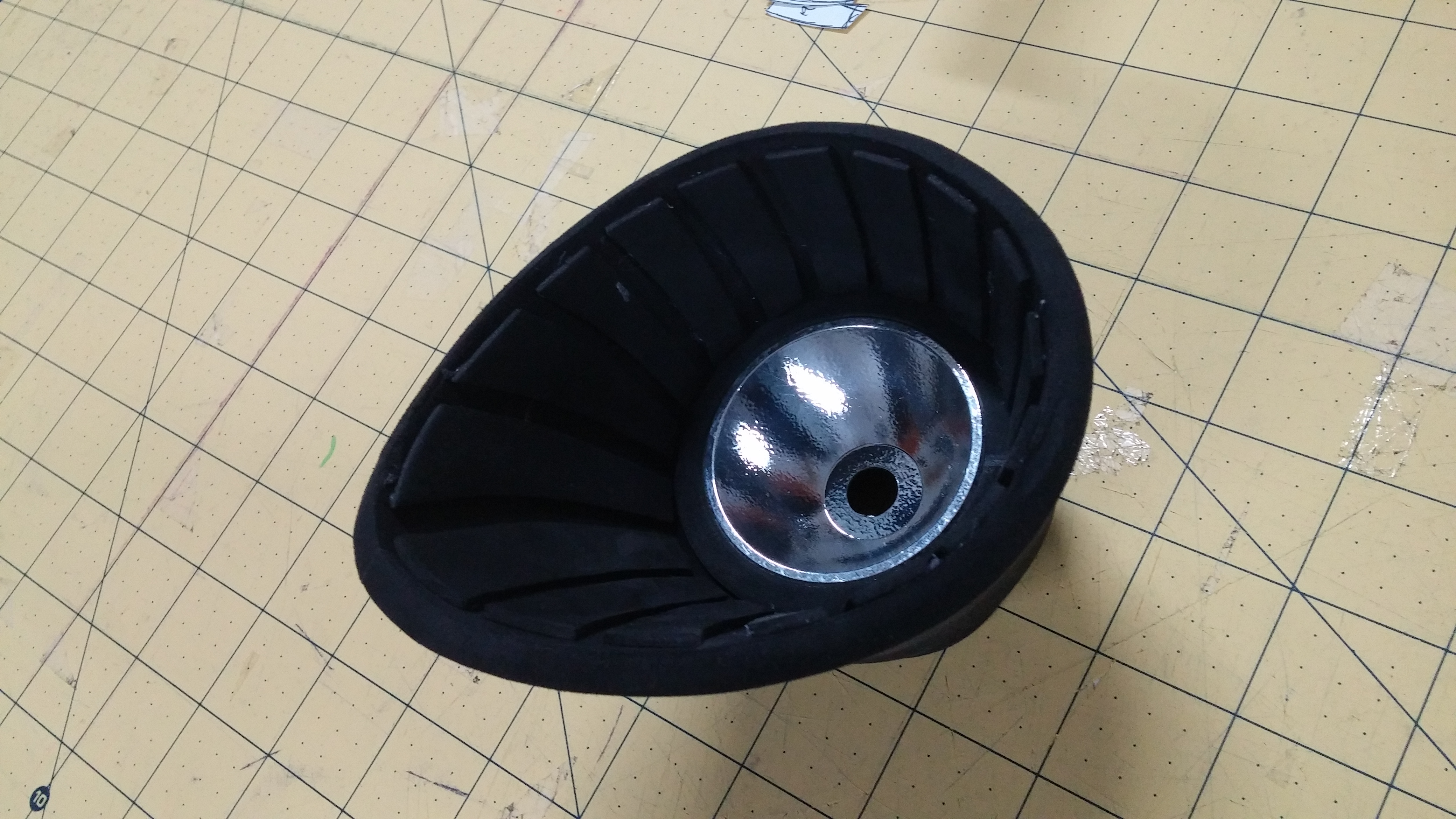

Next, I tried something I've never seen done but I couldn't think of a better way at the time. I've invented sculpting with tape! Basically start laying tape where you want your next piece of foam to be and build it up layer by layer until you have the approximate 3D shape, trim, flatten and transfer, then cut bend and glue! Worked out quite well in this instance. I kinda think it looks like a headlight from some car from the 50's or something. Classy! I roughed out the opening for the housing and test fitted it, then went back and trimmed and sanded until I had the right shape. Still doesn't fit perfectly but it's close. A little more tweaking and it'll be seamless.
I went ahead and did the same thing on the other side and now I'm working on getting them to be as symmetrical as possible. Funny how little differences from side to side will affect the outcome so drastically. I put the housings in temporarily for mock-up because I still need to wire up the LEDs that will be going into them, but I'm very pleased with the result so far! BTW, the lights that I have for these are 10mm white leds that fit perfectly into the reflectors. I have glass lenses that will be fitted over the reflectors after the lights are installed and I plan to use the same method as with the visor to add a slight blue tint to the glass. That'll be later tho as I'm now in the process of building the top two lights and thier housings/mounts.
Thanks for watching, more to come! And thanks again for the feedback! I'm still keeping a tally of the colors suggested. Onward!
