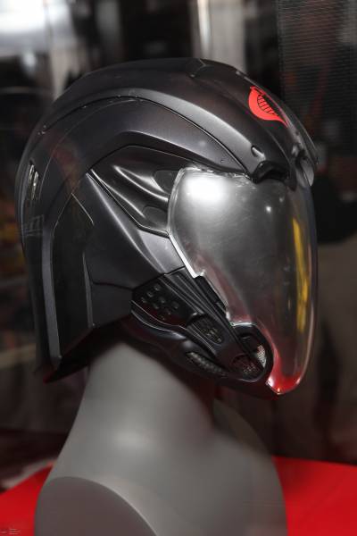

For those of you waiting on helmets, I have a conundrum that I've been fighting with for a couple of weeks and I think it's better if I leave it up to each of you individually.
Spray chroming the visors works well, as you've seen, but I've been bothered by how delicate the finish is. Basically you just can't touch it without leaving marks and it's near impossible to touch up after the fact. The obvious answer is to add a clear coat on top of the chrome to protect it, but no matter which type of clear that I use, I wind up with having to sacrifice something. Either the clear coat dulls the chrome from the outside or it fogs visibility from the inside.
My guess is that most (if not all) will want to err on the side of keeping the chrome reflective but I felt it best to let you weigh in.
Oz
The other option would be sandwich the chrome between 2 pieces of clear

"The other option would be sandwich the chrome between 2 pieces of clear"
That however may work. I'll test it this weekend.

I am very curious about and hopeful about sandwich Idea. As this is what looks like the original movie version had done to it.
Yet it also appears to have the same finish as one on the right that is dulled.

All three have a clear coat. One is an acrylic, one is lacquer, and the third is the automotive clear. Visibility with the auto clear is the same as no clear at all, but it dulls the chrome effect slightly. It still looks very good, IMO, it's just not as reflective. If you're good with that look, then I would recommend going that route.
I ordered a set of thinner plastic sheet yesterday for the inner shield and will get those run as soon as it arrives next week. The inner layer needs to be of a much thinner plastic to conform to the same shape on the inside.
