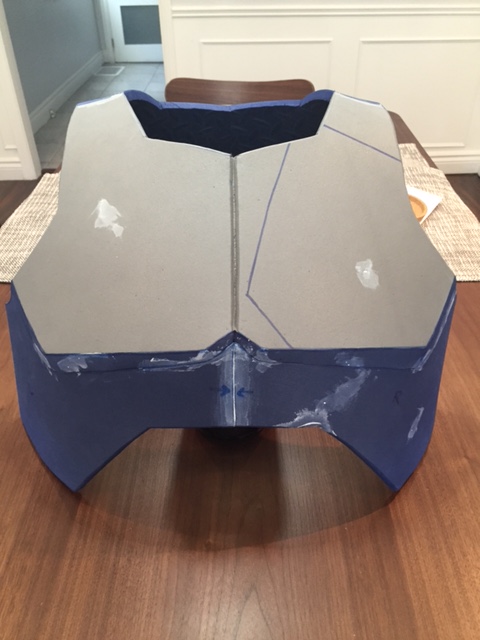

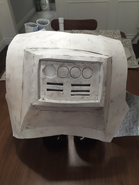

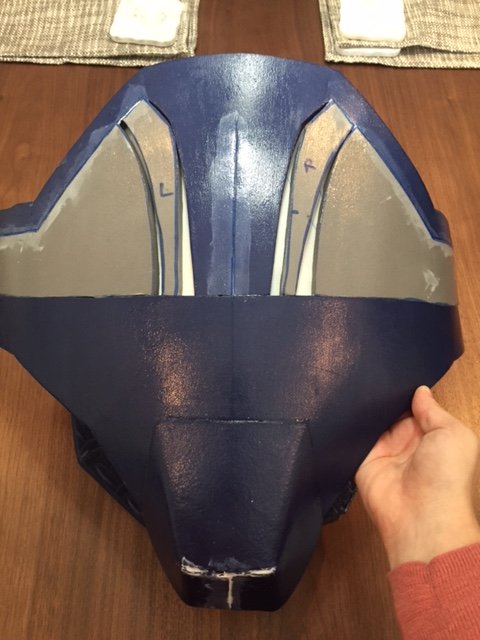

Chest:
- Even though this is for a female version of Rex (Rule 63 :)) I didn't want to differ from the original design because I didn't want it to be overtly feminine
- I also screwed up one of the circles on the back pretty badly so I decided to not cut all the way through but to make a surface cut then heat the foam to open the cut for the rest

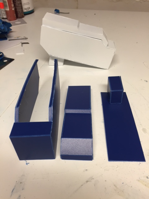

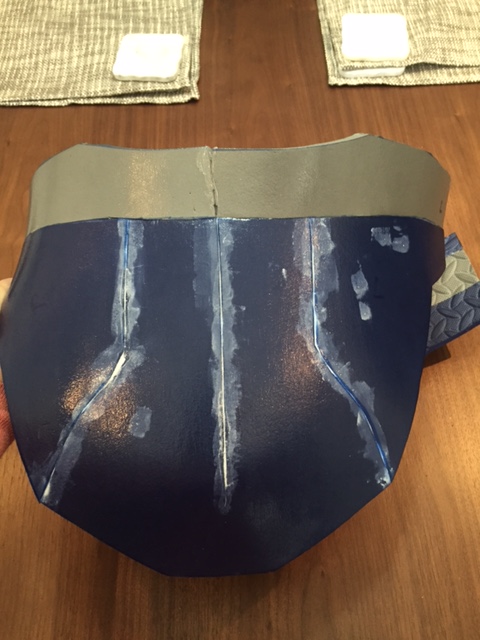

Abs and Cod:
- I attached these two pieces for ease of putting on the armor so hopefully this works out okay for movement

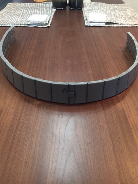

Belt:
- There are two belt boxes I've made for each side that are not attached to the belt yet

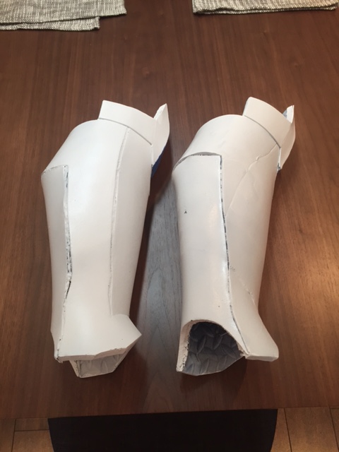

Chins:
- These took a good amount of modifying as I made them one solid piece so I needed to open the bottom quite a bit to allow my foot to go through

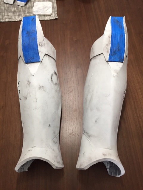

Thighs
Chins

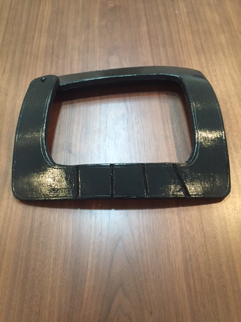

Collar
- made from foam floor mats
- paint is an acrylic high gloss black

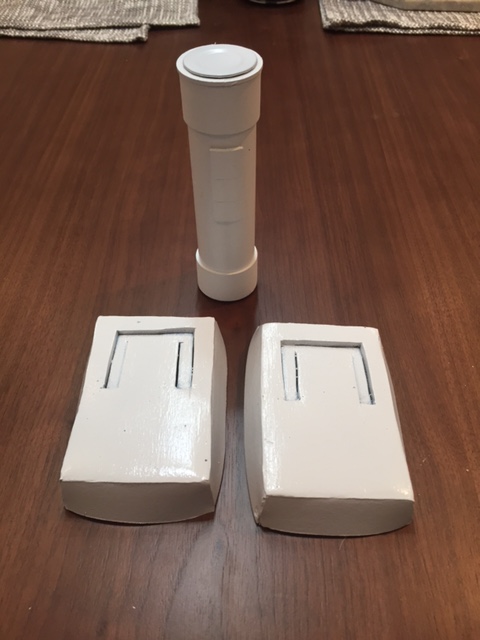

Belt Boxes and Detonator
- boxes made from foam floor mats
- detonator made from a pvc pipe, 2mm foam for button details, and knock out caps on the ends (found in electrical section at home depot)
