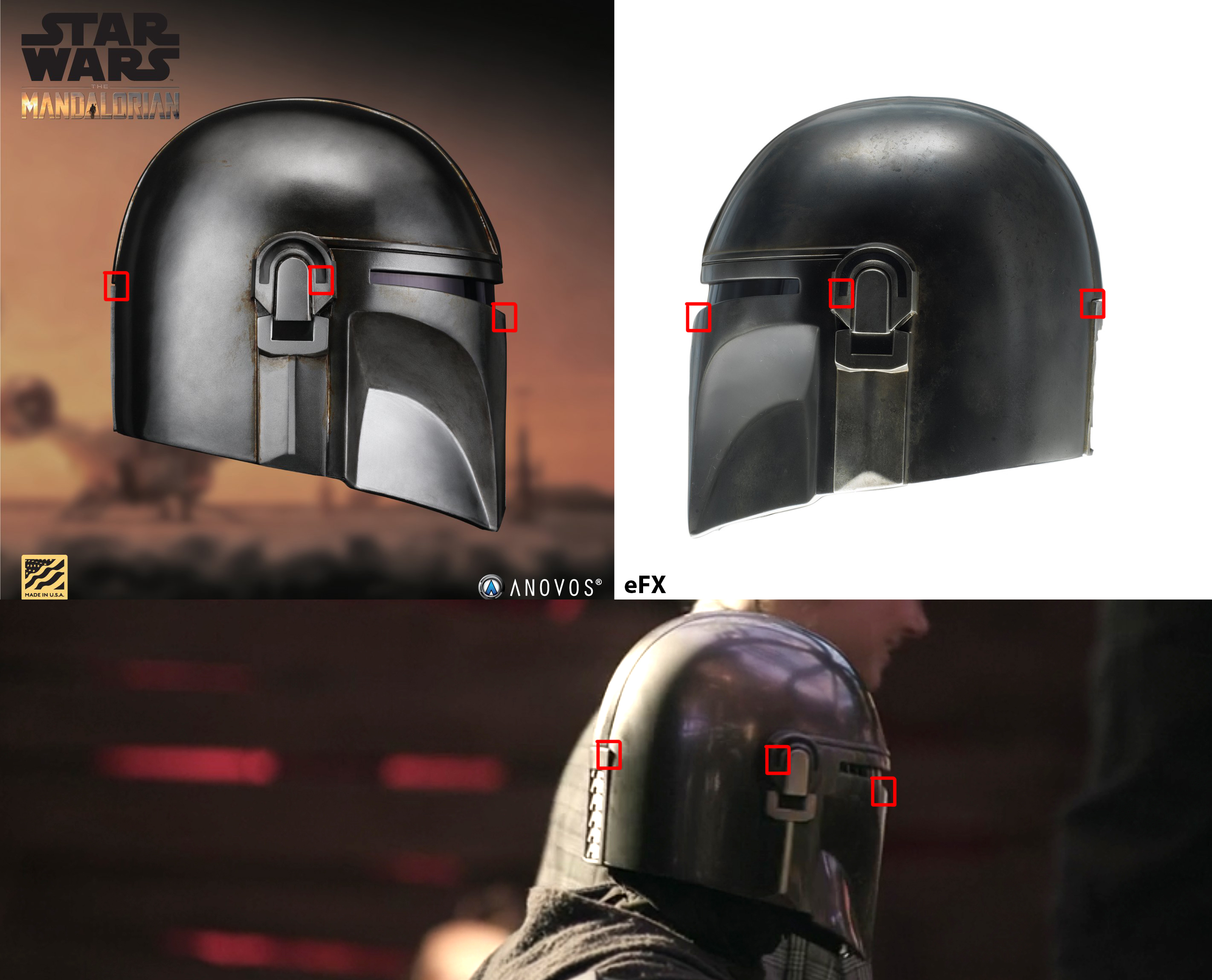

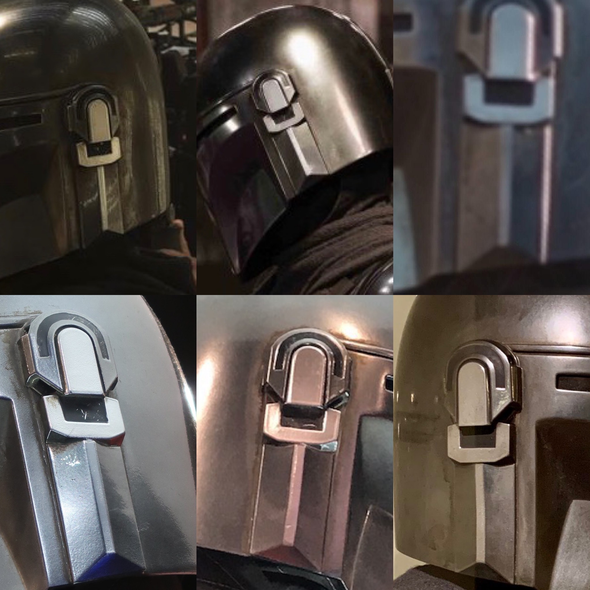

I think it also depends on the angle of the light and the shooting.
Anyway, yes, the "edge" is much less pronounced on the EFX helmet vs the Anovos.
The efx ear can show the vertical line if the lighting is a certain way. It isn't as defined as the screen used helmets.
It appears to be much more common for photos of the screen used helmets to show the brighter vertical line. Maybe that is because of the lighting.
I also wonder if the vertical part is not weathered as much as the angled parts or if the vertical part actually is a brighter shade. The vertical part seems to match the shade on the top part of the ears, but not the angled part.

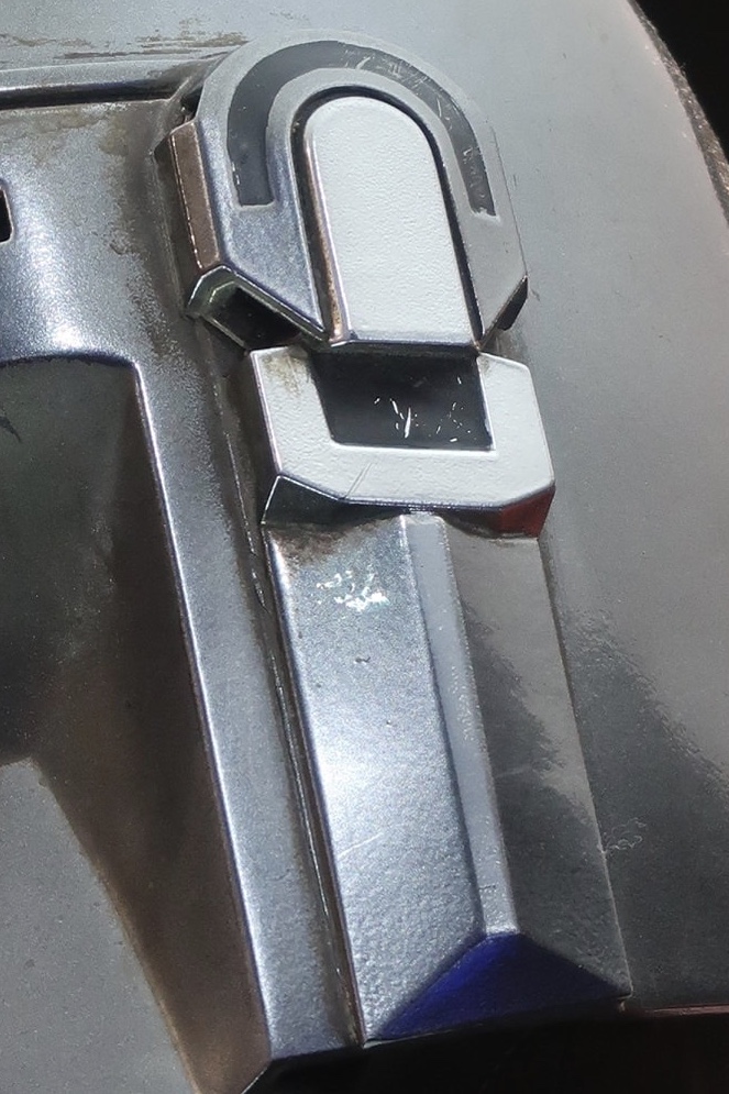

Looking at the bottom photos alone from this post - those ears have a specific edge.
Just going by the touch test on my helmet, the EFX vertical detail on the ears do not feel as sharp as these look. The EFX ears definitely feel rather soft. It's not a lighting thing. It's a sculpt thing.

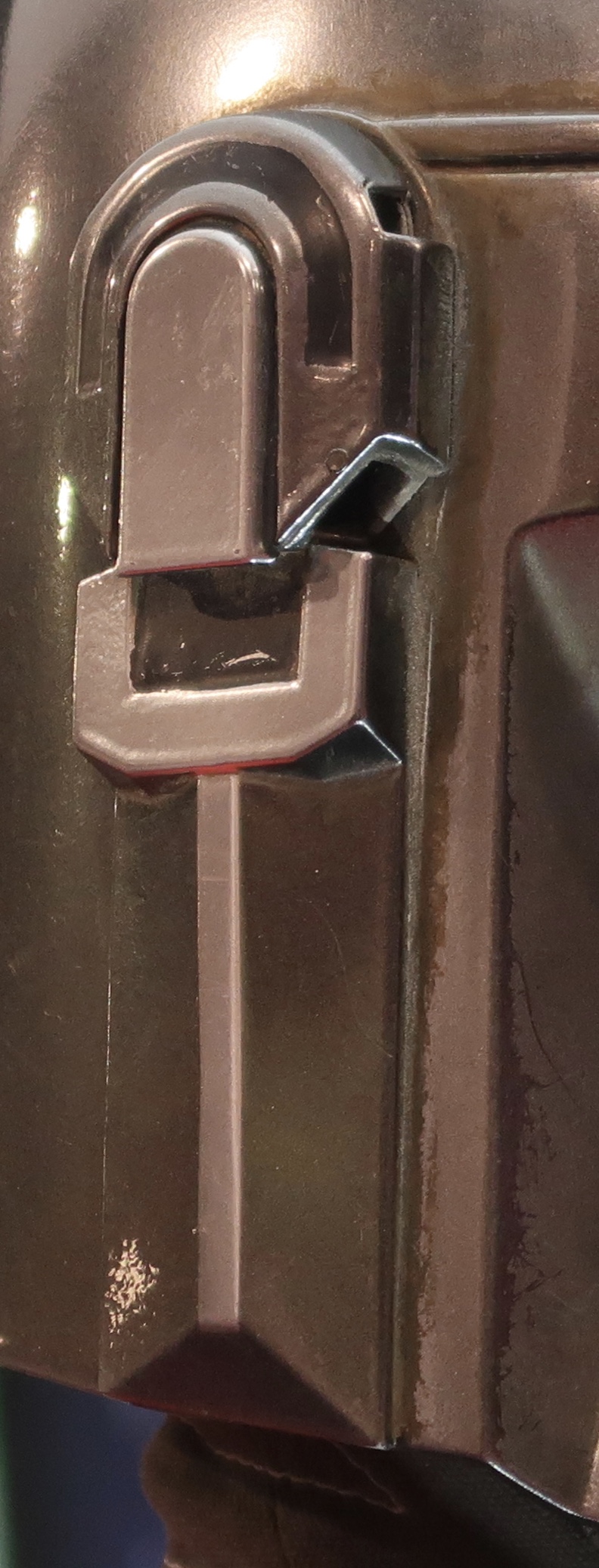

I don’t believe the real helmet has that bottom line too much sharper sculpturally. It is an illusion, as it is taped and sprayed along that edge. In fact you can see in some photos where Legacy actually missed the edge. It looks like EFX freehands that potentially. I almost think the do silver first and then the other color after which is not correct.
As I’ve said several times.. the ears and vent are the same paint as the rest of the helmet. The helmet was sprayed to about 50-65% opacity, while the ears and vent were taken to full opacity. Anovos and myself “cheat” the highlight by base coating them a slightly lighter color and the Alumaluster shows up brighter. Different method, same effect.
On the original helmet, do you think the entire ear is the same opacity and it is just the angle or weathering that makes certain parts appear brighter?
To me the angled part of the bottom of the ears look really close to the main helmet color and the vertical stripe looks brighter.

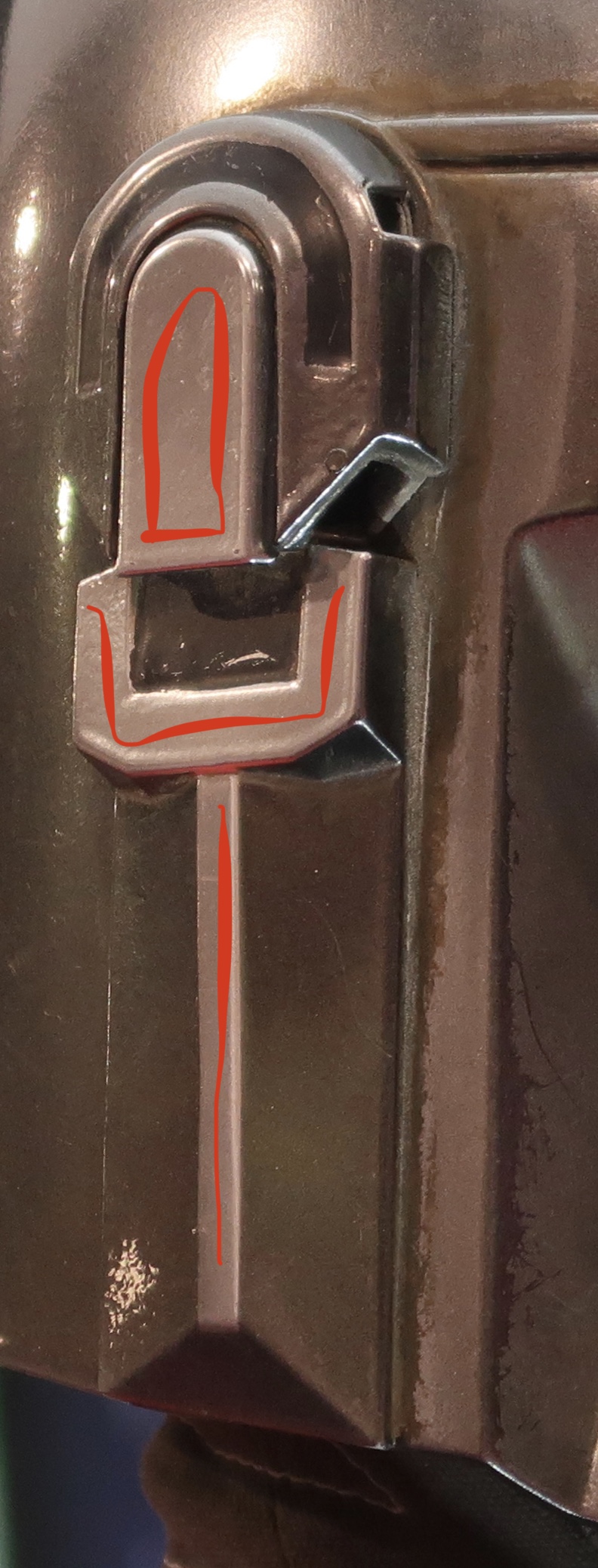

Look, the highlights I’ve marked here in red are Alumaluster at 100% opacity. Meaning full bright aluminum chrome. The REST of the helmet (excluding the vent which has the same 100% opacity finish) is Alumaluster at a lower opacity, for a more gun metal look.
So the process would be, you paint the WHOLE helmet with Alumaluster, consider this a base coat if you will, and then you mask and paint the highlights with MORE Alumaluster. That gives you the variation. The highlight. So yes, the rest of the ear should match the helmet. I hope that makes sense.
Look, the highlights are Alumaluster at 100% opacity. Meaning full bright aluminum chrome. The REST of the helmet (excluding the vent which has the same 100% opacity finish) is Alumaluster at a lower opacity, for a more gun metal look.
So the process would be, you paint the WHOLE helmet with Alumaluster, and then you mask and paint the highlights with MORE Alumaluster. That gives you the variation. The highlight. So yes, the rest of the ear should match the helmet.
Yes, that makes sense for how the original helmets look to me.
The bottom portion of the ears on the efx look too uniform to me (not brighter on the vertical part) and the color on the angled parts does not look the same as the main helmet color. This seems like a pretty odd decision to paint it like that.
