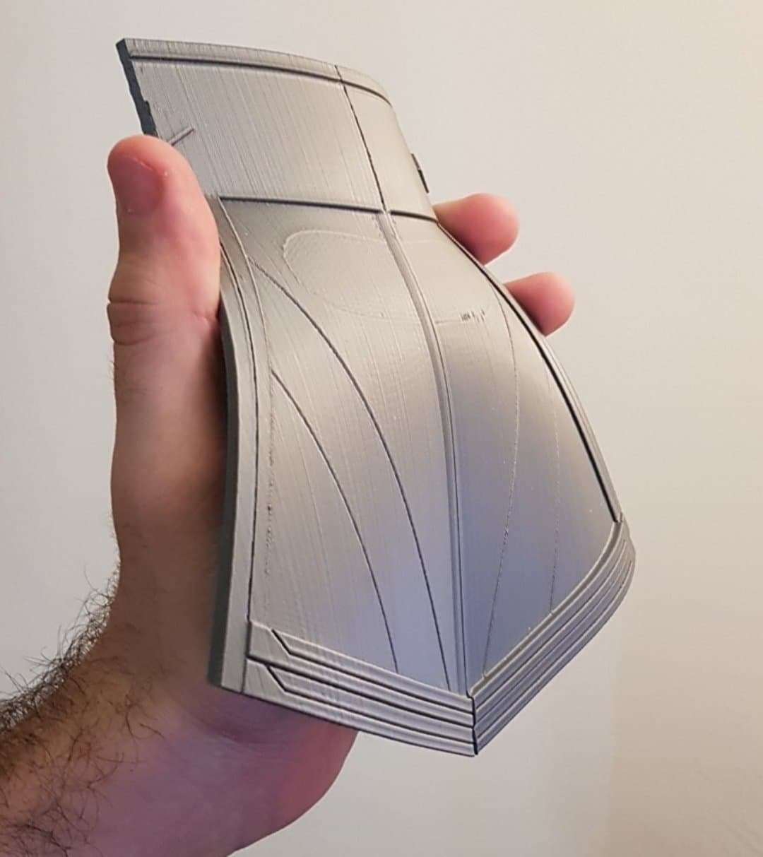

I started by finalizing the spine plate, and threw it over to netfabb for splitting and printing!
2019-01-02 12_25_17-Autodesk Netfabb Standard 2018.0 - V47_Neck-Spine_Plate_Sculpt.fabbproject.png
2019-01-02 12_28_22-Simplify3D (Licensed to Luke Daley).png 49081695_335612160609416_1014001255569162240_n.jpg 49153874_957614304438277_106886587647787008_n.jpg 49388114_2186327431618861_1792050833395810304_n.jpg
it contours really well to the spine and looks the part! *cheers*
